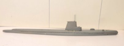

Reshaping of USS Entemedor's hull begins. She has to get ugly, before she gets p-p-p-p-purty!
The outer hull had a slightly different profile than a standard Balao or Tench class boat. Hydrodynamics and that sort of underwater guff.
A less devout model maniac might have simply reshaped the bow profile and called it good.
Not THIS fat kid! It must be "just so" for the TLAR Models name to go on the box!

GUPPY IIa boats had distinctive, rectangular limber holes in the outer hull. The idea is to fix .015 X .030 strip vertically, gently saw them to the proper shape, cap them with another strip of plastic and then gently sand all this smooth.
I will not post every intricate, boring step of this process, rather give my mates an idea of where the project is going.
Oh my! The jig it's sitting on, part of the casting?
This is the framing is to support the Master for molding. The framing is cut away from the castings before packaging the kit. I almost "cheaped-out" with just reshaping the bow, and making the forward array and molding the hull, but Bob Kirby and I would know the difference, even if nobody else did.
A couple of days have passed. USS Entemedor progress has been steady. I might have accidently, carefully, made just the right cuts. The midships rectangular midships limber holes look about right. P/E parts will make up the rest of them. These are cut from strips of 1/700 bridge windows.
It is obvious my model Master has quite a bit more freeboard (the distance from the waterline to the main deck) than the actual combat-loaded sub in the picture. Wet, swirl-sanding the casting will easily reduce the freeboard.

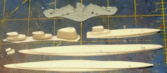

The first casting of the US Navy 1/700 Fleet Schnorkel/ GUPPY submarine mold during the Google meet came out swell! A second casting cures in the pressure pot as we speak! From left to right are the Portsmouth sail, the Electric Boat sail, and the North Atlantic sail, or conning tower.
You can see the resin contents of TLAR Models Kit #518. I cast this lot in natural, cream-colored LPP, because I've had the tint react with the mold release in in initial castings in the past. Following sets will be cast in the cool, gray color that is a TLAR Models standard.

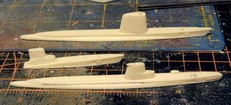

It seems the extra effort on the USS Entemedor ballast tank vents was well spent! Once again, Tamiya X-22 (thicker) and Future (lower viscosity) gap-filling properties on display.
