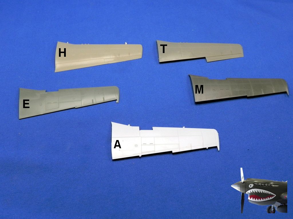

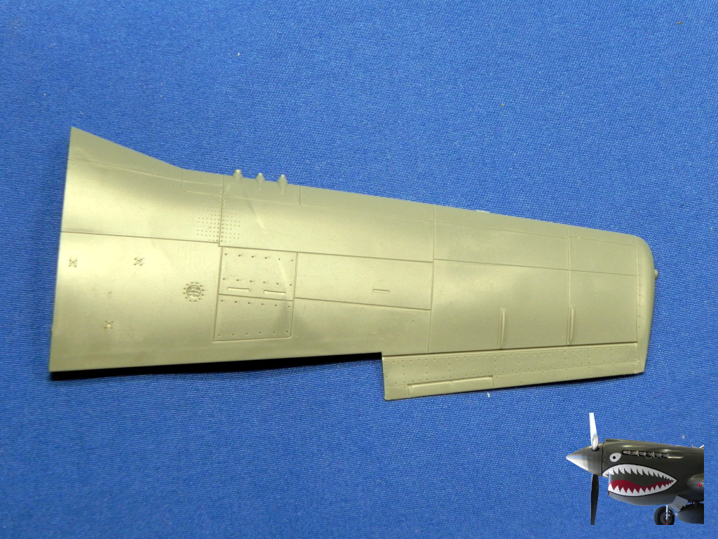

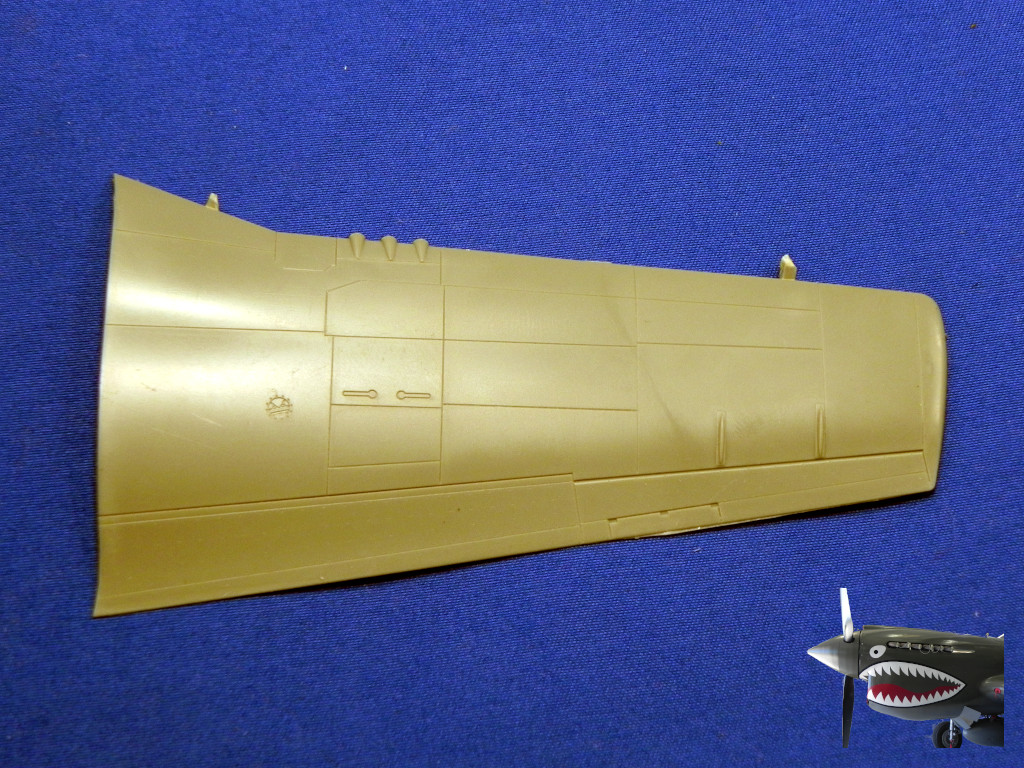

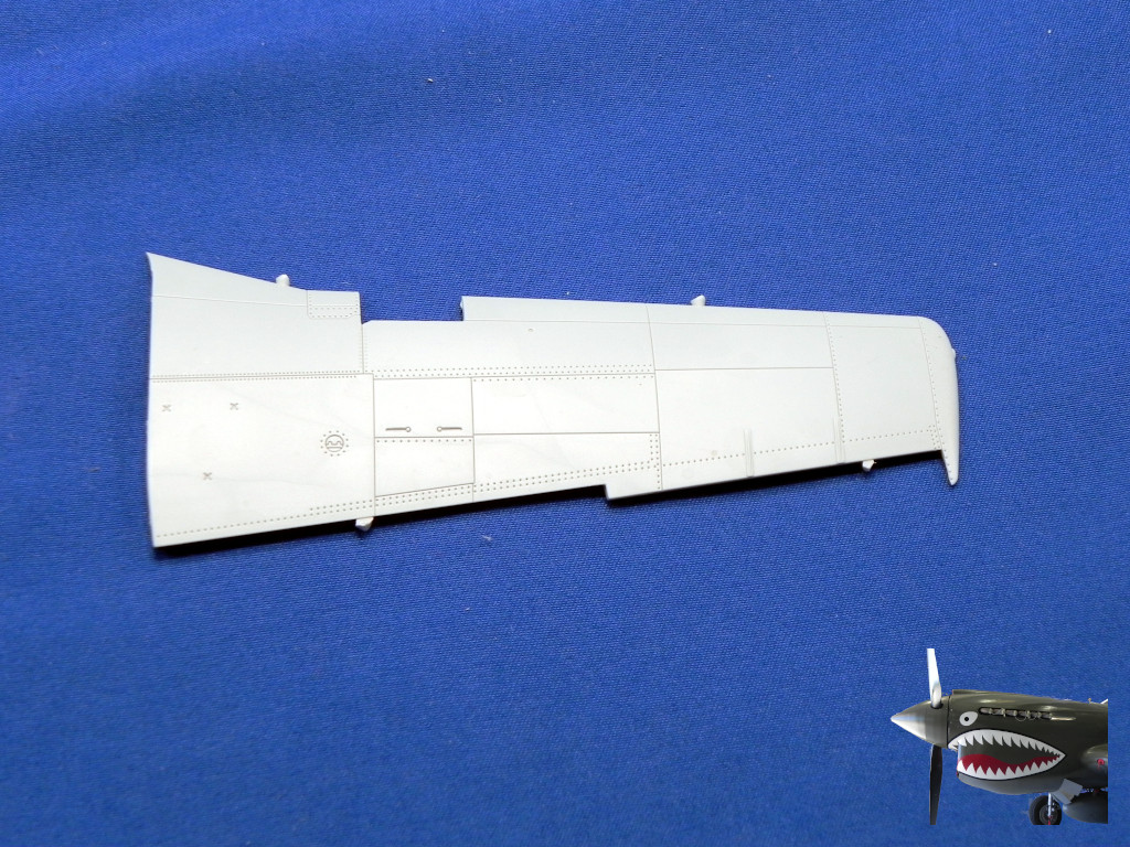

Perhaps I am not seeing the trees for the forest. Last night, I took out the five kits and looked long at the starboard upper wings. I didn't see any difference on the gun bay covers but both Airfix and Eduard have a finger push (button?) lock release on the ammunition bar cover while Hasegawa, Tamiya, and Meng do not. I am aware of which museum airframe Airfix scanned and I know which airframe (a warbird) Eduard used. I'll try to find photos to see if their doors presently have that push button lock, or not. In any case, I will also check out the actual aircraft's history, to see when and how it was rebuilt.

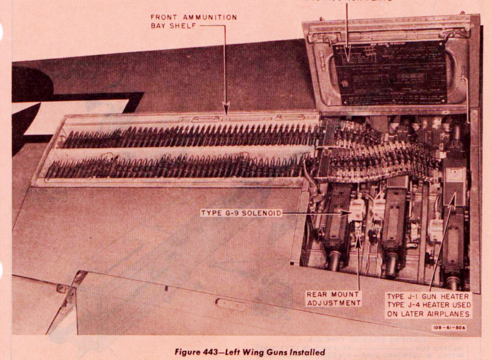

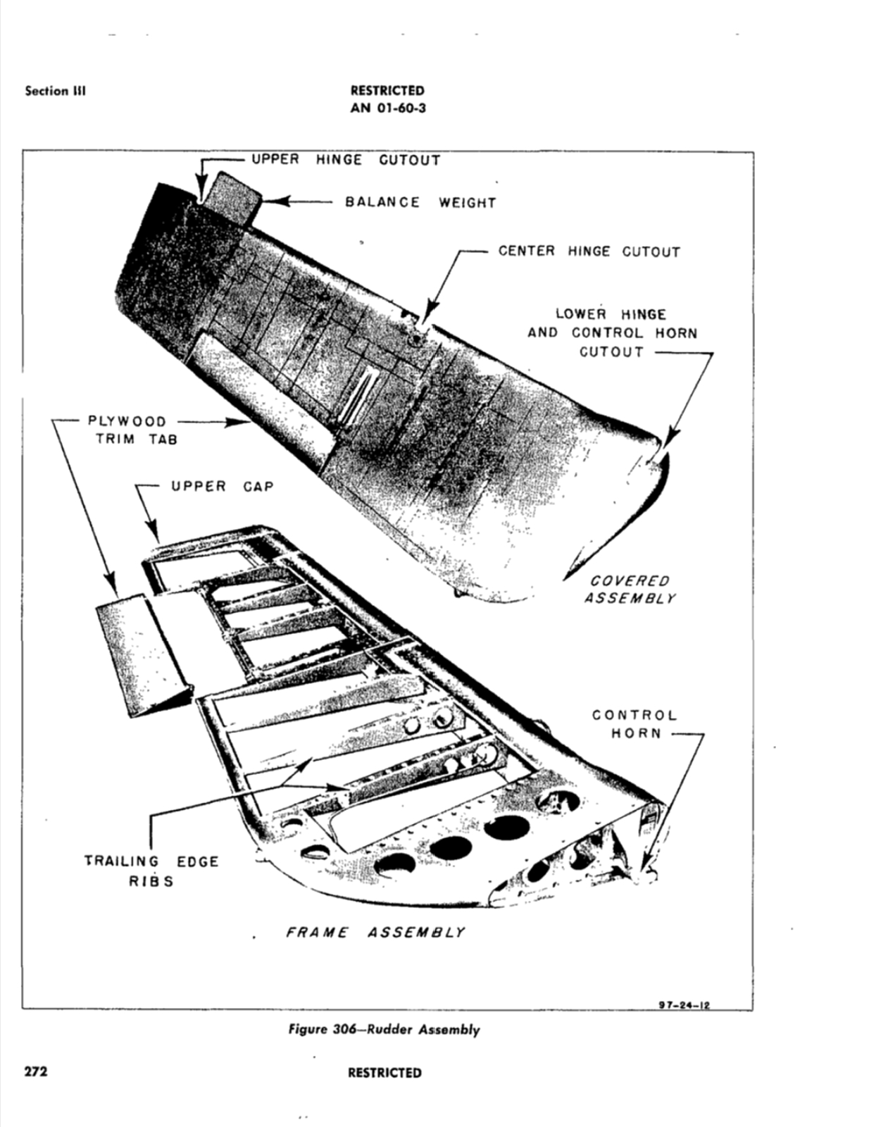

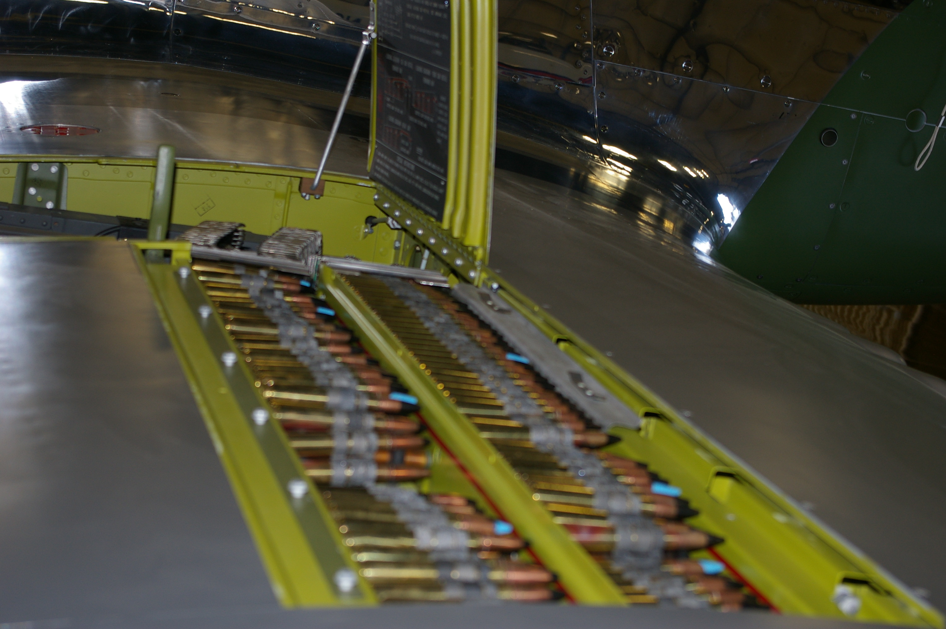

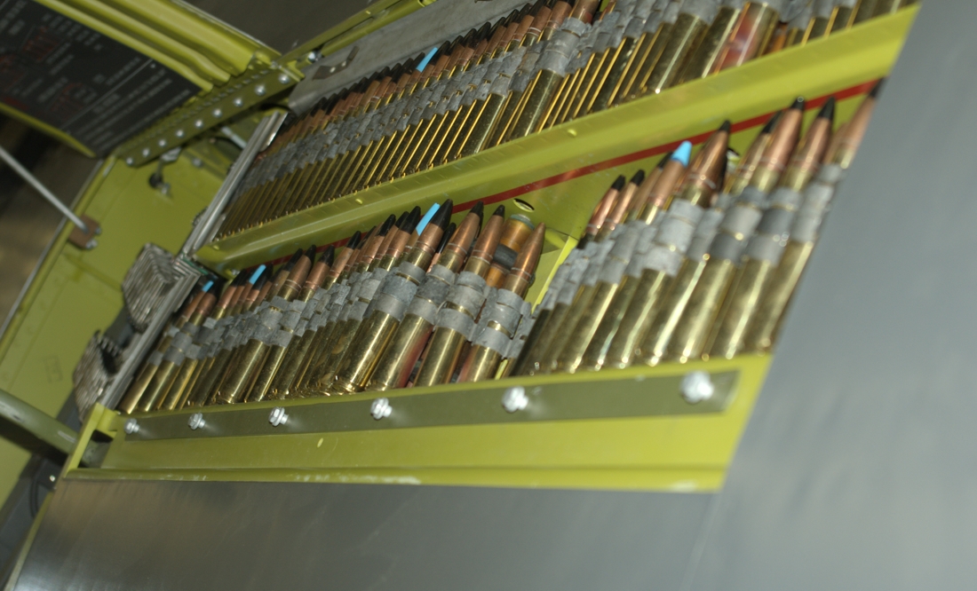

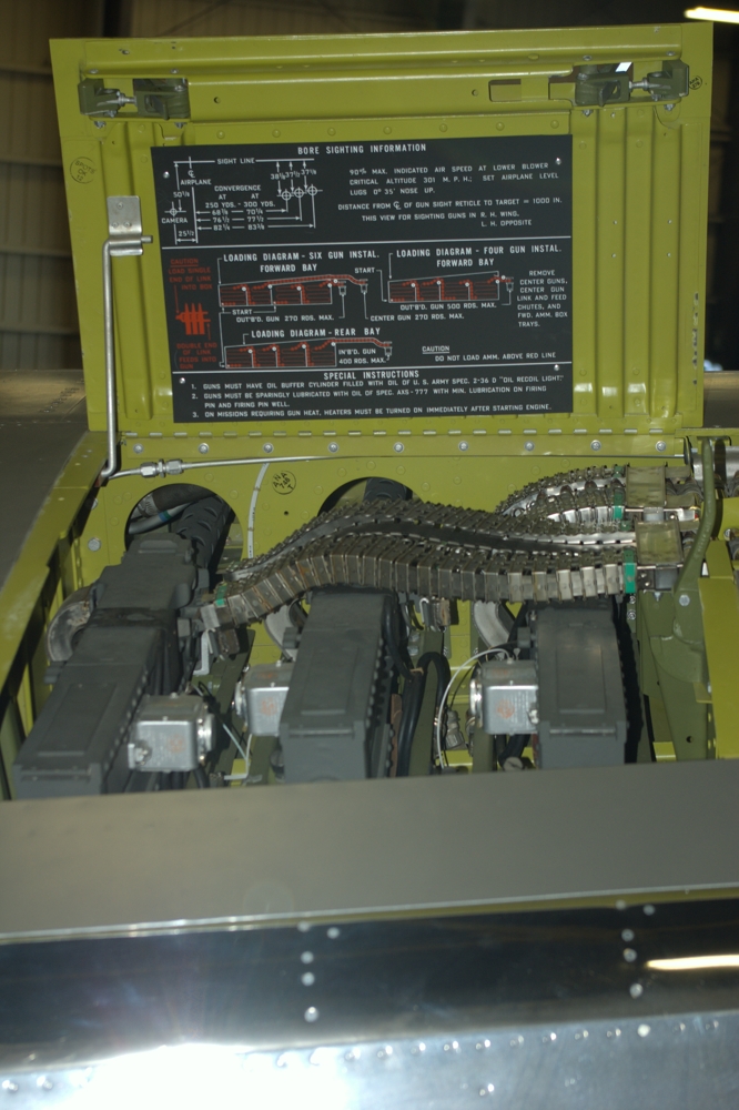

My issue with the Eduard ammunition doors is that they are very obviously not true rectangles, but get noticeably bigger as you go to the tip. I just looked at a Tamiya kit and it is a little that way as well but not nearly as much. Here are some photos I took of the D gun bay, and also some images from the D Erection and Maintenance Manual. After looking at all these closely I can see the ammunition bay cover widening slightly as you move outboard due to the skin on the front side moving away from the structural member enclosing the actual bays, which of course have to be parallel. I think there is also an issue with the forward gun bay door, which I do think is square, or perhaps the inboard side is marginally longer than the outboard, but Eduard has it significantly longer on the outboard side.

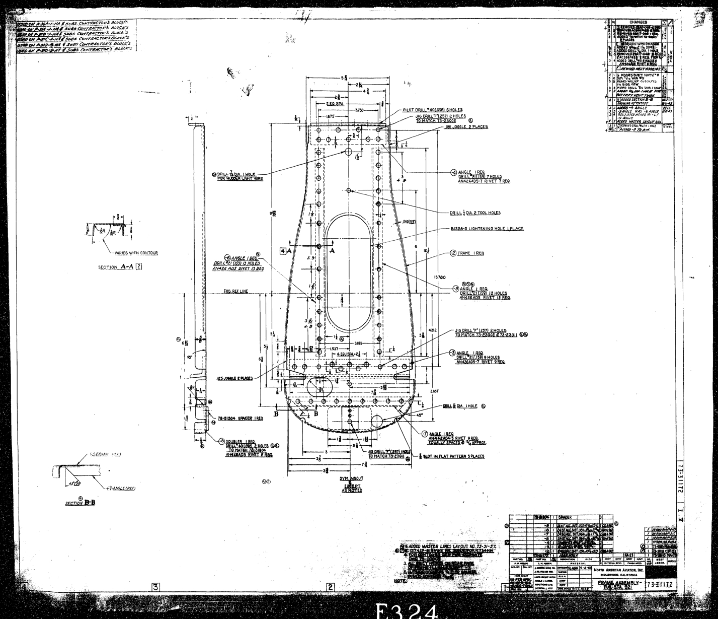

None of this should cause people not to enjoy building the kit, but it still is hard for me to understand. The actual construction blueprints and manuals for the Mustang have long been available in DVD format, they are here on my computer. The rudder structure is also included here to show the bulge on the bottom of the rudder, it is there to conform to the larger cross section of the fuselage below the stabilizer and to keep the gap small there as the rudder rotates.

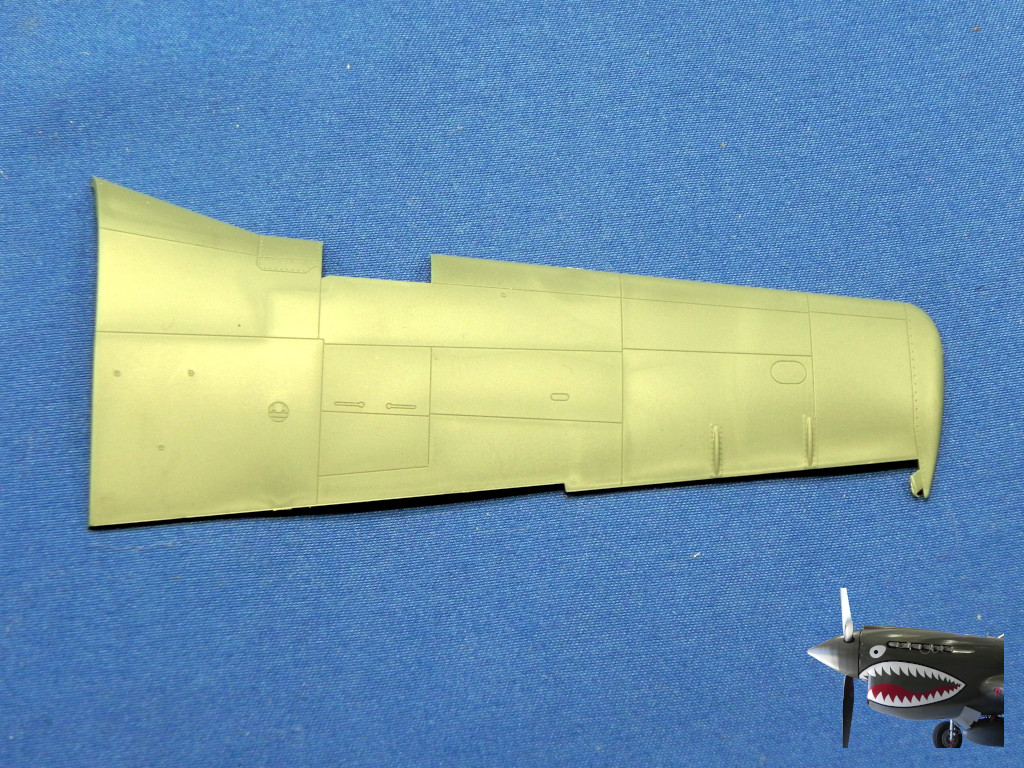

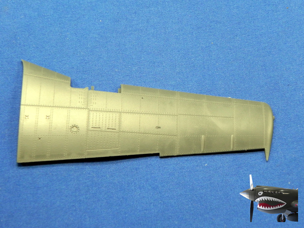

Seems to be a lot more rivets than needed.
Hasegawa, only panel lines to fill in.
Tamiya's flurry of rivets near the leading edge is to represent the strengthening plate added by T.O. (Technical Order), mostly panel lines to fill in aside from these.
Meng got carried away... most work of them all (aside from the Dragon 32nd scale one).
Airfix has a few, so not too bad.
Eduard only has panel lines to fill in. Since panel lines are filled in on ALL, it should'nt be a big deal to fill in the (ammunition and/or gun) bay doors and rescribe to correct dimensions.

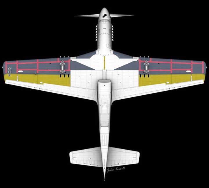

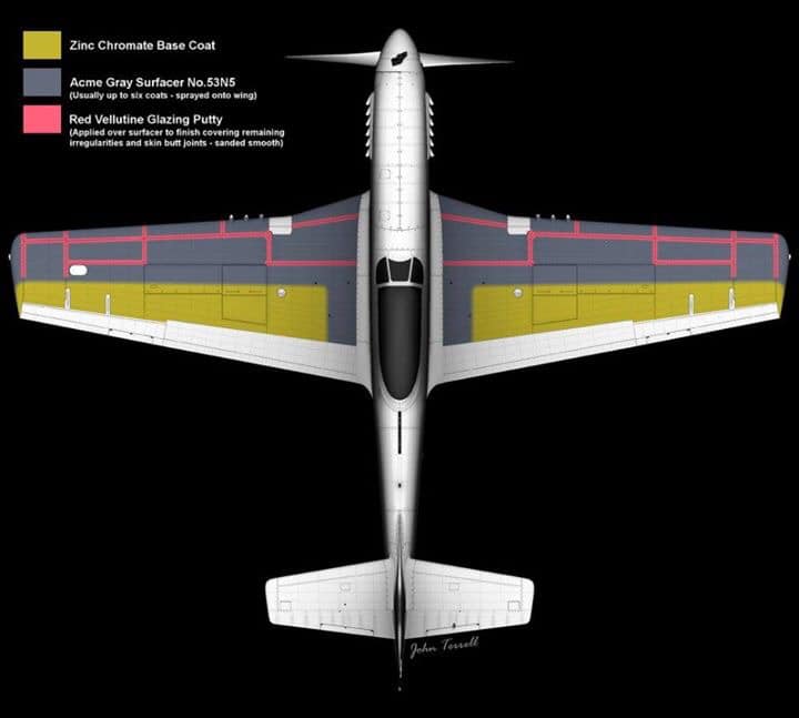

Schematic showing the filling, painting, sanding done to them at the factory (courtesy of John Turrell):
For clarity, Zinc Chromate is added to the complete wing (minus radio altimeter inspection hatches (outer ovals on wings), landing gear covers, fuel tank covers, and wing strengtheners (gussets on wing in aileron area, two above & one below). Then the Acme Gray Surfacer was added to at least 40% of the leading edge (top & bottom), with Red Vallutine Glazing Putty on panels lines and all sanded down to a smooth finish before receiving aluminum paint over all prior Zinc Chromate surfaces (yes, gun and ammunition bay covers too).
