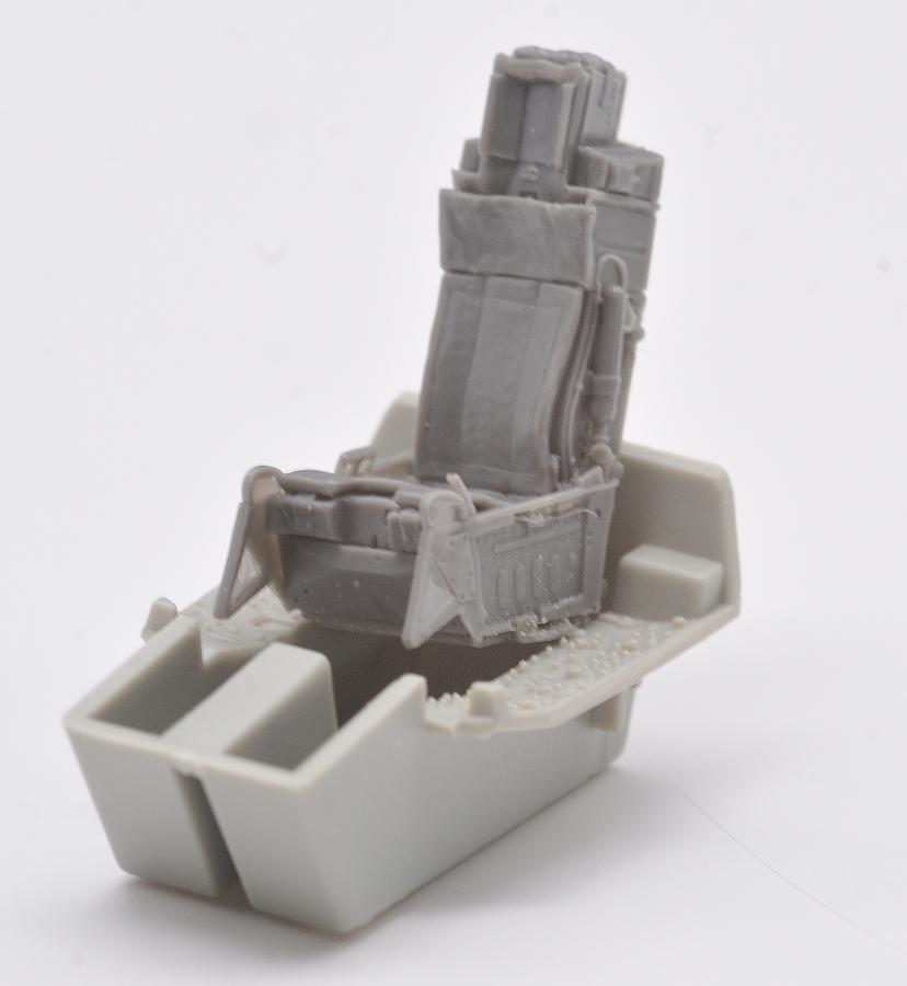

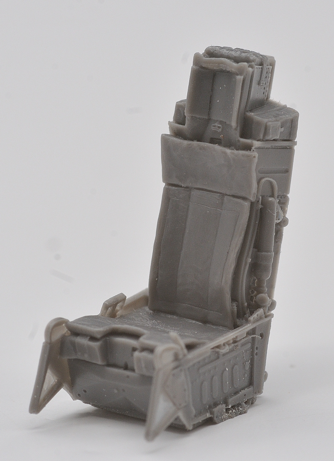

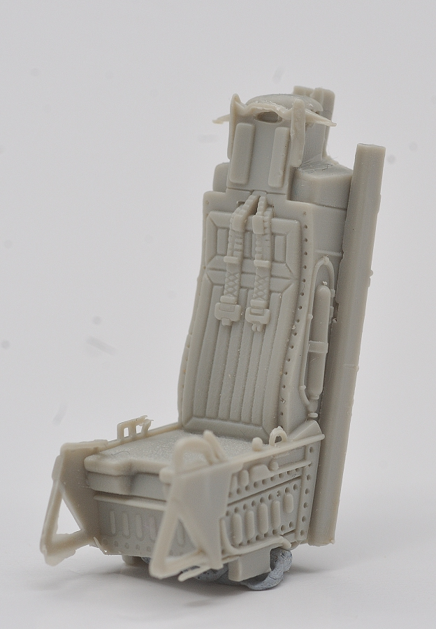

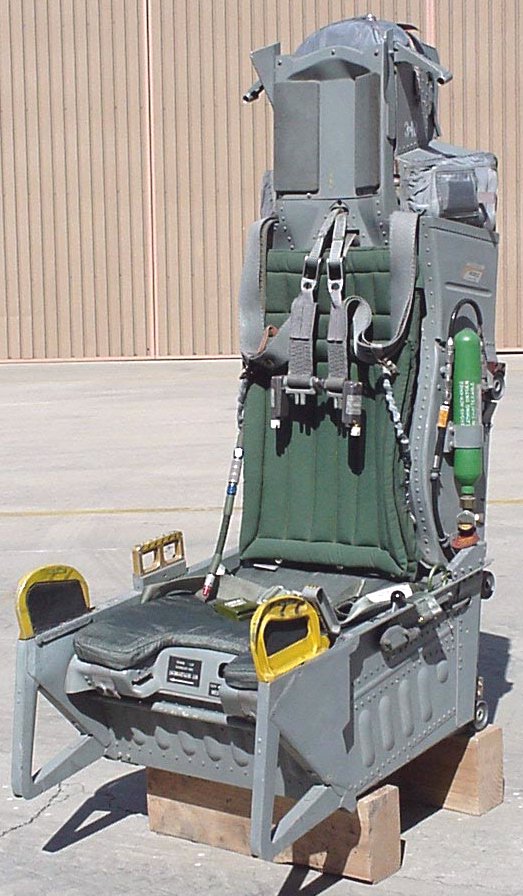

I have the aces 2 seats from Aires for the A-10 and F15 but are they as good as the kit parts ?
Aires Aces 2
Kit part, would need to just remove the cast in belts
the real thing
The aires part seems to me to be a different seat....and it doesnt fit in the Kit pit
for me anyway the kit part trumps the after market resin.

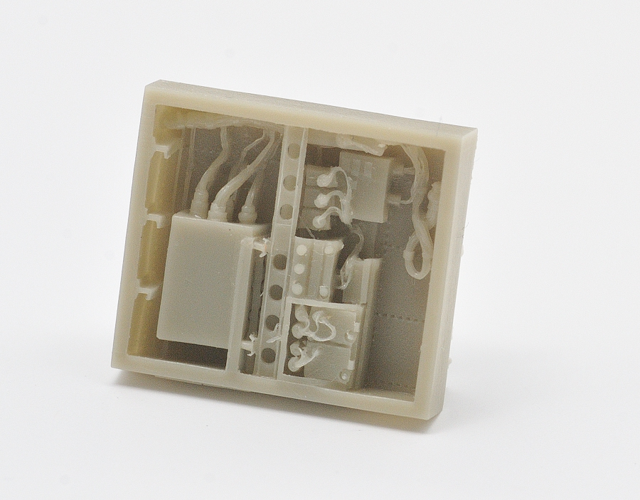

This is very nice though, this is the Aires resin electronics bay

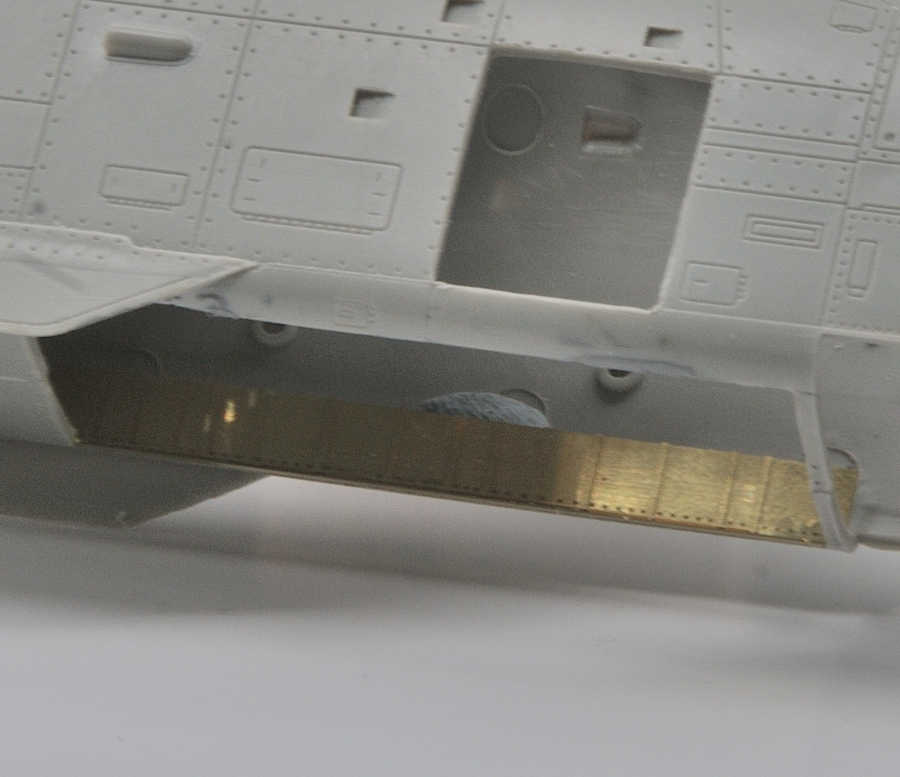

I also have an interior and exterior PE set and a Gun bay PE set which is a complete addition as its not featured in the kit

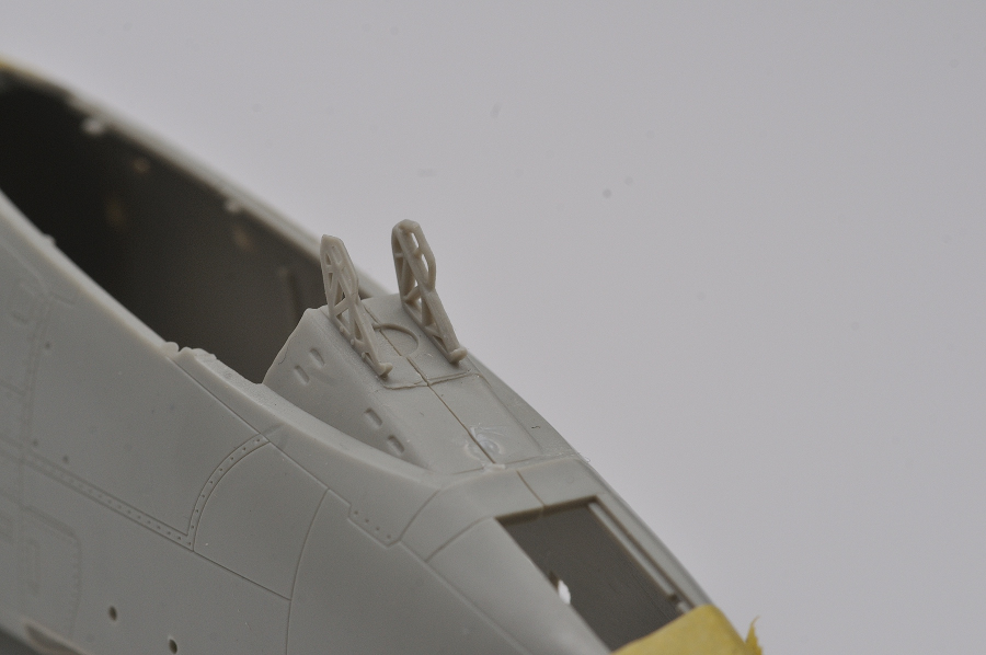

This reflector mount will have to go for some PE

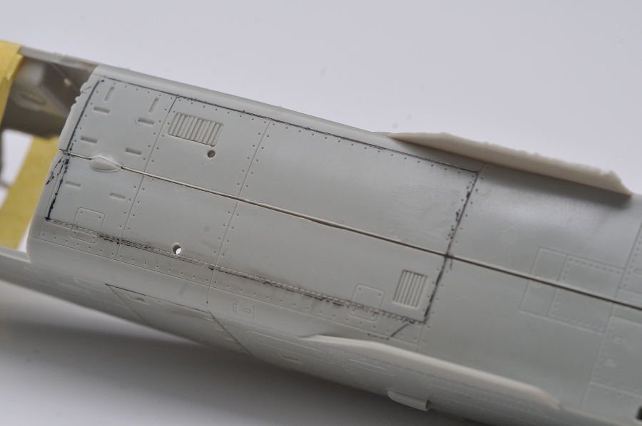

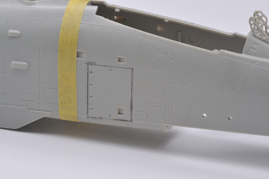

this needs to be cut out for the electrics on the RHS
And this needs to be cut out underneath for the gun bay PE
Kit part looks great, don't see any need for "upgrade". The head rest pads look smaller but that's an easy fix.

I have found that the AM resin parts and "USUALLY" the kit parts are close to the real thing to a point. Usually, (there is that word again) it ends up somewhere in between. By that, you take the good stuff from the kit and good stuff from the resin and combine them with the best of each. My Ho-229 instrument panel was one of those bits. Had four different panels I could have used to build the instrument panel, and ended up kit bashing parts from three of the four to build it. Got the best of all worlds with awesome instrument faces and panel with excellent relief and plenty of details to add and improve the looks. The trick is to choose what you want to mod to get the look you want.
My rule f thumb these days is ...resin is a big risk, its no better than 50/50 chance it will actually be better than the kit part so always worth checking other peoples build reviews.
i would say the only real advantage is if it adds something not included in the basic kit like the Aires resin engine range for 1/48 or flattened bulged tyres etc. I suppose at the end of the day its a matter of how much you want to "buy already done" and how much you want to do yourself, Quite often getting resin to fit can be more work than actually detailing something yourself.
When I was building my 1/32 Ju88 kit, I had a large amount of reference material. Bought the CMK resin cockpit upgrades, and after doing my research, found them to be totally bogus. The Revell kit was pretty much spot on. I did use Eduard PE to enhance it a bit and some other things, but found that it was really best using the kit parts.
I guess the key is do the research first then add the extra stuff.

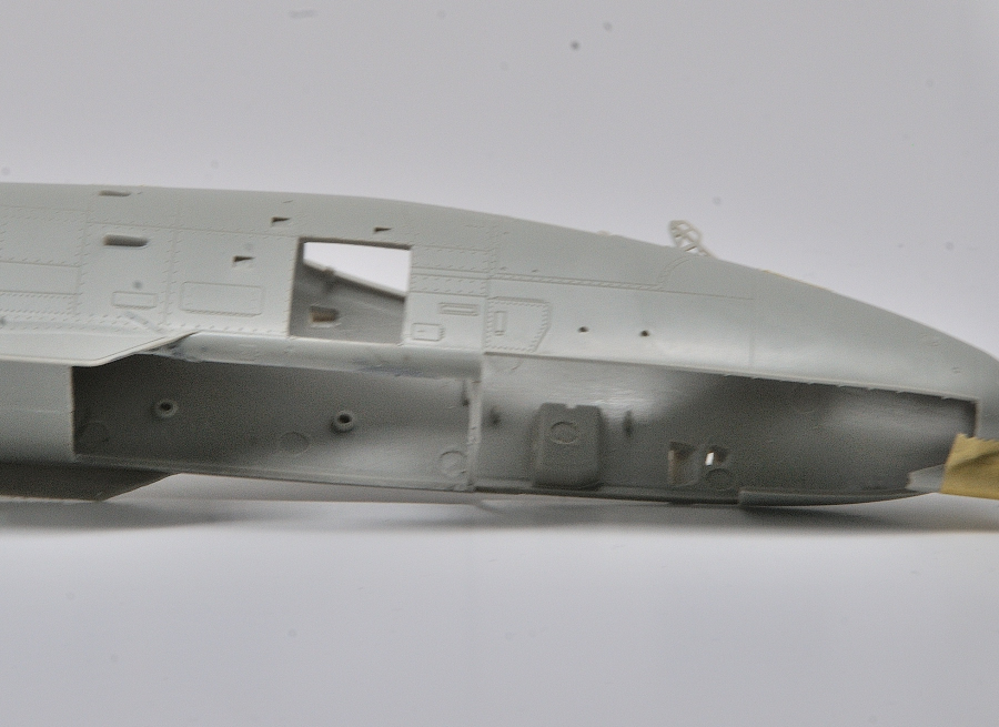

This shows the amount that need to be cut out to fit the Gun bay, also shows the electronics bay that i have opened up on the side.
the panel line give a good indication of where to cut but always forward fold any PE thats going to help with dimensions
always easier to enlarge than reduce :)

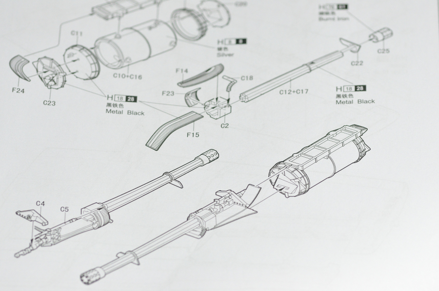

You may be wondering why i am bothering with the gun bay ?
this snap shot from the recipe :) shows the kit parts that make up the gun and the huge ammunition barrel. None of this would be seen if i didnt open up the panels.
