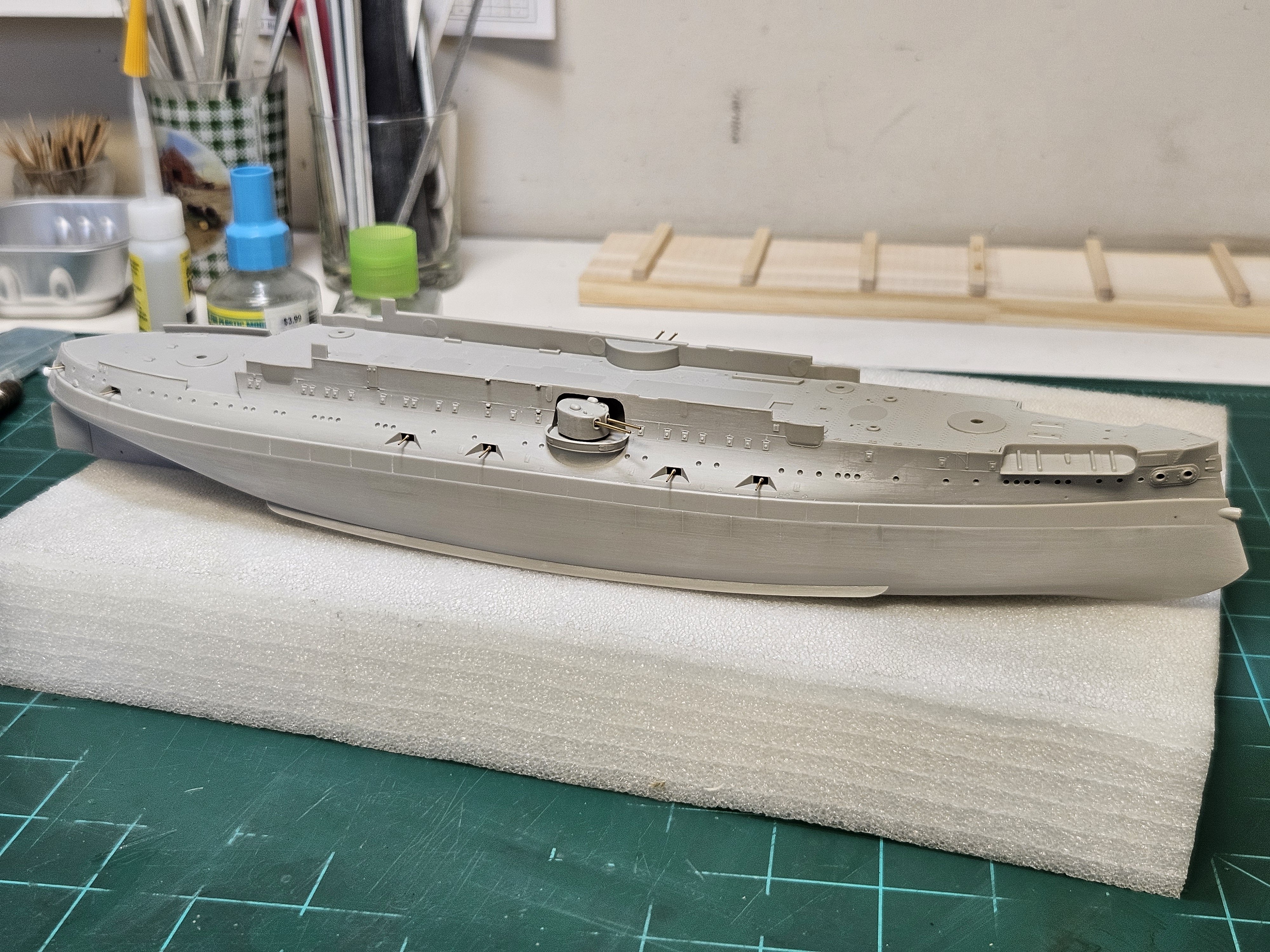

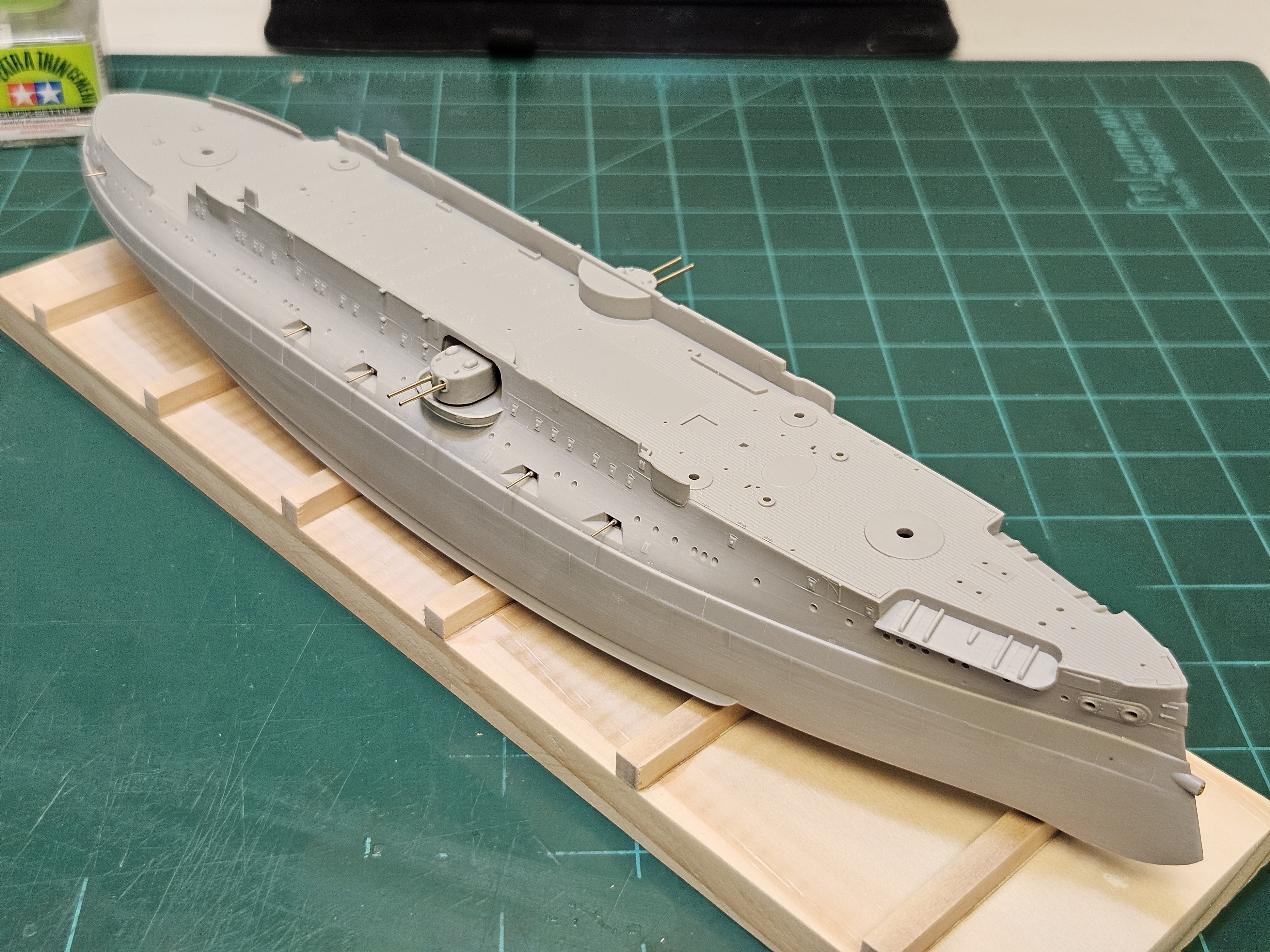

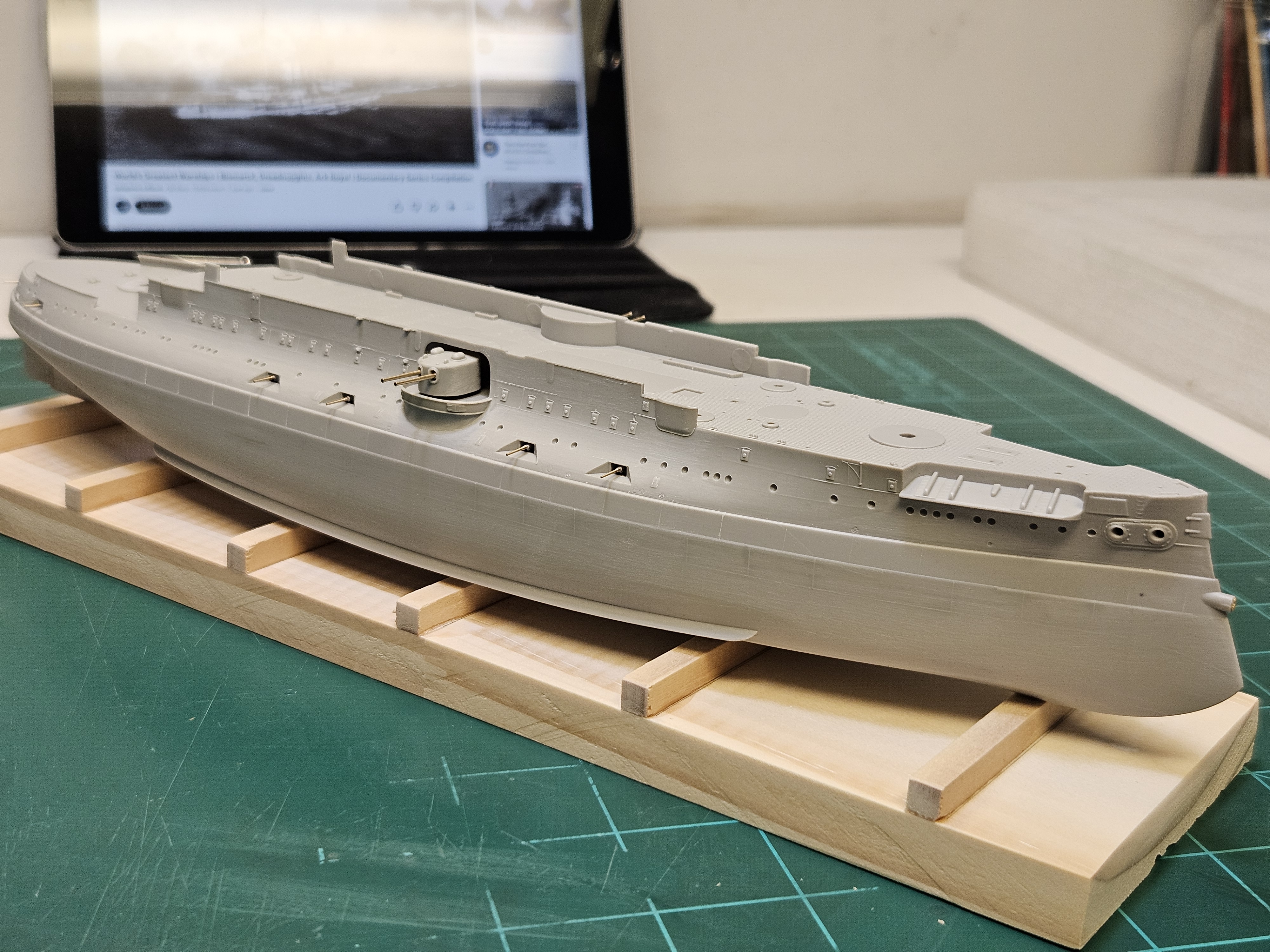

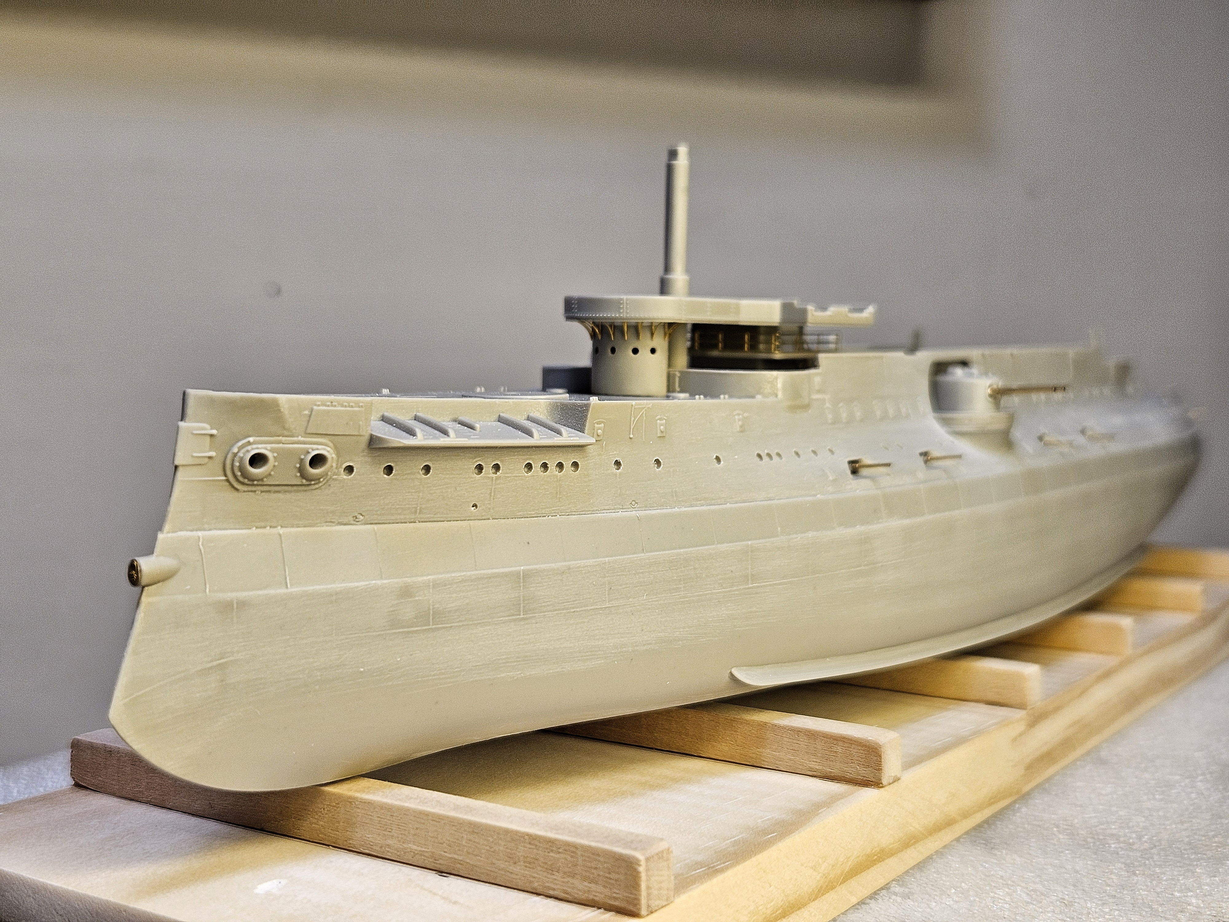

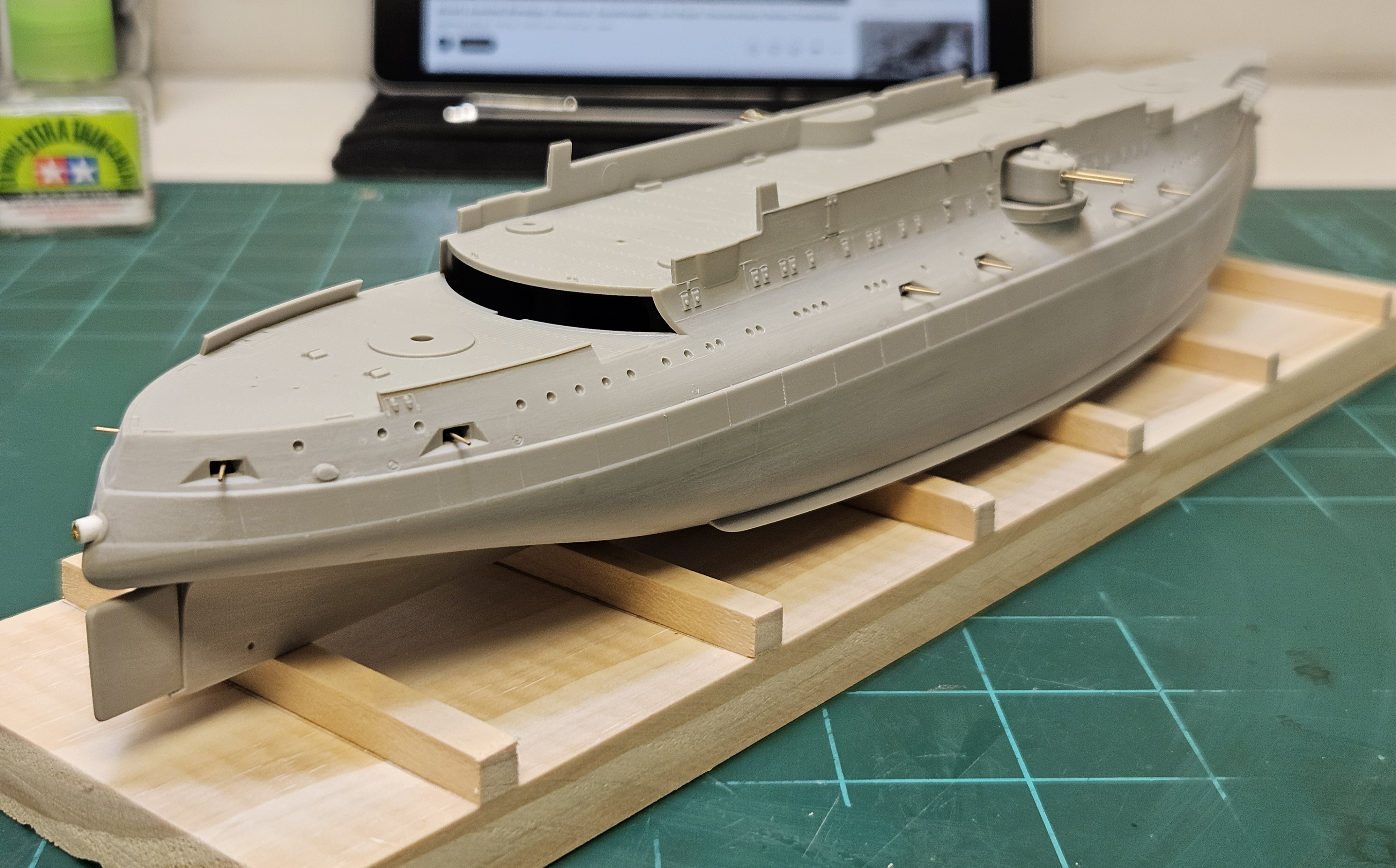

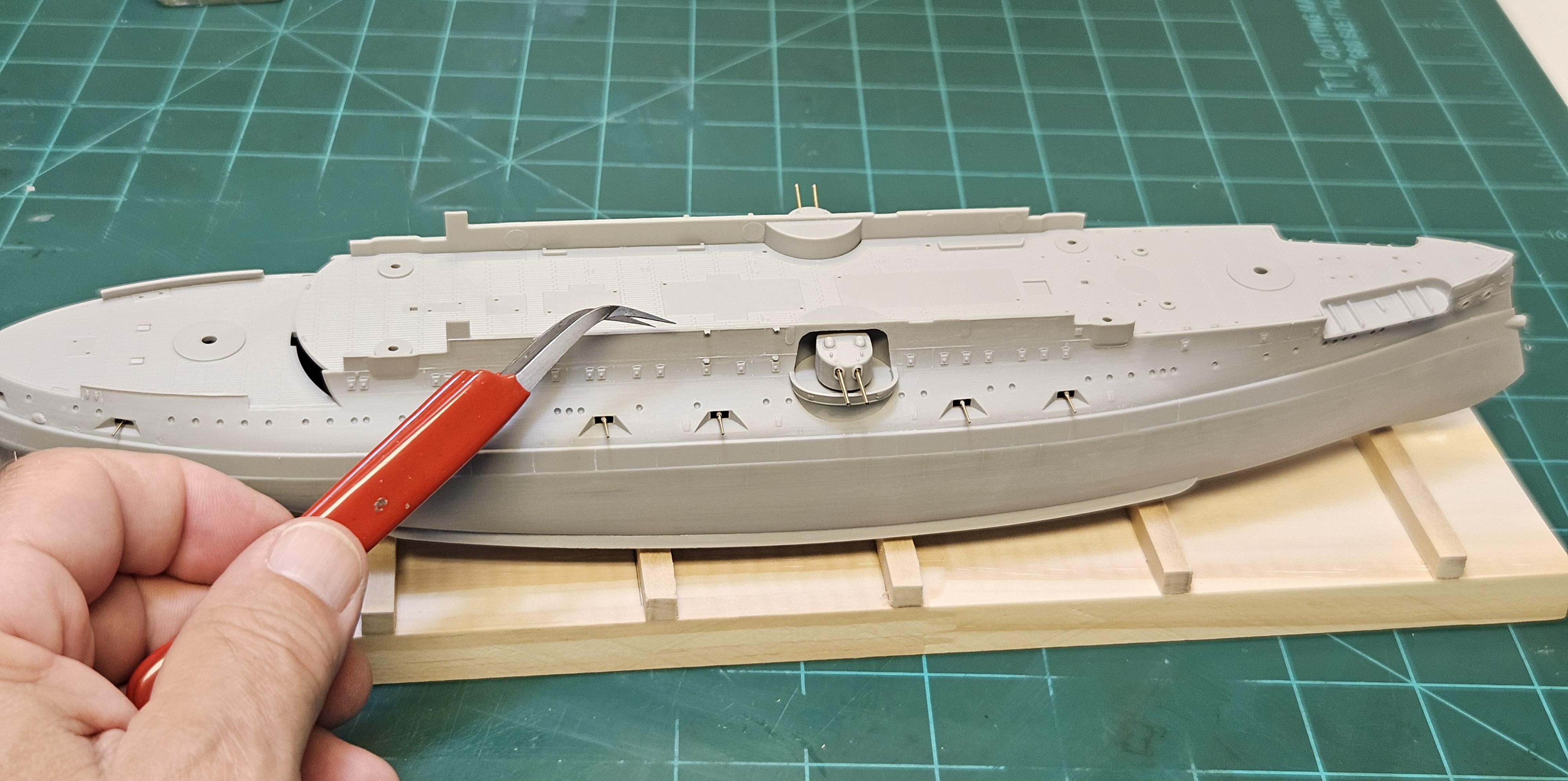

Got the hull halves glued up.
The bilge keels on.
Rudder on.
Replacing the gun barrels with the aftermarket ones.
Had to rework the stern torpedo tube.
Sanding down more exaggerated weld seams on the lower hull. I've left the one's on the armor belt though as looking at photographs they appear more pronounced.

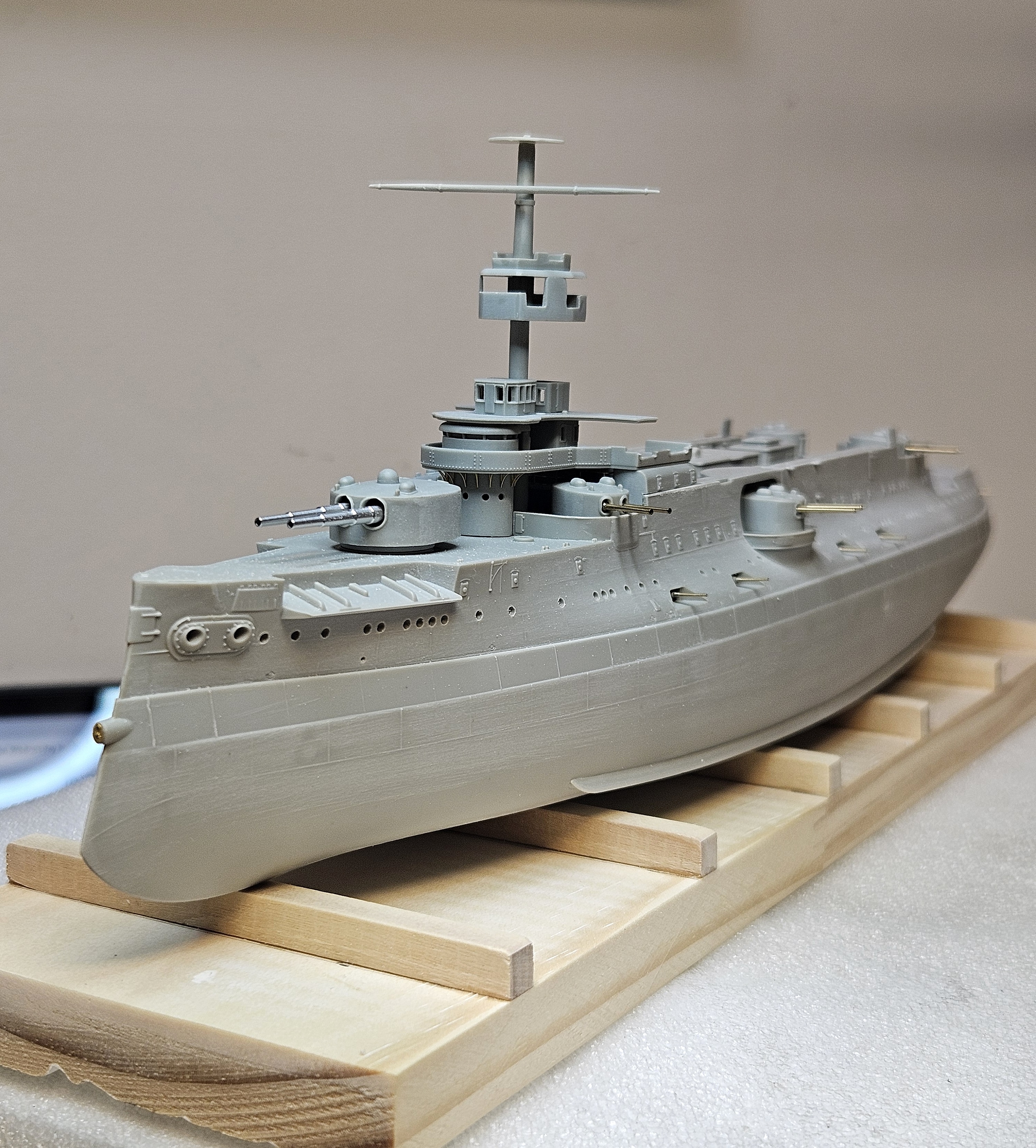

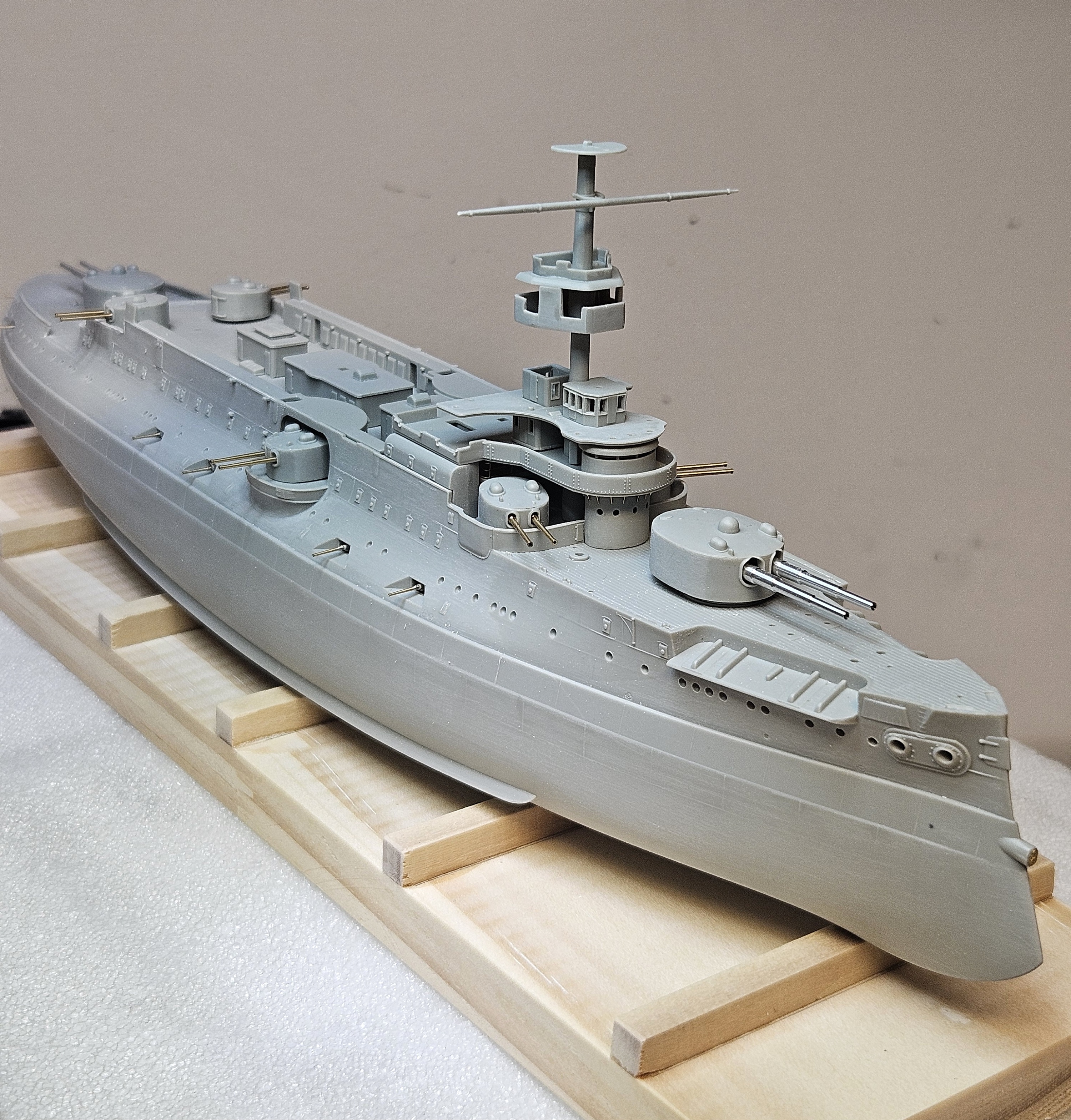

The decks and midship turret guns are not glued yet.
Dealing with Trumpeter's weirdness.

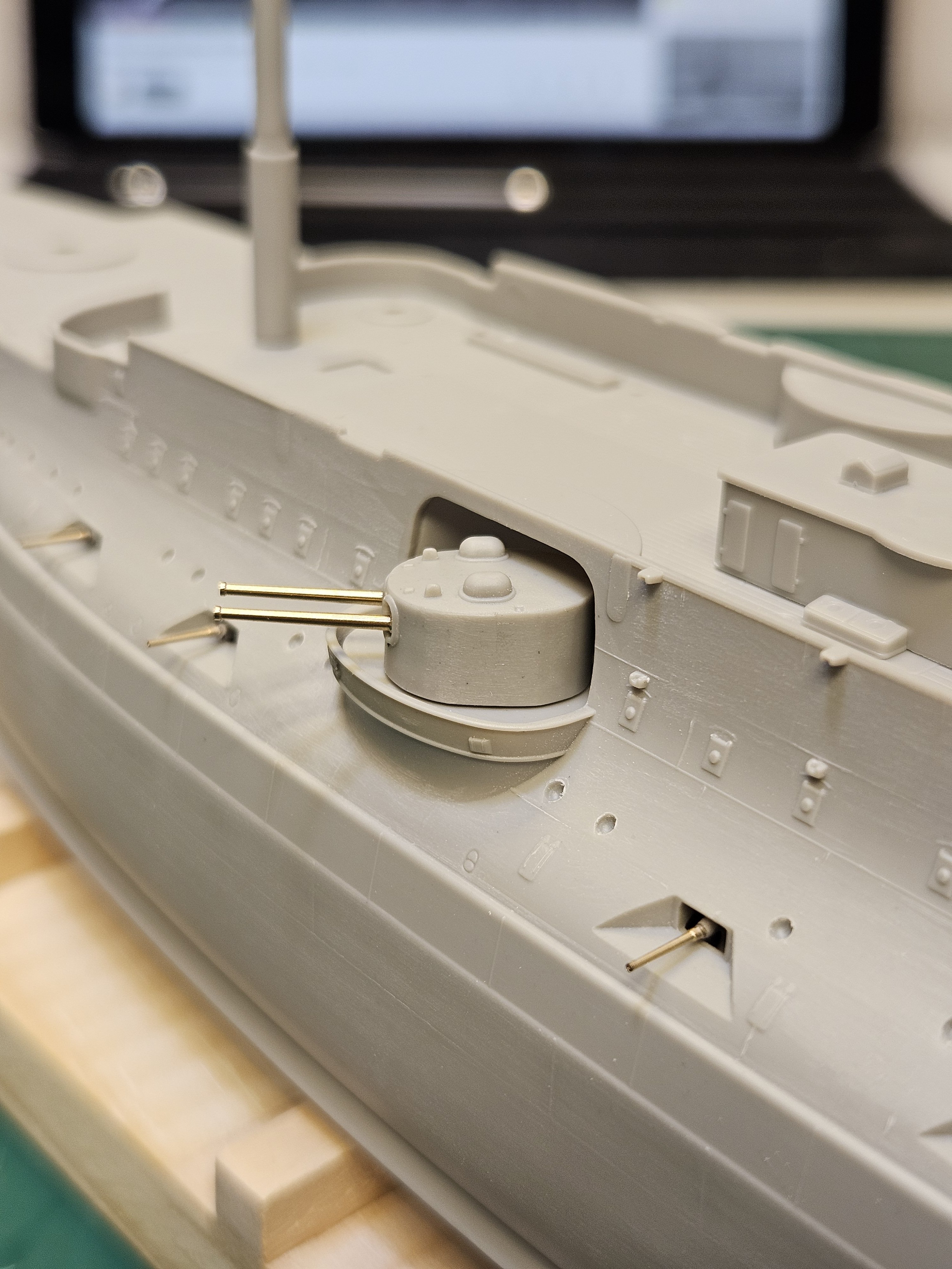

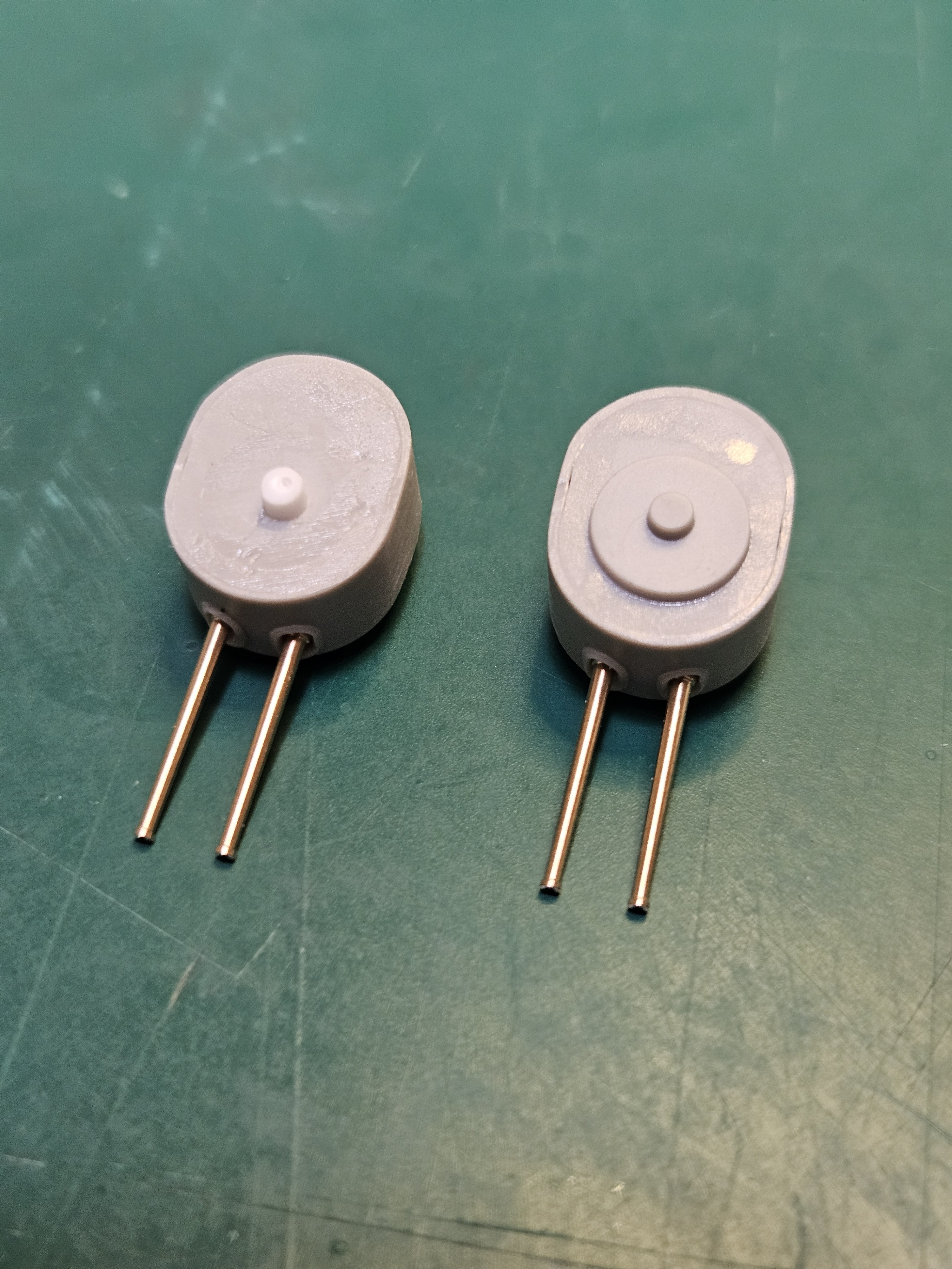

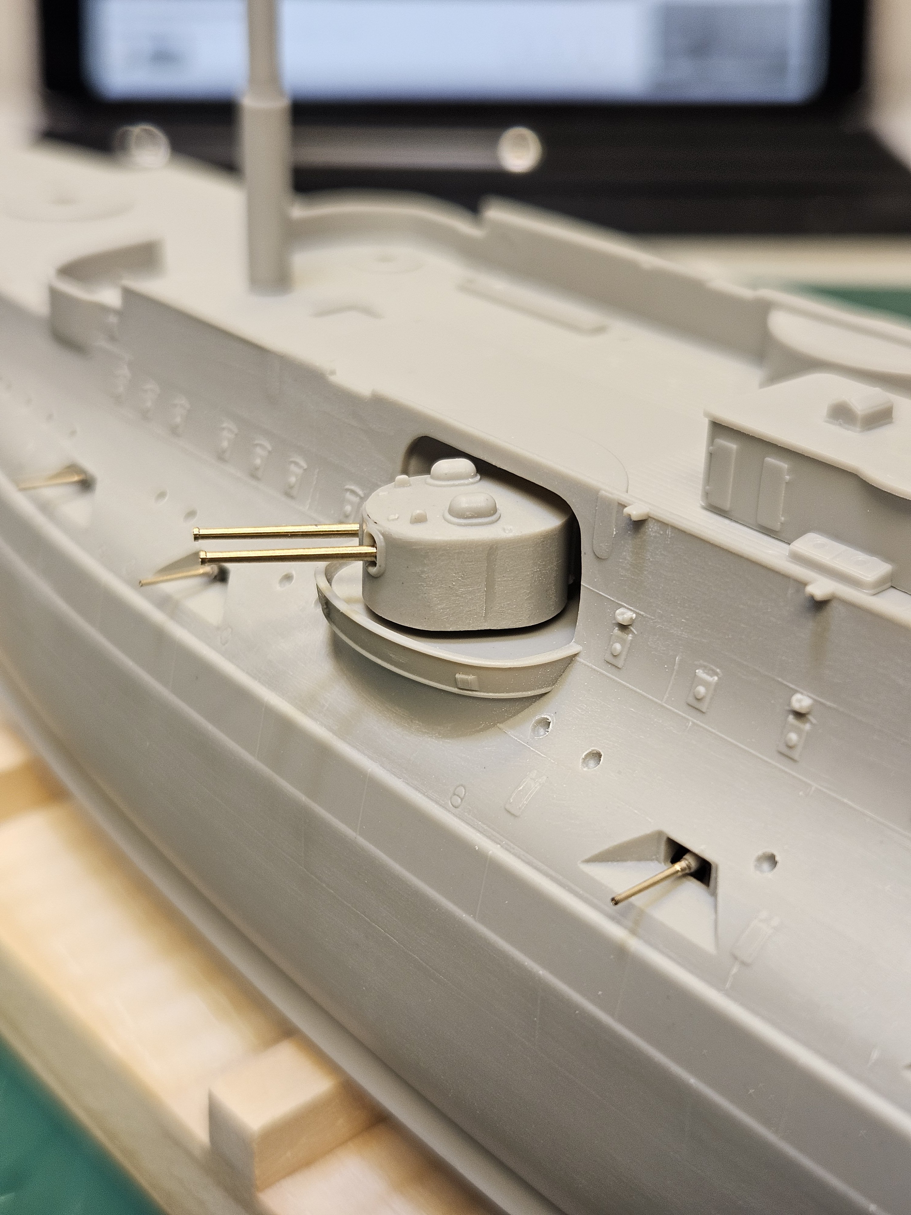

First up is fixing the turret guns. They sit way high on the mounts. I haven't seen a good reference photo, but I suspect they didn't rest like 3 scale ft of the deck, it just looks dumb. Easy fix is to shave of the bottoms and add a new styrene rod.
First pic of the gun mounted is before, the second pic is after.

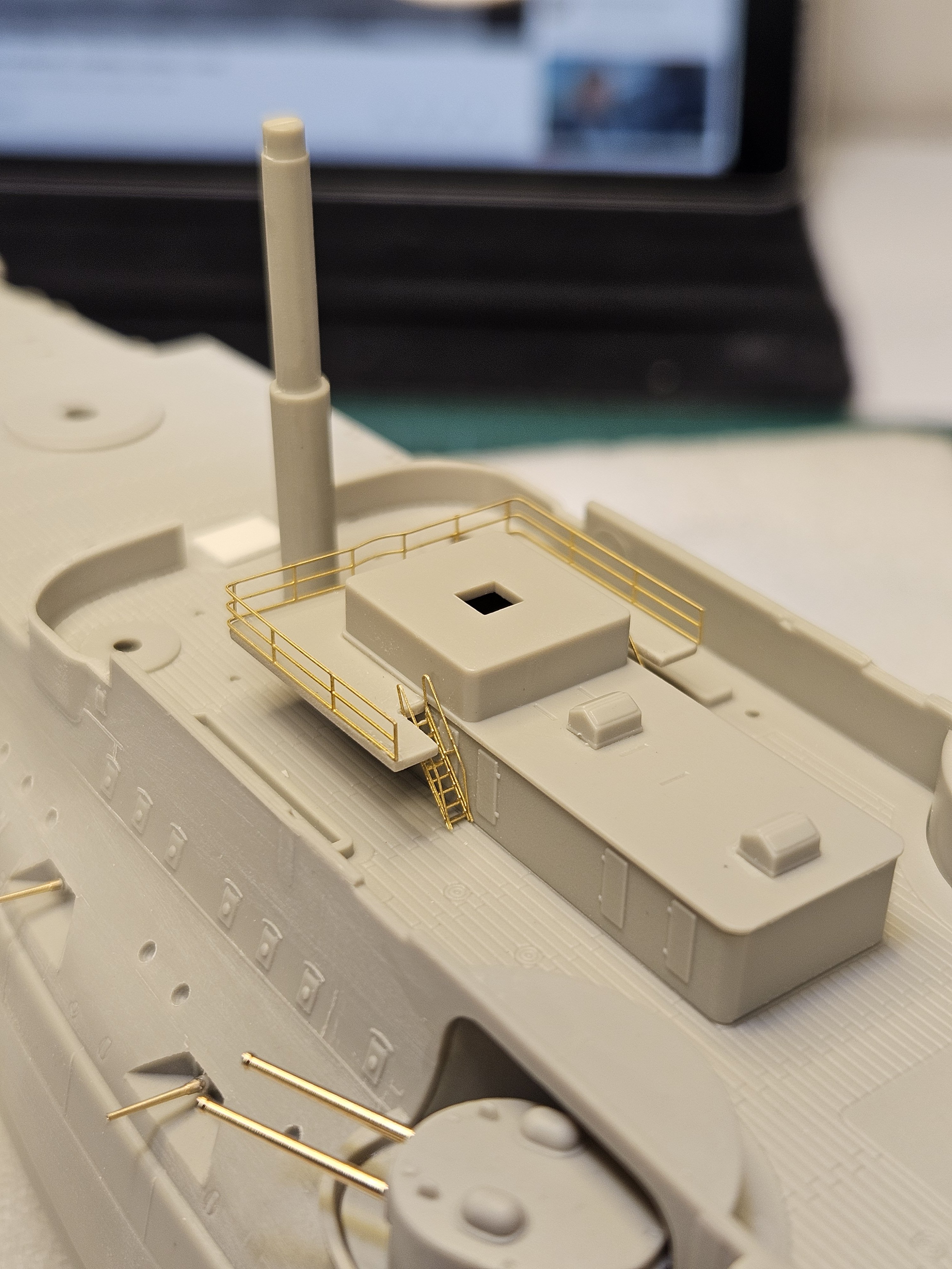

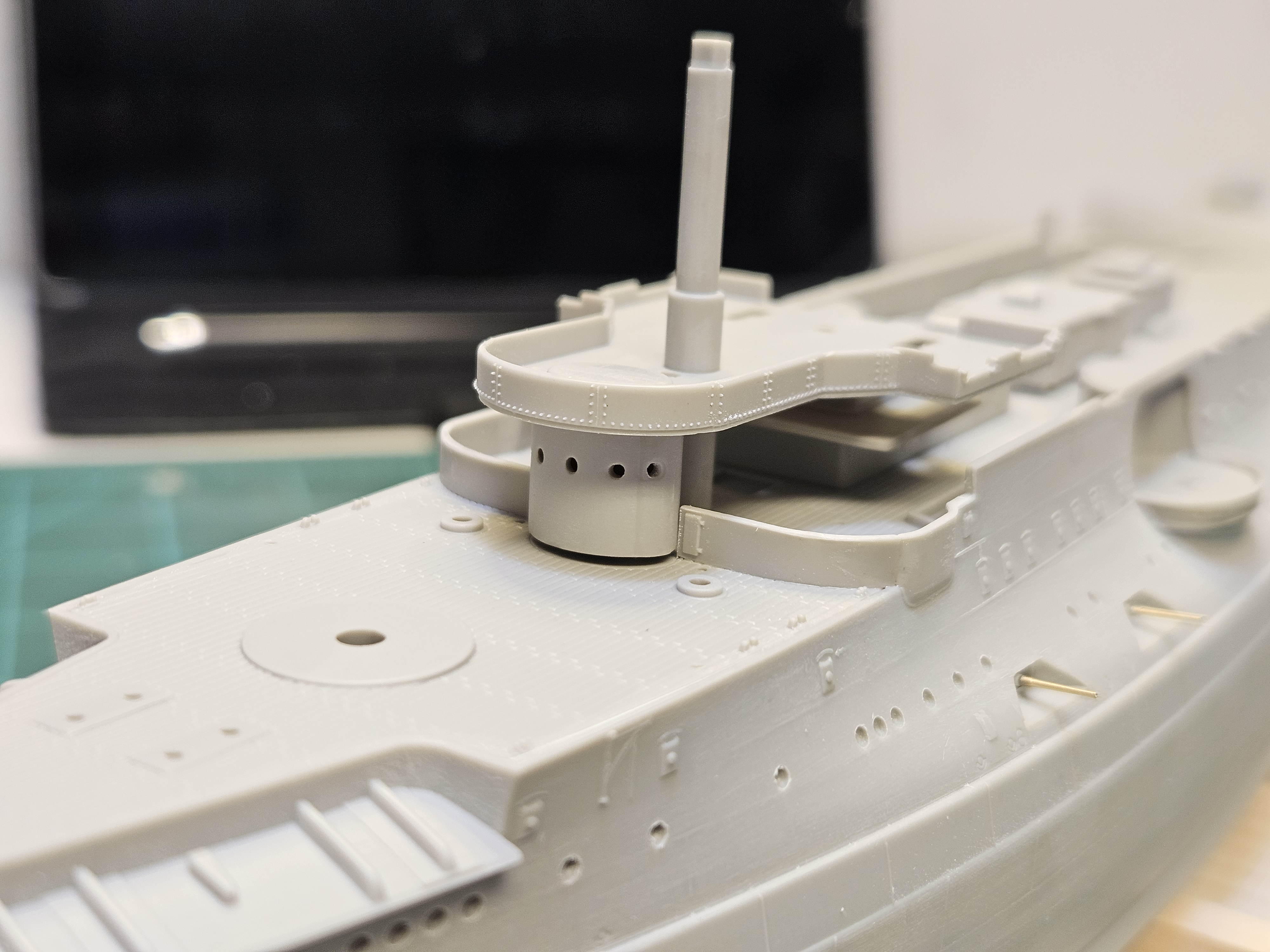

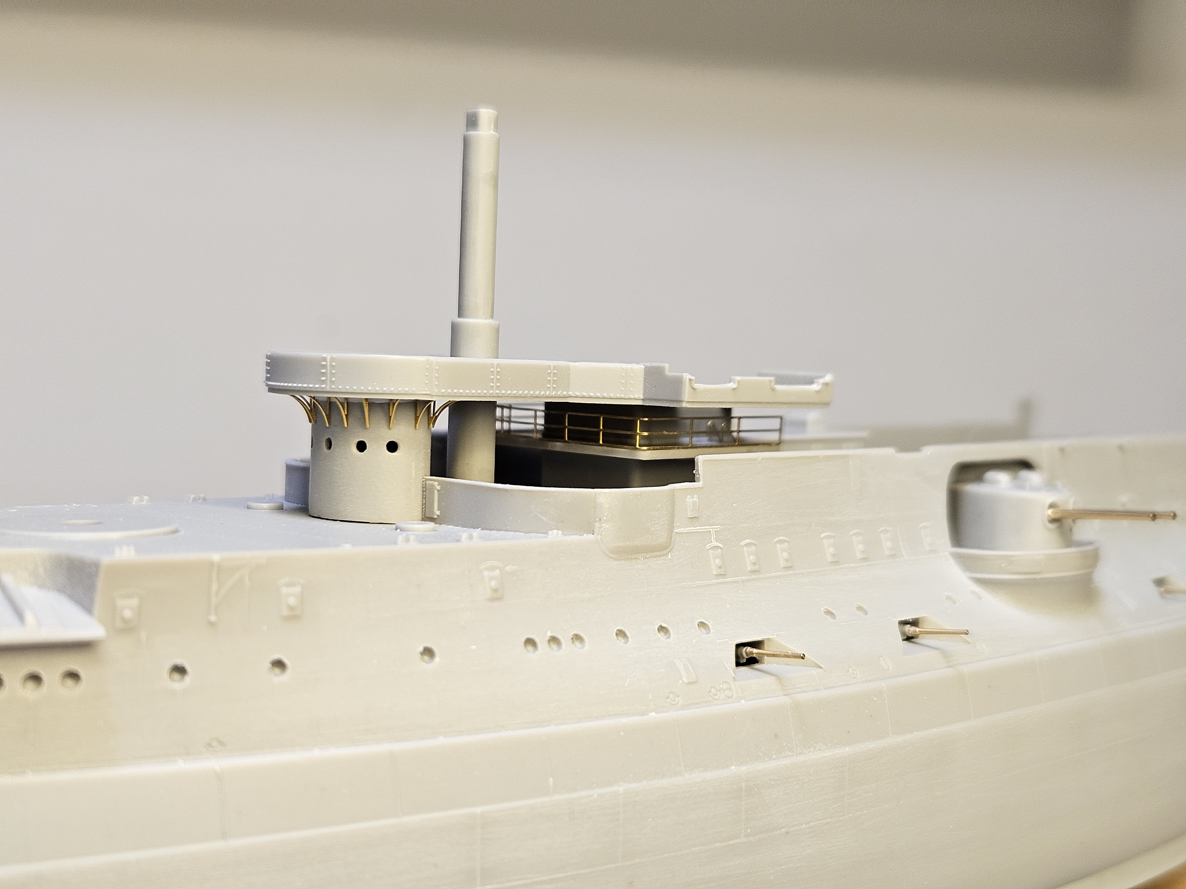

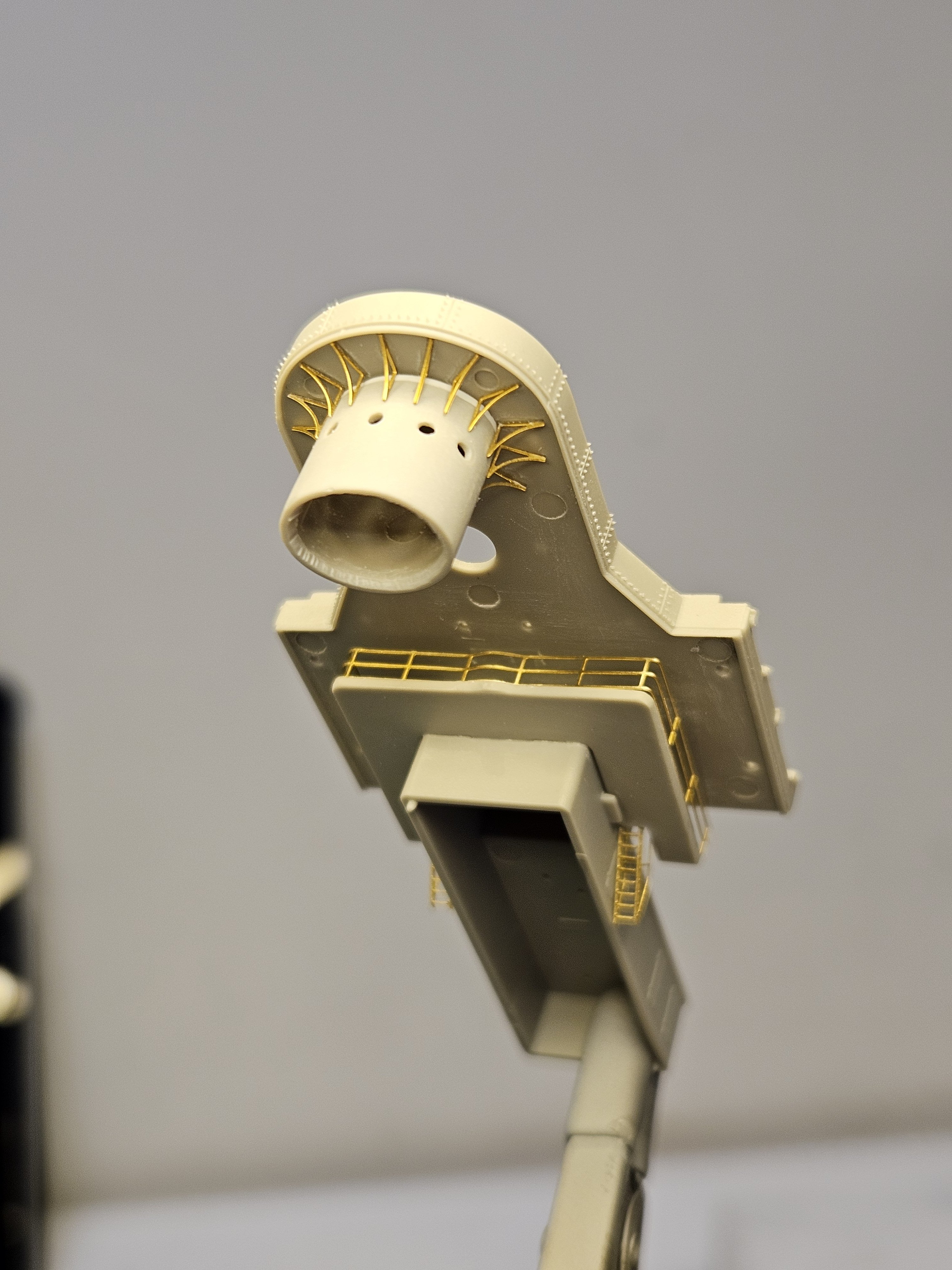

Starting to build up the masts.
As most know, Trumpeter is not known for their accuracy on the subject or the fit of the parts...at least for the ship kits. However, they can build into nice enough displays with a little work...or a lot of work!
This pic is a good example. The oval structure with portholes, if glued to the upper platform as instructed, doesn't quite make it to the deck. I'll fix it with the proper thickness of styrene. While I'm at it I'll thin the inside walls of this structure so the portholes look right.

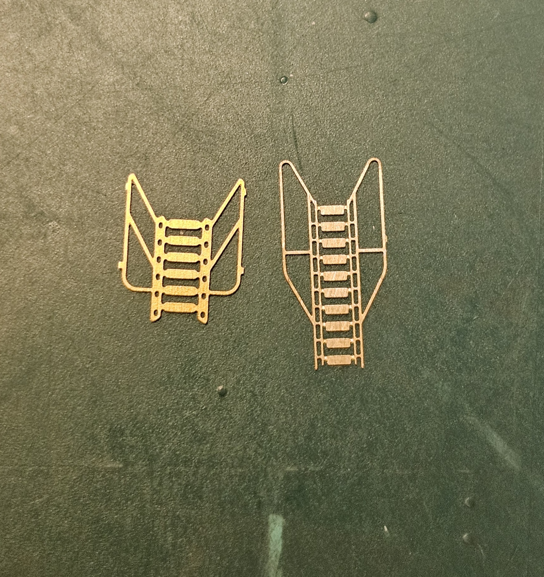

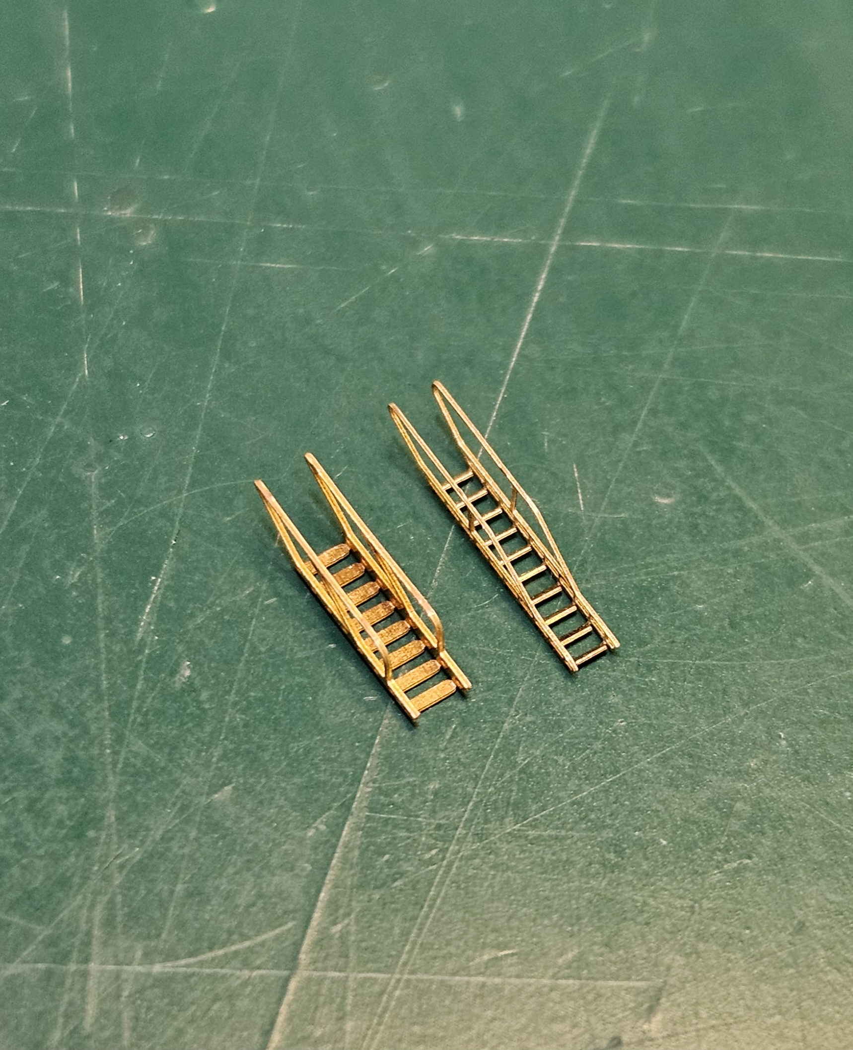

Not sure what happened in the Photoetch department with this kit, but wow.

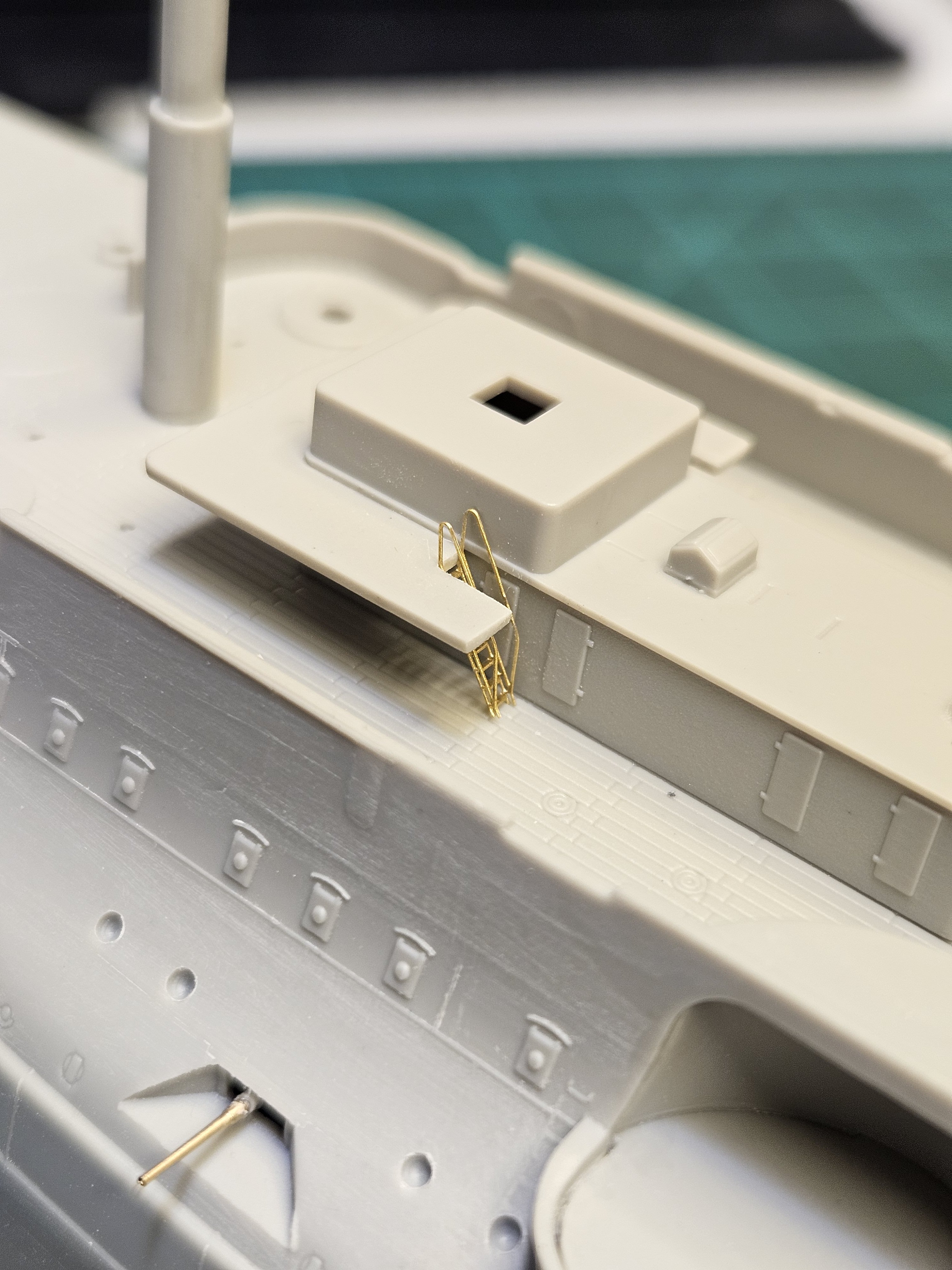

Went to bend some stairs and the treads wouldn't budge. After a closer look I saw the problem.
On the left is a stair from this kit. On the right is one from the USS Texas fret. Both are Trumpeter, but there's a big difference in the two. The tabs for the step treads are completely wrong on the one's from the Tserasivich kit. Luckily I have an extra Photoetch set Texas when I built it. Slightly different style but oh well.

Your bridge ports look dandy in this scale. The USS Texas ladders look like close copies of Tom's Modelworks 1/350 parts. They are probably made there anyway.
Ah, China...........
She's kind of tubby, cheerful-looking vessel, yes? I would be she rides like a fat lady in an inner tube in any kind of sea.
I have a set of Tom's as well and may use some of those too.
It's weird that one's in this kit's frets are so screwed up.
