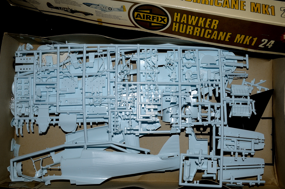

Its been 50 years since i built one of these and 50 years since it was released.
This is the original kit, original boxing and ........original decals
(that will not be used )
I bought this on E-bay and understandably a lot of the parts are loose in the box which has also seen better days ( bit like me) It looks like its all there at least , all the important parts
When this was released i remember the propeller could be motorised with a "spin a prop" motor, basically a motor with alternate segments of the armature missing so it wouldn't self start, you had to spin it to get momentum and when stopped it wouldn't draw power so you didnt need a switch........and guess what ? i found one of these in my 50 year old box of bits

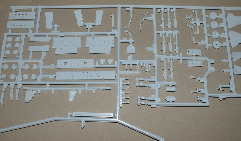

Detail is par for the course for the early 70's ,Most parts are a bit "chunky" but that said are far better than the Spitfire and ME109 realised at the same time. For example the Hurricane has wheel well detail, the Spitfire had non in fact the wells were not even boxed in so you just had holes in the underside of the wing, There is little flash, crucially the panel lines and rivets are not raised and this version has a detailed fabric covered fuselage with metal covered wings

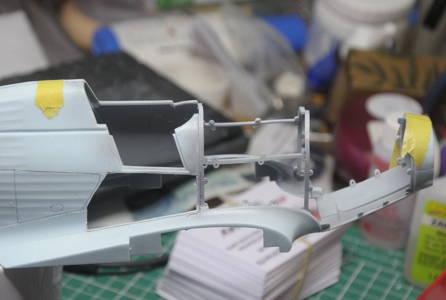

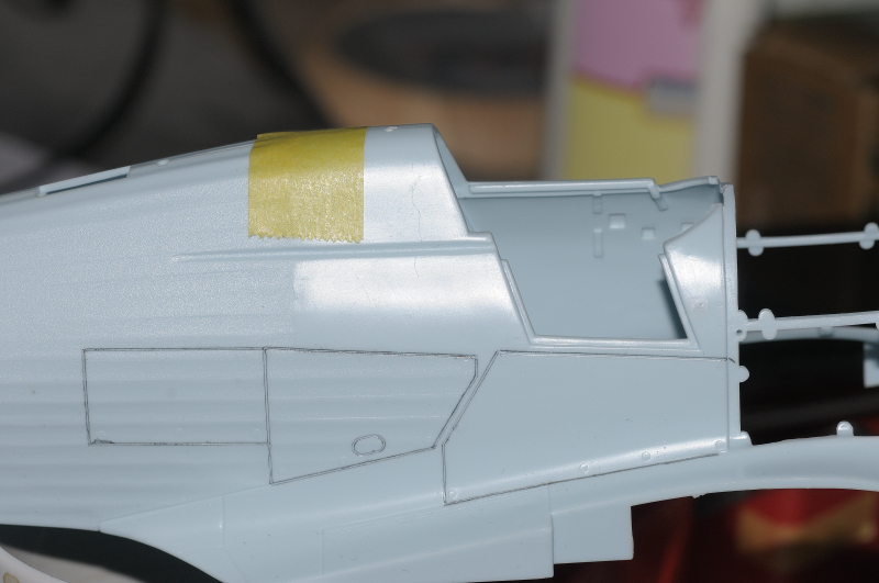

I am not sure what to do with this ? the choice is
1/ Build with the panels closed up. This means you can leave out the engine and the panels will fit well.
2/ Build with panels open and display engine knowing you cant them fit the engine panels
3/ Try and build with engine exposed with the panels still able to fit. This would mean knocking a few mm;s of the engine height however if you do this things like the Exhaust will also drop and not align with the fitted panels
4/ Build with panels open and open up extra panels to reveal more ( scratch built) detail

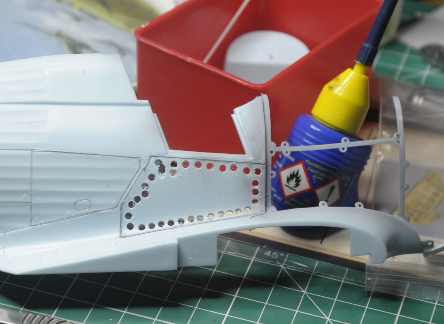

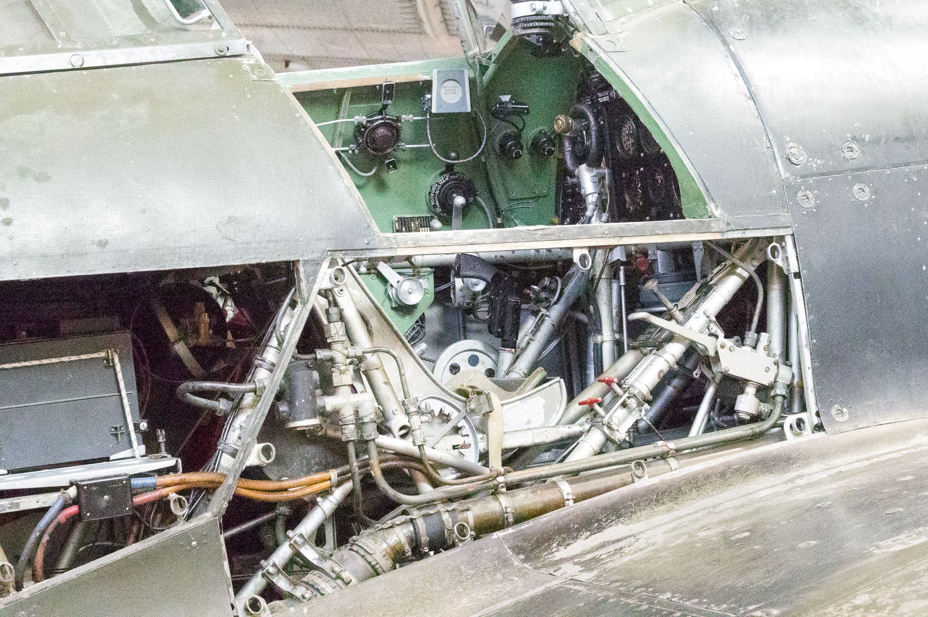

These are the panels that could realistically be opened. Disadvantage here is the detail required would be hugely complicated

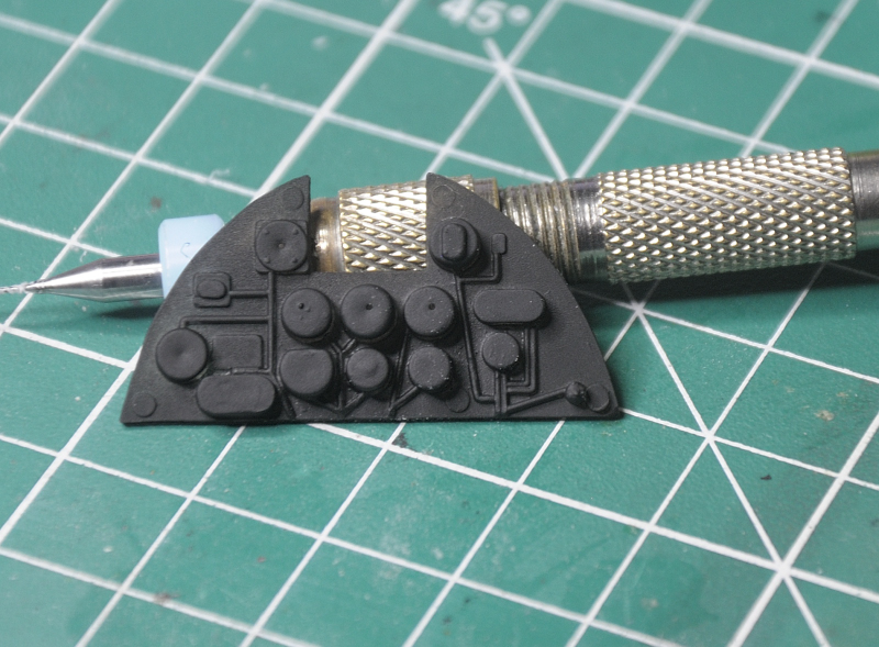

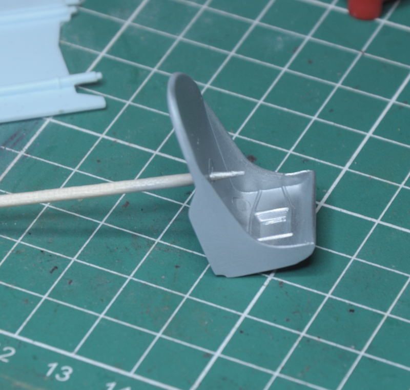

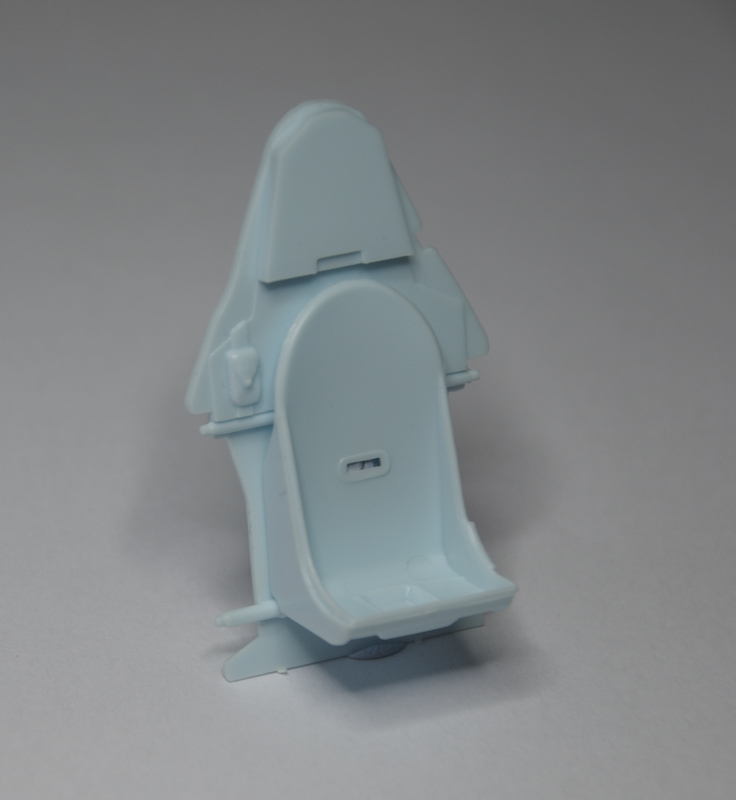

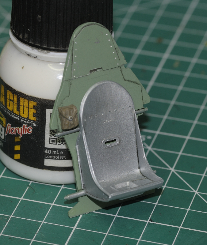

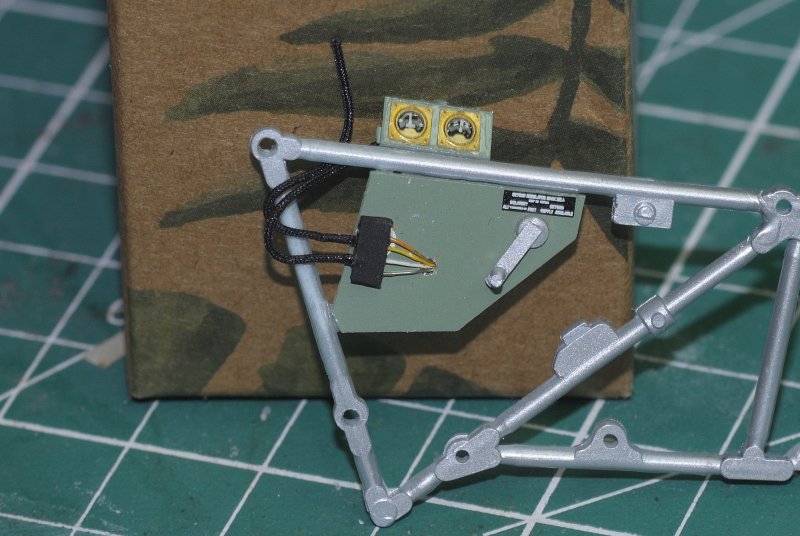

Well i decided to start with the seat, gotta start somewhere

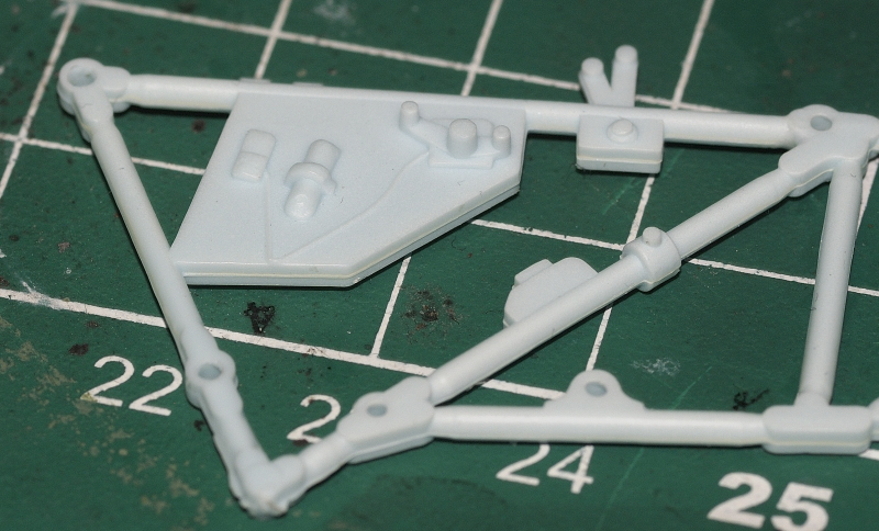

The kit parts are OK

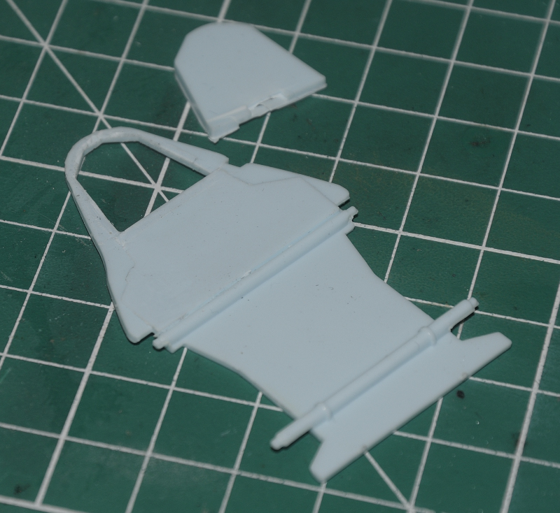

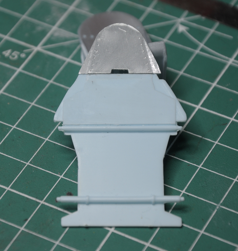

The head rest armour here is 2mm thick, the equivariant of 2". In fact the amour was about 3/8" thick so scaled down less than 0.5mm
I cut the armour out and replaced it with 0.3mm alloy

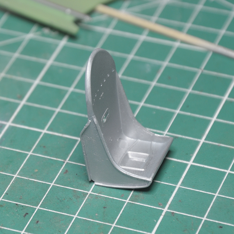

The seat is also pretty Chunky so i thinned the sides down by 50%

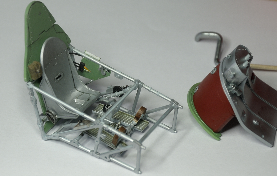

And added some beading round the edge to simulate a rolled edge which is correct
And this where i have got too so far
