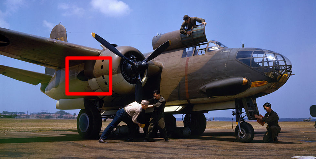

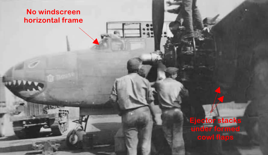

This post is repeated on the A-20G-1-DO thread. Photos to follow but some work was done on the engine cowlings for both the A-20B and A-20-G-1-DO as they are the same. This meant adding five (5) exhaust ejector pipes on the outer upper fixed flap (see A-20G-1-DO tech manual image below whose engine cowl cover would the be same), four (4) exhaust ejector pipes on the inner fixed flap, and five more, to complete fourteen (14), underneath the stamp shaped movable flaps on the lower side:
Still better than Paul Budzik who has to smooth out the cowl flaps as the A-20A he's building had a collector ring with a single eject on the outboard side of each nacelle. The open cooling vents were a temporary measure which were deleted later during production:
Sheesh, need to remove the horizontal frame from the common windscreen in all the kits... It shouldn't be there for any Havoc produced prior to the DB-7B/A-20C:

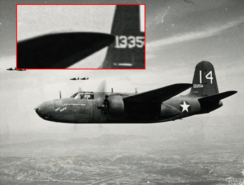

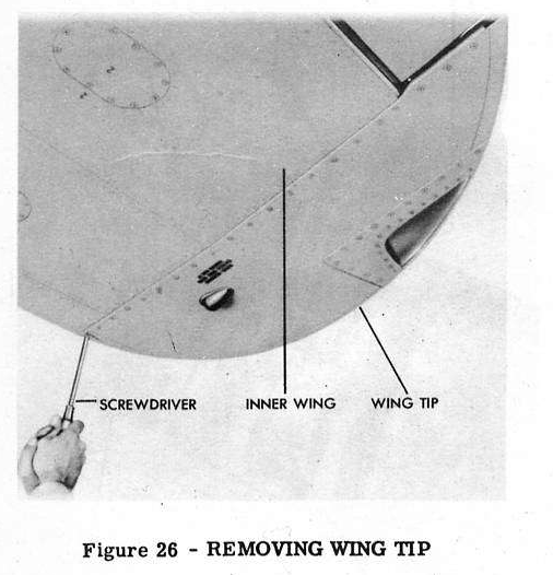

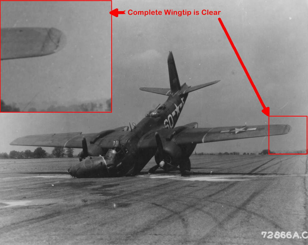

This is the wingtip from the start of the A-20G-1-DO to about the A-20G-30-DO (I may correct this range later). Note that the teardrop shaped bulb is the navigation light while the bulb in the clear aft half of the wingtip is a formation light. It should not be green/red.
Compare to full clear wingtip incorporating both starting with the A-20G-30-DO (this one is serial 43-9716 from the 647th Bomb Squadron, 413th Bombardment Group, 9th AF, after a hard landing in England on the 28th of May,1944):
Clear sections of the wingtip are not on this A-20B. I will simply fill in the outline for the clear section:
Someone, on another forum where I am sharing my TMI (since they are building in 32nd scale where it is all visible), stated that "...some early airframes were converted to the later style (likely during engine changes later in the war), so check your references for your particular bird:"
I've never seen this but did find an image which could lead someone to believe that. This 'looks' like an A-20C with much later engines.
However, the serial number (43-21751) exposes its identity. This is the sole CA-20J attached to Air Transport Command (see badge on tail cone after the national insignia and below the serial. The is was made by stripping the last A-20J-25-DO made and swapping the nose (or perhaps it is what was available) of an A-20C. The 'C' designated cargo. So, if I weren't so stubborn about my 'sharkmouth' restrictions, I could get another A-20G kit to use the nose on Amorous Amazon and attach the spare A-20C nose (not used for Outhouse Mouse or Amorous Amazon) and create this! ATC decals and yellow serials are readily available!

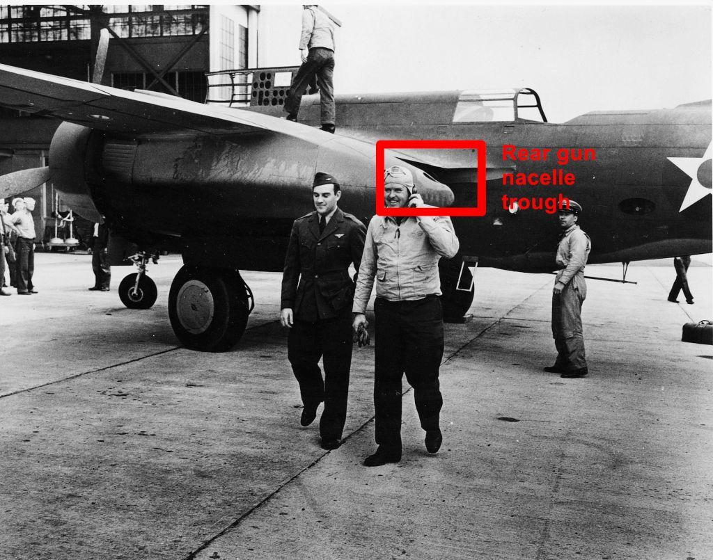

Rear nacelles need their guns added:
Some more images. I haven't found these nacelle guns on any photographs of the A-20G-1-DO although a document stated that the first 250 would be so equipped. However, only 248 A-20G-1-DO were built and none of the manuals mention nacelle guns. Only Outhouse Mouse will get the modification.
Reference images to help location:

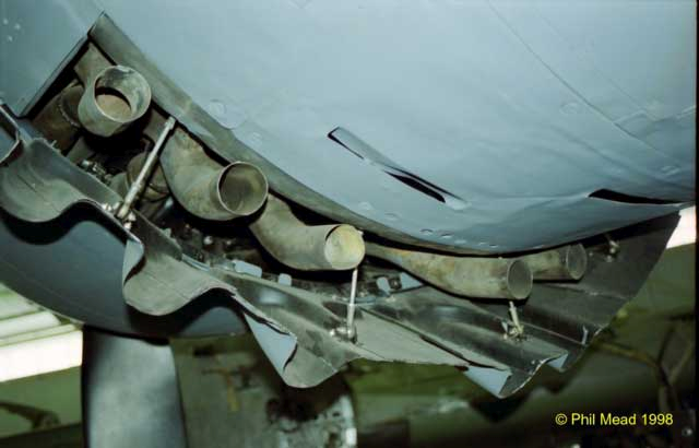

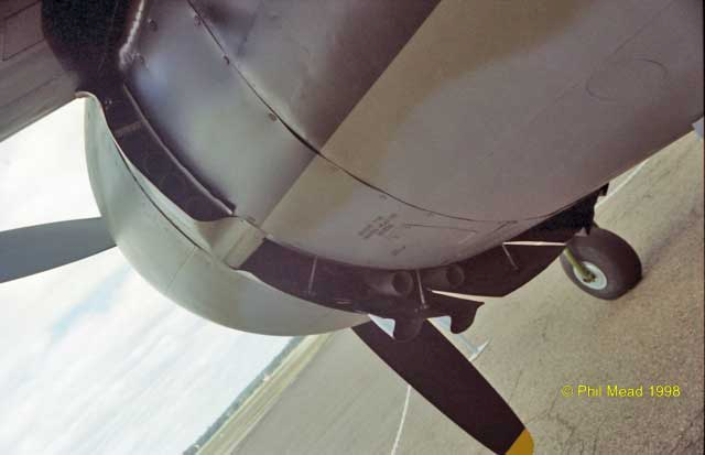

In this photograph, you can see how much I thinned the fixed cowl flaps which should cover the 4 inner and 5 outer exhaust ejectors. I also stated drilling out the formed movable flaps when I noticed something that made me stop. Do you see it? Hint, compare to the images above!
Spacings are different, but that doesn't mean anything as it could be on purpose. Other than that, don't know enough about these to know what is right and what is wrong Saúl.
Indeed, one has six 'bumps' and the other seven. Also asymmetrical. The fixed cowling I thinned show the number of exhaust ejectors I believe are under each...
However, I was WRONG!
This is what is wonderful about our hobby, one learns with every subject, if one wants to and is willing to do the research! Under each fixed cowl should be five on the outer but only three (that is my mistake) on the inner fixed cowl with the remaining six under stamped movable cowls.
Now I need to research which pattern(s) they were. AMT did some very good research on the cockpit, landing gear legs and shape so, were they right here as well? Update, with photo back up, coming but will be posted on the A-20G-1-DO thread to keep it running as it is the same cowl covers.

@moon puppy mentioned the closed movable cowl covers and I plan them on staying that way! I have enough to do as it is. I simply what the mystery of how the remaining six covered ejector ports appeared.
We see two under the port outer fixed cowl cover (over the five ejector ports) with a pair seen under the starboard nacelle. The kit has, from outer to inner, 2+4:
Two under the fixed cowl on the starboard outer side (which are closer to the top than the port side) and another two under it but... then? Maybe it is 2+2+2? The kit has (from out to inner side) 2+2+3:
'5' seems clearer but '6' I'm not so sure yet...
One of the reasons I DON'T trust restorations is this. Symmetrical 2+4 configuration on the Lewis Air Legends flying example:
