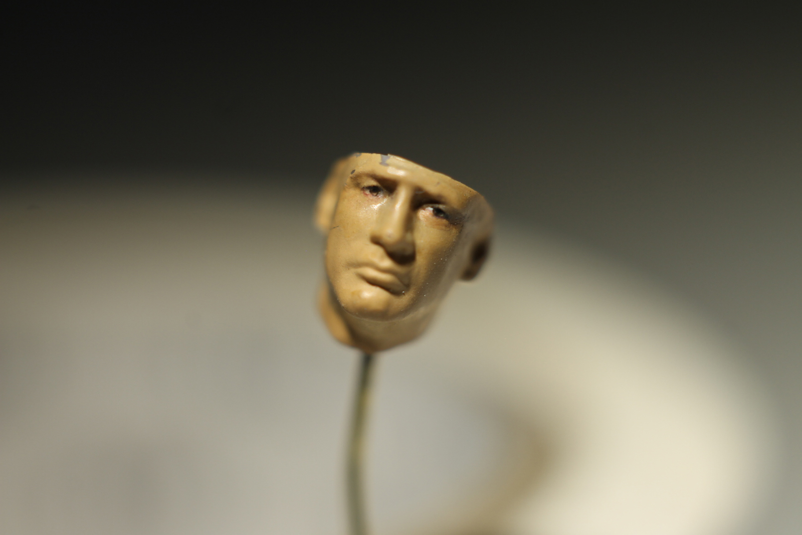

The Nikkor with 12mm of extension:

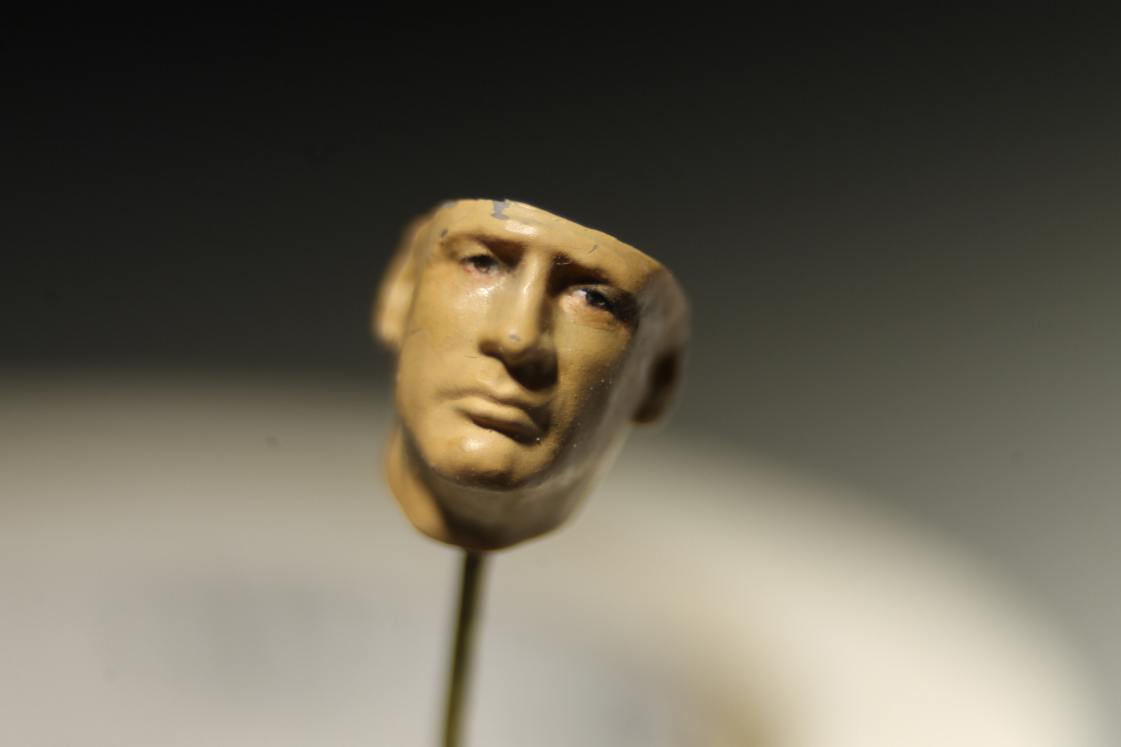

The Canon lens with all three tubes:

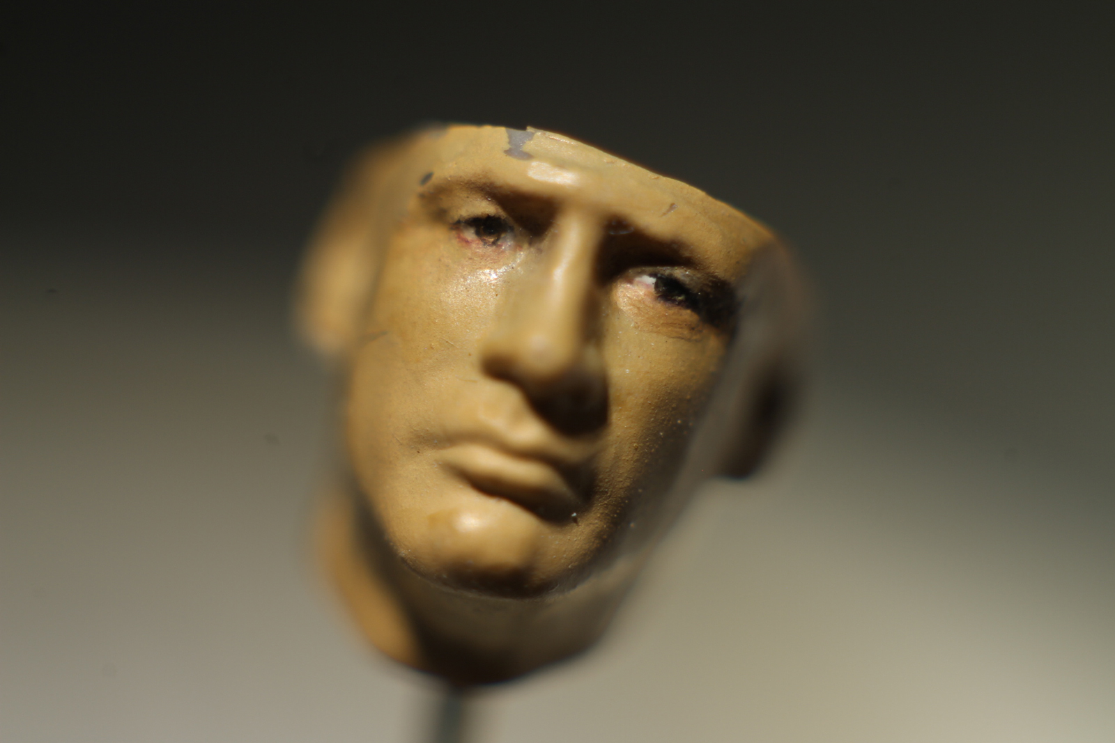

And finally, the Nikkor with all the tubes:
