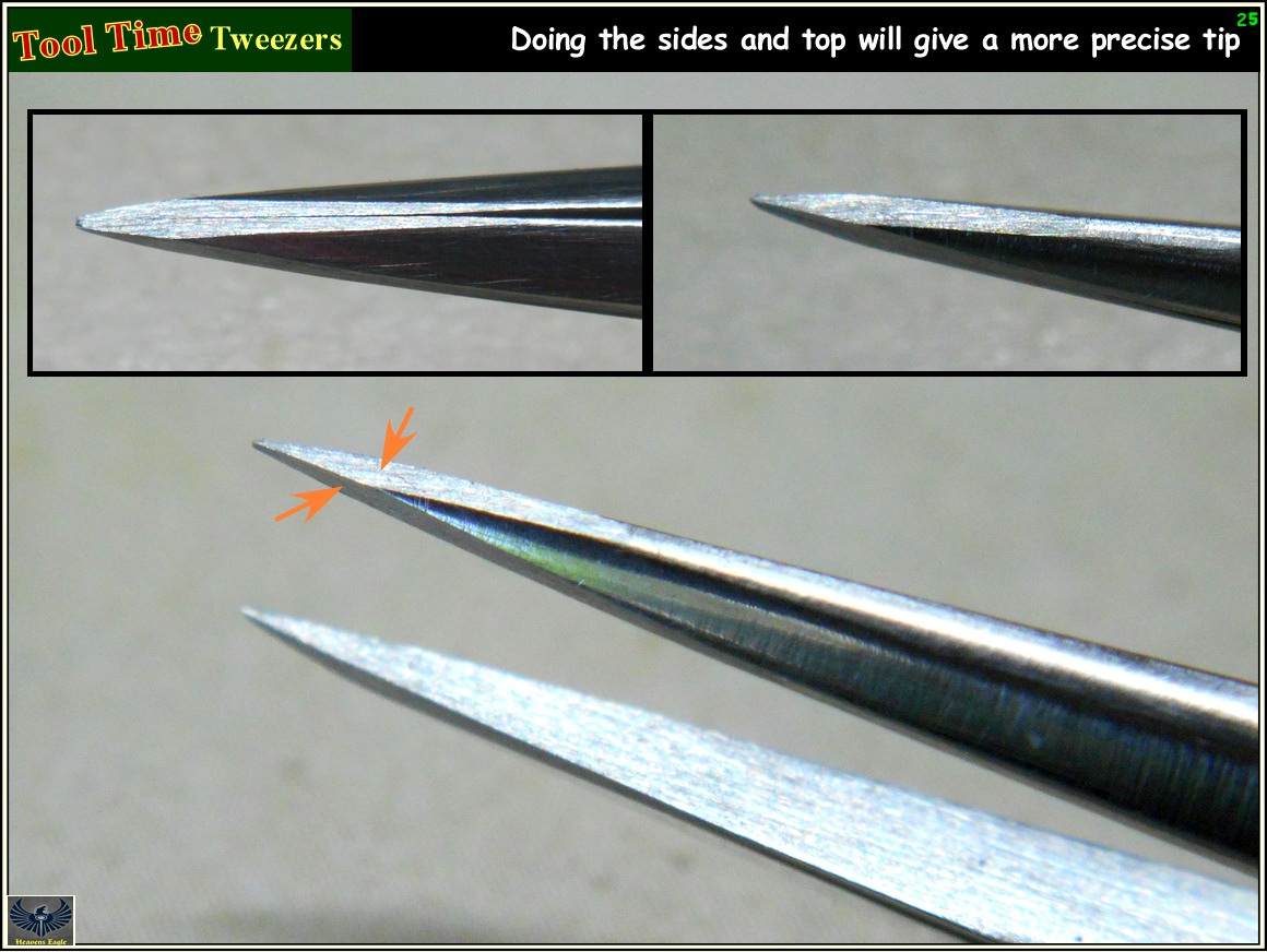

Something else, if you have some old but pointed tweezers that don't require a lot of effort to squeeze, you can redo the tips on them to get some nice ones with just a little effort. It just depends on how decent the steel is in them.

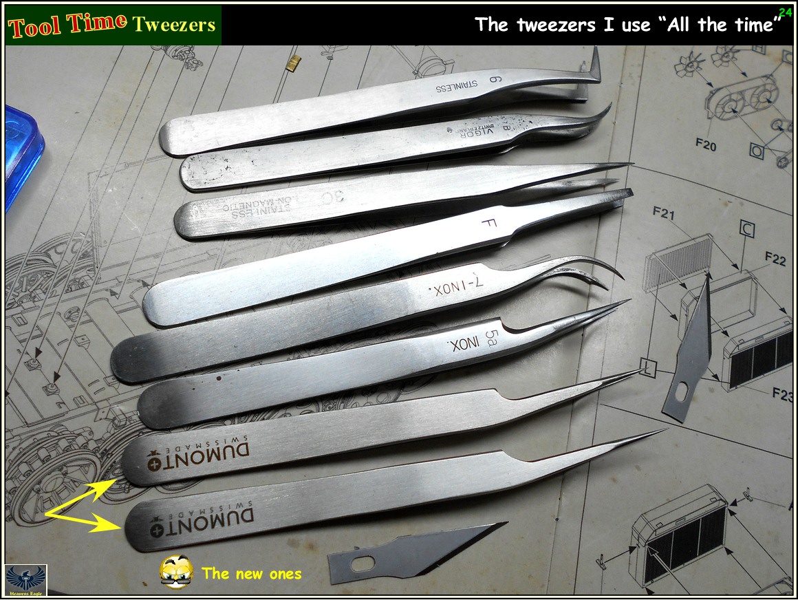

OK, here is the first link. This link is to Esslinger which is a watch parts and tools supply house. I would suggest looking around the site as there are all kinds of tools and goodies. Several items that caught my eye in looking around were two different 4 inch digital calipers. One was $19 and one was $32. The tweezer pages which are here. There are cheap tweezers and there are more expensive pairs. If you can (or want to) swing the Dumont tweezers, they are about the best. I have a number of them and have had them for over 30 years. Yes the tips get a little buggered up once in a while, but that is normal and the big difference between the expensive and cheaper pairs is that the more expensive ones are tougher. When that happens, follow the instructions (now in the first post) and redo the tips. It isn't hard and even when I do a major oops on mine, it only takes about 5 minutes or so to get them back up to snuff.

  • Stainless steel tweezers are the most common material. They resist rust and tend to be less susceptible to magnetism. They are also usually a little softer and the tips can bend and bugger up easier. The better made ones though can tend to be tougher than the cheap ones.
  • Carbon steel tweezers are harder and tougher. They can rust and if a person has that "rusty touch" they will get dark and rusty. They can also be easily magnetized. In normal use though the will turn a medium grey and keep on going. I have several pair that I bought used and they are still as good as the day I bought them.
  • Titanium tweezers are fairly new. Of course titanium is rather light, but it is supposed to be a little tougher than the carbon steel variety. They are also non-magnetic and more resistant to solvents and other corrosive agents.
  • Squeeze pressure is one of the most important things when using tweezers. Once you learn how to hold tweezers properly, the lighter the pressure it takes to close the tweezer the less apt you are to shoot it across the room or even your bench. Crisp and straight tips make it easy to pick up the smallest part easily.
  • The biggest difference between the cheap and professional tweezers is not just the price. The price reflects the quality of the tips, how sharp, strong, square, and how well they align. The cheap ones might be easy on the pocket book, but they can give a lot of trouble right off the bat. While the cheaper tweezers can work well enough, in many cases I have found the tips need some major renovation to get them to really work the way they are supposed to.
  • The best size for most hobby work is the #2. That is followed by either a #3 or a #3C which has a finer sharper tip. There are some that are sharper than that but those tips are very delicate and unless you have a good hand with a light touch those will be too easily damaged.

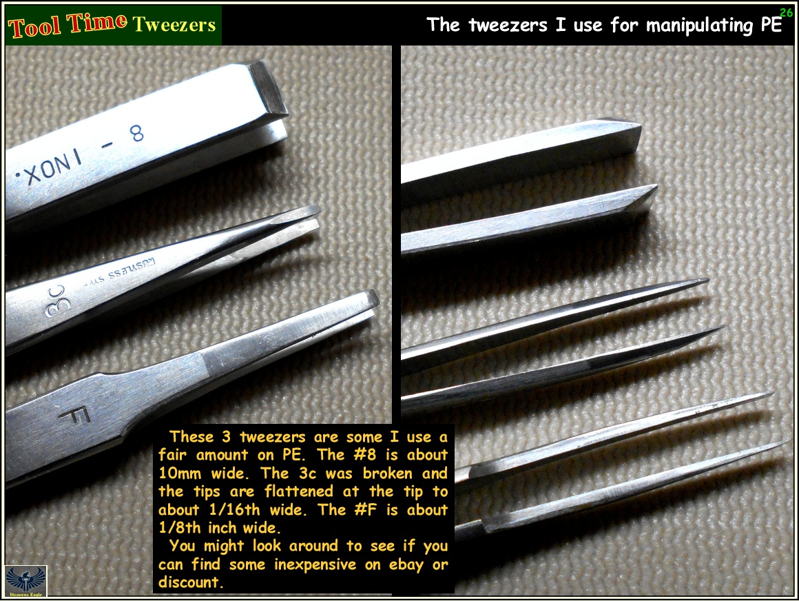

  • There are also the wider tip tweezers. I use mine a lot for holding PE and in some cases bending PE.
Some better quality tweezer brands:
  • Dumont
  • Vigor
  • Bergeon
  • Horotec
