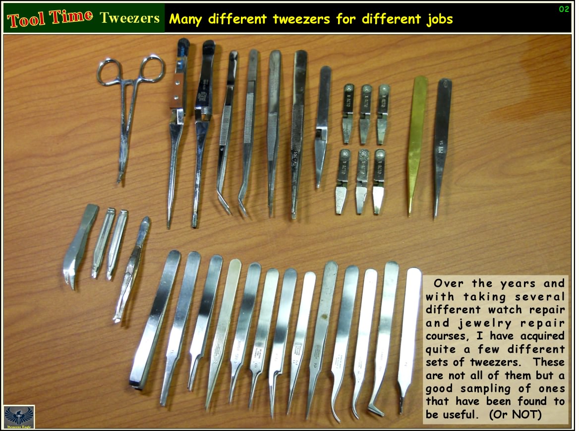

If you have a need for some special tweezers, please PM me for some suggestions. Also PM me if you are interested in trying to obtain some watchmaker style/quality tweezers and I will do some searches and supply some links.

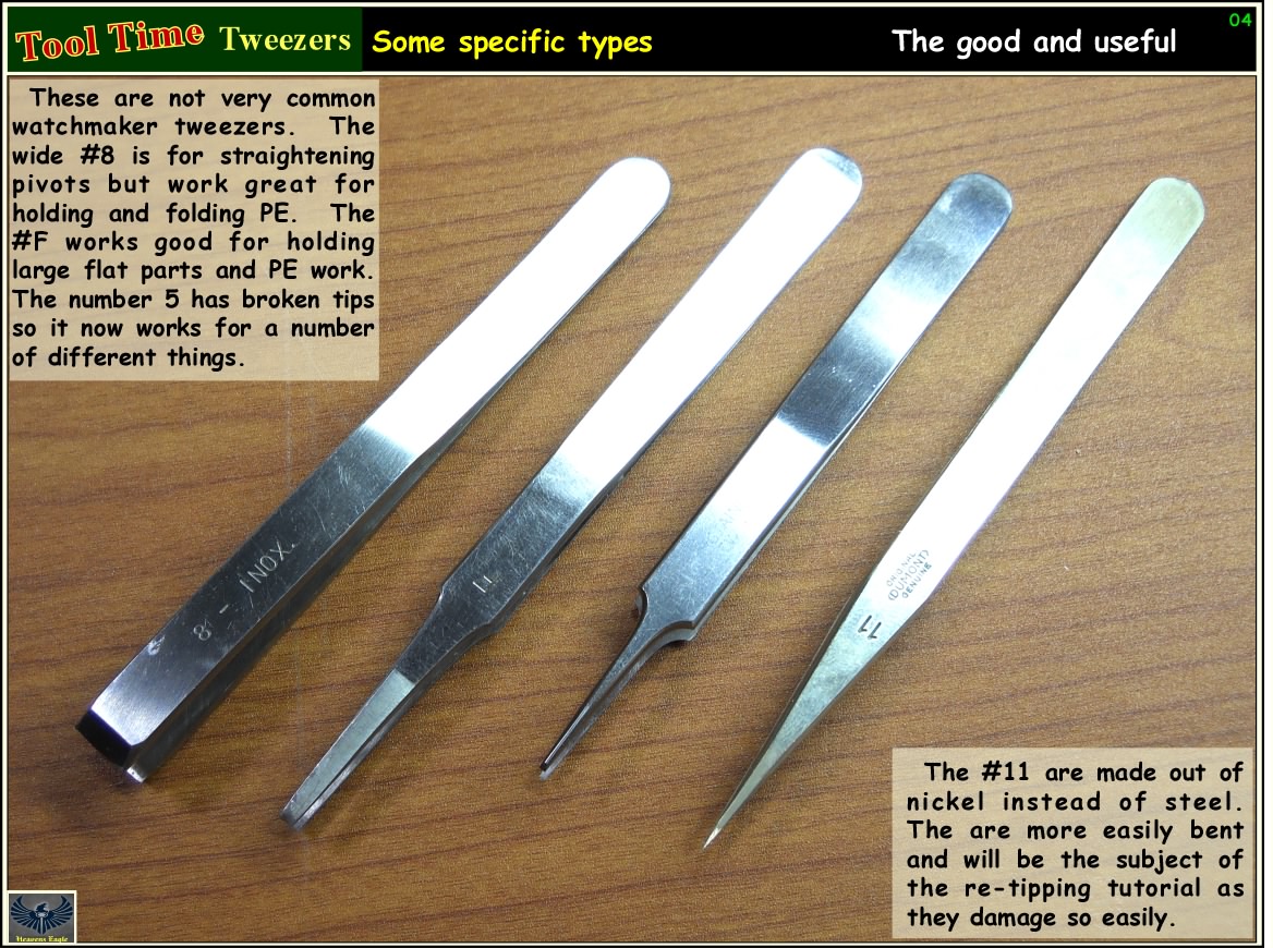

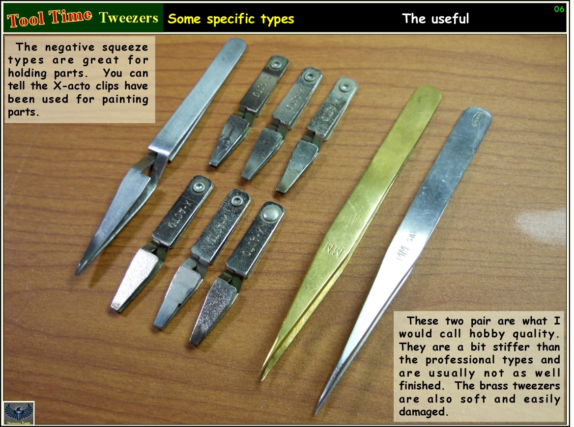

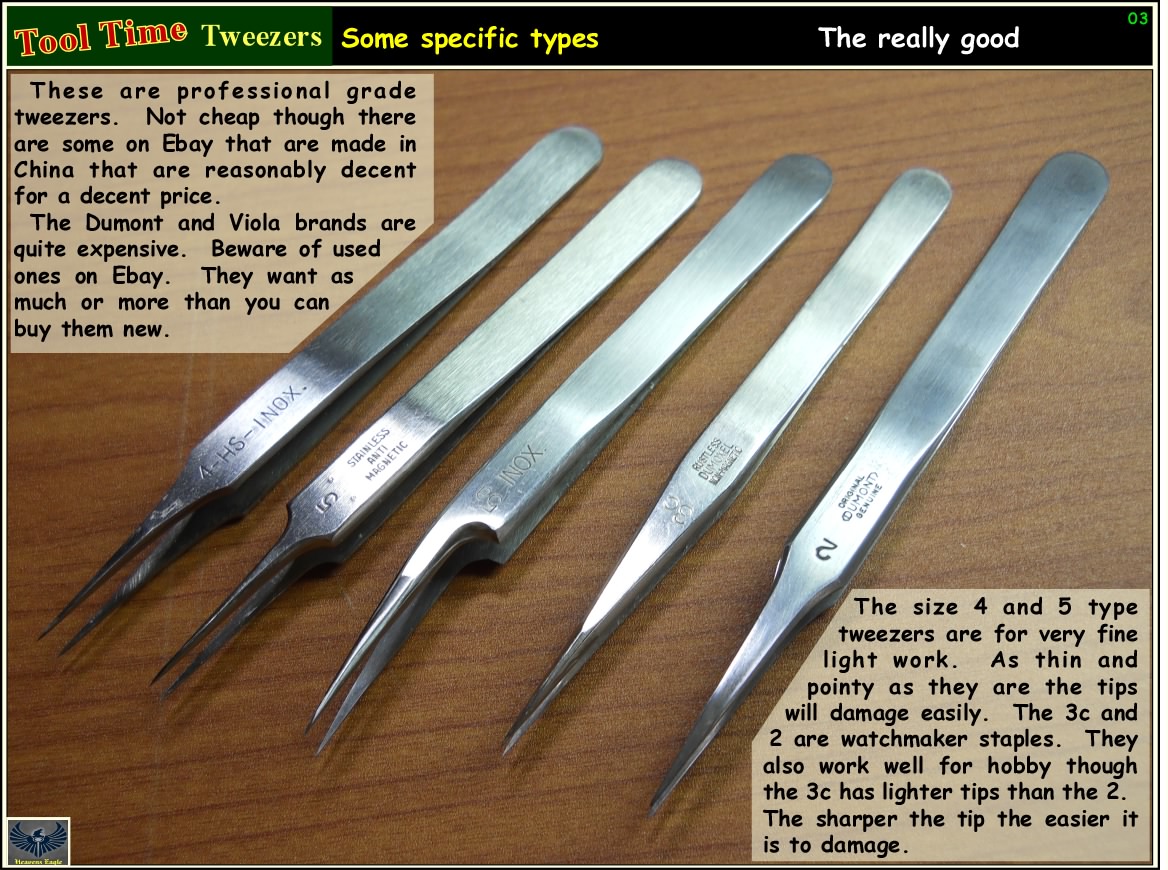

The Dumont tweezers are some of the best you can buy, and are a bit pricey. There are also have some tweezers from other sources that can be found in the $5 - $10 range if you are interested. I don't know what the quality on the cheaper tweezers are, but I have been using some of the Dumont tweezers for years and they are worth what you pay for them.

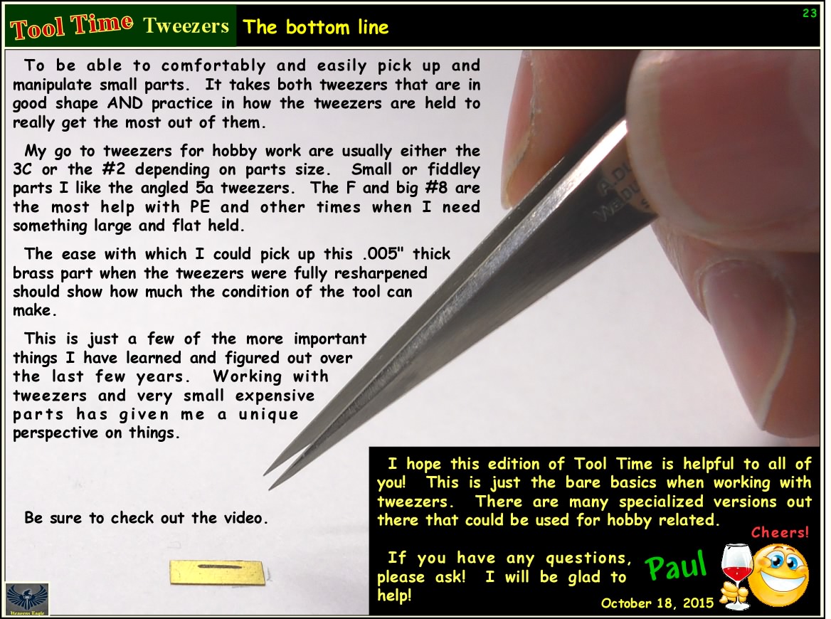

For hobby work I would recommend the #2 style as a good all around tweezer. A #3 or #3c would be good for really small parts handling. Then there are some others that work well with PE.

Let me throw out some things here folks, you don't have to spend $25 to $40 bucks for a pair of tweezers to get some good ones. There are some decent ones on Ebay for just a couple of bucks that are probably made in China, but are very close to the Dumont ones quality wise. You have to be a little picky with which ones you choose but you can get some decent tweezers for about $10 with shipping, or several types for under $20.
The trick is to buy the ones that show good photos and call them out by the Dumont sizes.

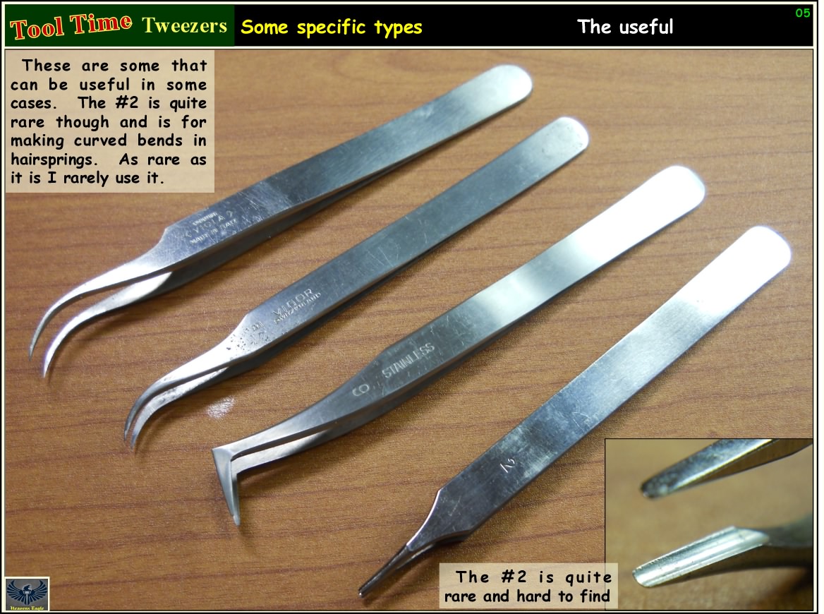

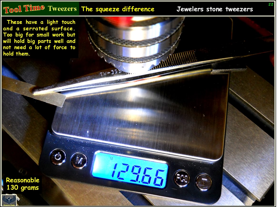

Here is something else to be aware of, the size 5 and 5a are really long thin and sharp. This also means they will not hold up to anything but light use. They are meant for working with watch hairsprings. It can be nice to have them though if you do have something light and touchy to work with.

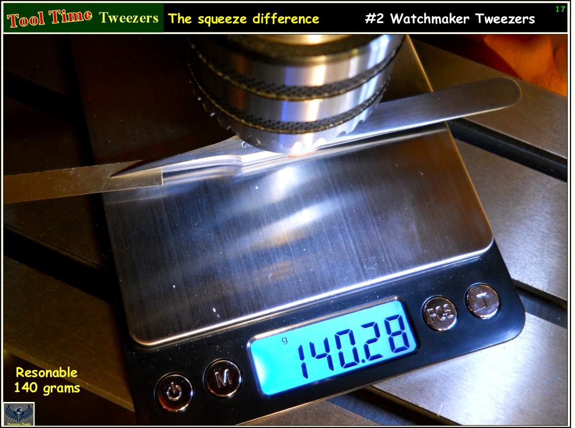

The #2 size I suggested is a good strong pair that shouldn't tend to launch parts (unless you have the bonecrusher grip). Size 3 and 3c are a little lighter and also quite sharp but will need a little lighter touch.

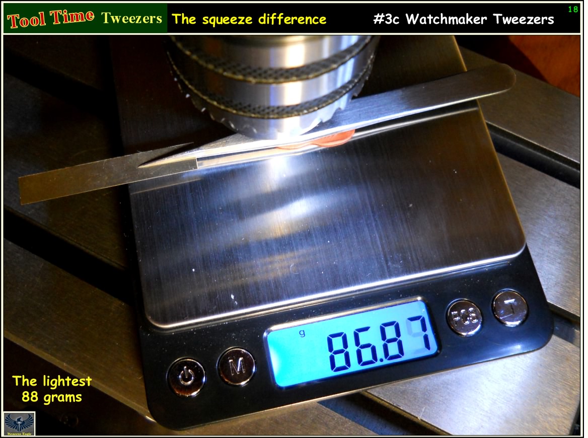

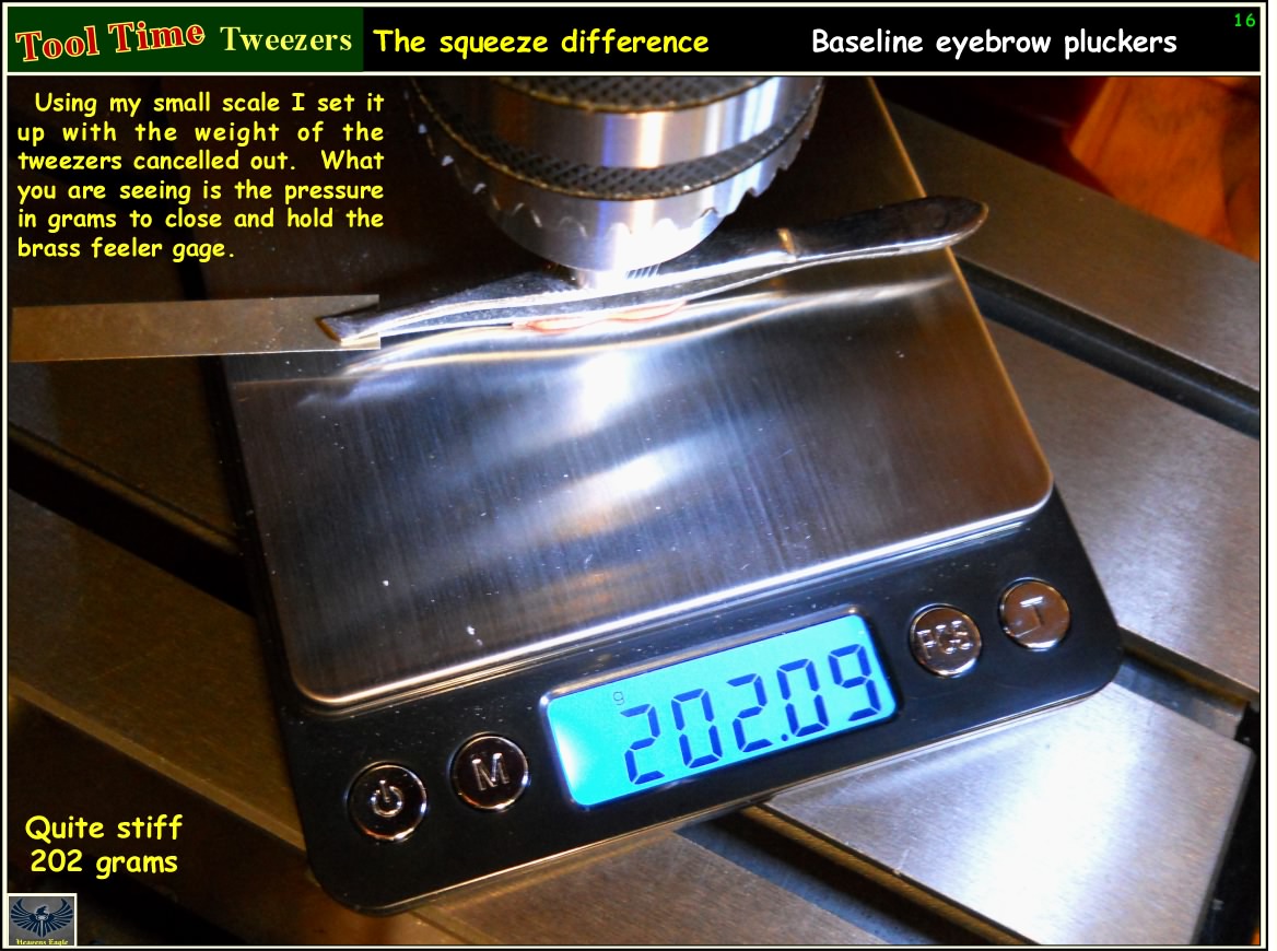

Any tweezer if squeezed too hard will flex and can launch a part.

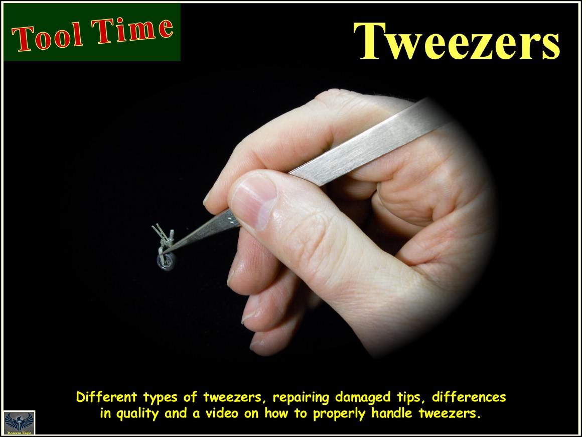

I have a lot of pics I am trying to get together in some semblence of reason, including a short video showing me picking up a flat .005" thick piece of brass sheet with a resharpened pair, rolling it 360 degrees in my fingers and setting it right back where I picked it up. BY THE EDGES! Can't do that with buggered tips. Takes 2 fingers and your thumb to do it. That control comes with holding tweezers correctly and practice. I am going to try to convert the video to an animated GIF file as it is fairly short. If that doesn't work I will just make a simple video file on Utube again.

While I still have my usual pictures with explanations coming, I have made a quick video showing how to hold and use some tweezers with good tips. The particular tweezers I am using in the video are a pair that I used to show how to resharpen and clean up the tips.
The thin brass part is .005 of an inch thick, or about the thickness of most PE. Enjoy!

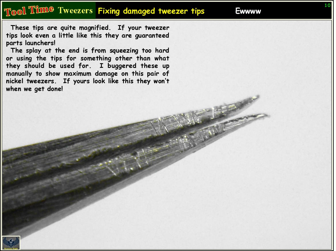

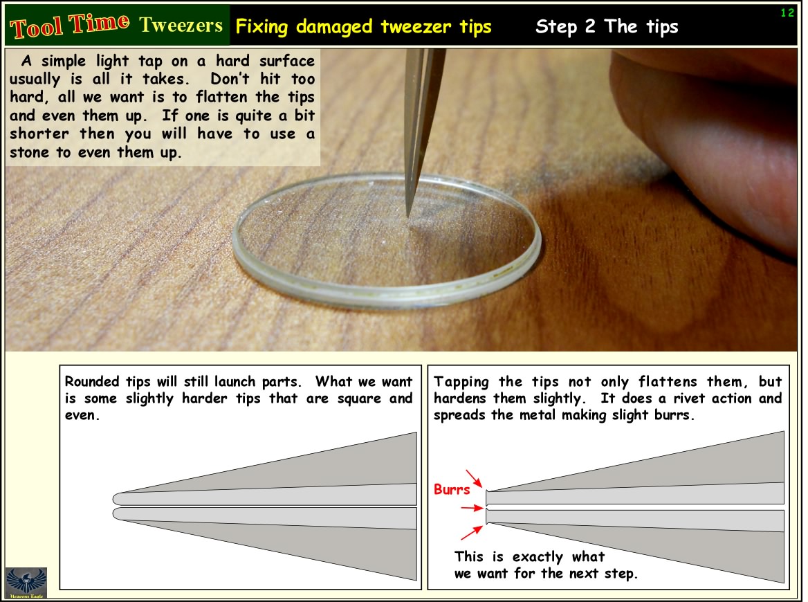

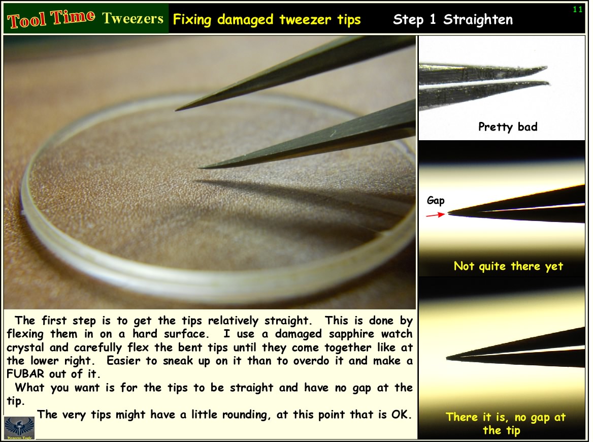

If the tips aren't in good shape it won't matter how you hold the tweezers, they won't be able to hold the part.

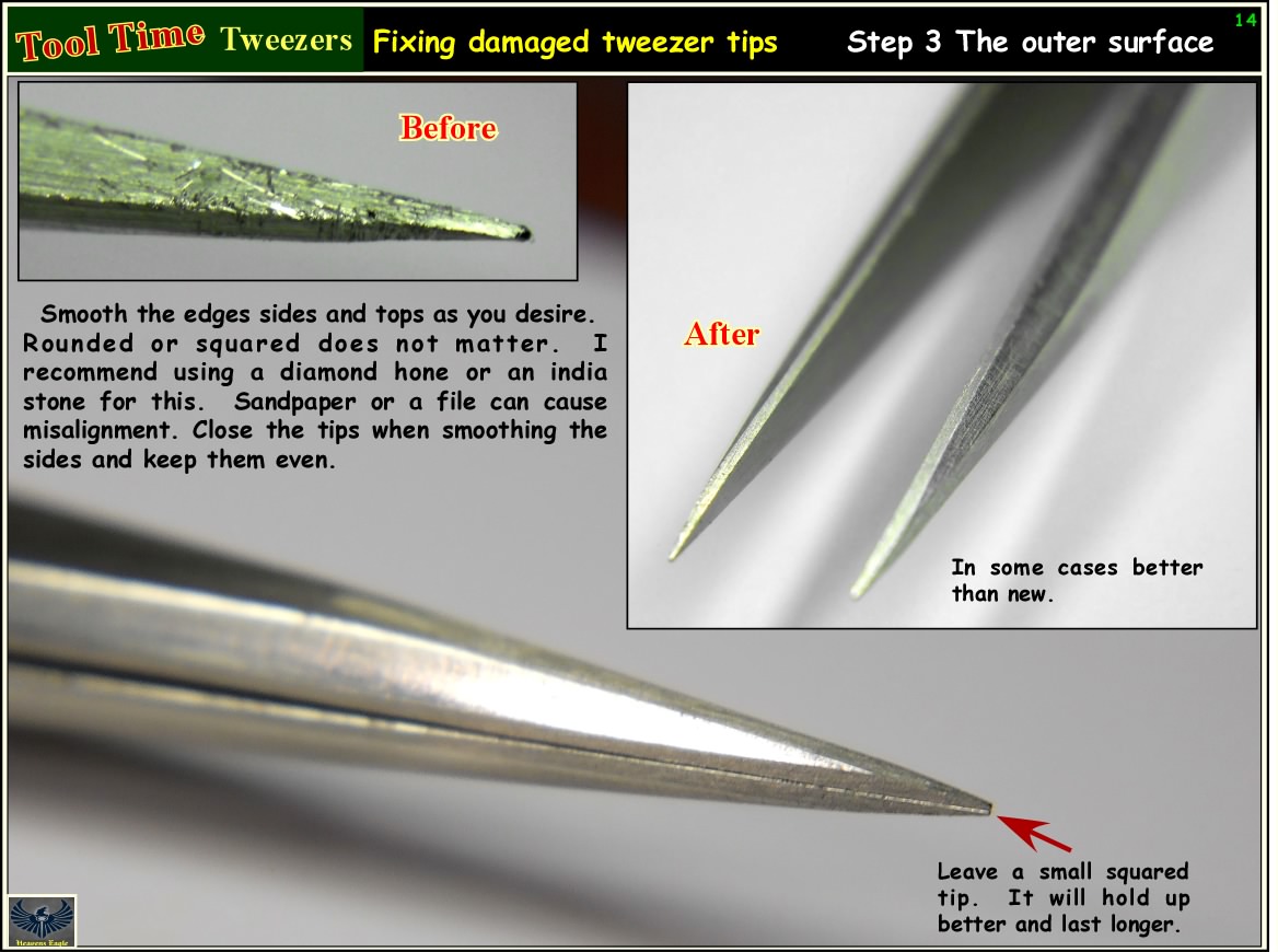

The lesson here is you can have some $50 tweezers with damaged tips and $10 Chinese copies with nice tips and the cheap ones will work better. Once you learn how to revamp the tips though, the expensive ones become your "go to" tool. Even the inexpensive tweezers can become decent to use if retipped correctly.

I have also been meaning to add that I have been thinking of some more little tweaks on the tweezer tips. That will be coming up in another post soon. Since it will be super small details there will be mostly drawings to illustrate what I will be explaning.
