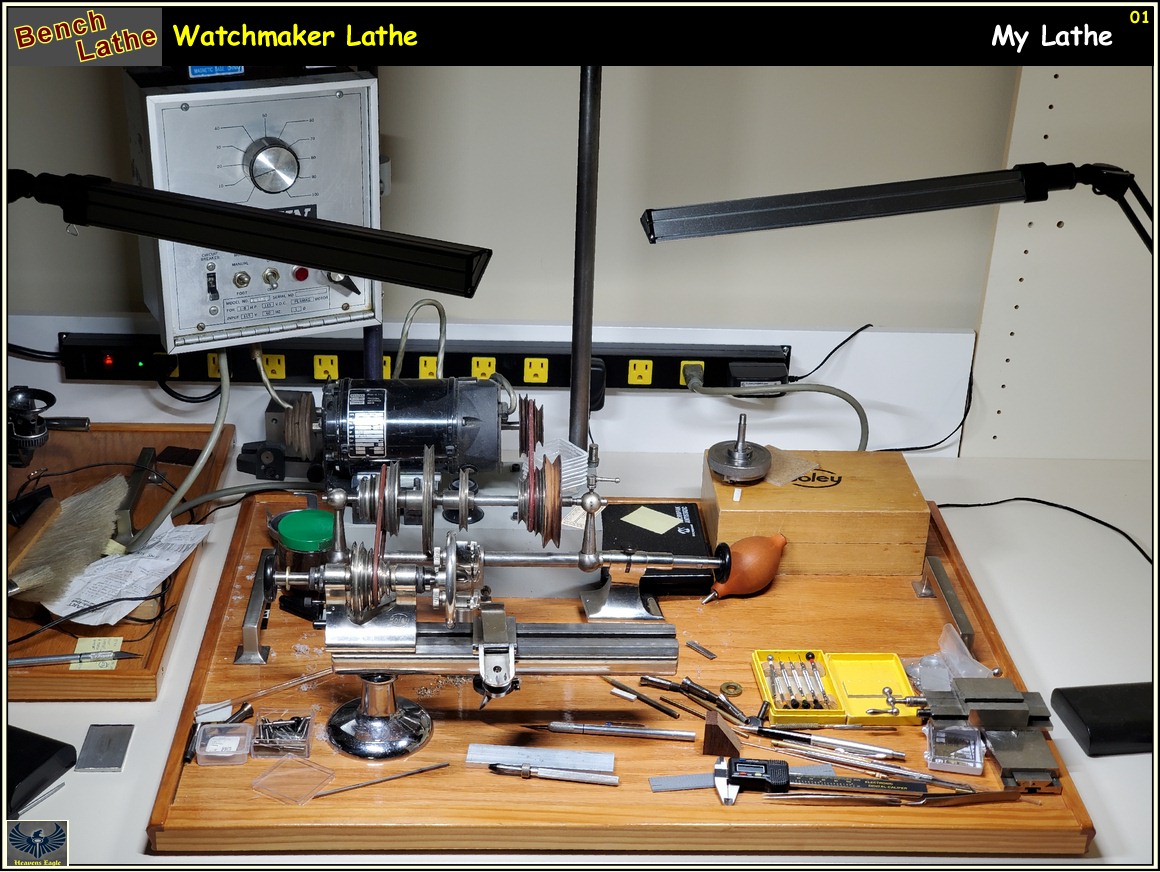

I have a watchmaker's lathe and use it fairly often. It is kind of a cross between a wood lathe in how you work the tools to cut the work and a very fine machine lathe. As I said the lathe itself is only the first part. My lathe cost me about $800 twenty years ago. Then there were the chucks, 3 jaw and 4 jaw, wire chucks, wheel chucks, cross slide, and a few other add ons. There was also the motor that I purchased separately which was another $600 if I remember correctly. all the other items I listed probably cost about $3k at the time. Some tools I have used a lot, and others have never been used.

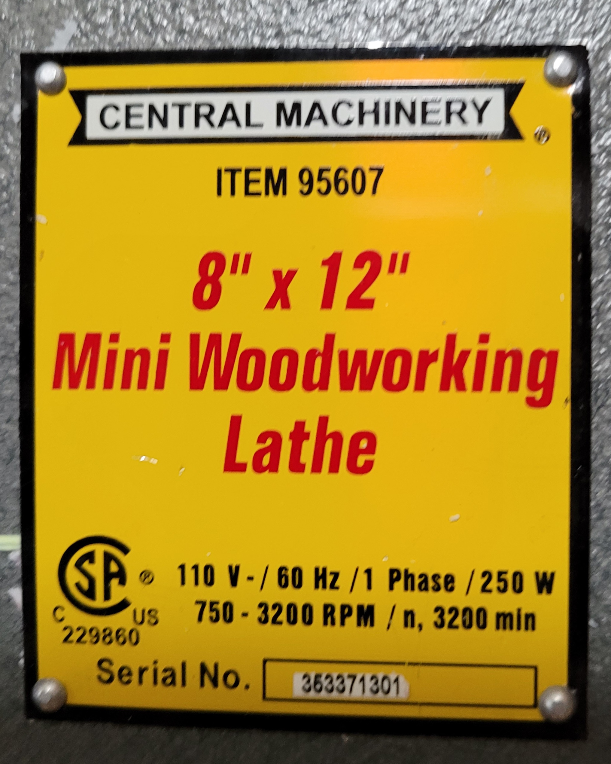

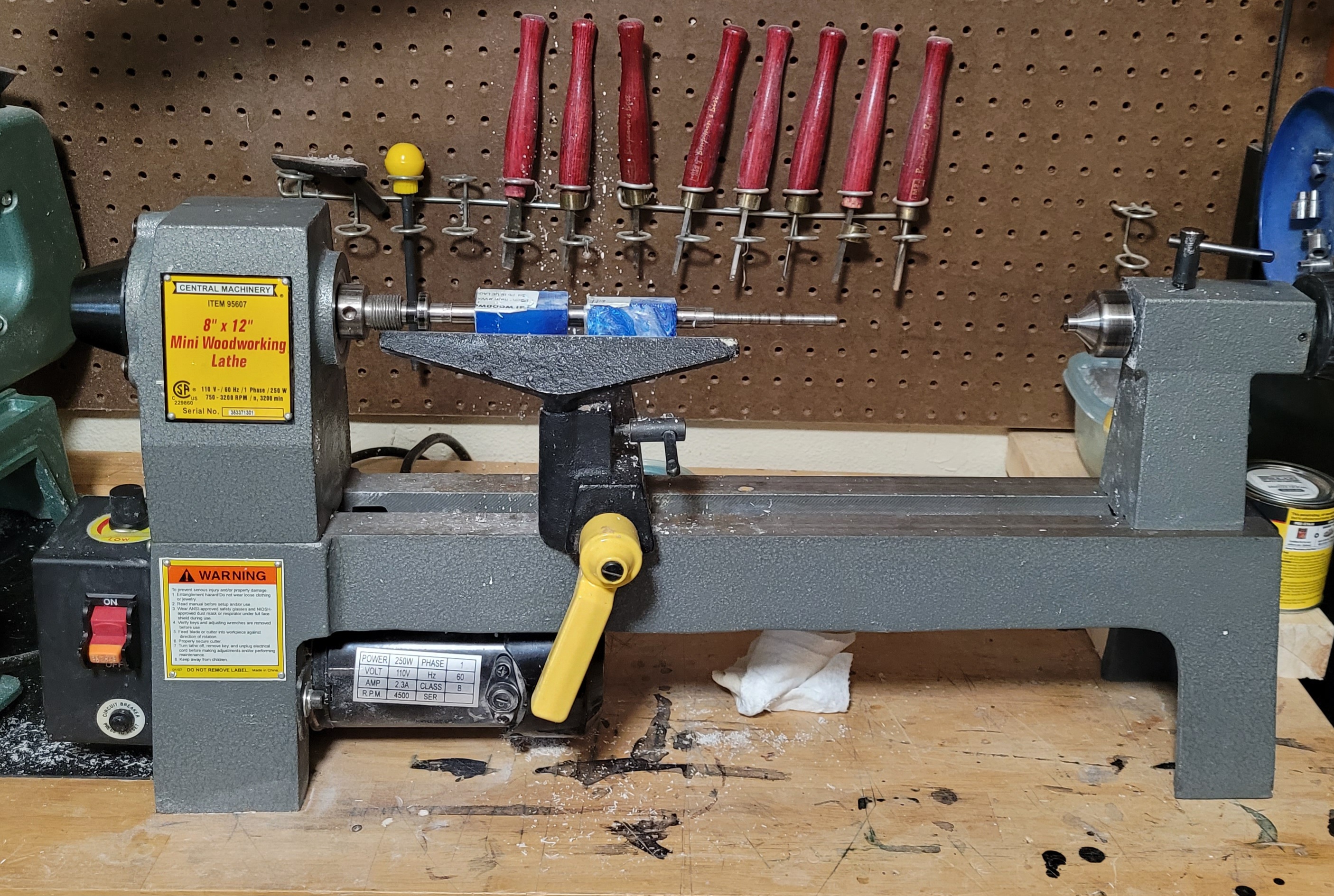

Teresa uses this one to make all her Eggknobs & Inksticks products. She doesn't care for belt-drives because she like to twist a knob to change the speed, rather than swapping belts around. She's used this lathe since 2013 without much fuss.

I wondered about something like that, but its no good for metal work. funny story about wood lathes, in school I laminated wood together to make a nice 18 inch salad bowl. I ended up giving my Mom a 5 inch round jewel box. Too bad the instructor wasnt interested in teaching , just shaking his head and muttering obscenities. Still Mom did like her jewel box so not a great loss.

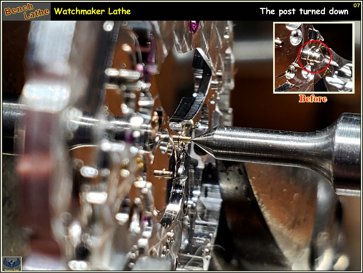

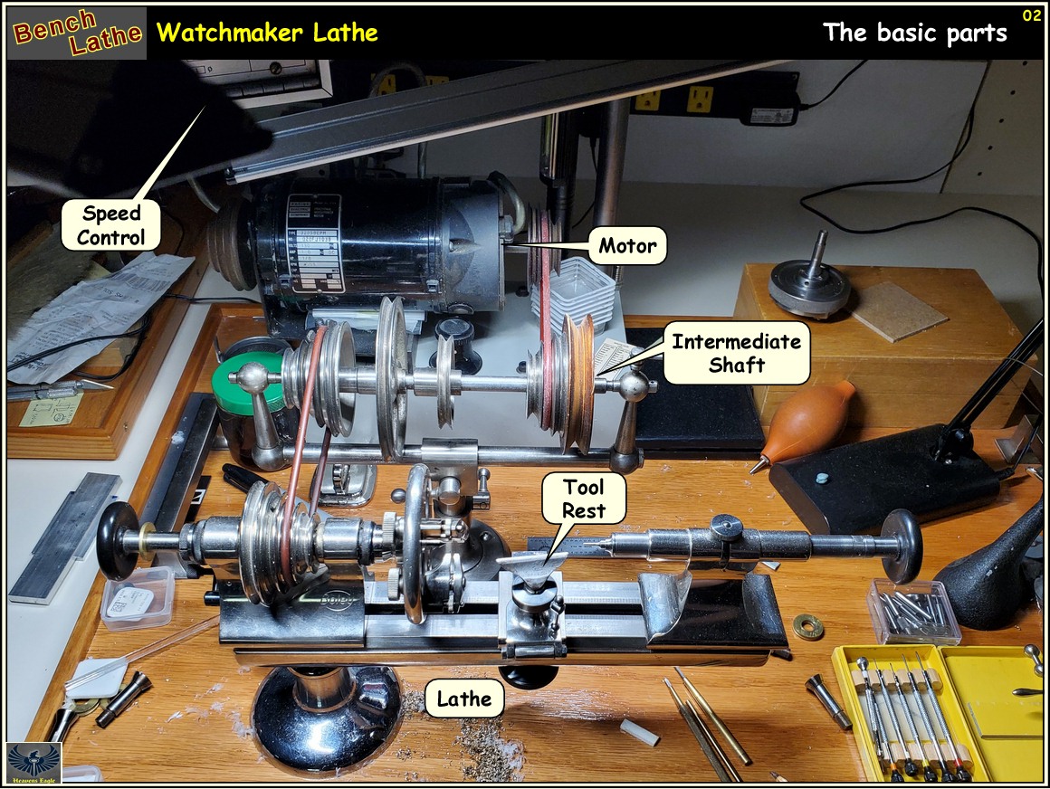

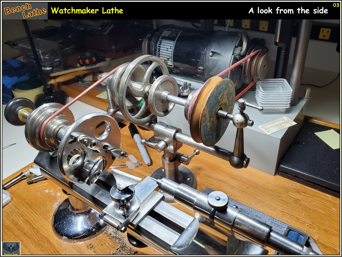

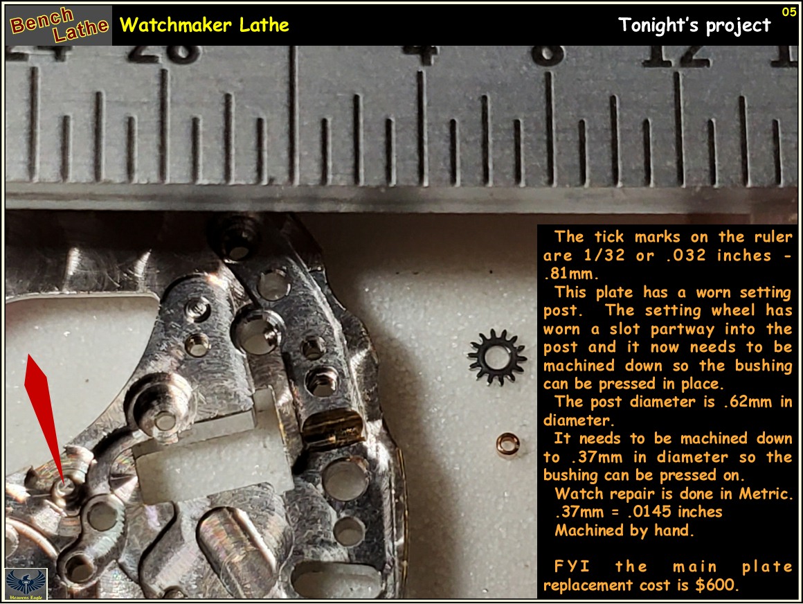

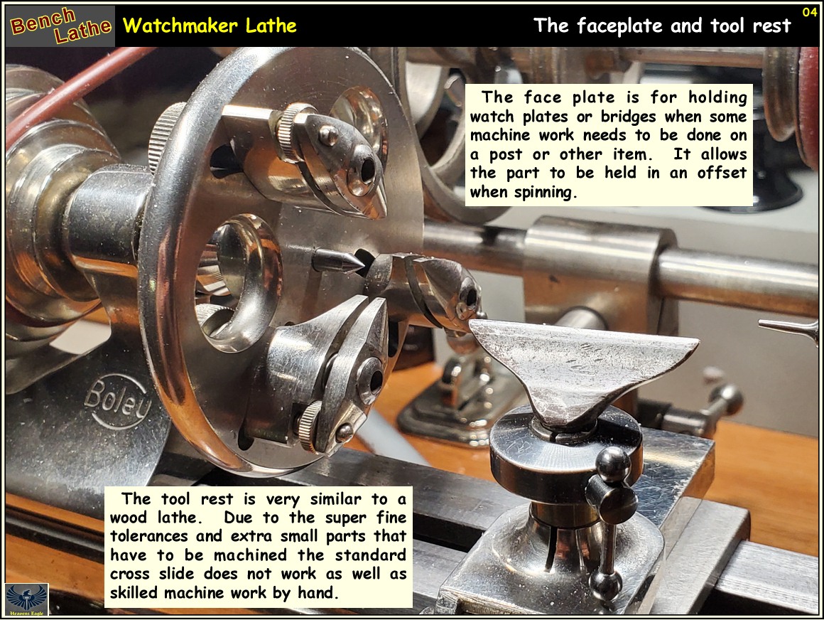

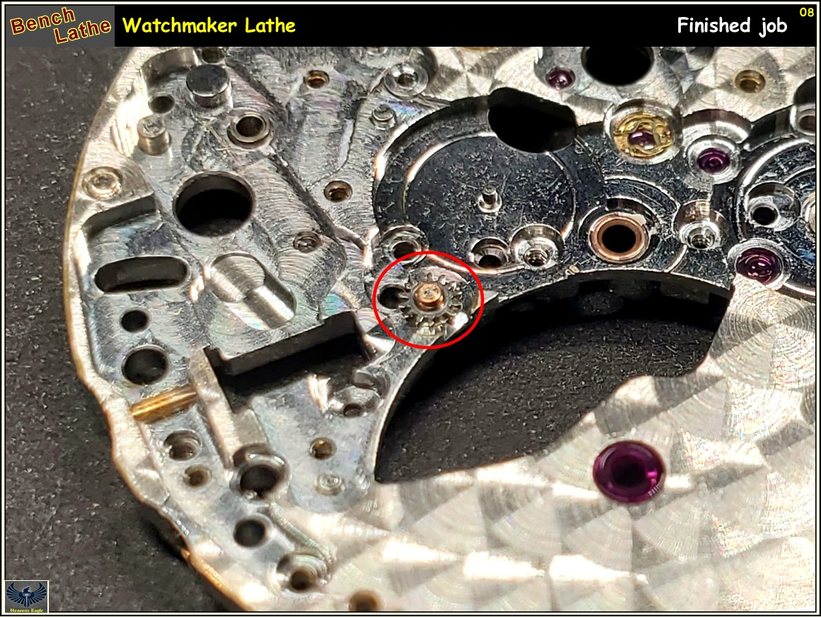

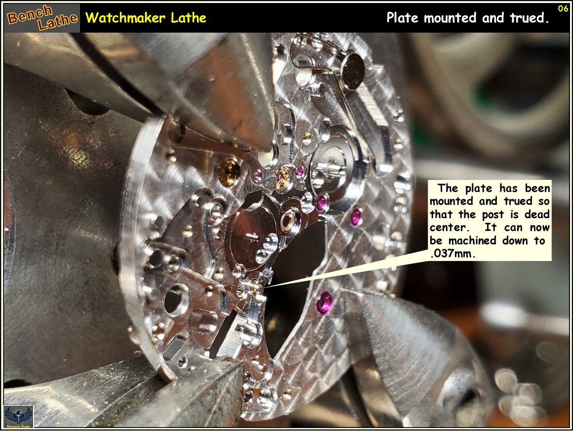

I had a project from work that I had to do on my lathe tonight so since this thread has been going on, I took some photos during the process. Hope you enjoy! It took me about an hour to do this little job. Sometimes it is quicker, sometimes it takes a little longer depending on how contrary it is while trying to get it true to center. I need to make another little tool which would help with that, but just have not had the time as that tool will have to be quite small delicate and will have a fair number of parts for it to work properly.
Anyway on with the show. This is a true watchmaker lathe that uses WW chucks that are common to the older American made lathes. My lathe is a Boley with the motor and speed control made by Levin. This has been a very good lathe and I have been able to do quite a lot of different projects and jobs with it.

If you have any questions feel free to ask. Not many people ever get to see these kinds of things.
