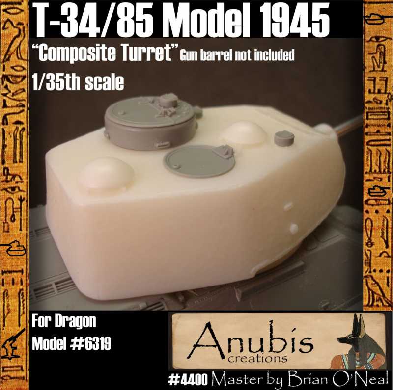

Images of the real item and my dilemma as the turrets from Anubis don't fit the type needed and the hull may be Factory 174 instead.

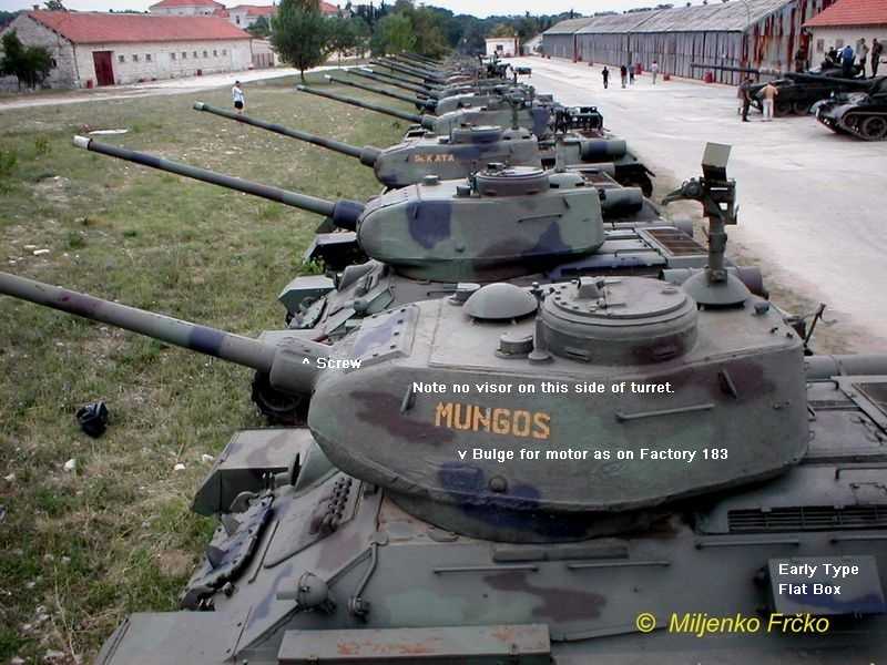

The subject of my entry, the Serb clown:

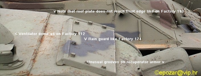

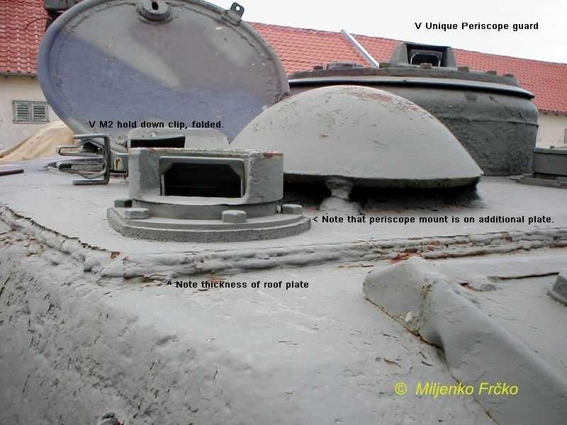

Read the comments on the photos:
Here we see a Factory 112 tank whereby the upper rear hull plate overlaps the lower rear hull plate and it has two large hinges.
Problem is that the turret is correct for the Factory 112 with the long roof plate and lacking the starboard turret visor!

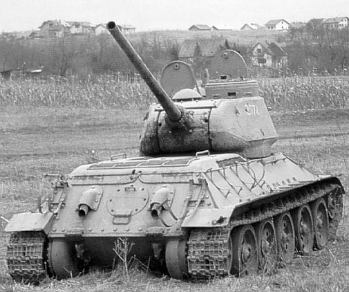

Well, I need to make a decision as to the hull variant to replicate. This one seems to have the same turret and it is a Factory 174:
Note that the large hinges are very similar to the (round) transmission access hatch hinge. Also, the upper armor plate rests atop the lower plate:
