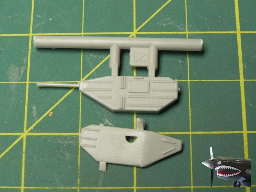

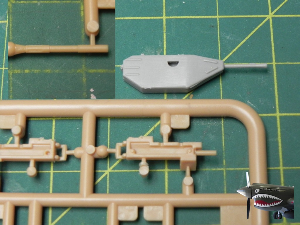

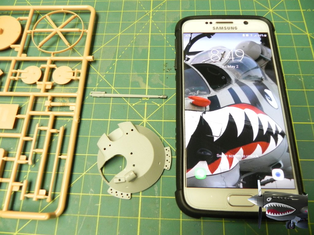

Last year's unused start photo.  Turret with probable turret armament from IBG's Rosomak kit:

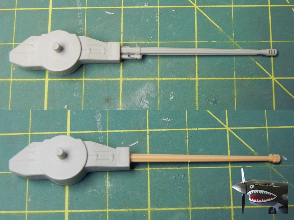

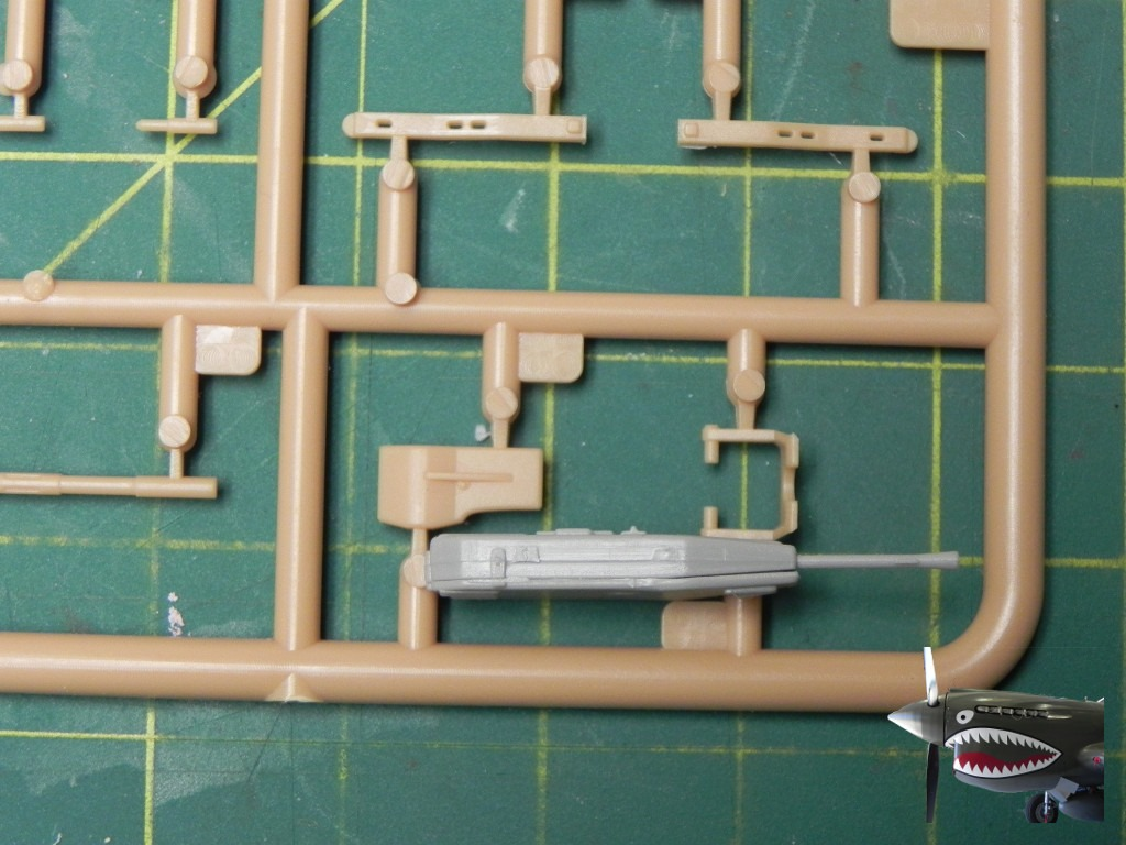

Kit 25mm cannon above 30mm cannon from IBG's Green Devils Rosomak kit:

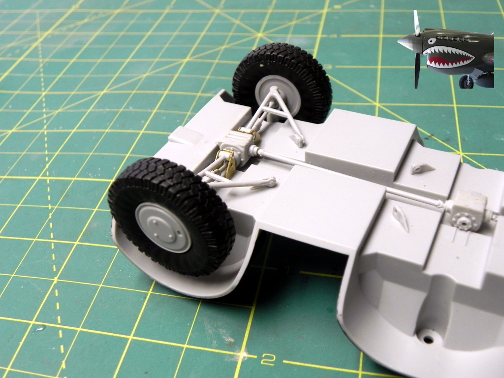

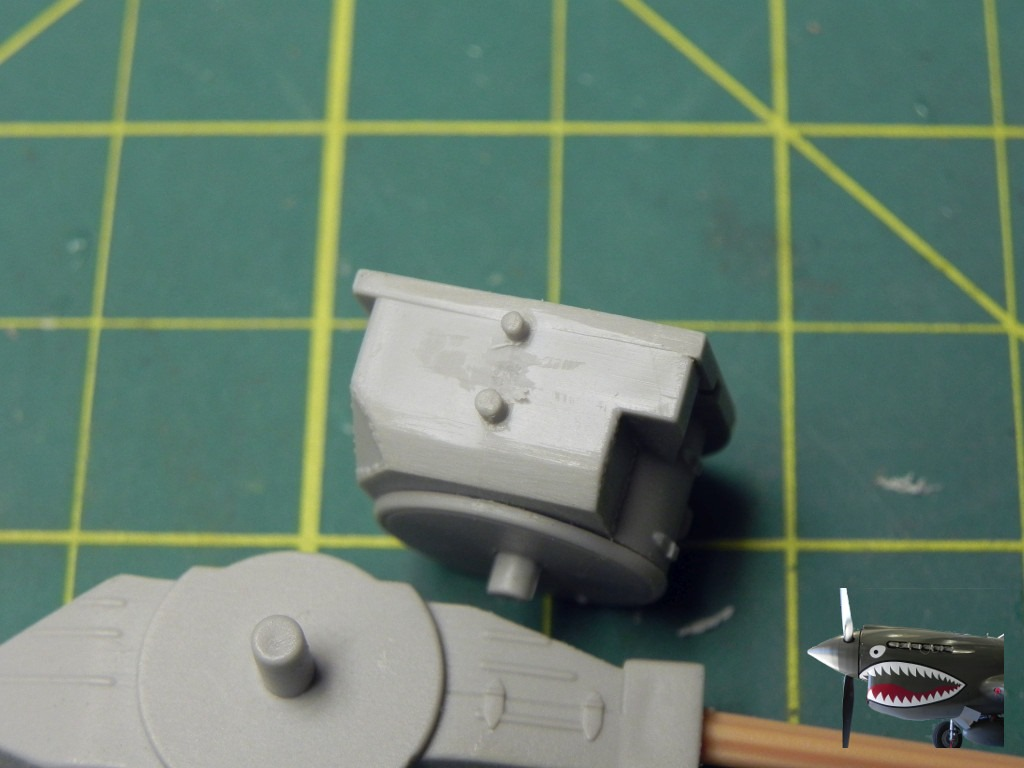

The kit from which the cannon was taken (to be replaced with a metal one from Master Models:

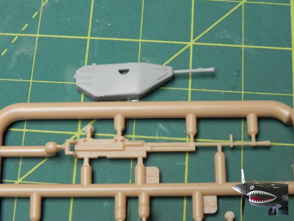

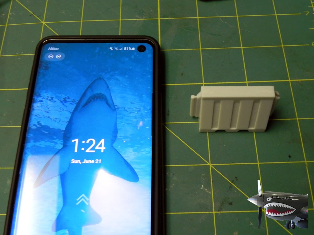

Trunnion/ammunition box base wasn't level so work was done:

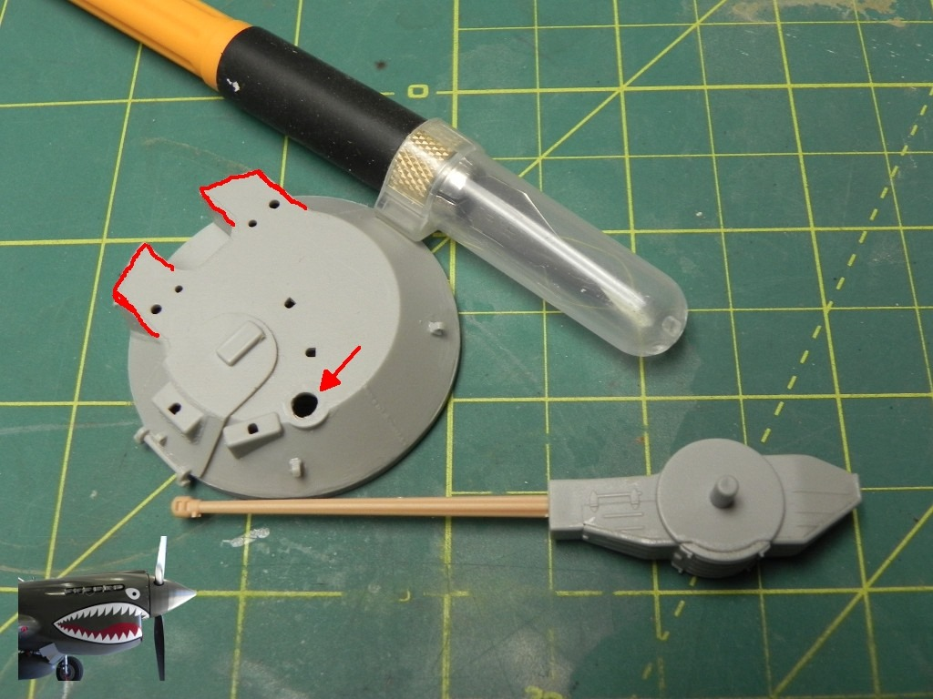

Settling on IBG's 30mm Cannon, some work on the turret must be started to check clearance and modify the trunnions/ammunition boxes as needed. Note that I have already removed the smoke grenade launcher shelves as the Iveco Puma has them on the hull. Red are removals (welds and gun sight). IBG Rosomak barrel in lieu of WZ505 barrel.
