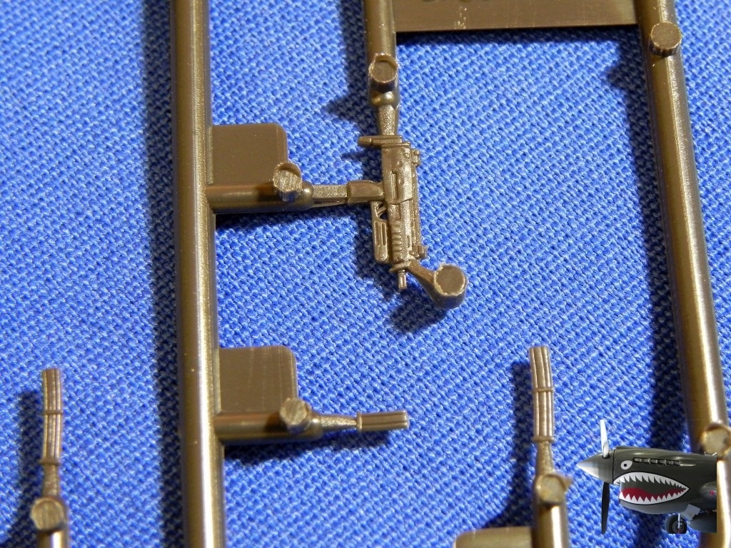

Until 1970, the Pope had a private army called the Gendarmerie who were reduced to a paramilitary police force. However, they did continue to use military hand weapons such as the MP-7A1 submachine gun. With the recent events the Pope decided to reinstate them as an army and had them procuring new vehicles such as the two AB-214 armed helicopters which are able to whisk away the Holy See in an emergency.
Swiss guards in traditional uniform wearing the PVC helmets. — in Vatican City.

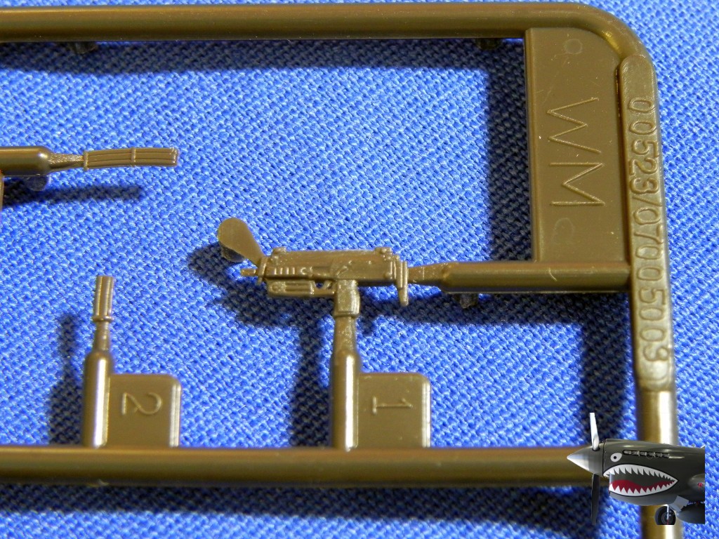

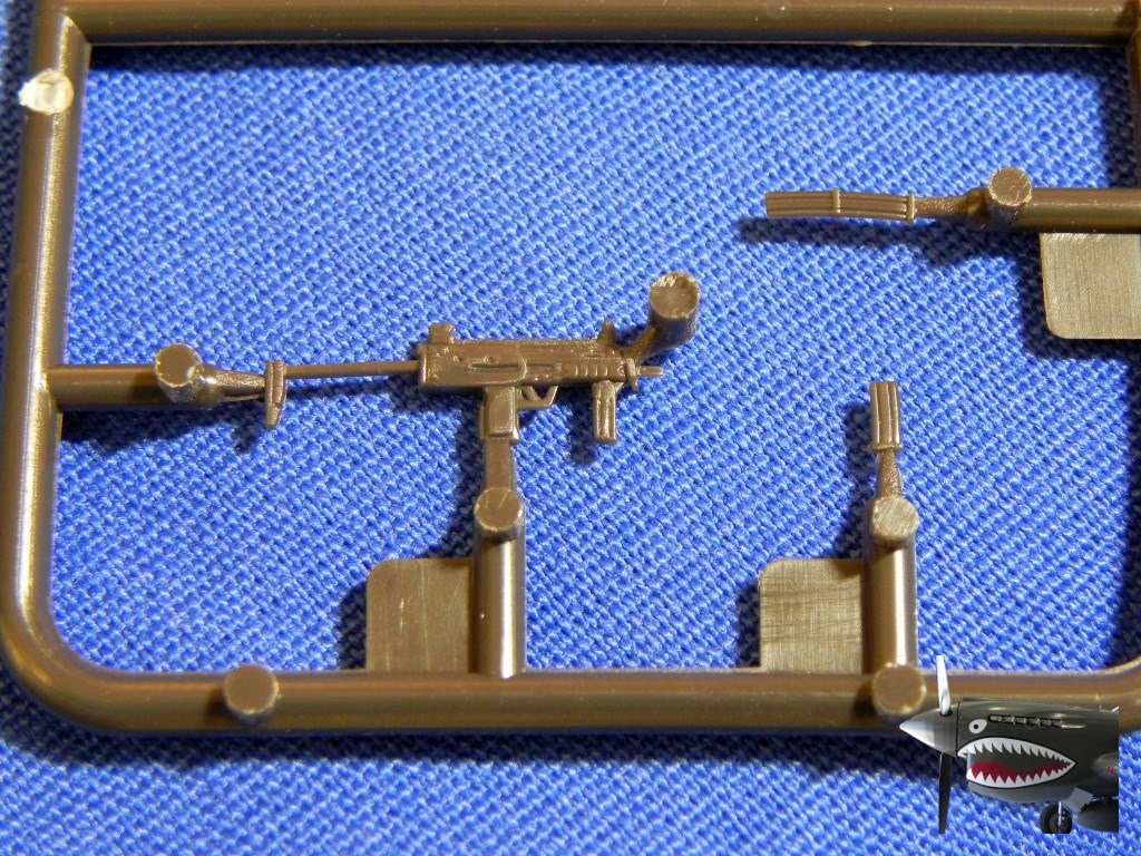

MP-7 as used by the Pontifical Gendarmerie from one of Trumpeter's small arms packs.
MP-7 with extended stock, as used by the Pontifical Gendarmerie.
MP-7 with stowed stock, as used by the Pontifical Gendarmerie.

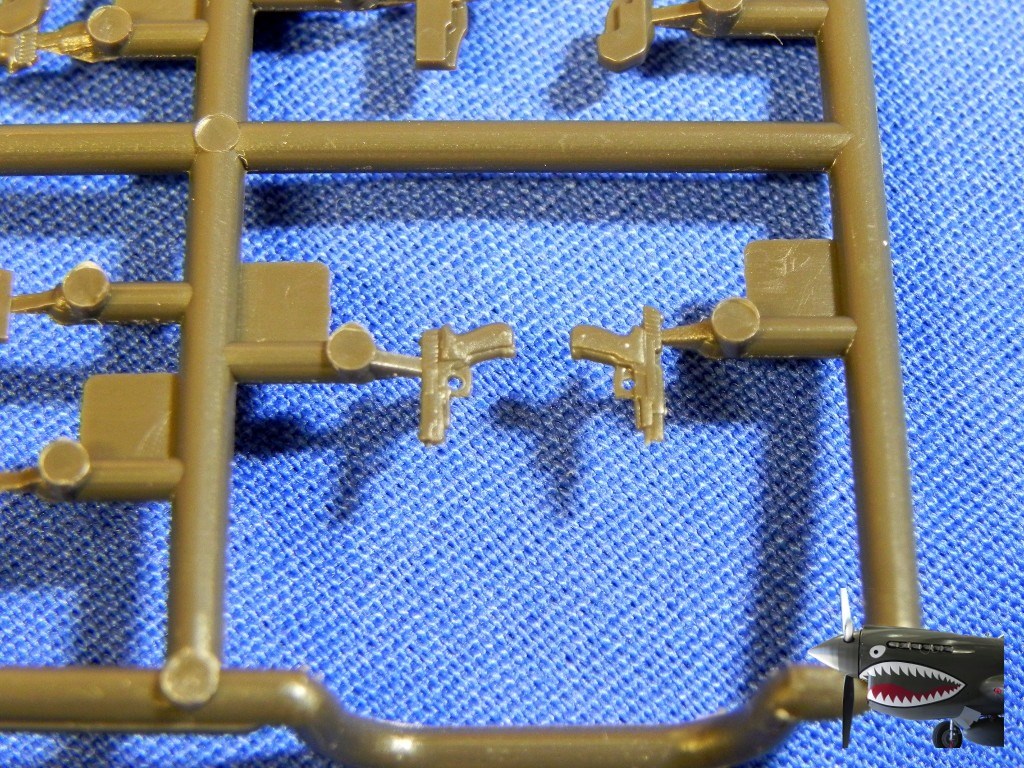

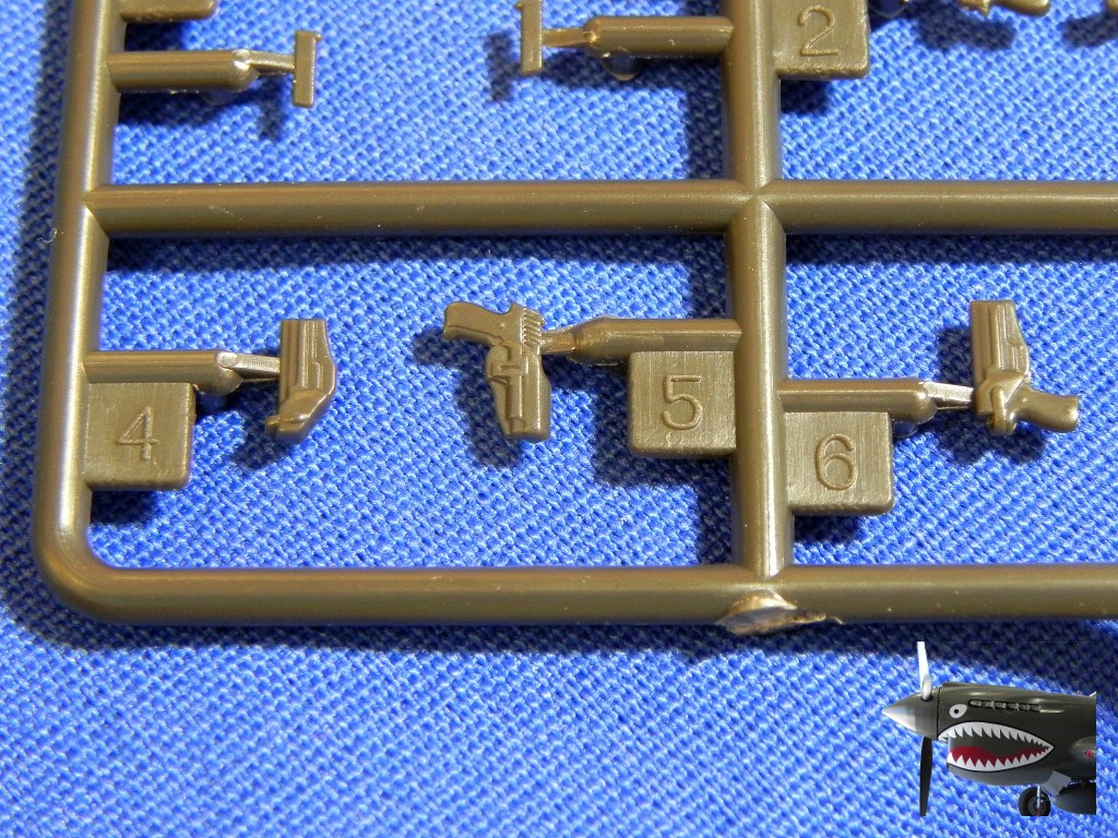

P226 pistols as used by the Pontifical Gendarmerie from one of Trumpeter's small arms packs.
Even the back of these P226 pistols in holsters, as used by the Pontifical Gendarmerie, have accurate details.

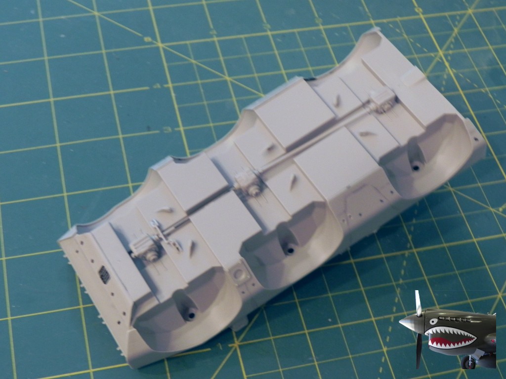

The Puma's interior had the armored glass vision ports painted and installed with the rest painted matt black as I decided what armament to use...

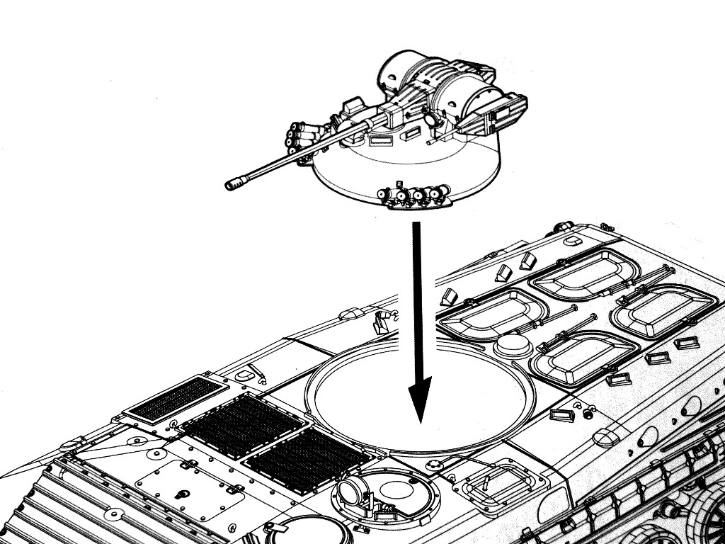

I decided on the turret from this BMP variant...

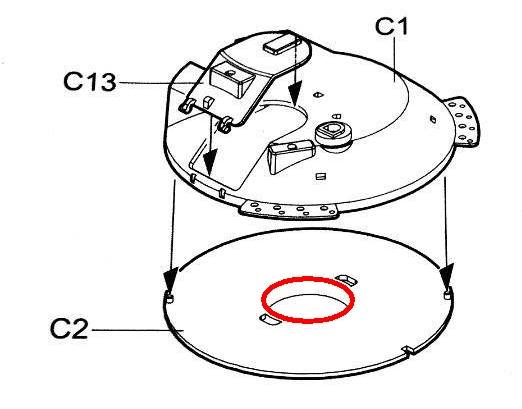

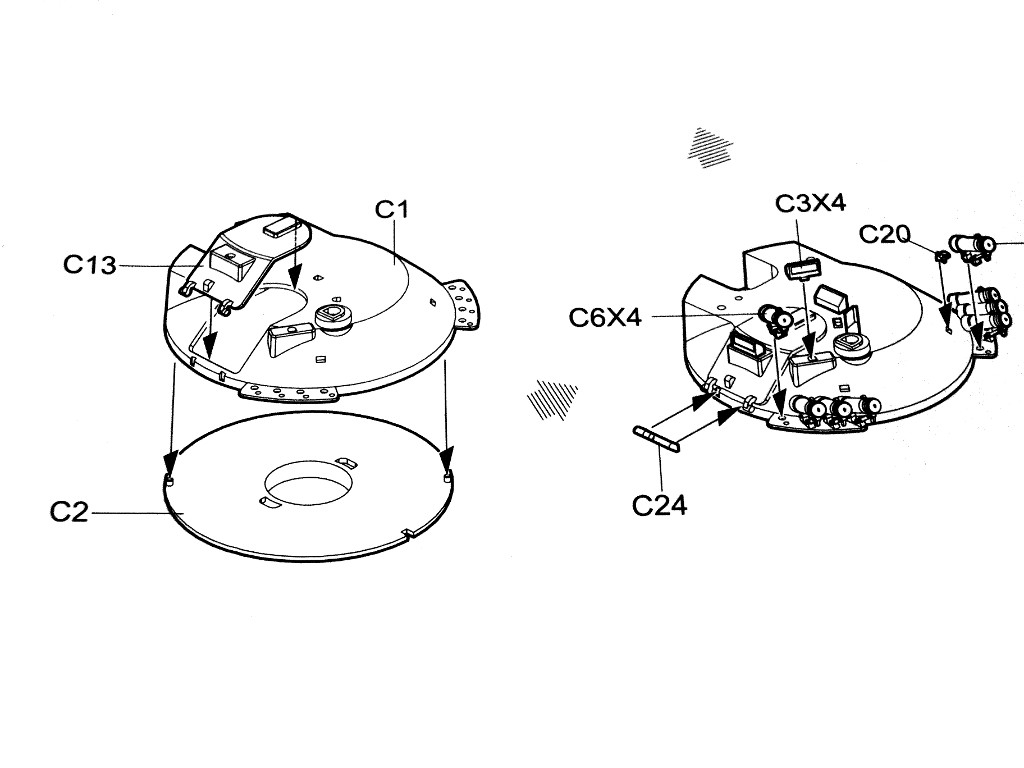

Since the design team at Trumpeter decided to use a turret from Hobby Boss (which Trumpeter designed) and not mention the disparity in sizes of the turret piece and hull race. Note how small the turret race should be based on part C2.
Yet, the BMP turret race is the correct dimension and therefore too large! I decided to use an upgraded SP Designs BMP turret.

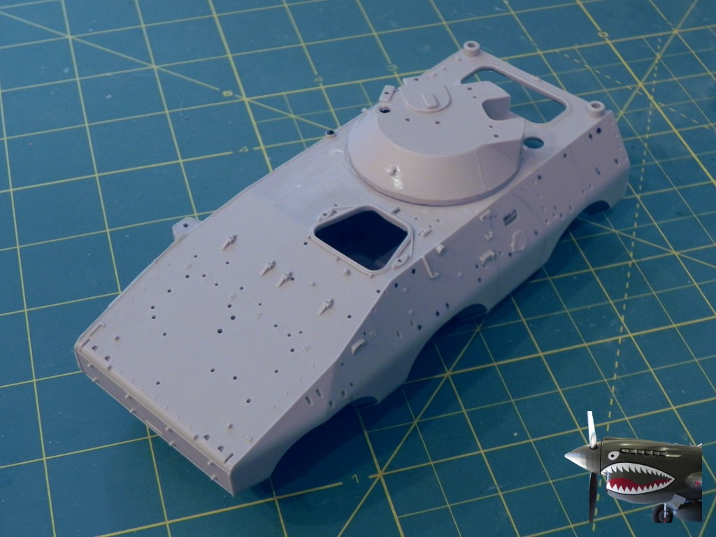

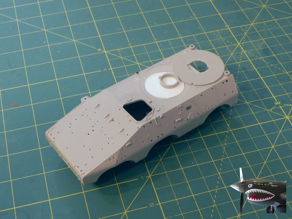

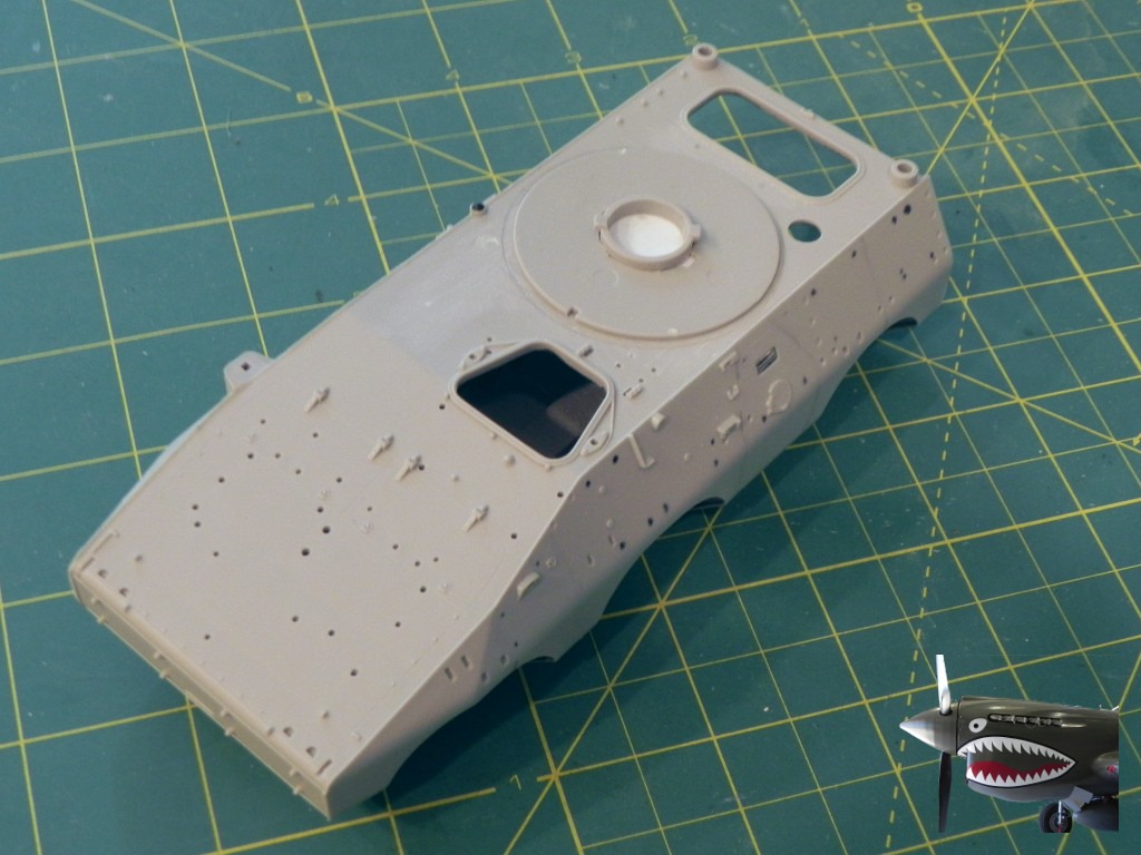

Now the hurdle of adding it to the Iveco Puma hull. First, decide where it goes and then we begin! Let's fill up the cupola hole on the hull. Pencil lines show where the turret will be and many hull roof details were carefully removed to reapply in new locations.
The first step is to scribe into the turret base (C2) all the way in (red line) and not to cut it flush with the base. The resulting hole on Part C2 should accept the removed ring.
The removed turret ring is them placed where needed and tack glued with cyano-acrylate from the inside of the ring.
Here, the turret base is added to ensure correct placement then removed to properly bond the ring to the hull roof with cement.
You now have a turret which can be added like any kit (twist on) but in reverse.
