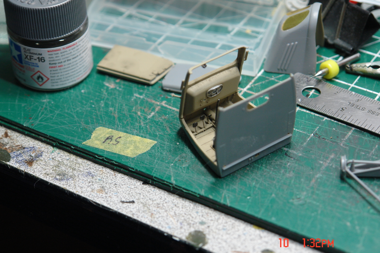

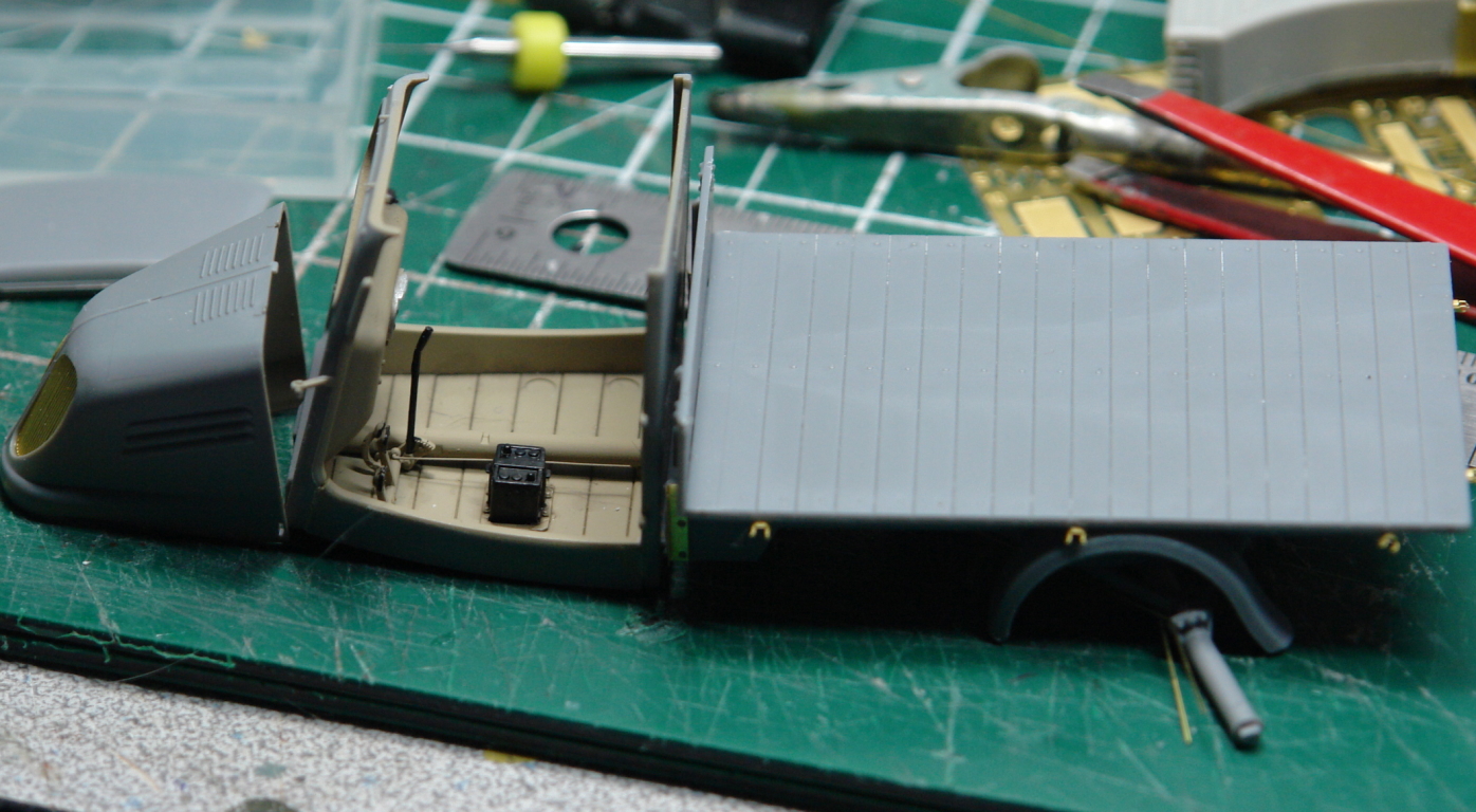

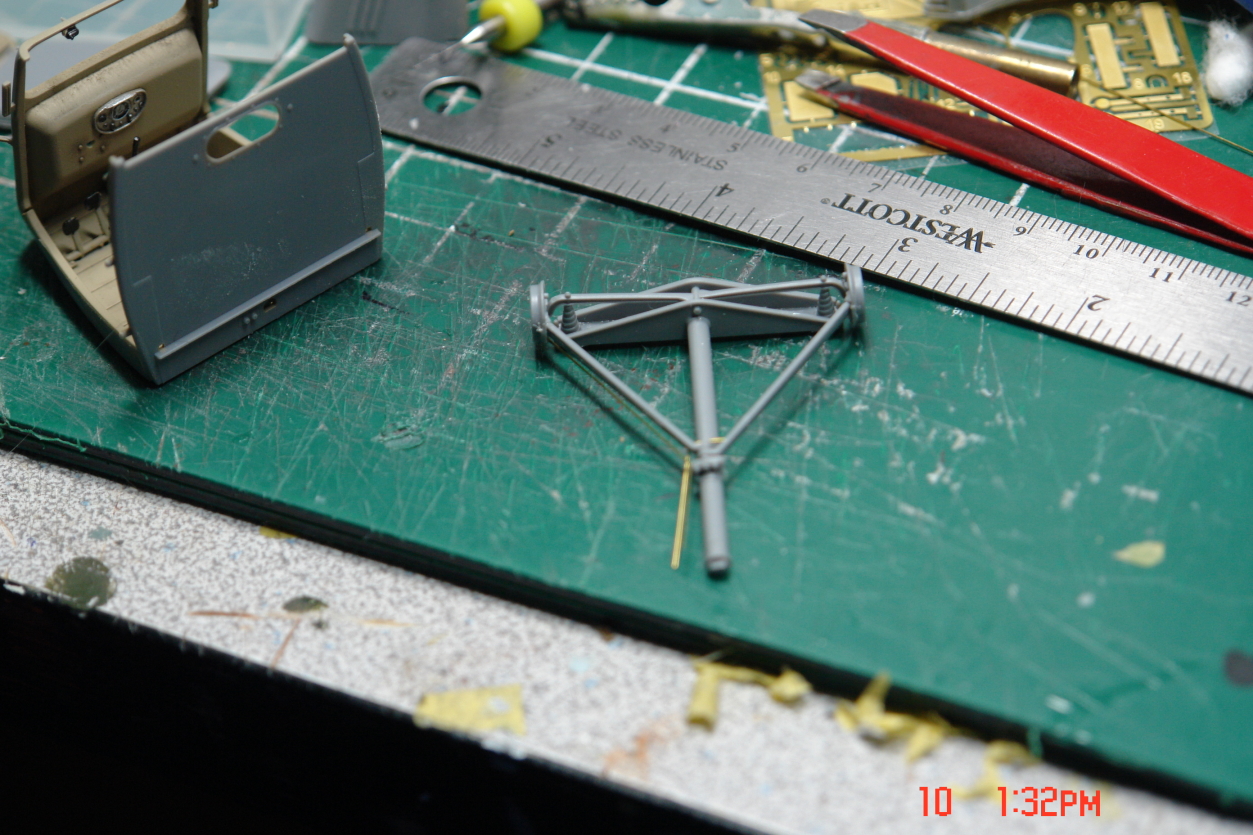

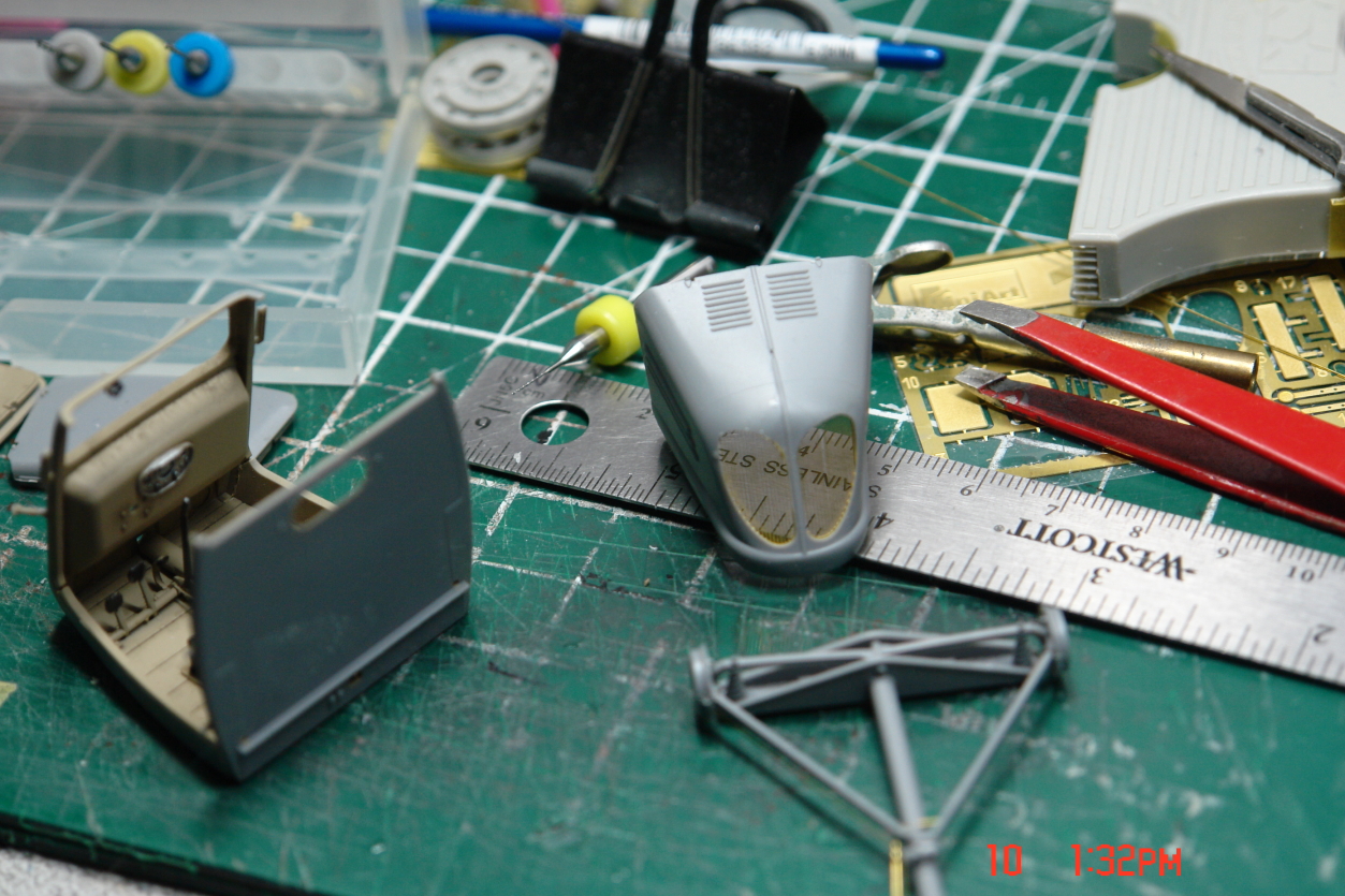

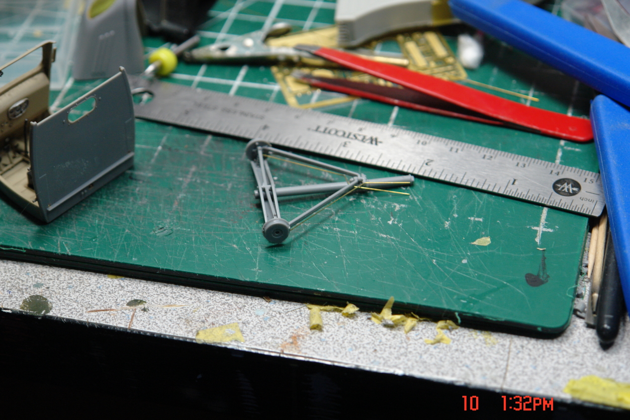

Try this again. I havent had much time for modeling but started the new Miniart Tempo E400 because I really wanted to do it. Here is about 2 hours work. .03mm brake lines started and the line from the break pedal/break handle. The PE is very fine and the kit is very fiddly. So far though it has been fun.
Doing the pickup version and then I have 2 more after that. Looking forward to doing the Red Cross version shown on the top box.

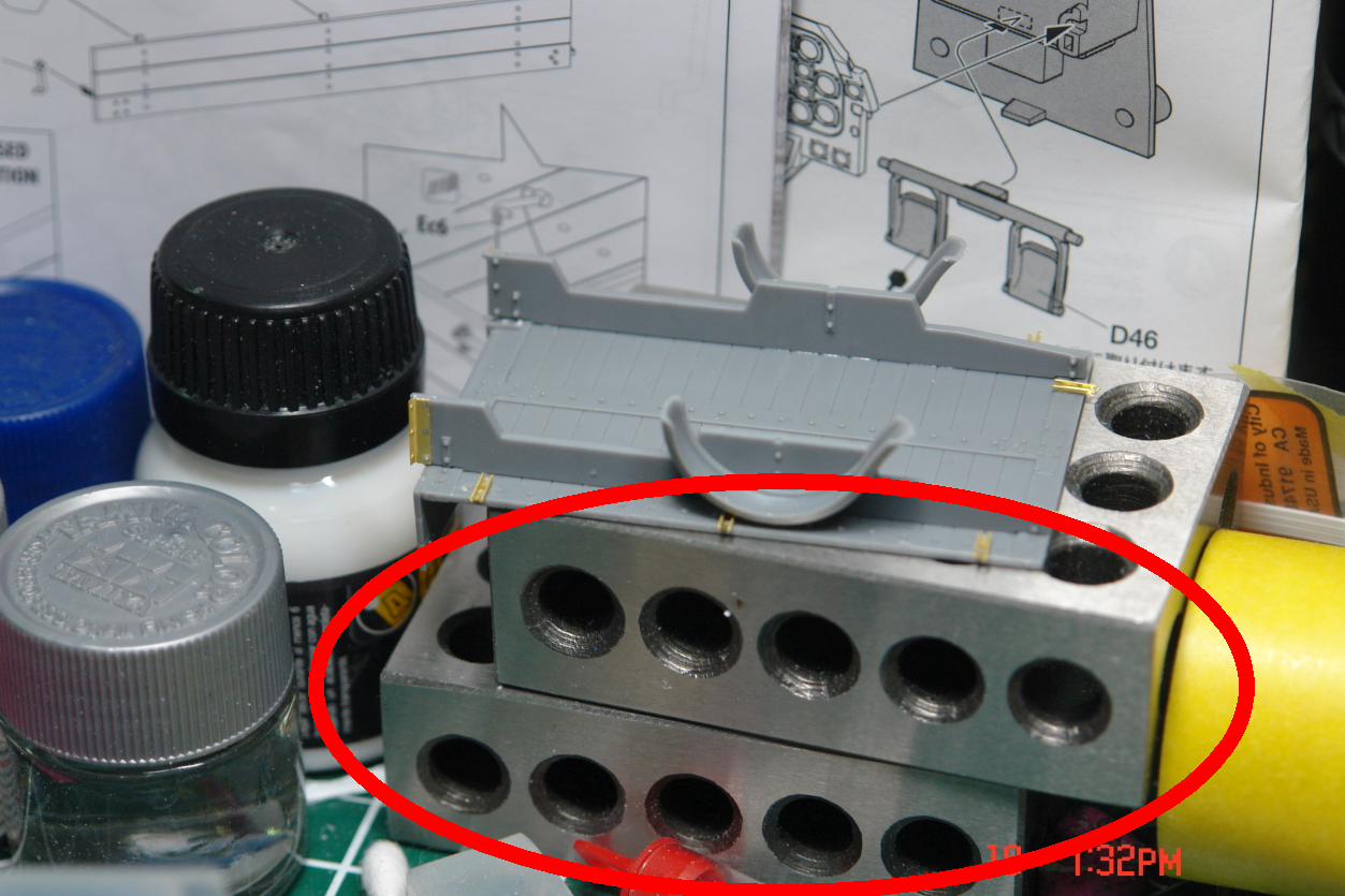

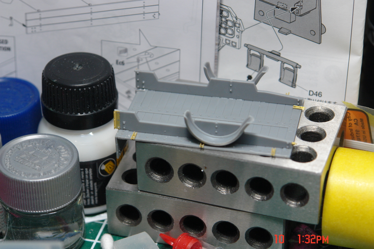

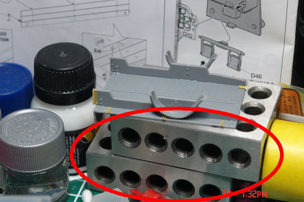

I had something similar to this, without the holes which I used to ensure parts were square. Where did you get these?

I got these from Amazon and am going to buy some more. They are awesome for truing multi part frame and chassis assemblies. I might get a set without holes as well although the holes are very useful. Also great weights when truing the chassis so it doesnt twist while drying.

If anyone doesn't want to follow the links, or wants to look elsewhere, the two blocks are called 1-2-3 blocks. They are proportional 1 thick by 2 wide, by 3 long. That doesn't mean they are exactly 1 inch by 2 inch by 3 inch. I have a set as well but never use them it seems. I have an awesome sine vise that works for me.
