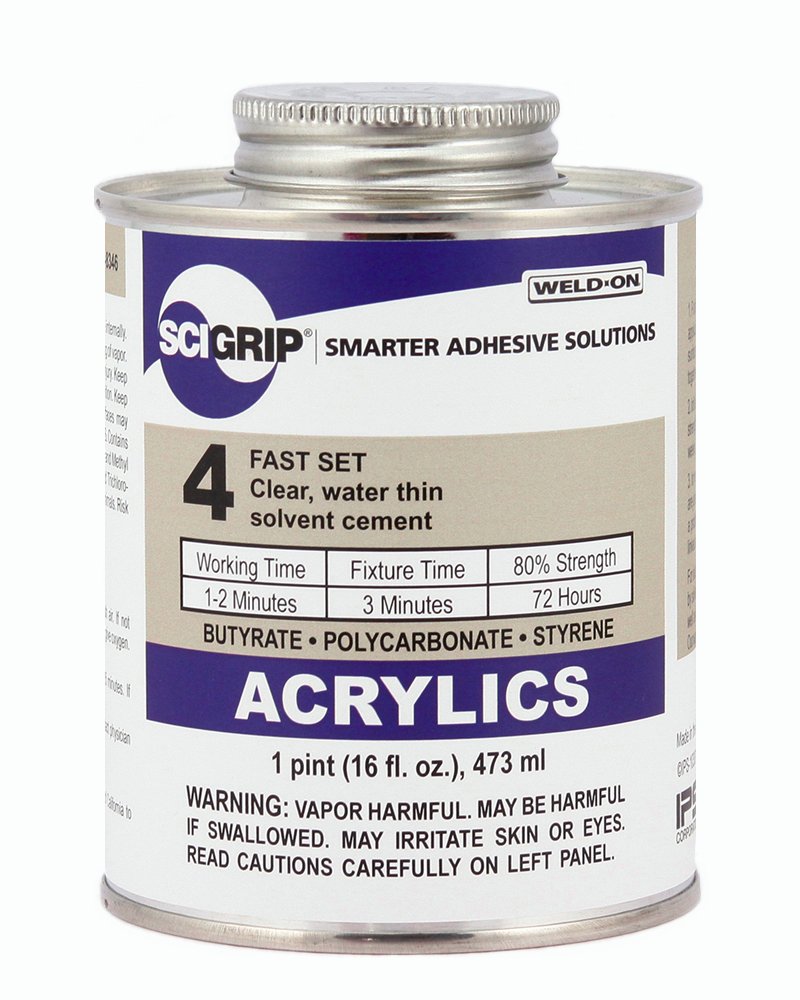

The next product is something a watch maker friend of mine turned me on too last year and I find it a grand substitute for Tenax and Plas-T-Weld.
This stuff comes in all sizes and viscosities. It is just as hot as Tenax and the other but with a 4 oz. can you get almost forever use out of. Scigrip Weld-On #3 very fast set and I mean very fast set. Mine came with an applicator bottle but that bottle is for more of an industrial application.

Good stuff Paul, if someone finds a source on that Weld on 3 other than Amazon let me know.
I just received my tin and was going to post it in Latest Acquisitions. I took the last one since it was less than $12 for a pint! See here (click marketplace and you'll see Amazon is cheapest and Free Shipping if the order is over $35USD):

I just noticed that Paul bought the very fast set while mine is 'only' fast set...
