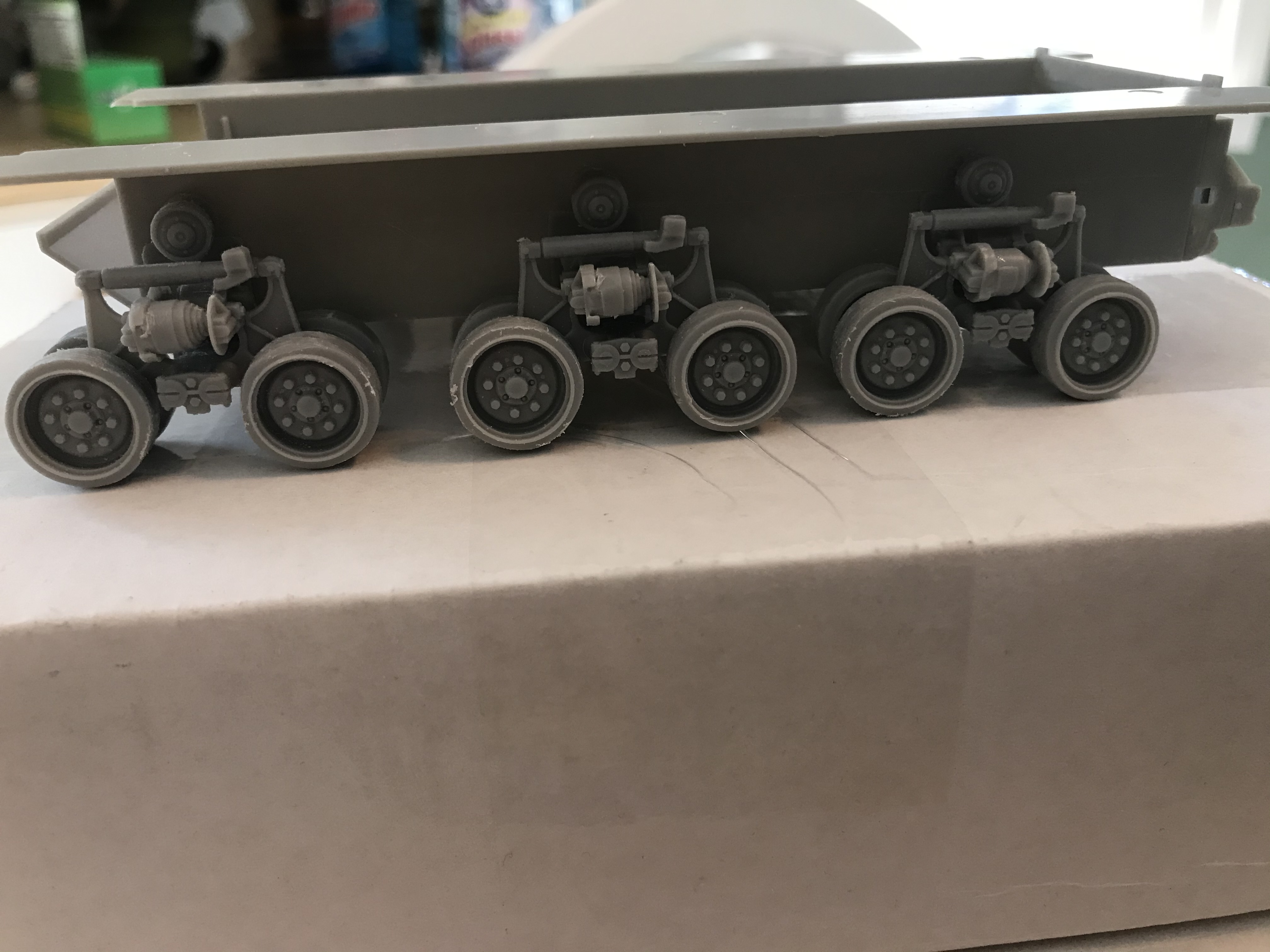

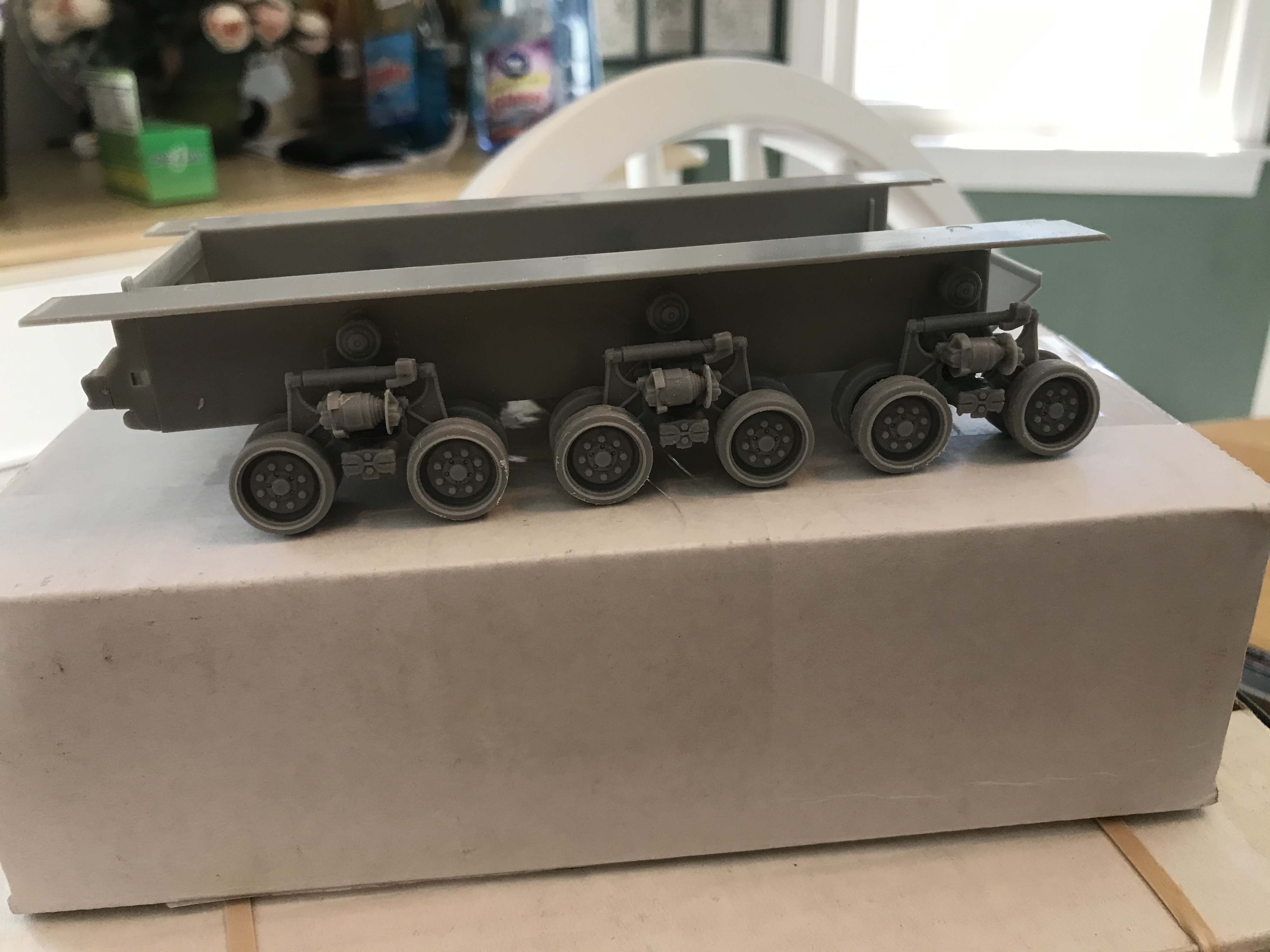

Hoo-Whee is this thing ever a Dragon kit! I had read an article regarding This kit and it’s ‘difficulties’ and am REALLY living it!

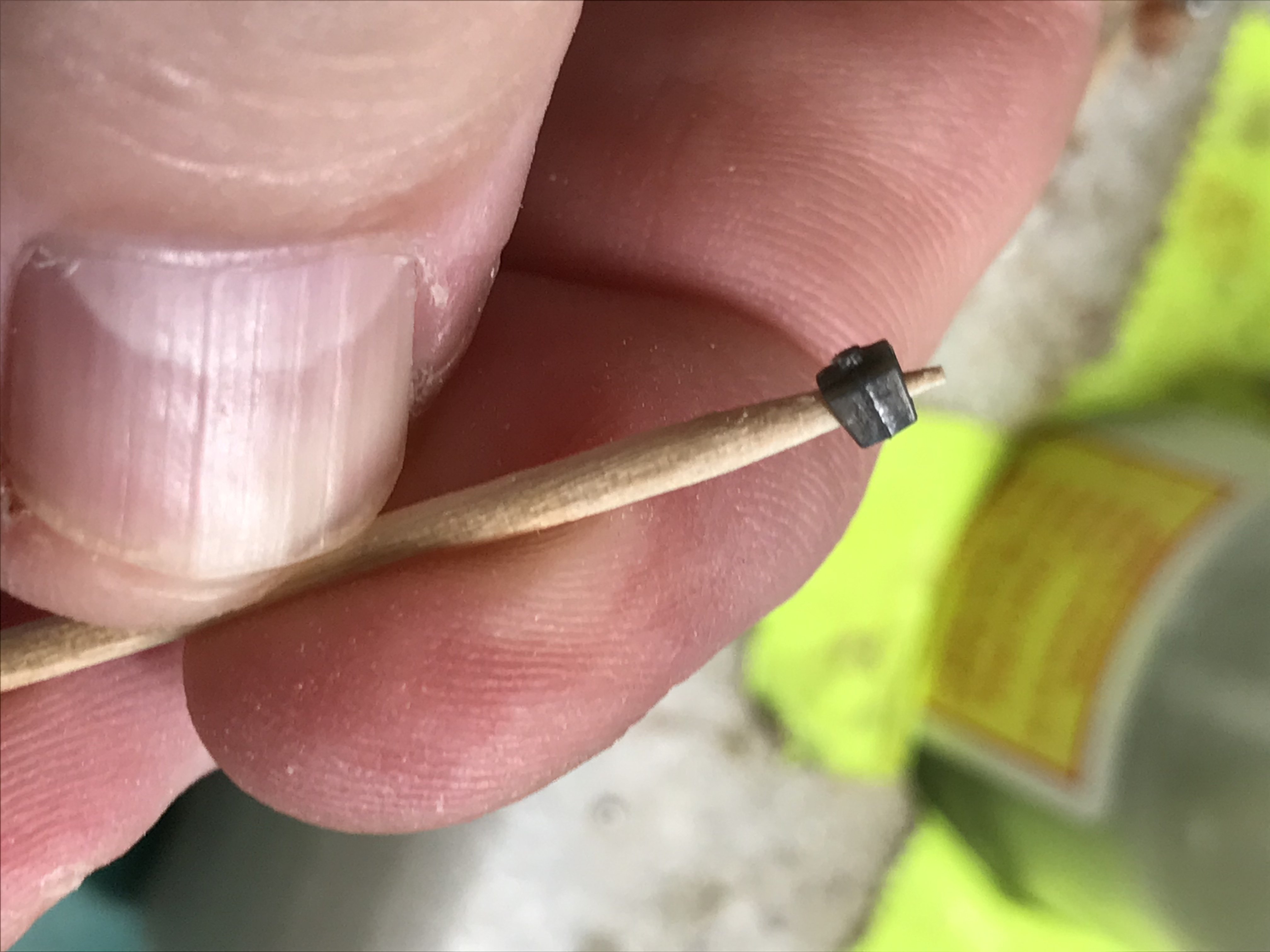

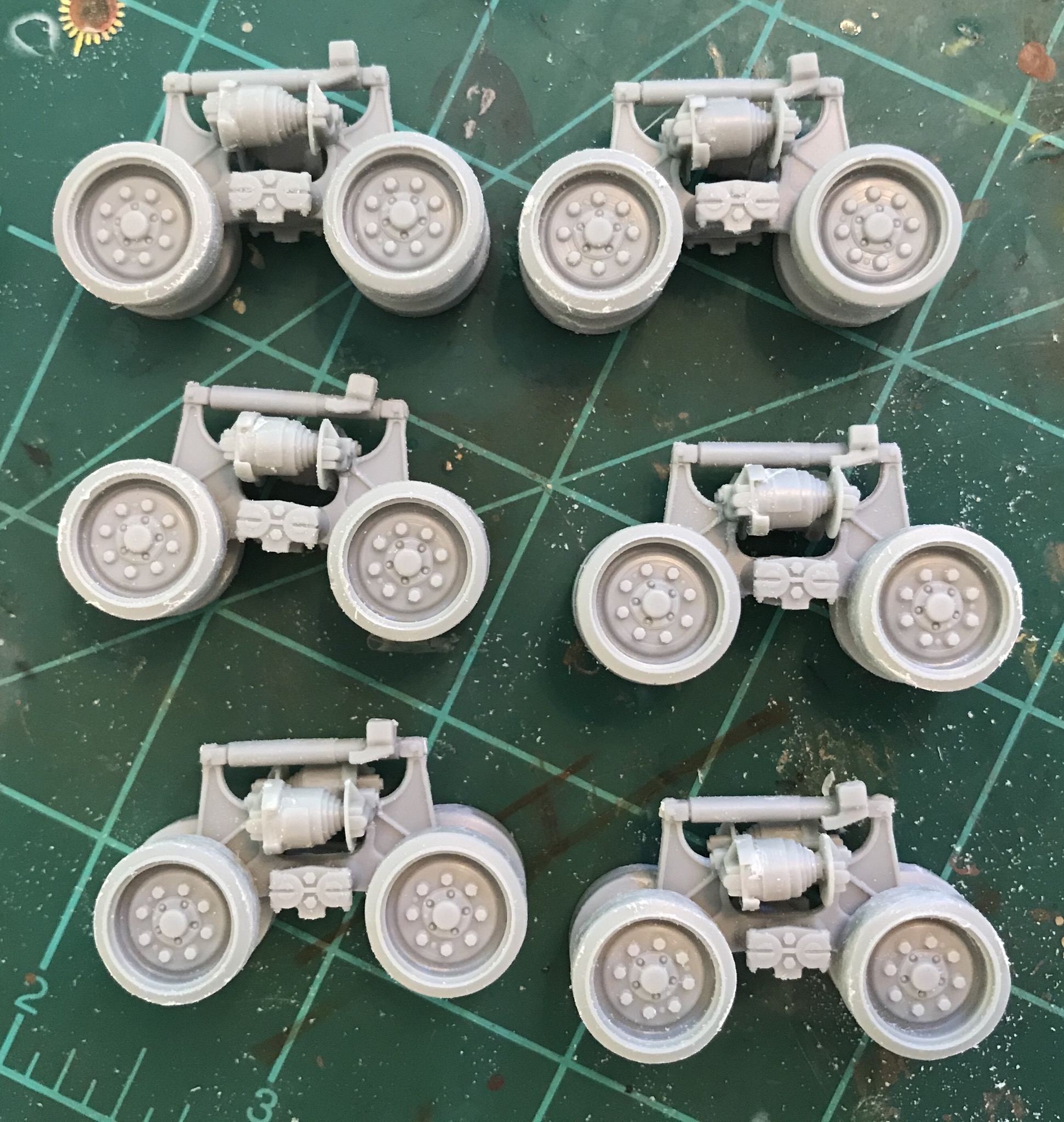

so each HVSS suspension assy is 12-14 parts!

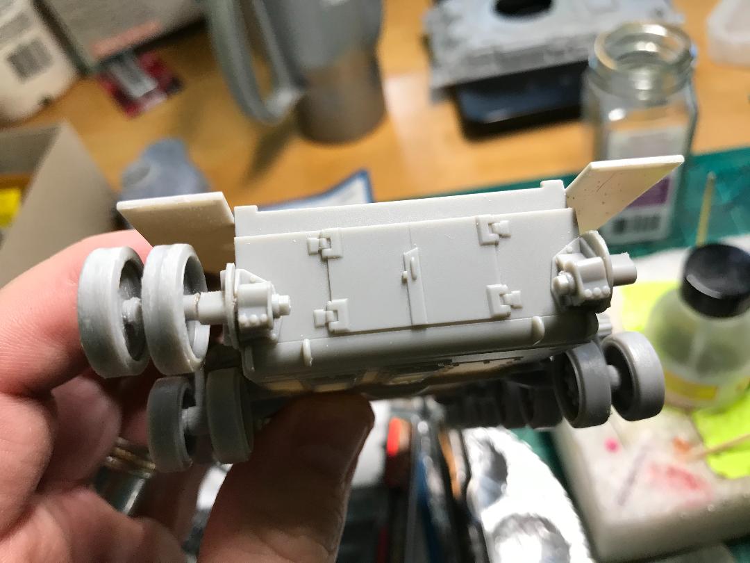

Not only that, but the mounting point for these will not fit without modification. Here it is showing the level of gap before modification
I really don’t have pics, but the mounting points were so small, I had to hand drill holes & install pins, along with a mini-level & a handmade jig. It don’t look like much, but it’s all solid, and even the wheels touch

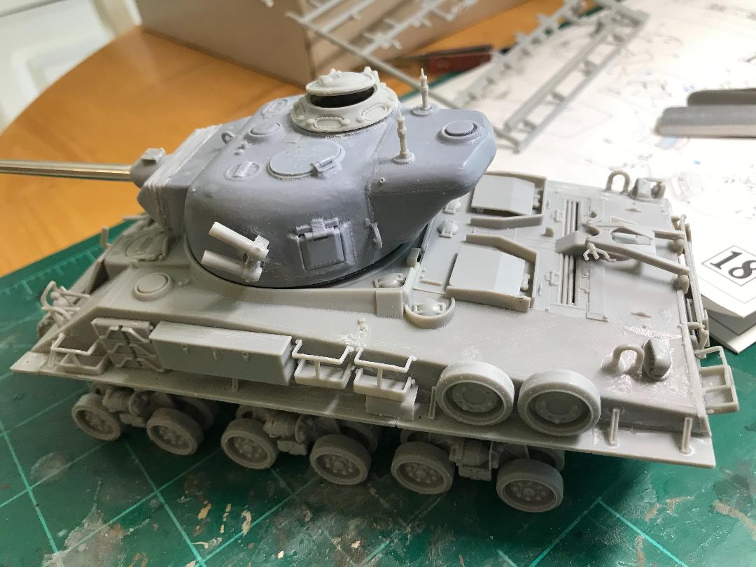

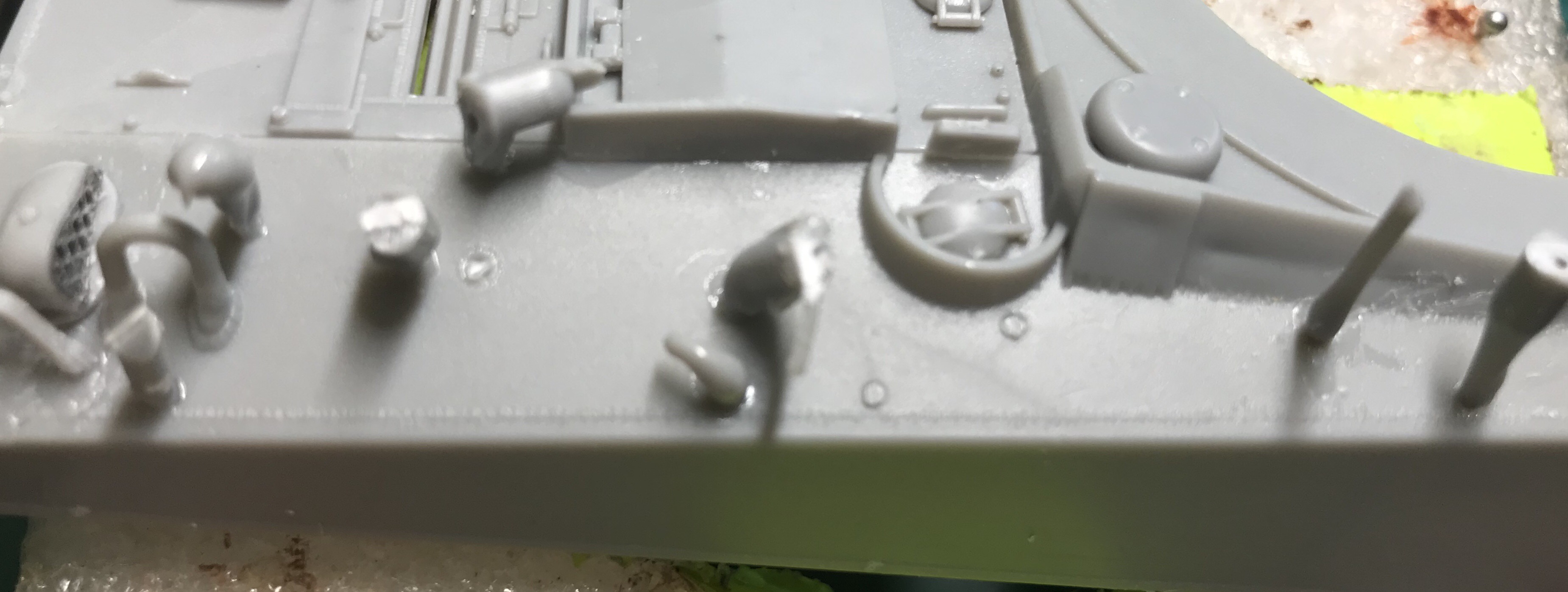

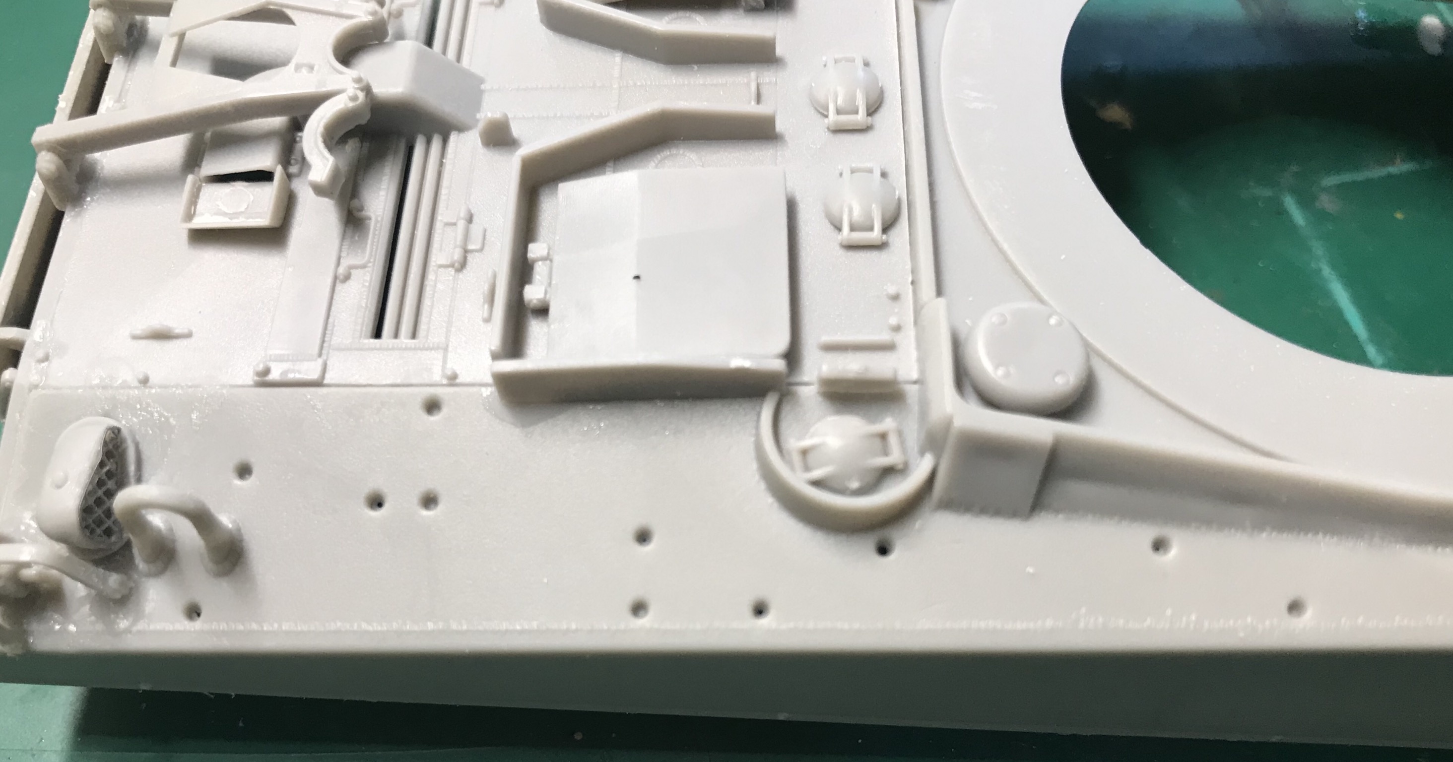

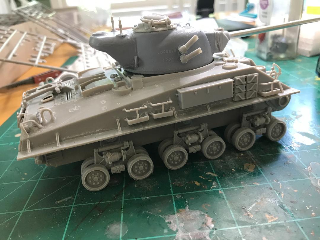

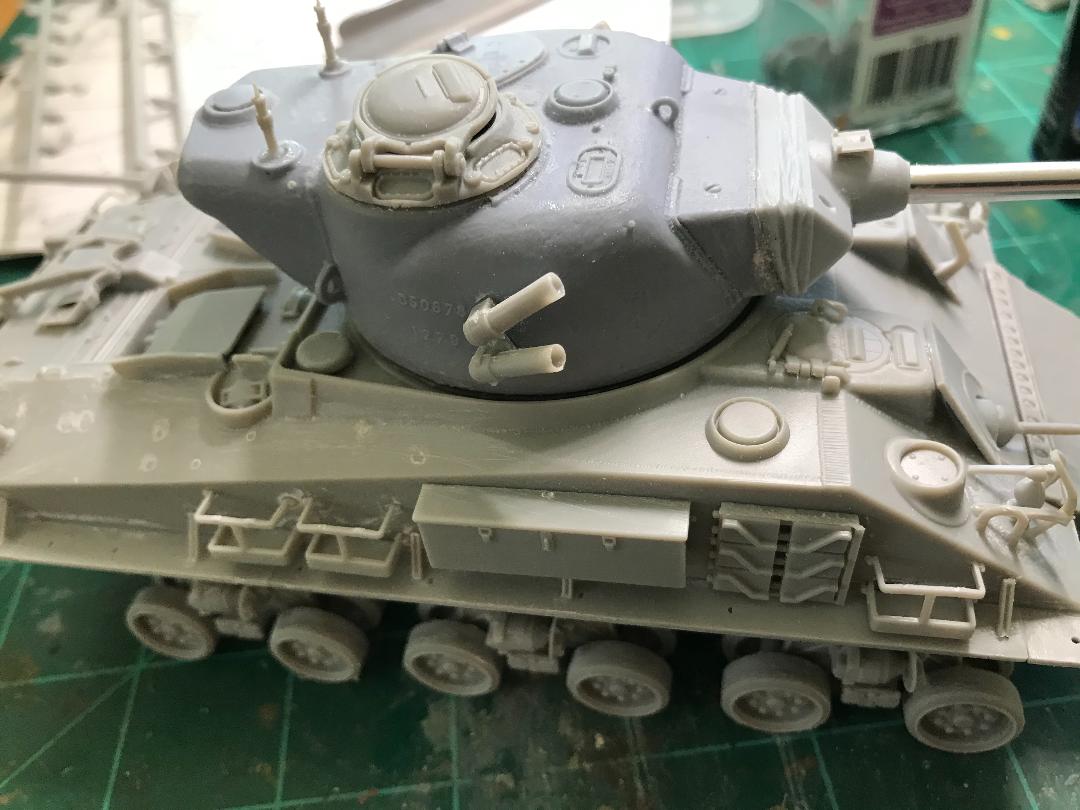

A bit more as of late. I am going with rhe a Lebanese version, even found all the correct paint! To that end, if you look at those pics of the Lebanese tanks, you’ll see that the were supplied with no tools or any of that lot as you would normally find on ‘Shermie’s’ . Issue is, this Dragon kit ha holes all over the Hull for tools, so I had to stretch spruce, sink it in and cut/sand

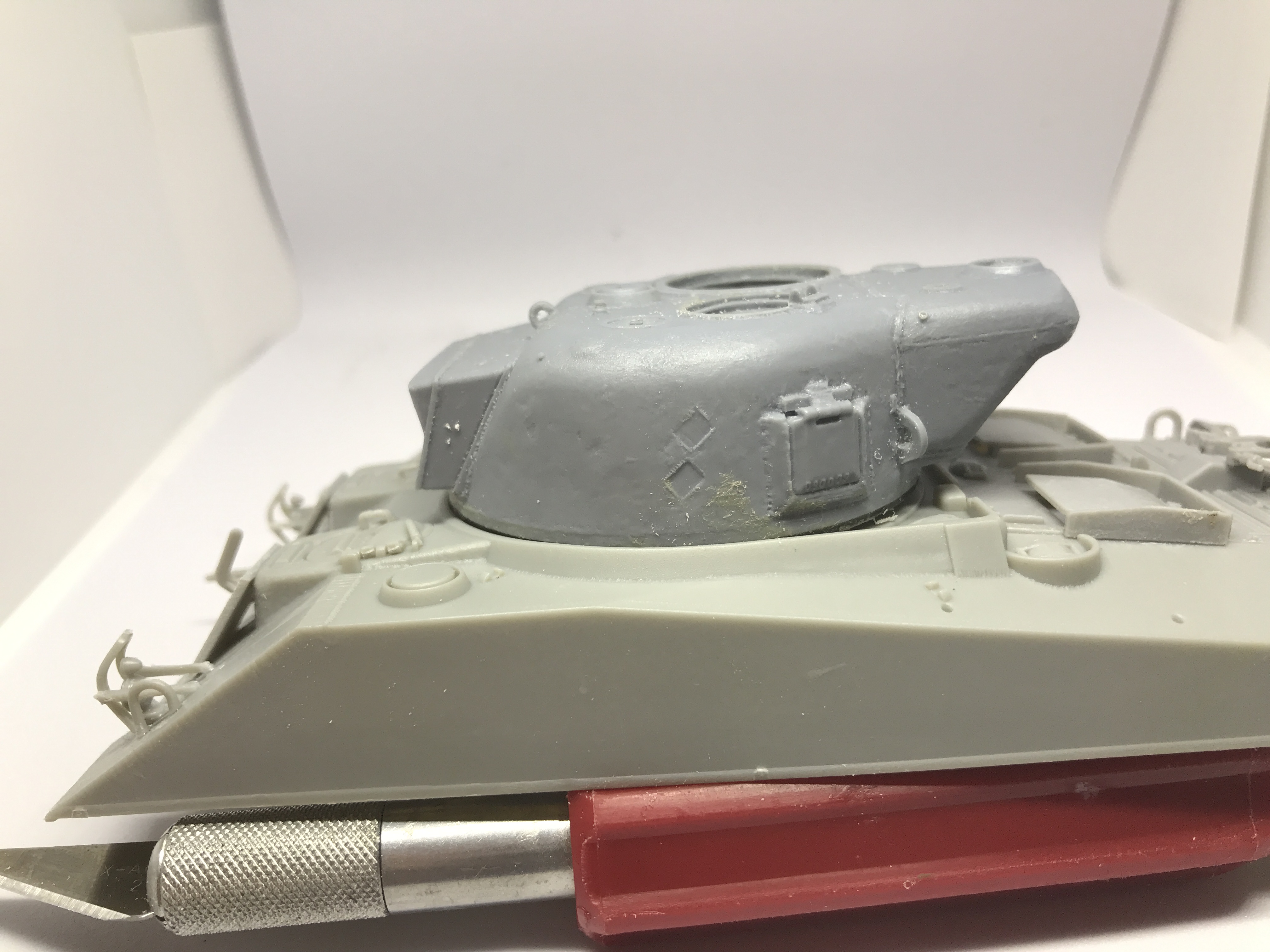

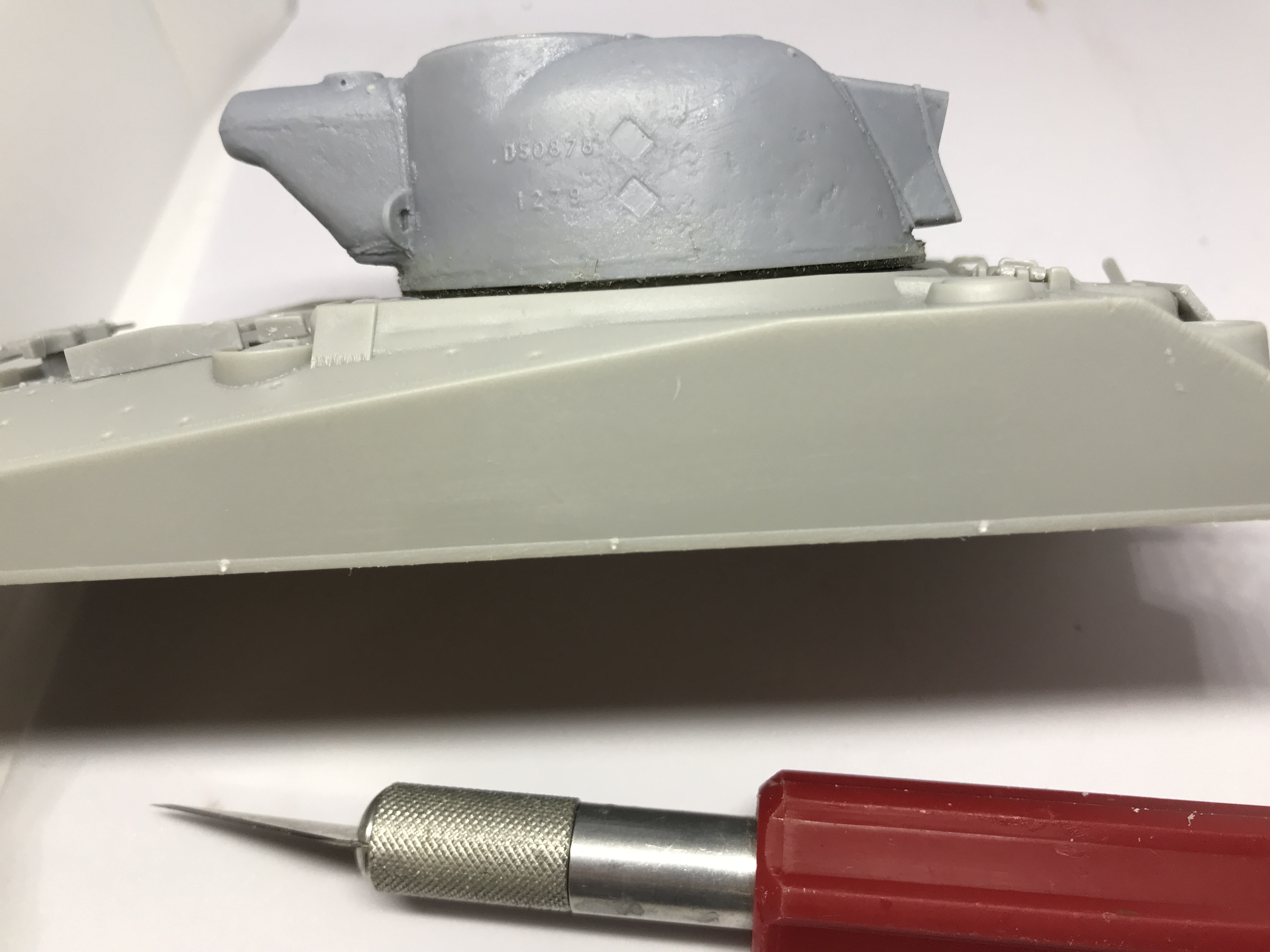

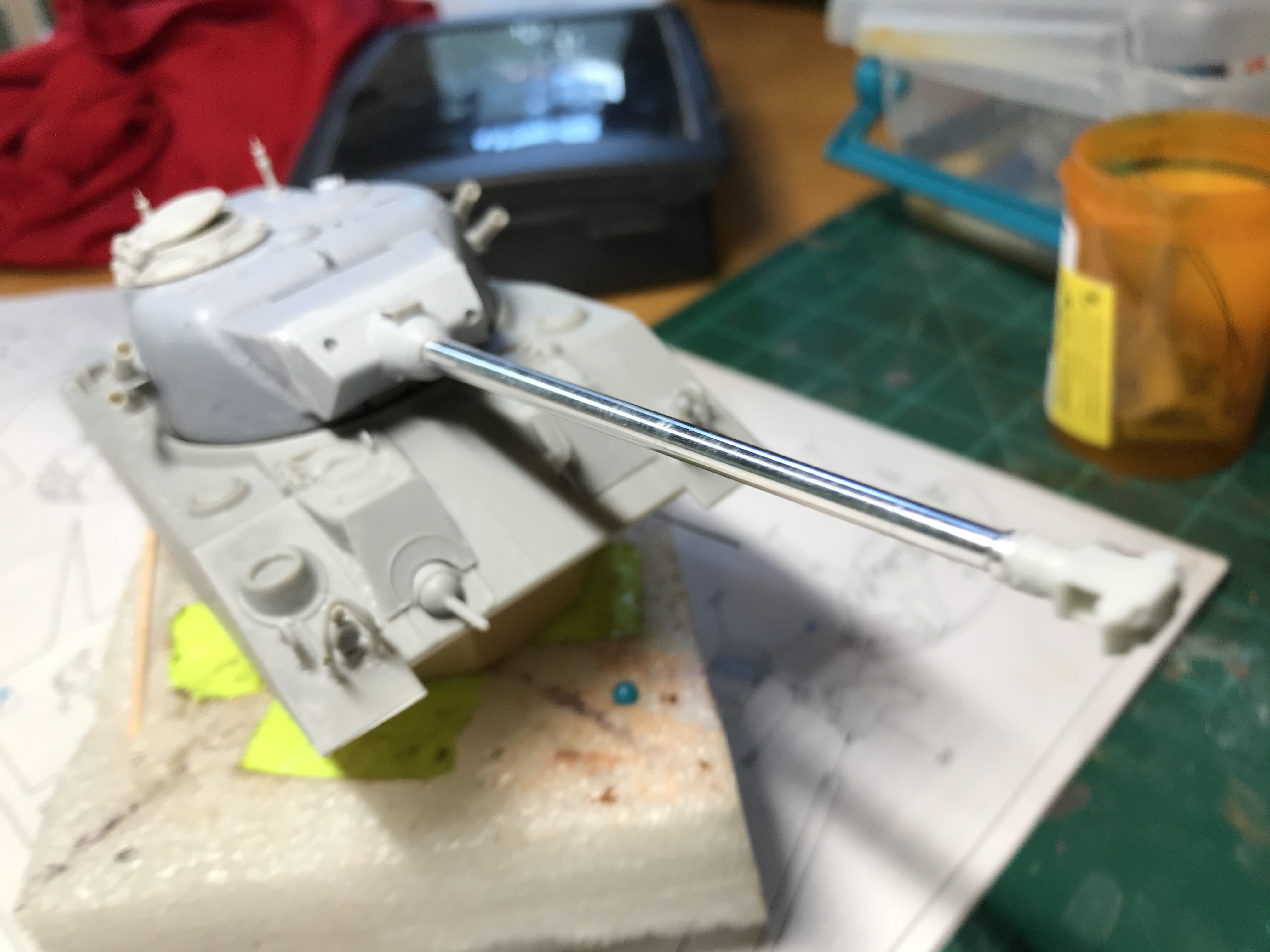

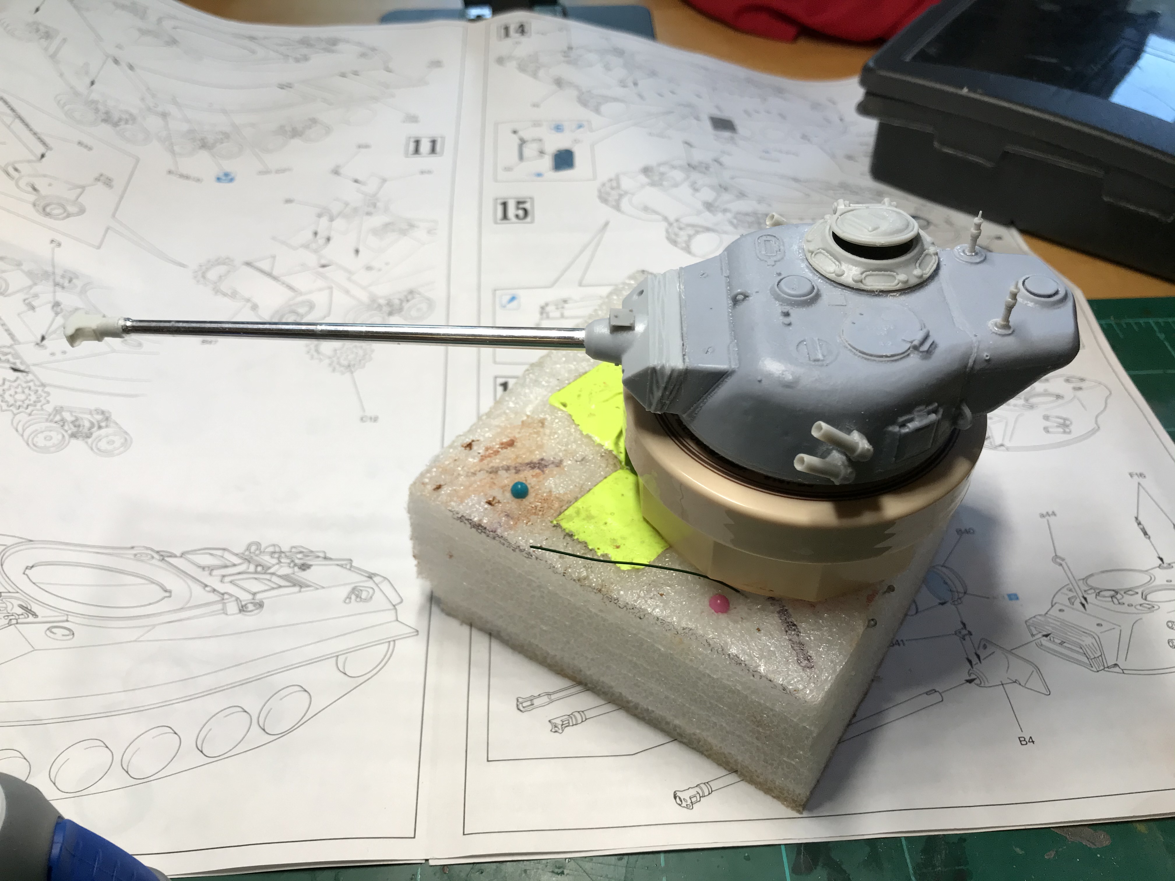

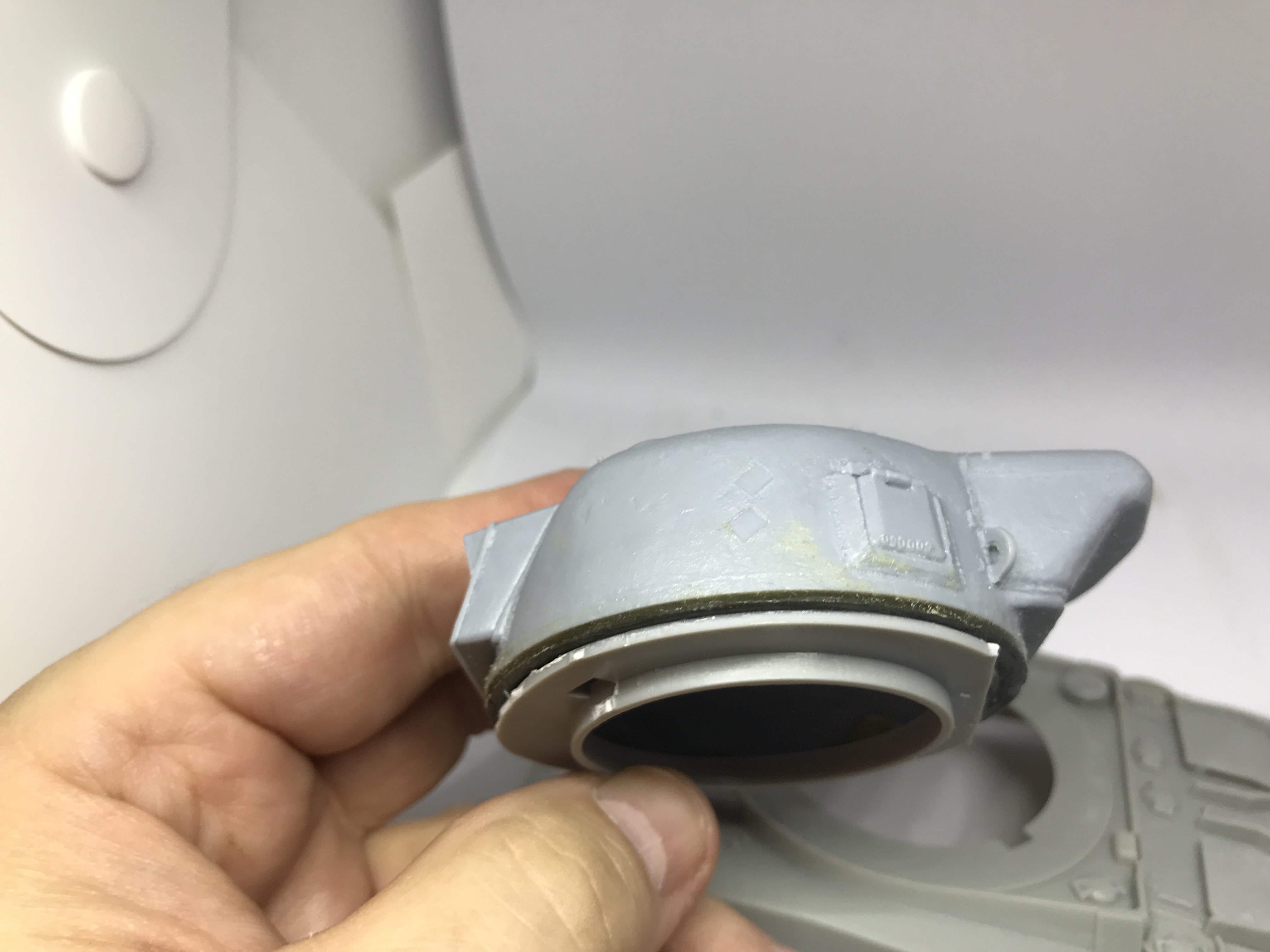

Next up was the Turret. A highly esteemed member here (cough-Eric...cough...) donated a DEF model turret, whose ring had already been modified for a Tamiya kit. I was too high, so I took my hand ol' wood rasp to it and thinned it down, to like paper thing then fitted it, and here is where said turret sits. Note that I have to take off the very top bit

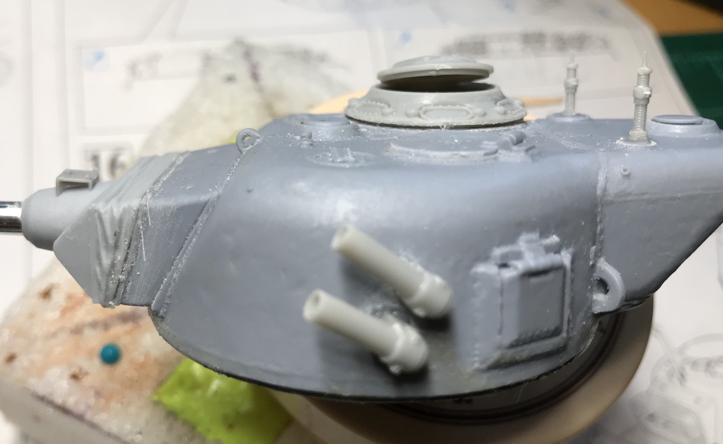

So as you can see the rasp worked really well. There were two versions of this French-designed improved gun, both with & w/out the canvas mantlet cover, but the one in the pic had it (as did most). So I got out the razor saw and removed a small bit of the mantlet and installed it. I have a tiny bit to patch in one side, but I feel good with this. Won’t put much else on the turret till the end as the remaining bits are quite fragile, but again, not bad. I will add that this turret or the Verlinden product is VERY necessary as the kit turret is seriously not shaped right around the turret bustle

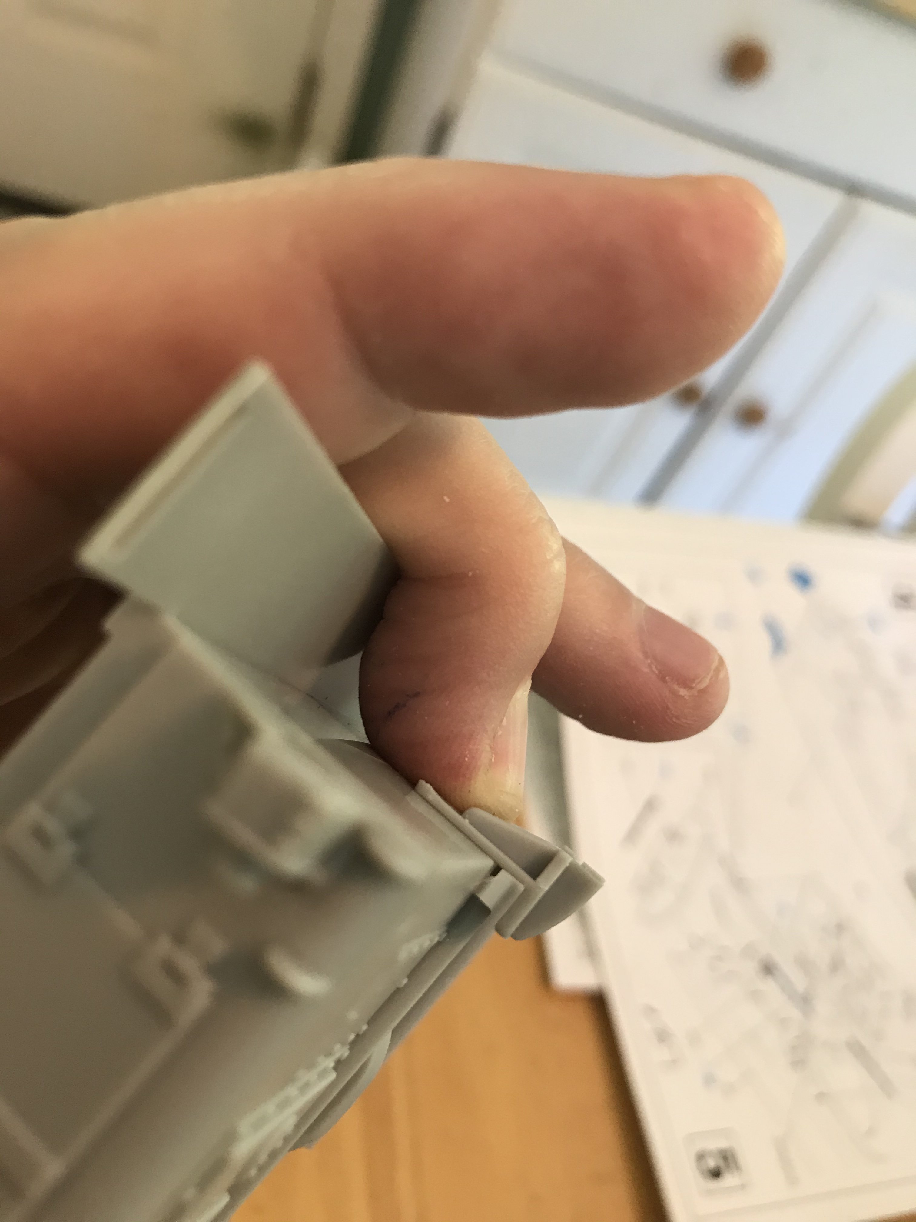

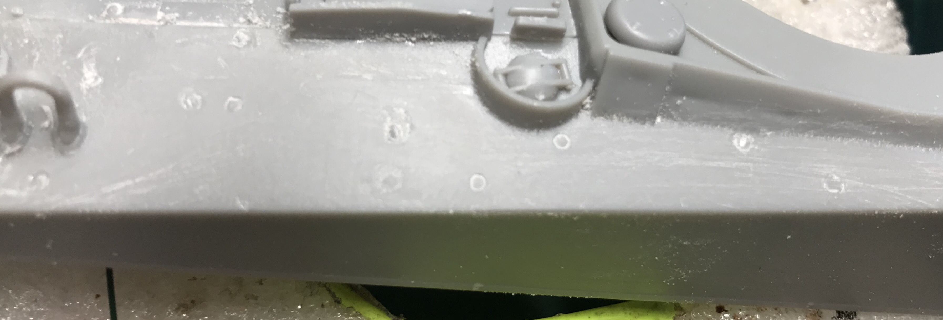

And today was a bit of a frustrating one for this model.

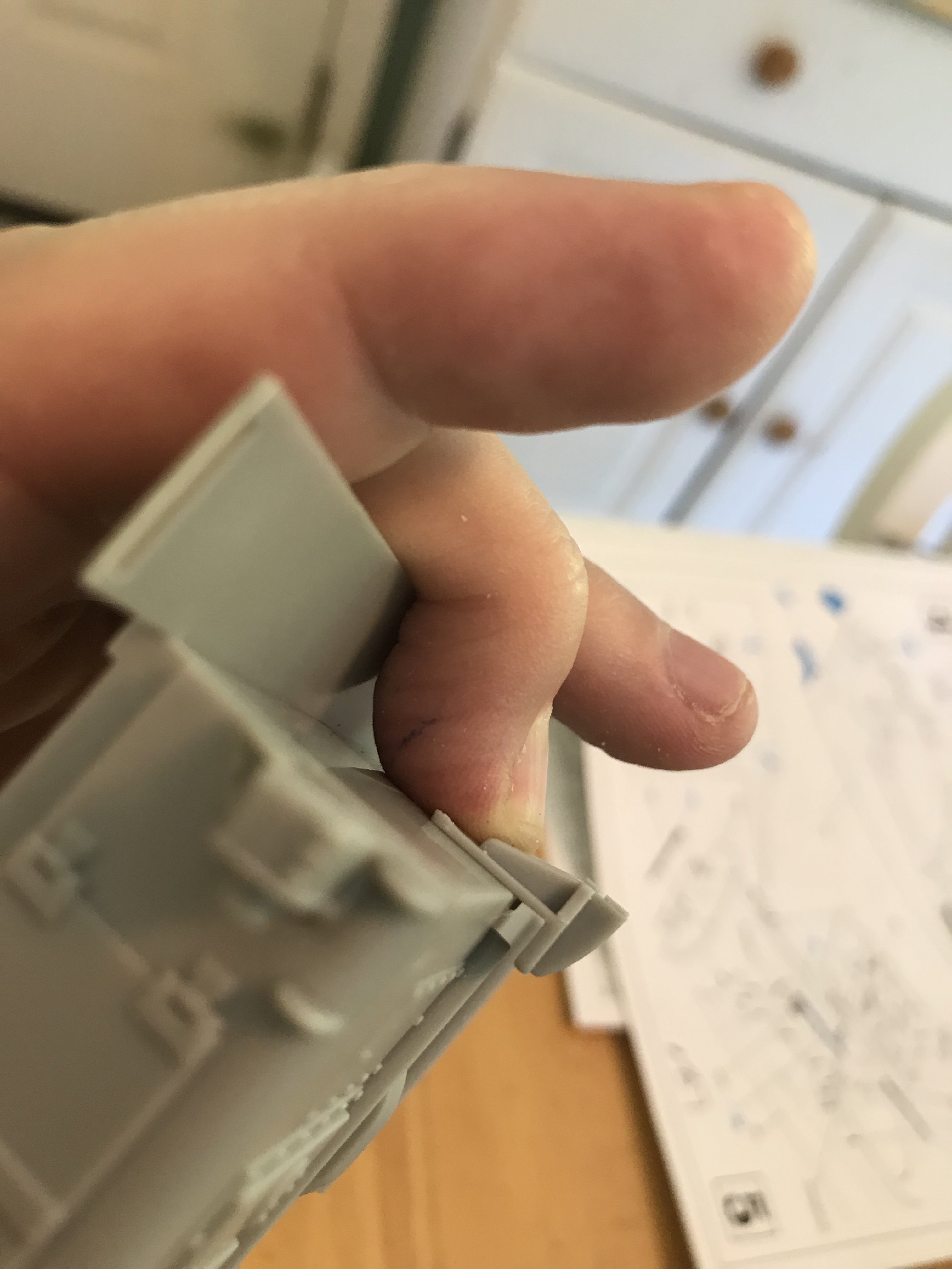

Sinkmarks anyone?
also the tracks proved to be doubly frustrating. The guide horns have big seams and there are pin marks in the main track
So it looks like aftermarkets are in order! So that’s it for today, sorry there’s no better to report

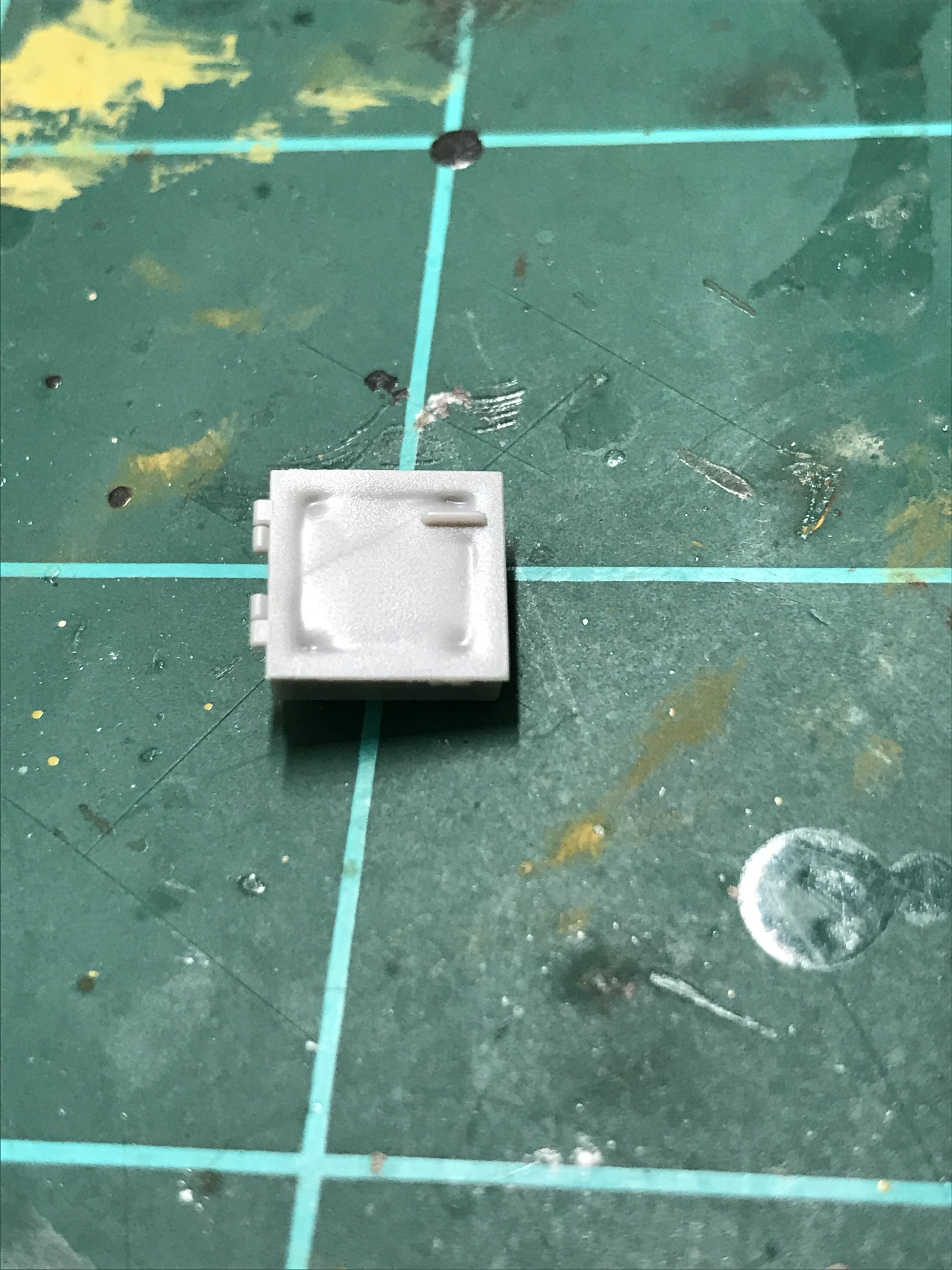

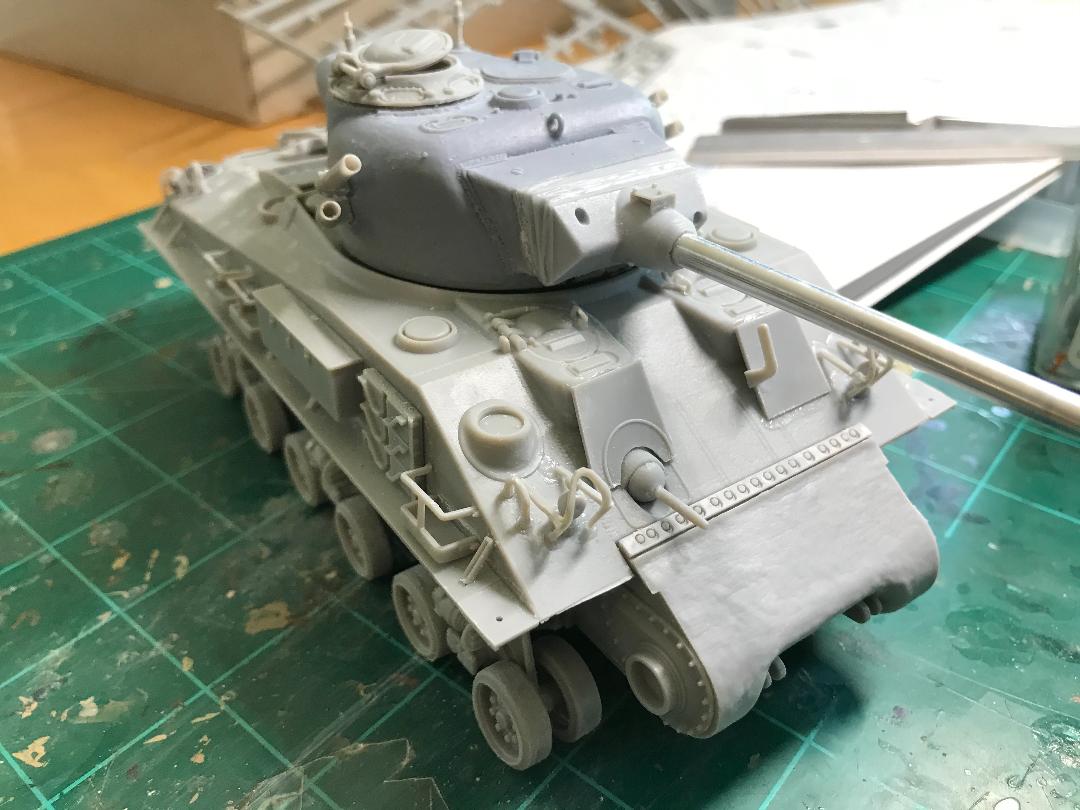

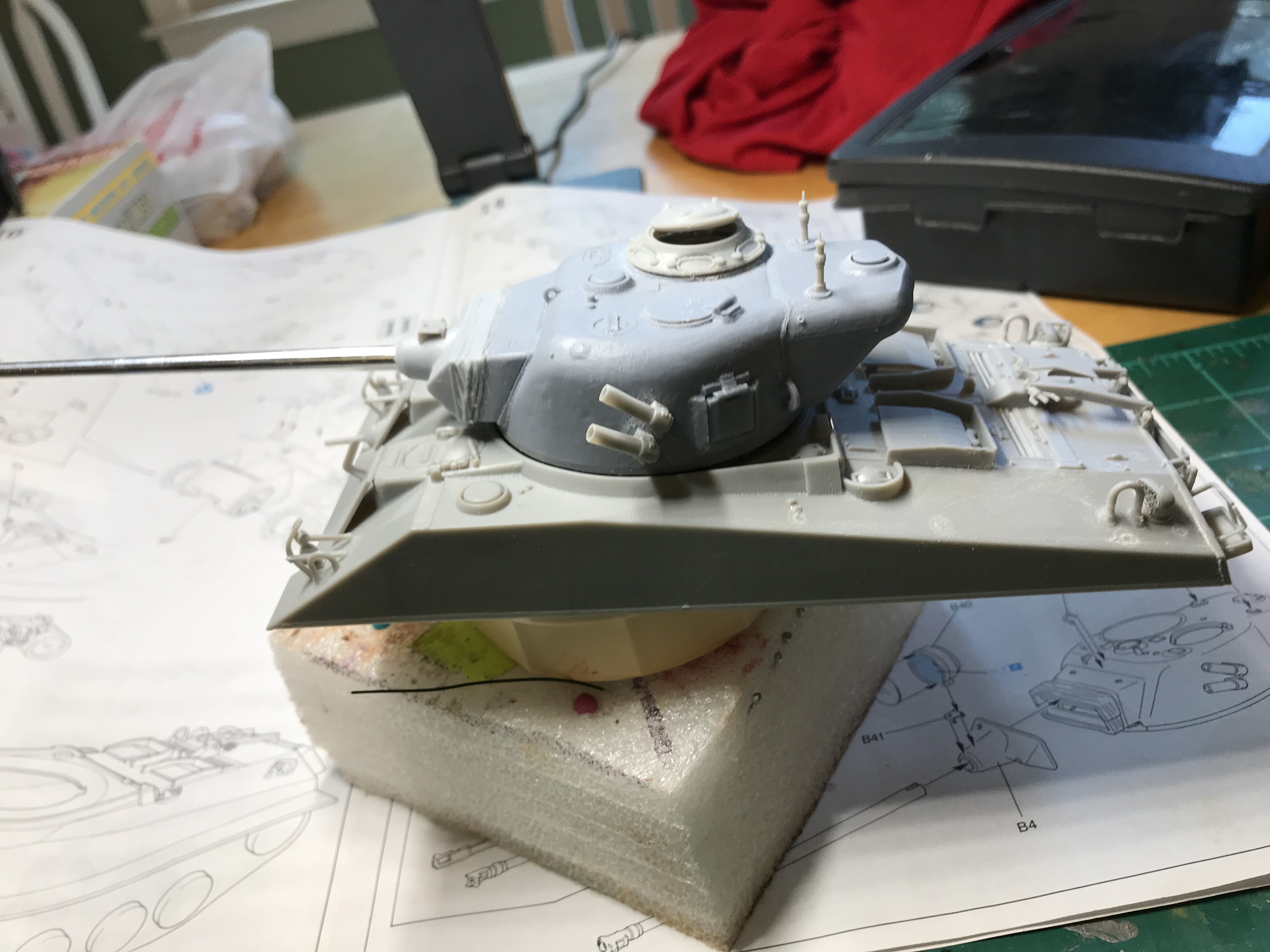

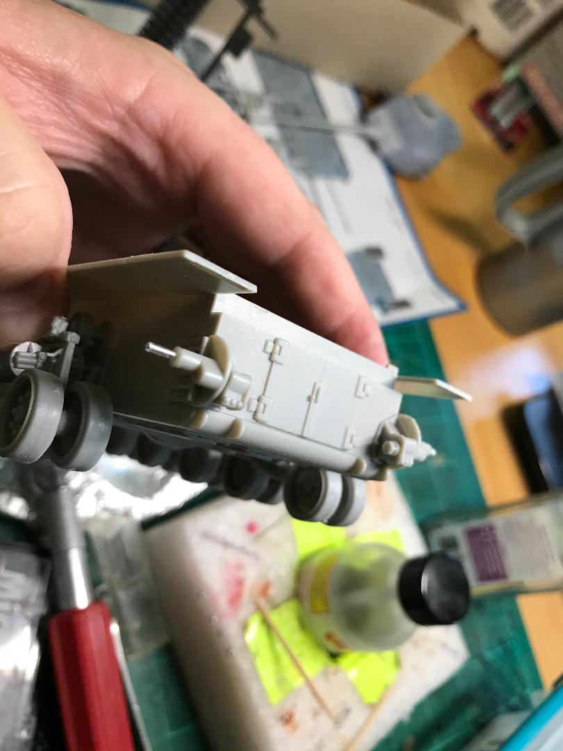

Ok feeling pretty good about today's efforts! So with the exception of needing to fill in some holes in the fender and at the rear where the telephone box should be, it is really looking nice. Here it is just 'setting' together, the upper, lower, & turret are not glued in place. So besides a few empty brackets I am basically I am at a stop-point until the tracks come in and i can get them assembled, but overall looking quite nice I do say!

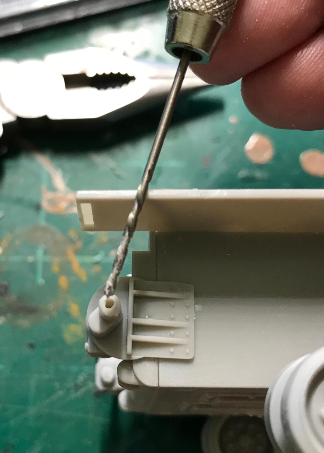

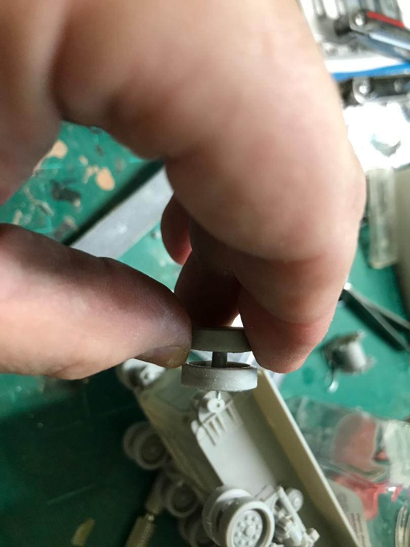

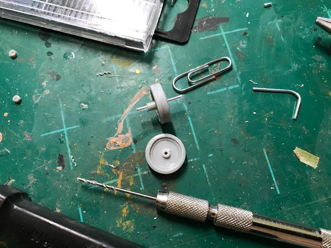

OK so I now have both a seat of Tamiya M51 rubber band tracks plus a set of AFV Resin tracks, so time to get the running gear on this, right? Not so fast. Only Dragon would design this to have no securing pins or any of that on the trailing wheel! So I drill holes & make my own pins, no prob., right?
Not so fast. Note the 'hub' where I installed the pins. Turns out this makes the return wheel stand out waaaaaay to far! So I had pull the pins back out, and do surgery. Note how much of the hub is gone (Hint: try ALL of it)
But hey, at least it all lines up now! So then I had to re-drill the holes. Also, the two wheels themselves basically fell apart when I tried to drill out one part just a tad, so I took them apart, drilled more, and made a long pin that goes thru both wheels and into the 'hub,' or whats left of it. Came out nice but man is thing ever some work.
