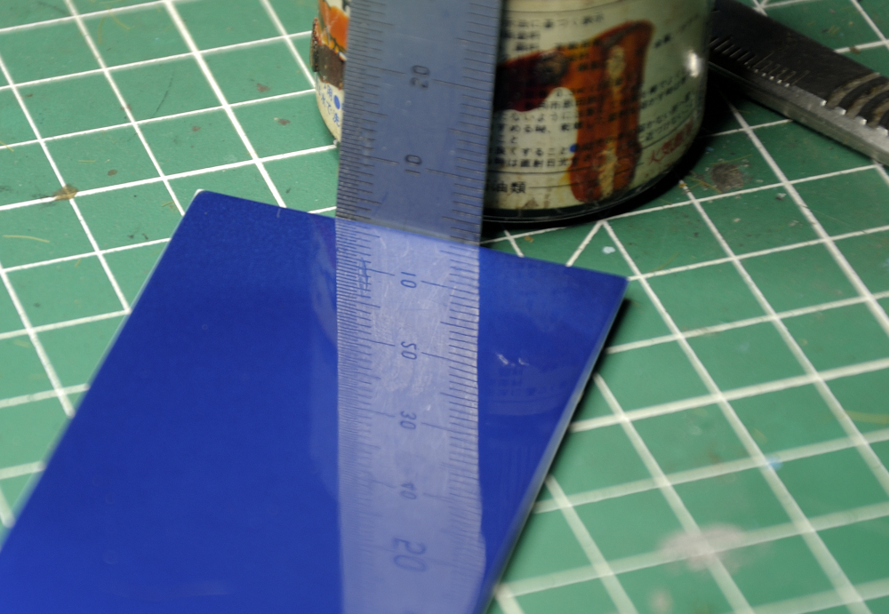

I think i have made my mind up about Paint for the Jag
This is Mica Blue TS-50. with a couple of clear coats. The secret with this stuff is it takes an hour to dry but a further week minimum to go hard and you cant even think about polishing a finish before that.
When it eventually goes hard it is pretty hard.
