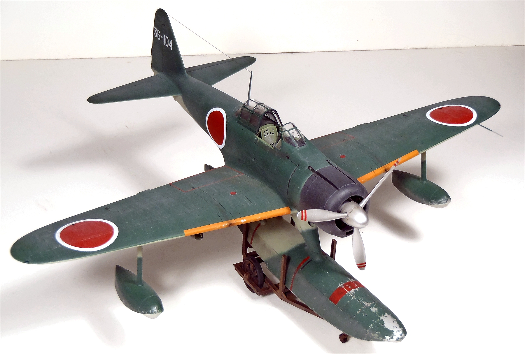

I use future over a silver base coat instead of hair spray along with a home made masking mixture of white glue, liquid soap with a little food coloring. then apply salt. Gary S.

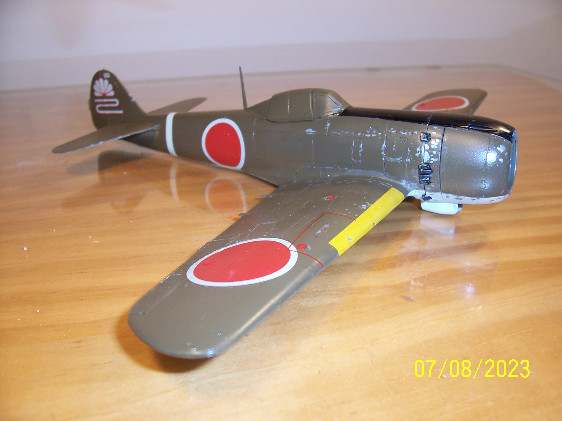

I've always been happy with Tamiya Titanium silver base, a couple of coats of Treseme hair spray (applied with an airbrush) and then the camo. Chipped with dampening small areas, and chipped with a sharpened toothpick, on the point of a #11 blade. Overcoated with Future, flat spray.
