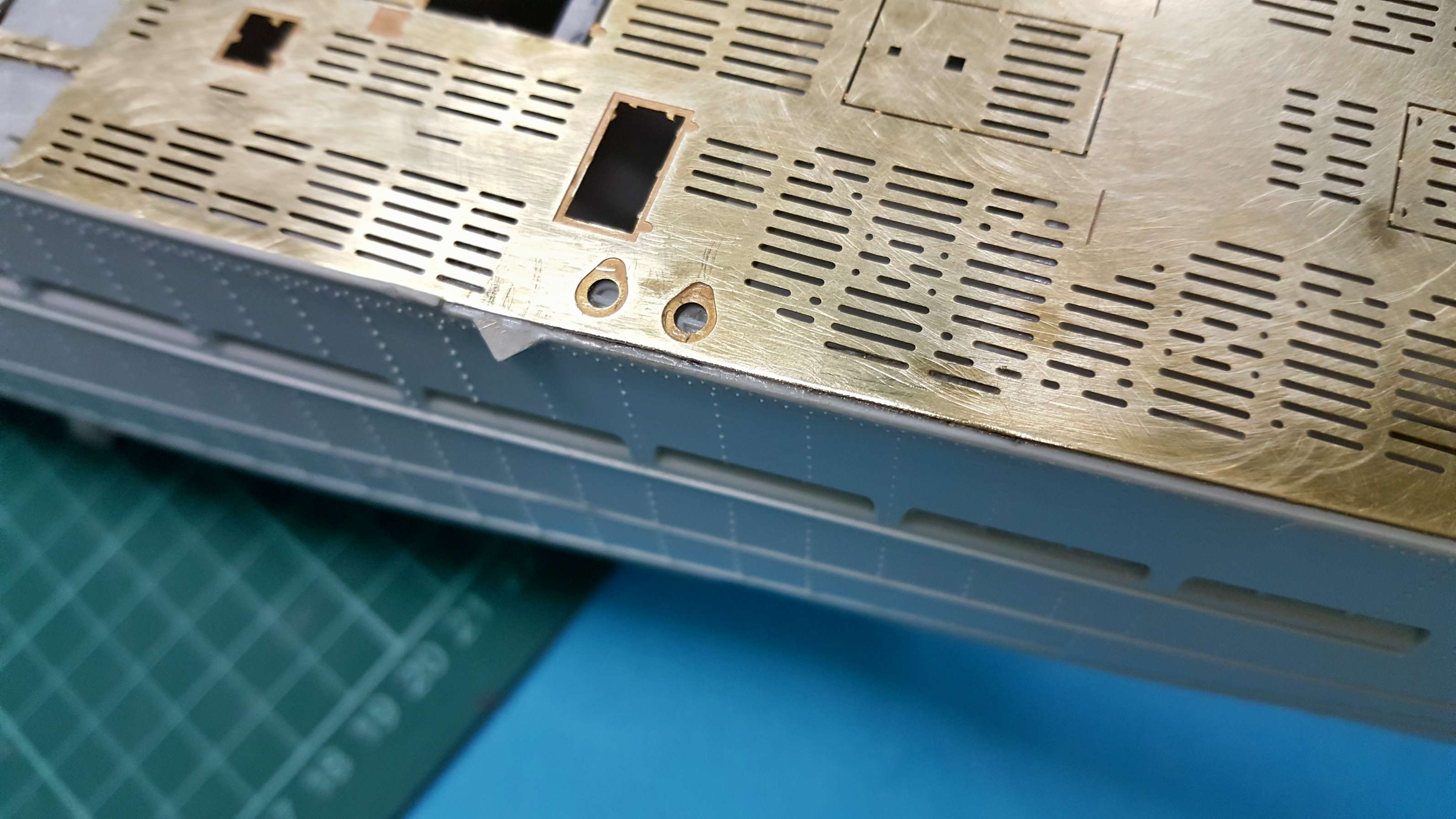

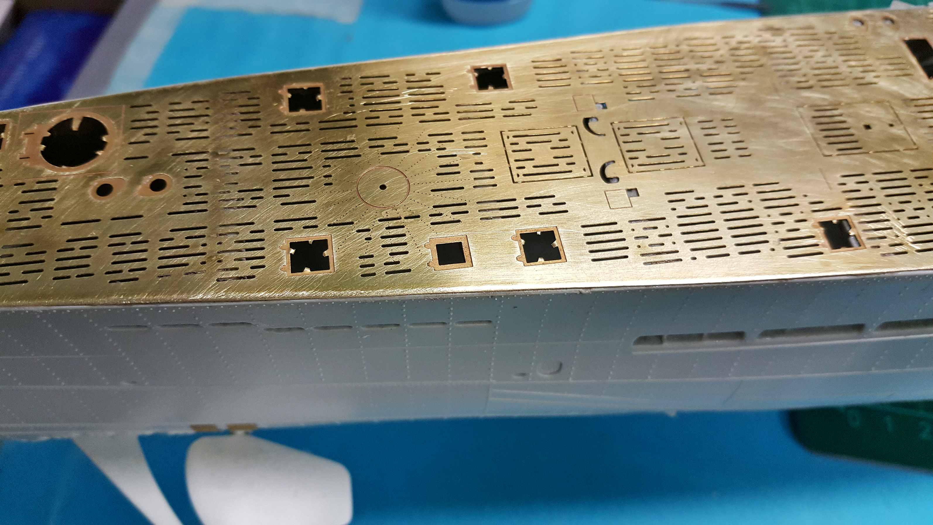

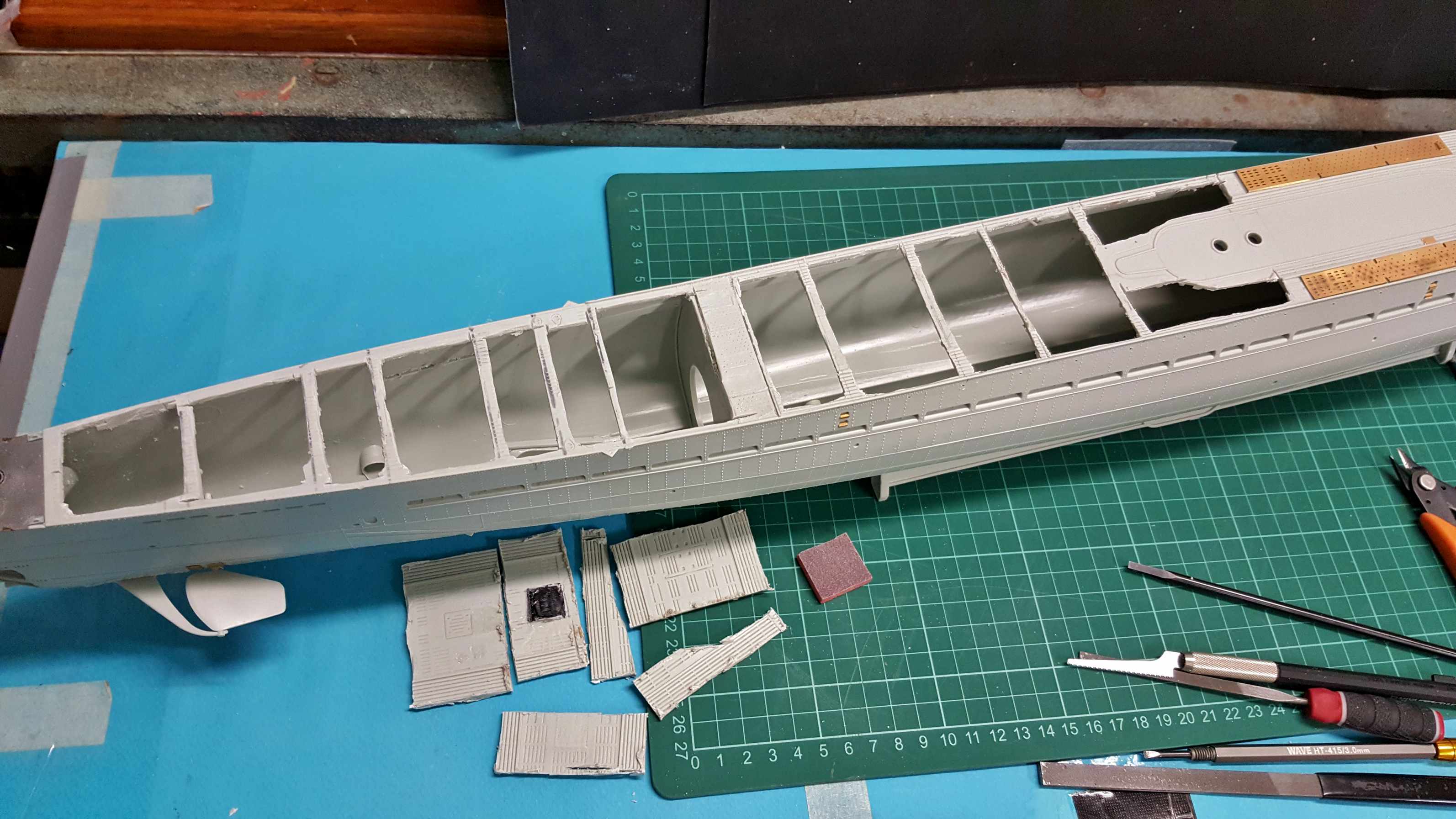

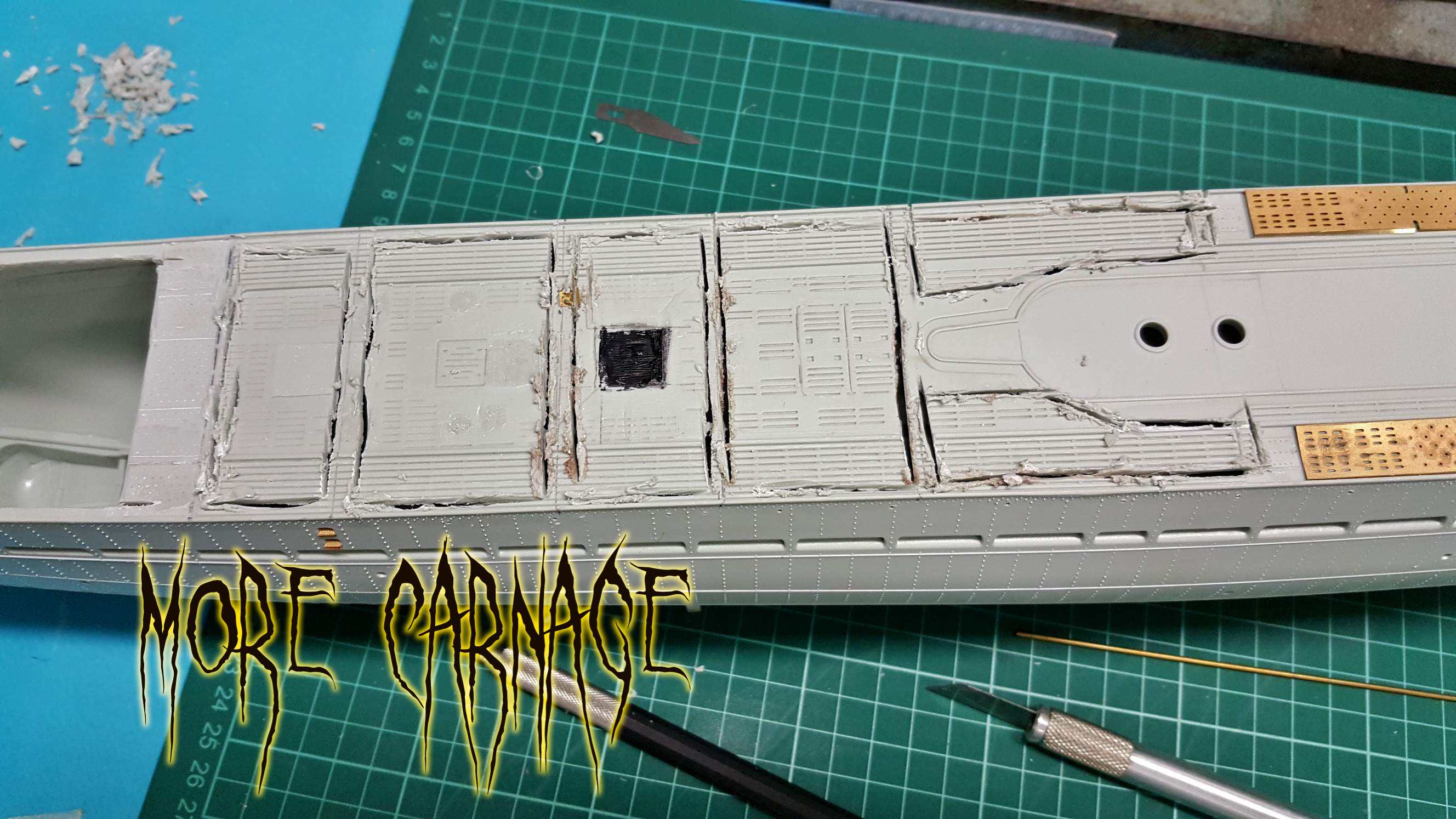

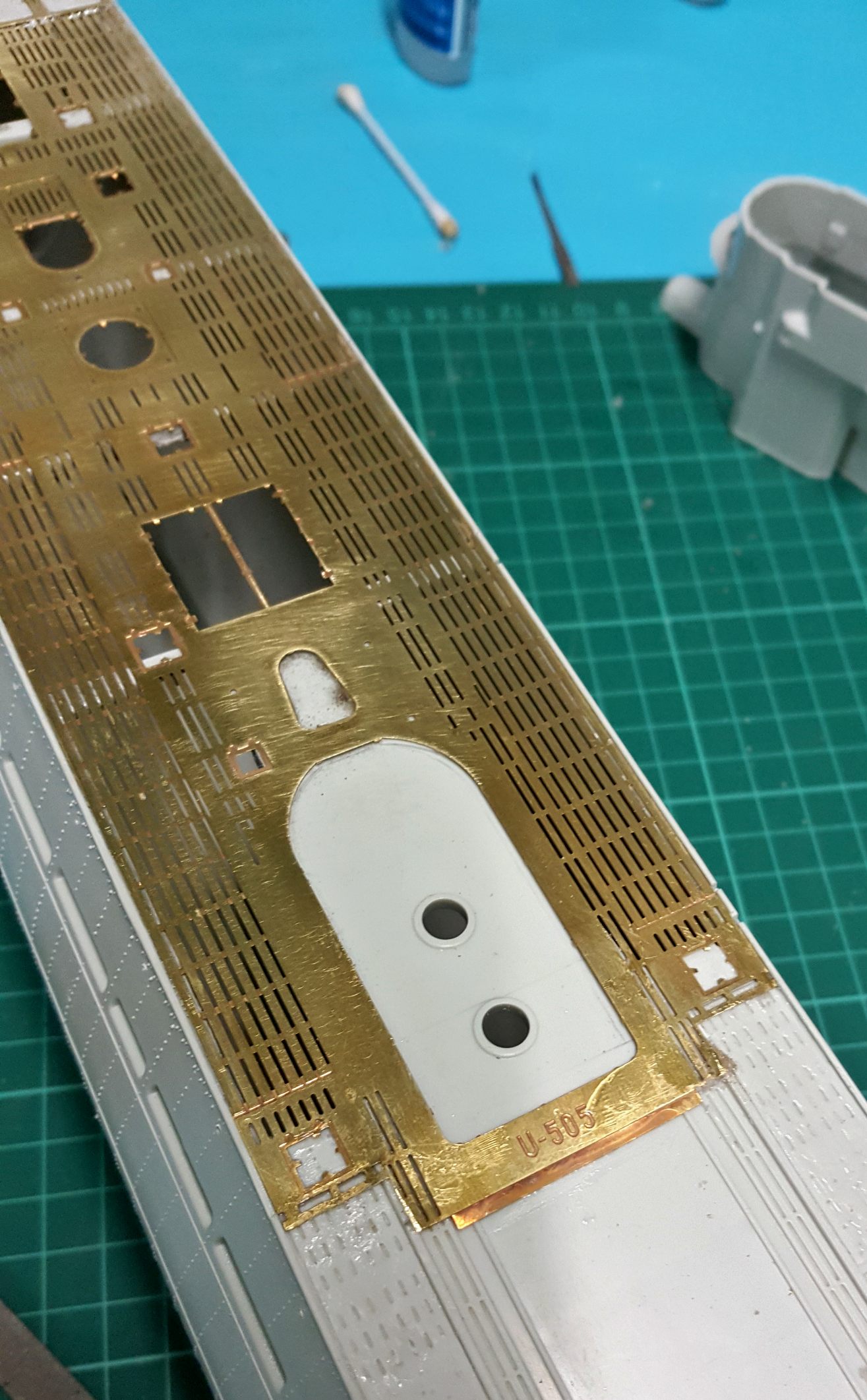

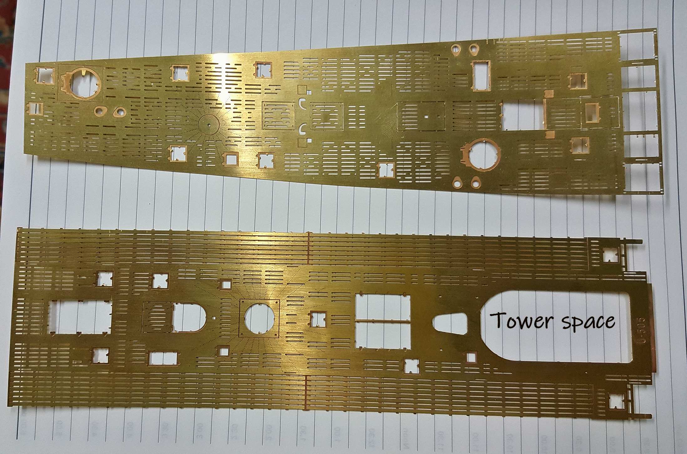

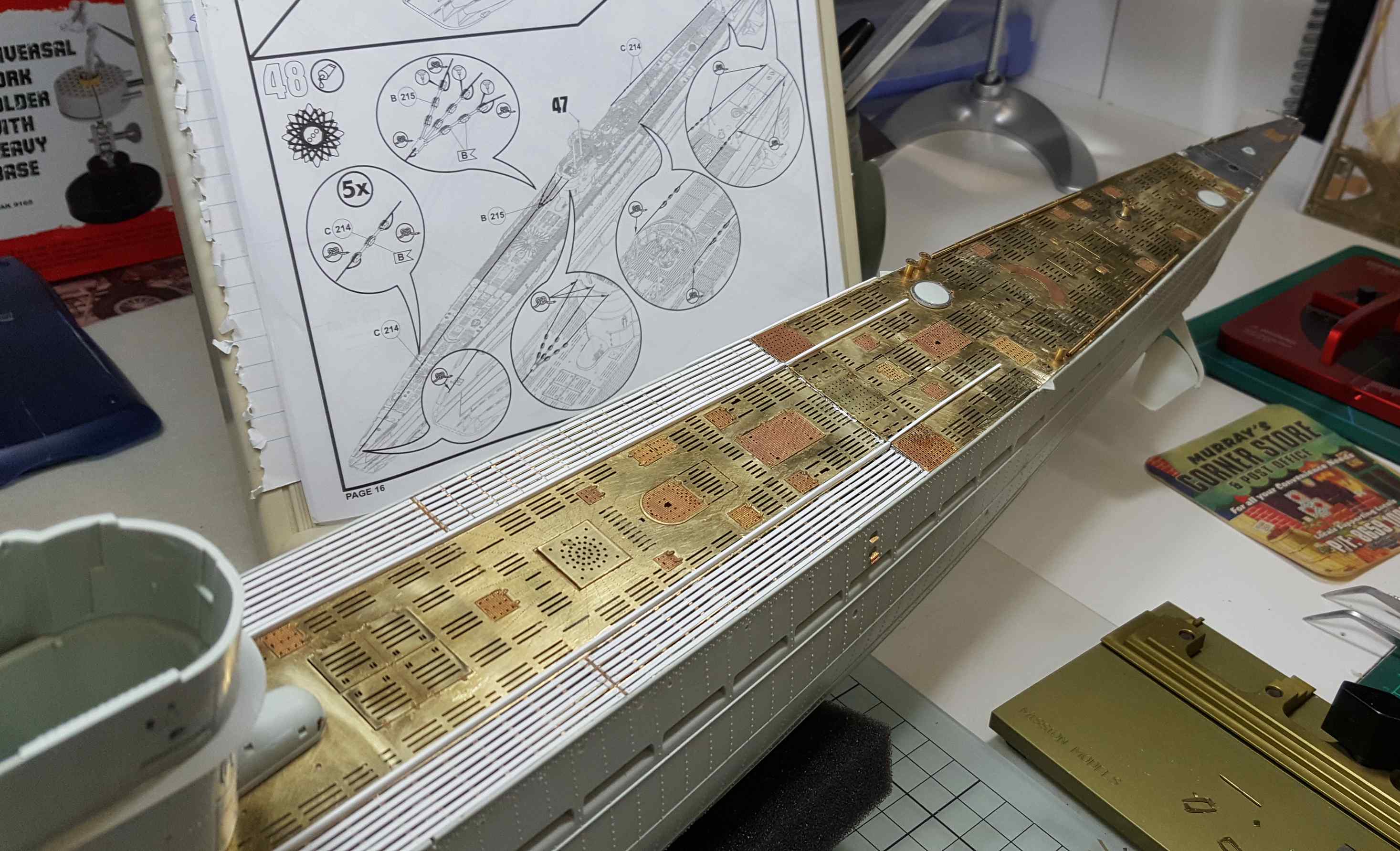

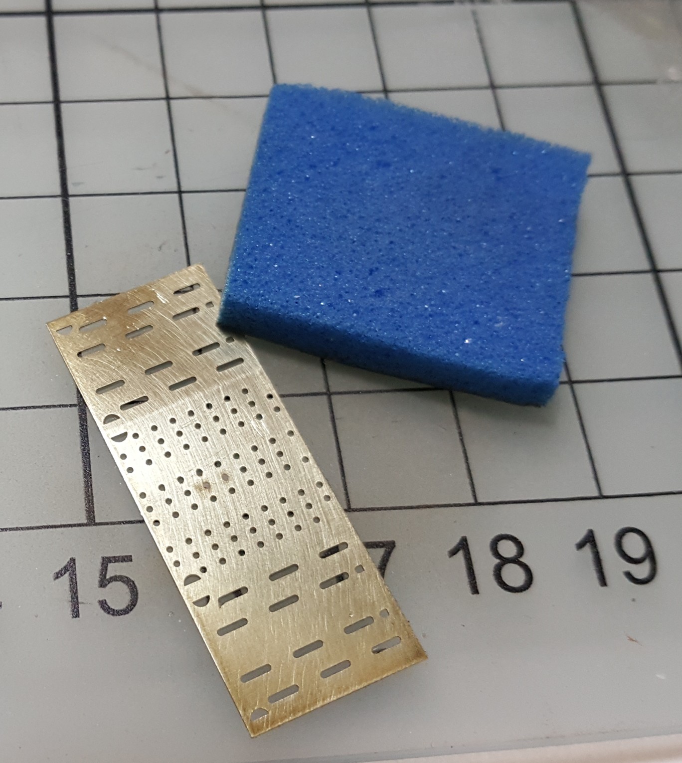

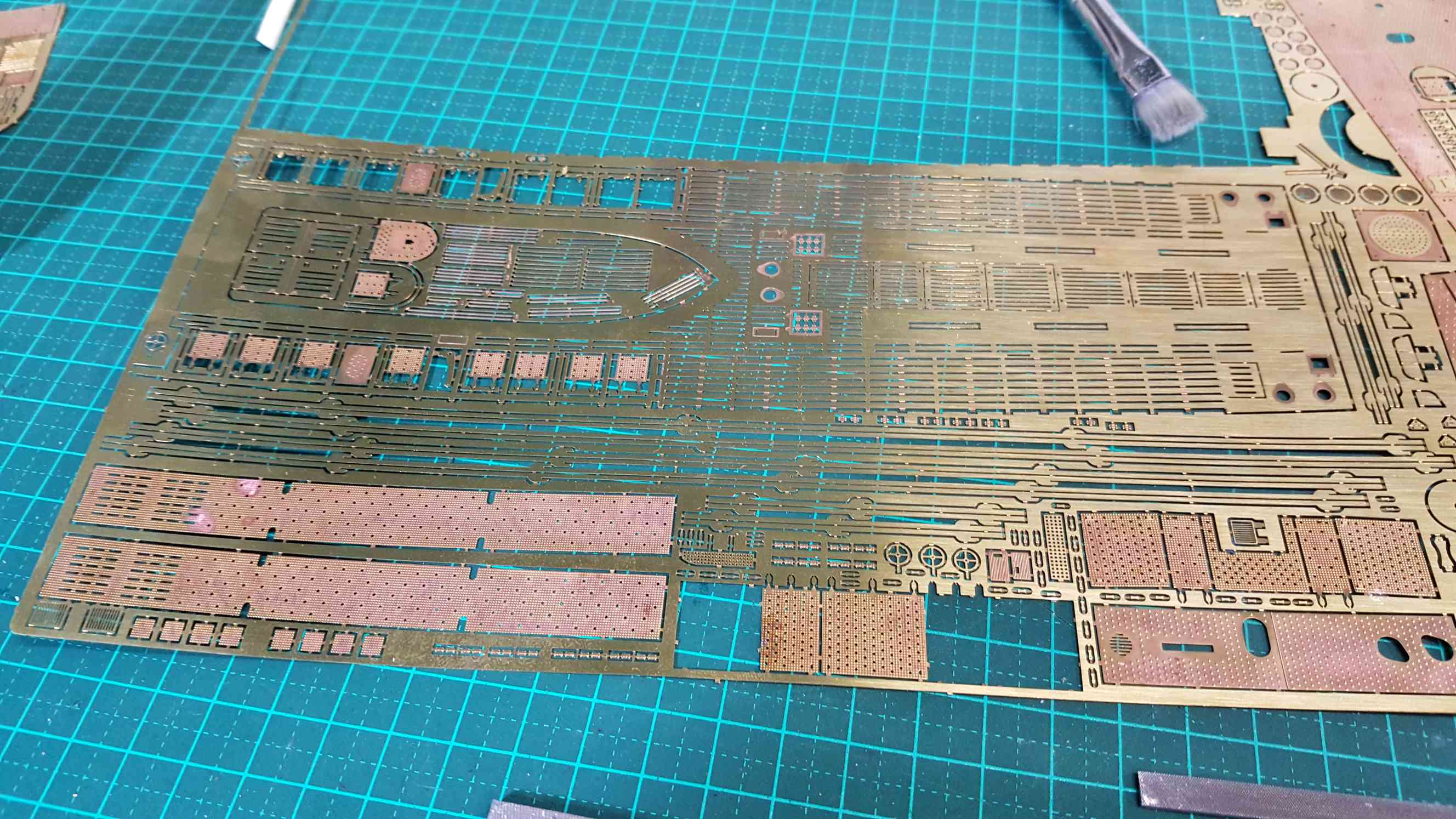

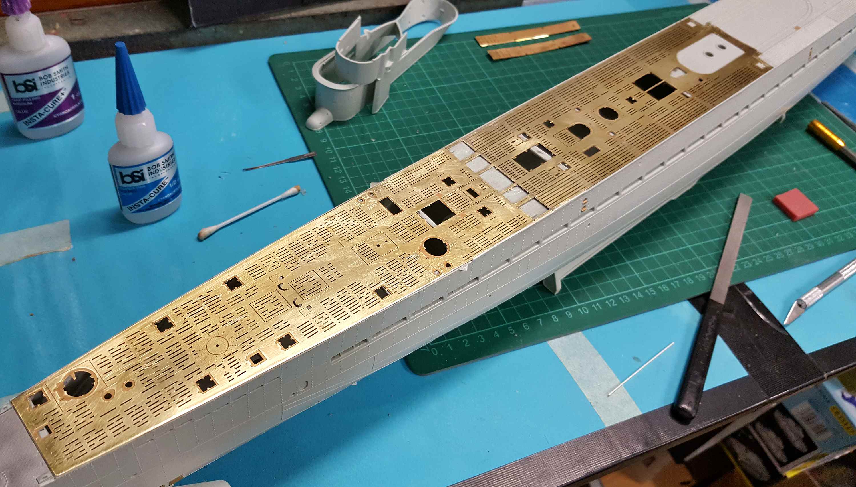

I worked all afternoon cutting out the second part of the deck, cleaning up the mess and triming/ sanding the edges on the PE section for the next bit. A far bit of work was required soldering the 2 brass deck halves together, filing the join smooth, then smoothing the edges and finally super gluing it in the correct position. The brass is very nice to work with and makes it easy to clean-up the excess super glue that gets on the deck surface - I used a chisel to easily remove it after a light sanding.
I also sanded and filed the edges of the brass to nicely transition with the edge of the plastic deck. I planned the deck cut to allow me to have the thicker cross members run underneath the sections with hatches rather then slots. Some slots have a little bit of the plastic deck showing through them but I can solve this with black paint. The water over the deck will also help in some places.
The use of the brass RC Subs deck gives this model the correct slotted deck pattern for U-505 as well as a realistic 3D feel with the slots actually going right through the deck. They represent the drainage slots on the actual sub more realistically now..
As I have said already, Revell have done a fantastic job on all their 1/72 subs but like any major manufacturers model kit, that has to represent a subject that has many variations, they cannot be 100% and have to make these kits viable by making them useful for the depiction of other earlier or later versions, which means compromises. This is fine, as this allows them to give us subjects like this, in large scales, that we can build OOTB or spend time doing a little modifying using a good base kit.
Revell had to bring out U-67 (the earlier version) and a later versioned U-190 using this same base kit, so a generic slotted pattern was always going to be the gameplay. Still , they have managed to provide some uniques details for each of these boats that makes for a good base.
Overall this has been a geat learning experience (my first PE deck and plastic deck cut to leave supports) and has actually been a lot of fun. The real advantage in doing this with U-505 in a diorama scene is that the water dio setting will be very forgiving for any build /PE issues, which allows me to learn for the others without wrecking a model. The water and froth can be manipulated to cover any bad sections as well the figures on deck. I was not going to do this for the first time on a stand mounted model.

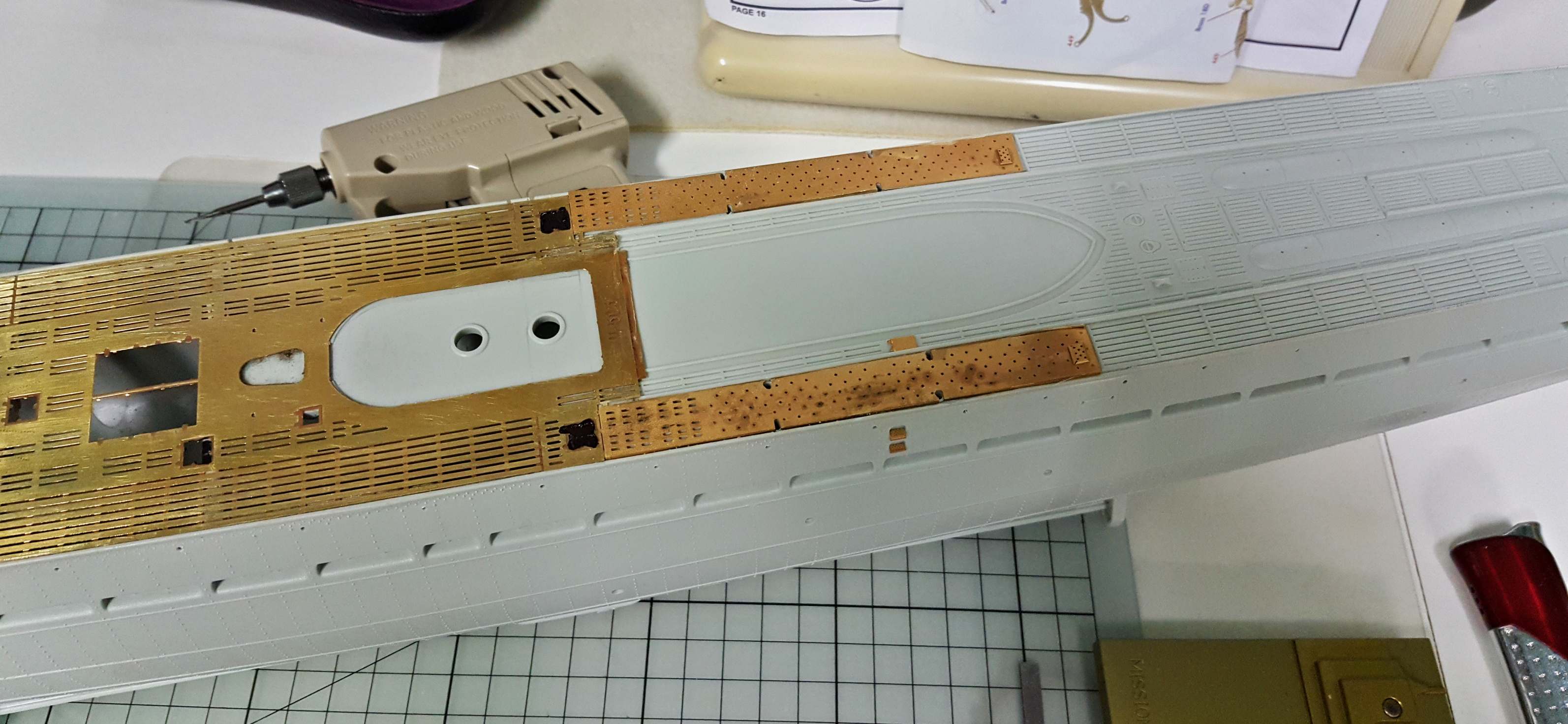

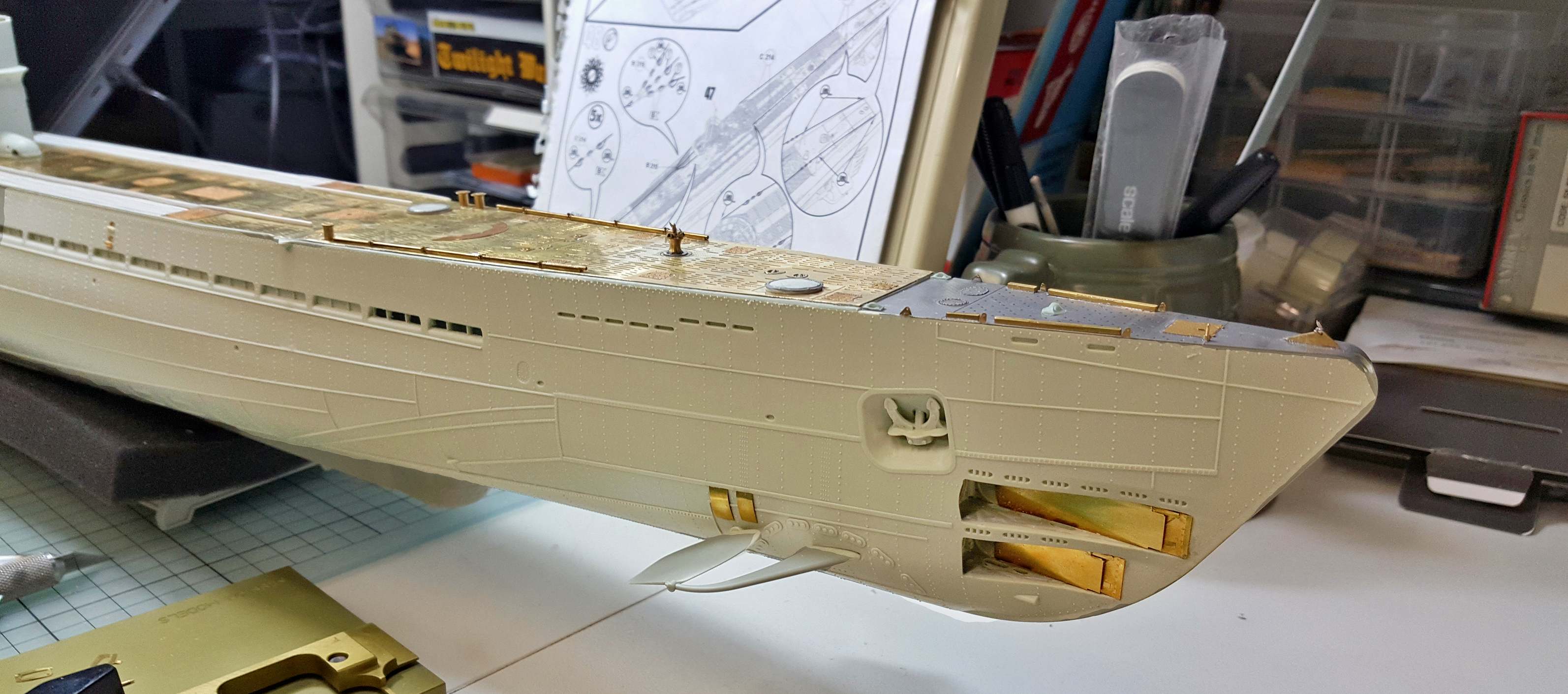

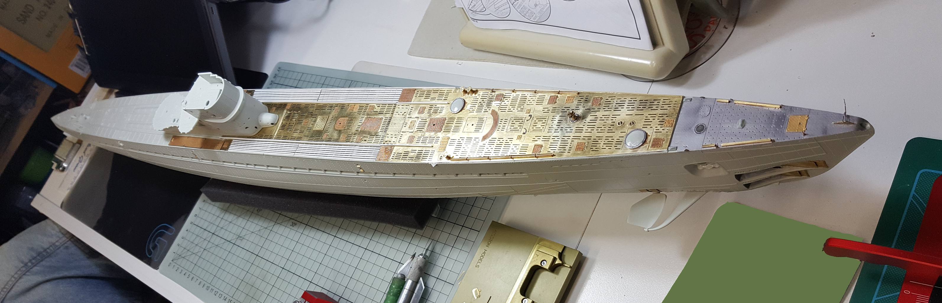

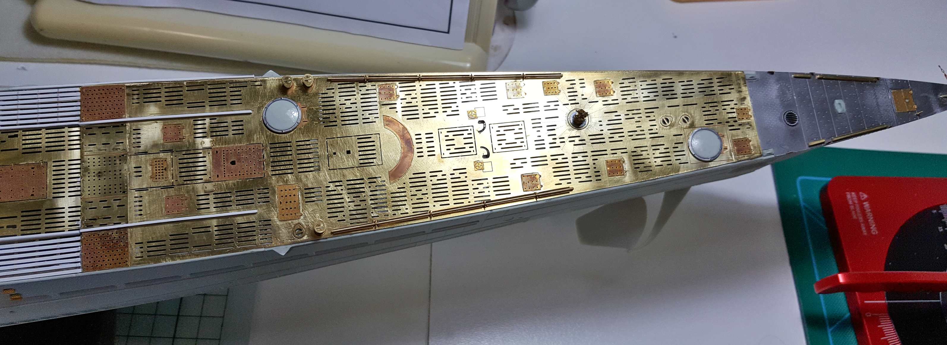

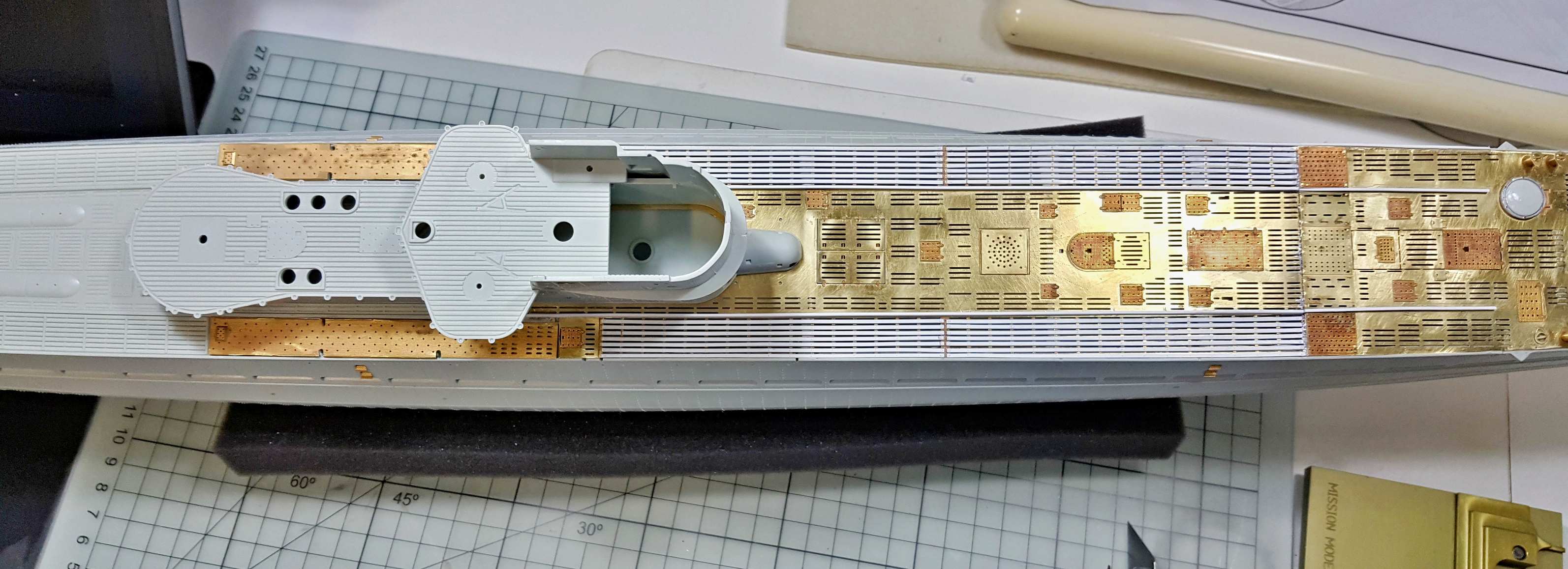

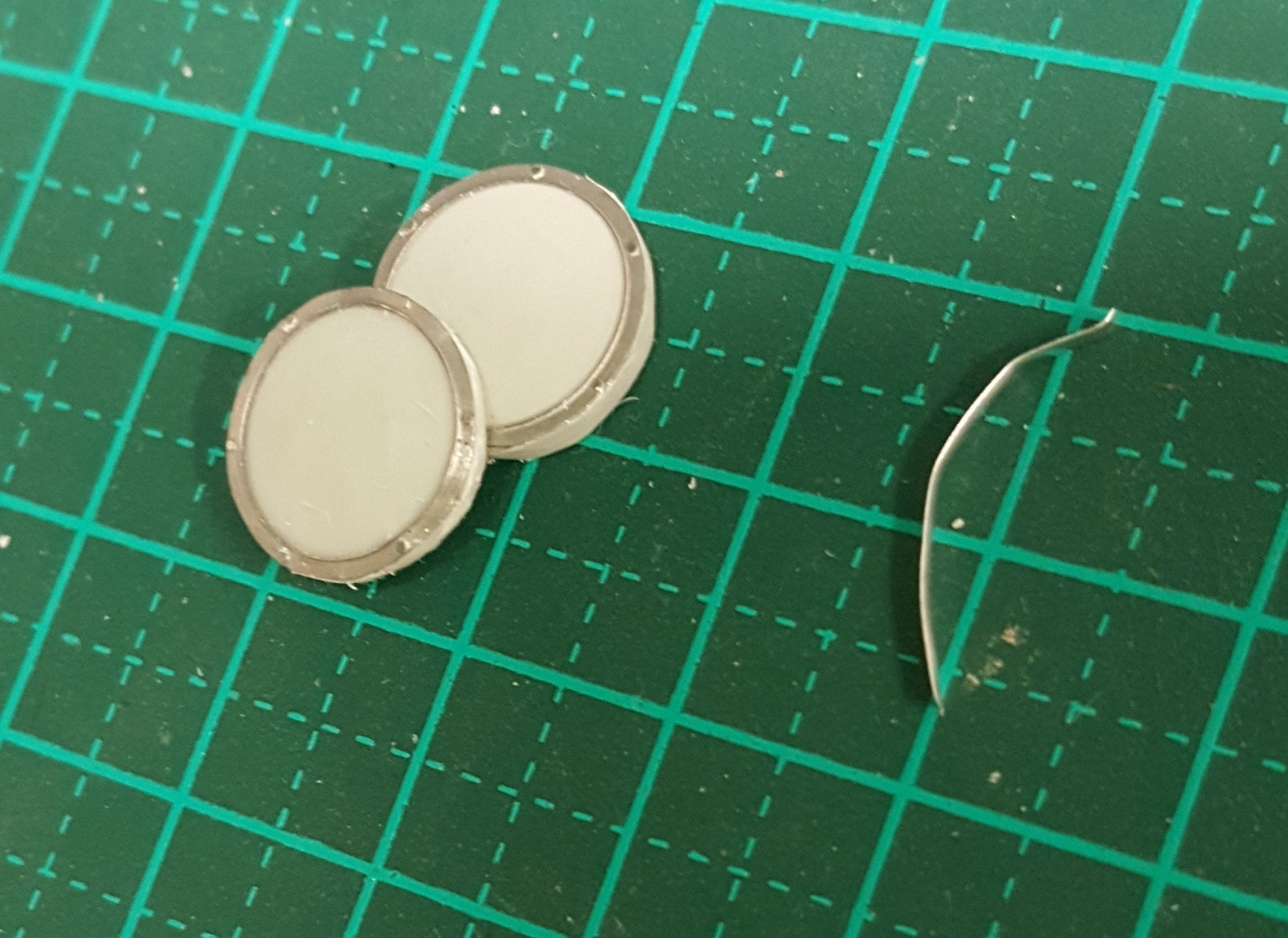

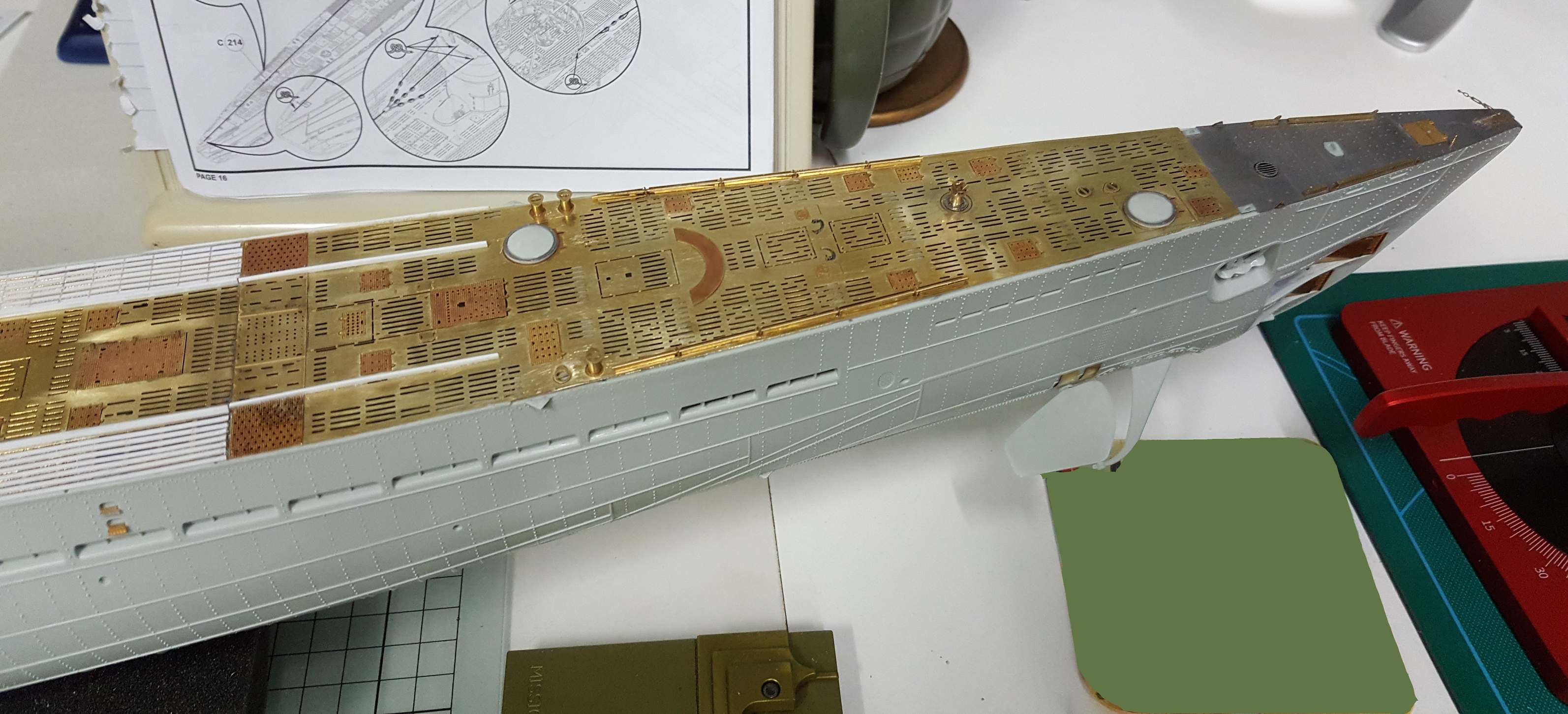

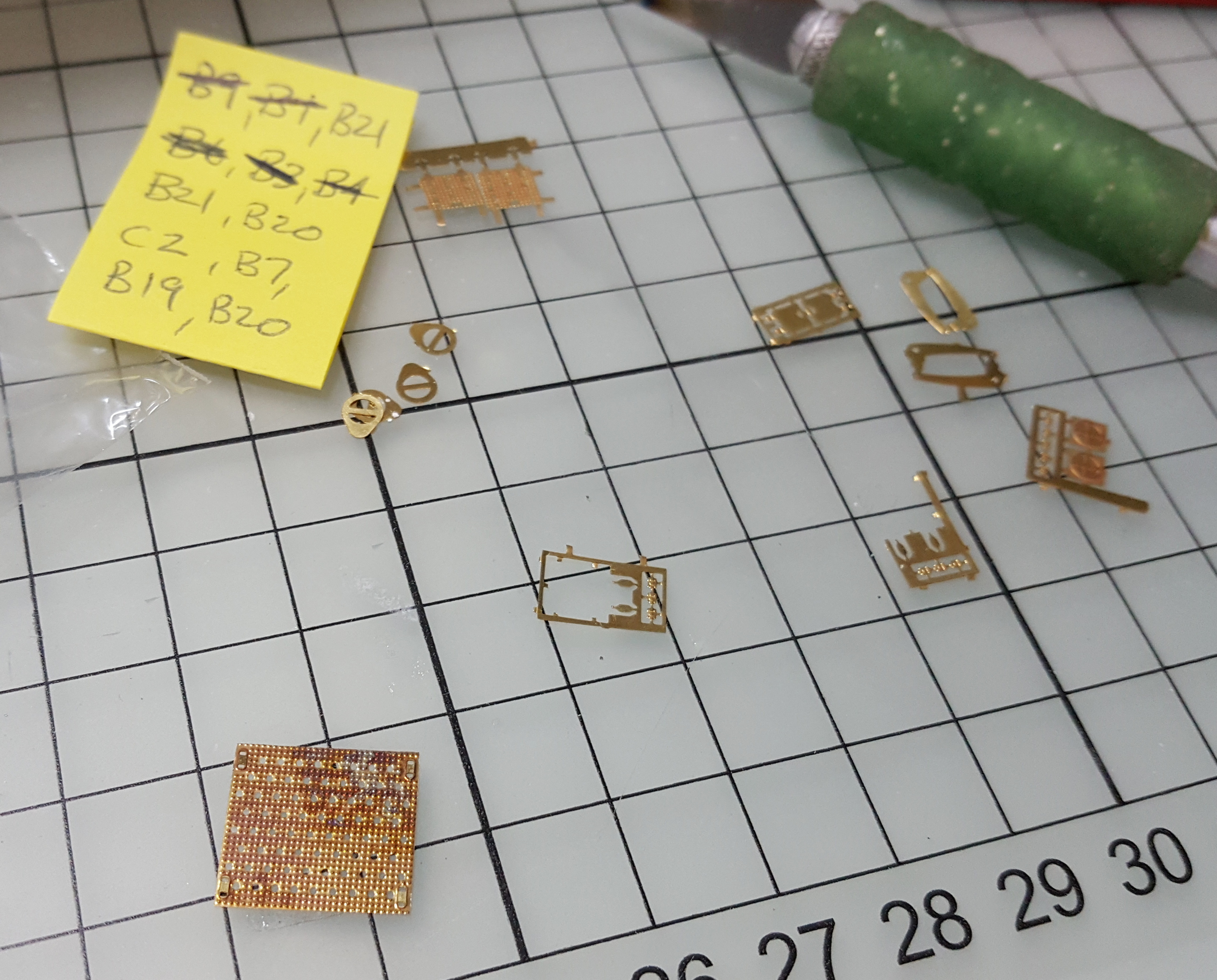

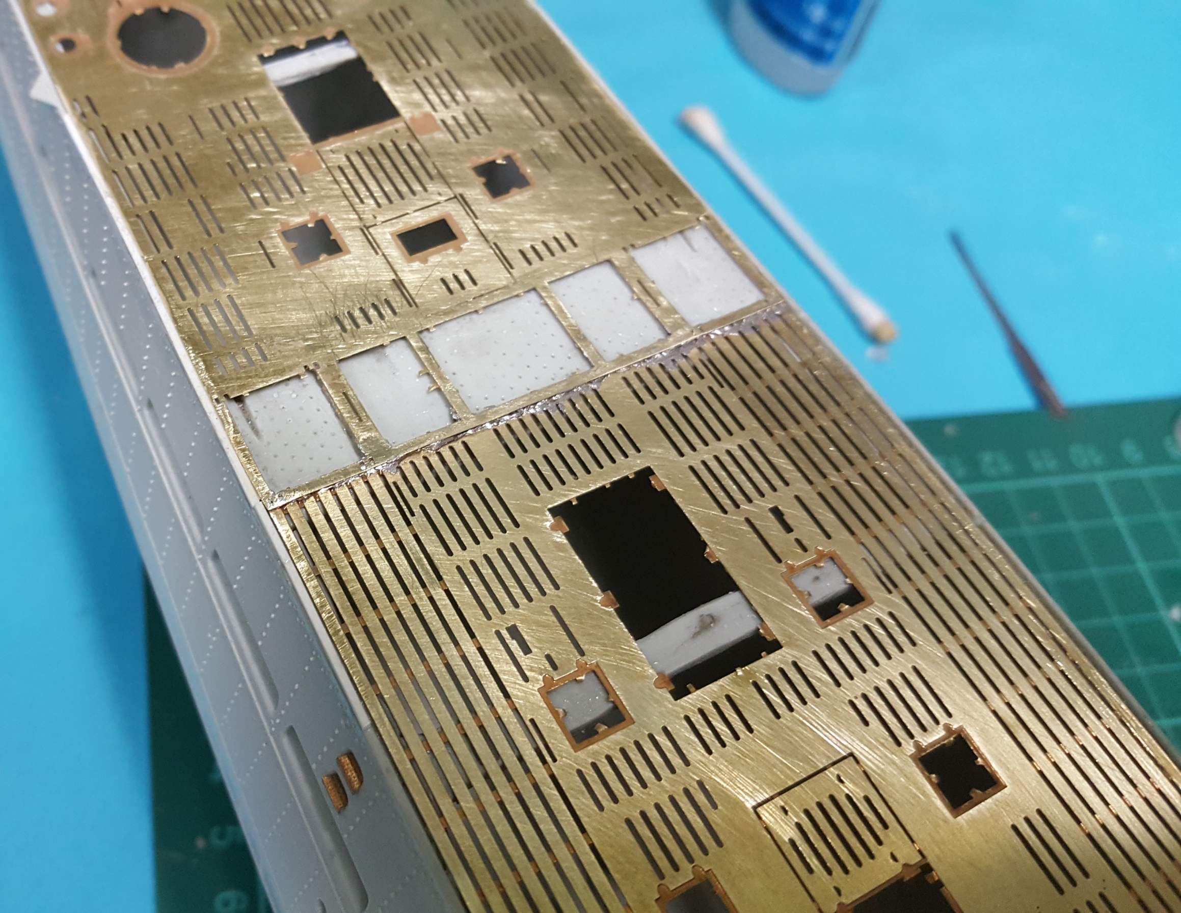

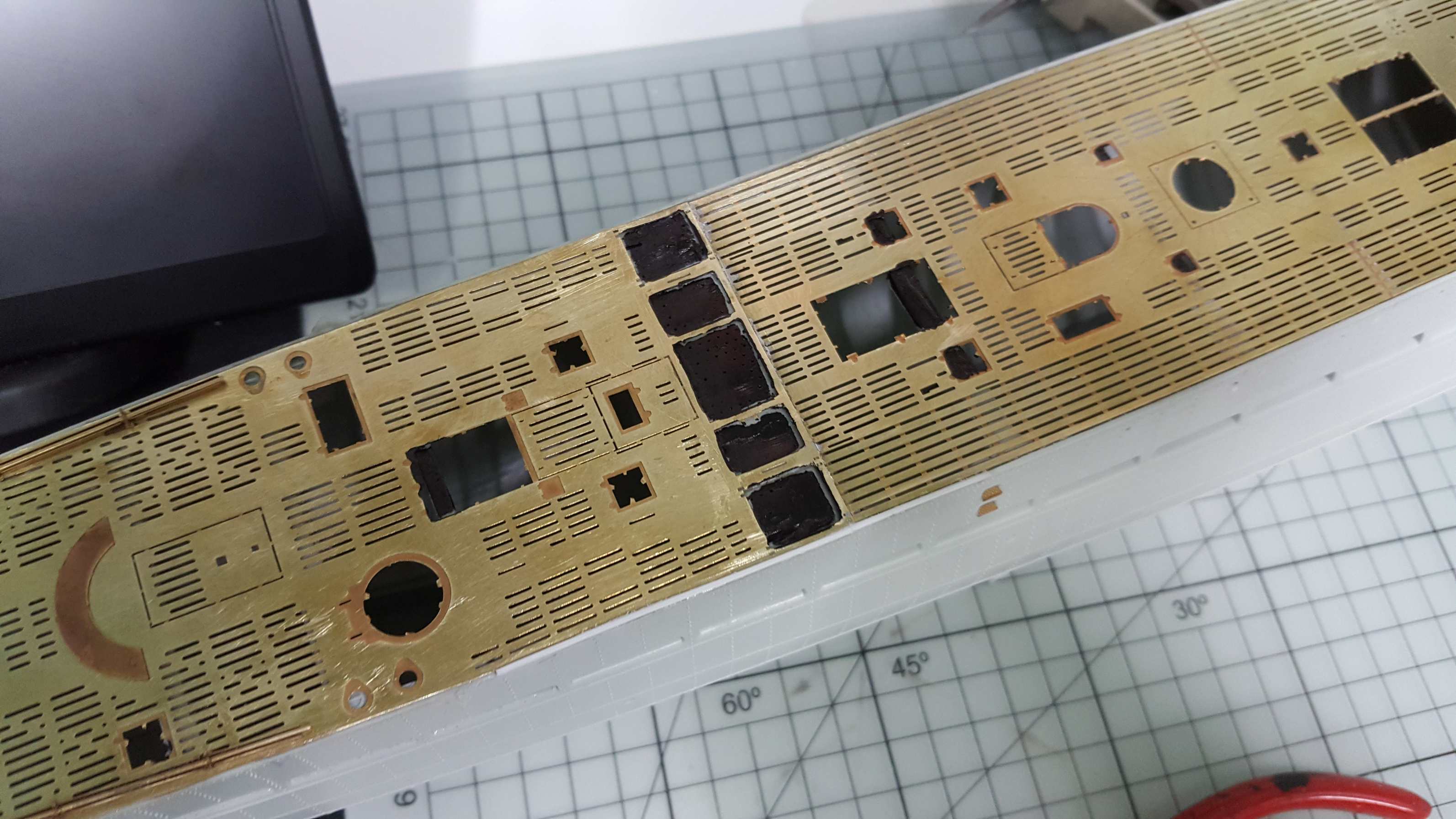

Some more progress on the forward deck. I still need to attach the PE hatch arms on the Revell kit hatches (grey). They took a bit of cutting and sanding to remove them from the deck and turn them into nice round stand alone parts.
I also needed to darken the supporting plastic left in place from the deck cut. Once the panels are in place I wanted to make sure it would look black through the slots in the panels. I just used a black marker pen to darken the plastic.
The point where the brass deck meets the plastic deck needed a lot of blending to take out the step but this section will have a lot of water effects over it so I am not sweating it too much. I can cover whatever looks bad with white water.
Next up the forward section of the deck needed the PE details added. As I said above I still need to do the hatch arms and a couple of hinges.

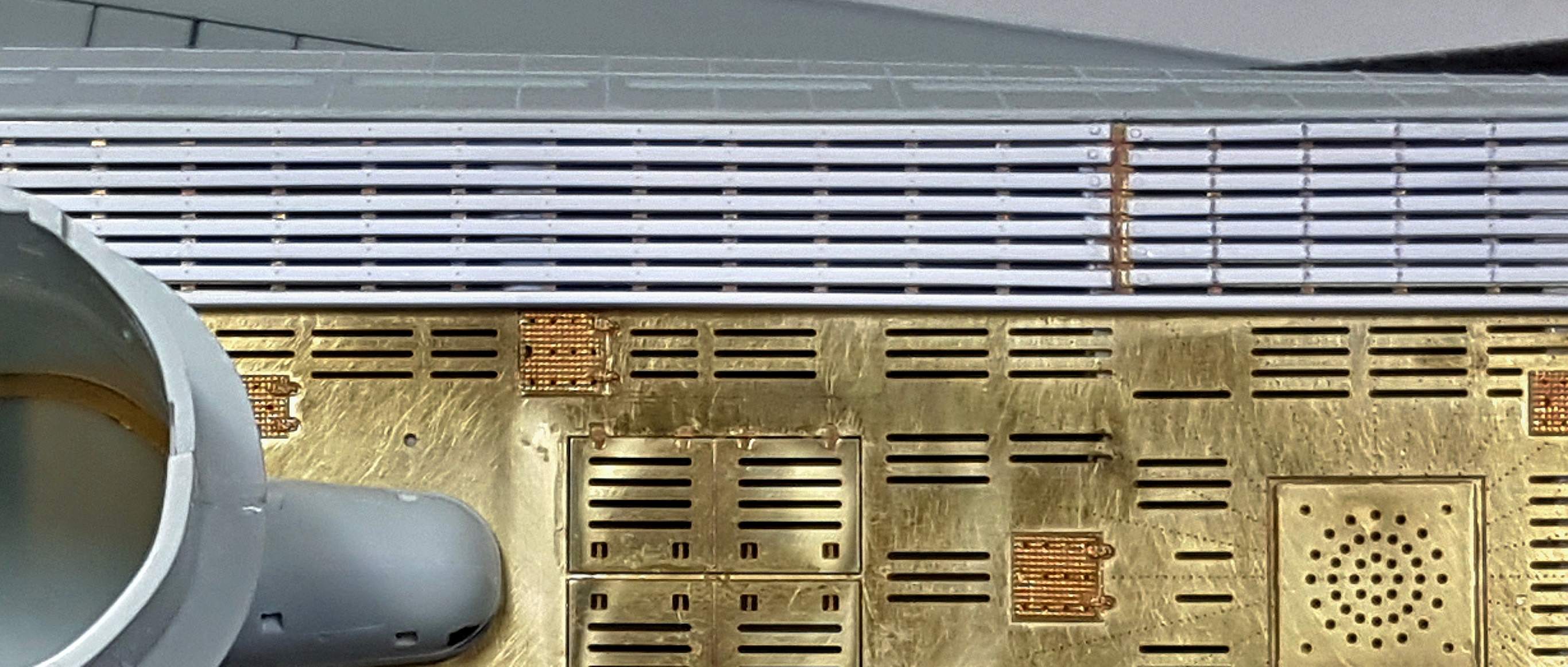

The second section required a bit more work with the separating rails between the torpedo covers and the deck. The PE rails are to thin in scale and because I soldered the second section end slightly under the first, the PE rails would not slot in with the slight height difference. I replaced them with plastic strip at the correct thickness. The forward cover style is different from the rear ones and don't have the cross beams on top. These covers change on different type 9C decks, with each boat having various styles and configurations, even when they come from the same shipyard. These changes make each build unique and more interesting.
I also added plastic strip to the forward PE torpedo covers. These were totally flat but they are actually raised wooden planks bolted to the metal cross members underneath. I used the PE for the underlying metal, adding the strip and then applying the bolt detail at each end with smaller holes along the length - this process took ages and cramped up my thumb muscle pessing in the patterns.

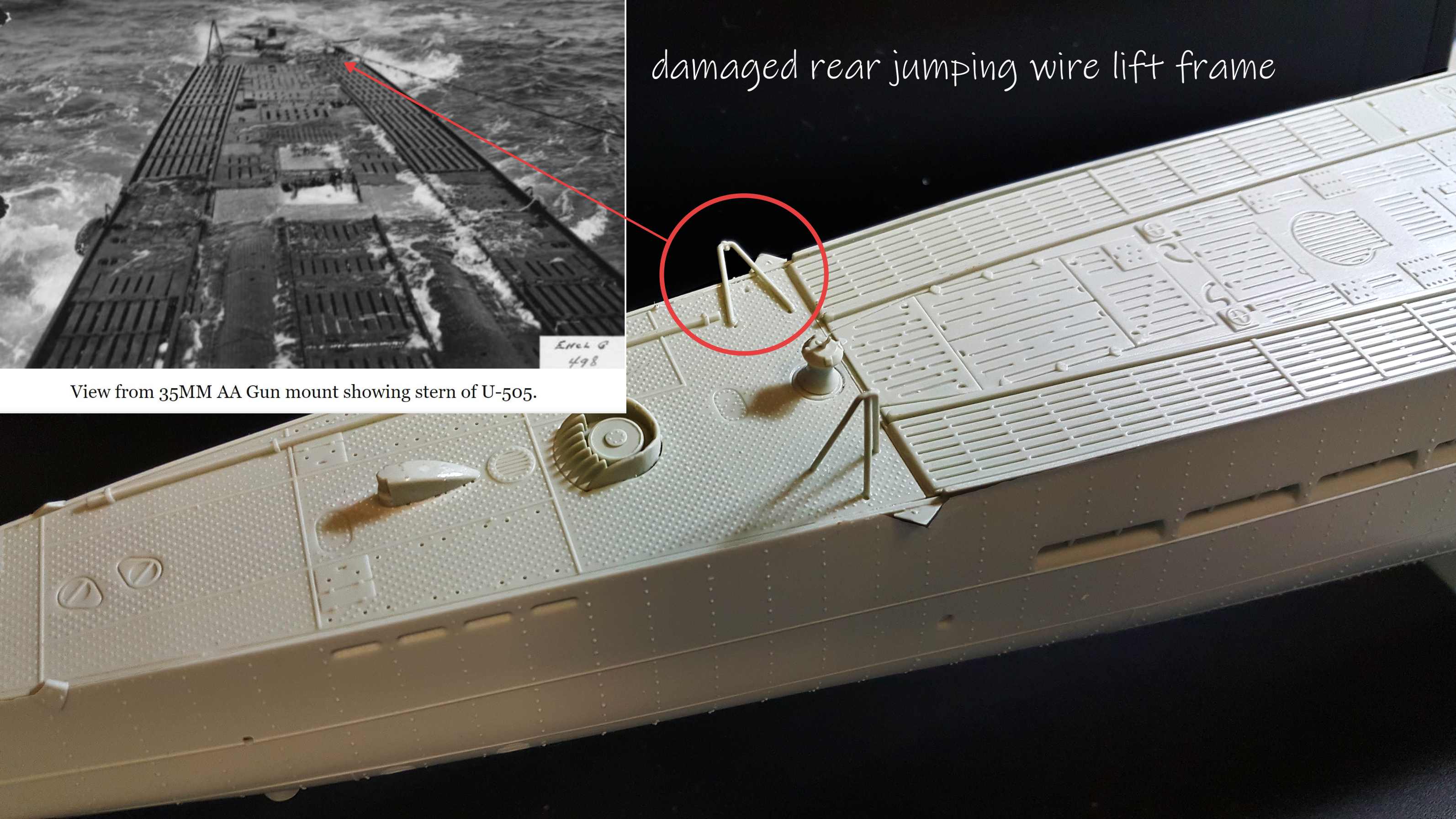

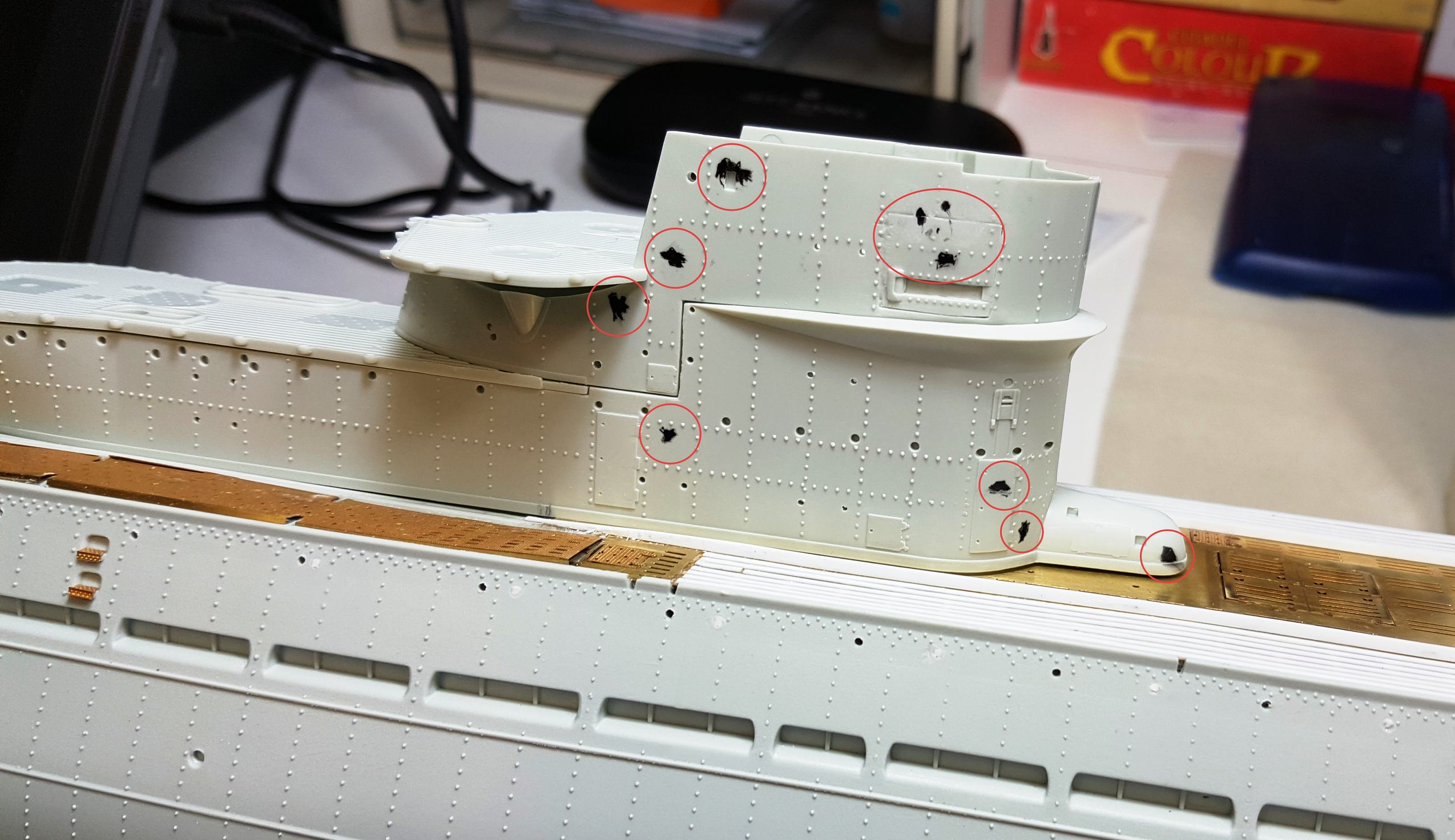

I damaged the rear stanchion for the jumping wires coming off the Wintergarten as per the photo taken after capture.
Next up will be the tower. I have not attached it yet but have marked the damage that I will be adding. There are very good references as the sub has been preserved in a Museum in Chicago. Some features have been restored incorrectly from the original but the Conning Tower damage has been left as per the capture. The warping on the torpedo cover is not a worry as it resembles genuine damage and will be under water.

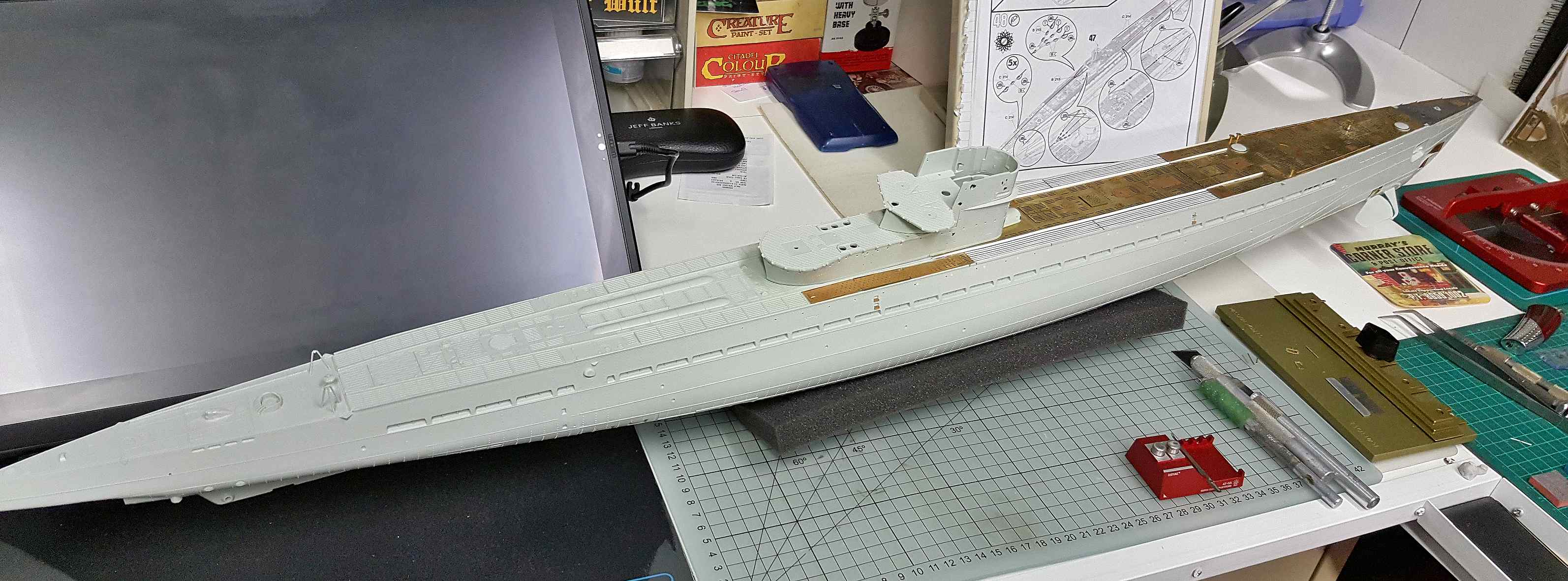

The tower damage looks really good, and the deck rework is impressive. The size of the kit looks like there's got to be some pre-planning when just flipping the thing over to the other side, sheesh. I would most definitely have to make major alterations to my bench just to work a kit this size.
Ruck On!
Ruck On!

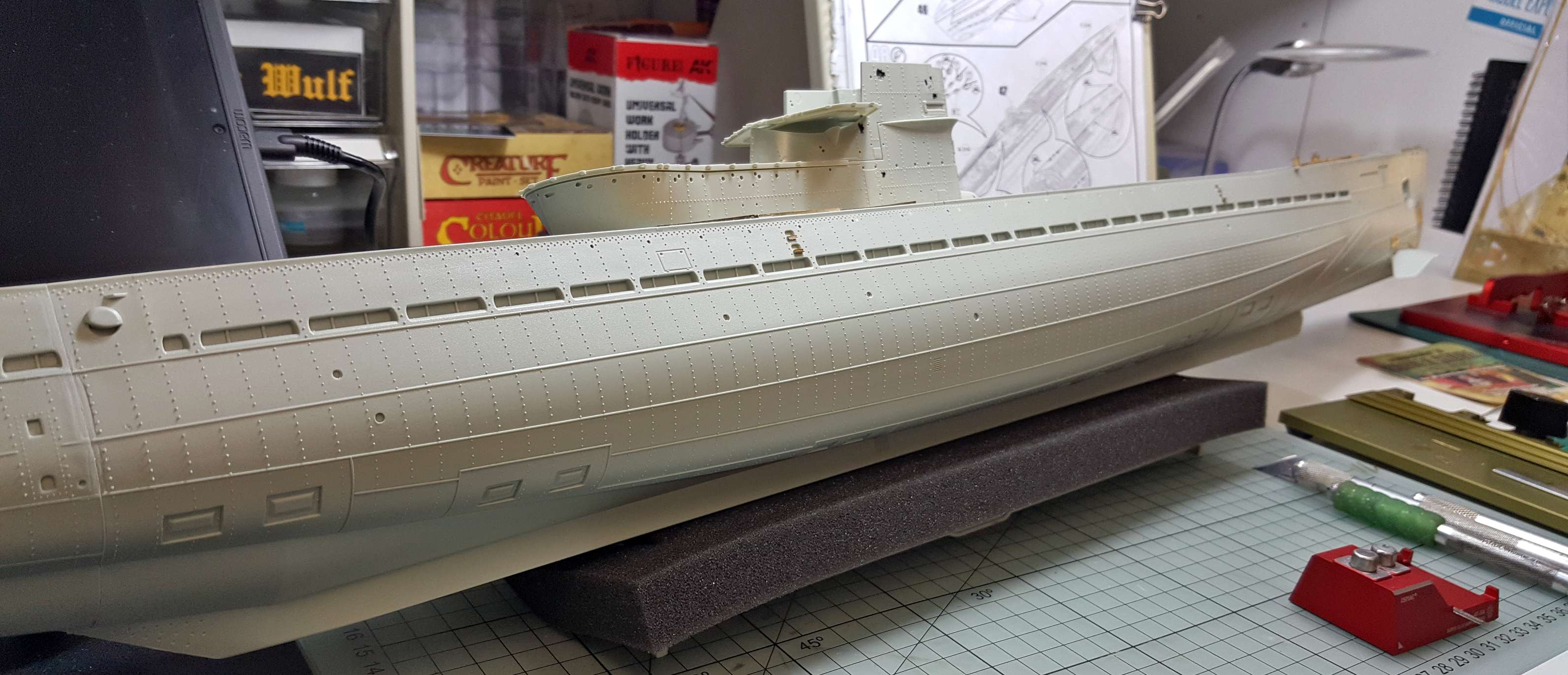

Thanks Steve, however the tower damage is only at the mark-up stage and the tower itself needs to be started. Plenty to go yet. Yeah. the stand that comes with the kit is an excellent holder but is lacking when you need to turn it on its side. I adapted the piece of foam from the packing in the Pontos set to sit on the stand as a curved pad so I can work on the sub at any angle. :hmm:
