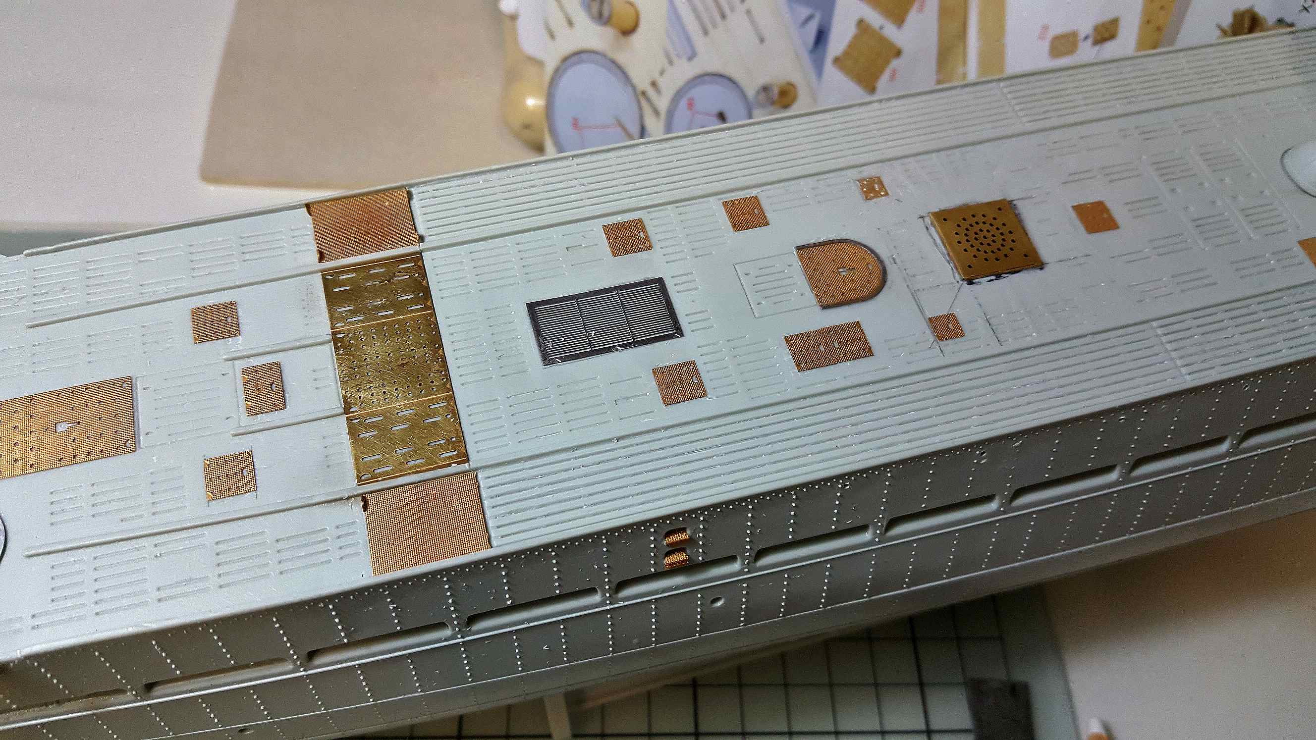

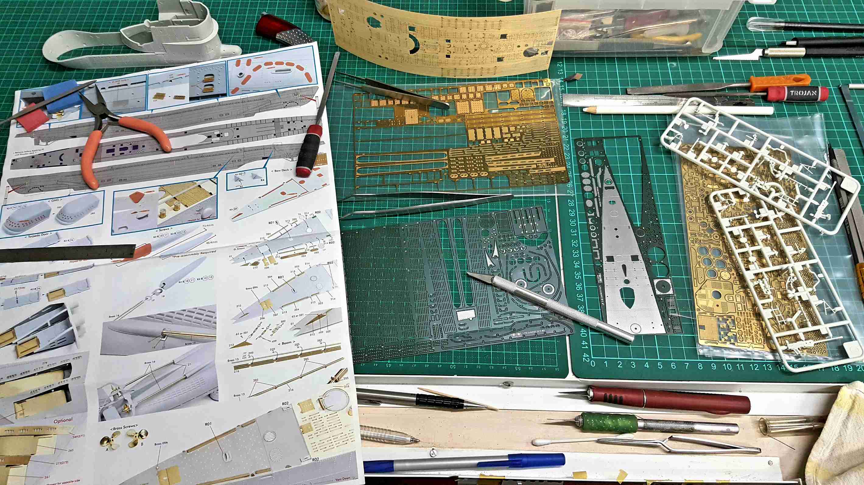

Some more PE stuff..........

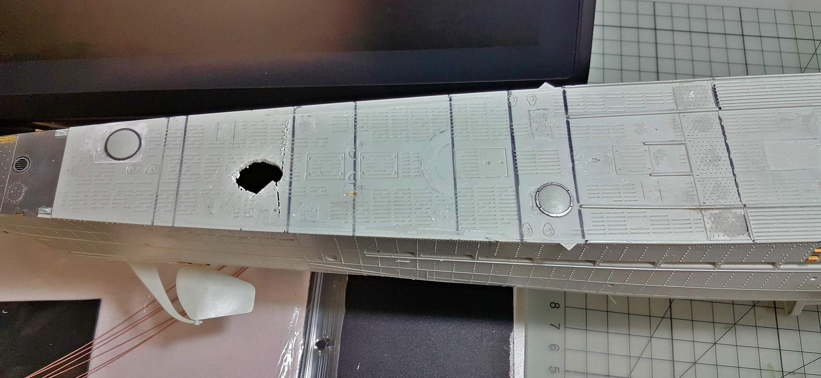

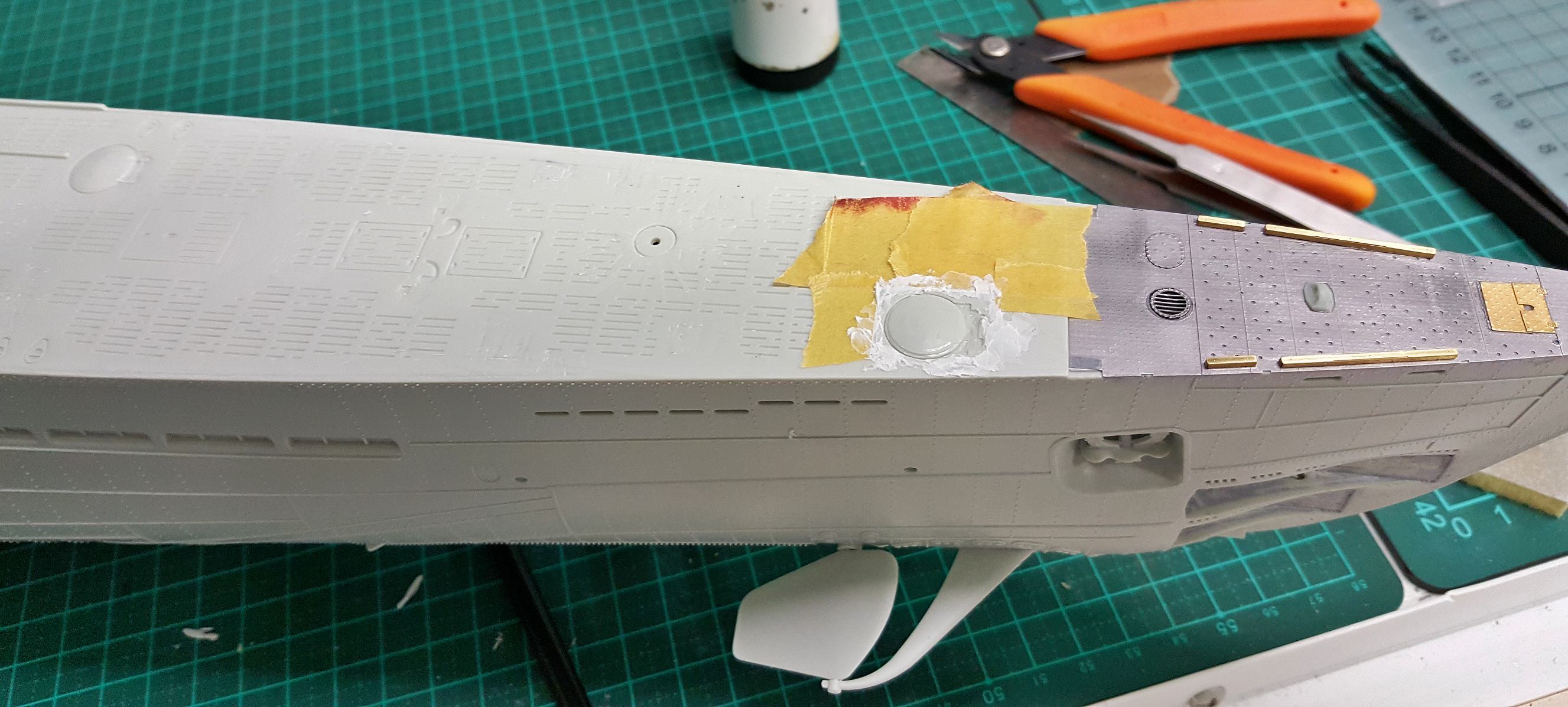

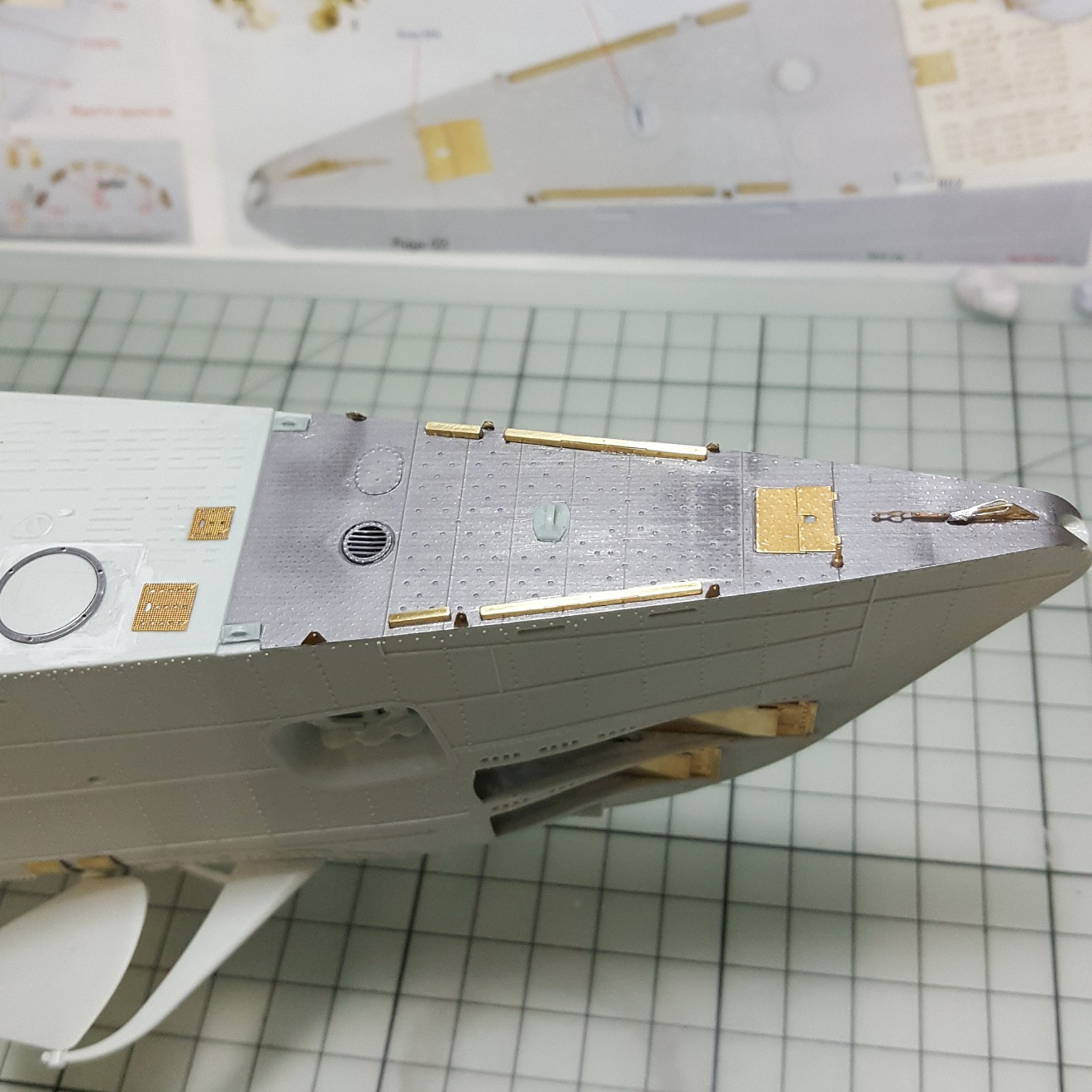

The forward hatch comes as a seperate part to the deck and fits into the square provided. The fit is good but the part lines still need to be hidden without filling any other detail on the deck. At this point I have removed the hatch arms ready for the PE.

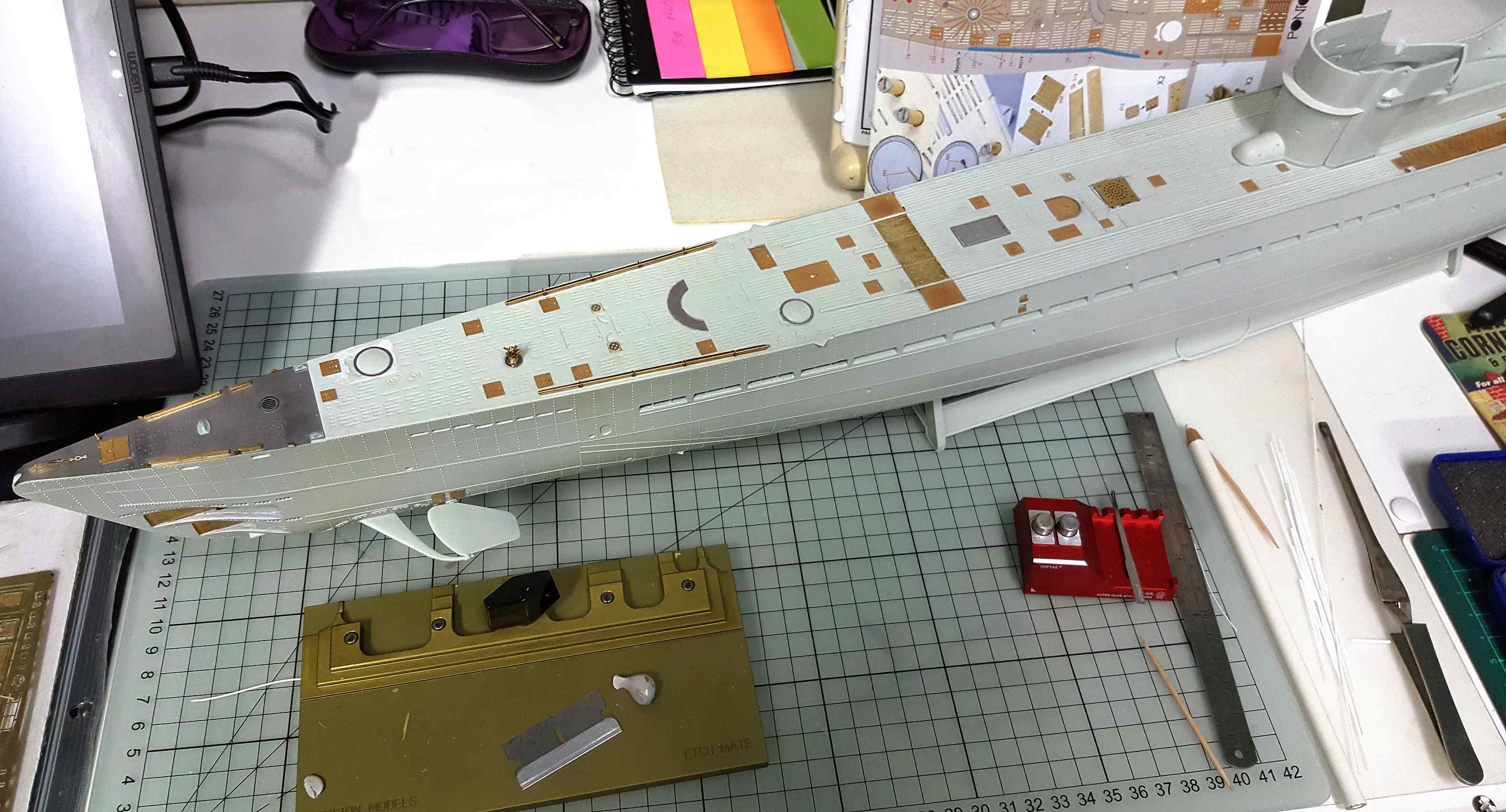

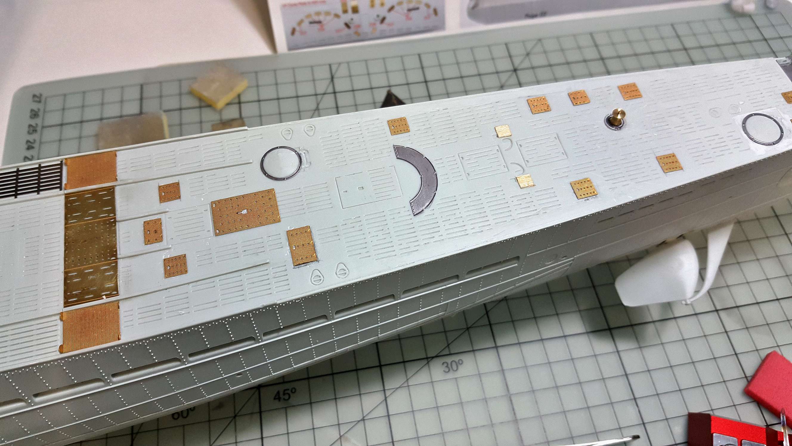

I started on the PE for the forward deck........slow progress but steadily getting there.
What I really like is the fact that they give you the details (in brass) for the mountings of the net cutter frame that was removed from U505 a few years earlier. U-505 is a pre -1942 launched boat and therefore has the earlier features such as the 'slotted pattern' deck and triangular net cutter frame that was common to the earlier 7C's and 9C type subs. An order was issued on the 1st March 1941 to remove all net cutter devices and as U-505 was launched on the 24th May that year, the net cutter would have been removed before the initial launch. Photographic evidence shows that the mountings/fittings on the fore-deck were left in place.

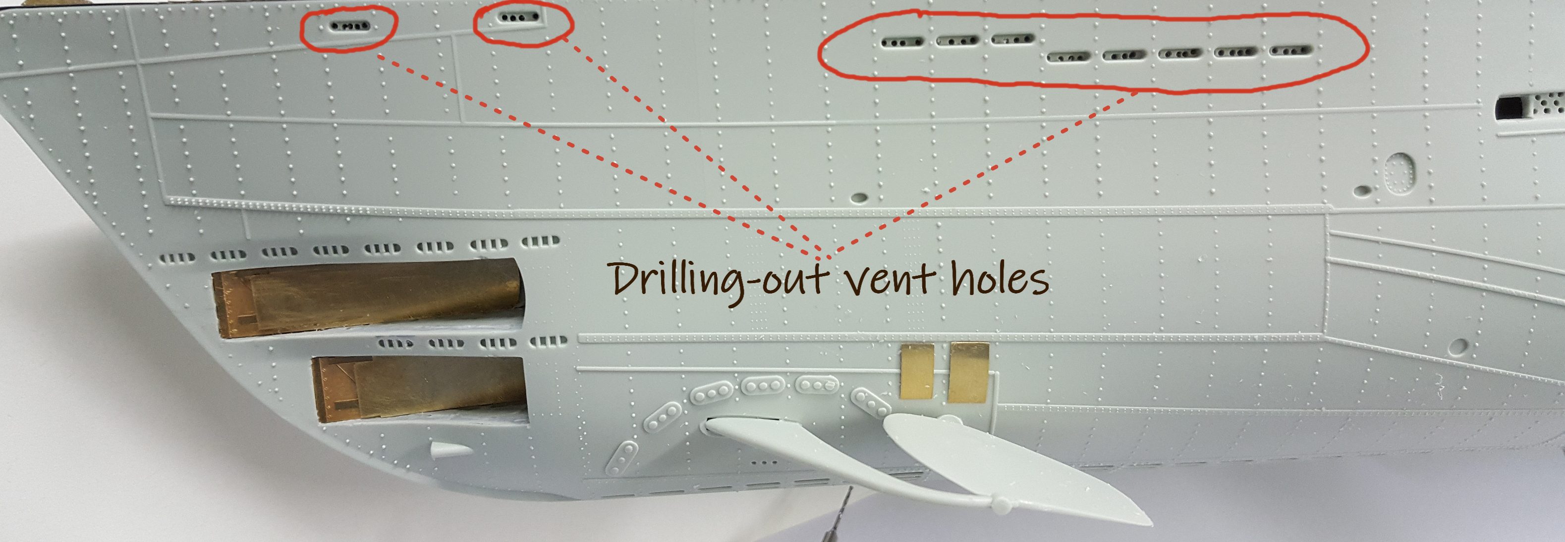

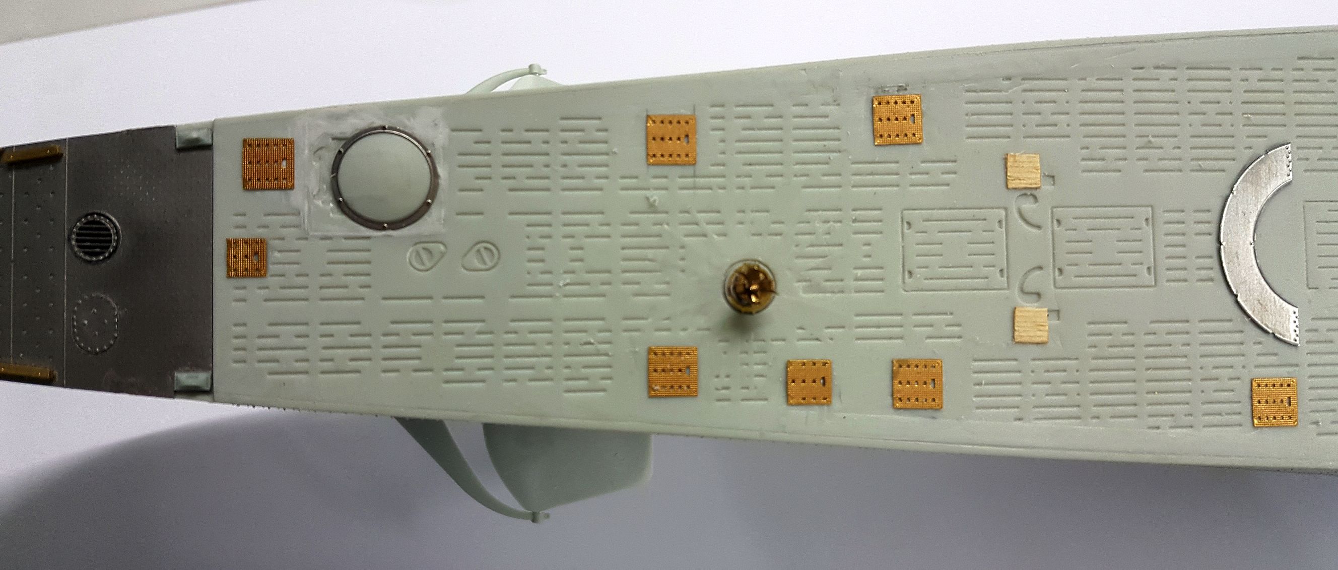

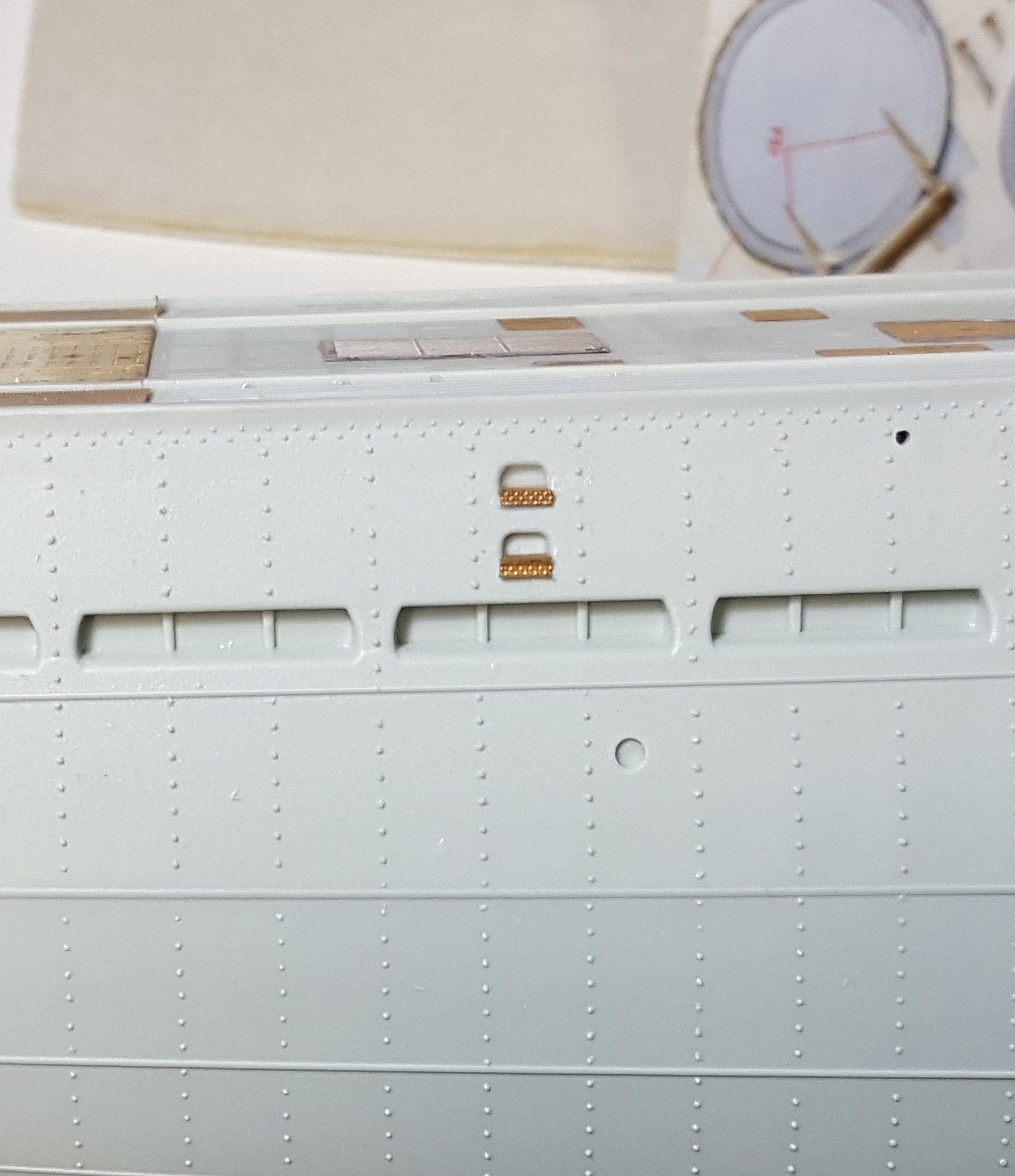

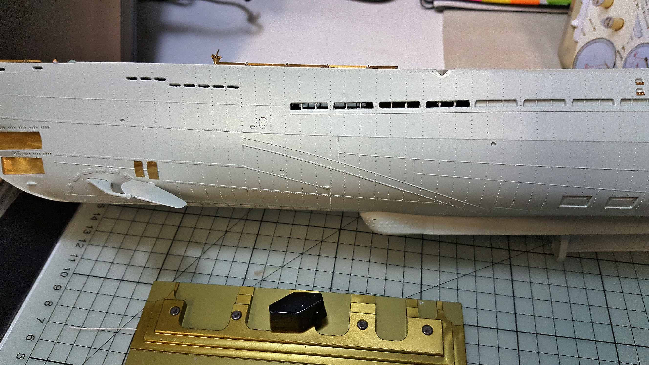

I have put more of the PE on the deck such as the boat hooks and additional metal covers. I also drilled out some of the hull side water vents on each side but only the ones that will be exposed, as per the photo. I started by drilling holes then bored these out with a larger grinder. The same has been done for the first 5 larger vents as well.

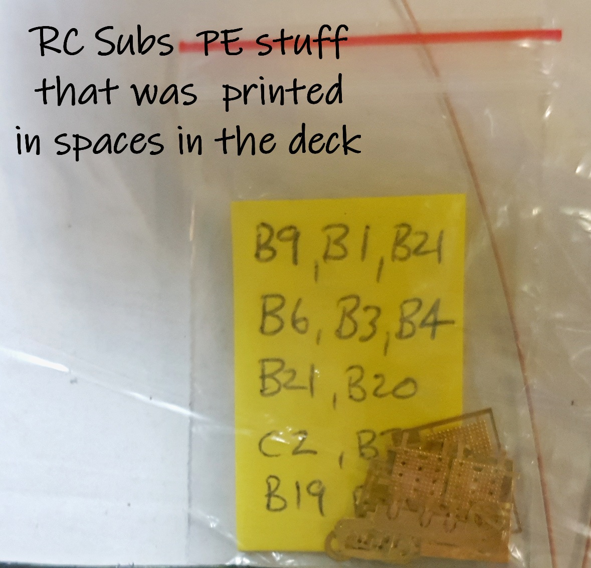

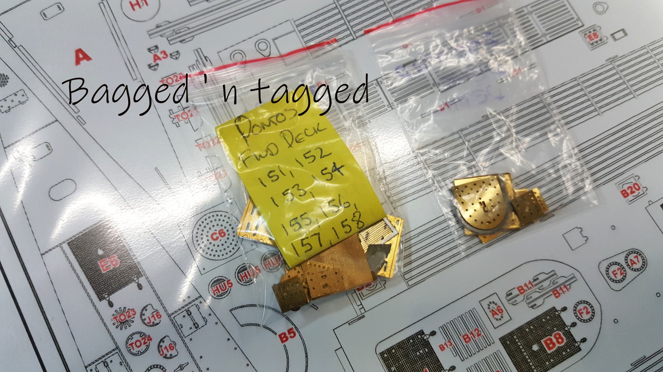

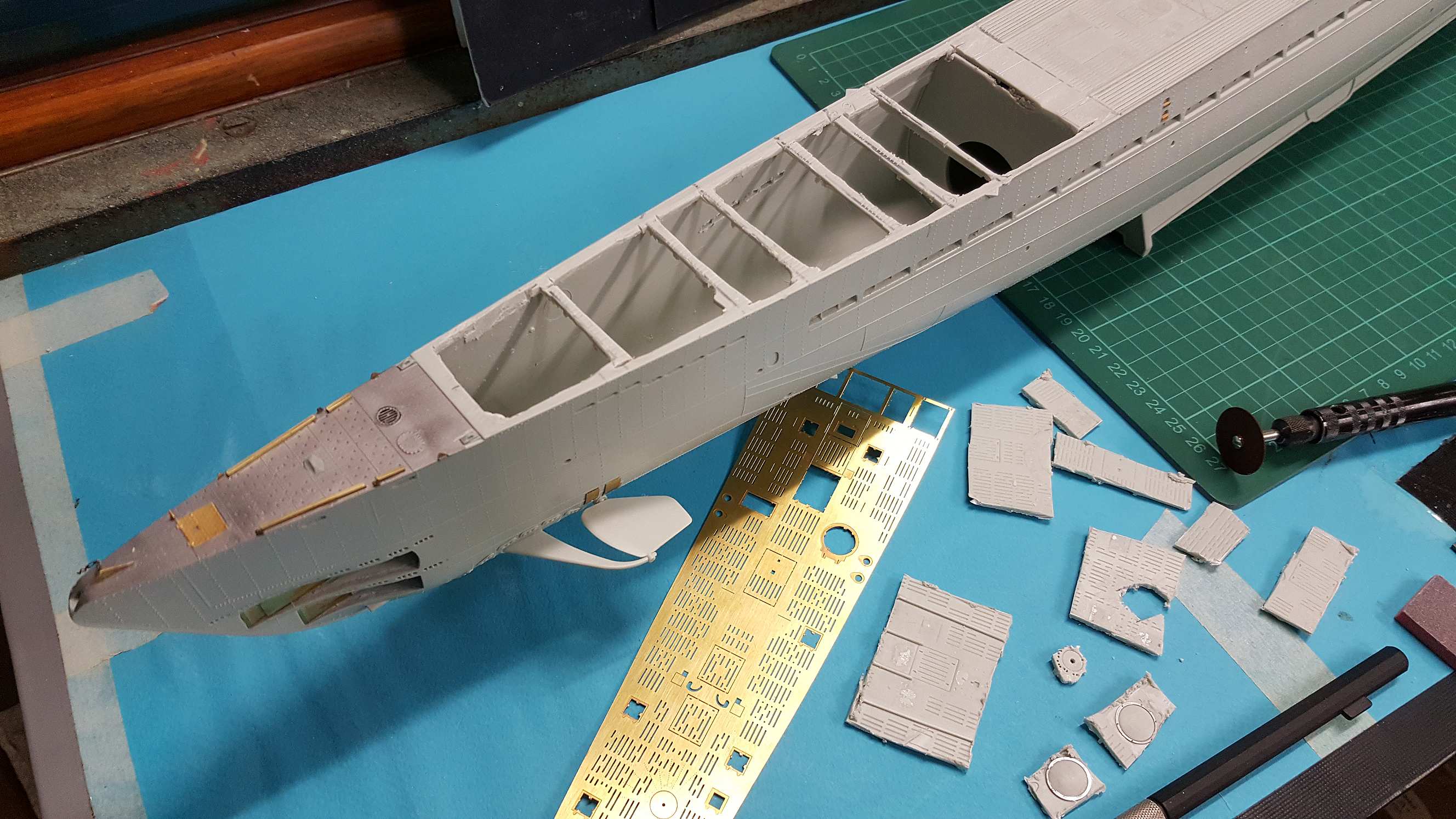

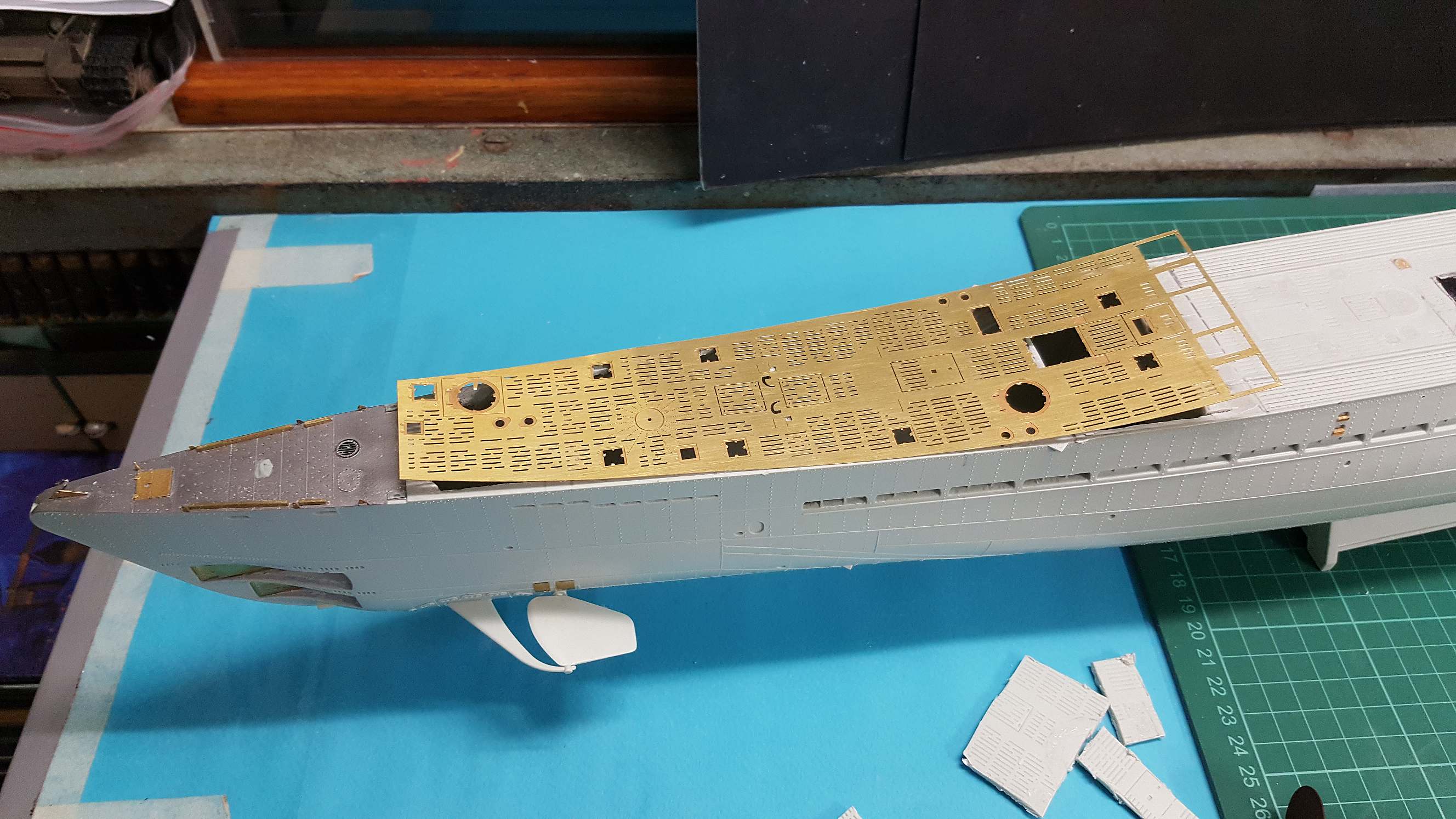

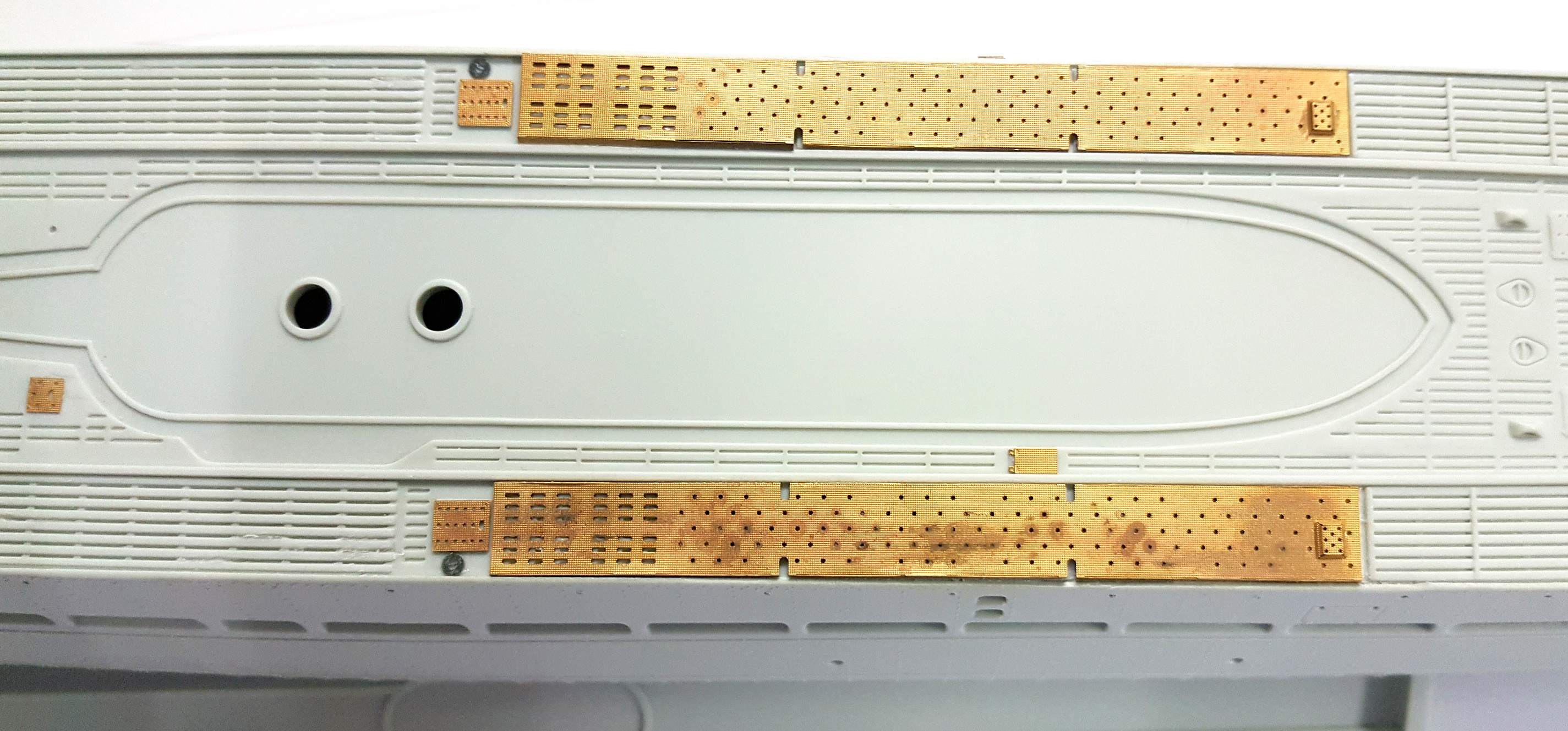

So having reached this point my plans have dramatically changed. I originally kept the U505 RC Subs PE set for my U-172 build but after further research I found out that this boats deck pattern is different because it was constructed at a different shipyard. I was not going to use the PE because a lot of the deck was submerged, however now that I will have it spare again I may as well use as much as possible.

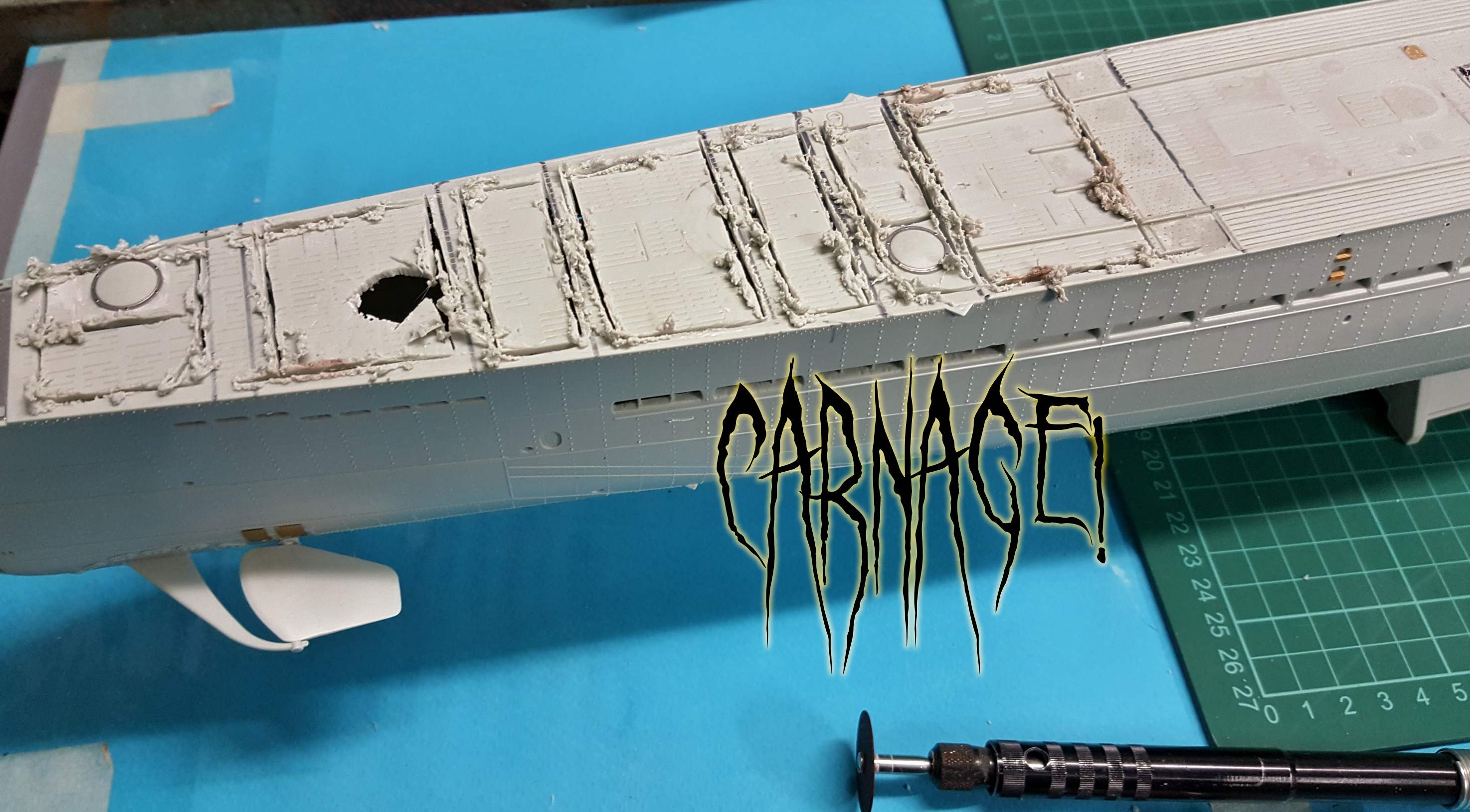

So stay tuned for some major deck carnage as I grind away the plastic deck to just leave supports for the PE. Before this though I will need to remove, tag and bag the Pontos PE off the deck (except for the very forward piece).
That's a tremendous amount of work. Looks great!

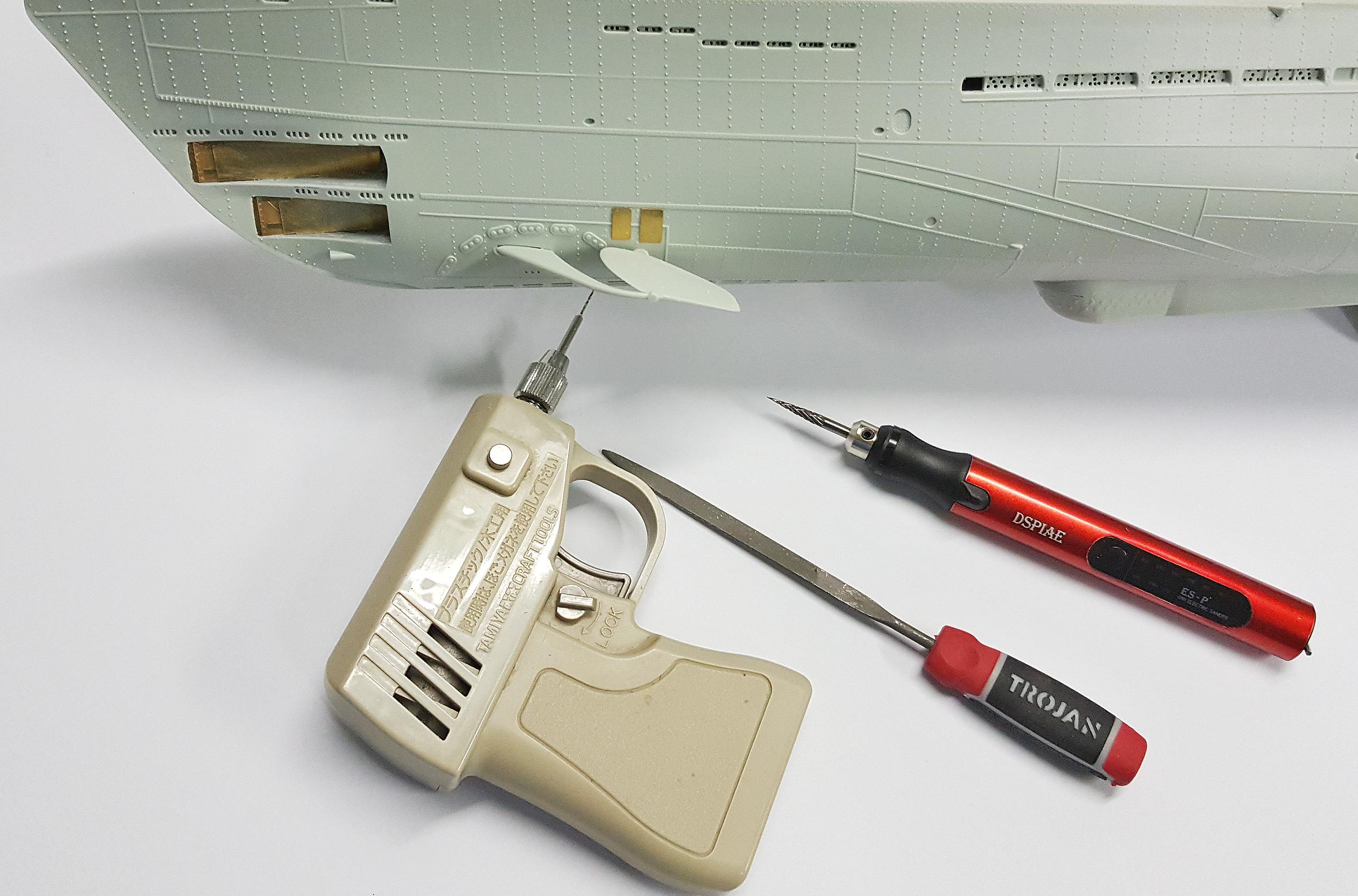

Btw I've never seen a drill like that before. It looks like it's about the size of my wife's vintage 25 auto Raven.
Lovely work Ian, what's the red tool in the last shot?
The red tool is a super glue holder and aplicator stand. Got it on Aliexpress. You put the drop of Super glue on the stainless stumps and use the silver applicator to apply. Cleaning is to burn off with a gas jet lighter. I love it! No more lumps of super glue on the work mat that I always seem to put my arm in.
Which drill? if you pick on the thumg you can zoom in to see the brands.
