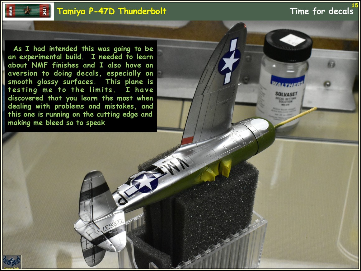

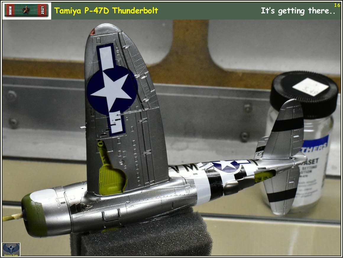

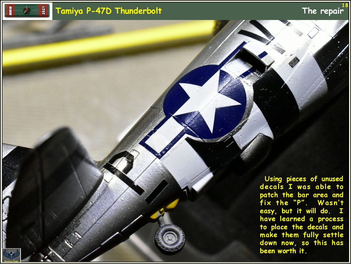

Spent the weekend applying decals and learning some things. I learned the Micro Set seems to work well as a surface layer when setting the decal in place. Micro Sol doesn't do diddly. It might work on super thin or really weak decals but it doesn't do squat otherwise. My almost gone Solvaset is wayyyyyyy too strong , but it does the trick especially if I dilute it 3 parts to 1 part with Micro Sol. I finally couldn't stand it and did a deep search for another bottle of Solvaset. Walthers is out and most everyone else is as well. I did manage to find ONE bottle at a model train supply house. Bought a few other items while I was there, but they just didn't have much unless you needed something in a train scale or something for a diorama. We shall see if the bottle arrives later this week or not.

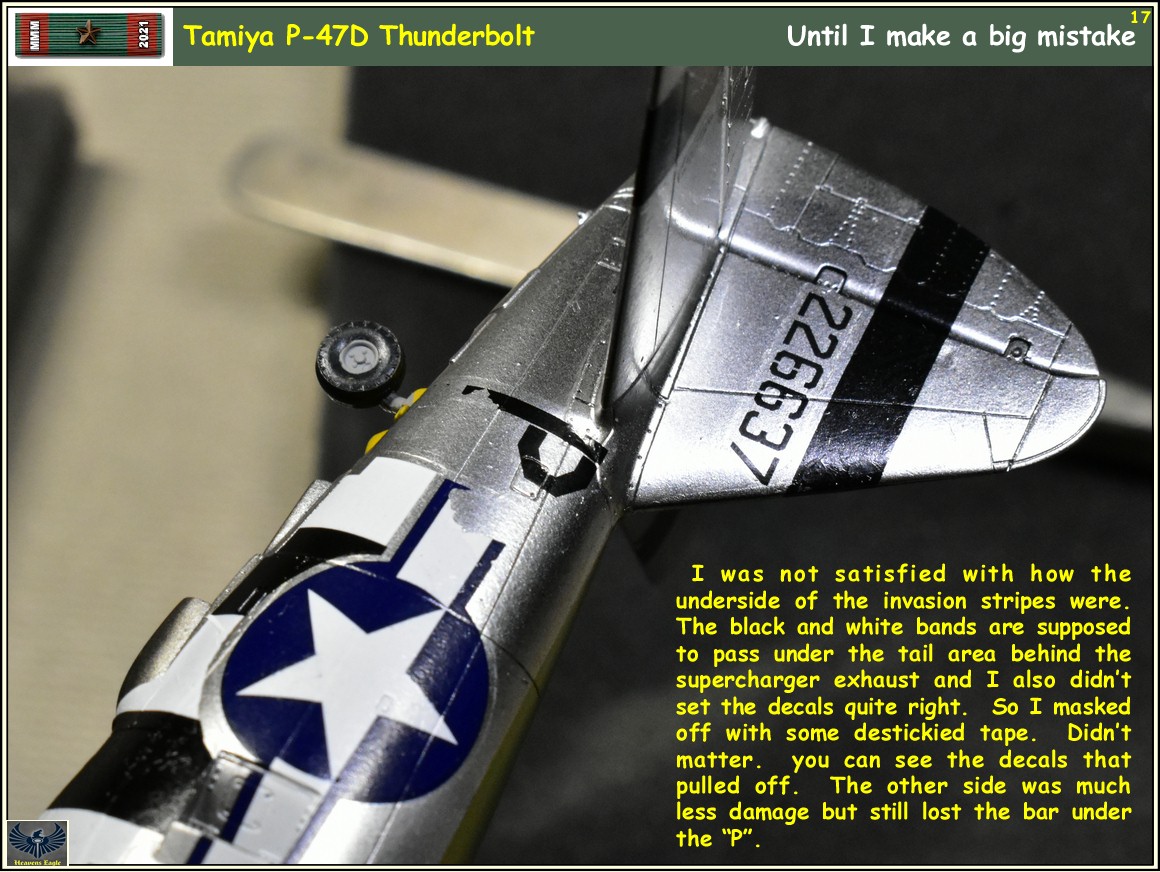

I also decided to do a little mask and paint of an area after applying the decals. Yeah, I know and knew at the time it could be risky. Used some tape that almost wasn't sticky enough to stay in place. Didn't matter, but look at the photos and you will see the story and repair.

Am done now for tonight. Have some decals to place on the prop and some more detail paint. Then it is assembly and weathering time. Should be no problem finishing up by the end of the month this time.

But the fix looks good, Paul. I have some Walthers but Tamiya Mark Fit Strong is maybe stronger, and the Gunze is pretty good too. And no two decal makes act the same.
I actually goofed with the invasion stripes and used the wrong set. The ones I was supposed to use were a lot smaller. Looks a bit better with the bigger decals, but not accurate. Was a good learning experience putting them on though.
One thing I did learn is that the best way to apply Solvaset is with the airbrush on low air pressure. It limits the amount of solvent applied and with care drives out the excess water from under the decal. I also found that the pointy end makup Q-tips I get at Walgreens are great at wicking away liquid from the edges of the decals using the pointy end. This helped with the complex curves decals once they were perfectly placed.
Tonight I am going to wipe down the model with a damp cotton ball, dry it and give it another coat of future. Then a little bit of flat on some painted areas and then it will be ready for weathering.
