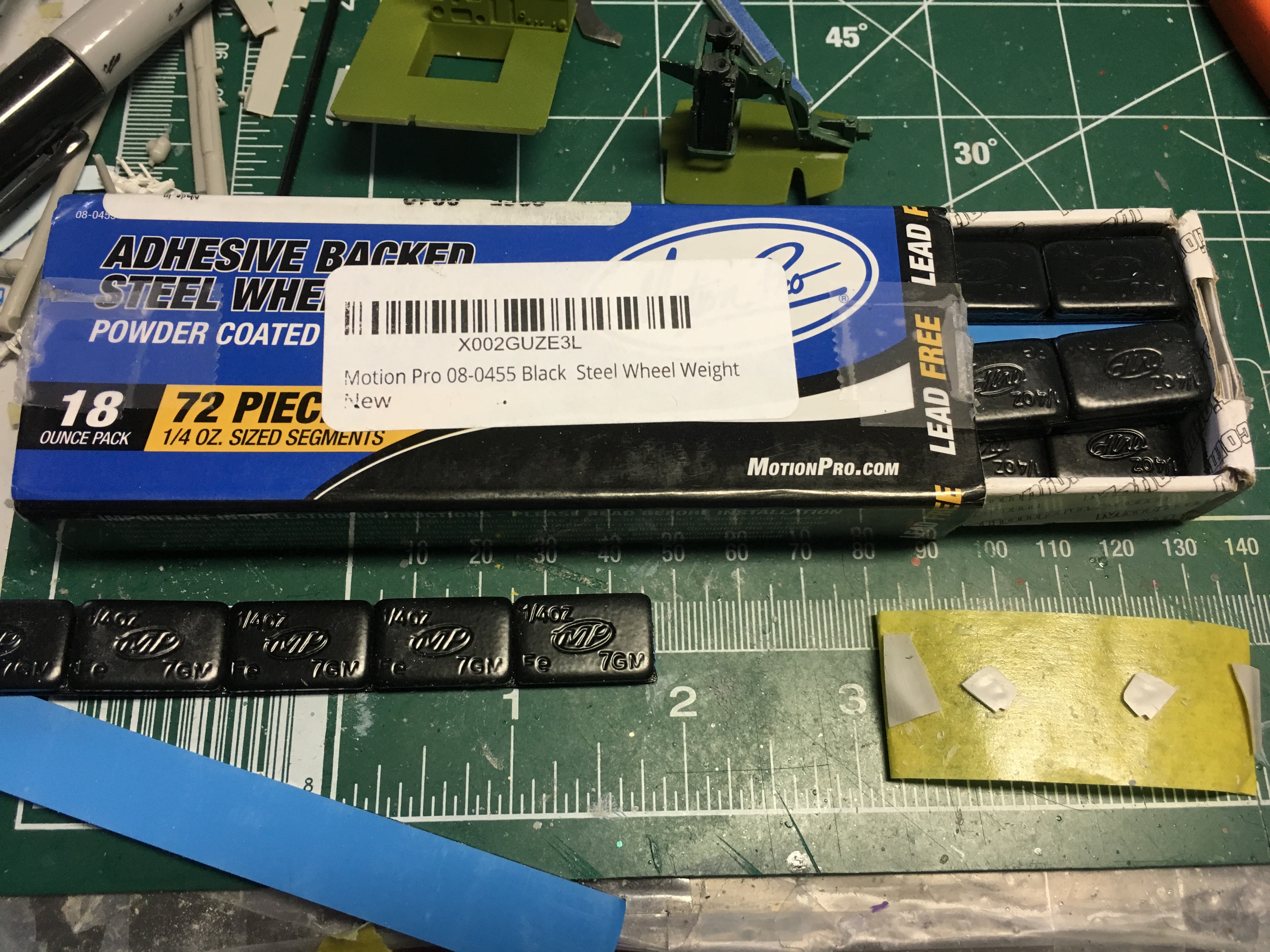

I picked up some adhesive motorcycle wheel weights to use. I haven't used them yet, but it seems like a cleaner solution to shot & epoxy/pva. At least as long as there is enough room. The motorcycle ones are pretty small though, so should work in most applications. I got mine off Amazon.

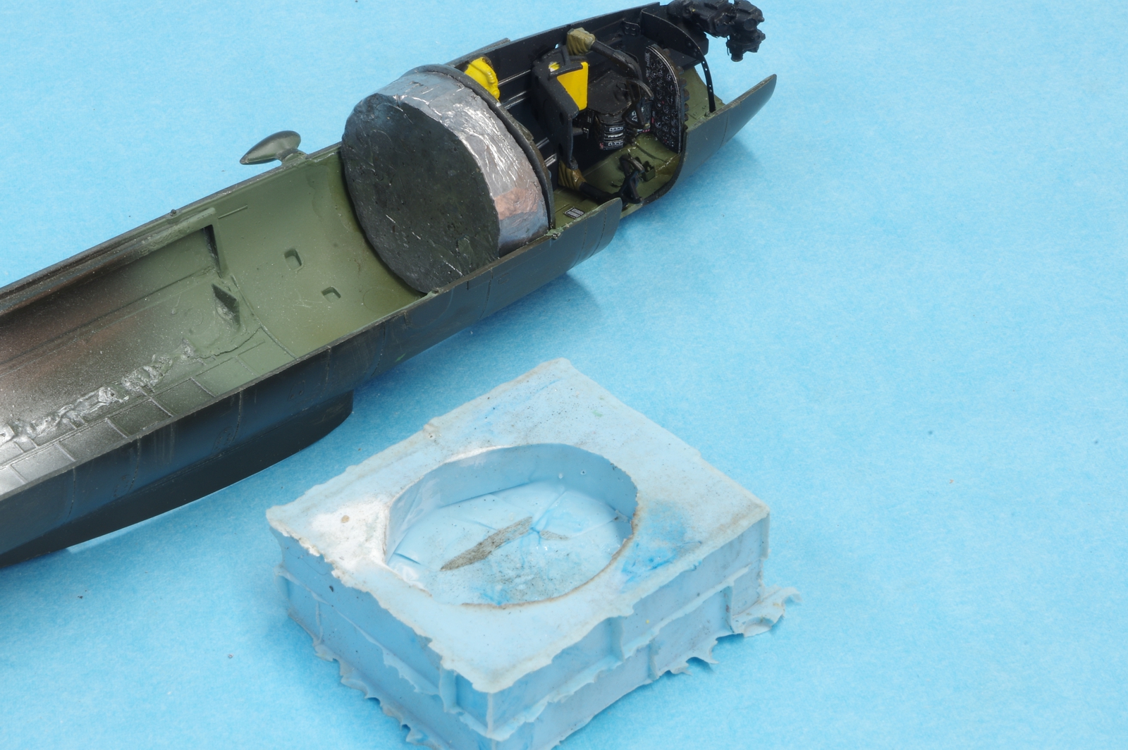

I make molds and cast my own by melting lead from fishing weights or some plumber's lead bars I have scrounged over time. Silicone mold making rubber can handle that much heat.
Once I figure out how many weights I need I mix up some epoxy put the weights in place and drool the epoxy over them.
