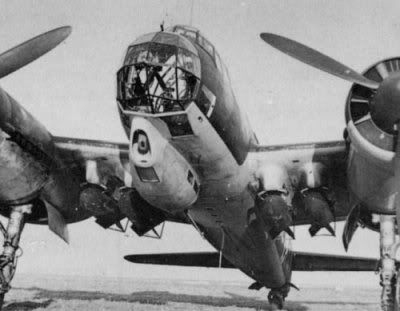

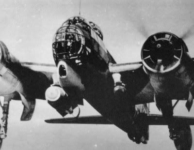

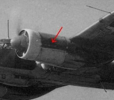

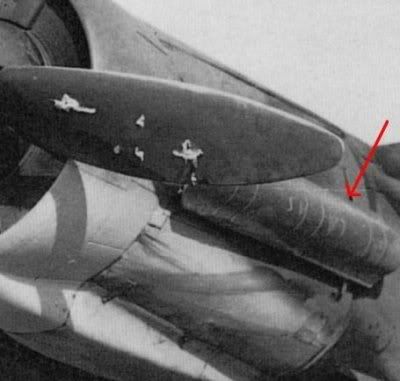

Would you by any chance know the name/internet address of the American company/store that sells the bomb racks in four? Thanks in advance! ;) Well, after the bunch of changes pointed out on Sharkmouth's post above, to make my Junkers into a Ju-88A-4, the pics I was going to post aren't needed anymore... But I'll post them anyway, just to illustrate a little this Thread! :D
Ju-88A-1 with four bomb racks
Ju-88A-4 with two bomb racks
Ju-88A-1 exhaust with no flame hider
Ju-88A-4 flame hider
