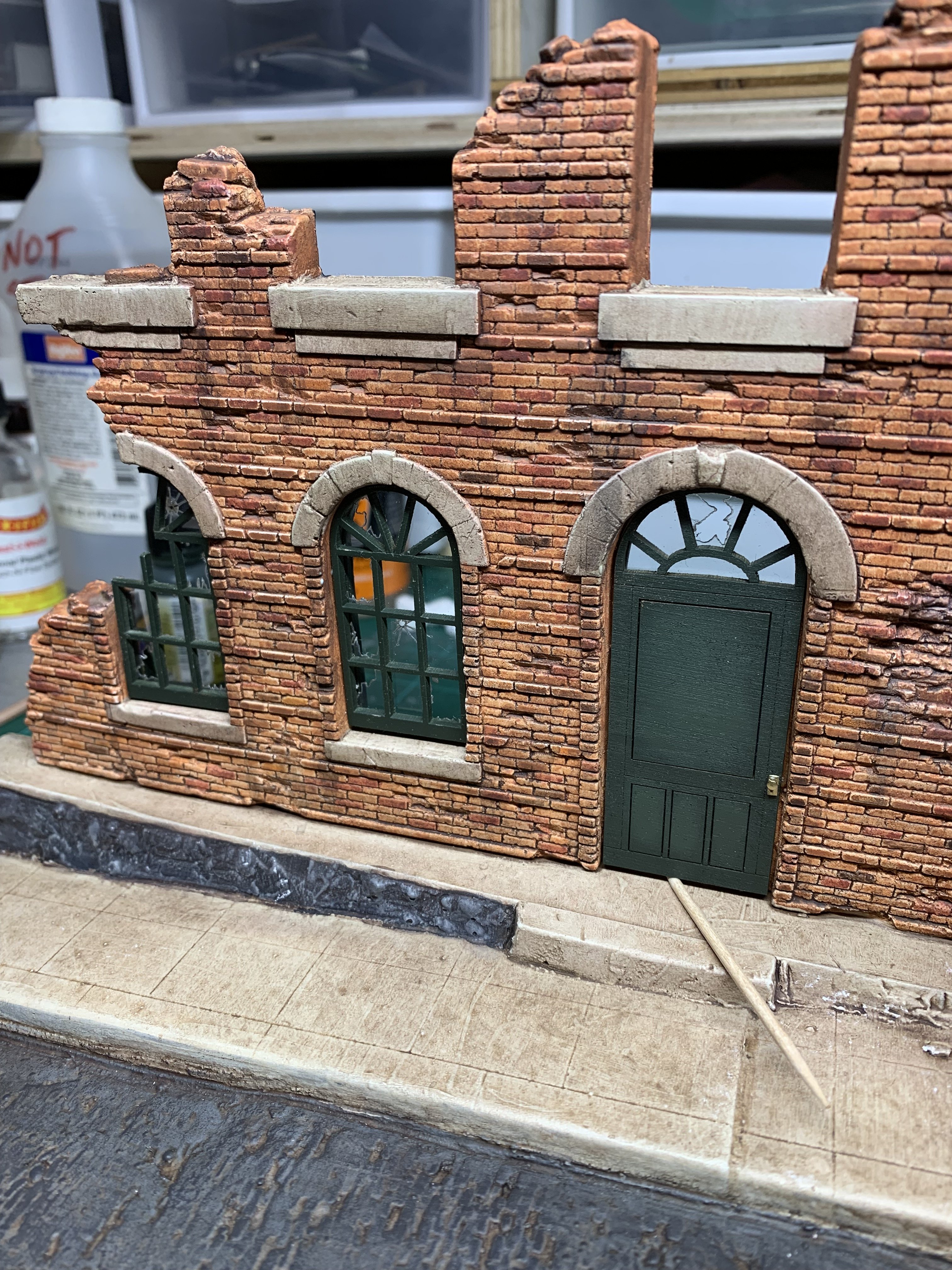

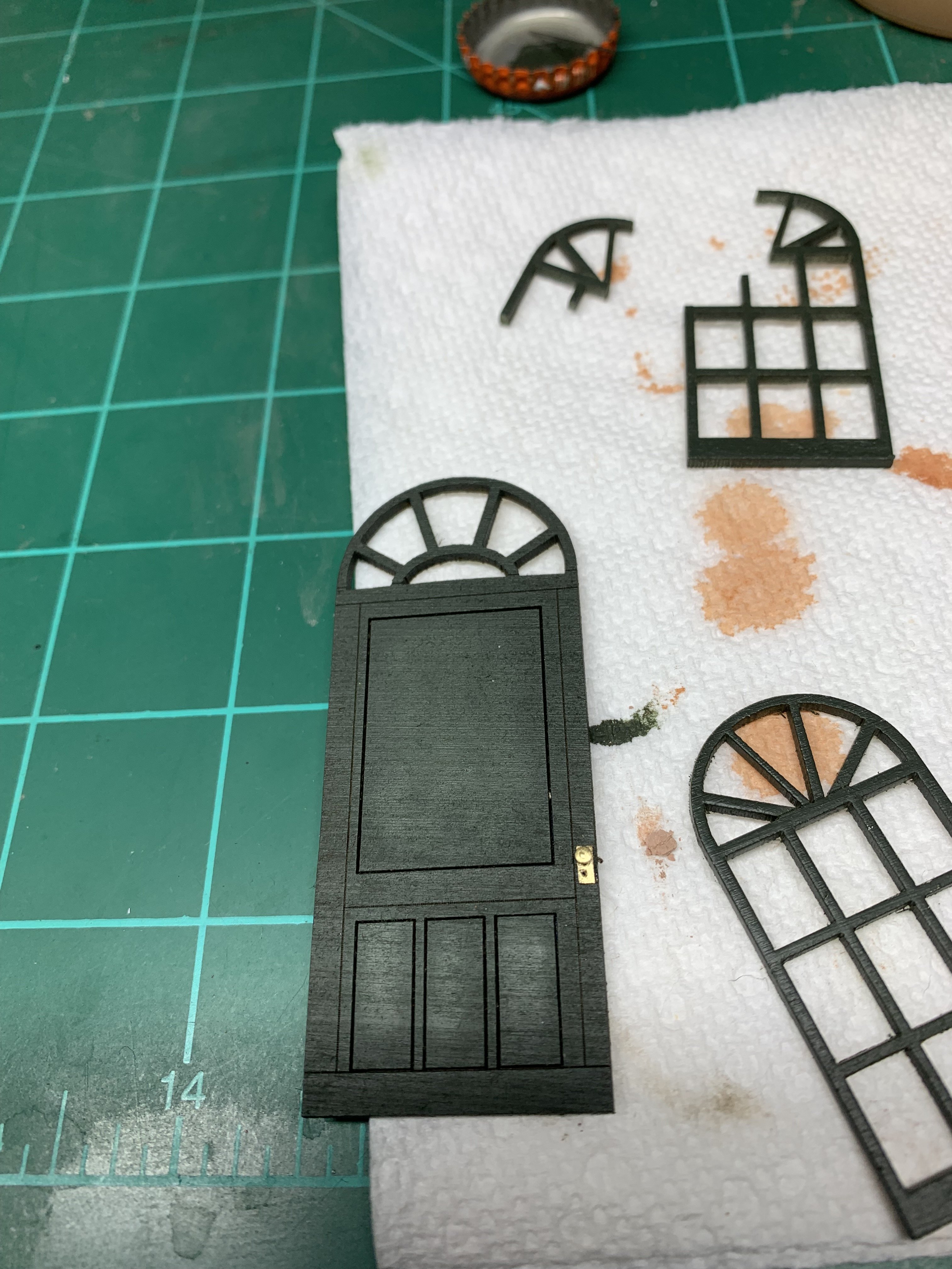

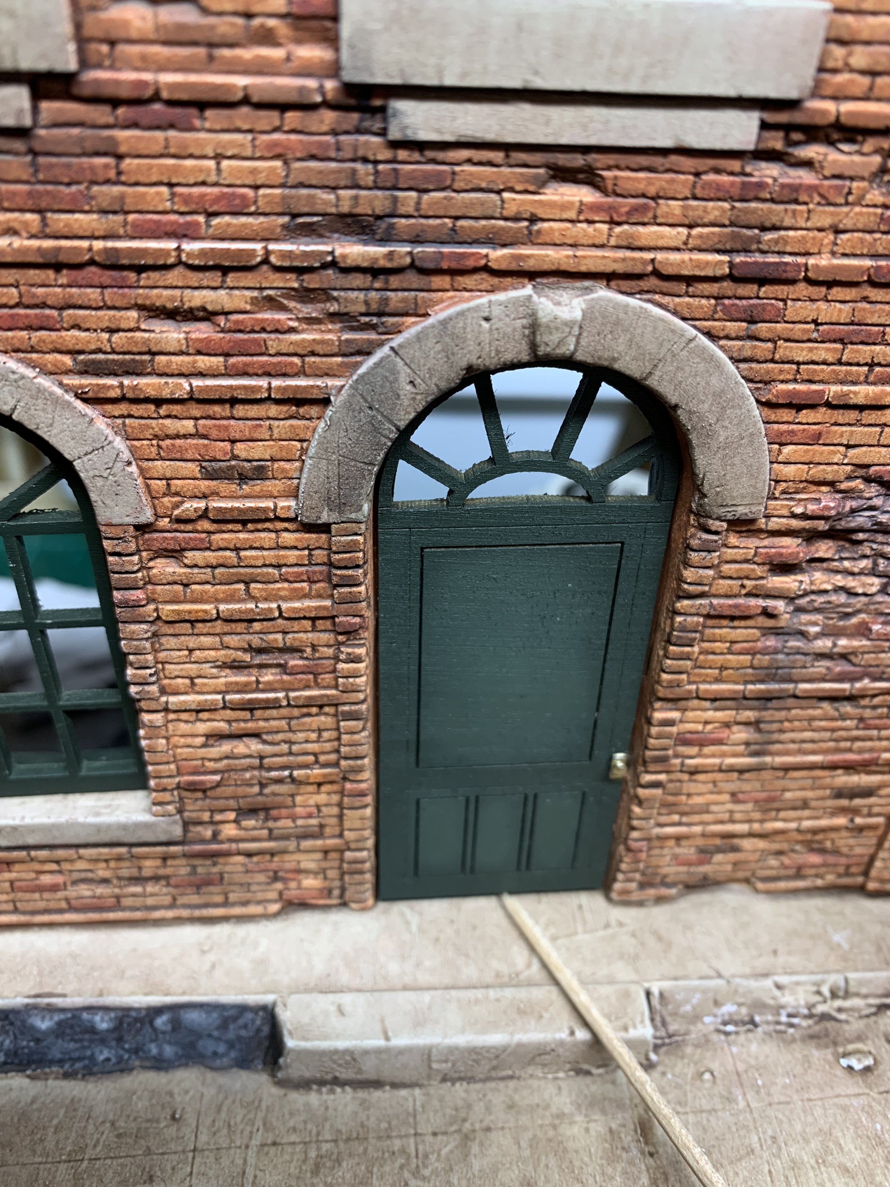

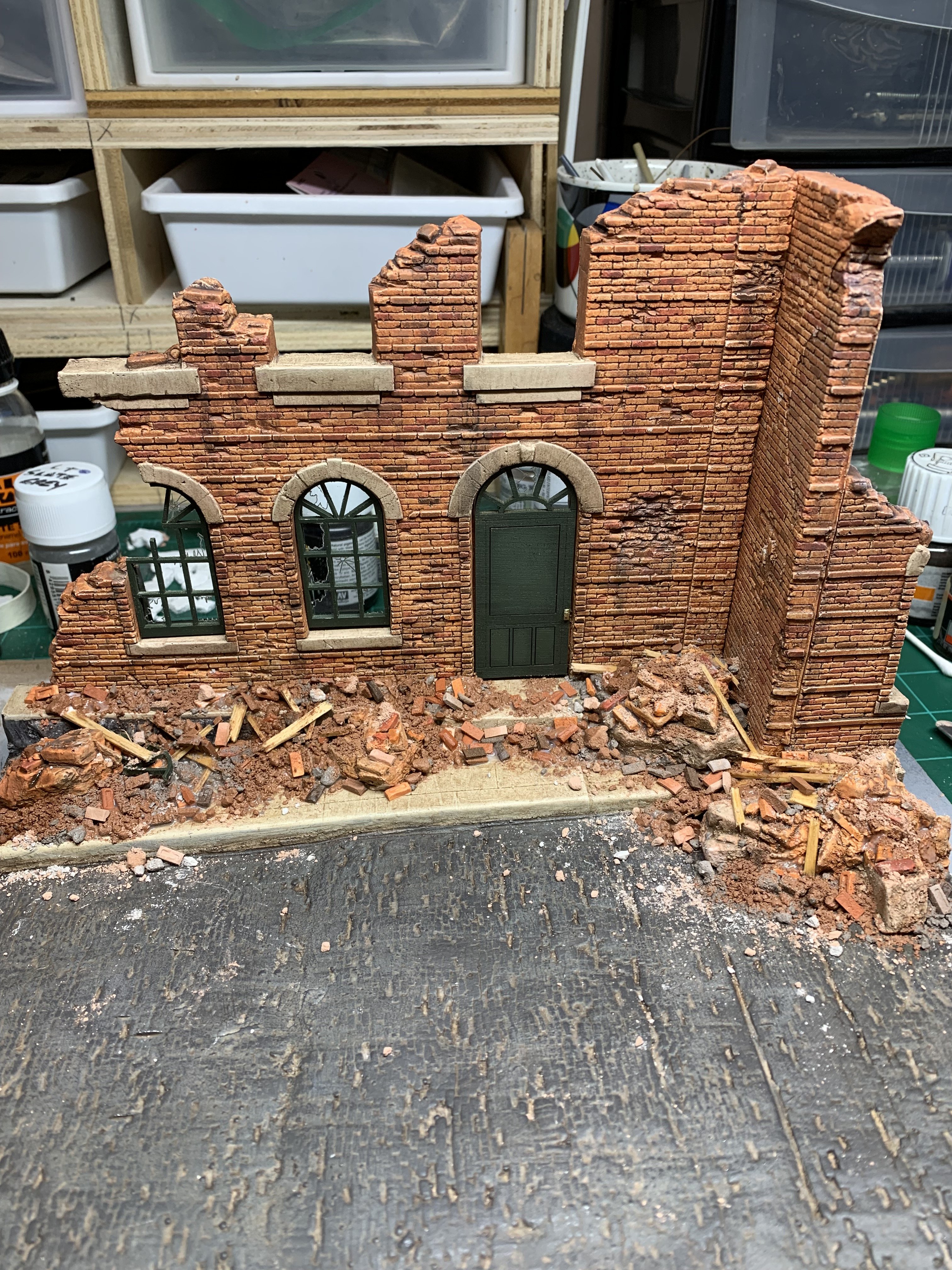

That is beautiful! Stunning work! Man, I'd love to have something like that for my models. I agree about the door. Perhaps the 'wrongness' you see is the fact that the grain goes sideways. Every natural wood door I ever restored has always had the grain going up and down on the main part of the door.

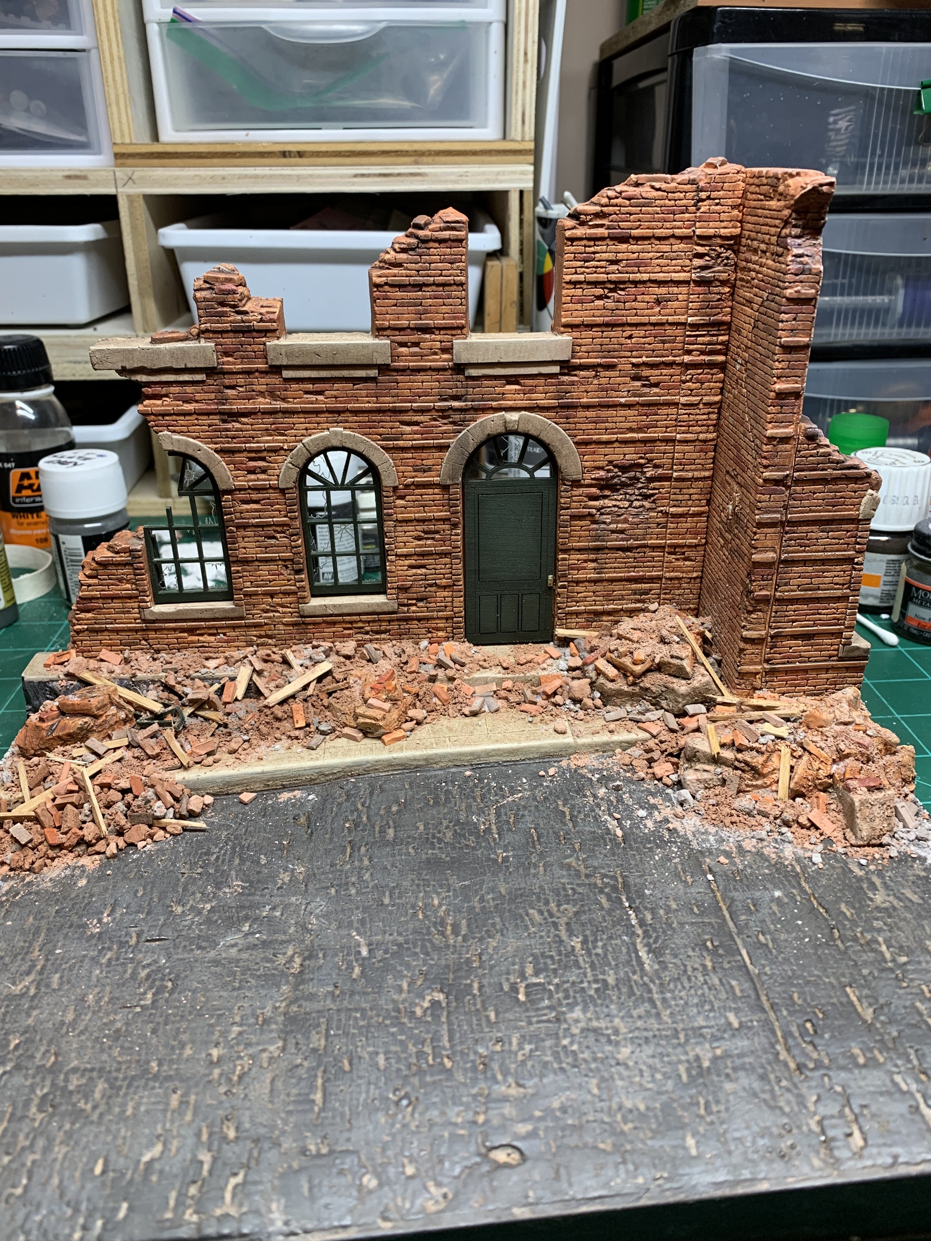

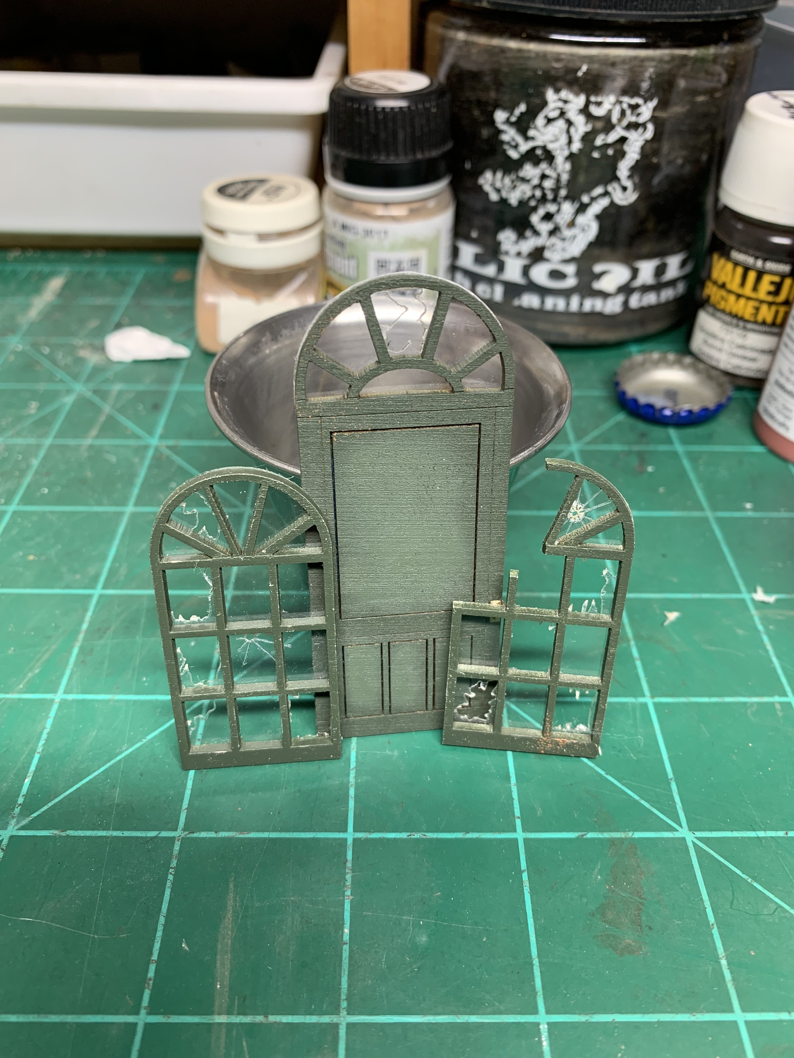

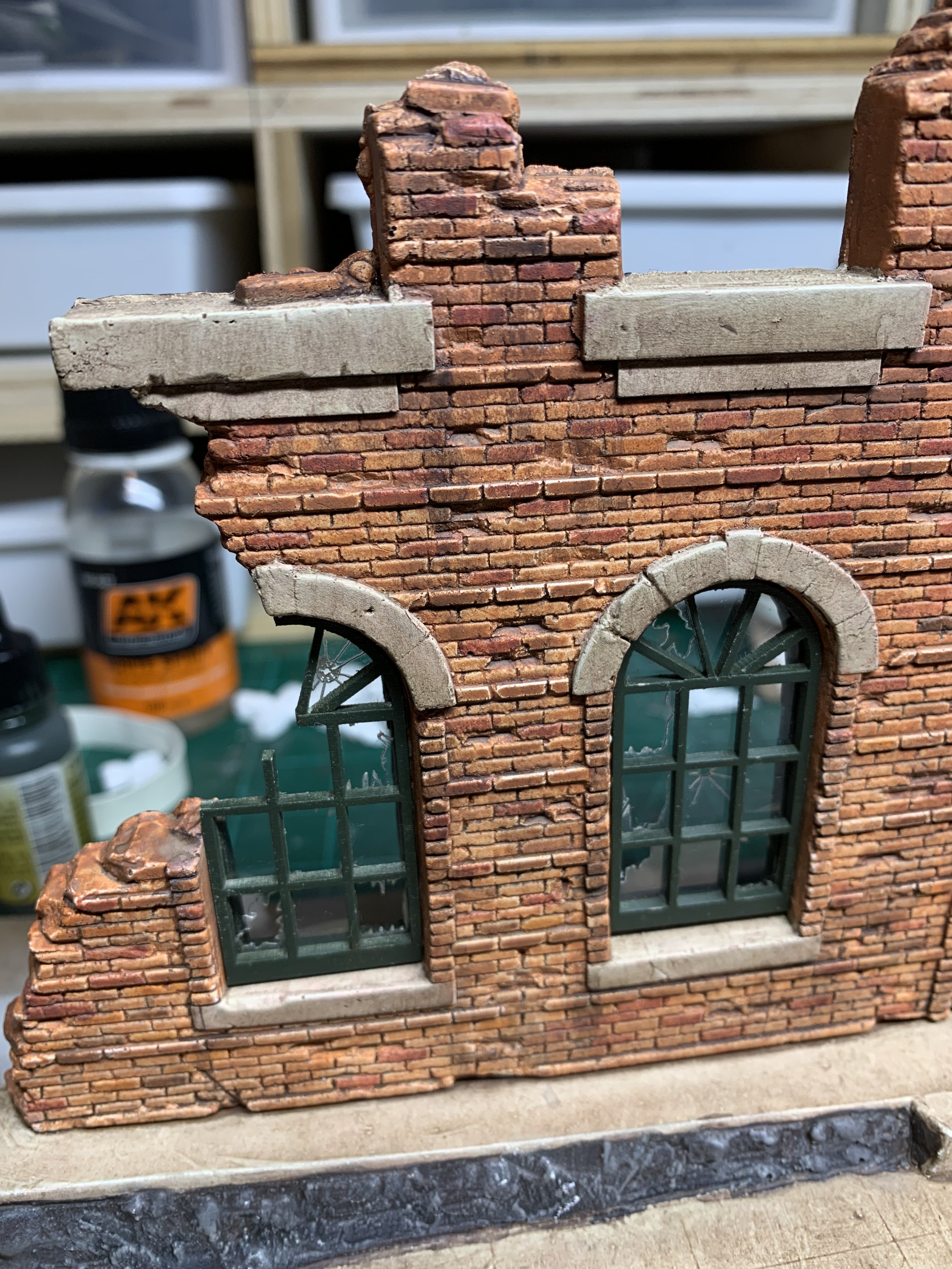

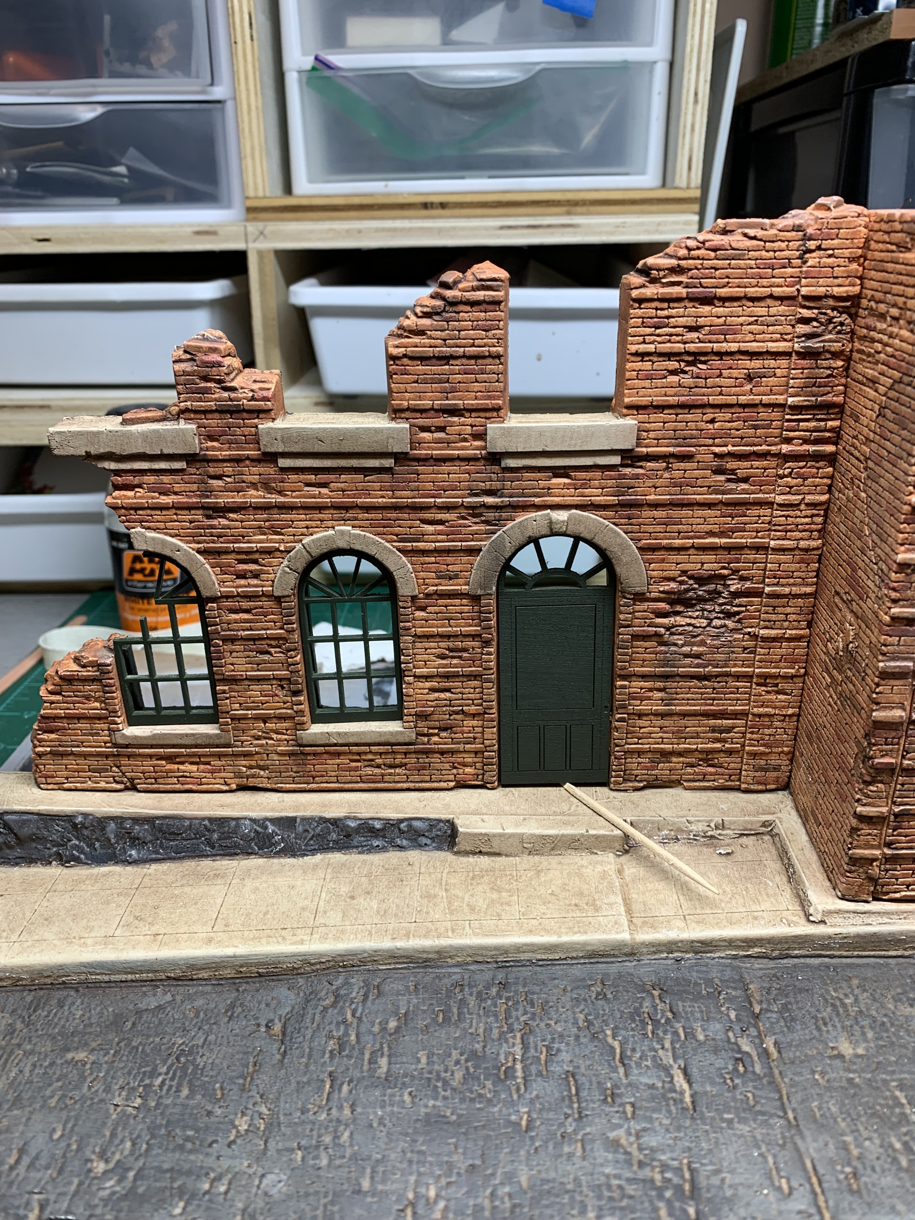

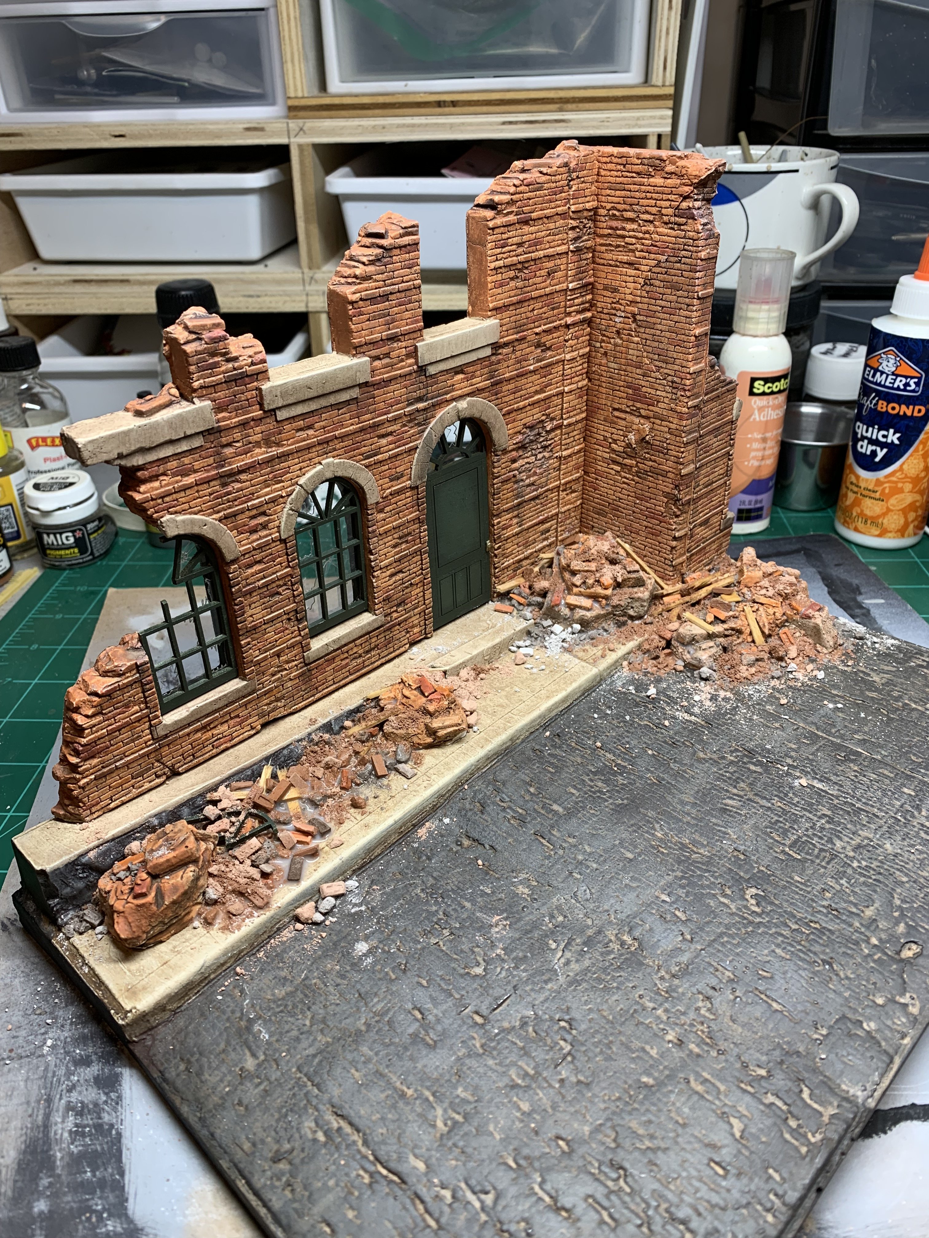

Many thanks, my friends! This has been a fun project, loads of new stuff to try. I spent to day working on the windows and door, the rubble piles and more bricks. I called in for a consultation on the trim color, I think this will do the trick.

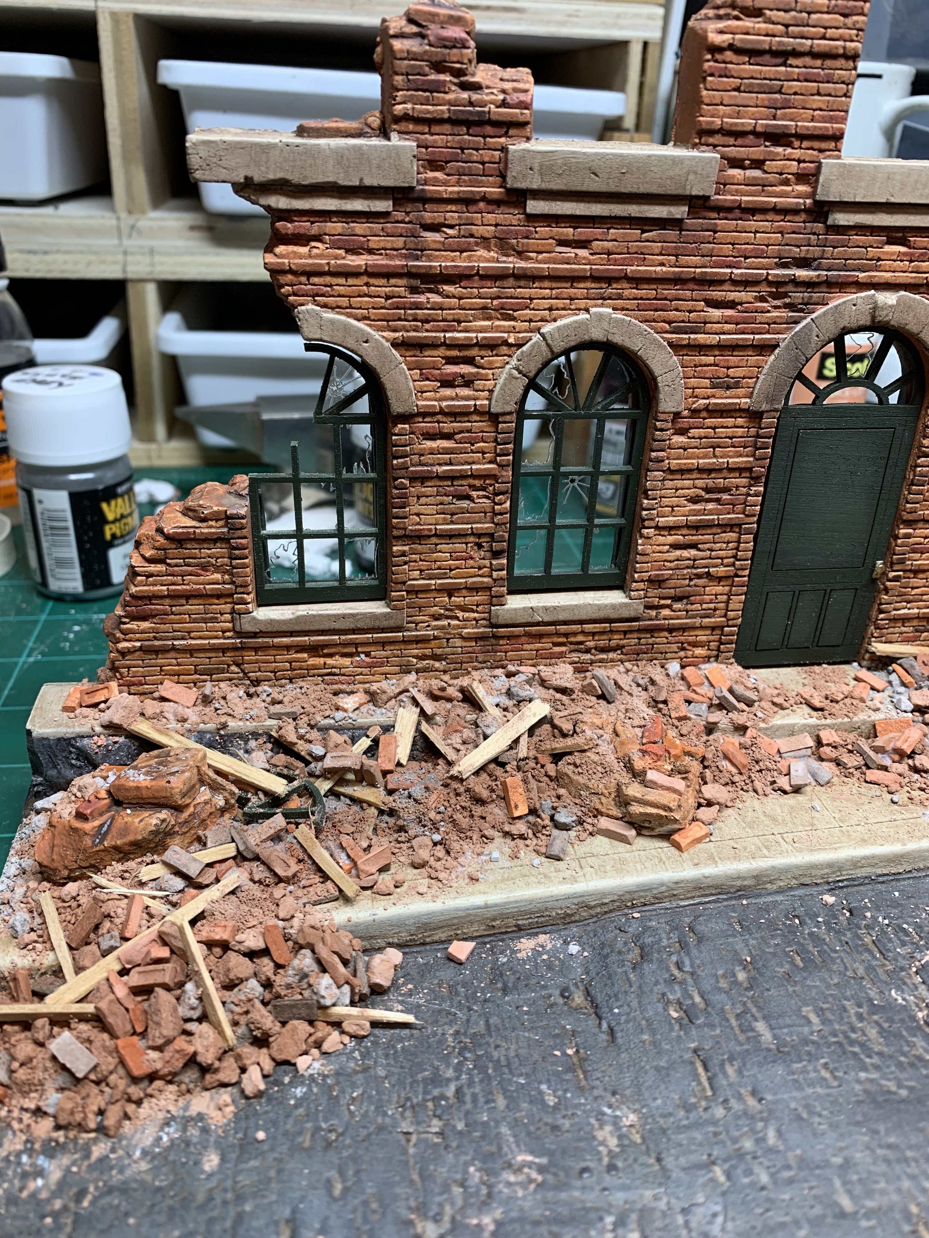

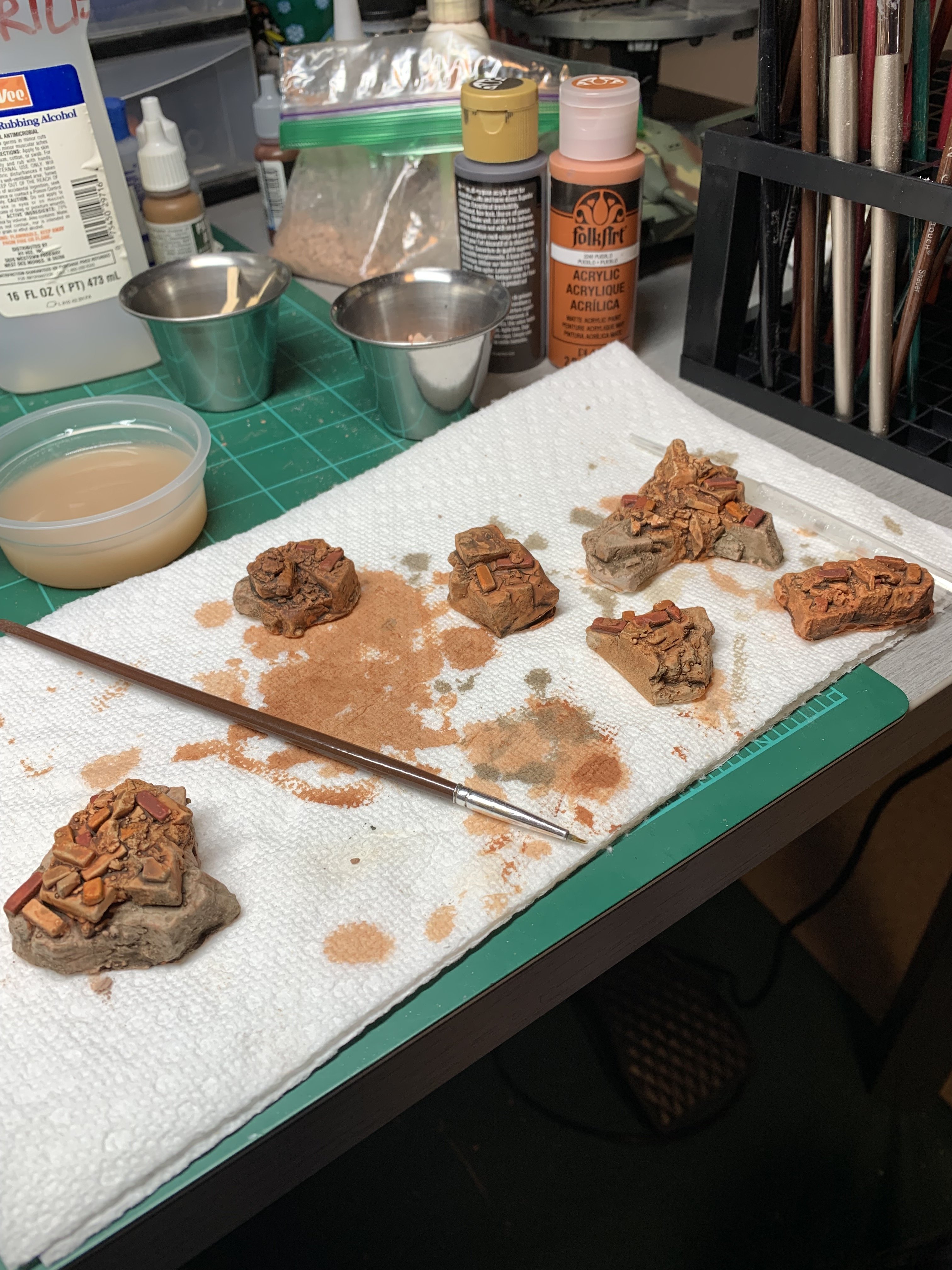

While that was drying, I painted rubble piles.

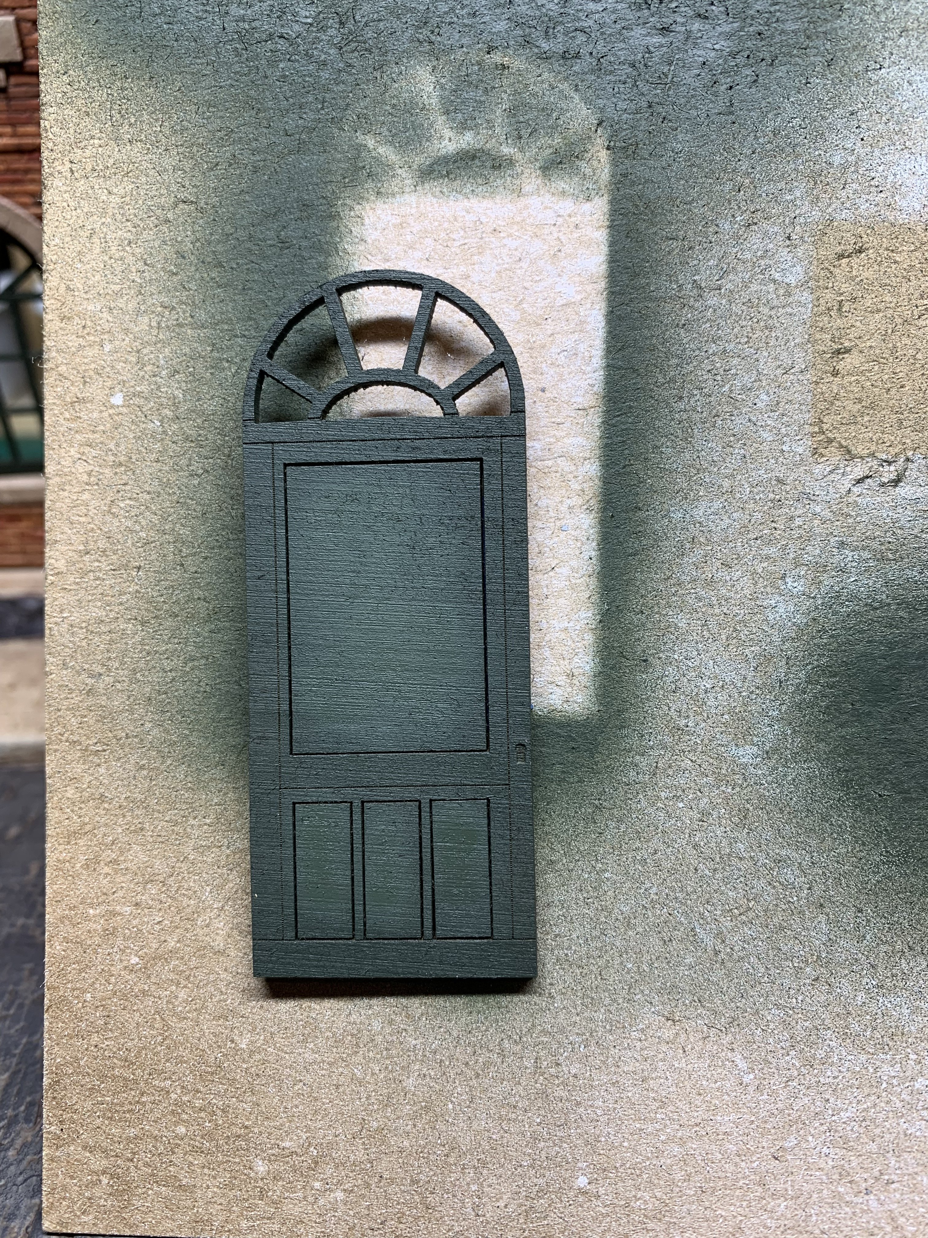

After discussing the door color with Eric, I decided to add some highlights.
Made a door knob from a straight pin and strip styrene, yes, there's a keyhole.
Seems counter productive to put busted glass into a window...
With everything glued in place, the toothpick is just a shim while glue dries.
It was at this point my buddy Greg says, "I think the windows should be a lighter color." I responded in Marty Feldman voice "Too late." Damn, just like at work!
Anyway, that's what I did on the first official day of vacation. More to come, thanks for coming by!

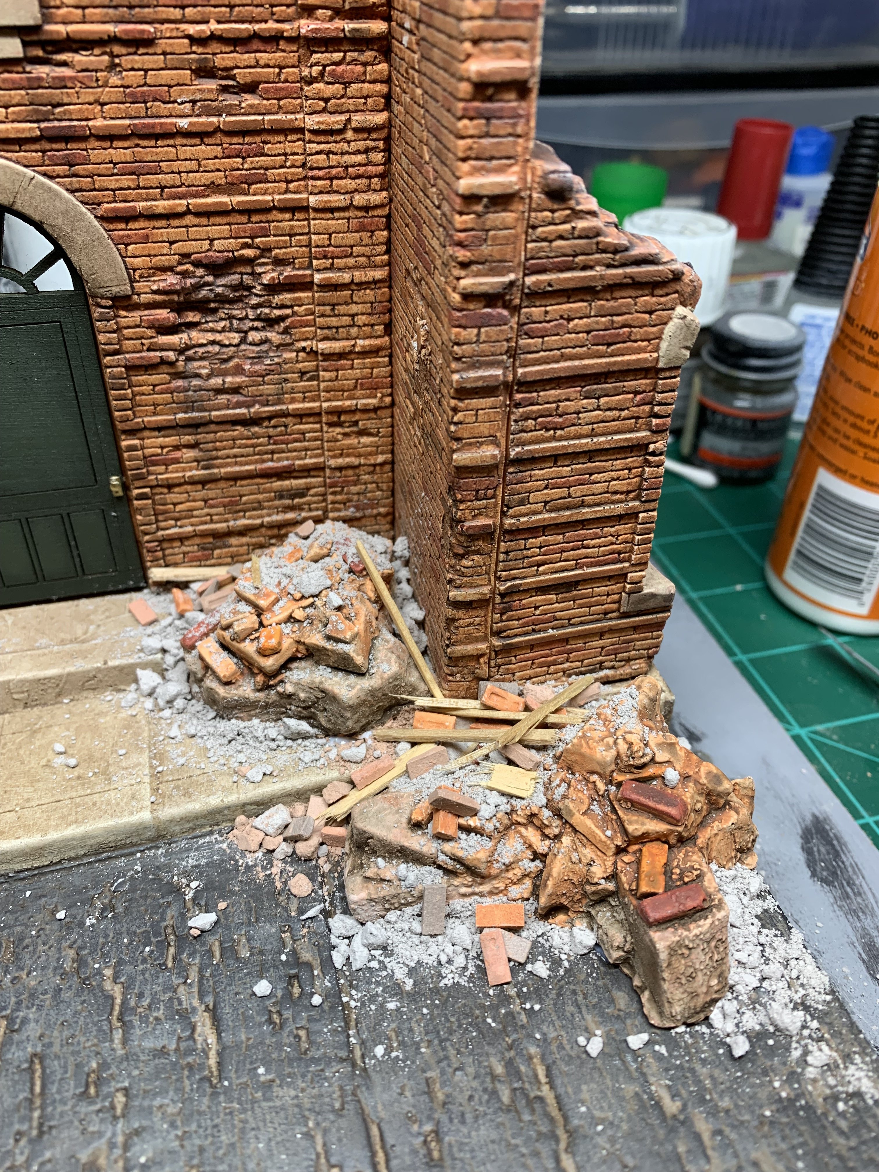

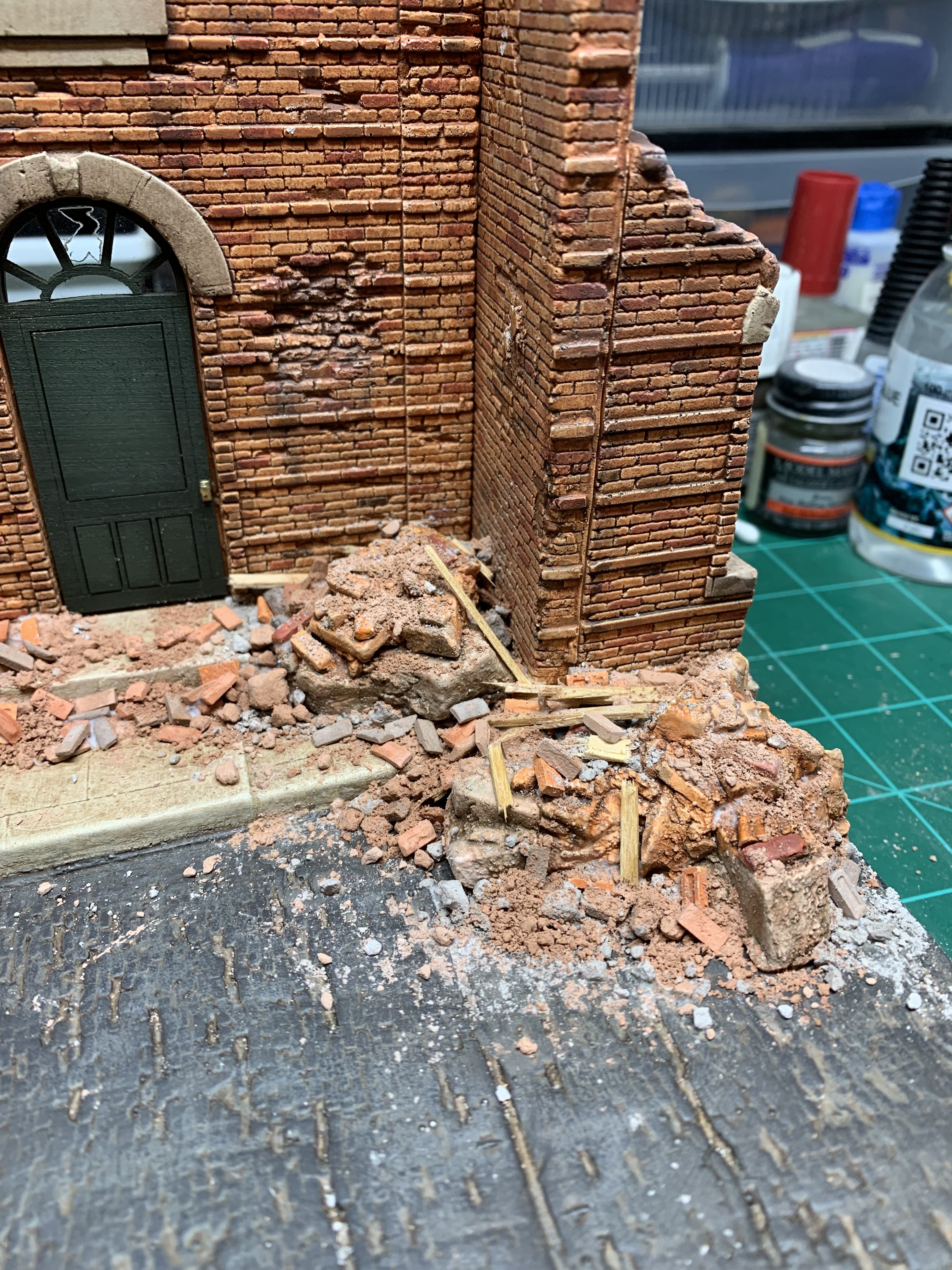

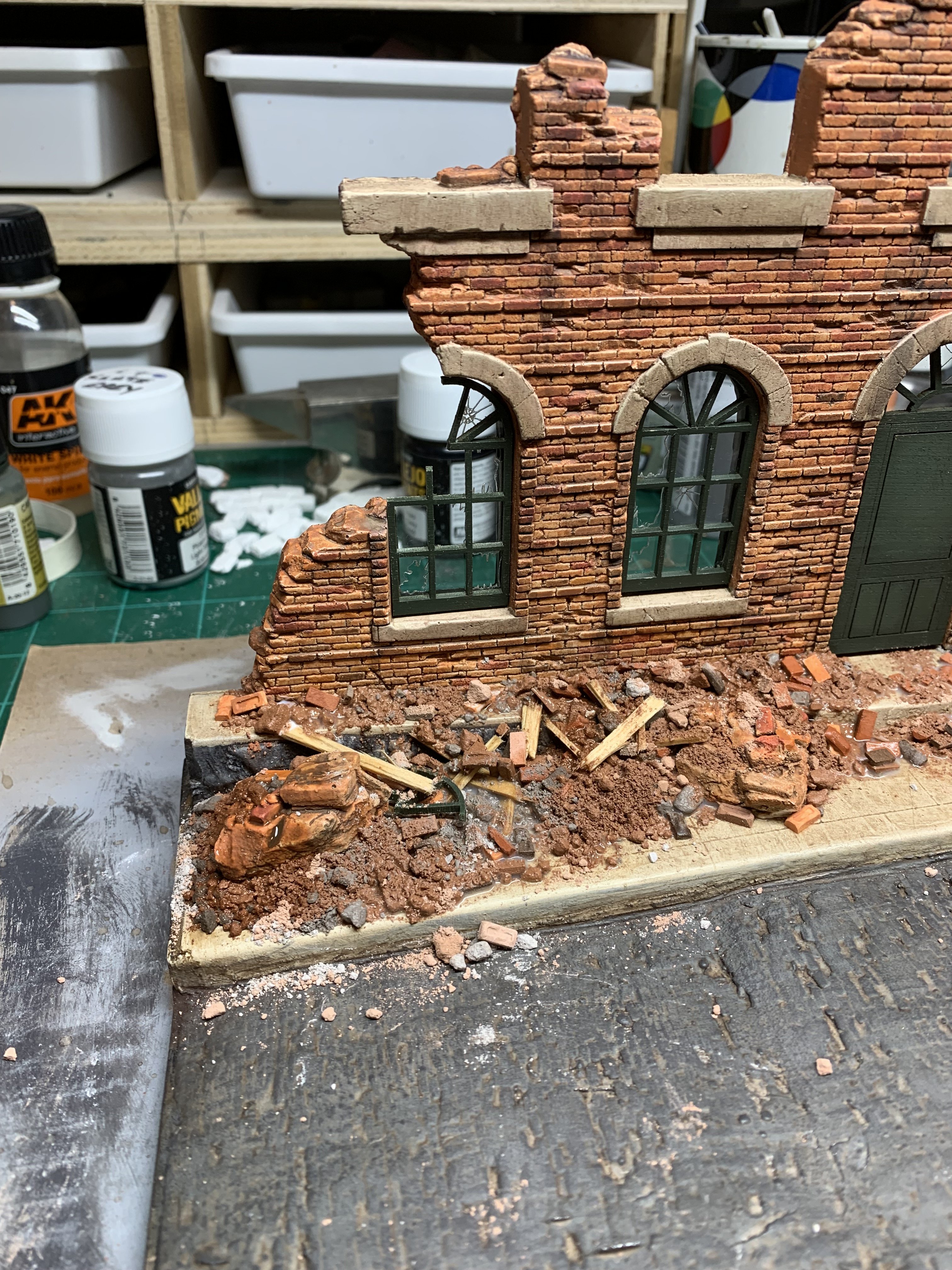

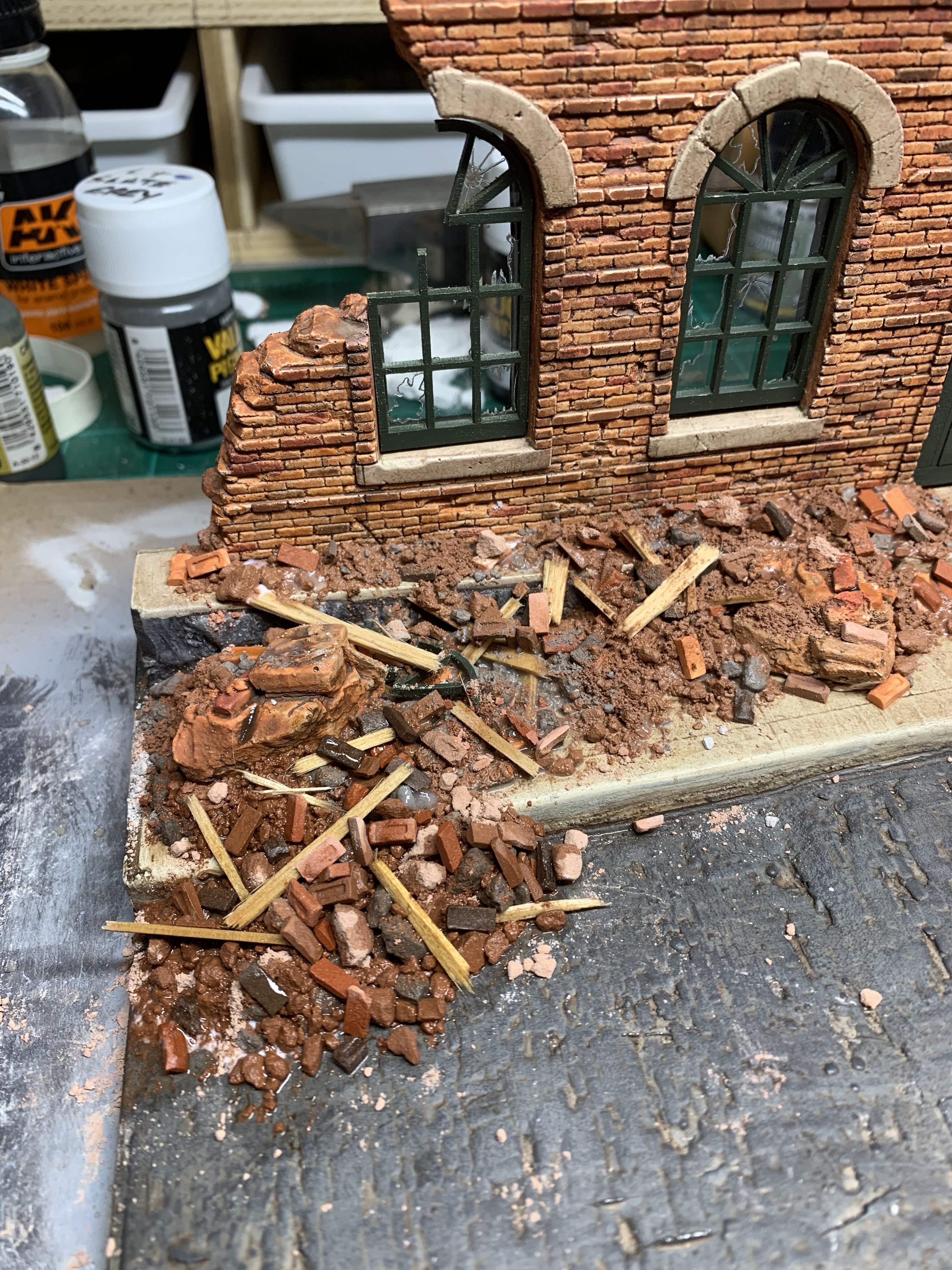

Thanks guys, I appreciate the comments! Yesterday was pretty productive, I spent most of the day at the bench. Those rubble piles that came with the kit were a good starting place, they helped me gauge where the piles needed to be and added volume and height to the piles.

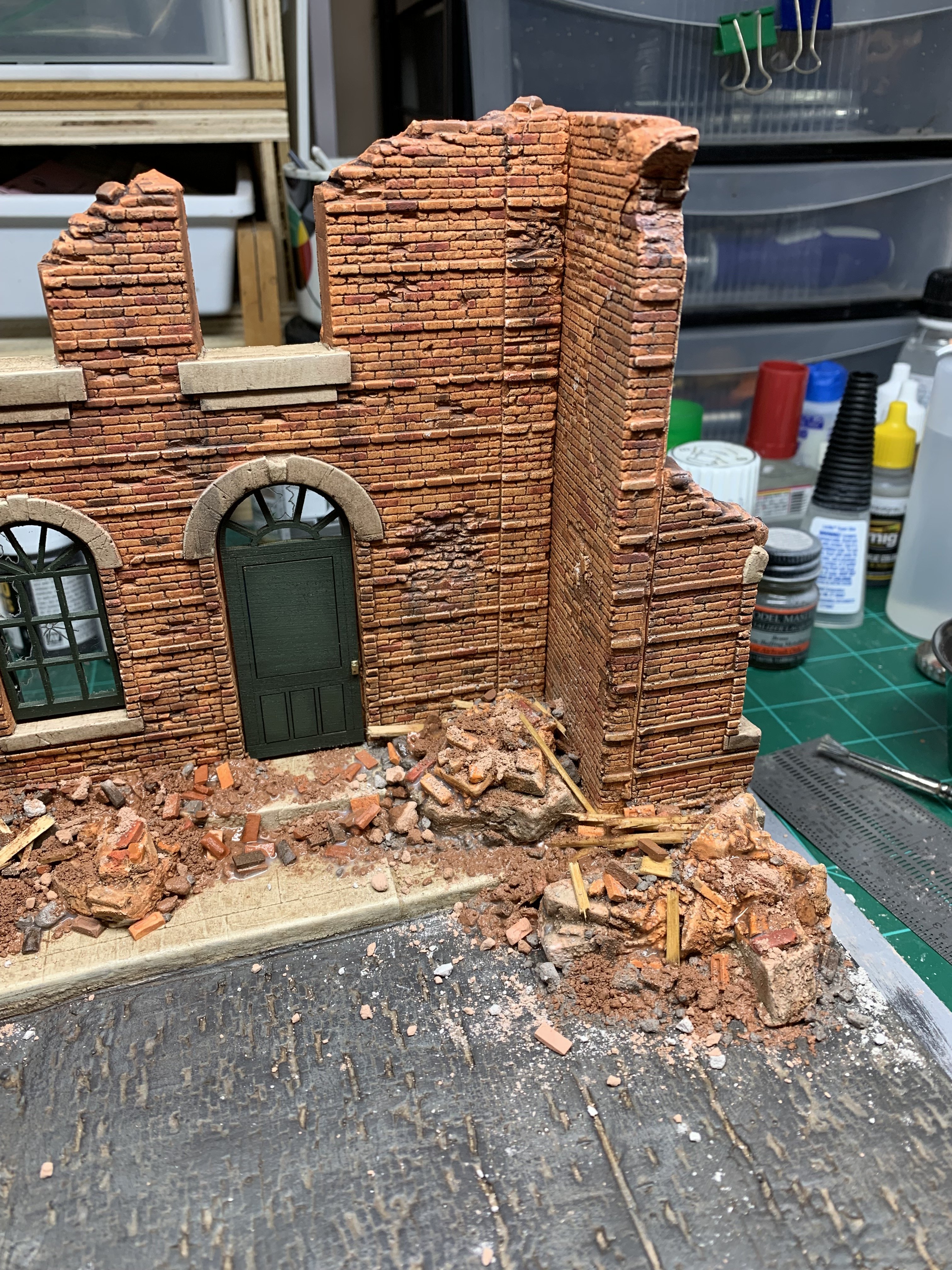

I started adding my homemade bricks, broken concrete and wood (coffee stir sticks) until I got the look I was going for. I then wet the piles with a blend of 1/3 isopropyl alcohol and 2/3 water, followed by a squirt of 1/3 Elmer's glue and 2/3 water. I added some additional crush brick material to tone down some of the gray. It looks pretty dark while wet, but stay the course.
That's where I left off yesterday afternoon. This morning, it has dried quite a lot and looks pretty good, if I do say so.
I will add more scatter after the tank is in place. More to come, thanks for coming by!

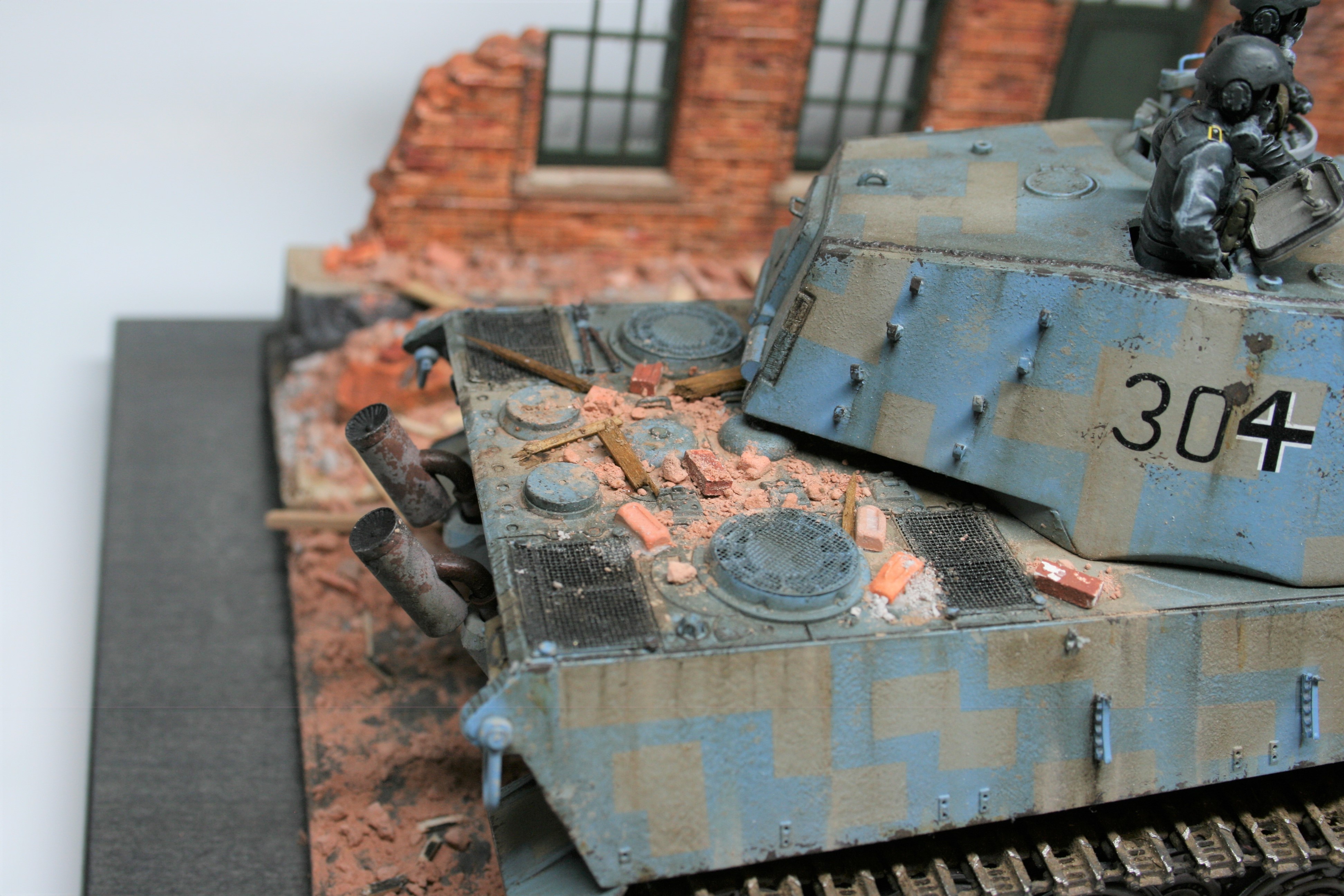

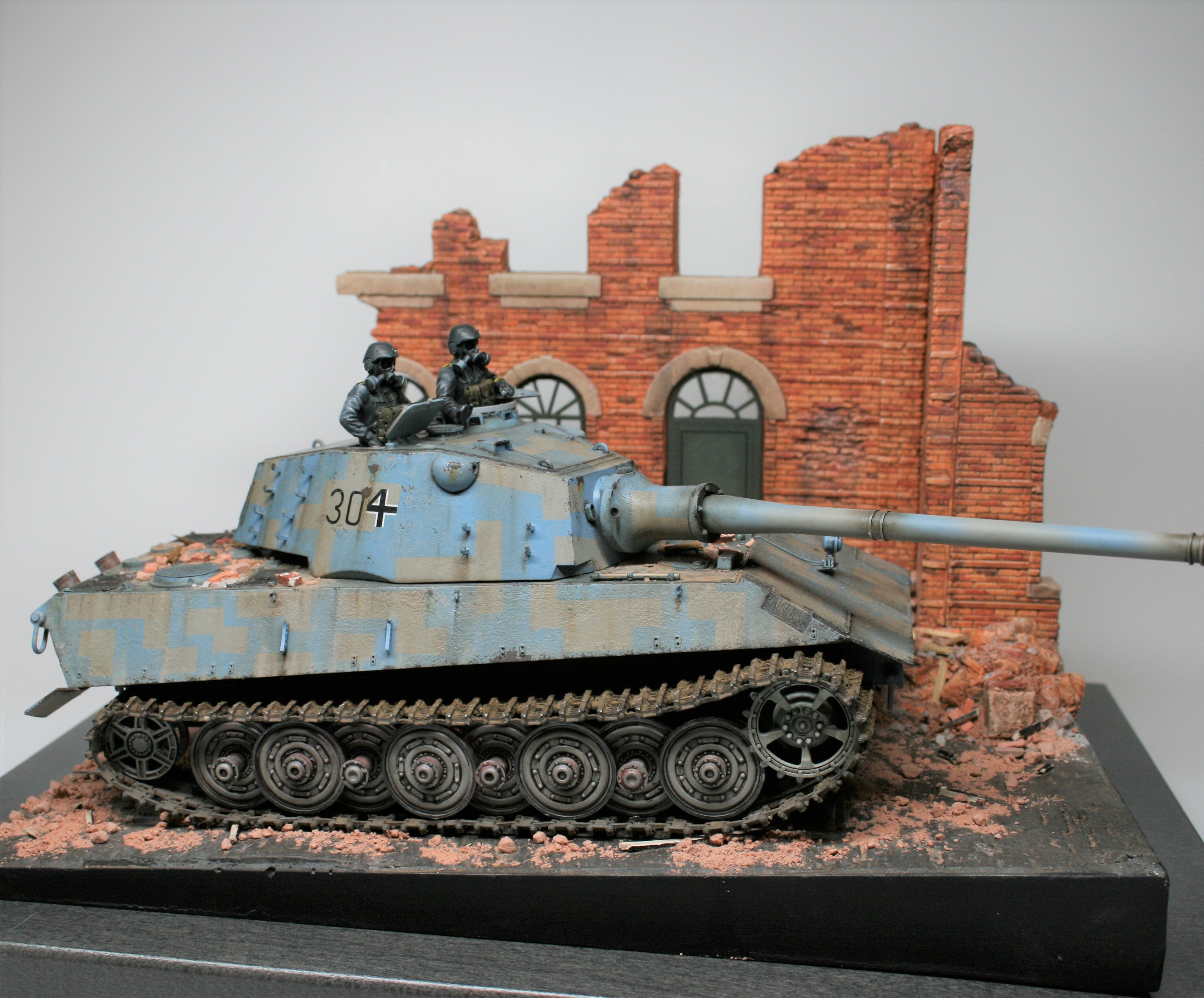

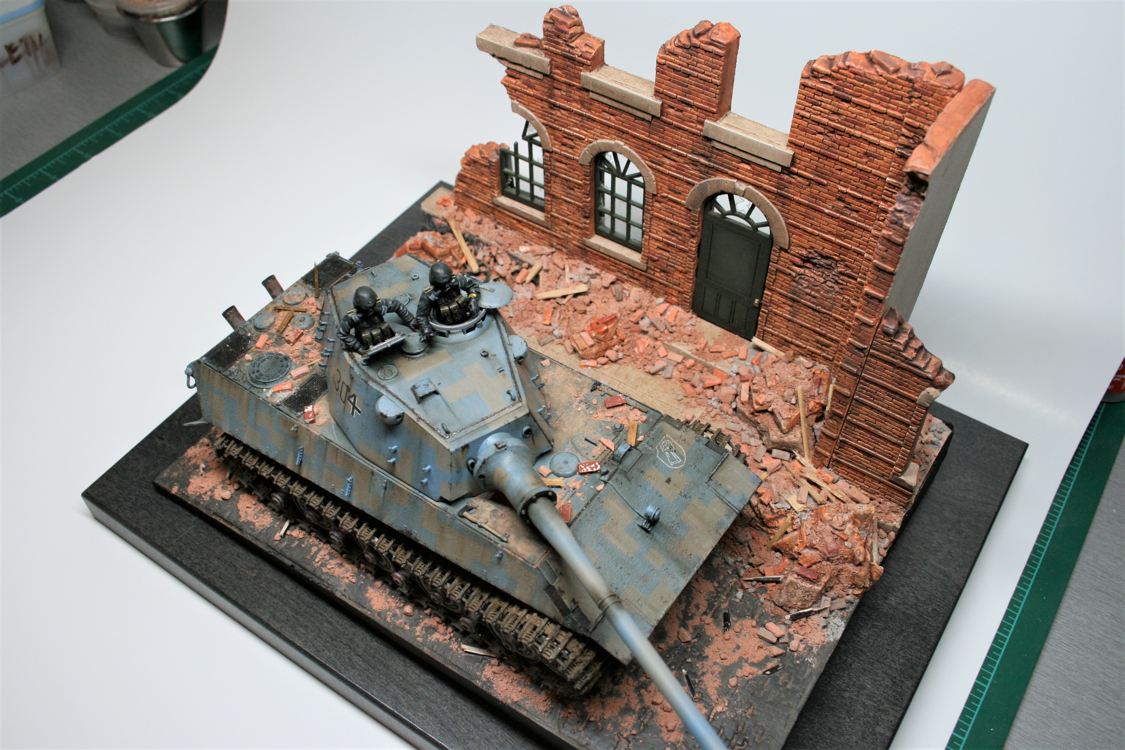

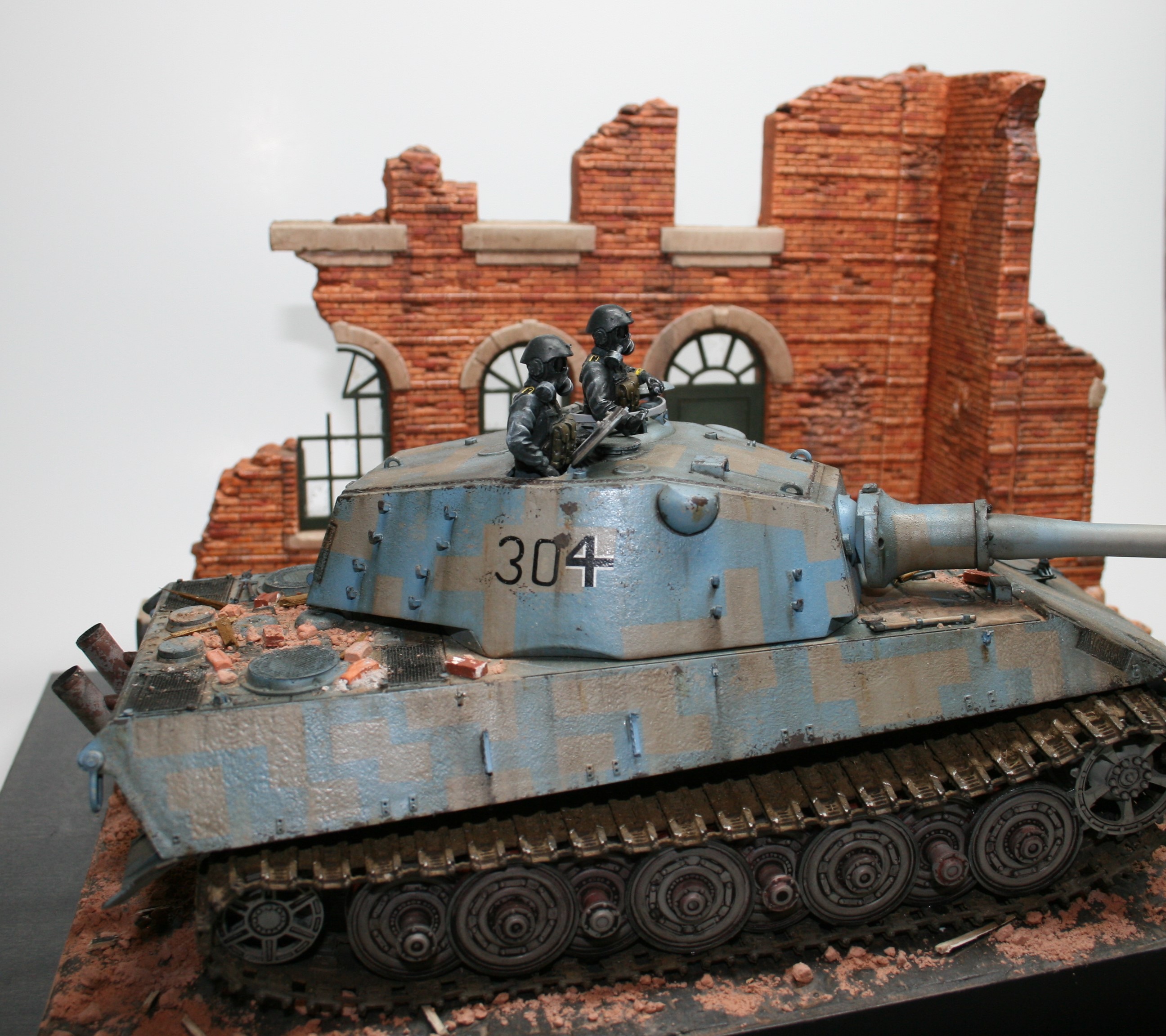

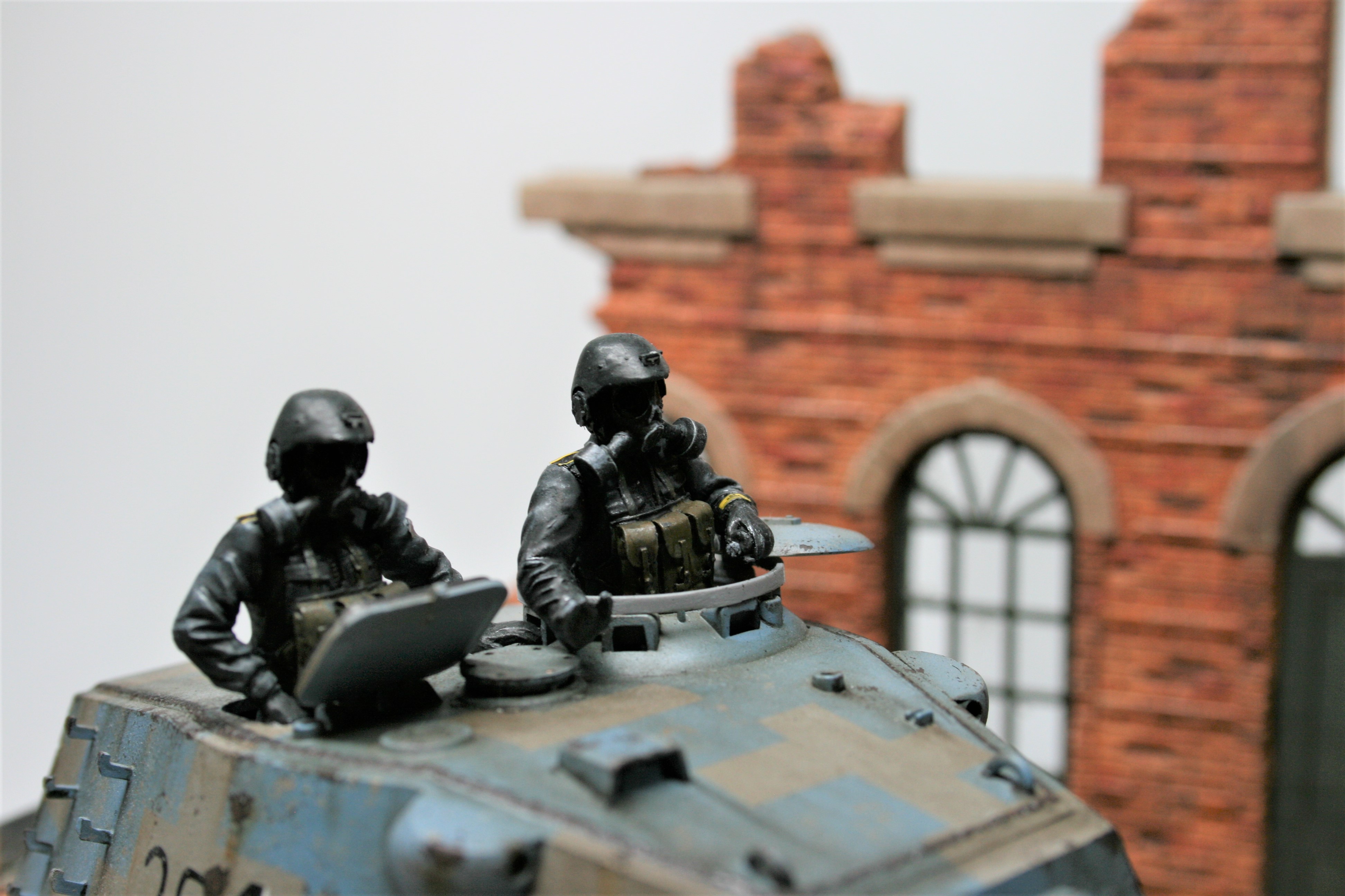

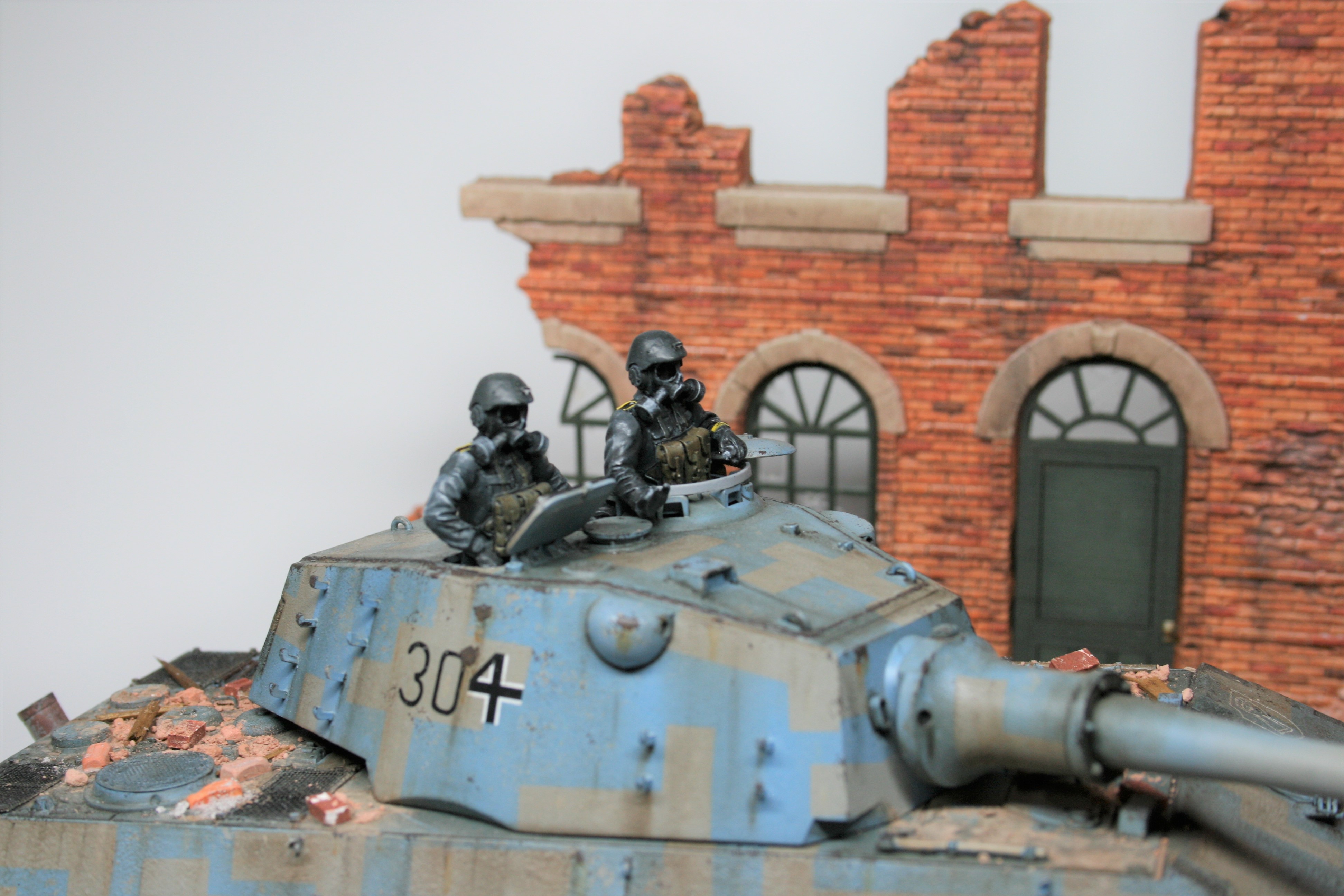

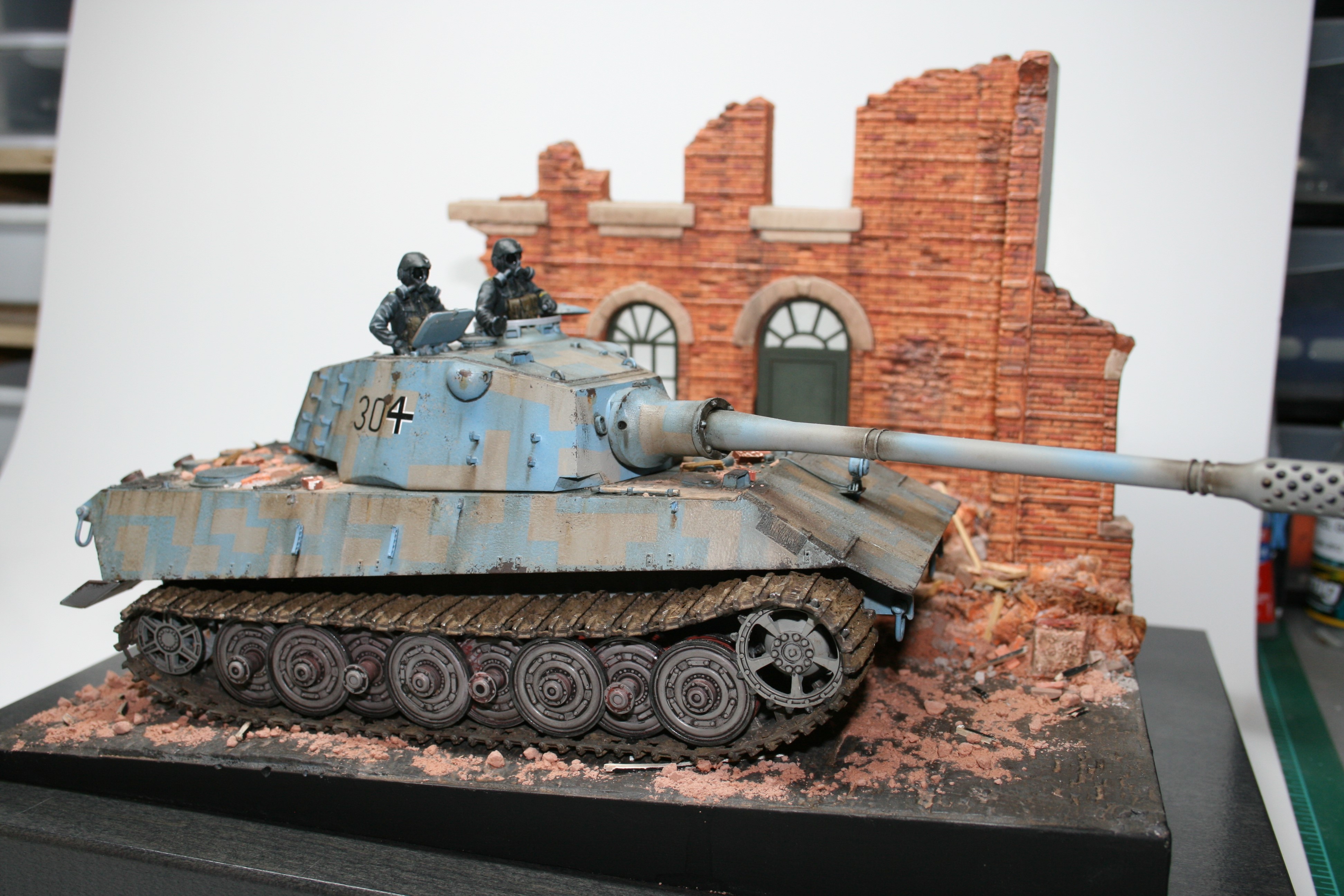

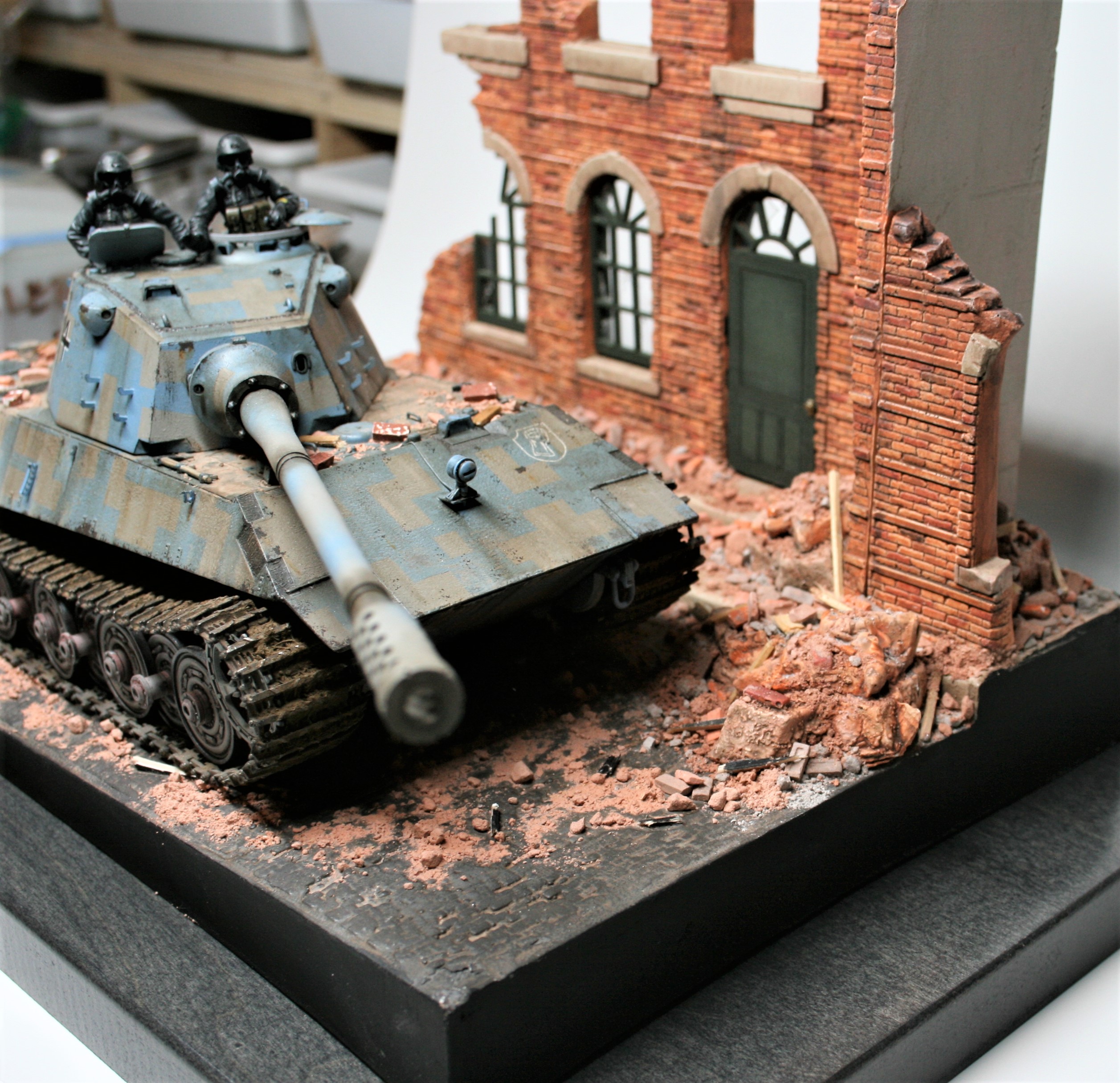

Thanks guys! It's been awhile since I took time to shoot any progress photos and now I'm just calling this one done. I added more rubble, a pair of sinister figures from MaiM and a finished base for the whole thing to sit on.

Other than the kit barrel and tracks issues, this was a pretty good kit, but definitely not a slap it together build. I learned a lot along the way, trying new stuff is a stretch, but in a good way. Thanks again for following along.
:Drinks:
That looks great Mike! I think you nailed the rubble and the contrast of the tank to the building looks great too. Very nicely done!
:tens:
Most excellent Mike!! The whole build look really great. The camo is really kool and not in your face...which is a good thing.
:tens::tens::tens:
The tank is very convincing, love the weathering and all but it really gives the impression of heavy iron. I hope I learned something about the rubble from watching how you did it.
