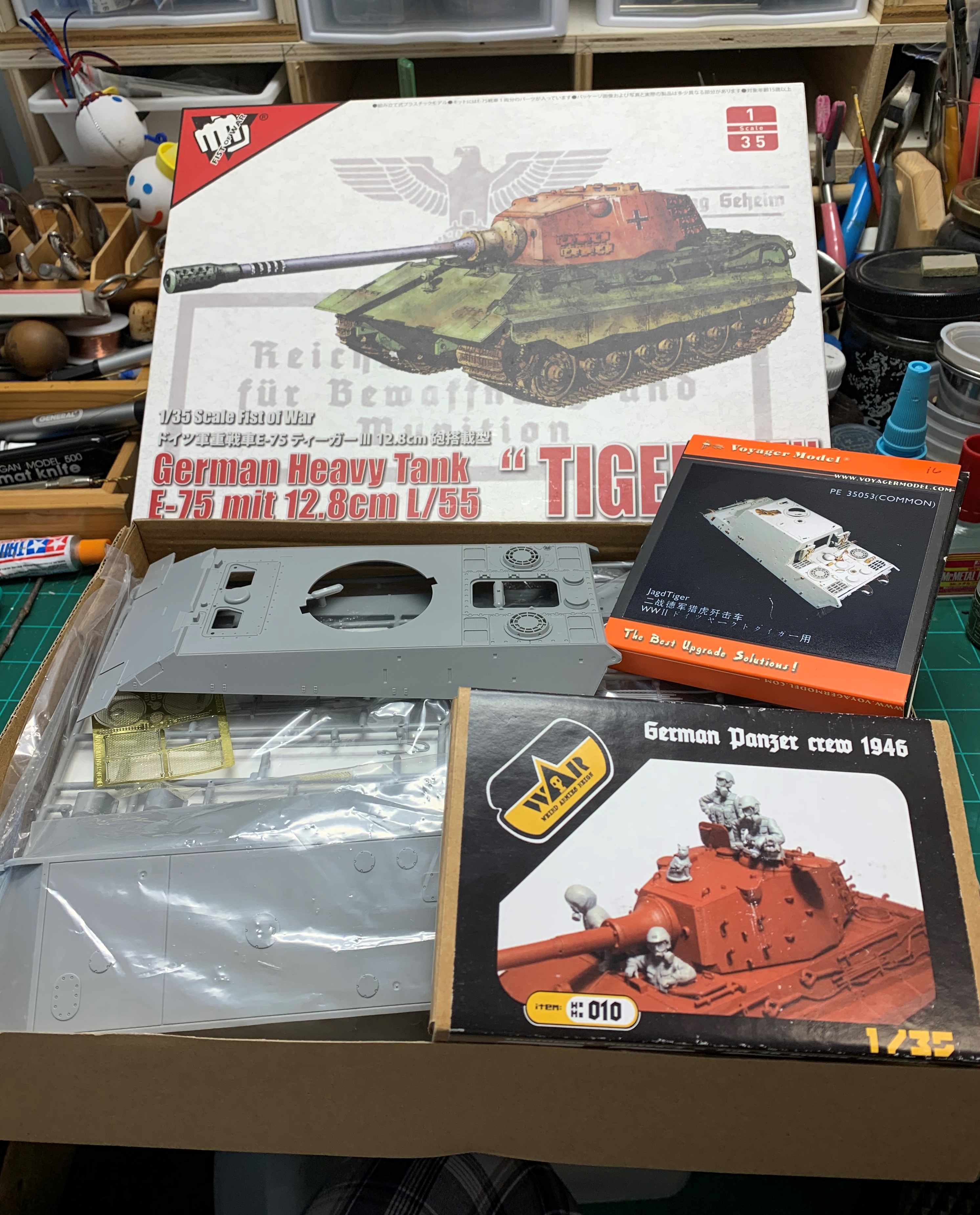

Thanks men! So I had every intention of painting camo on the Luchs today. but just felt like building something instead. Here's my start up photo of the Tiger III.

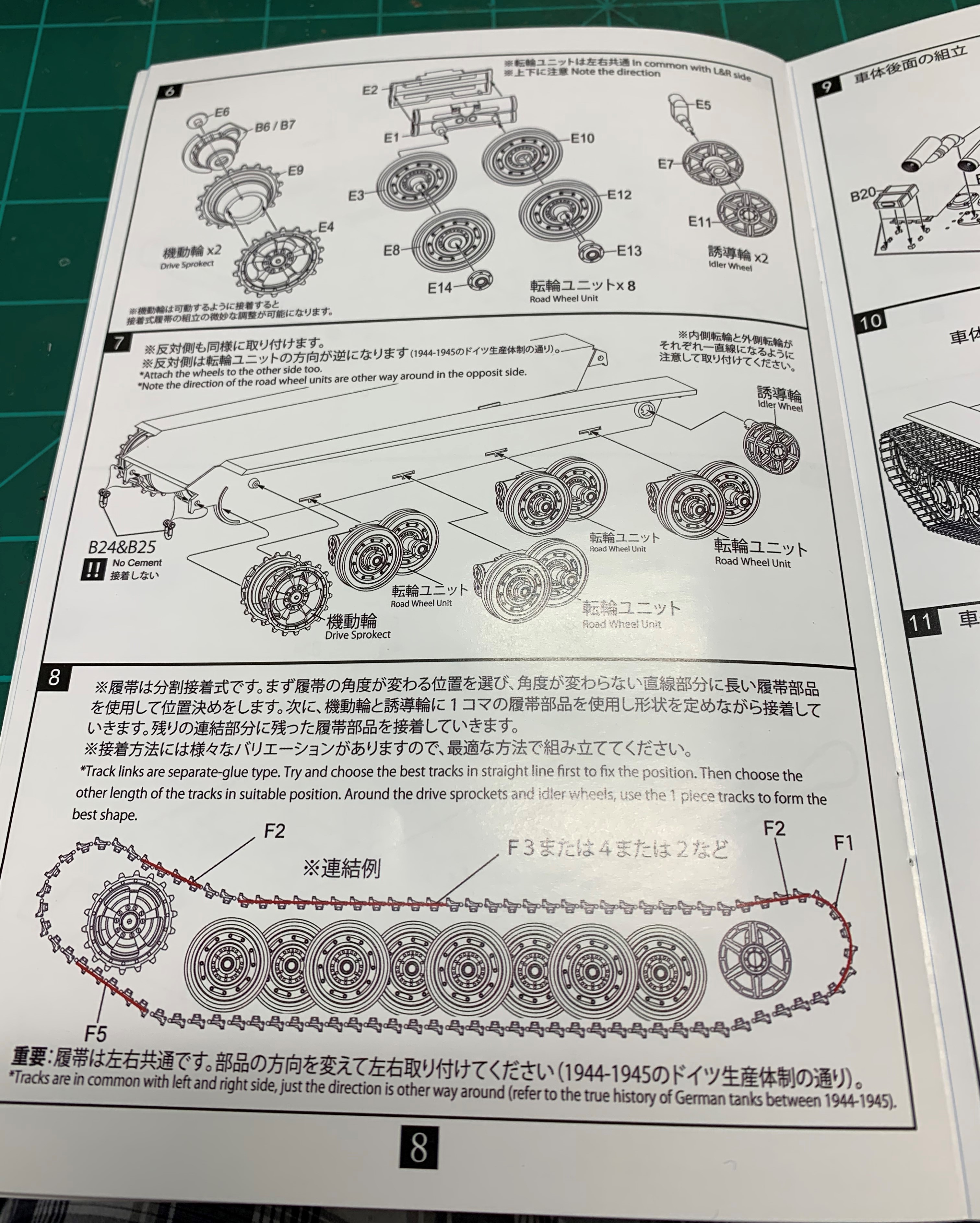

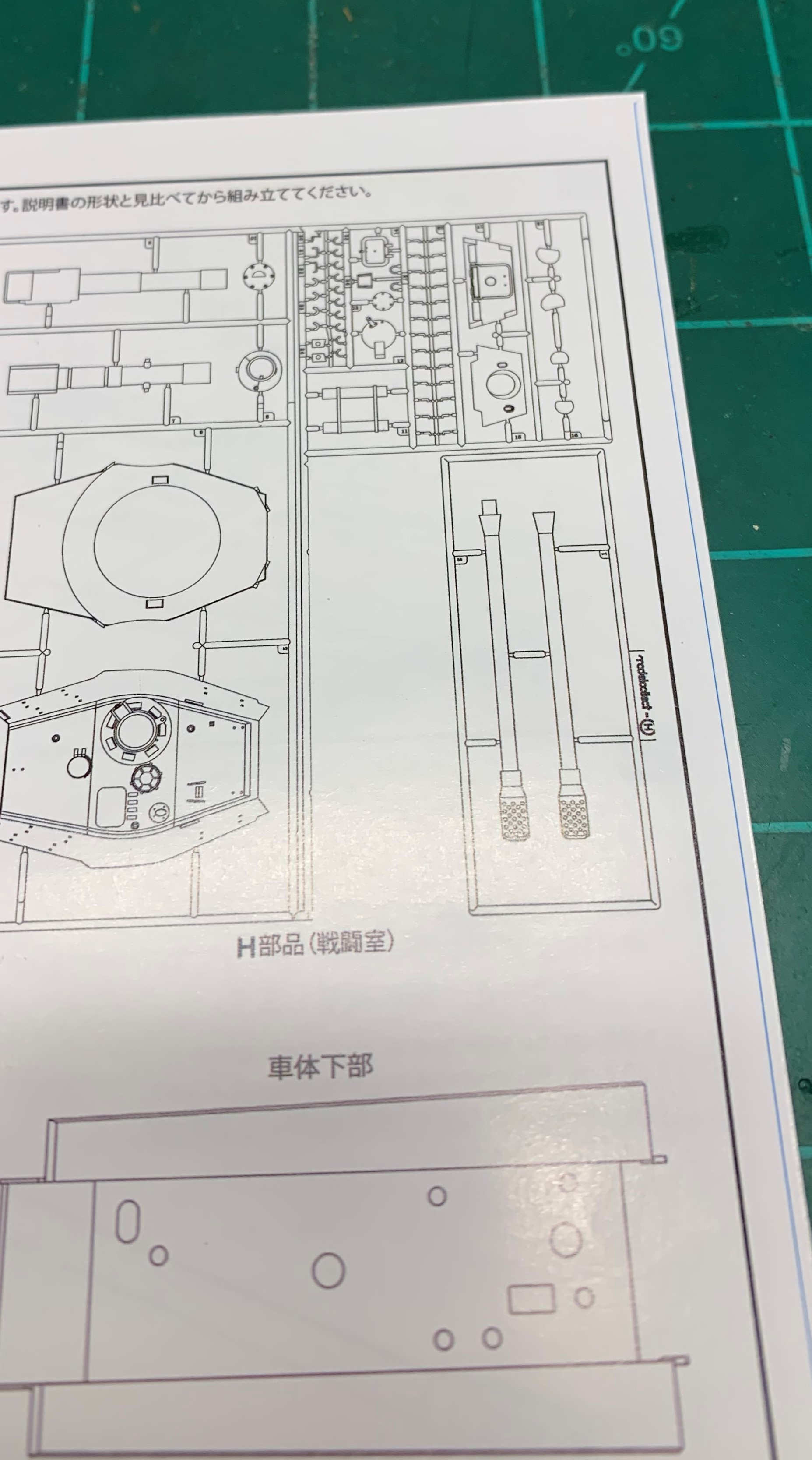

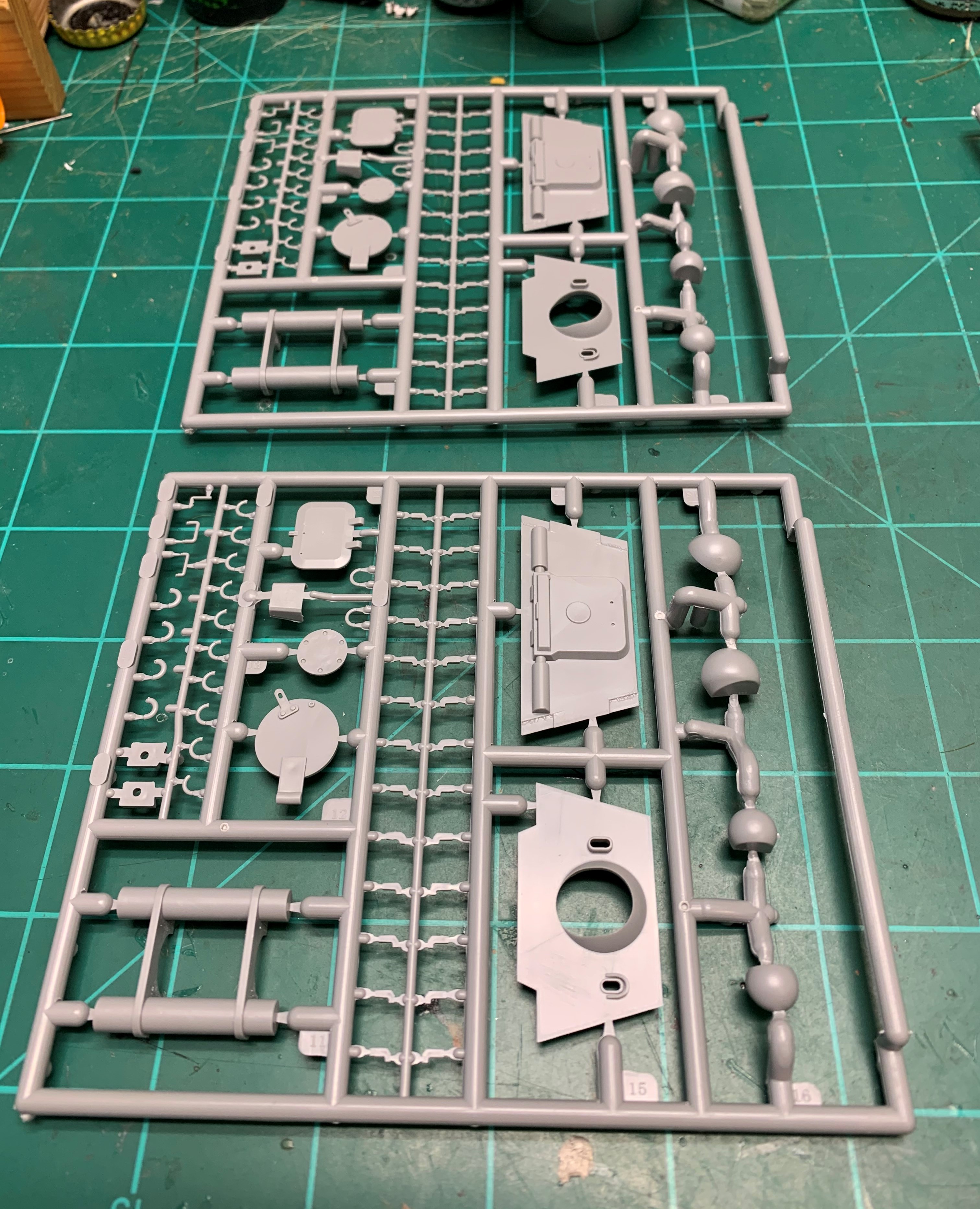

I wanted to know if the two piece kit barrel was going to be a problem before I got too far into the kit, so I got out the instructions and took inventory. Guess what!!?? The sprue with the barrel halves wasn't in the box! They did, however, supply me with an extra sprue of stuff I don't need.

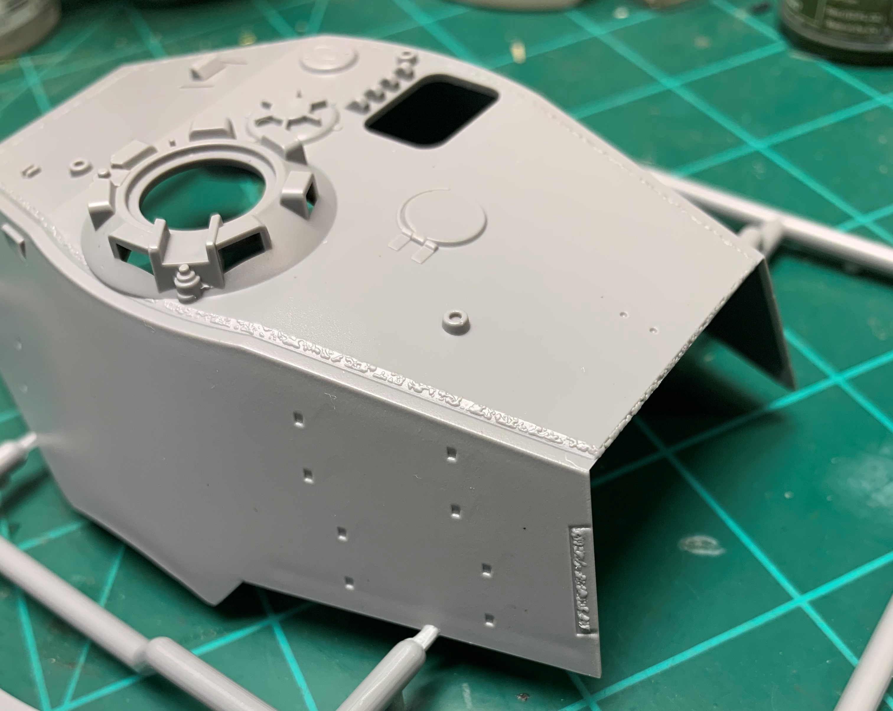

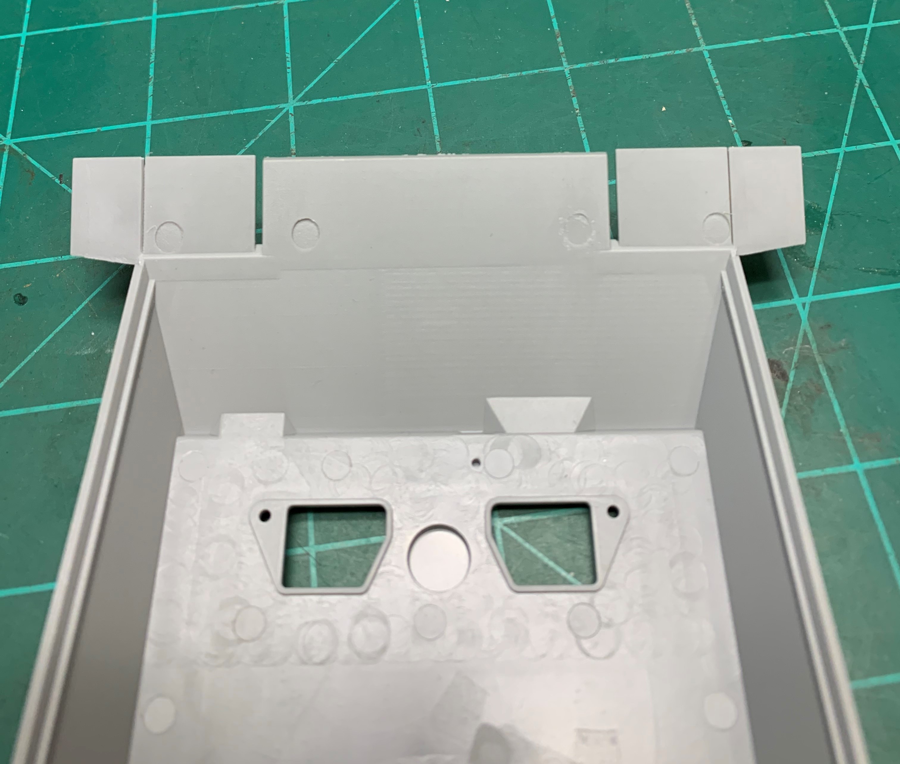

Having already researched aftermarket barrels, I think I can get a replacement pretty fast, but still plan to contact Modelcollect for a replacement. As I suspected, the part count is low (um, yeah), so I decided WTH (thanks Eric) and plowed forward with hull assembly. So of the details are kinda wonky, but can be fixed.
The weld beads provided might be okay.

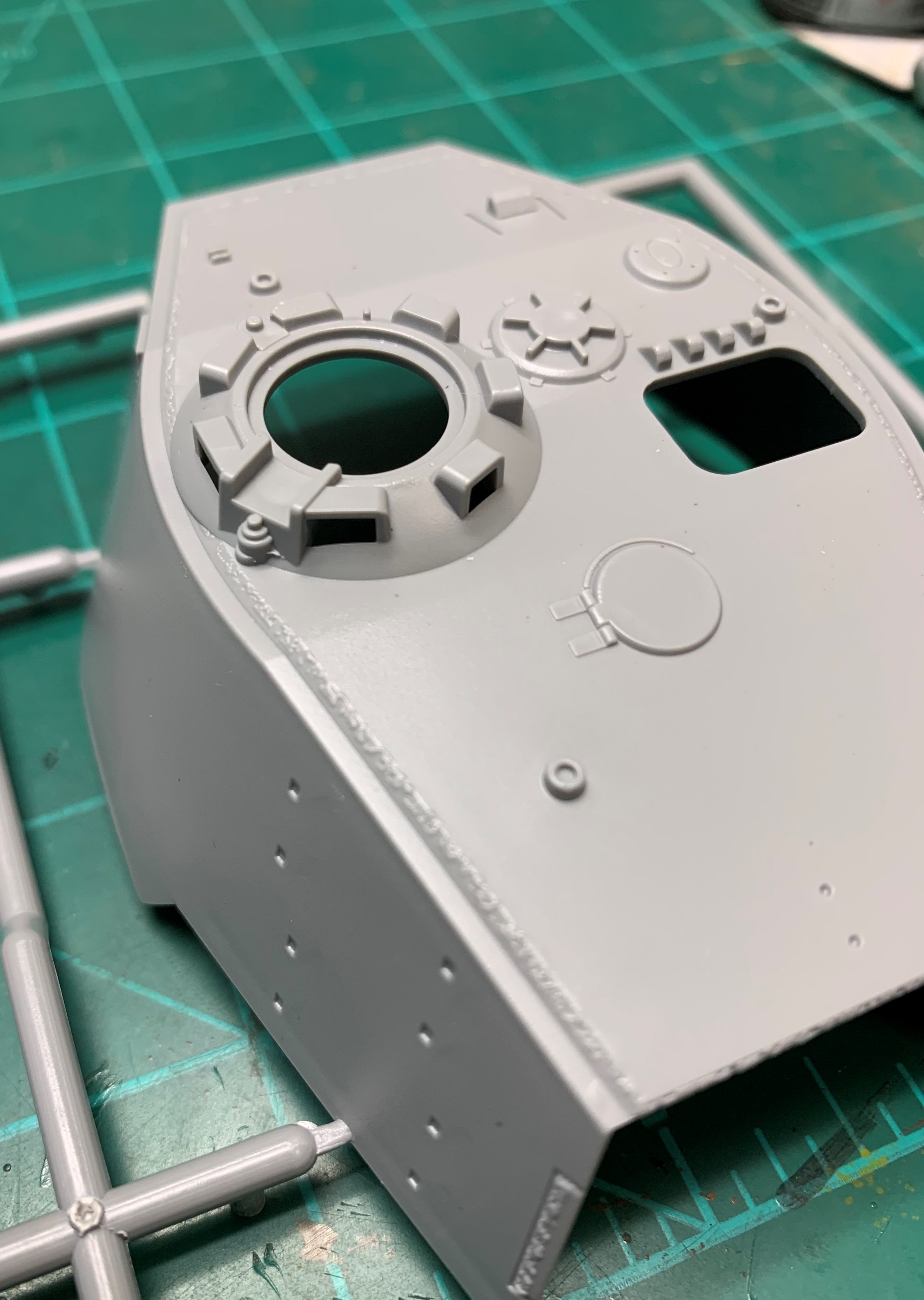

These fenders gotta go!

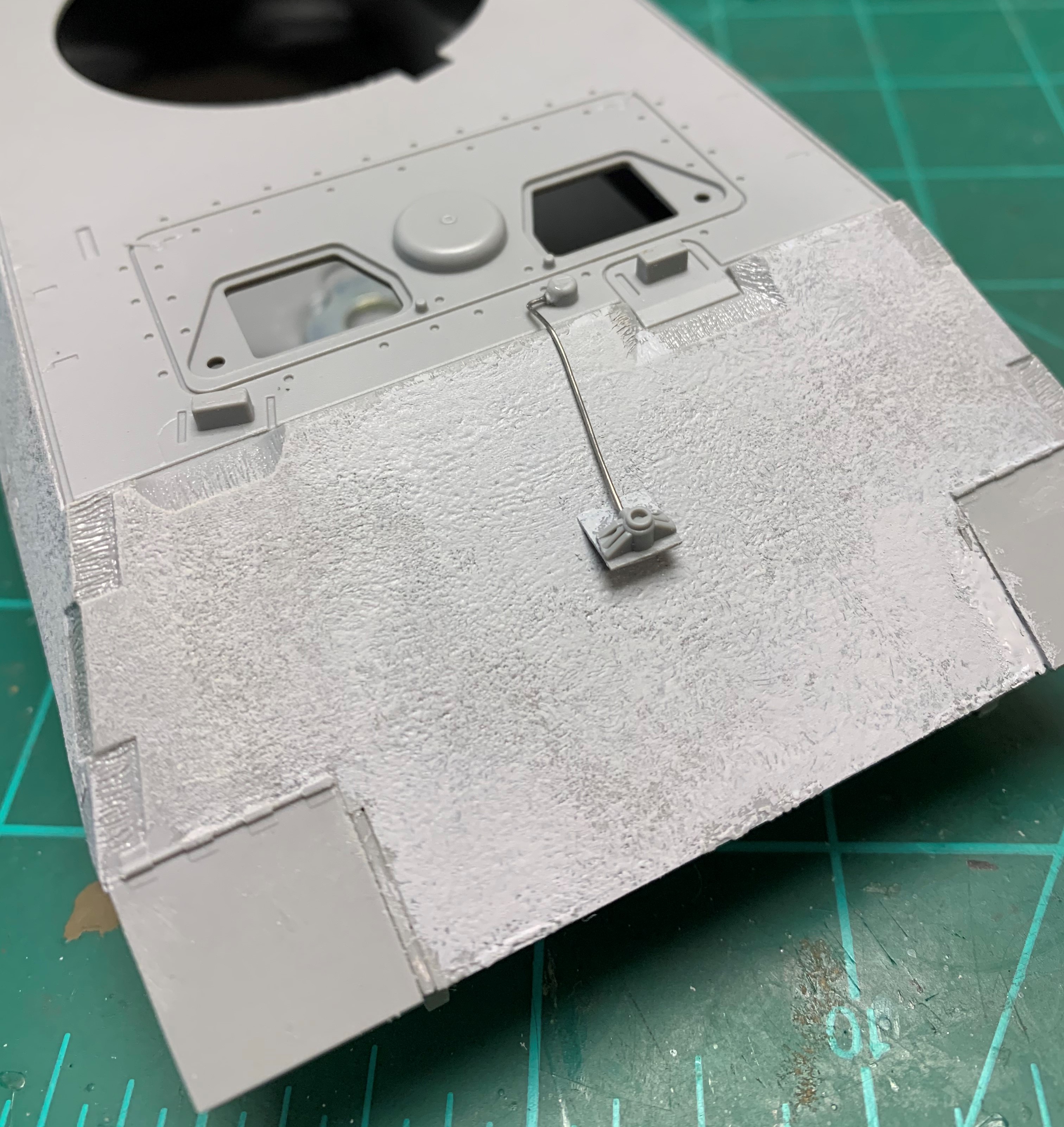

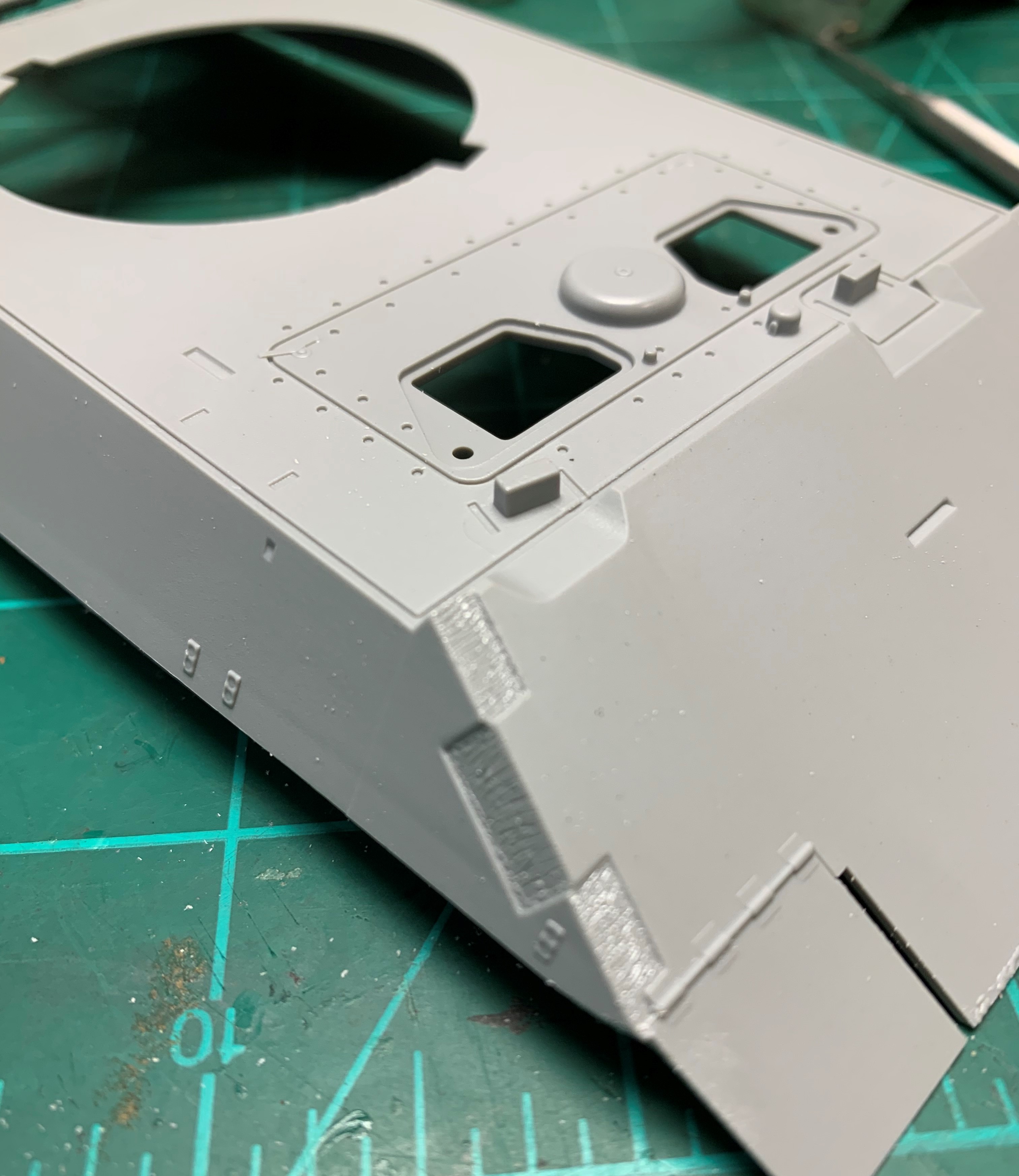

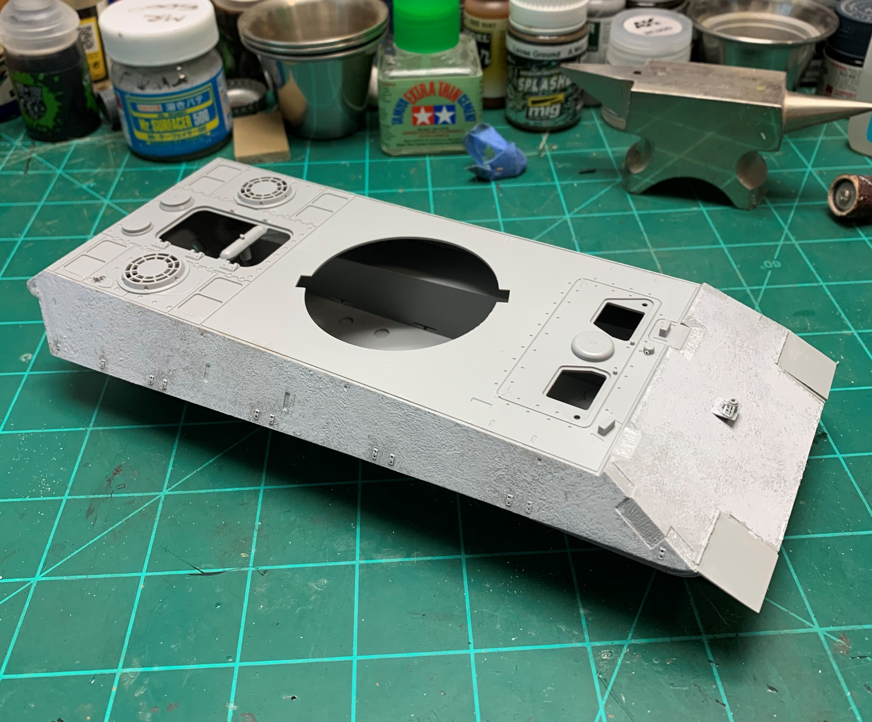

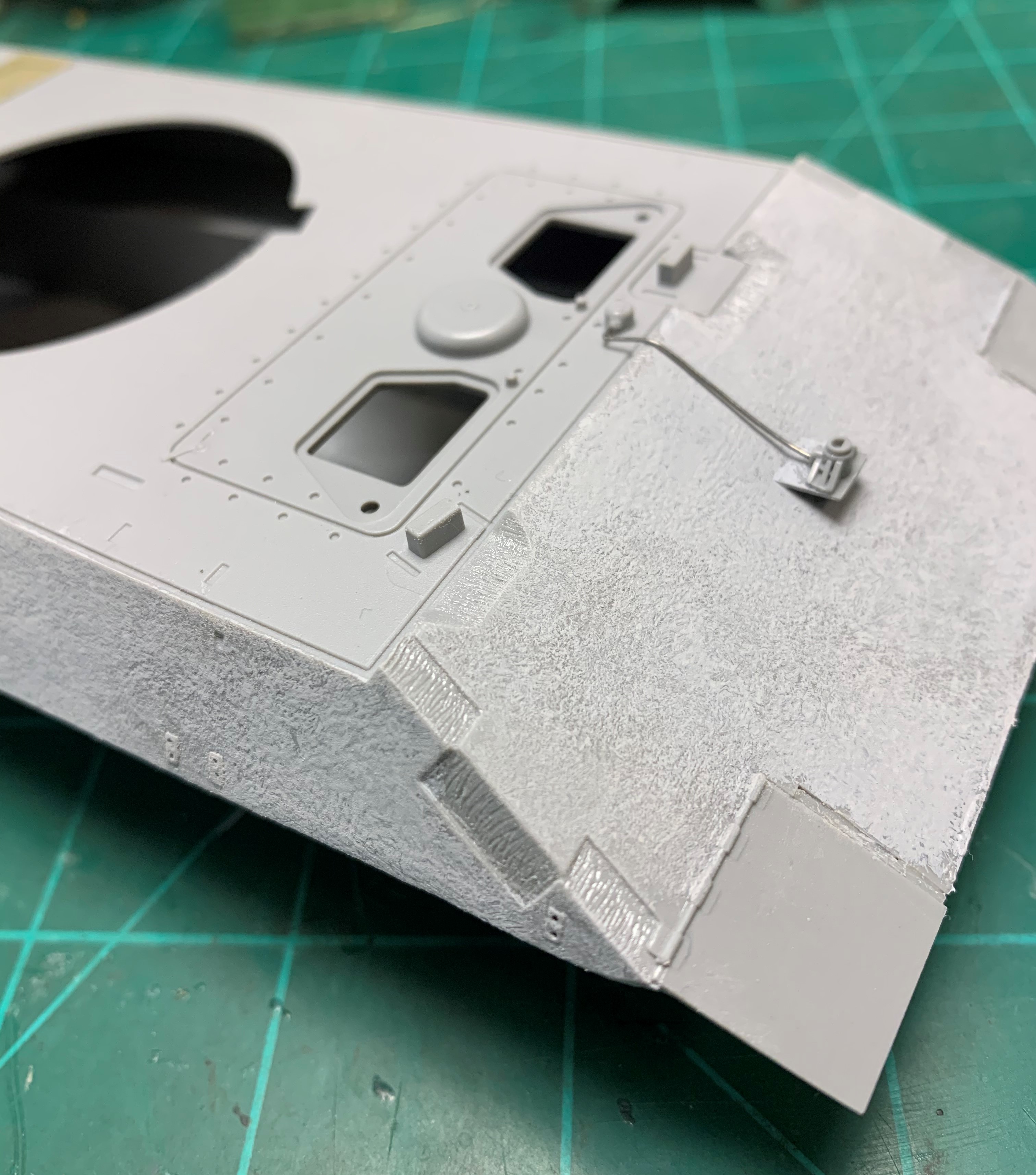

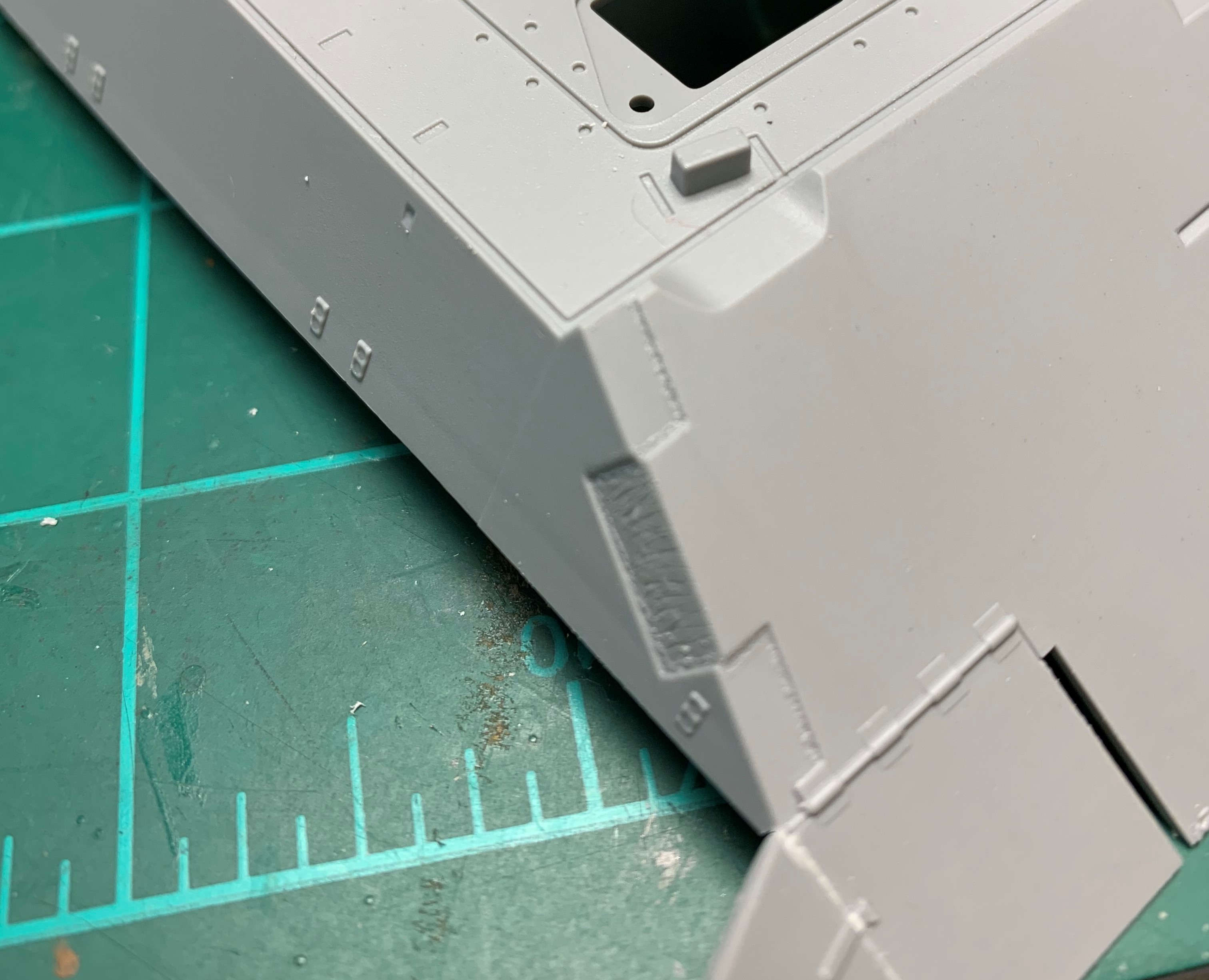

No flame cuts on the frontal armor, so I'll add some. Having been corrupted by Cousin Eric and Uncle Nightshift, I decided to add texture to the armor plate, using Tamiya Extra Thin Cement and a stiff brush, followed by a quick stipple of Mr Surfacer.

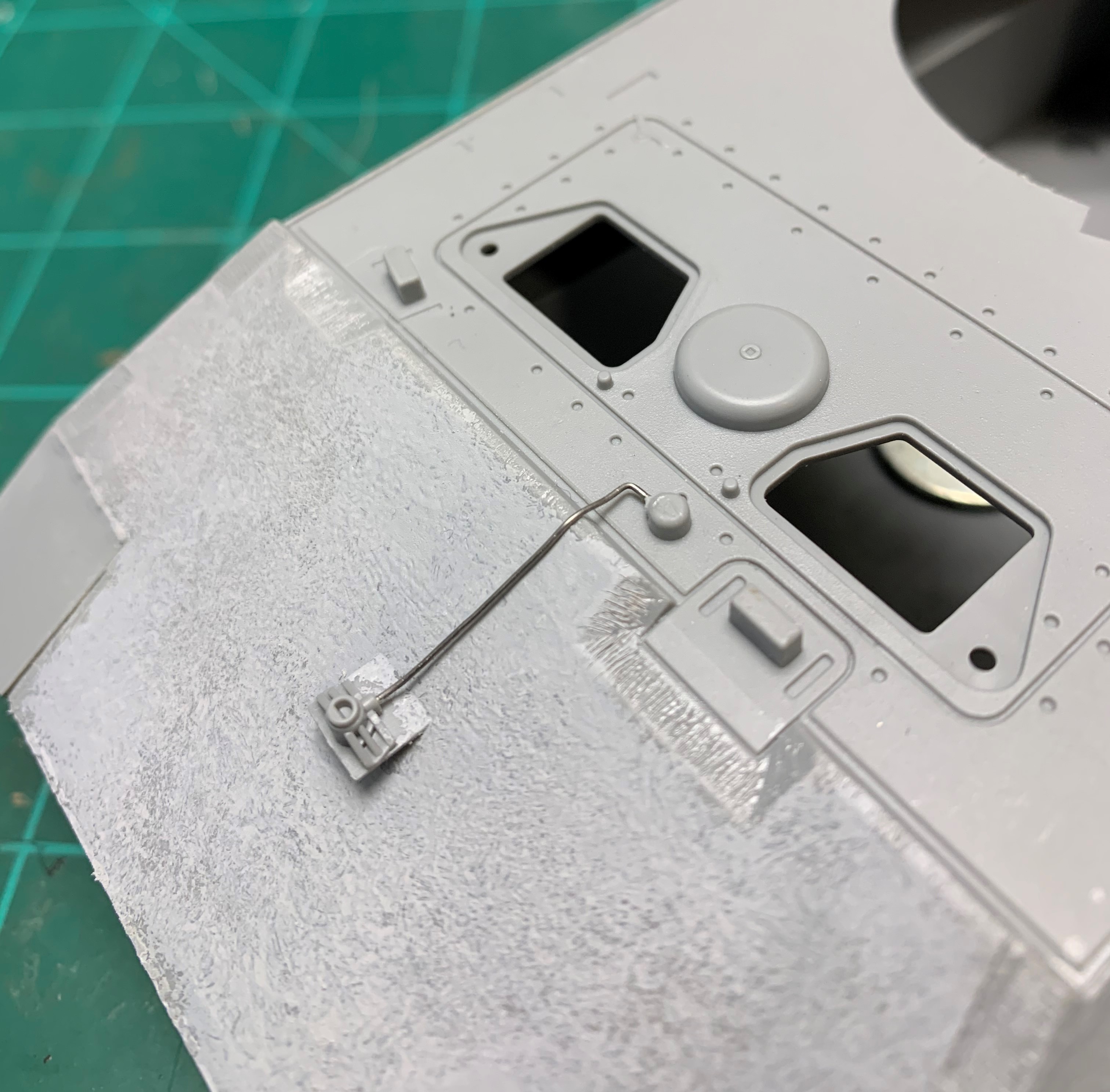

Modelcollect didn't include the conduit for the Notek light, so I made one from solder.

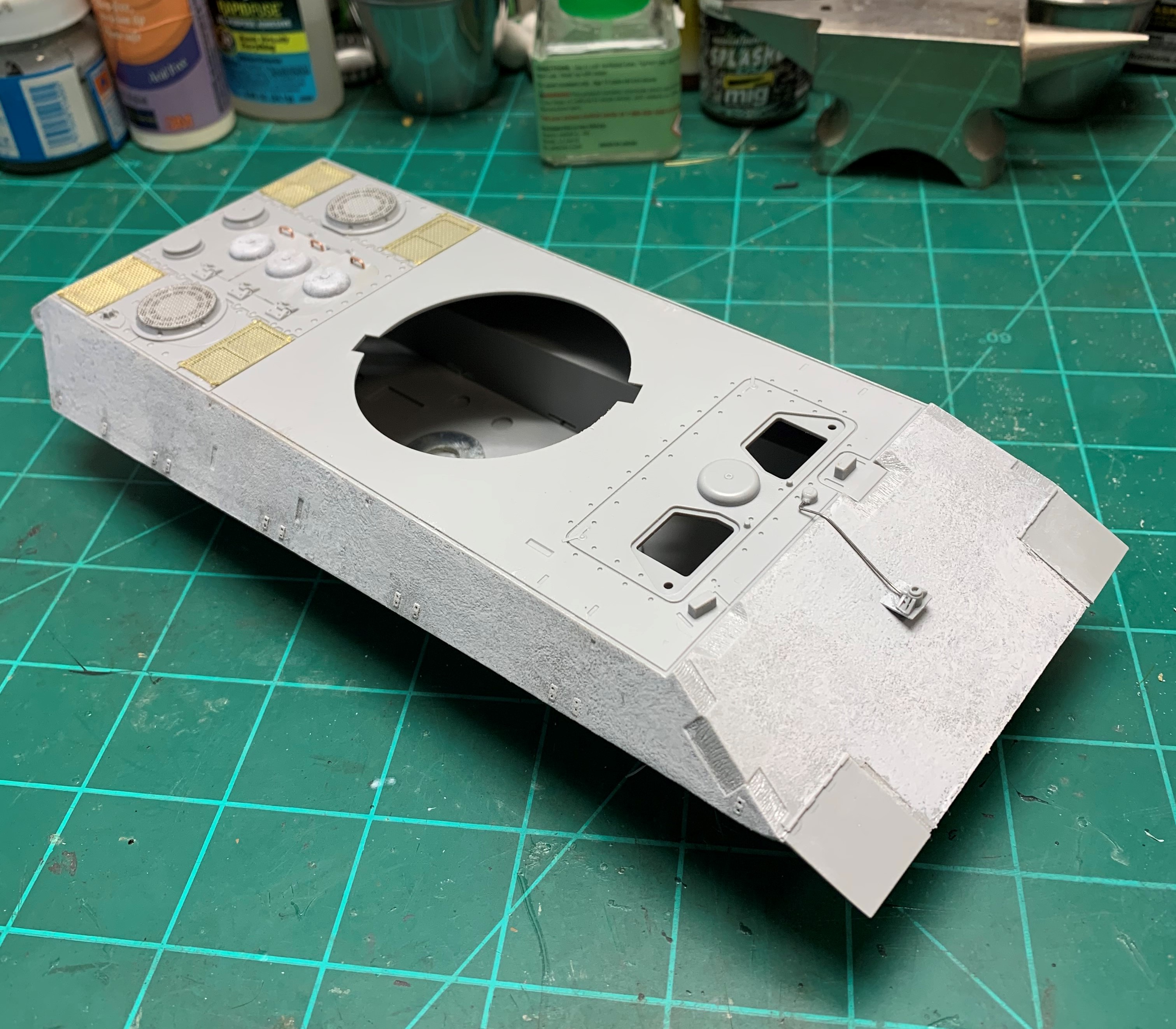

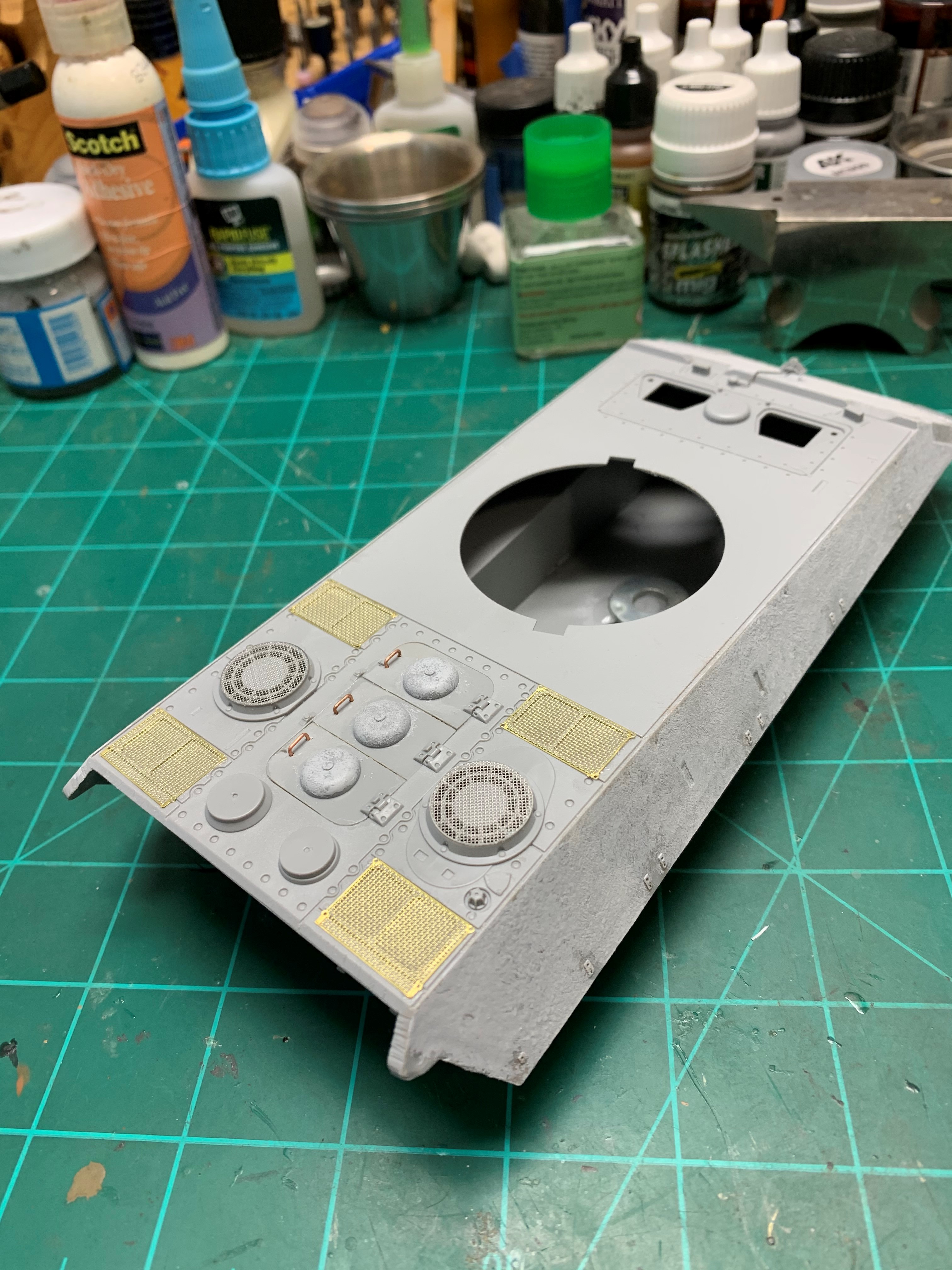

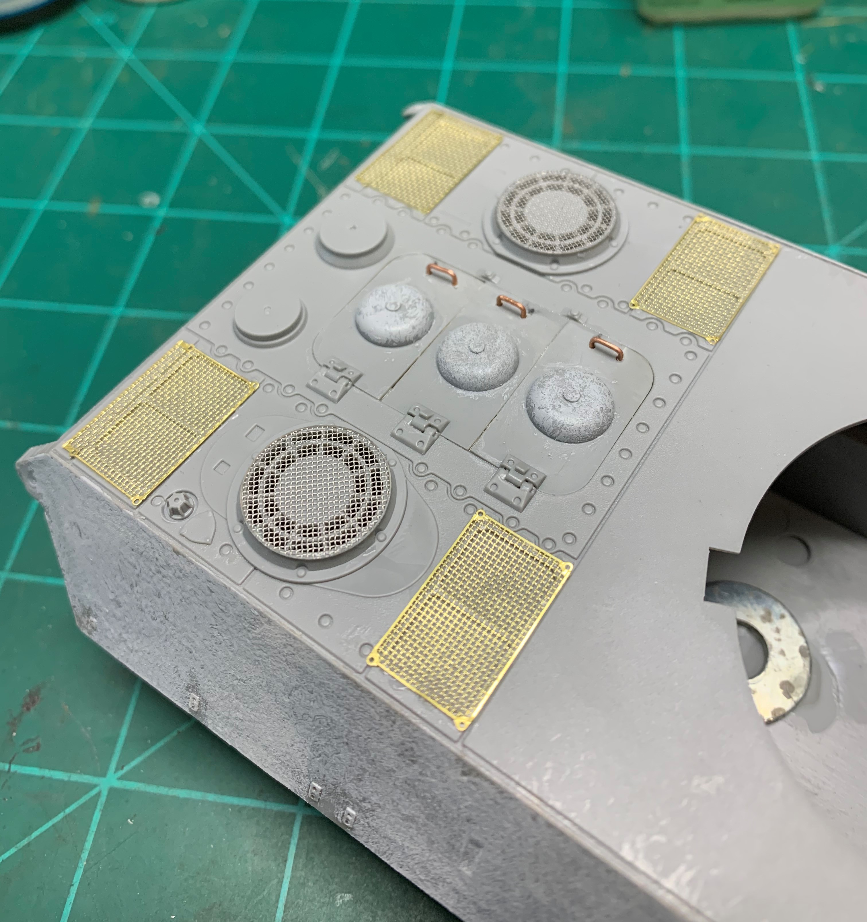

Wrapping up the upper hull with copper grab handles and leftover PE mesh screens. I did find an old Voyager Model PE set for a Jagdtiger that I will pirate parts from.
