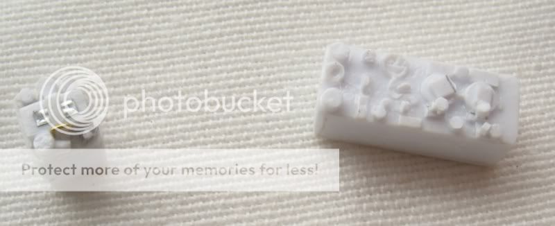

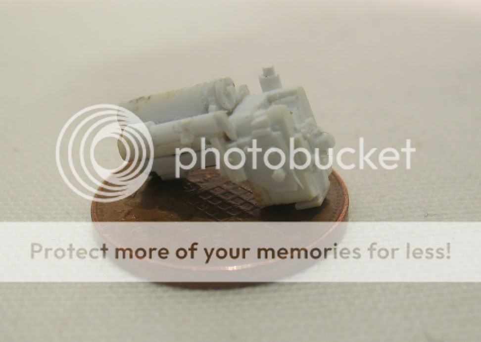

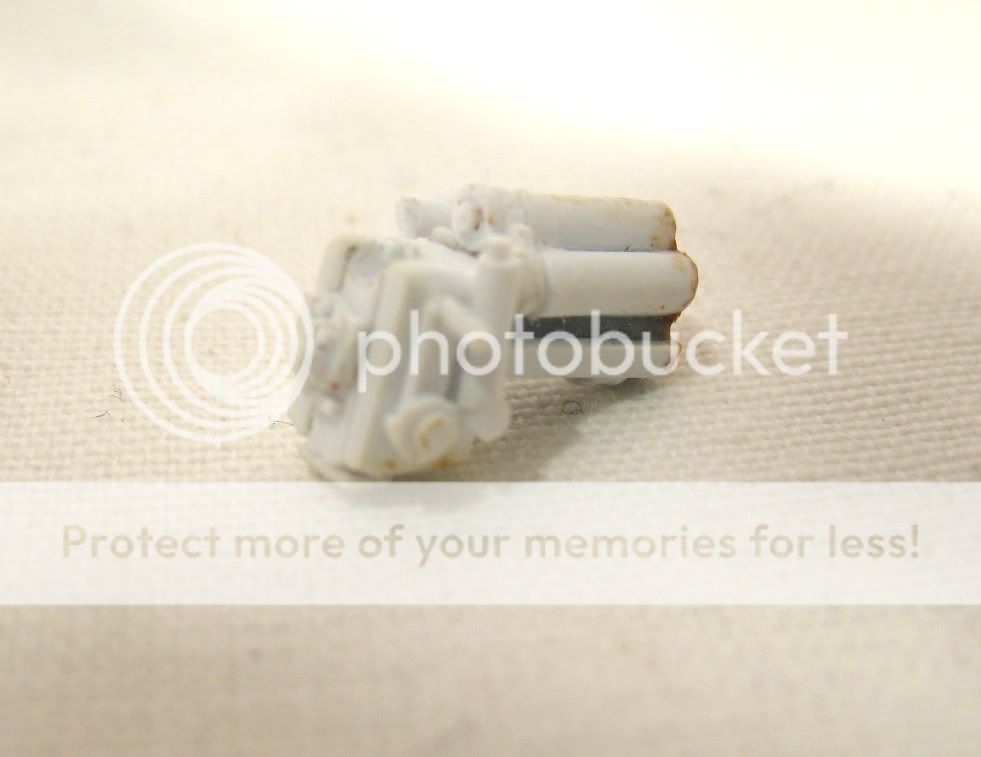

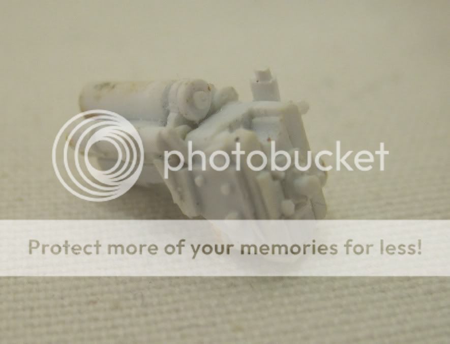

I started with the breech for the 2pdr:
This is considerably smaller than the 6pdr breech I mastered for the churchill, and more complex, and its still not complete! Several parts will be supplied to detail this, but due to the difficulties of casting and the thinness of some parts, they will most likely be rendered in PE

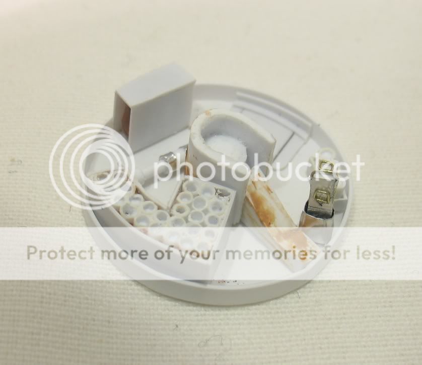

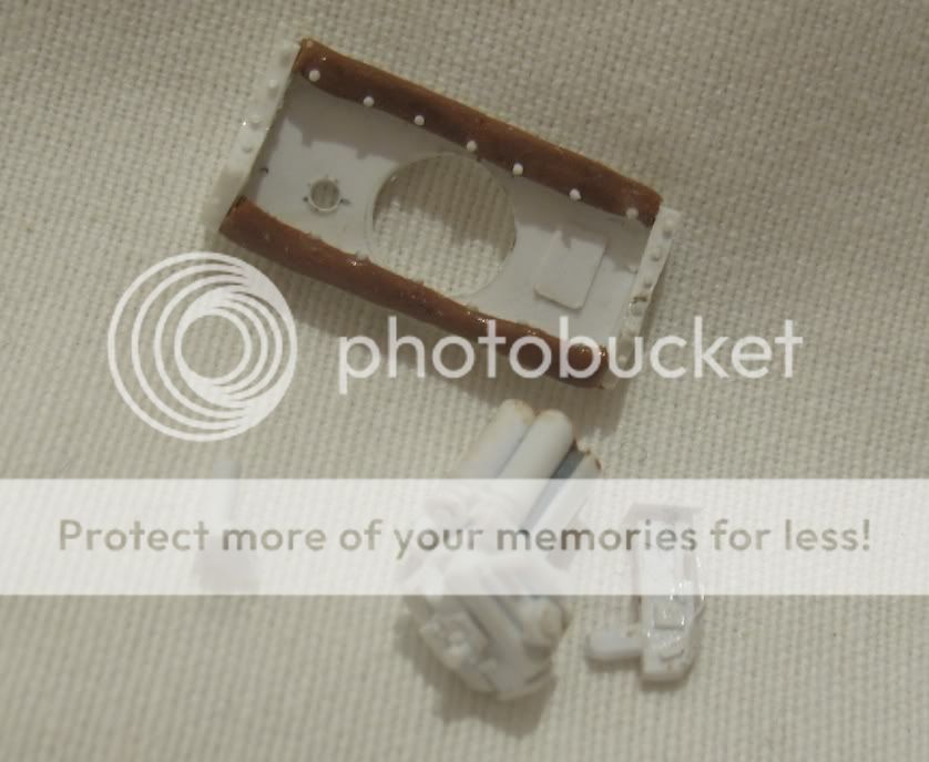

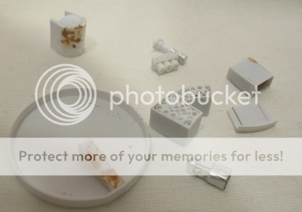

With that done, I've had a go at the masked floor and contents.
As the seperate parts to be cast and assembled:
and all dry fitted together:
I've since received info on the dimensions of 2pdr ammo, so I'll be redoing the ammo bin, but you get the idea

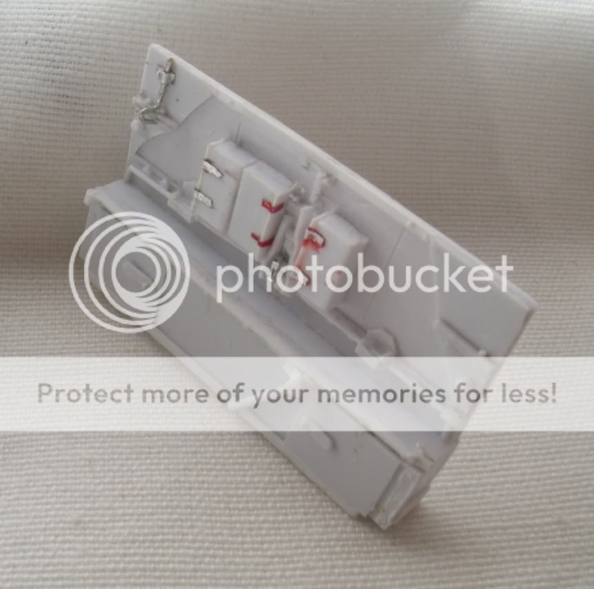

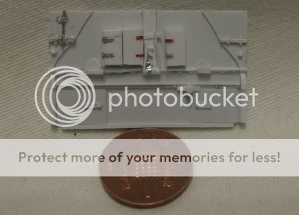

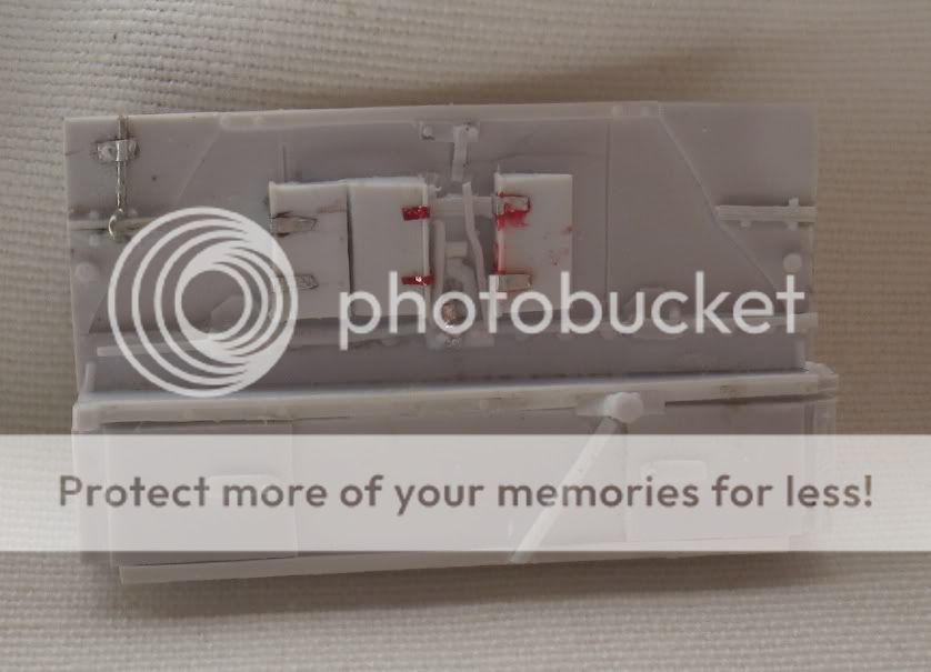

And finally, the very complicated and eye straining firewall:
I still have some rivets to add to this, and its missing handwheels which will again be supplied as PE
Any comments welcome

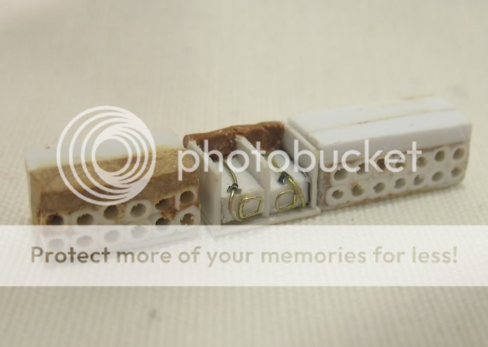

OK, so here are the fruits of several hours labour working on the hull stowage:
Sponson 2pdr and Besa stowage:
The left and right sponsons are mirrors of each other, with 14 2pdr rounds aft, 2 boxes of besa ammo in the center, and 12 rounds of 2pdr forward. I've left these in three parts so that they can cast in twos and assembled as mirrors of each other

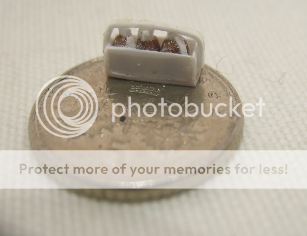

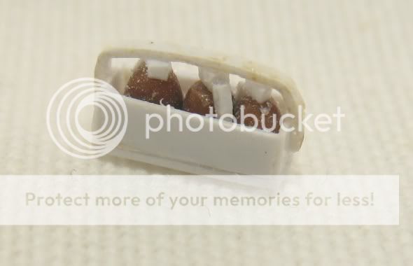

Next I did the grenade stowage for the turret:
These are rather small!:

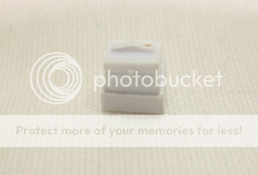

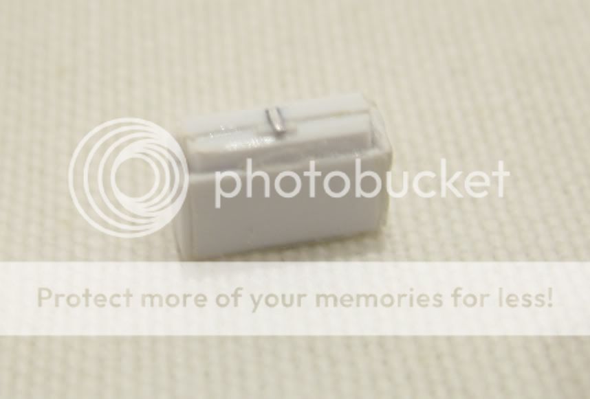

MG Spares:
Radio spares:

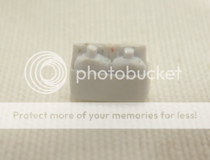

And two periscope prisms with two water bottles. It doesn't show so well here, but the prisms have frames around the 'glass':

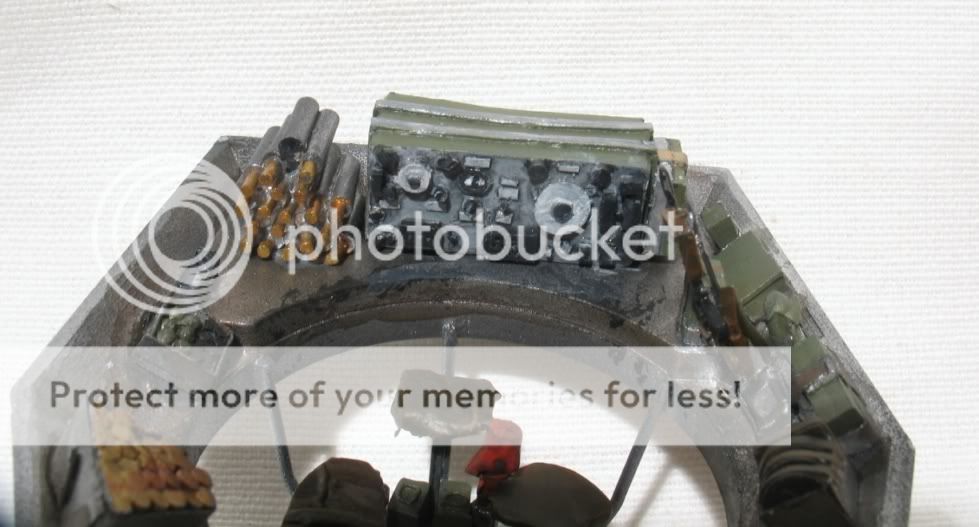

First I tackled to complete lack of interior for the mantlet and armament:
This includes the inside face of the mantlet itself, gunner's sight, 2pdr breech of course, and the besa.

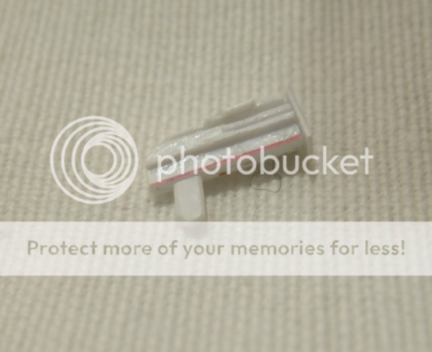

Here's a close up of the Besa:

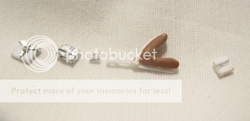

And on that theme I cracked on with turret parts:
L to R: signals satchel, spare cuppola vision blocks, commander's IC box, 2pdr shoulder brace and the vision block for the cuppola itself

Very nice Chris, some serious scratch building there. I have one question, which Matilda variant is the interior for? I ask because the ref I have show an access panel on the upper section of the fire wall.
Rob
www.scratchmod.com
Thanks Rob
I'm working on reference for the MkIV, as the kit is the MkIII/IV.
However, I'm awaiting further reference, and I'm considering adding options to the kit so that people could build a MkII version also. This might mean including two firewalls
We'll see when the reference arrives ;)

Thanks to the new reference, and to Rob for pointing out one of the flaws, I've corrected the firewall:

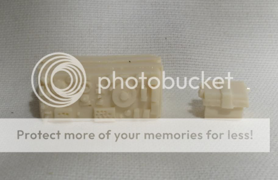

I also received a couple of test casts of the Number 11 radio set back too :) :
As I needed one of these for a Crusader MkI I'm doing, I wasted no time in painting one up to see how it came out:
This set was only fitted on tanks up to 1942. It will be suitable for BEF and early desert deployed builds. However I want to make this kit suitable for almost any timeframe, so I decided to master a new Number 9 set to go in the kit too so you can build a Mtailda for 1942 onwards:
I am thinking of releasing the two radios on their own (with a small etch sheet for some details and the number 19 set 'cage') as a 'British Tanks Radios' set.
I'd be interested to hear if this is the kind of thing that might interest people?
Chris
Looks great Chris , I think items like the radios etc , once a correct master is made are invaluable for other projects modellers may need them for . It may be a good idea to do a list of vehicles that carried them so people know if the radio is correct for their build .
Jenny :kiss:
Good idea Jenny, I'll include that in the packaging :)
Briefly though, between the two, they cover every british tank of WWII from the A9 Cruiser to the Comet, and a number of immediate post war tanks. They are also seen in a number of armoured cars, and in universal carriers, so lots of uses ;)
Chris
