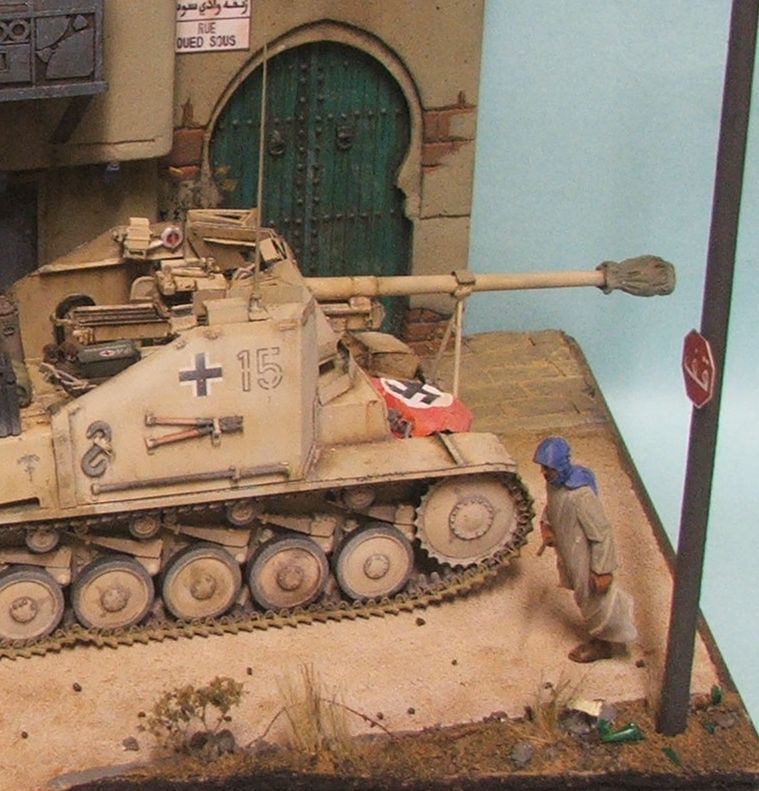

When I made my Marder Diorama , I wanted a little added detail for a corner of my diorama . I wanted the scene to be a slumish area on the outskirts of an African township . I looked around an abandoned block and the abundance of broken glass bottles was apparent. Here is how I made my own .

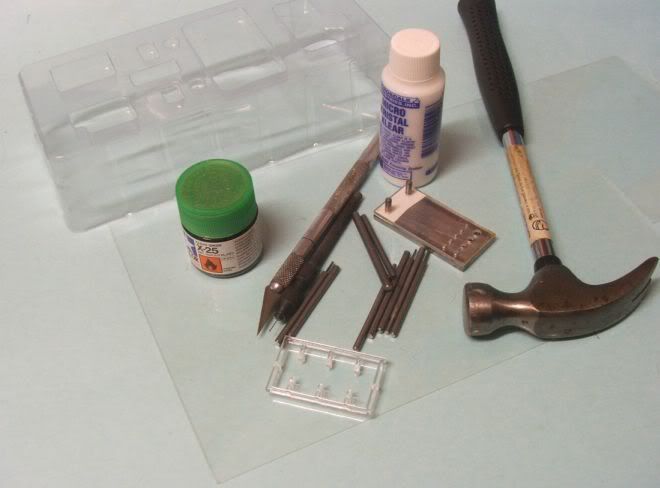

I looked out for some useful stuff , I needed a bottom for the bottle , sides & the neck , here is what I used

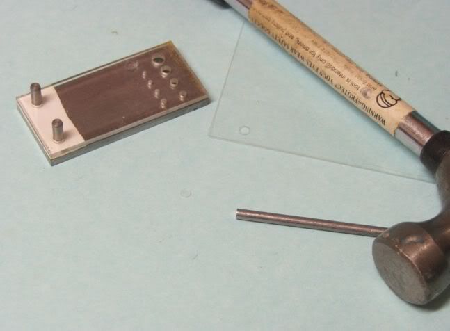

Right then , the bottom was cut from a piece of clear acetate with a hole punch .

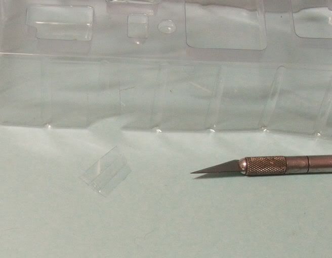

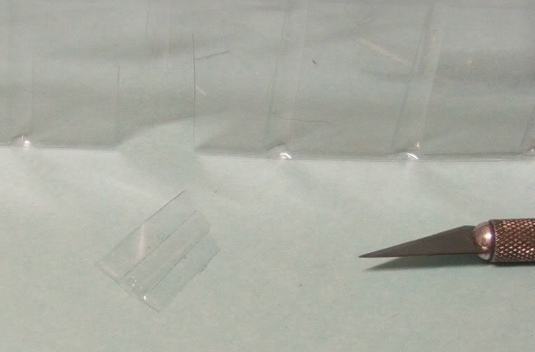

Now the sides were cut from some round bits from the side of some packing , I cannot remember where I found this but I think it was the inner packing of a DML Action figure , lots of the DML etch comes similarly packed too .
You need to cut the curved bit out and then cut it into jagged shards .

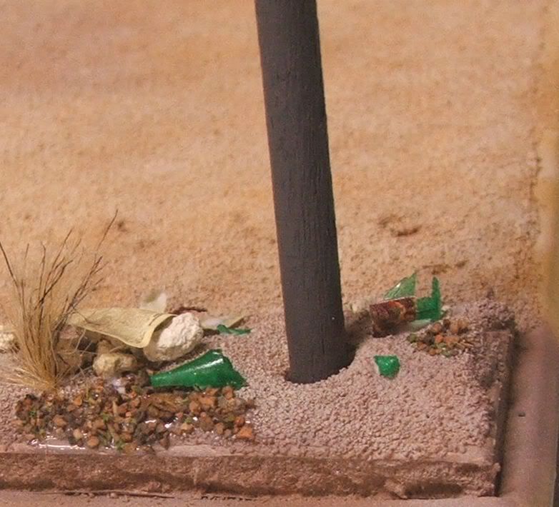

Here it is in the finished scene and adds a little visual interest where before was nothing
