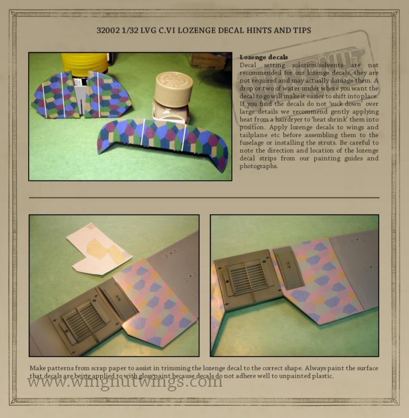

Paddy as stated you have to cut the decals and apply in strips with rib tape covering the edges.On the decal instructions you should see some tick marks with the approximate widths (if I remember correctly). One thing I found after screwing up was that the edges where not matched by colour. I wasted a lot of decal sheet trying to do that. There are some companies like Pheon who make a fitted sheet. I dont know if Pheon is working or not as I havent seen them in a long tome. I think, but could be wrong, that WNW has some fitted sheets, but not a hundred percent sure. Also their decals dont like setting fluids. I believe a hair dryer works better.Hope thats helps.
Oh and this may be of use
James
Cheers James. It seems i was a bit hasty as the fabric was applied across the wing, at 45 degrees across the wing, and down the cord as well. there was no set way. I notice in the instructions you posted below its across and down the cord in the elevator and tail plane pictures. When they ran the fabric down the cord it doesn't look like they tried to match the pattern between strips. ?
