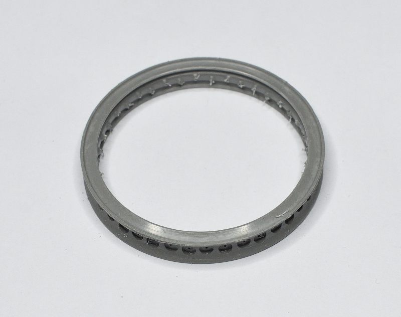

Anyway, I have built about 20 wheels now for cars and bikes, some scratch conversions using the original hub and rim and others using after market.
Even now i dont really know how i will do this, 99% of online builds of this kit have the original wheels and i can see why

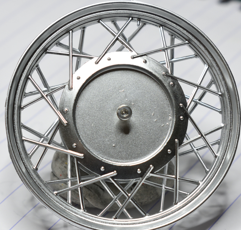

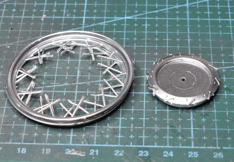

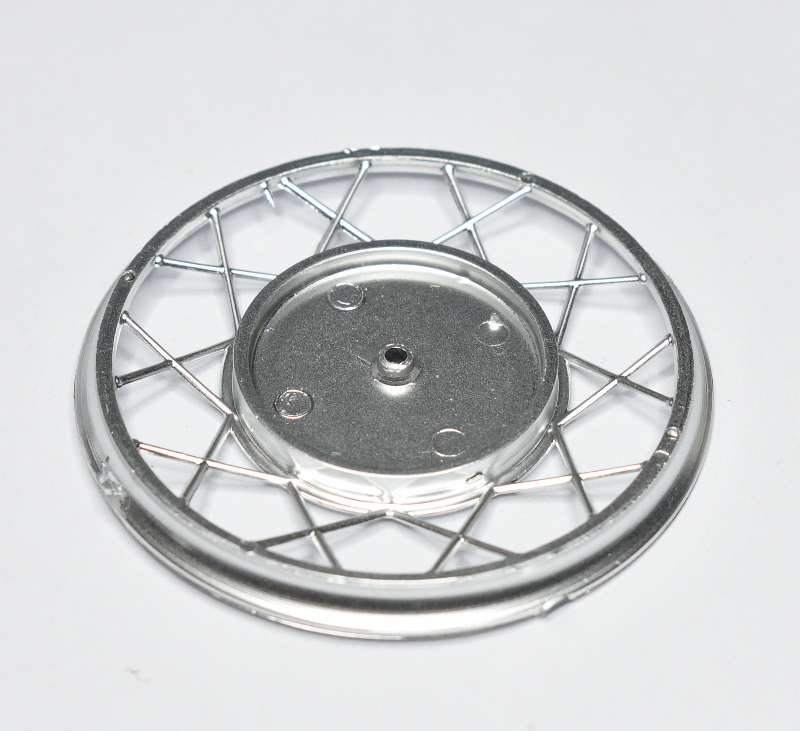

You can see here a typical spoke pattern (half wheel) which should be easy, note alternate spokes attach to the hub, inside and outside.
But turn the wheel over and the lip on the hub is a fraction of what it should be so if you drill the holes for spokes on the outside, they will come through the hub itself on the inside.
With a lathe you might be able to reduce the dia of the inner hub. Another build i looked at has actually drilled the 20 holes needed around the 1.5mm lip...

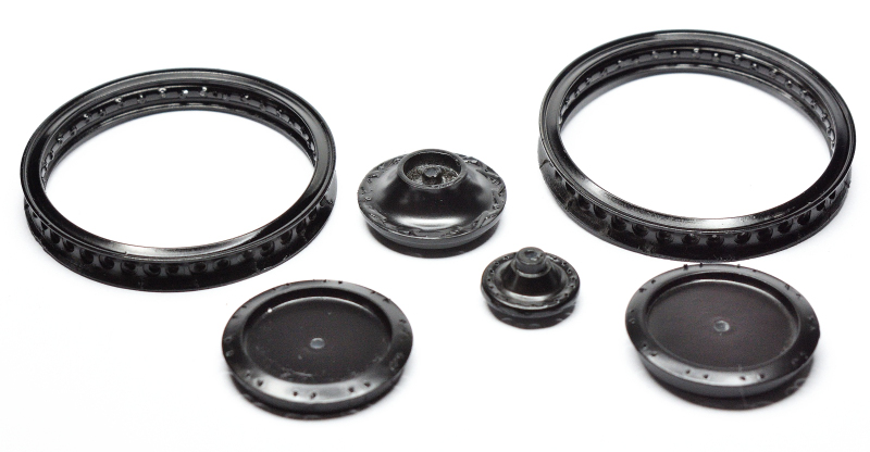

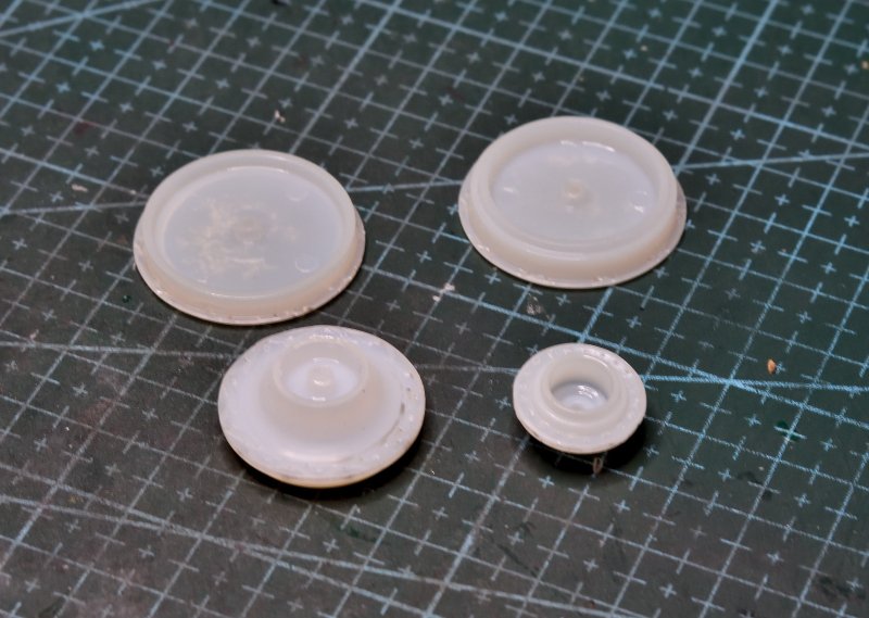

I do have a set of generic resin hubs and rims but warning to all. Resin hubs are incredibly weak around the spoke holes
Those of us that have used resin will know its brittle and to he honest with the spring in steel spokes the edge of these hubs will break off as you try and assemble.. The rim on the other hand has possibilities being the correct 40 spoke and the correct dia for the kit rubber tyres.

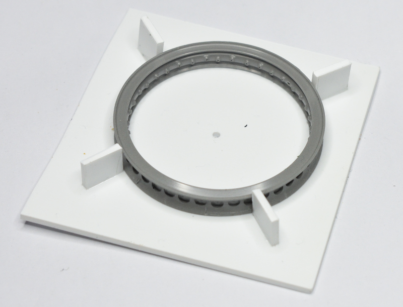

So far all i have done is make a crude jig to hold the resin rim with the hub centred
I know its not very professional but i am hoping having spent the whole of yesterday puzzling over this, that if i make a start, the problem might solve itself as i go on.

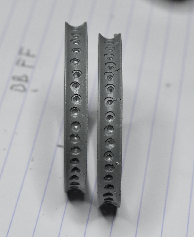

The spokes on the front leave the rim at a hell of an angle and obviously you have to drill the hole in the rim at that angle

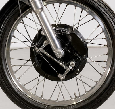

Then i found a picture of the real thing to use as a reference as you do.
and the spokes are nowhere near that angle so this is what i think would be correct
This makes the rim drilling a bit easier as the spokes and the spoke nipple holes are much nearer 90 degree to the rim.

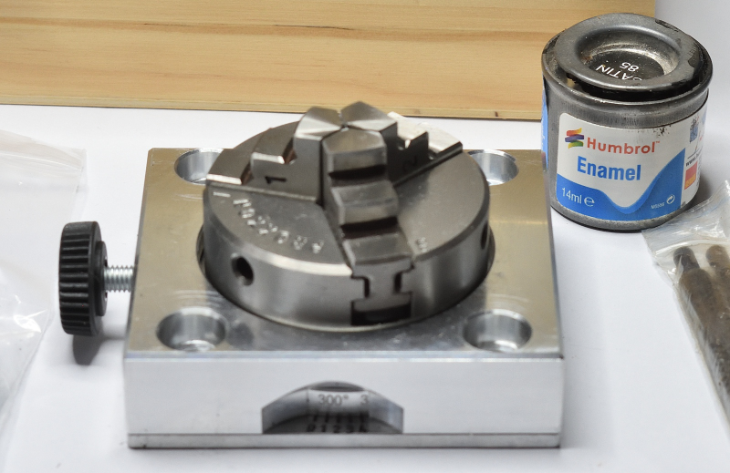

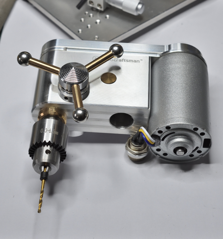

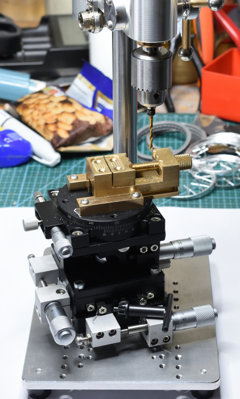

this out of focus indexing head arrived today with Humbrol pot to give scale but it a 48mm chuck that rotates 360 degree with a Vernia display on the front that reads to 1 degree ( or less by eye) Nicely made, smooth operation and comes in its own wooden box. £96.00 from Proxxon
The info craftsman table on their fine adjust vice is good but it doesnt allow you to revolve round as centre point because obviously a 2 jaw chuck doesnt hold different dia central to a drill as only one jaw moves.

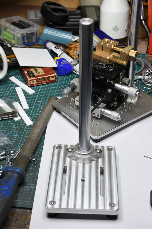

The standard infocraftsman dill will not take the above set up without their larger base and taller pillar as seen above so i have the std base and pillar spare. You can see its smaller than the new one behind.
The really good news/luck is the throat of the spare base and pillar just allows me to centre the drill to the chuck. although i did shave 1mm of the pillar clamp above just to give working room.
I will now permanently fix this indexing head or technically a diving head, to this base and then its easy to just swap the drill head from base to base
the purpose of this is i can now drill a ring of evenly spaced holes round any dia up to about 2.5" and lets face it who has ever got through a day without needing to do that :-0

I have a slightly bigger indexing unit that I bought years ago that has much finer control. It is kind of a beast for it's size and I would have to dig around to find it (yeah it has been that long) When you need them, you just need the right tool.
I wanted to keep it compatible with the infocraftsman drill so the choice is limited being so small. One advantage you cant see on the pics is it can be mounted on its side so you can also drill holes round a rim for spokes for example.

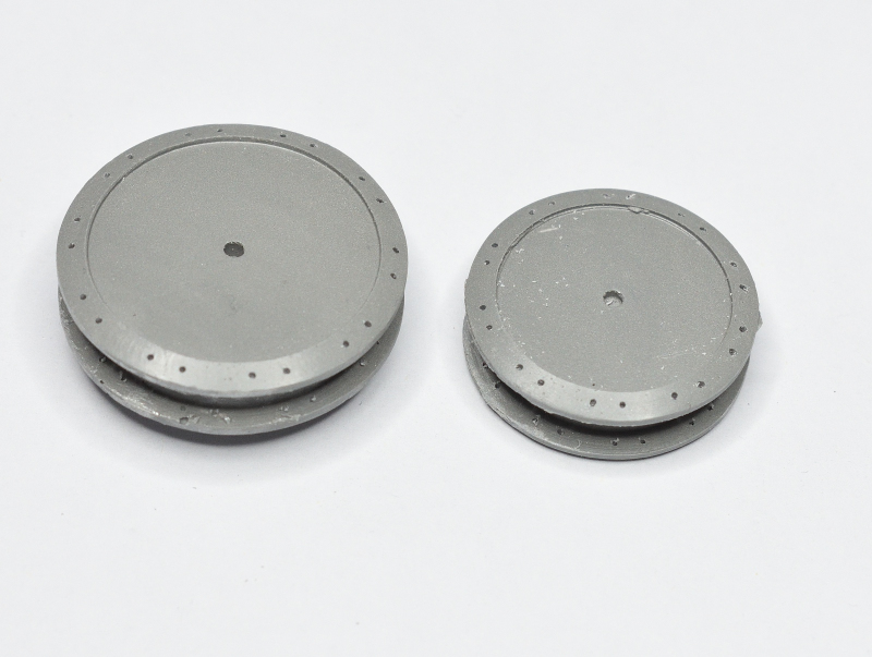

These are the hubs after 6 hours in bleach and drilled, Spokes will be 0.45mm so about 12 thou nickel silver so i have drilled the 0.6mm to give me some wiggle room literally :)

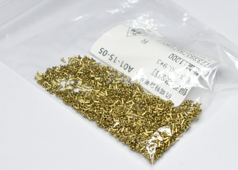

Rims are drilled, these are tricky because they are drilled at an angle to 90 degrees and also lean out a bit. I am using circuit board wire connectors for soldered wire as nipples. These ate 1mm dia with a 0.5mm hole so should work with the 0,45 wire spokes.
these are readily available on line from China for pence by the thousand
and this where i am with all the drilling done, Hubs are primed and semi gloss black and rims are primed and Full gloss ready for a shiny silver coat to replicate alloy.
All drilling was done free hand as the mouldings are so far out, ie: they are nowhere near round and the centre holes are nowhere near in the centre :)

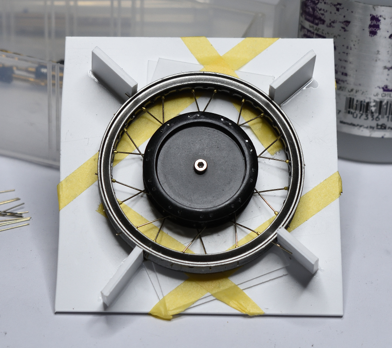

Well i am 20 spokes in with 20 to go on the front wheel
Its proving quite hard to do compared with previous wheel builds because i used the position of the original plastic spokes to drill the holes for the new spokes but now i find the plastic spokes were not correct in position as well as spoke pattern. the holes in the rim are angled out because the hub is wider that the rim. This is fine however because i corrected the spoke pattern some hole are angled to the left side of the hub and should be angled to the right side. Basically the original spoke patter repeats ever 4th hole in the rim however the new pattern repeats every 5th hole and the holes in the rim are not even..
the upshot is some of the pattern forms a perfect cross like at 4 oclock while at 8 oclock they dont. It looks worse straight on but doesnt notice at any angle and will look better withy then next 20 spokes...................i hope :)
I notice these are all just a bit different as far as spoke layout. I admire your tenacity, Paddy.
Well its not perfect but its 100x better than the OTB offering. I have learned a lot doing this one and the rear should be easier but then its a different pattern altogether so lets see.

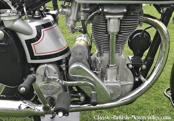

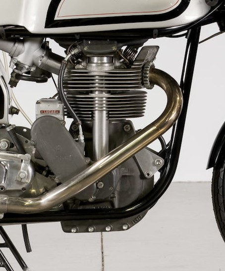

looking ahead the engine looks really odd. the problem is Manx Norton's were made from 1947 - 1963 and every year was an upgrade or improvement and some years a completely new /different engine . Obviously as a racing Motorcycle it had to be ultra competitive each year at the TT. (Manx refers to the Isle of Man TT road races).
The model is a 1951 version but i am having trouble finding the definitive 1951 bike as so many have had engine changes and upgrades over the last 70 years.
Yea the 30 was a 350cc and the 40 a 500cc They did a 250cc as well and all used a very similar engine but the big difference is in the cam drive shaft, on some engines it exposed and on others its inside the barrel and head fins. The one inside the fins seems much later than the 1951 date of the kit.

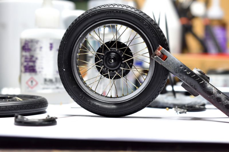

And now Ladies and Gentlemen for your daily pleasure and continued enjoyment i present (drum roll) a Back Wheel !

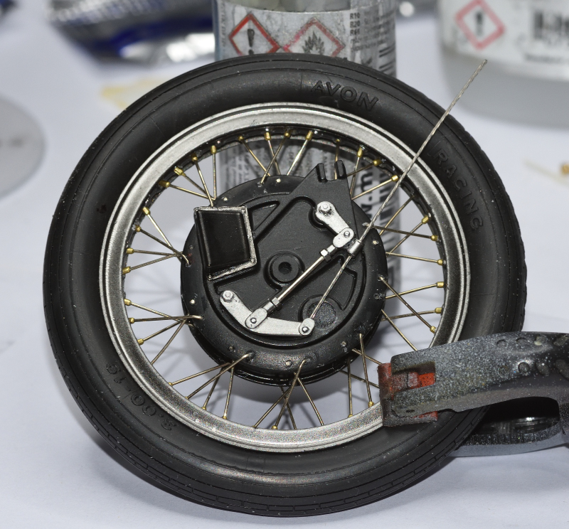

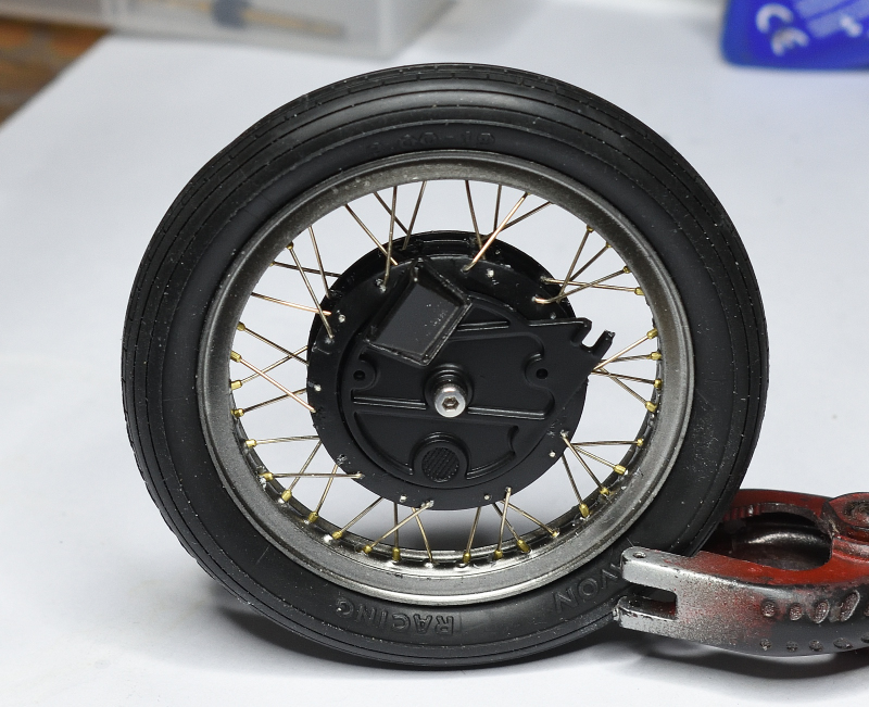

I have also started on the brake fittings for the front wheel
This is the kit part, stripped of chrome. For what is a 50+ year old kit its not that bad
Here it is deconstructed, stainless nuts, 0.8mm nickel silver rod and some 0.5mm rivets and some MFH nuts., parts painted in black/gloss then chrome which i find looks nothing like chrome but makes a good nickel plated steel effect.
re assembled onto the brake plate and fitted to the wheel
cable is 0.5mm Bowden cable cut short as it will be sleeved down to the brake plate.
