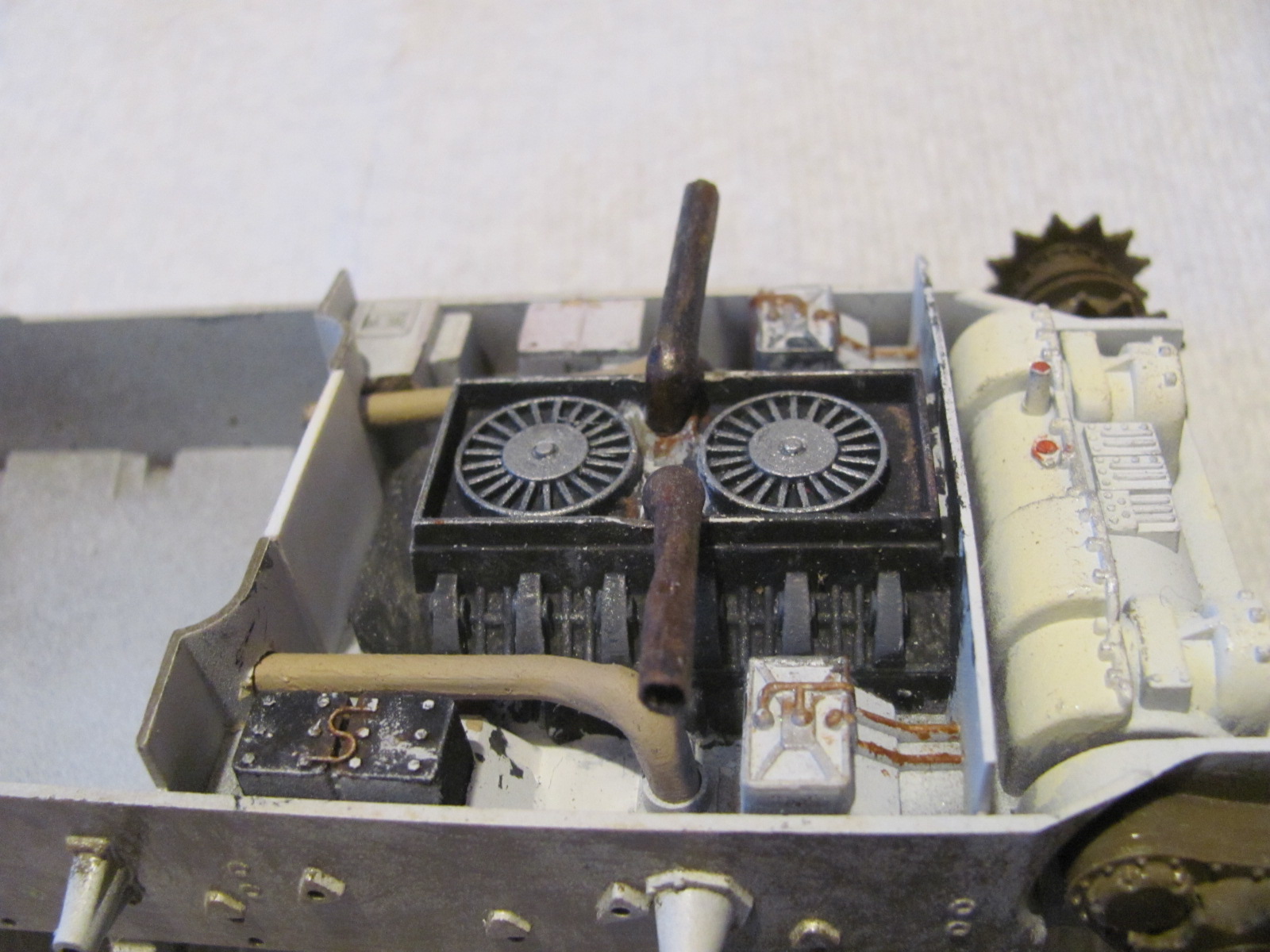

I kind of liked the looks of the engine so I decided to open up all the louvres in the deck plates. What a job! Can you say tedium extrodinaire? I also decided to add some details to the engine.
I do have a question regarding the engine provided in the kit. Is it the gasoline engine or is it a diesel engine? If it's a gasoline engine I'll have to add carburetors and air intake pipes to it. I've added the exhaust tubes and the cooling ducts already and did some painting of the engine. Here's an image of what I have done to this engine so far.
So, gasoline or diesel engine?

Its a gas engine and air cooled.
The cooling tubes you are talking about are for the carburetors from the air filters.
There is transmission coolers on the left and right of the engine.
I think I have some pictures I have found while surfing. I'll look for them and try to get them posted here for you to use.
A friend has the AV-1790 gas engine which he starts up and runs once in a while. Not sure if it was from the M-47 or an early M48.

The motor looks good here...:good:
