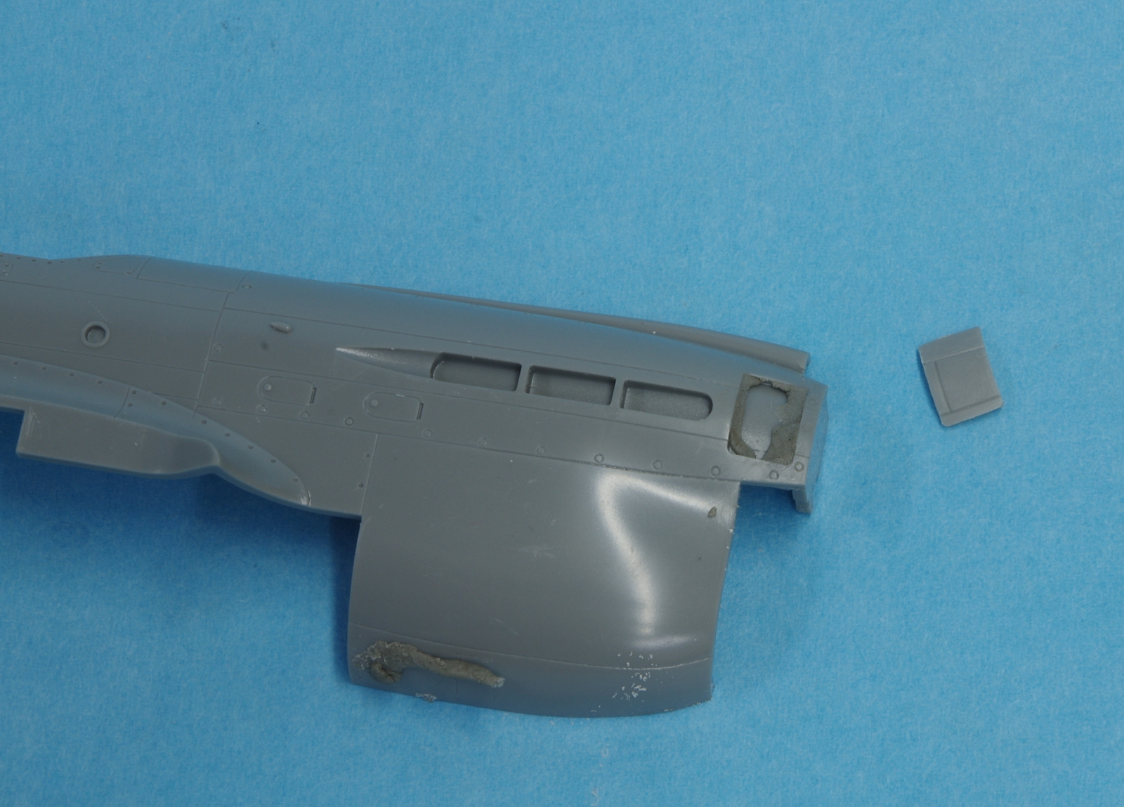

Never mind that worm on the bottom of the chin! To get a good fit on the upper nose inserts Aves Epoxy Sculpt was placed in the recess as shown
and the inserts were pressed in until they were flush with the surrounding surface. Excess epoxy was removed with a wet finger. And the worm.
