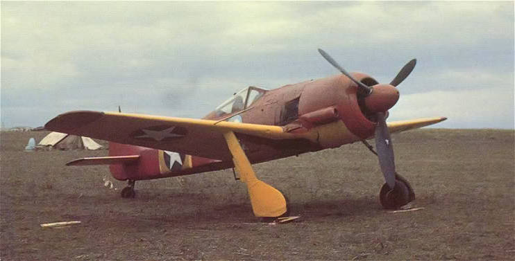

This is the scheme i'm going with, what is this? Red, Tan and Yellow?

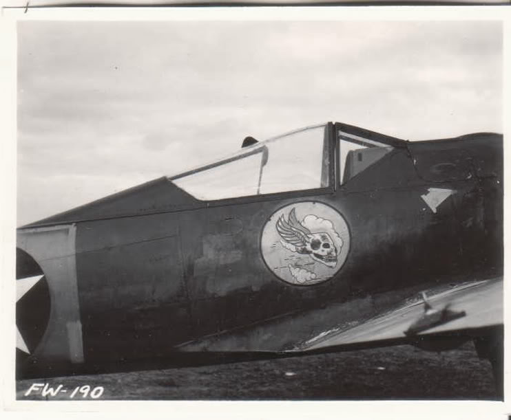

Red and Yellow but what is this color around the insignia?
1
Indeed, it is red and yellow. Around the national insignia is a desert tan color.
By the way, why not a later repaint of the same aircraft?
The rudder stripes are repeating (from the top) red, white, then blue. Like I wrote before, the winged skull insignia is available on one of MicroScale's P-40F sheets.

Last scheme used by this Butcherbird, note it is all brown and the tan is no longer evident.
Regards,
Don't leave out the nice paint detail either. The repainting looks rougher than you first think.That overpaint around the skull is very 'slapped' on and is a different shade as well.
Ian.
Ian you're raising the stakes on me, you want me to replicate the sloppy paint job? hmmm...might give it a shot. got to get the decals to call it finished but i'll have some paint on it maybe today. :mpup
Red Yellow and Tan is what i'm going for.

The tan band, I'm thinking Desert Yellow XF-59, Whatcha think?

Are you going to try the striped tail? I am aware that the Kecay book "Captured Butcherbirds" illustrates them alternating, from the top, blue/white/red but comparing the tones of the colors to the red fuselage, white star, and blue circle of the national insignia clearly shows them to be, from the top, red/white/blue.
By the way, Karaya has released a few sheets of schemes based off this book.
Yes, colors are incorrect.

Yes...I think I will do the Red White and Blue tail.
