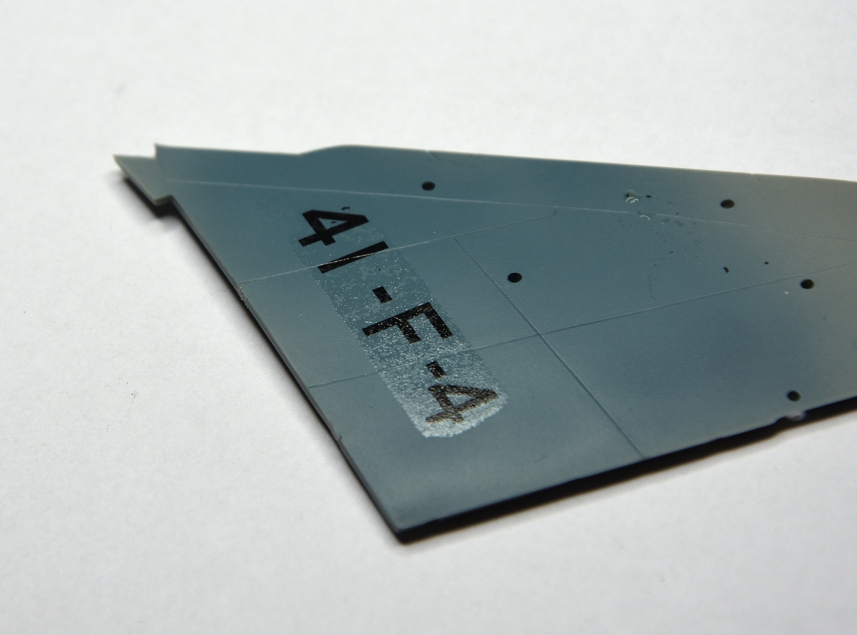

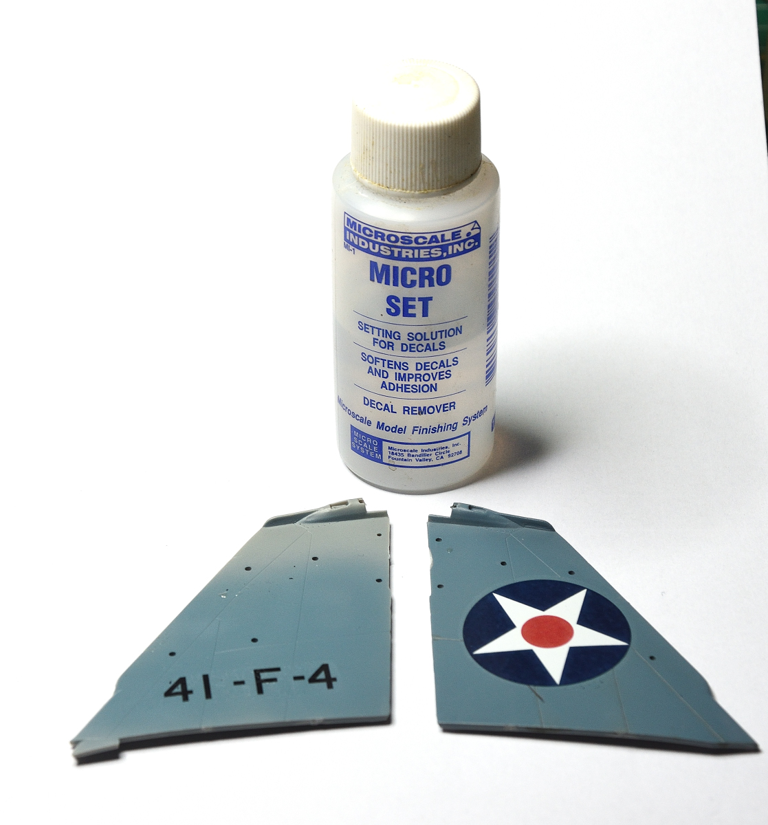

OK so this is how these eduard decals work.
Lay them down on a very smooth surface. Remember people say gloss because its smooth but if you use a fine pigment paint like MRP i find it doesnt have to be gloss to be ultra smooth.
I have used some spare decals from my current F4f build

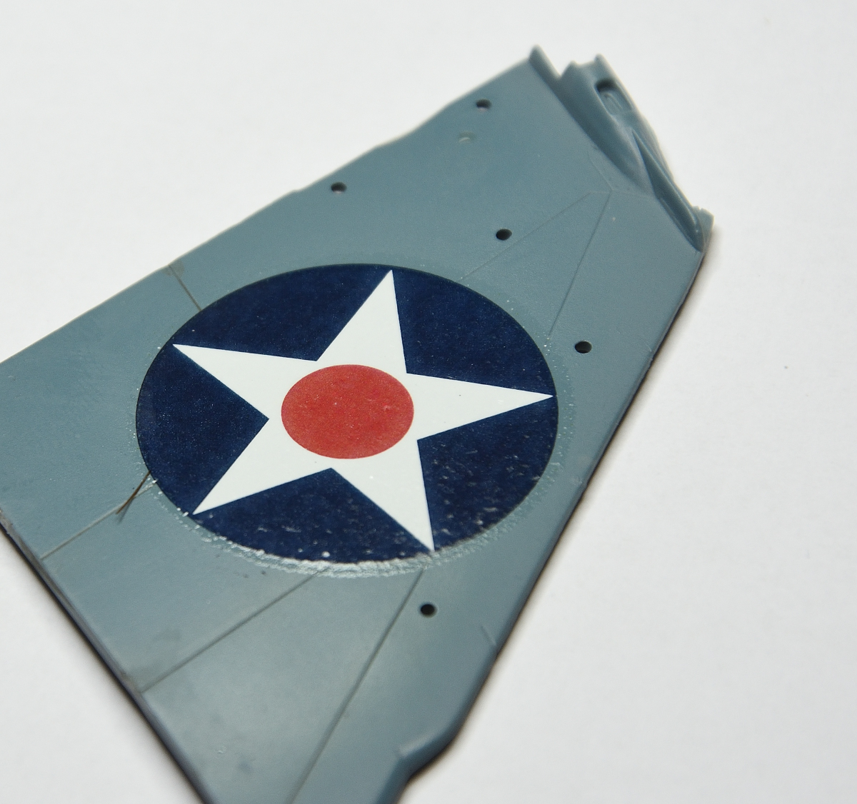

So this the decal straight on MRP with microsol

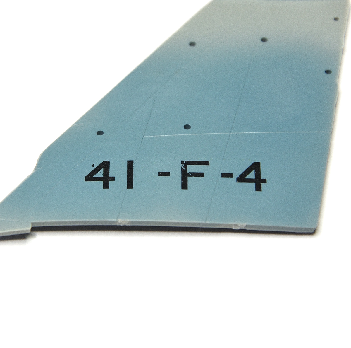

You can see the carrier film in the right light
obviously i have angled them to look at the their worst

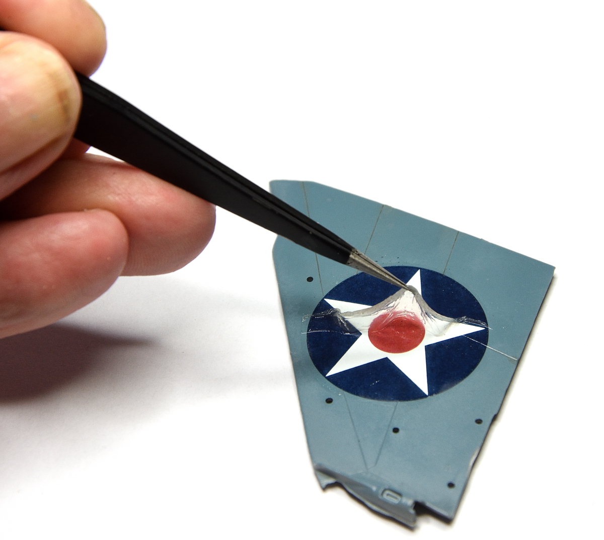

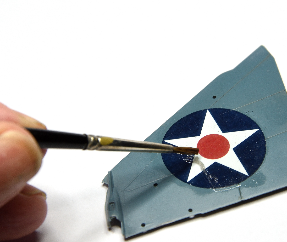

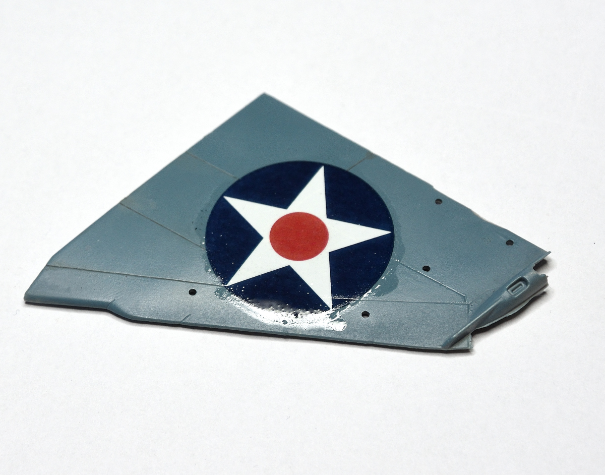

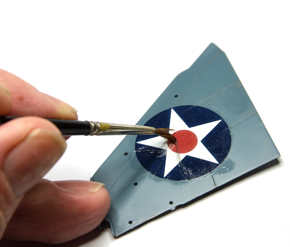

Here with white spirit applied, i think in the US this is turps ?
After a bout a 30 seconds you can work the carrier film with a soft brush and more white spirit and it will come off much like peeling skin after sunburn

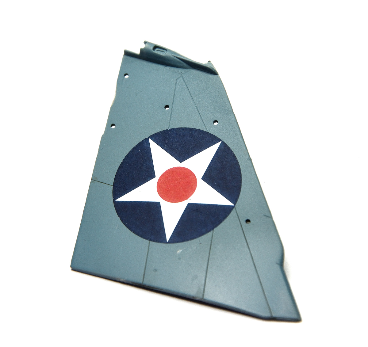

Wipe it down and give it a matt coat and you get pretty good results
Note this only works on Eduard decals and only on post 2019 !!!
