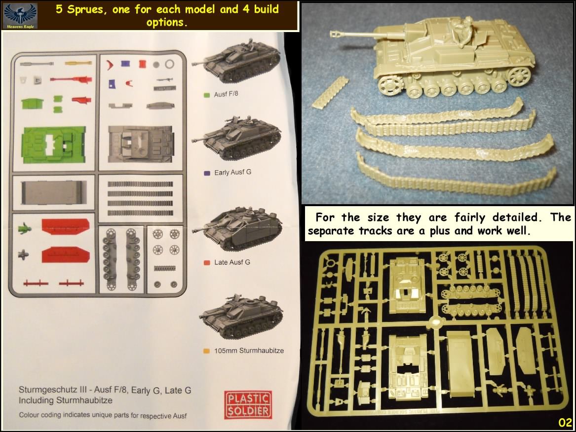

Then I had this mini box of Stug III gaming minis (15mm scale) that actually seem to be some nice little minis. For practice I decided to go ahead and build on these this weekend a little. Mostly need to do painting practice, so this will give me something to experiment on.
StugMini-001.jpg~original
StugMini-002.jpg~original
I probably won't have anything special here, just want to build something and not make it a huge project. Four months should be enough time. (I hope) :eek:hmy:
An OOB Dragon Stug B and some mini Stug's
That is cool, I hadn't seen the Plastic Soldier kits before.

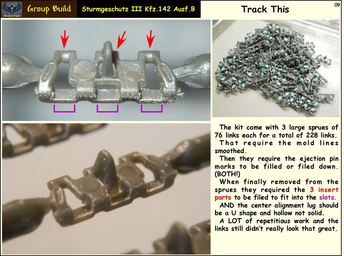

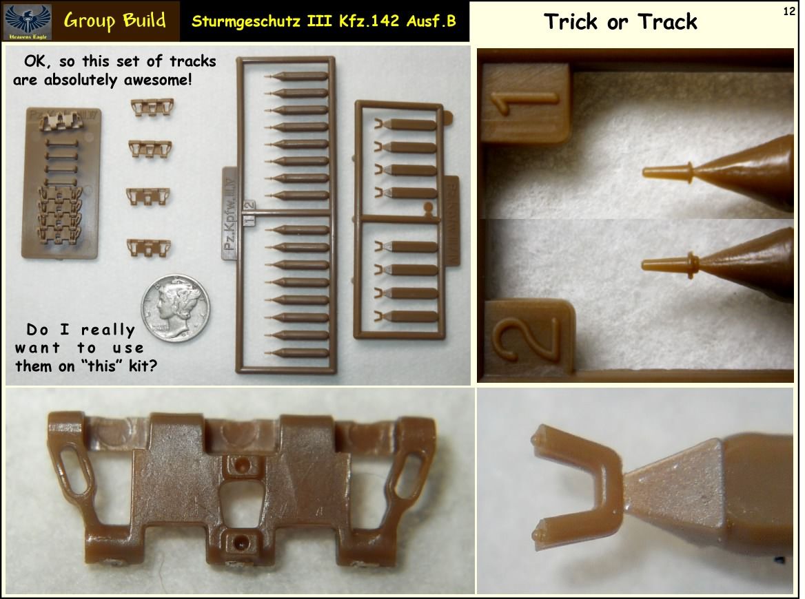

Have a question, This is the first armor odel I have built in years. As such I have dealt with the rubber tracks in ages past. This kit has 3 sprues of individual track links. Have been doing a lot of clean up of the links on the sprues. :blink
Anyway, does anyone have a suggestion on how to deal with getting the links together and wrapped around all the drive wheels. These are not the Magic Track and are still going to need some more clean up before they can be built onto the tank. :bang head

I wont be buying anything extra for this, though I might add a little stuff for stowage on the back deck. While the 228 track links are a bit on the rough side I am going to use them. Spent last night watching the old Buck Rogers series on DVD and removing all the micro flshing out of one and half of the 2nd track sprues. There are 3 sprues with track links and each sprue has 76 links on it . :blink :S
Once I have al the edges and flashing cleaned up , I will clip all the parts off and set up a little jig to drill through the alignment pins in the center of the links. The parts have them solid and they are not supposed to be. Then it's clean up the ejector pin marks on each link. :blink :blink
Then finally I will set up a little jig to set the links together and maybe tack them with a "touch" of Weld-on 3 and some tape to hold the links toggether.

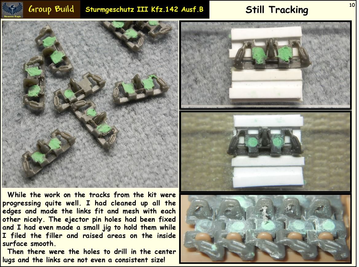

Spent the weekend working on 226 track links. Got all of the basic cleanup and de-flashing done and clipped them all out. I them proceeded to do a test fit. :blink :bang head
Yup you guessed it, the 3 little male parts were just a shade too large to fit the female part of the next link. (all of them) :facepalm
Good thing I have a fabulous set of escapement files and the nice square one worked wonderfully to clean all that mess up. (y)
Then it was time to clean up the 2 ejector pin marks in each link. :blink :gogo

This is where having the tools that I do and being able to make a small jig or two really makes the job go fast. The biggest help was investing in this set of files:
Which can be purchased here Cas-Ker Co
OK you looked at the price, don't choke! :blink
The truth is you get what you pay for and these beat the cheap files (which I have several sets) any day! (y) :D
I could not have reworked the links as quickly nor as well with any other files.
Last night I made a simple little jig that holds the links sideways so I can drill out that center tab that aligns them with the road wheels. Going to be drilling a lot of little holes. :S

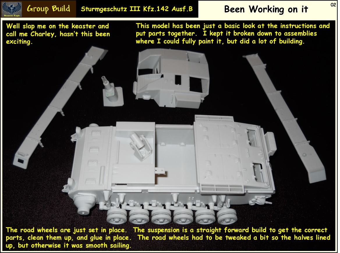

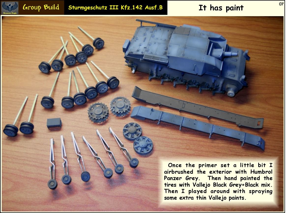

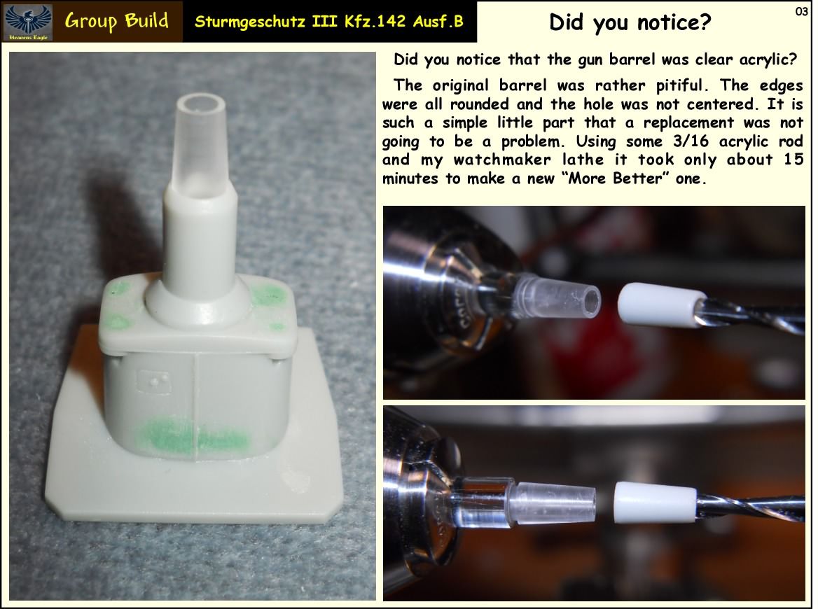

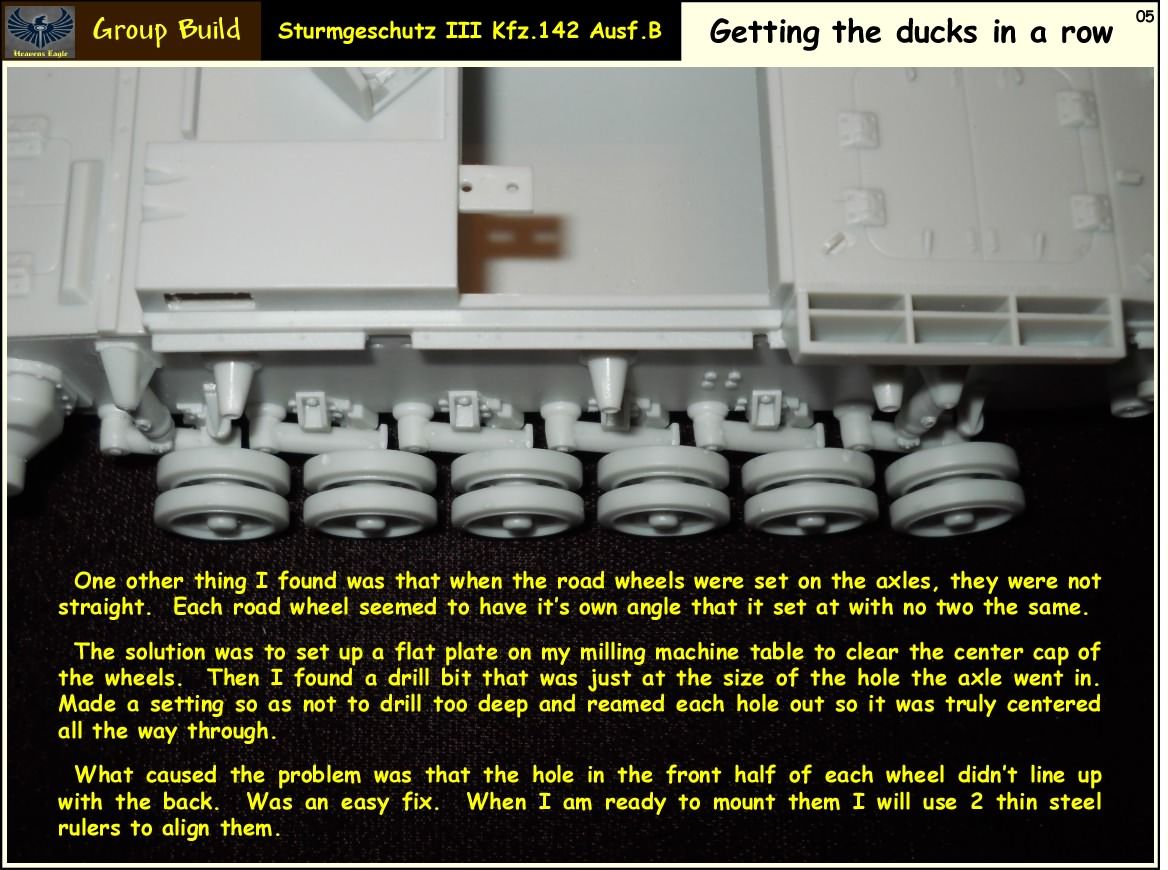

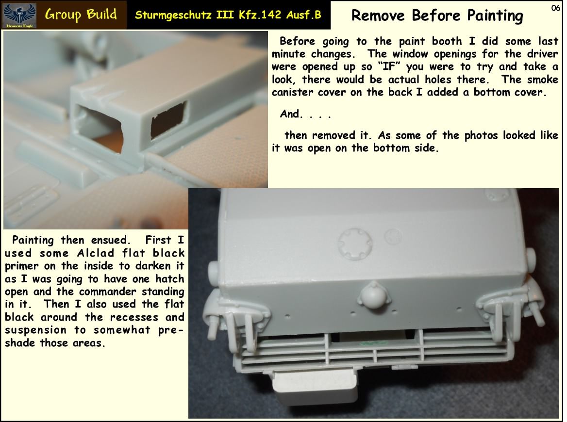

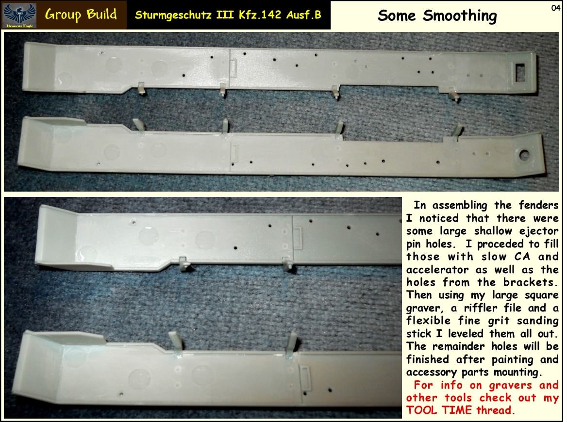

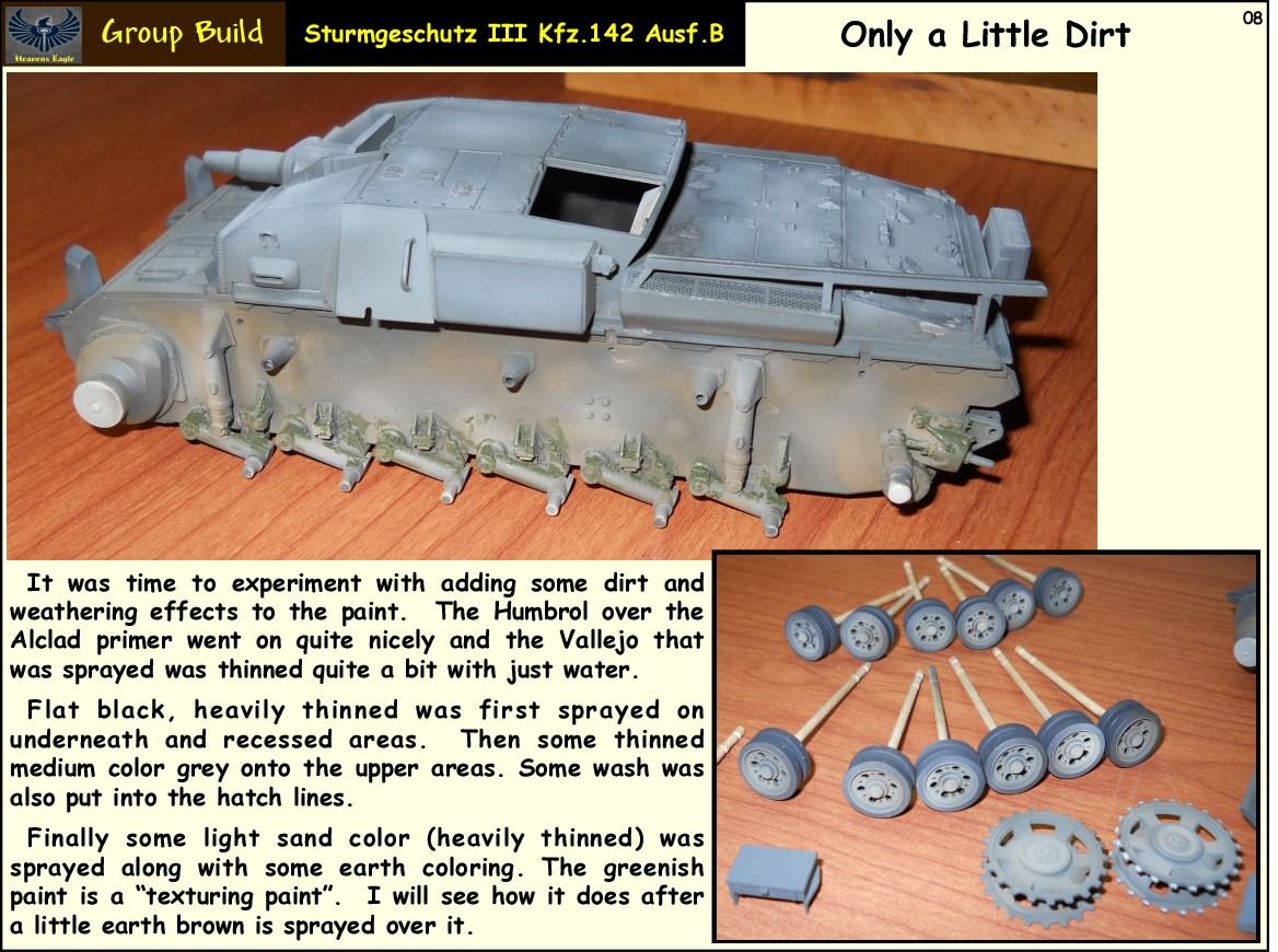

I have gotten a fair bit of stuff done on the kit and am just now getting around to posting again. Mostly it is just a straight build nothing fancy, but the track links have been the sticking point. Solved that and am now moving along again.
So here is a restart and an update to where I am now:
StugIIIAusfB-001a.jpg~original
StugIIIAusfB-002.jpg~original
StugIIIAusfB-003.jpg~original
StugIIIAusfB-004.jpg~original
StugIIIAusfB-005.jpg~original
StugIIIAusfB-006.jpg~original
StugIIIAusfB-007.jpg~original
StugIIIAusfB-008.jpg~original
StugIIIAusfB-009.jpg~original
StugIIIAusfB-010.jpg~original
StugIIIAusfB-011.jpg~original
StugIIIAusfB-012.jpg~original
StugIIIAusfB-013.jpg~original
StugIIIAusfB-014.jpg~original
StugIIIAusfB-015.jpg~original
That's it for now folks. The track link thing had me stymied for a bit :bang head that is all better now (I hope)

With all I did they were still "maybe" about half done Bob. I still will have them for emergencies or adding spares if I really need them. What finally killed them was the inconsistancies in the sizes of the center tab. Then to open up that tab is going to be a PITA that I don't want (or need) to be doing at this time.
