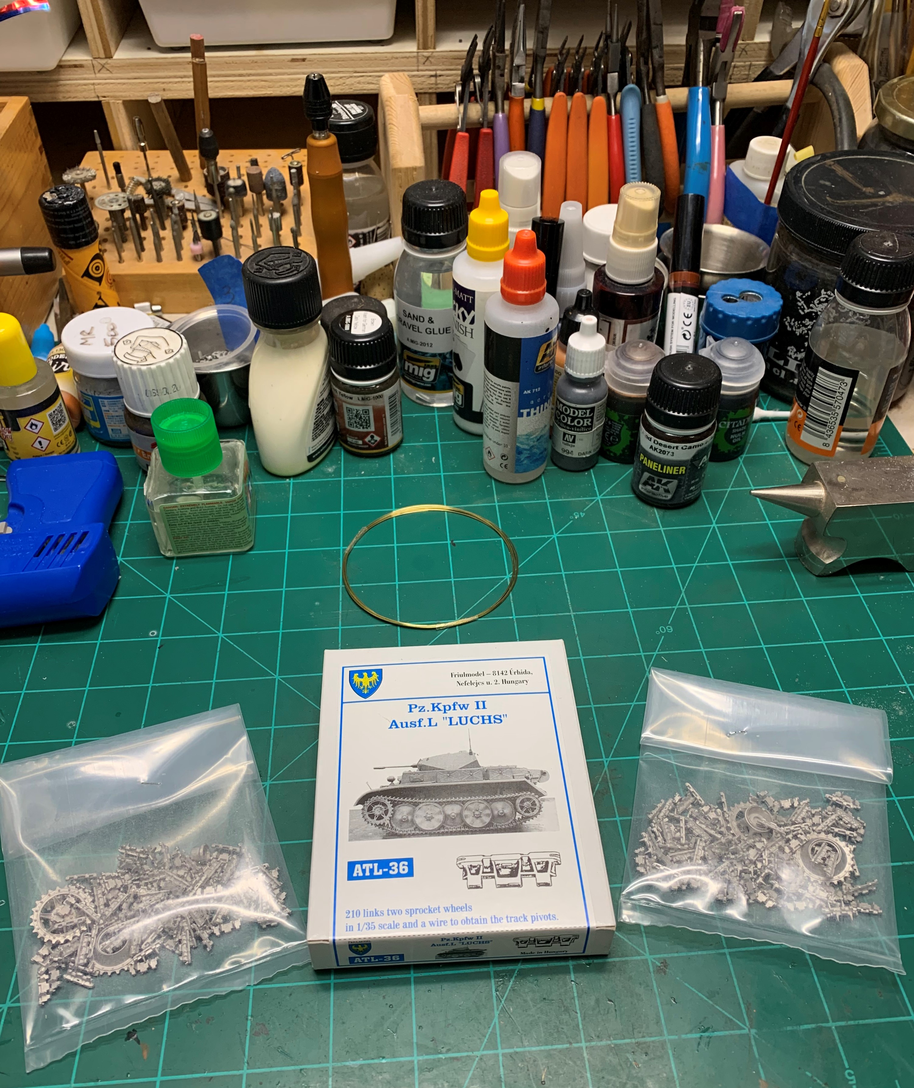

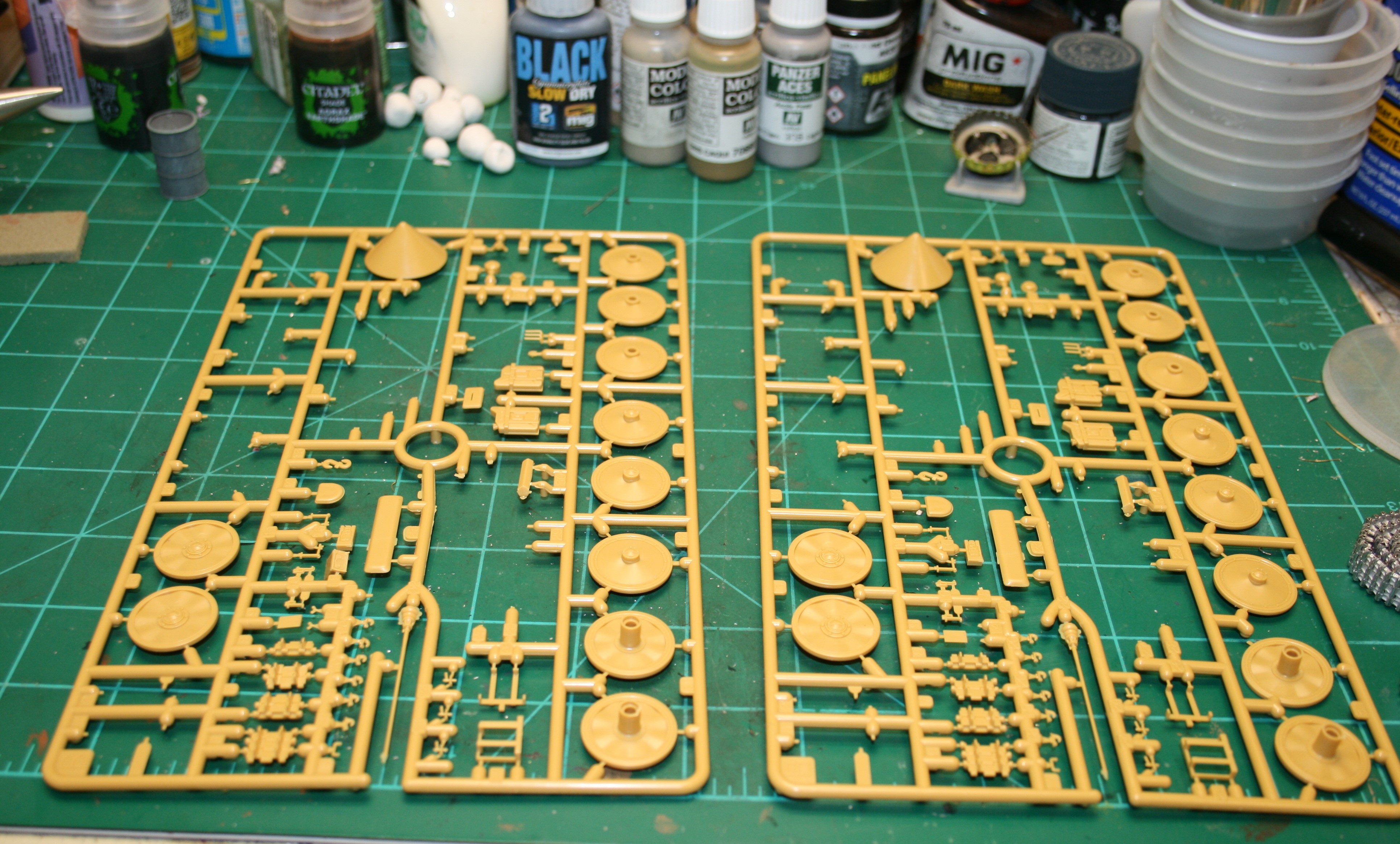

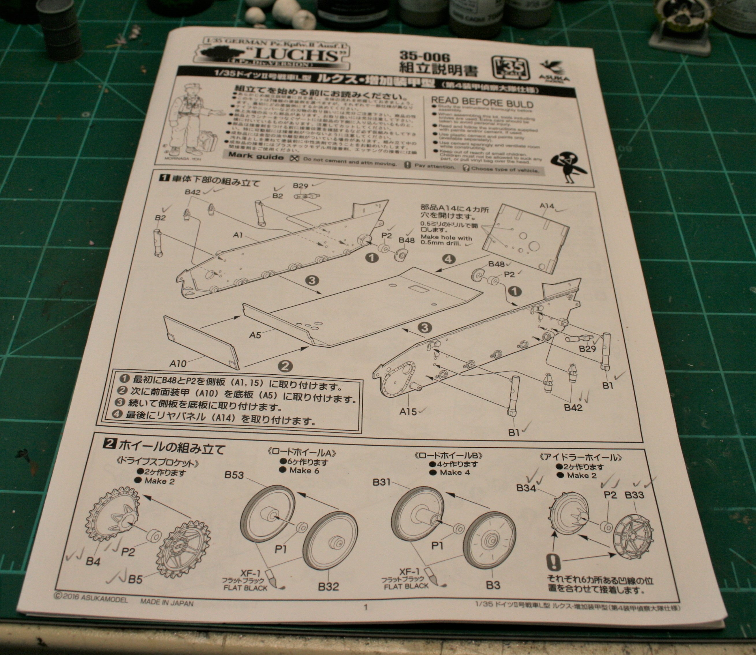

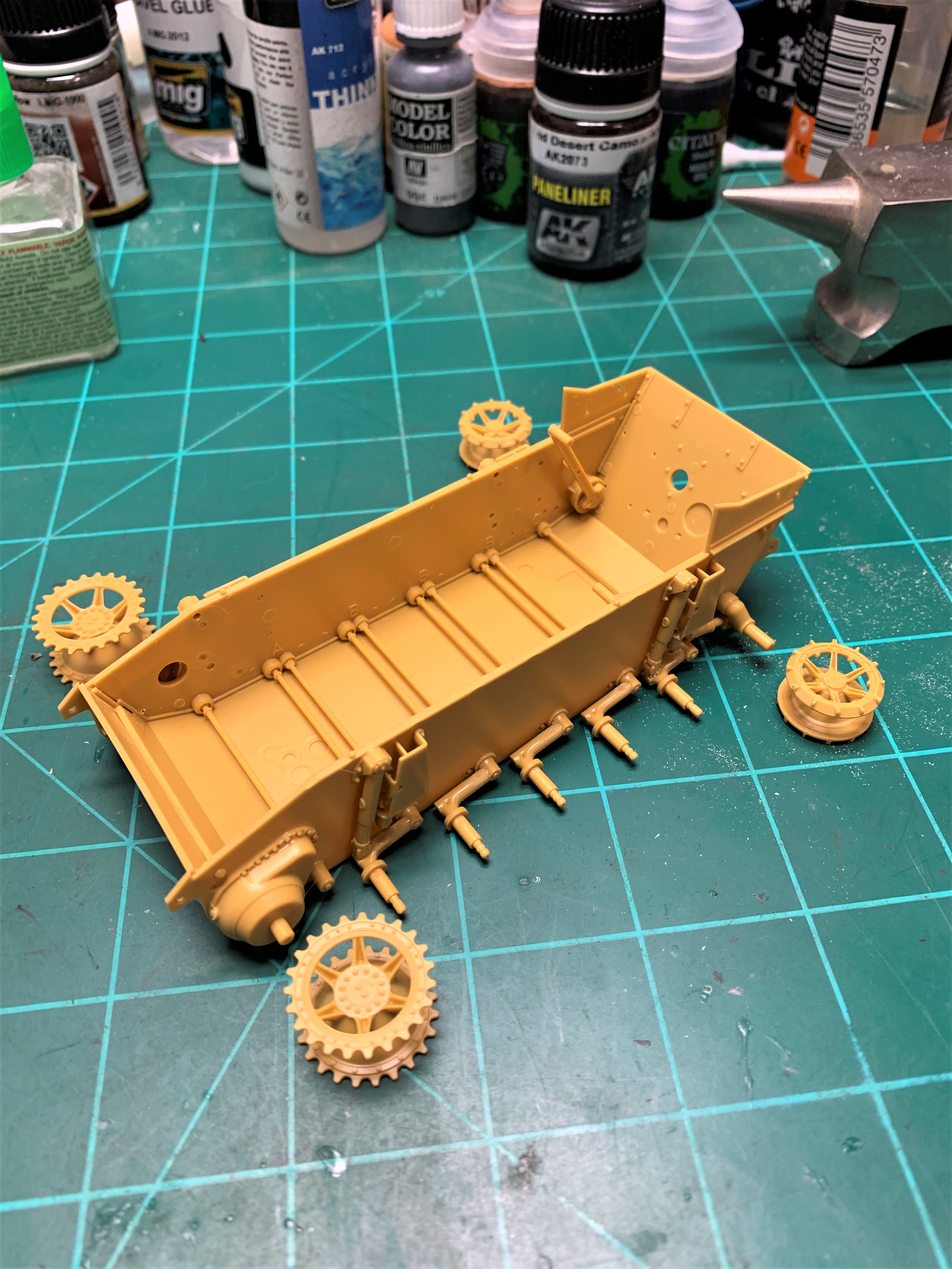

Assembly of the suspension was pretty straight forward, the kit comes with rubber band tracks and I just couldn't bring myself to use them. This set of Friuls has been problematic, I've had to drill out every link so far. Makes you wonder if their quality has slipped or if this is just an insulated isodent. :bm:Maybe the second set won't be as bad (yeah right).

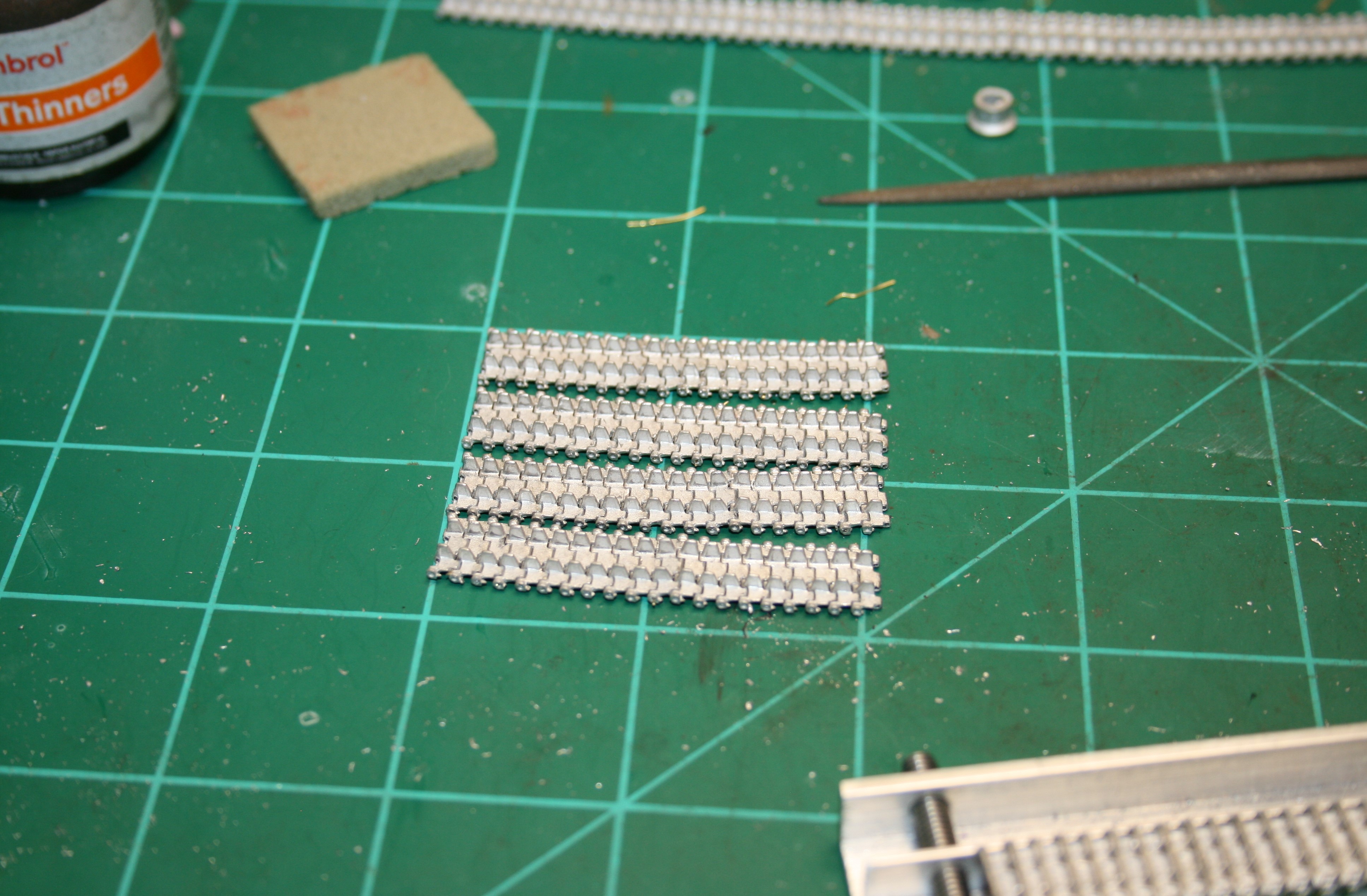

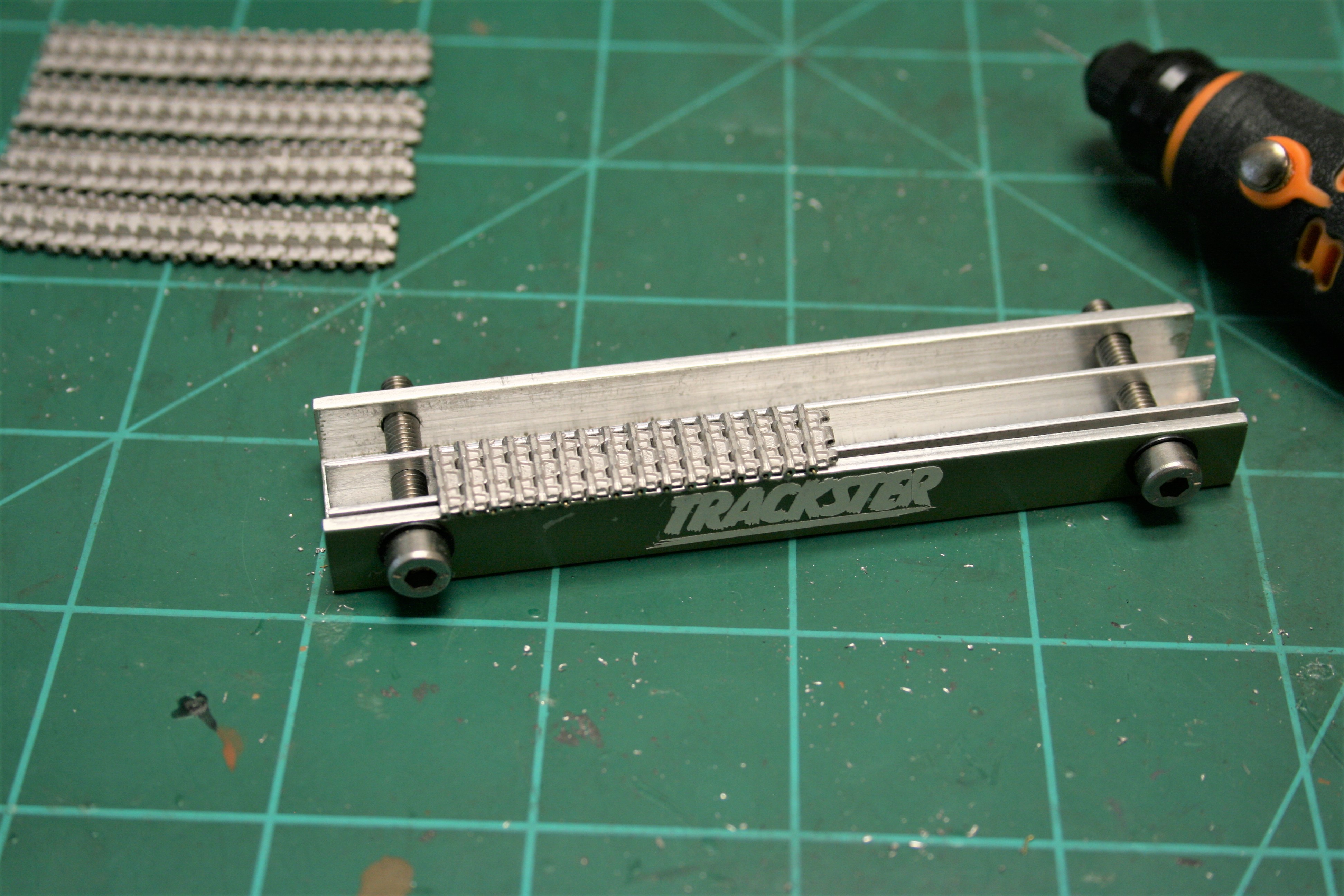

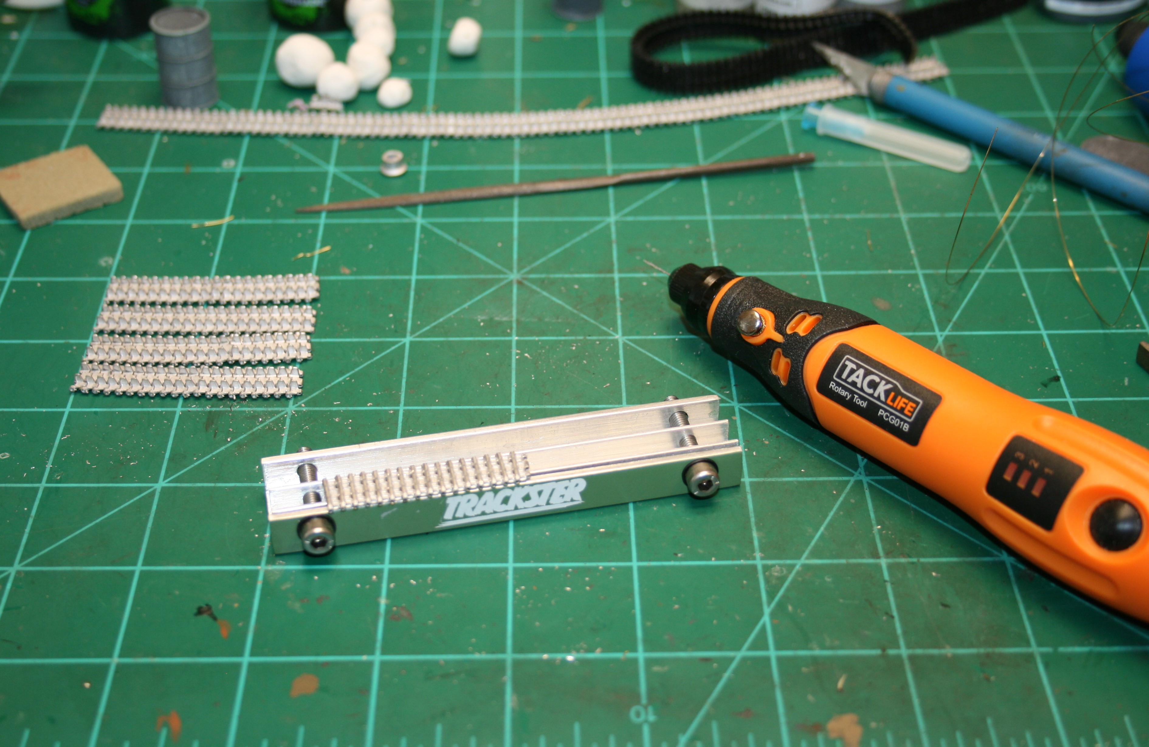

Thanks Bob. Well, as suspected, the second run was only marginally better than the first. All the links had to be drilled to get the pin to be inserted. My wife bought me this handy little cordless tool around Christmas, it works great for drilling the track links! Just add a .4mm HSS bit.
It's tedious, but the results are worth the extra effort compared to the vinyl tracks. The Trackster helps get the links aligned while inserting the pin.

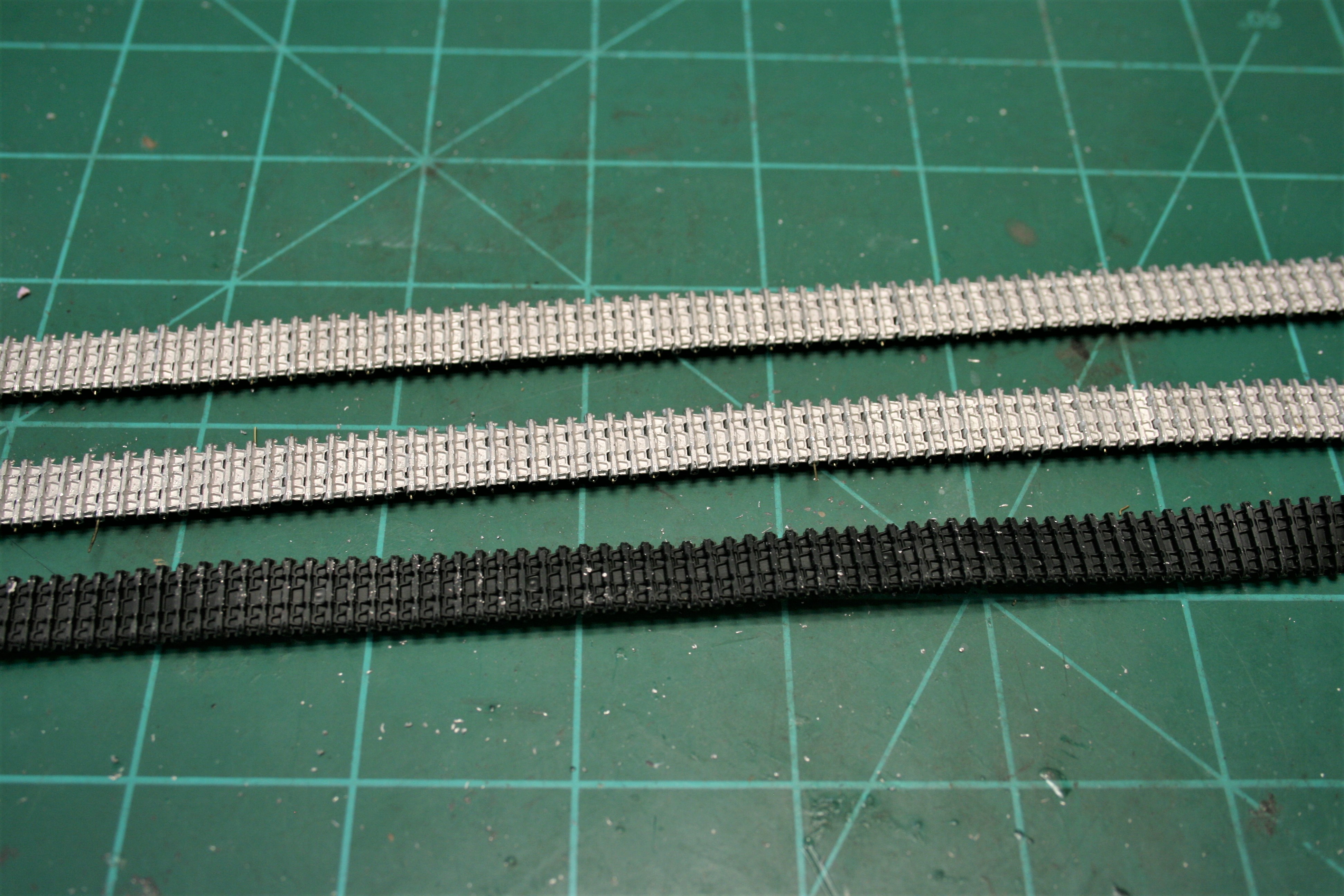

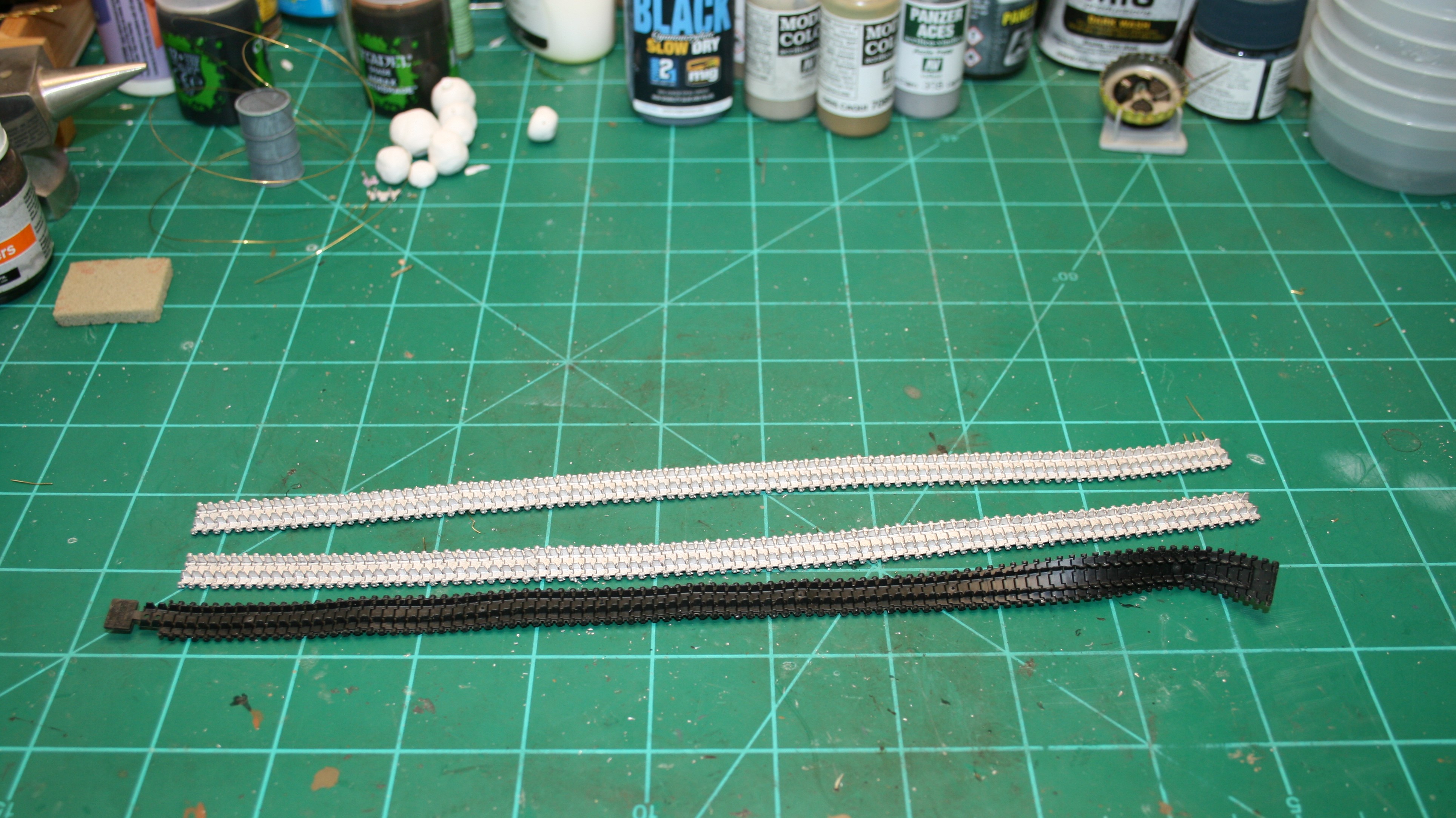

Here's a comparison of the tracks.
There is a track tensioner built into the kit if you should want to use the vinyl runs, but I just couldn't do it.
The instructions are mainly in Japanese.

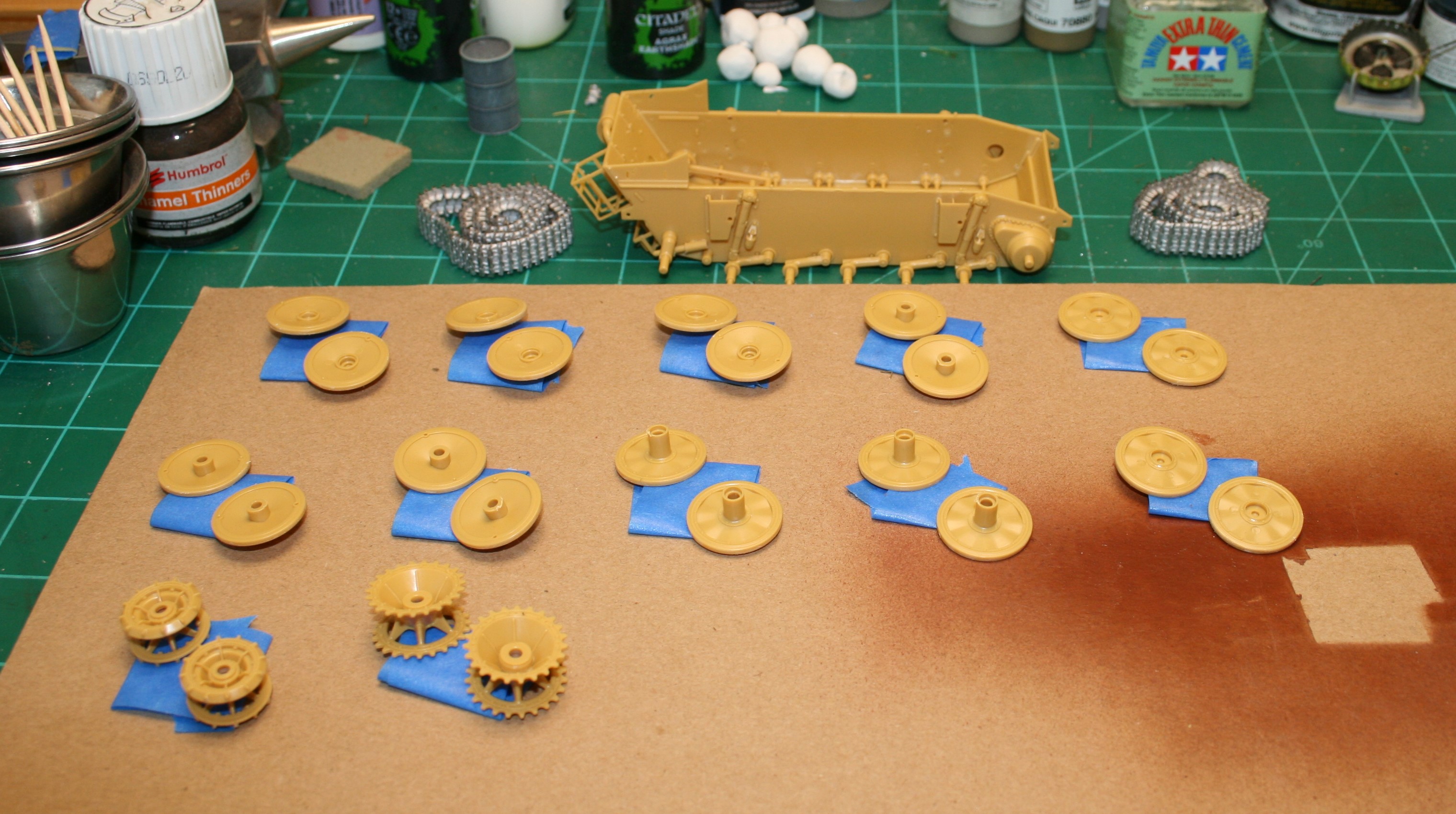

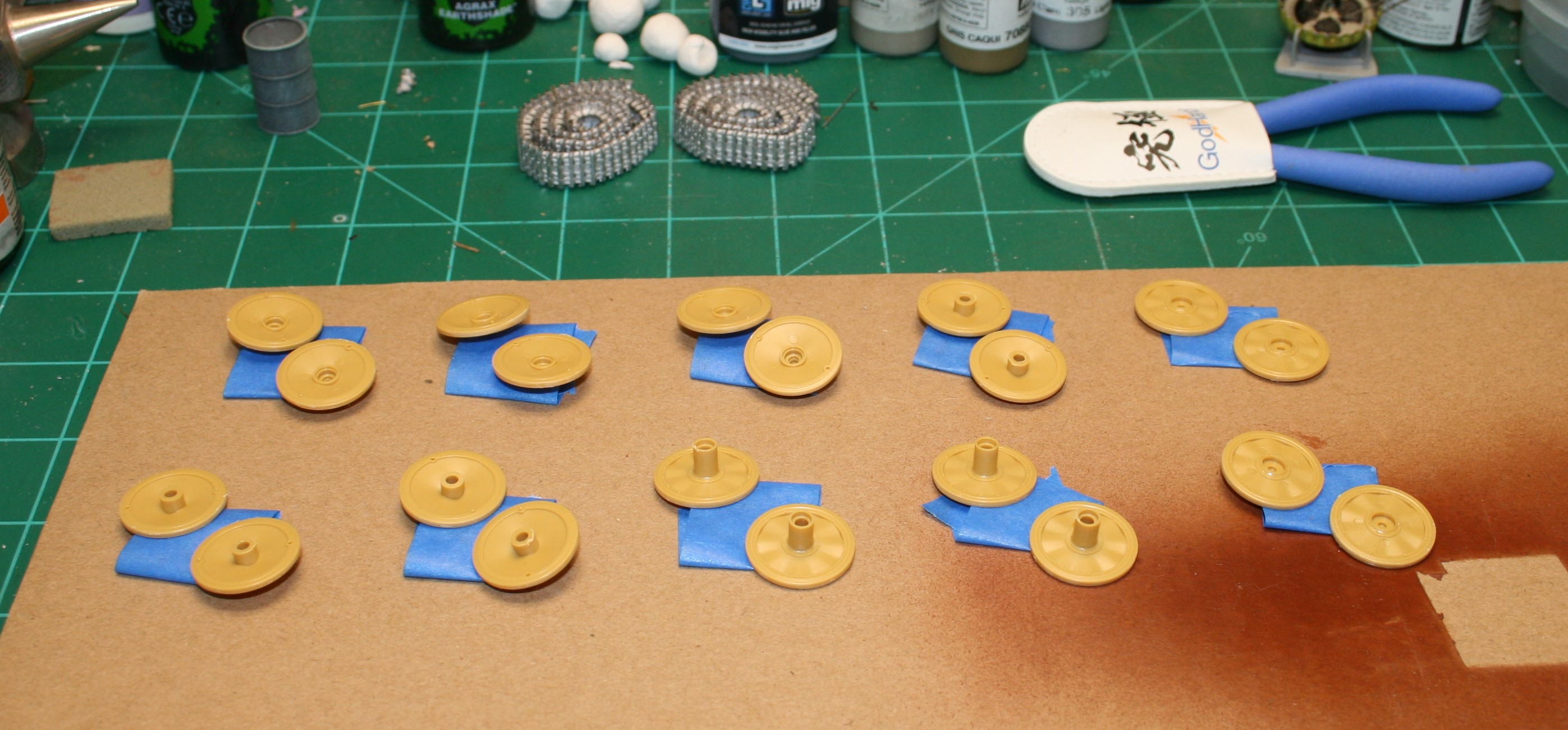

On to the road wheels!

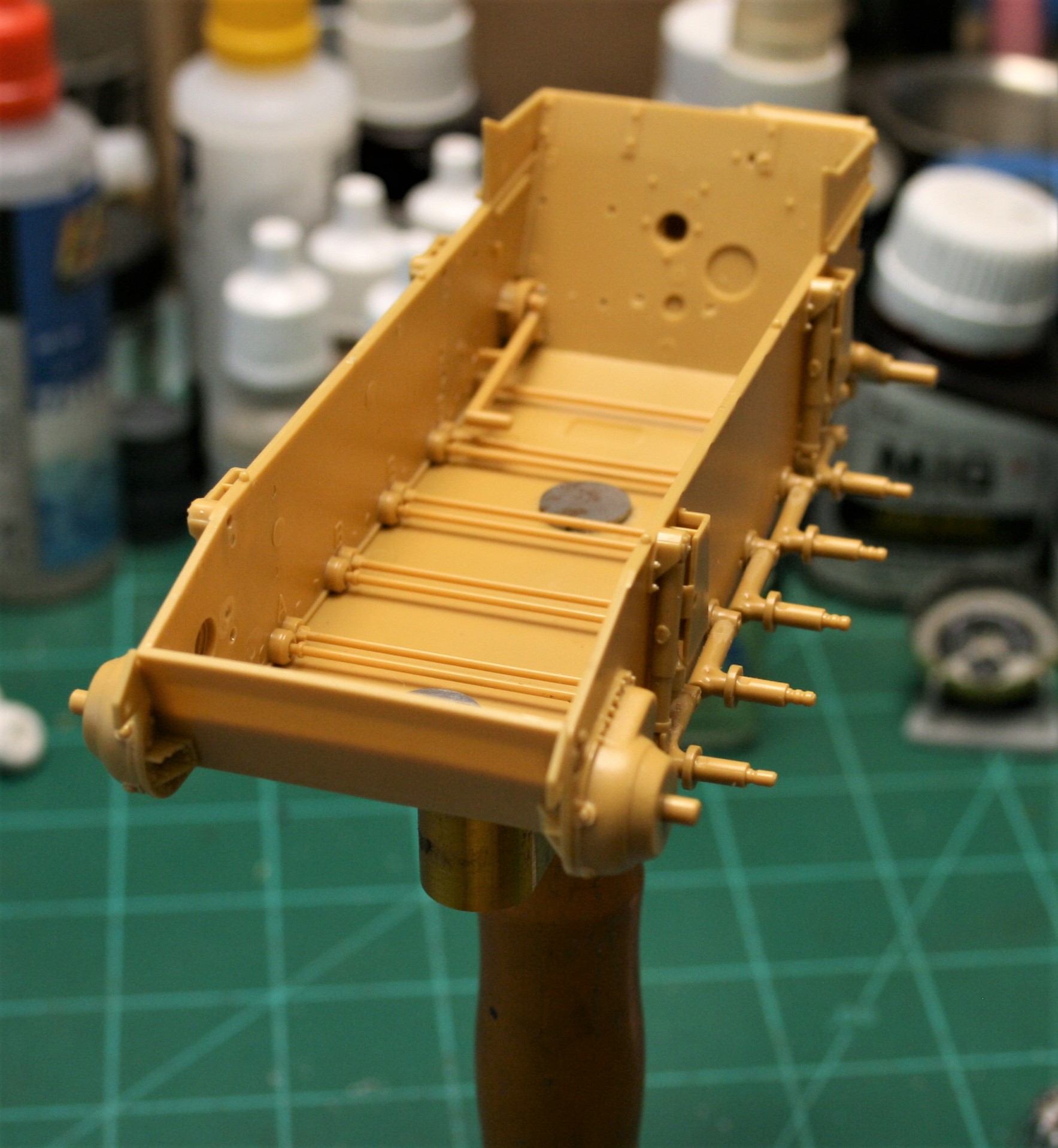

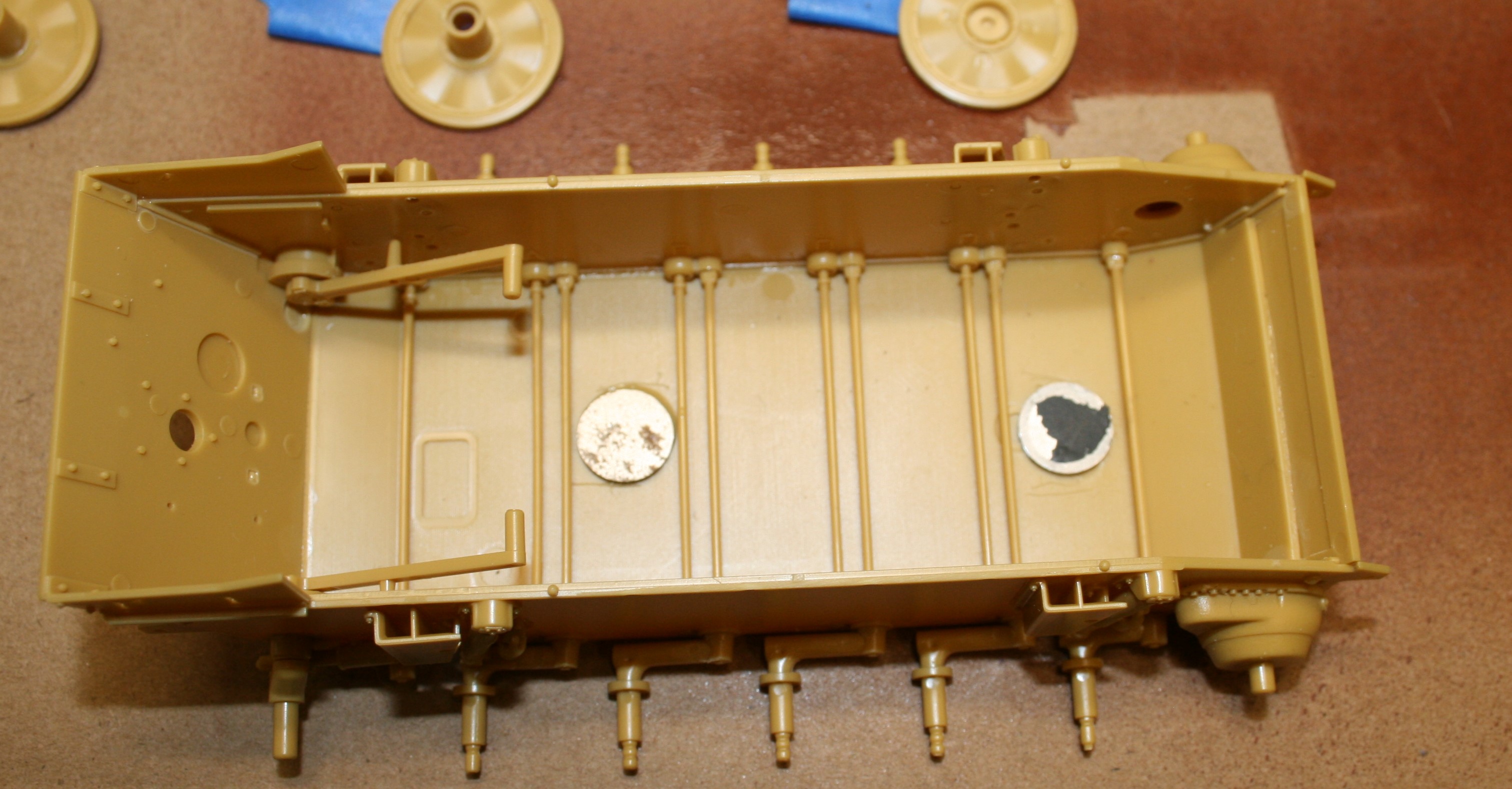

I added a couple steel discs inside the hull for my magnetic handle.

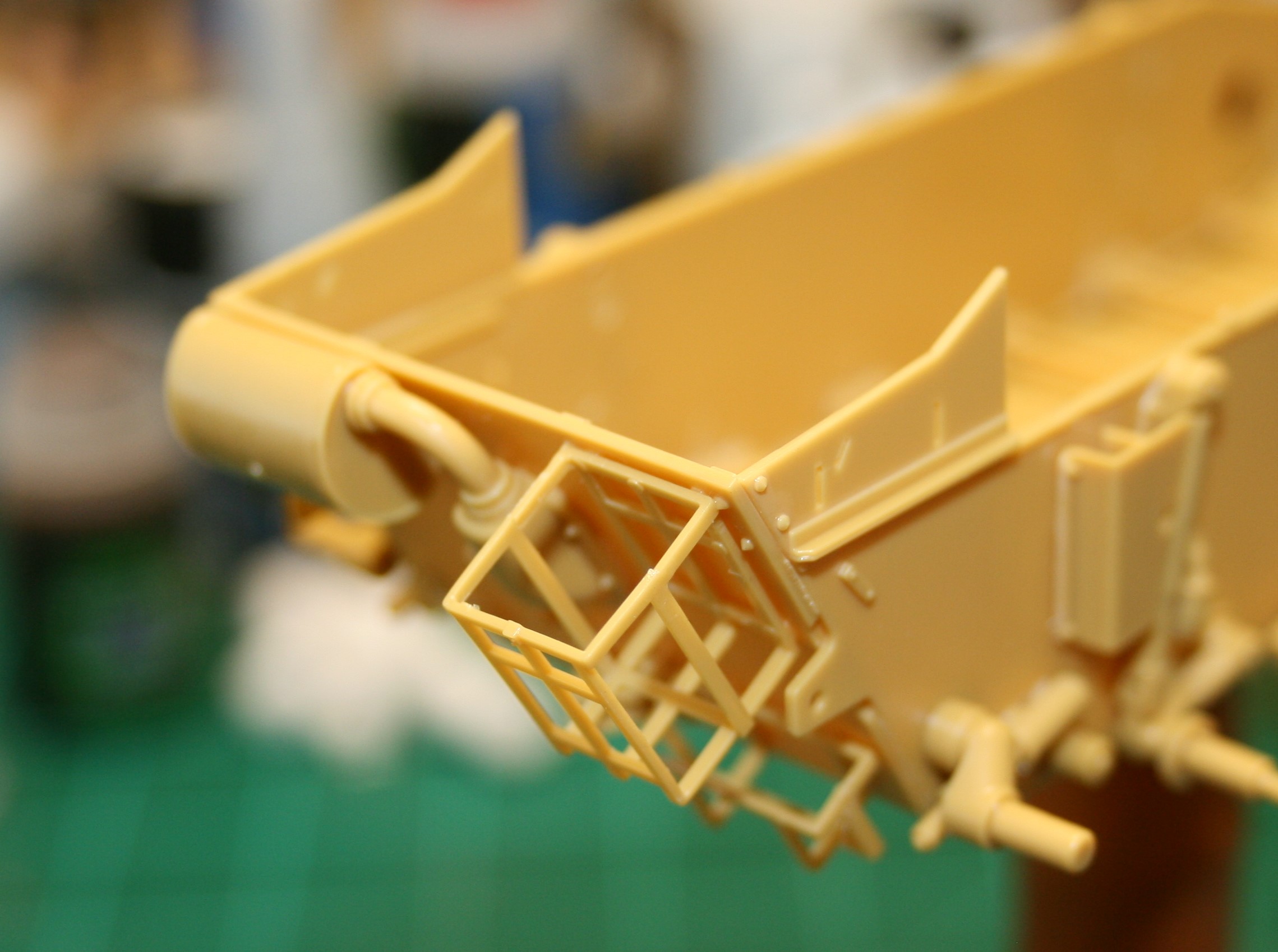

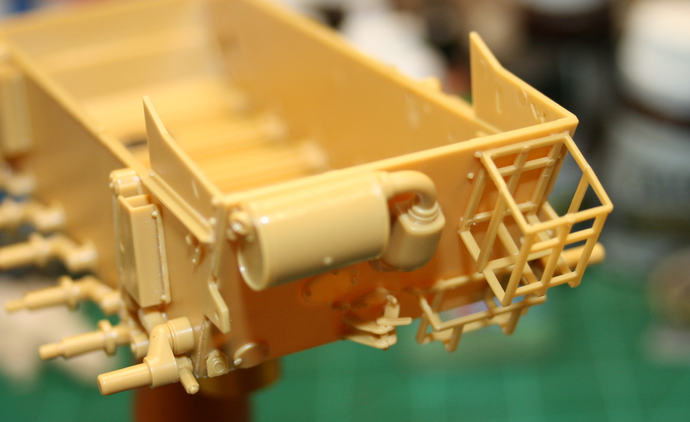

There are a couple jerry can storage racks on the rear and the exhausts to add before we can prime the lower hull.

The sun is out and the temperature is climbing, so it's off to the paint booth for me. Much more to come, thanks for coming by!

What a nifty little kit! The rear racks are impressive in injection molding! Are those levers inside the rear of the hull the track tensioners?:ro::vgood:
I haven't looked at my Tiger I Fruil's yet. Some of our club members have had a similar comment.
Yes, the levers are the track tensioners. The three center suspension arms move up and down too, so ought to be able to get some cool track effects.

What's that Trackster tool, I don't remember seeing it before. (disclaimer: there's a possibility that I did read about it and yet, not remember.)
Great start on the Luchs Mike. Defiantly the quality of Friulmodel have dropped which is just sad.
Thanks guys! As I am reading the Friulmodel homepage, it seems they will be selling direct to private customers, rather than wholesalers and hobby shops for resale. The Trackster 1.0 was purchased from Solidscale, Alex hooked me up during the pandemic by keeping me informed on the order status and I've used it hard since it arrived. Find his products here. https://www.solidscale.de/solid-scale-1/trackster-1-0/
