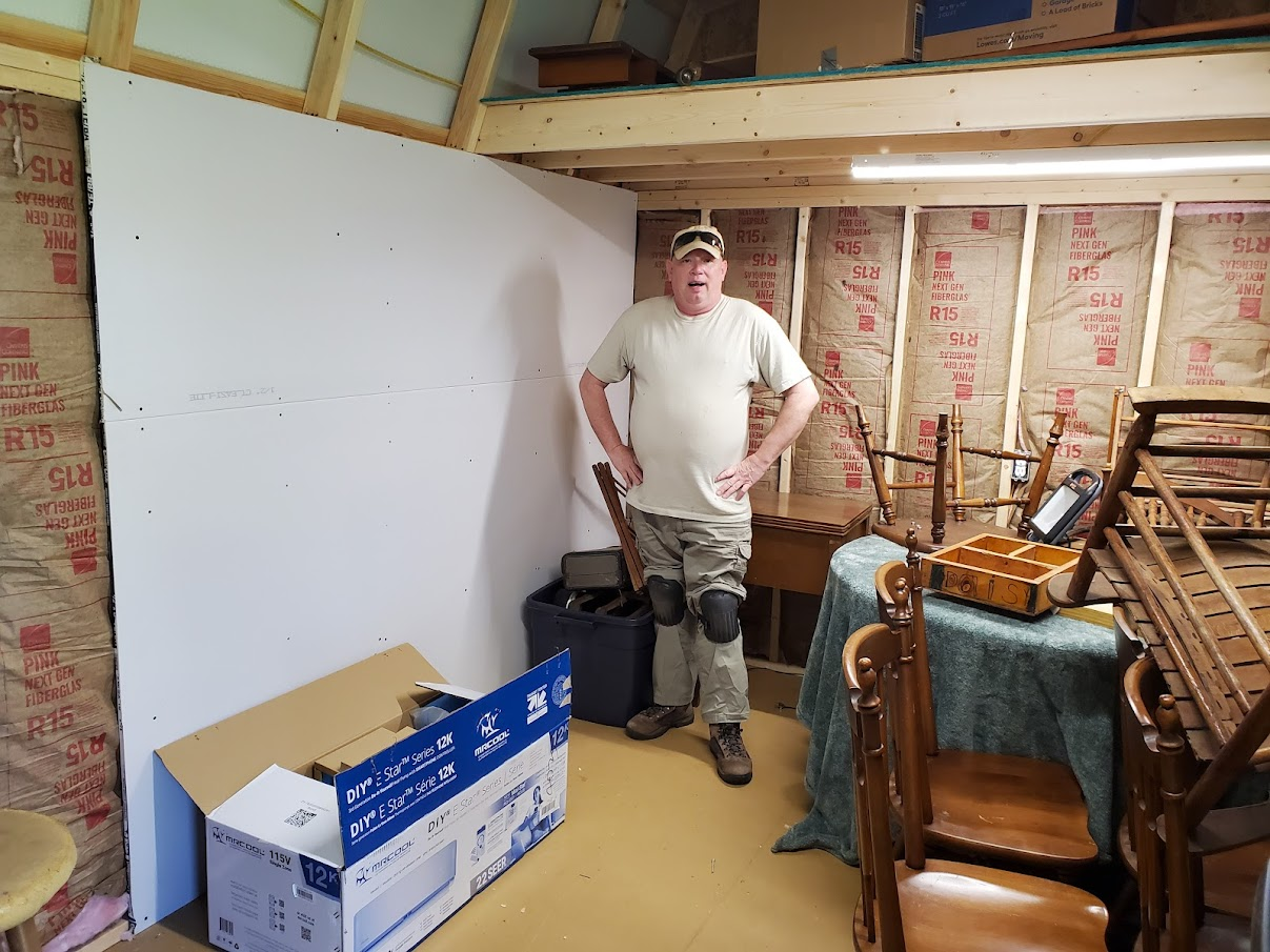

Thanks bunches to Eric for helping me get 6 rolls of insulation and 1.75 sheets of drywall up. The greater goal here today was to get that dry wall up on the wall before the HVAC crew shows up on Tuesday to install our new system (long story...). I asked them to throw in installing my "DIY" system.
One thing Eric and I learned today is I'm hiring out whatever work I'm going to do on the ceiling! 😒

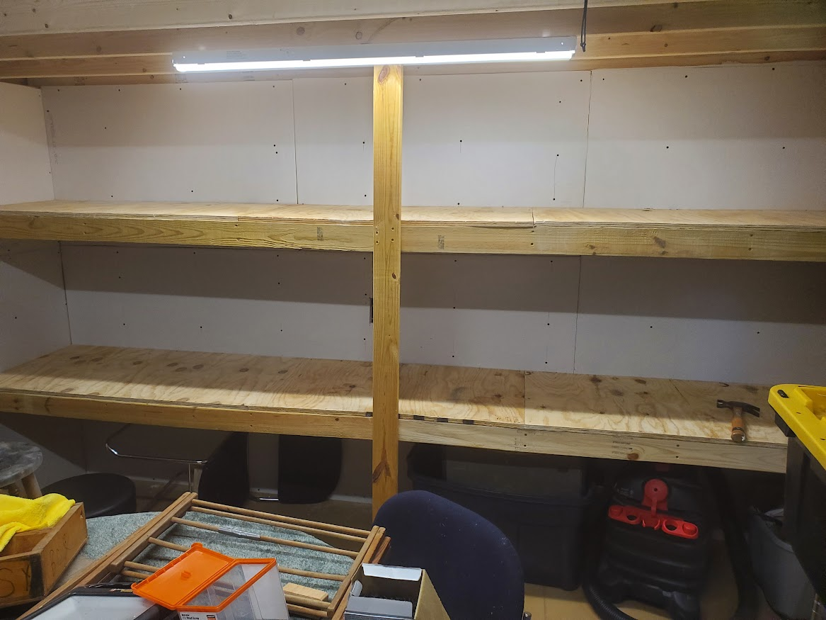

I got the shelves finished up the other week and started moving long term storage stuff in there.

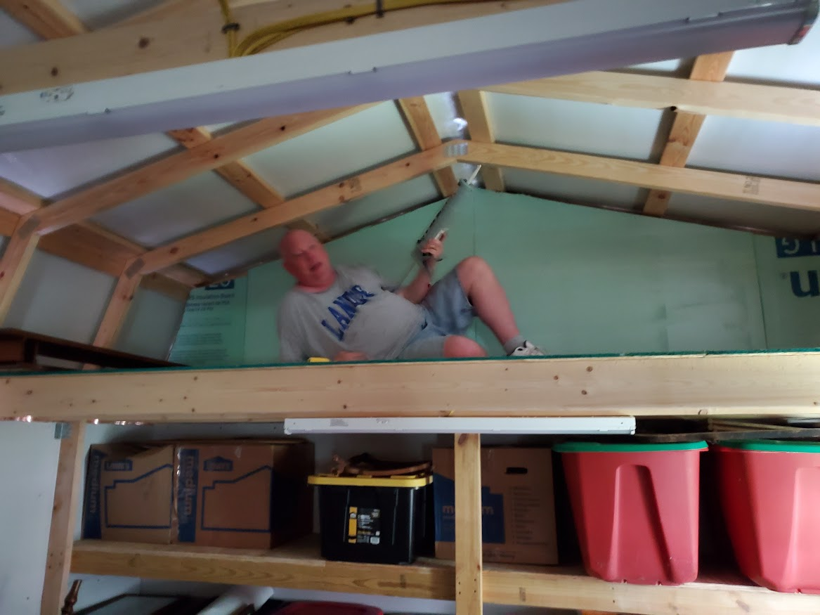

First order was getting the loft cleared out and repacked. since we had everthing out we figured might as well put the 4" foam insulation in place. After many cuts, measurements and eyerolls at each other we got the job done.
This was the best glamshot we could get with Eric armed with the liquid nails.

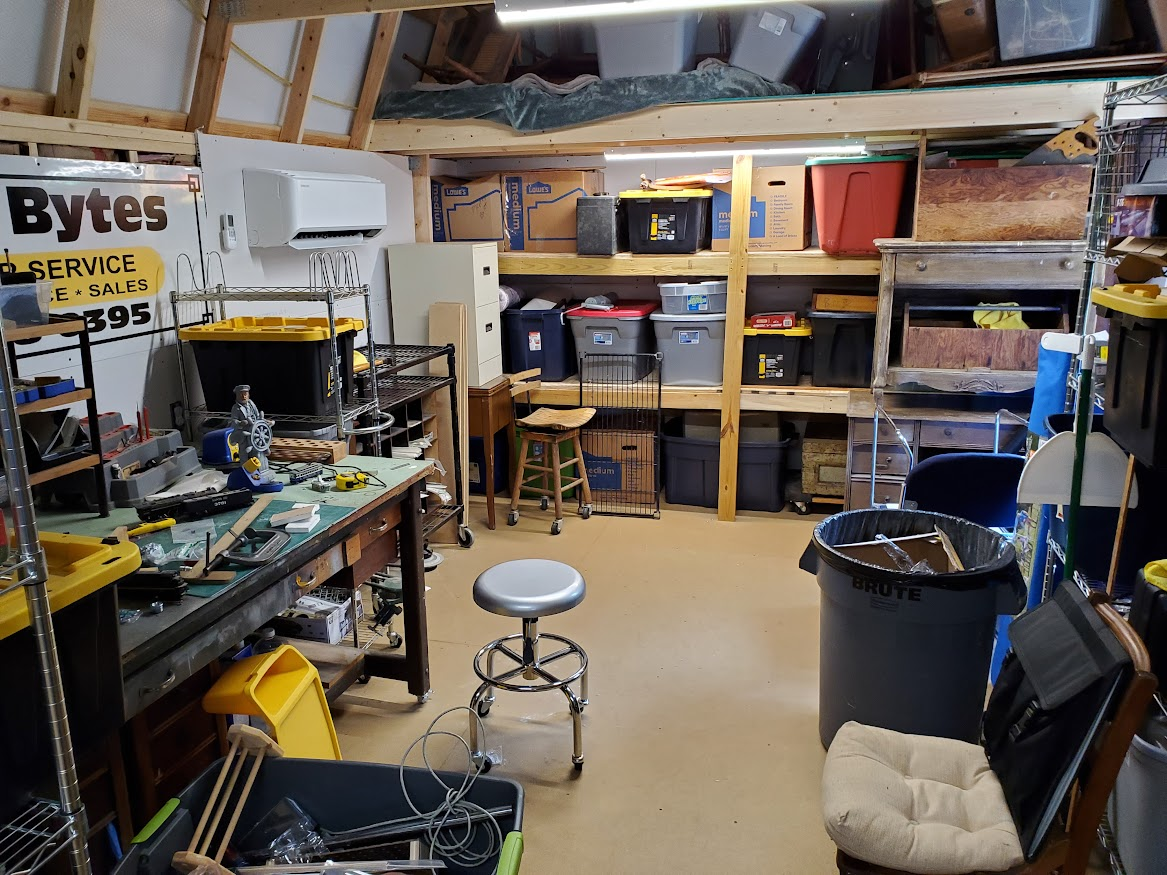

We got the kitchen table dismantled and stowed up in the loft, rearranged other storage and then the lay out of the shop. Modeling shop is to the west,
As you can see I got a lot more room to move about and the bench is clear to be stocked and lit up.

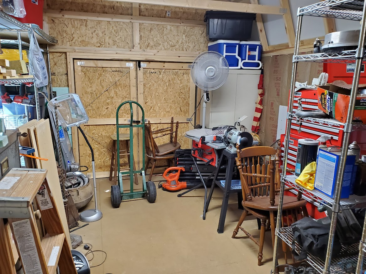

The east side of the shop will be the electro/mechanical shop
More insulation is on order for the roof and I have to get some more foam for the barn door end.
The Samsung AC did a great job of keeping things cool considering the 105 heat index we were facing when we gave up work.
