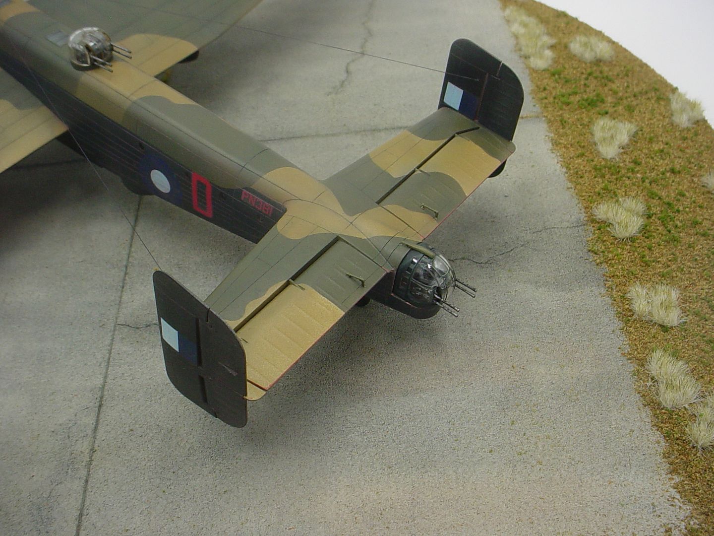

The model represents an aircraft of 1341 (radio countermeasures) flight stationed at Digri, India in May/June 1945. The markings came from DK Decals 72016 'No. 100 Group RAF'. To convert the kit from a bomber to a RCM aircraft, I fabricated a 2nd ADF 'football' from one of the kit's 250 lb bombs and carved some bomb bay fuel tanks from balsa wood. I made straps for the tanks from some 1/43 race car seat belts. I rescribed all of the panel lines so they would better hold a pin wash and used an Eduard Zoom set for additional cockpit and crew stations details. I used an Eduard canopy/wheel hub mask set and an AML camoflage mask set. The rest of the build was pretty much out of the box.
The kit fit fairly well with the exception of the engine cowl halves. They simply did not match up and, since the seam ran through the middle of the carburetor scoops and the oil coolers, i ended up doing a lot of tricky sanding and re-scribing. The nose transparency is very thick and had a lot of optical distortion. I attempted to minimize that by sanding the interior of the piece with successively finer grades of sanding wands (from 180 grit to 12,000 grit), polishing with plastic polish, and then brushing on a coat of Future. I ended up with less distortion, but a somewhat cloudy clear piece.
The kit lacks two diagonal bracing bars in the aft section of the cockpit transparencies. They are visible and should be added. I missed this detail until after the clear part had been installed and painted. The kit provides all of clear parts for the earlier versions of the Revell Halifax kits and the instructions indicate that some of ones on the sides of the nose that were not present on the B Mk. III are to be installed. The Eduard mask set compounds the error by providing masks for those same windows despite the set being dedicated for the B Mk.III. Check references. The nose gun was a Vickers K, a drum fed weapon with a pistol grip and shoulder stock. The gun provided in the kit appears to have a .50 calibre receiver and grips and a K gun barrel. Some late model Halifax B Mk.IIIs had .50 calibre guns, but in the only photo that I could find of the subject, the nose was covered with a tarp. I went ahead and used the kit gun with a Mini World machined brass barrel. The auxiliary bomb bay doors are represented as scribed lines on the fuselage whereas the lower edges should stand proud of the sides of the fuselage where they transition into the bottom of the fuselage. I didn't address this issue.
