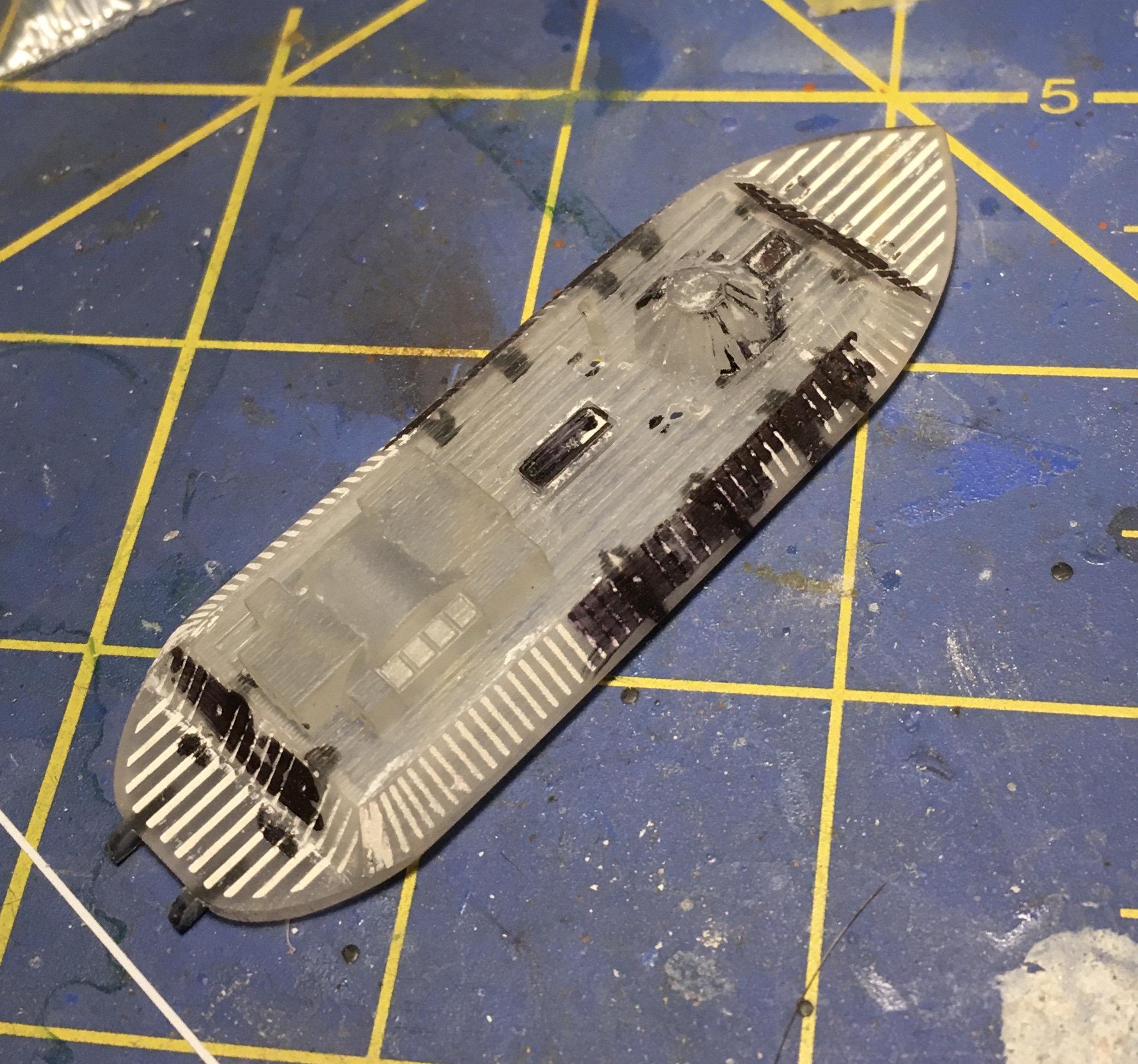

All these chunky details HAVE GOT TO GO! I hired the maker to alter the original 3D print. Custom deck planking, armor texture. No smoke stacks. I should have kept my mouth shut. USS Carondelet is accurate in length & beam. Her profile isn't terrible, considering.
The shaved gun port hatches will be replaced by parts to display them opened out with cannons primed for a fight.
The brass tube stacks are near the proper diameter, if jus a wee bit too tall.

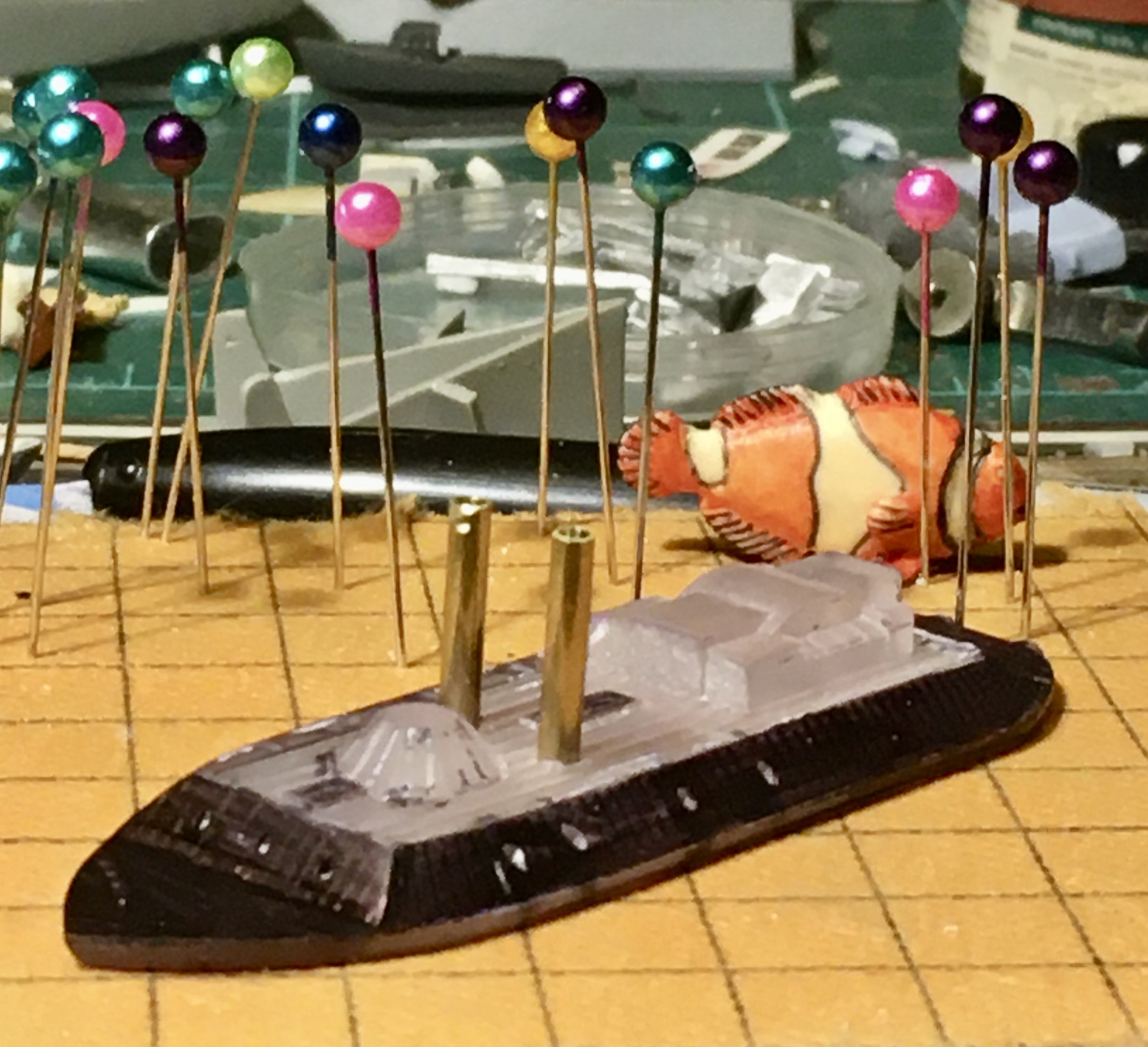

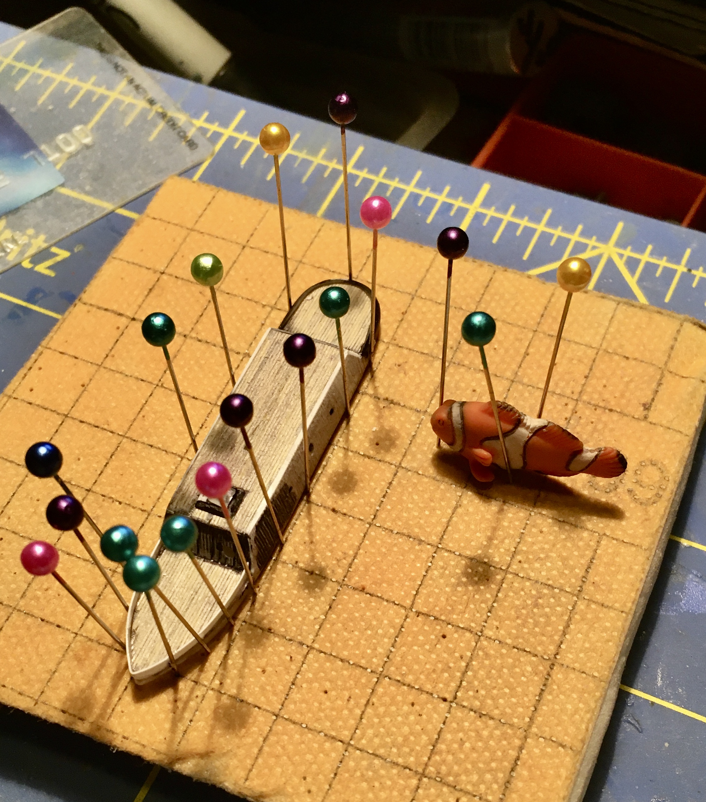

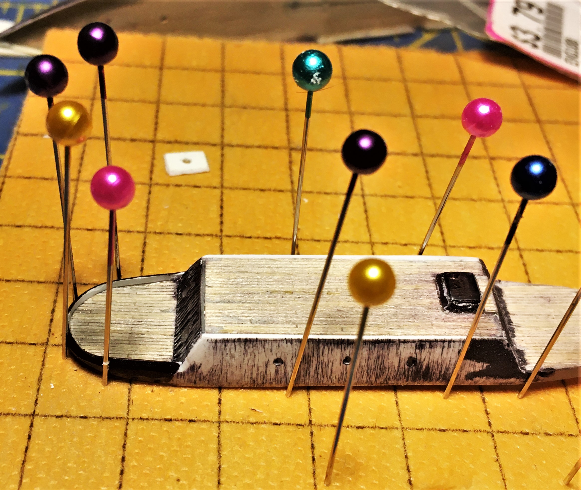

CSS Arkansas is under Party Balloon attack! Her stern deck rail is coming along just fine!

Thanks Men! The english version of "99 Luftballoons" seems more fitting for Civil War Ironclads, does it not?! :lol:

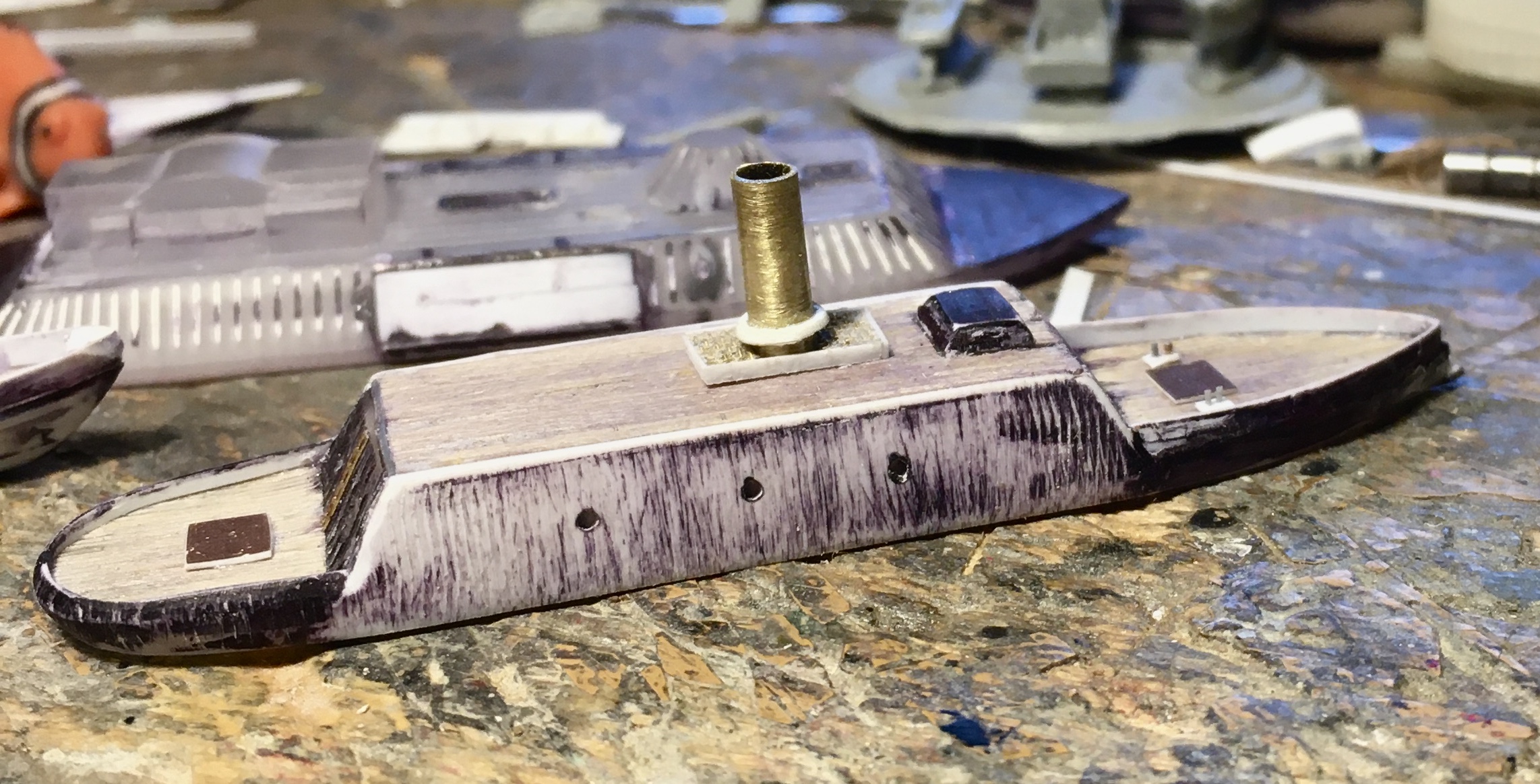

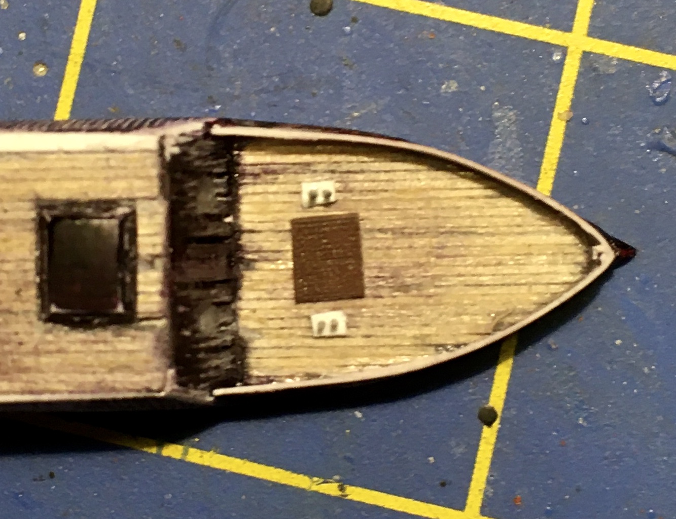

IMG_E7381.JPGCSS Arkansas braves the (not quite) 99 Luftballoons as her bow railings are installed.
IMG_E7383.JPGOne mustn't forget Her ram!

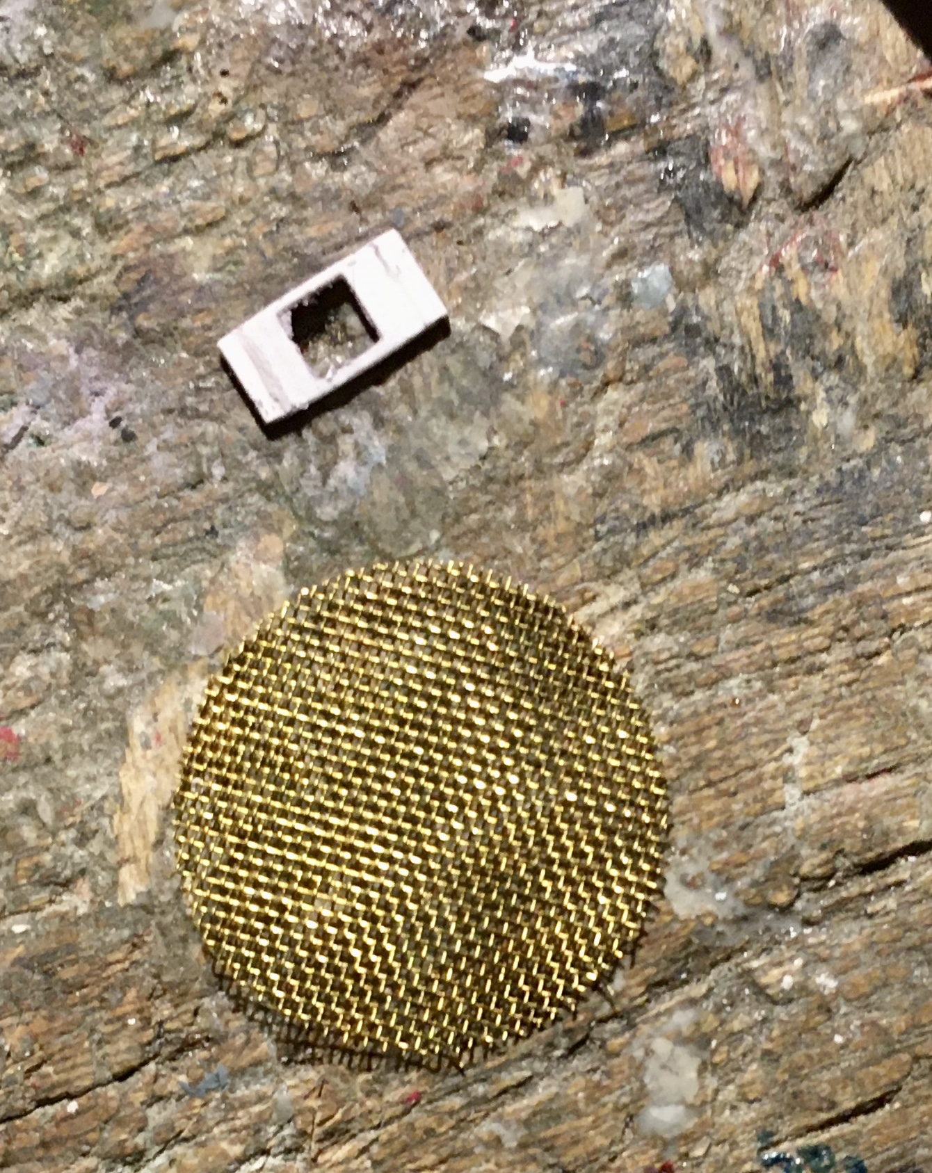

I had been hunting for my brass screens for sometime. Last night they were found.
So I did what any modeler does with screens for a pot pipe...............

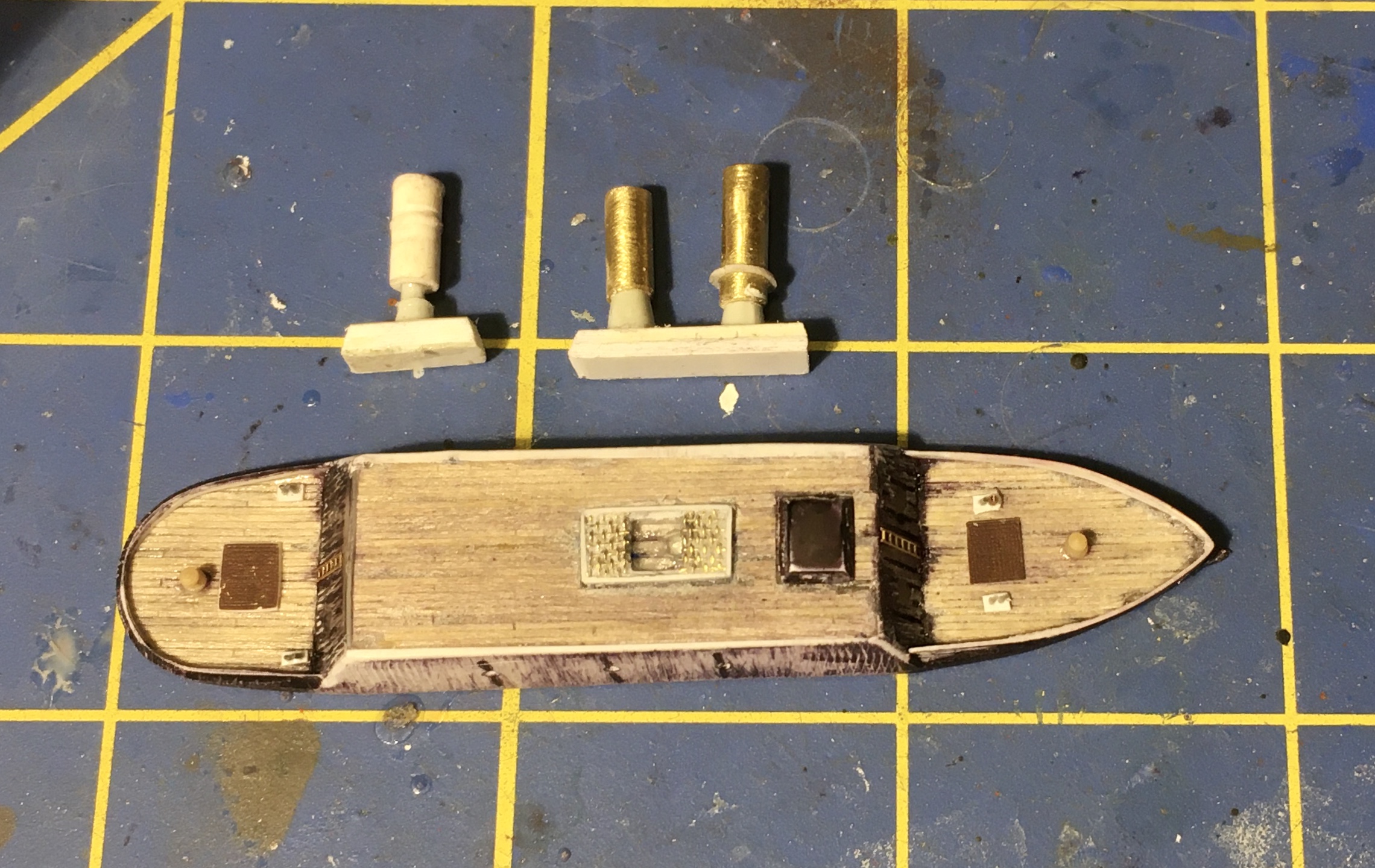

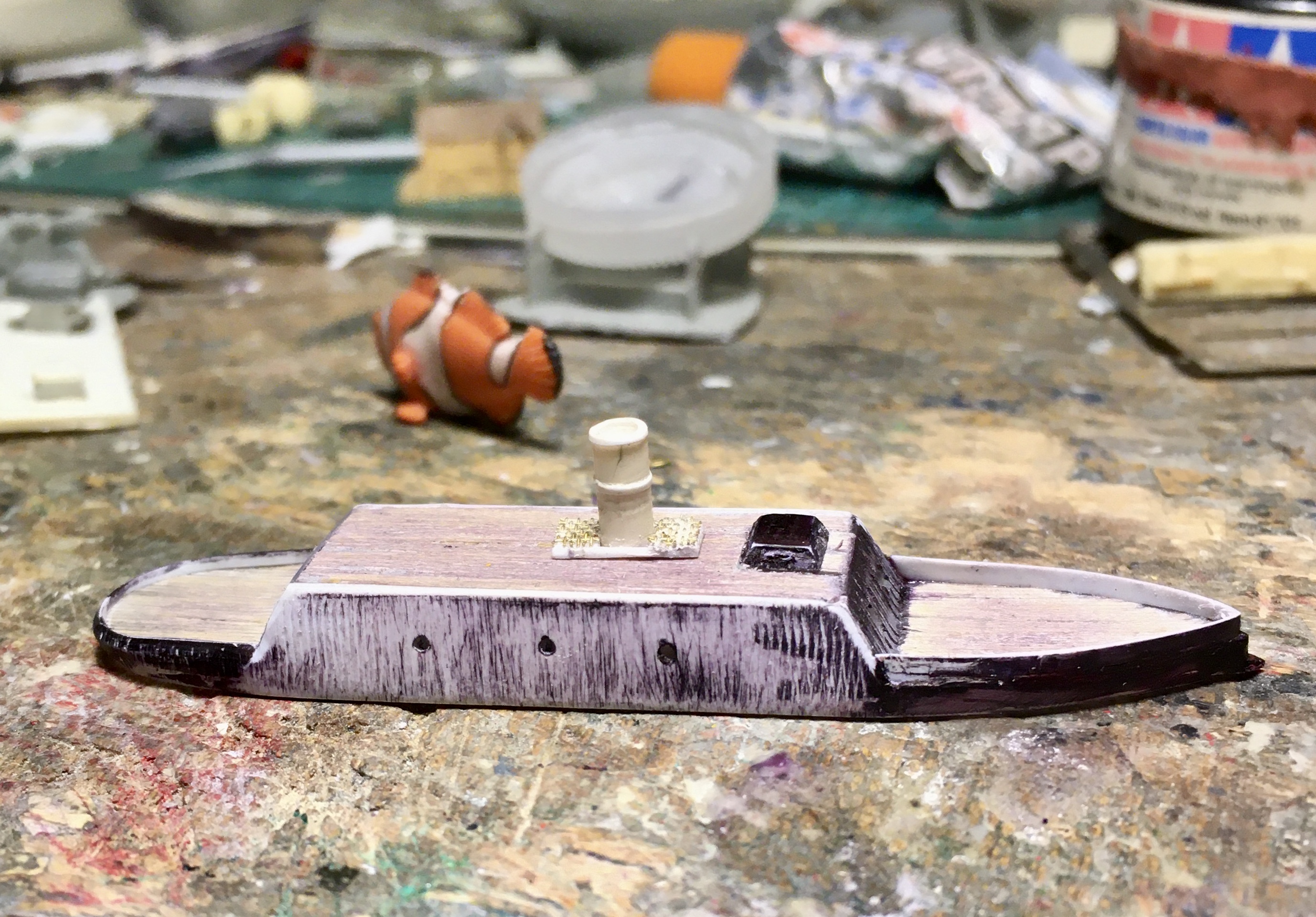

References disagree about how tall Arkansas' smoke stack was and it's configuration. Thisun heyer is a might higher with a spark deflector ona bottum. I also made a meduim tallness one from brass tube with no details at all. All three stacks will be included with the kit, so you can do whatcha wanna. I did box in the casemate vent as well. A more interesting if not more accurate feature of "The Terror of the Yazoo River".

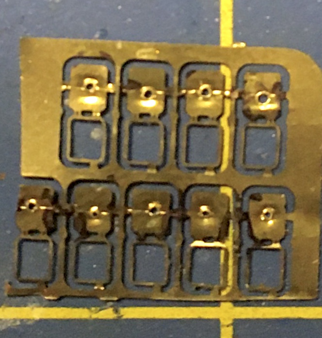

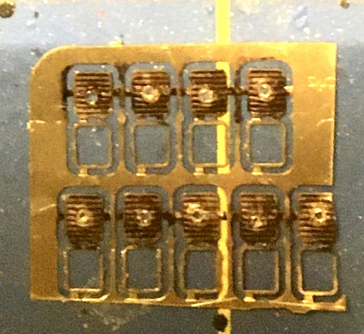

These hatches will be used for the gun port doors on the sides of CSS Arkansas. They opened out, hinged top & bottom. What?! You say CSS Arkansas side hatches didn't have that hokey relief on them? You must know your Ironclads, Suh!!
Of course there wasn't much of a texture to the iron-plate doors! Photoetched brass users know there isn't usually any surface texture on the BACK of their parts! Having drilled the holes in the doors, I'll just put them on upside down! See?!

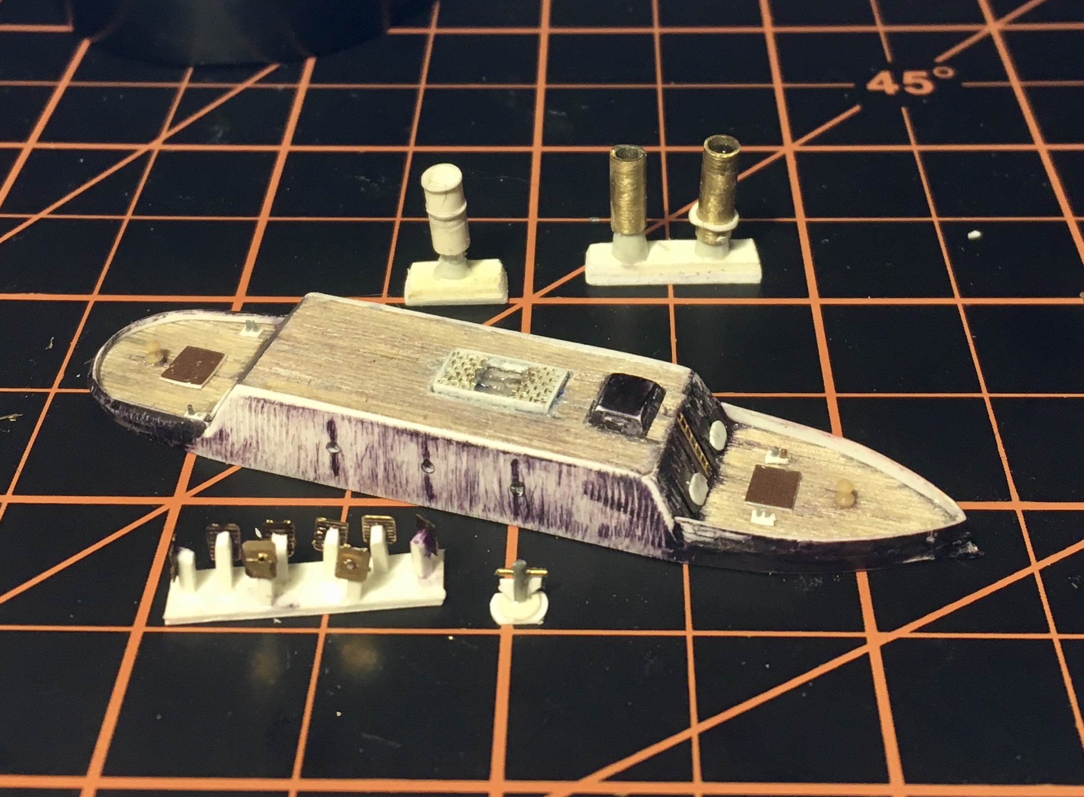

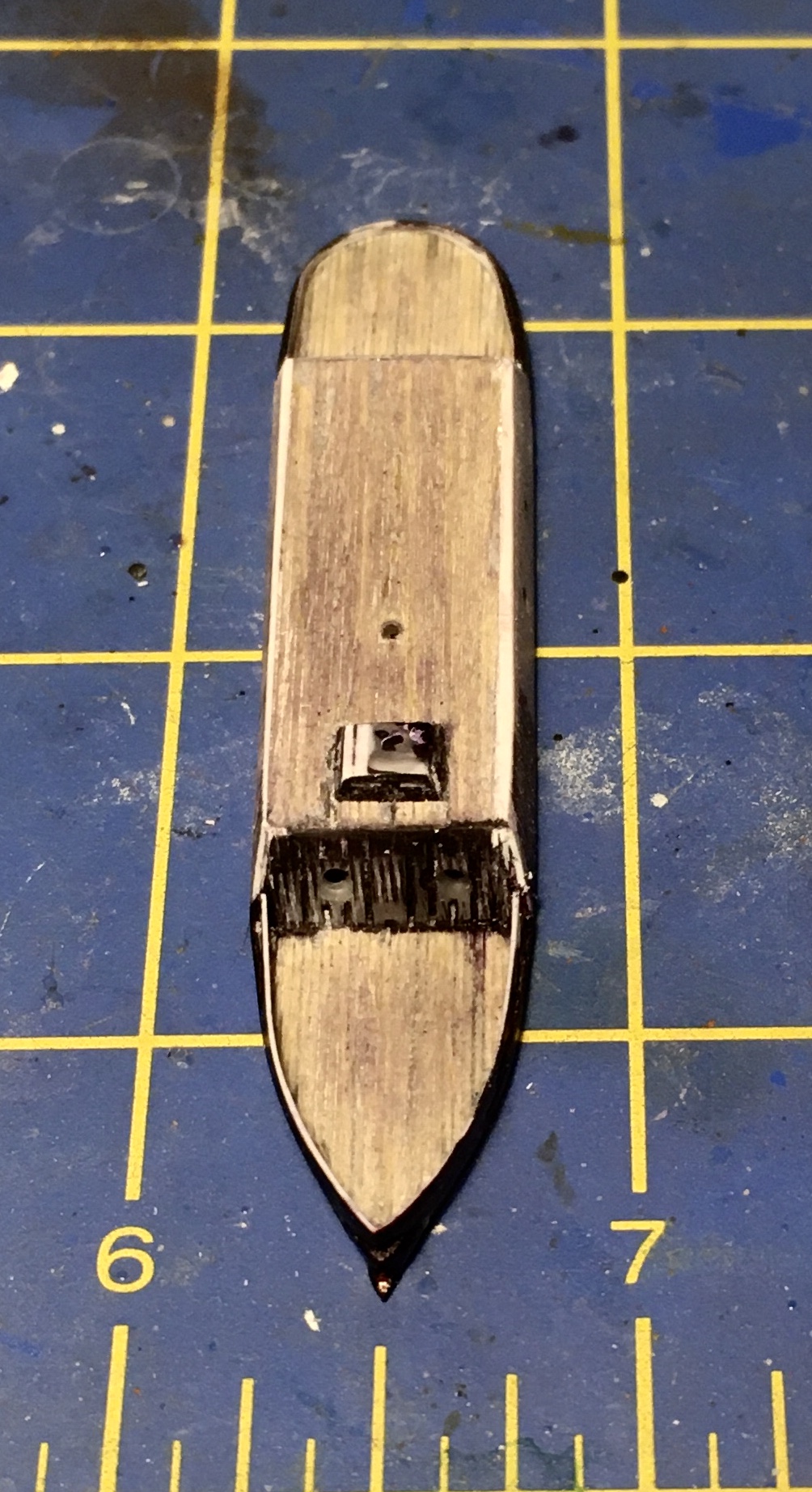

CSS Arkansas and I spent some quality time together. Most of her deck details are on. 3 optional smokestacks, depending on your preference, ready to mold. I carved out the casemate roof and added the vent as a detail on the main hull. I hate to add the gun port hatches on Her sides. She should be opened-out and ready for a fight!
I haven't made up my mind about the gun ports yet.
There was a T-shaped towing bitt on Arkansas' afterdeck. On a good day with both engines operating properly, running downhill, she might make 8 knots. This doesn't suggest a whole lot of towing capability.

Today is a red letter day! All the Mastered parts for CSS Arkansas are ready for mold!
I decided to mold & cast the gun port hatches to give a Confederate Navy modeler the choice of opening out, or securing from battle stations. I made fore and aft gun hatches and they are open, ready for action! Depending on where in her 129 day career you choose to depict CSS Arkansas, the towing bitt is a separate part, along with 3 smoke stack options. :blink
The detail parts are in a separate small mold along with anchors & ships boats.
