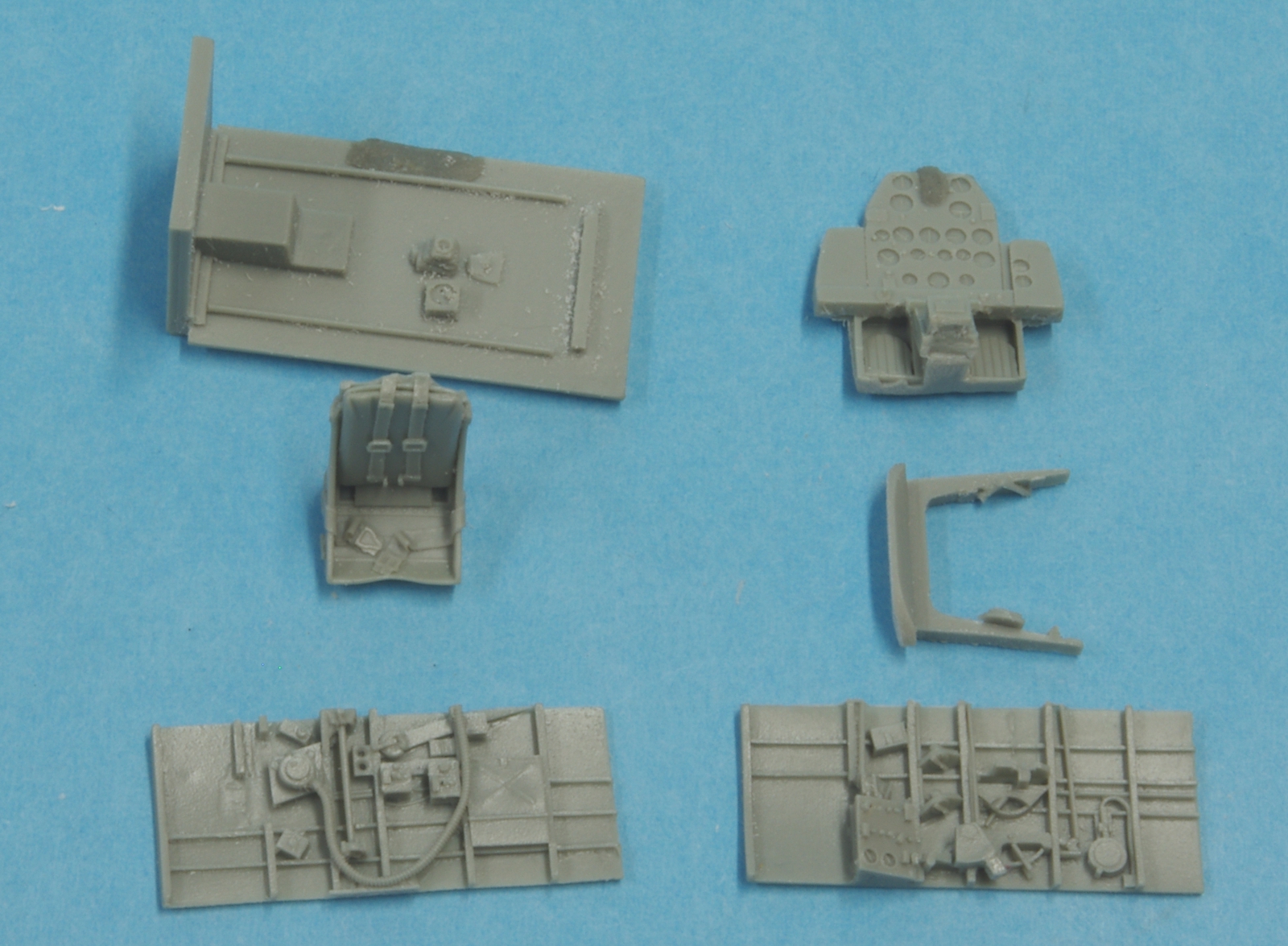

The True Details cockpit set to be used:

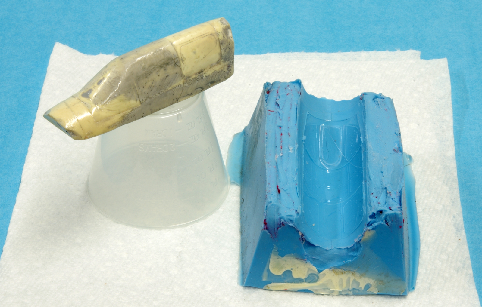

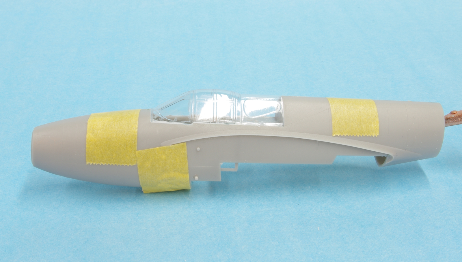

Here the kit canopy is white glued in place so a slicone rubber mold can be made of the shape, which will be sanded down to look like the earlier side opening affair.
The silicone mold. Plastic card and clay were used to make a dam for the mold. Silicone gets every detail. Too bad I had to sand it all away. On the left the reshaped and sealed canopy buck to be used for vac forming a new canopy.

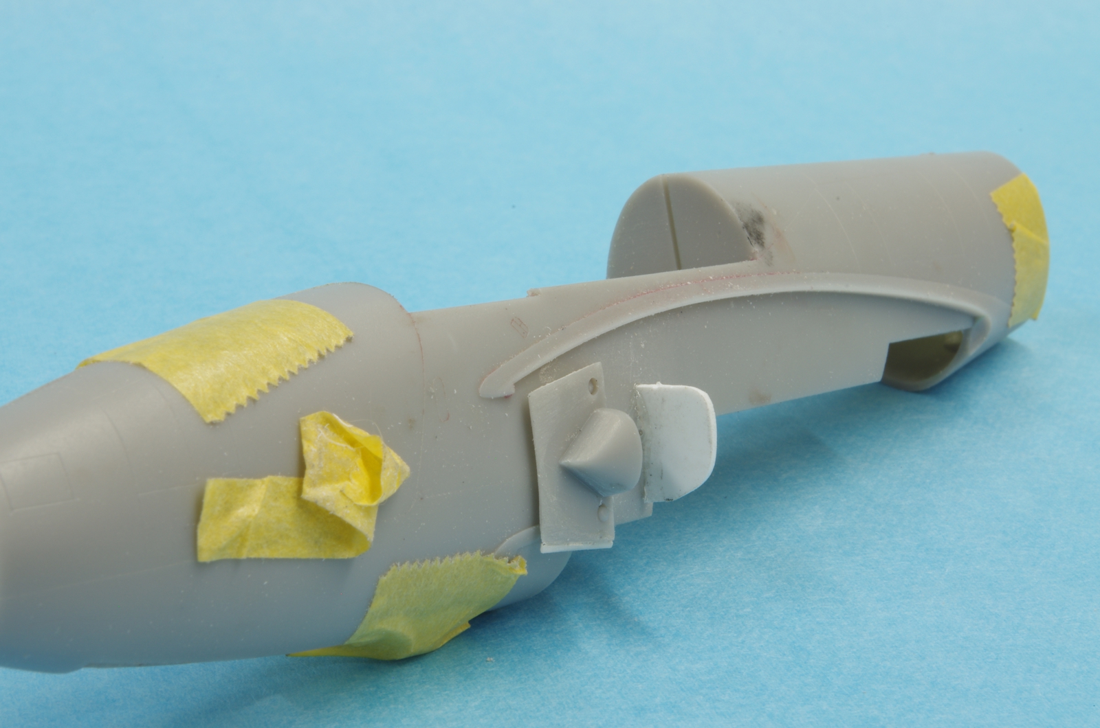

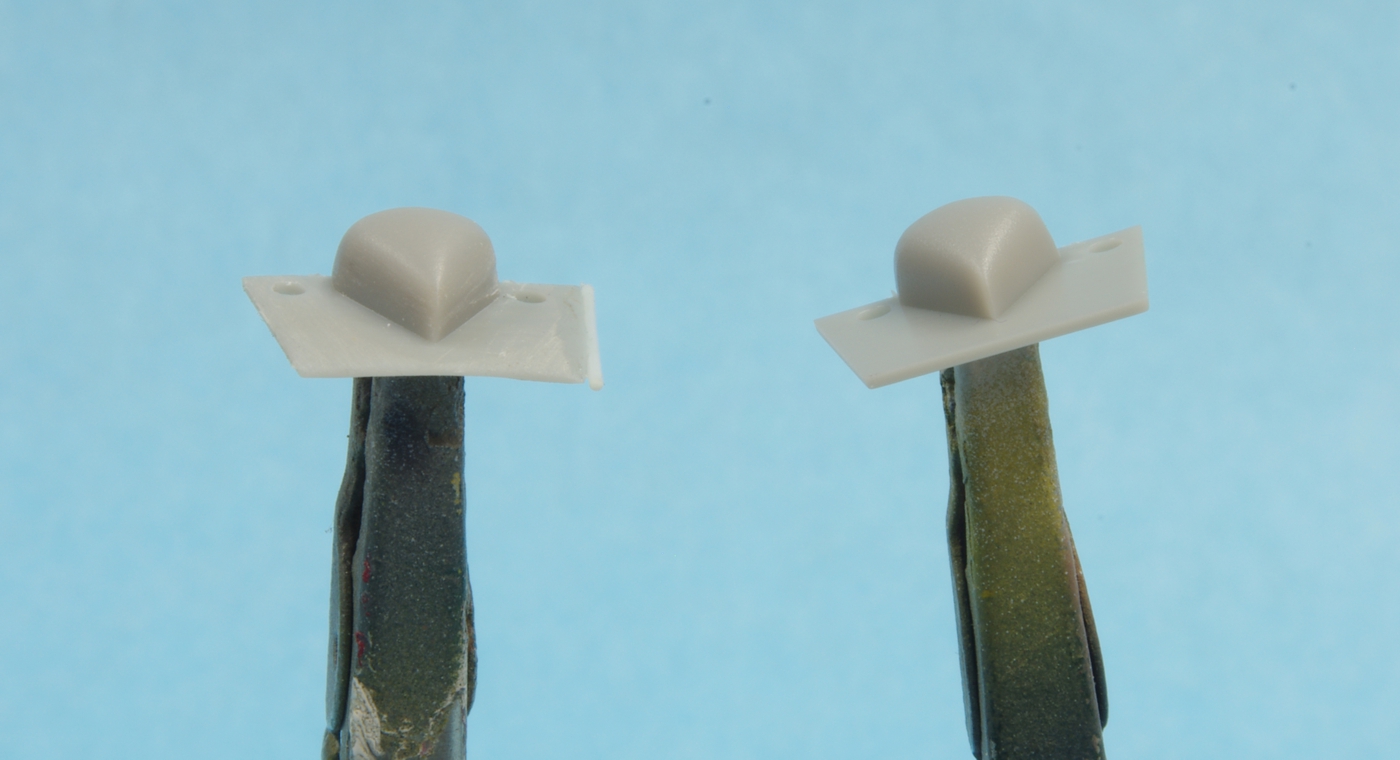

These are parts 14 and 18. They are shown installed in section 4 of the instructions. No reference is made to when they are installed. They disappear in section 5. 14 is the left splitter plate and inlet fairing, and 18 is the right.. I thinned the splitter plates quite a bit and added some plastic sheet on the bottom so they would match the inlet better. In this photo only the one on the left has the changes.

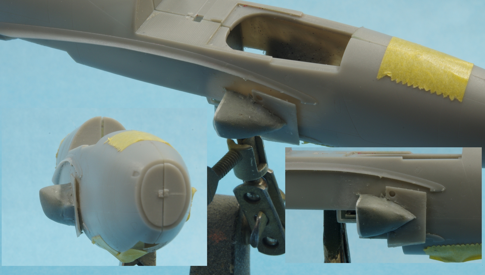

A plate was made to fit behind the splitter plate which will form the aft end of an enlarged inlet fairing. Photos in Steve Ginter's book on the P-59 were used as reference for this.
Aves Epoxysculpt was used to form the enlarged and reshaped engine inlet fairings. A little cleanup still required.

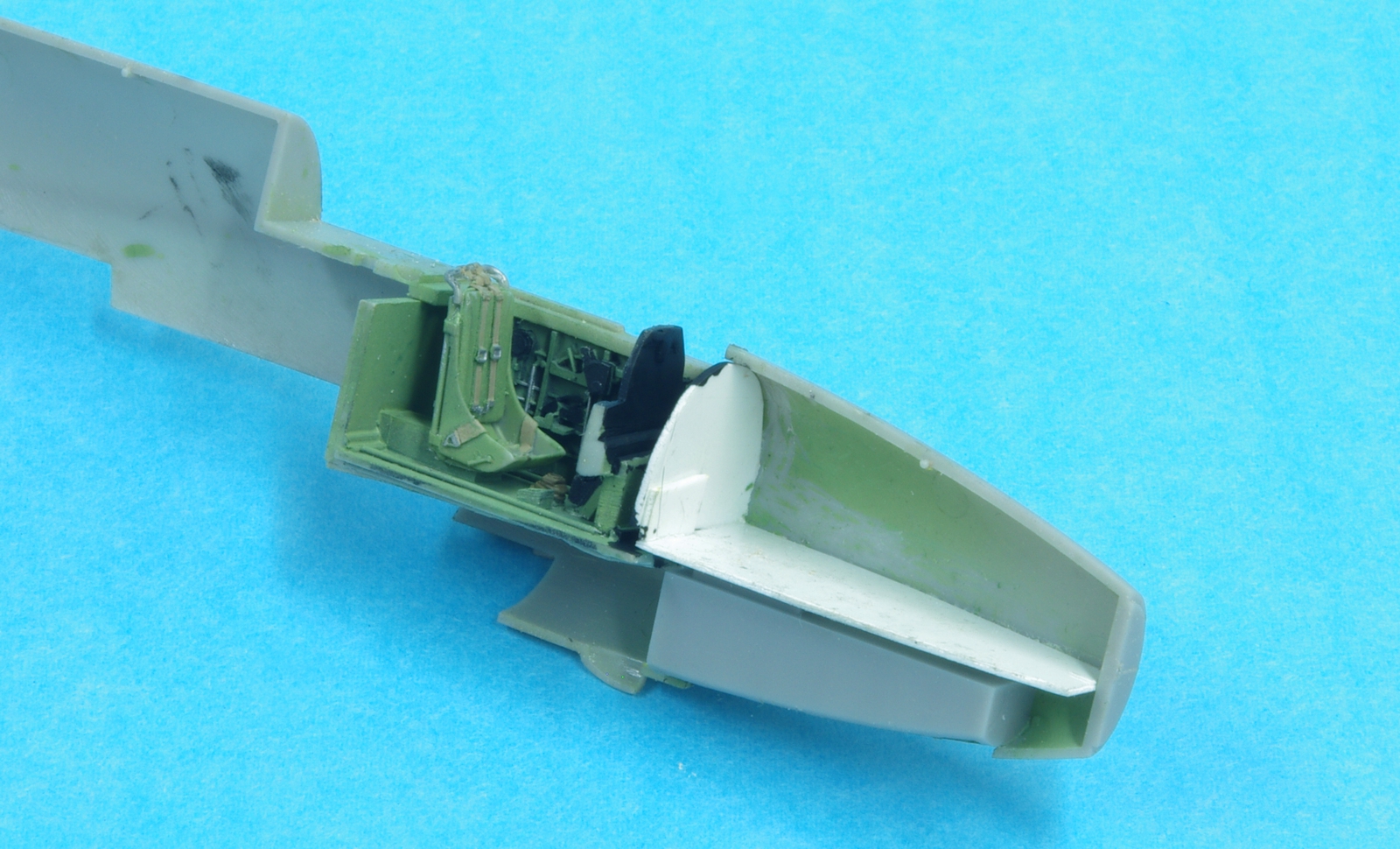

A plastic card shelf was made to form a cavity for a cast nose weight. This photo also shows some of the left cockpit which has been installed and painted using the Black Box set. 34227 was used for the cockpit base color, over black preshading.

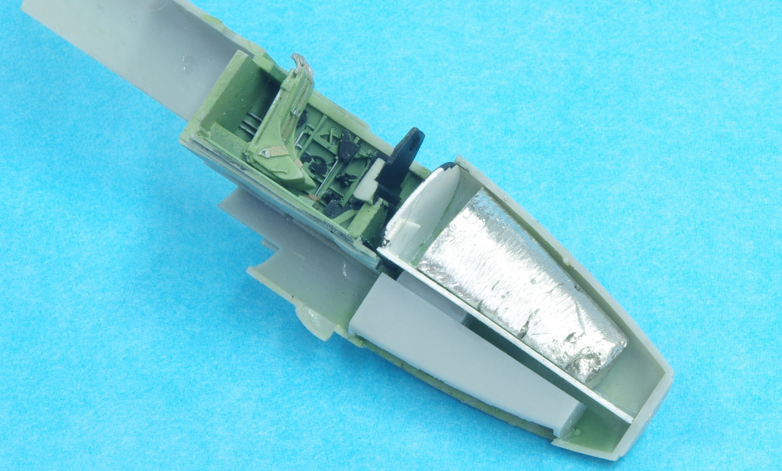

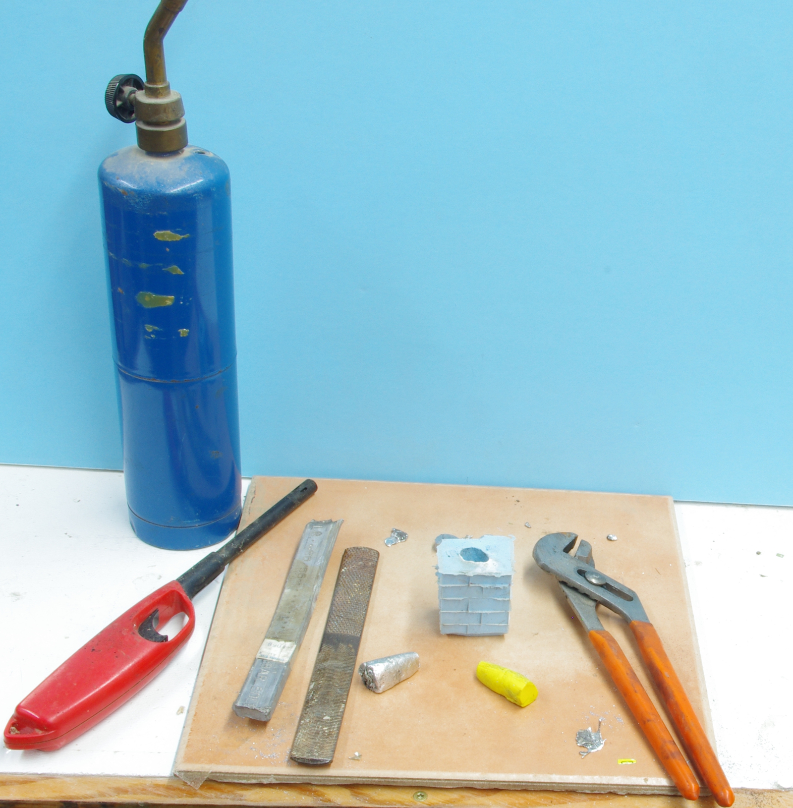

A clay buck was formed by pressing it into the left nose area, shaped some on the right and then the right fuselage half was pressed on to get a workable shape. A form was made with Lego blocks on a plastic base and the buck was stuck in the center. Silicone mold material was poured into the mold. Once cured, lead was melted into the mold from the bar shown using the propane torch. Some filing and sanding was needed to get it to fit but not bad. A second weight was cast as I intend to build a P-59B version later.

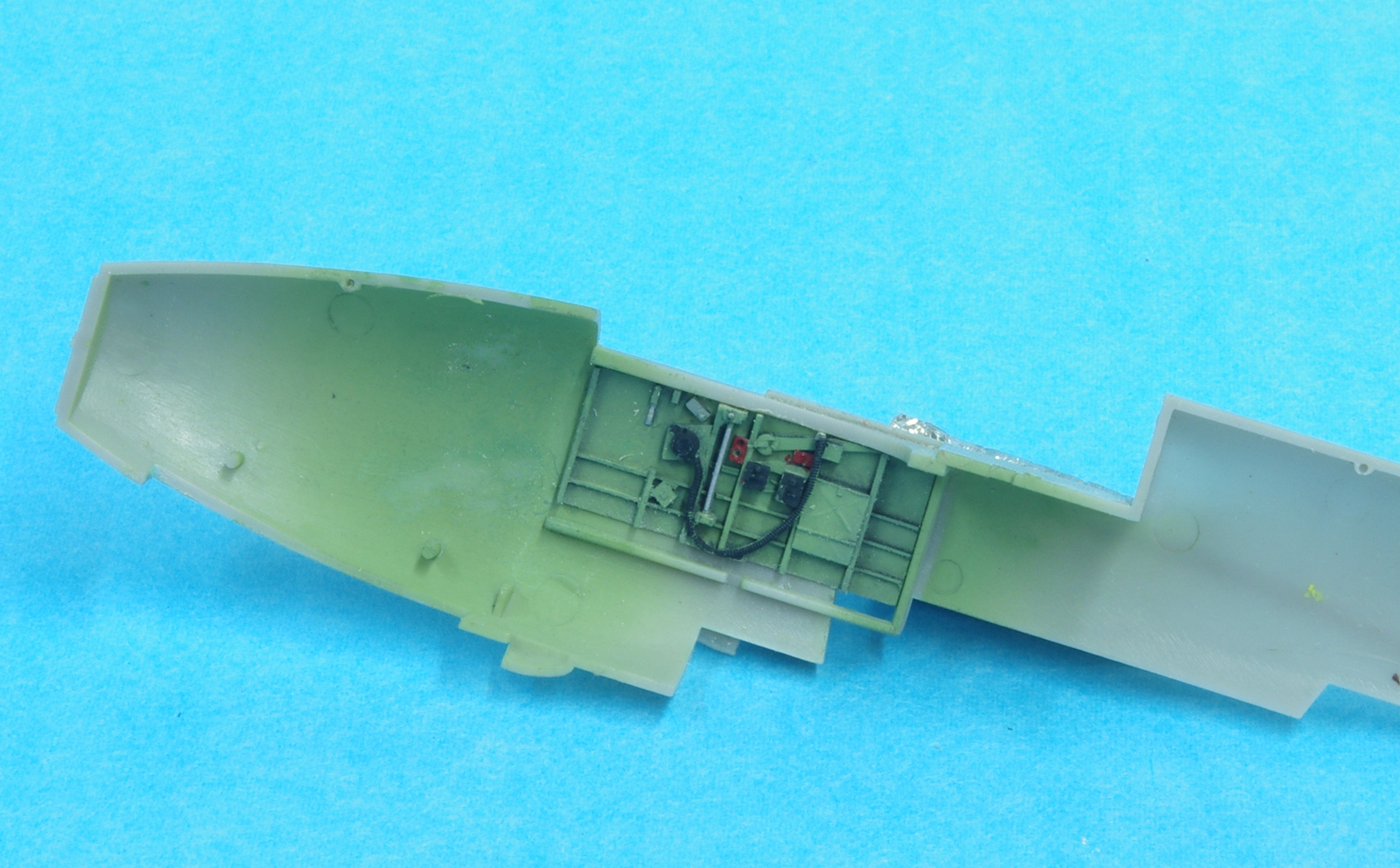

The right cockpit sidewall.
The finished weight. I don't think this one will be a tailsitter.
