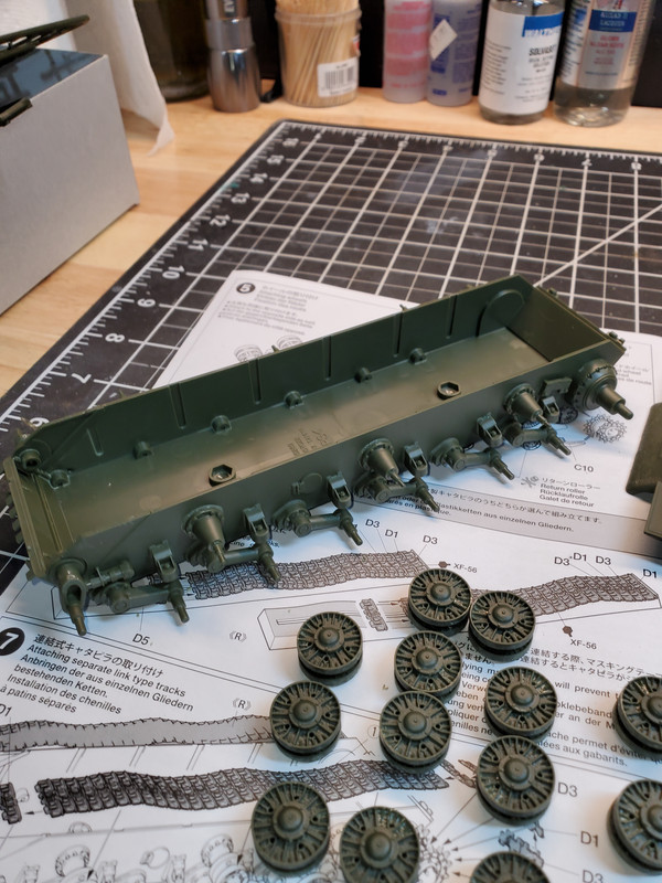

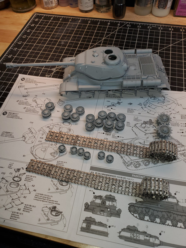

So far no just a little cleanup on the outside on some of them.Looks good, any drilling required?
So far they are holding up to being manipulated,we'll see after painting and weathering,still got plenty of Fruil wire on hand.Resin pins sound like a pretty delicate track assembly, unless something else adds some strength.

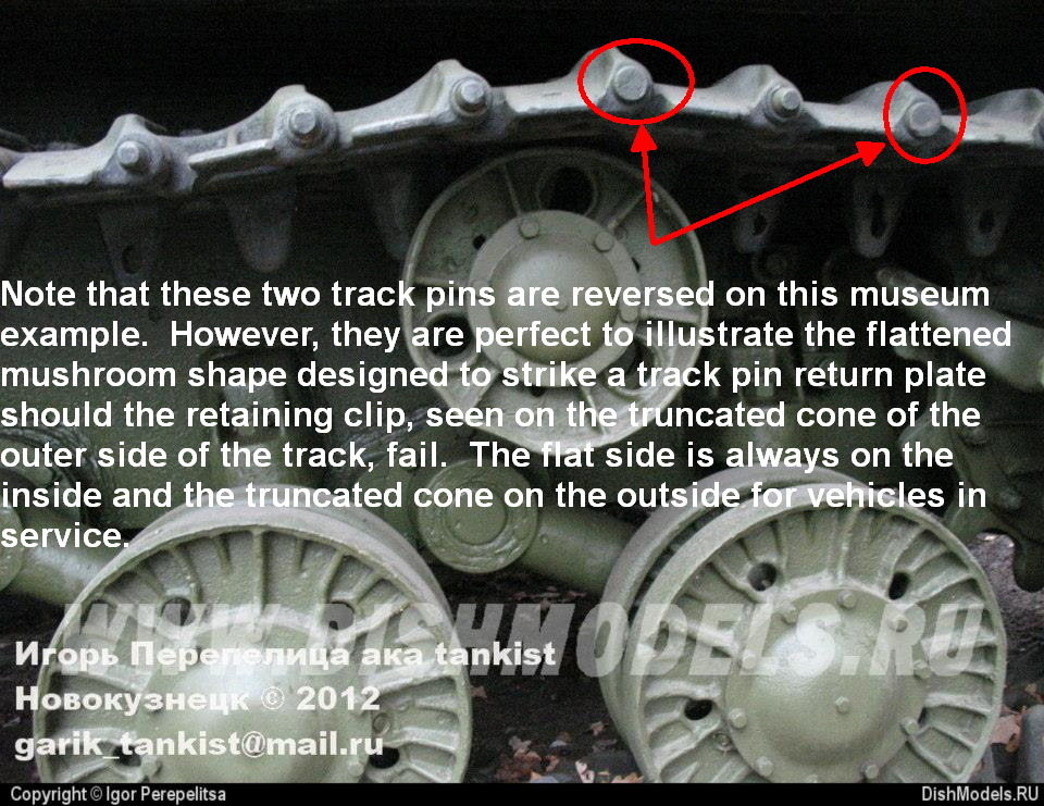

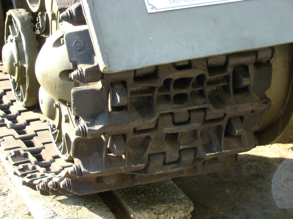

MasterClub tries to make their tracks as accurate as possible. Look closely at the resin pins and note their shape. If their shapes are like these photos, you'll be downgrading by using push pins.I know some guys have been using sewing pins (cut down) as replacements for the resin pins.
So far so good,I needed my optivisor and some good tweezers,but I got a side and 3/4 done,they are molded well and didn't need any drilling, just a little flash on a few.They give you plenty of pins to make up for the ones you break, but the more you do,you get the feel and it goes smoother.I actually have this kit and will be looking for some tracks so watching to see how yours work out
