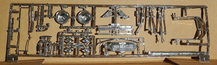

struggling to remove chrome.
paddy
Well i have tried oven cleaner and bleach as well as brake fluid on my Bentley chrome parts and not had a lot of success.?
Its not like the usual thin coating on polished alloy, this is thick Chrome...

Been going through he cupboard and found some "spirits of salts" that etched the stainless steel bowl but didn't touch the chrome. Of course its not usually chrome but a polished alloy coating however i have never come across anything as tough as this Airfix stuff...t

No sorry. Household bleach was the best but its patchy, some striped off in 24 hours, other areas were not touched in 5 days.
Interesting that under the chrome the plastic was copper plated first.

Most of the models i build dont have chrome but i remember Tamiya motorcycle chrome was very easy to shift. This new airfix chrome seems totally different. the fact there seems to be copper or brass under it makes me think its real chrome. I am still experimenting because unless i can get it off large areas like the radiator my Bently build is going to hit a problem.
