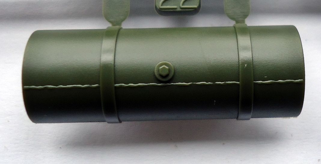

Over the years,I have built some Soviet W.W.2 era armor. I was looking through the Tamiya ISU-152 kit earlier today.
I saw this weld bead on the fuel tank.
Seeing that is a first for me,as far as seeing that on any kind of model. That is 1/35. I am curious if it is worth it
to try to add weld beads to 1/48 Soviet fuel tanks. :hmmm This weld bead is less than 1mm,to my eyes anyway.
I don't think it's worth the trubble, and the one in 1/35 looks a little bit big to, see the following link.

you can hardly see the weld in scale 1/1, not sure how thick plates there were in the tanks but the welds would be pretty much flat with the surface.
just my opinion :)

Hi Zod,
I would go for as small scratch with a scriber or knife in 1/48.
A wash will show it.
And Bagge is right, 1/35 ones are sometimes overdone.
Succes, Willem

Thanks Willem. I do know the dents in 1/35 fuel tanks are way overdone. :)
Take a look at these...
Top shot is a T-34/85 , bottom is the JS-3 both at Aberdeen Proving Grounds.
Both welds are different, T-34 heavier and not as neat as the JS.
The tanks on my T-34 are brass tube with sprue welds glued on.
1/48th......go for the scribe and wash.
Mike B)
Thanks guys,
They were easy enough to do.
1. Scribe line on tank.
2. Glue stretched sprue weld on line with C/A.
3. After it dry, lightly sand the bead to break through the C/A.
4. Brush on a coat of liquid cement to melt the plastic.
5. Add desired texture.
That T-34 is an old build and all welds were done the same way.
You could do the same thing in 1/48th just use finer sprue.
From the surviving examples out there it seems that after the war the welding became more neatly done.
Mike B)
Sounds simple enough Mike,thanks. :v
