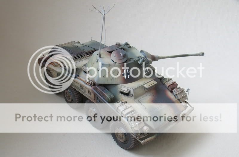

Right, this kitty is DONE. Hope you like it :)
Chris
I do not know how I missed this one . This is very nice , I am a big fan of the 234 series.
I really love your camo scheme . Do you intend to put it in a diorama ? Maybe with one of your other projects driving by ? I would love to see a figure with it to give some scale perspective .

Jenny, yes I have a vague idea for a dio for this one. The scheme is listed on the instructions as 'Normandy' so I'm thinking of having this abandoned in a ditch by a road with a british tank rolling past (I have a couple of candidates in mind) and maybe a 'keep out, this may be boobytrapped' sign on it
I'm not so hot on doing ground work though :blush: , so I'm waiting for those skills to develop a bit before I do it.
