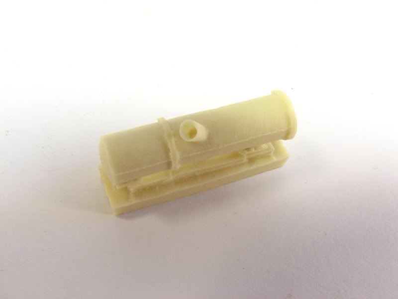

Here we have our victim for this afternoon. Mig Productions resin Panzer IV exhaust.
As always a little priming with Mr. Surfacer.

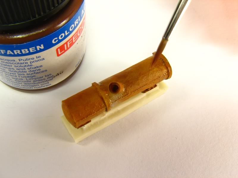

I used the Lifecolor "Rust&Dust" set, but any other acrylic paint in a similar shade will do also. I started with an orange shade.

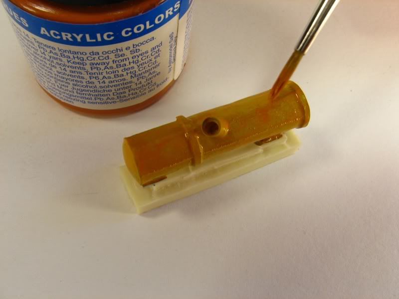

We apply the colour "wet in wet" so to speak. The second layer is a more reddish tone.
A more brownish tone will be next.

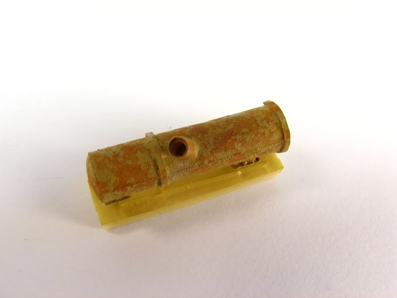

Then we apply the colour of the base coat of this model. In this case we assume that our Panzer IV was painted in darkyellow.

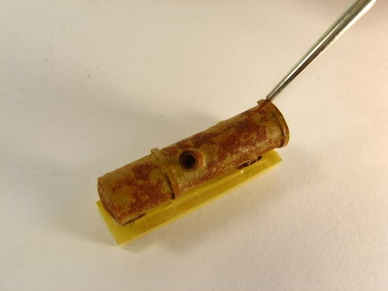

Then we remove the dark yellow paint in some areas again. This technique has been discussed before, so I am not going to bore you with that.

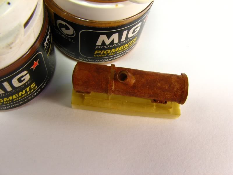

Finally a little more soot and we are almost done.
A few more touch ups here and there and we are done.
What we have now are multible layers and shades of rust. There is remaing paint and paint that appears to be pealing off. There are many other ways to finish exhaust, and this is just one example which worked for me (fast).
