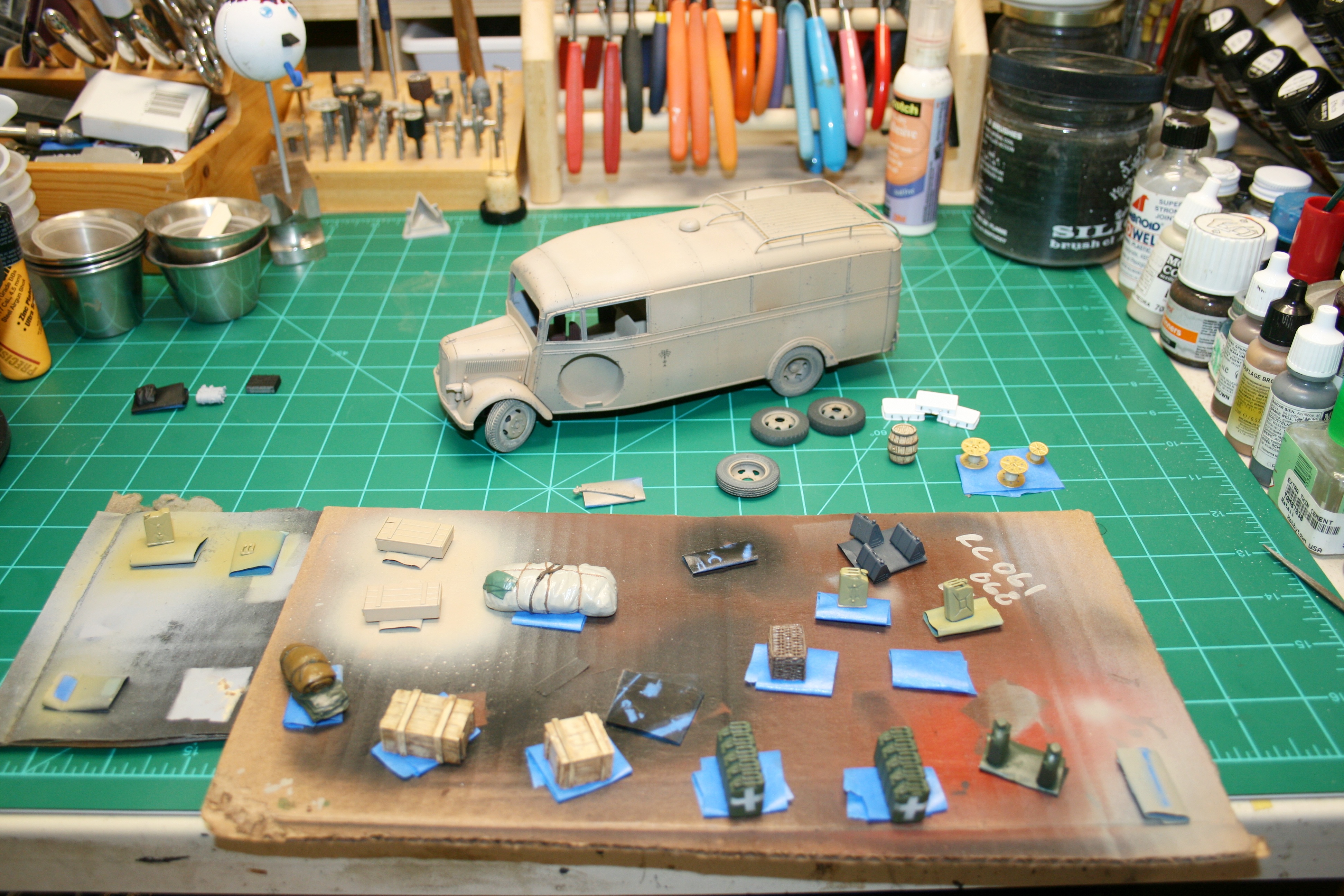

As I had said, there's not been much time at the bench, but progress has been made. I decided to paint up a load of stowage, knowing I will likely overdo it, but better too much than not enough. Here's what's going on.

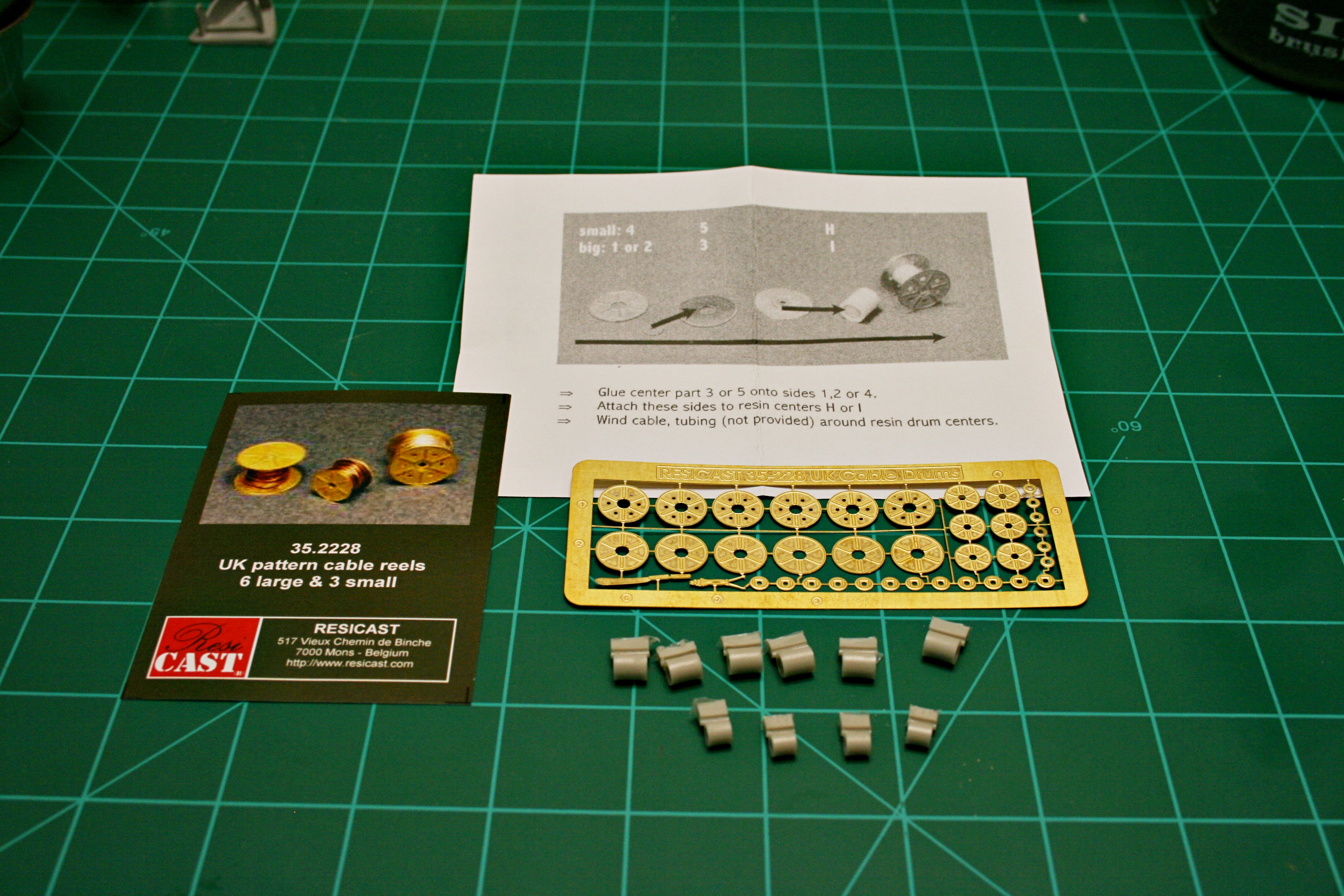

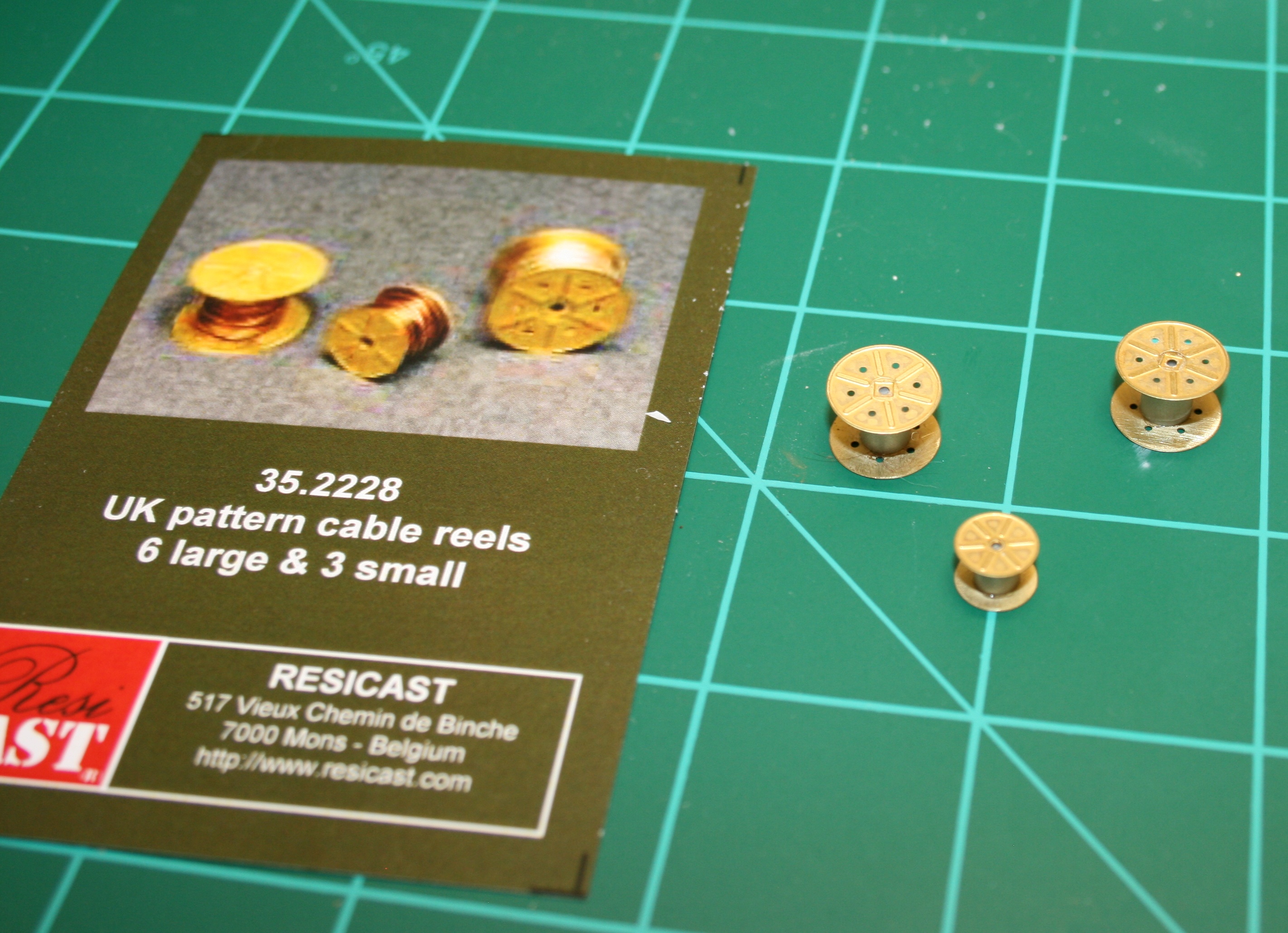

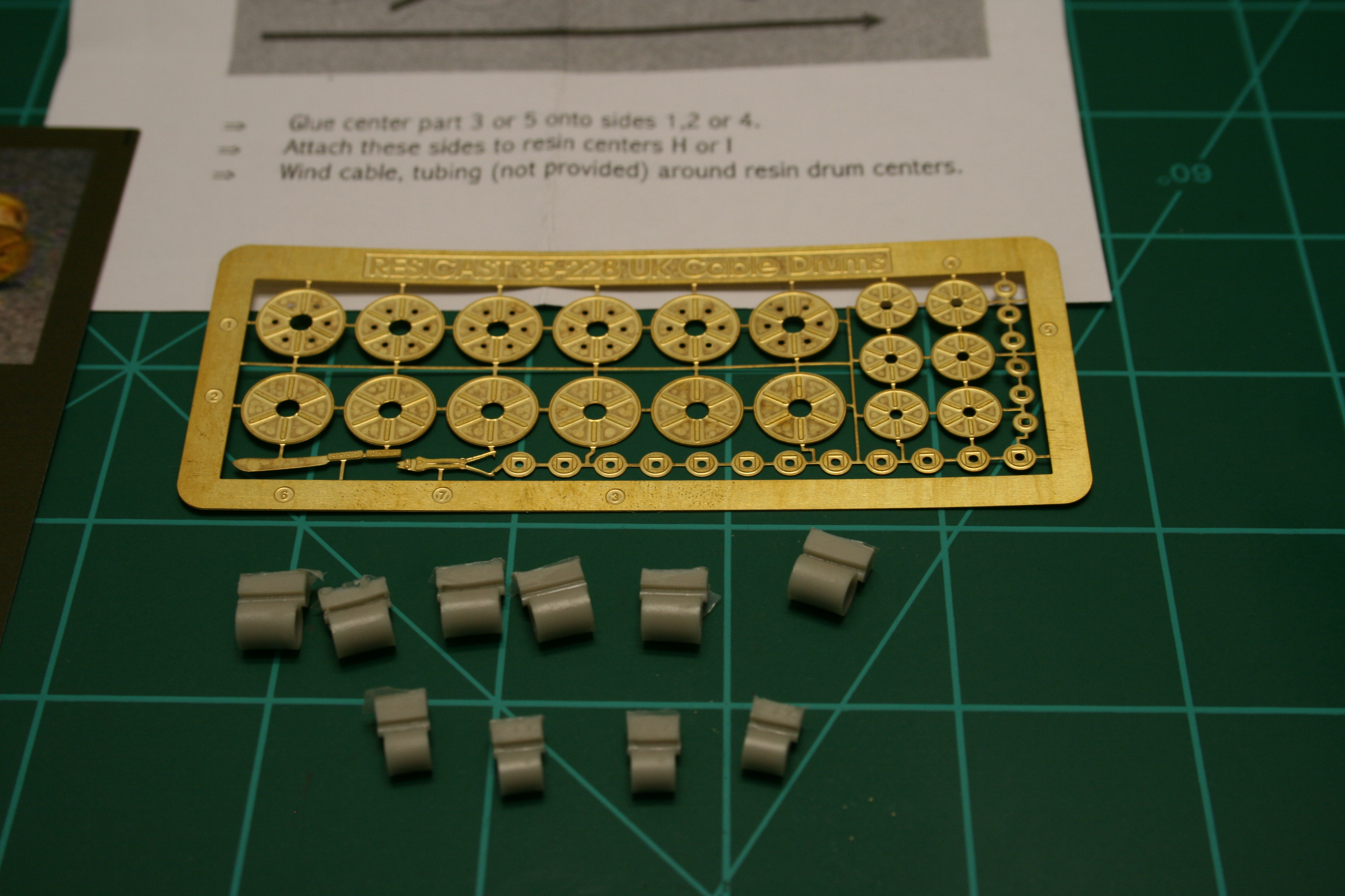

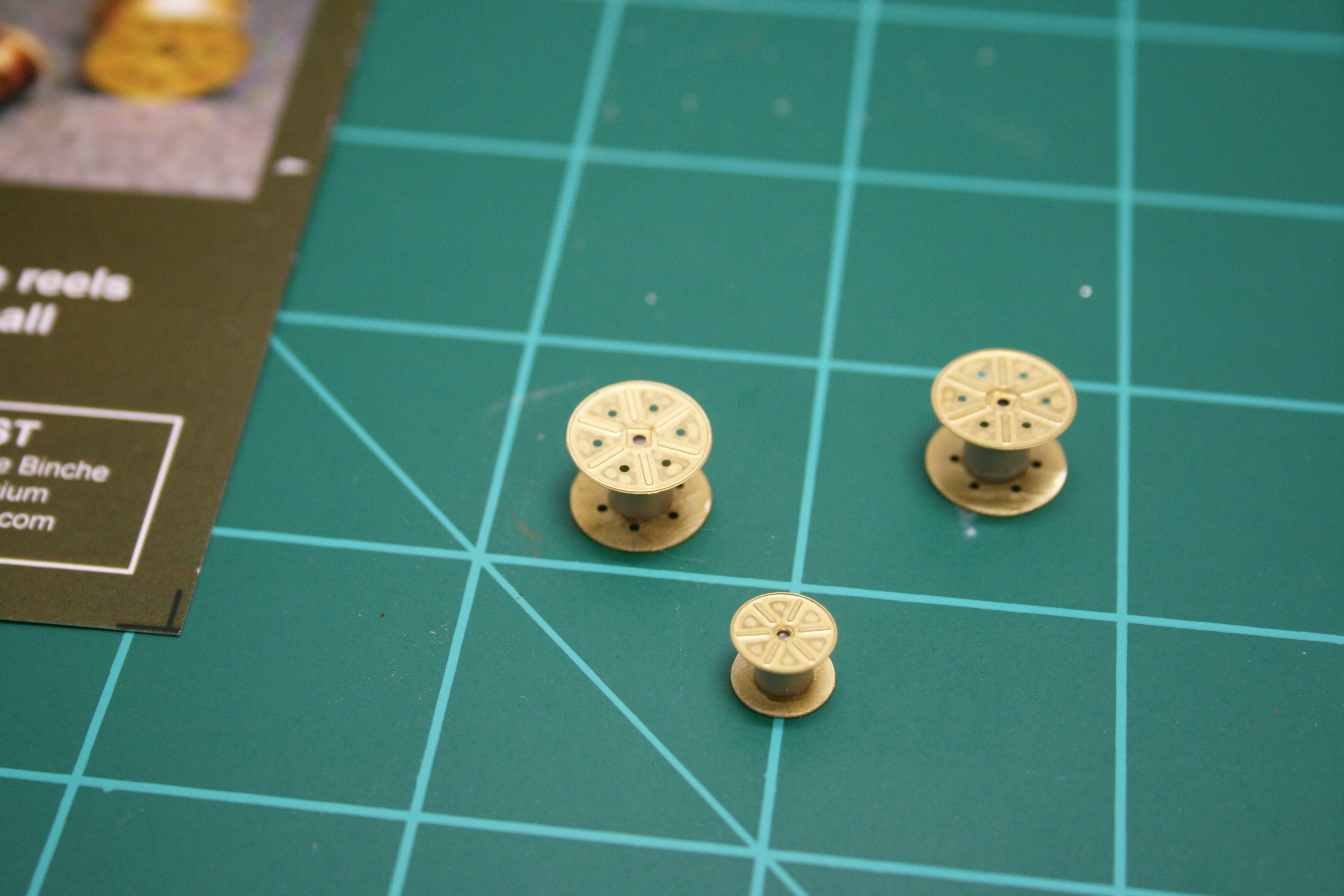

I found this cool PE set, yes, I know it's not a German spool, but play along.
The set builds up easily and looks great.

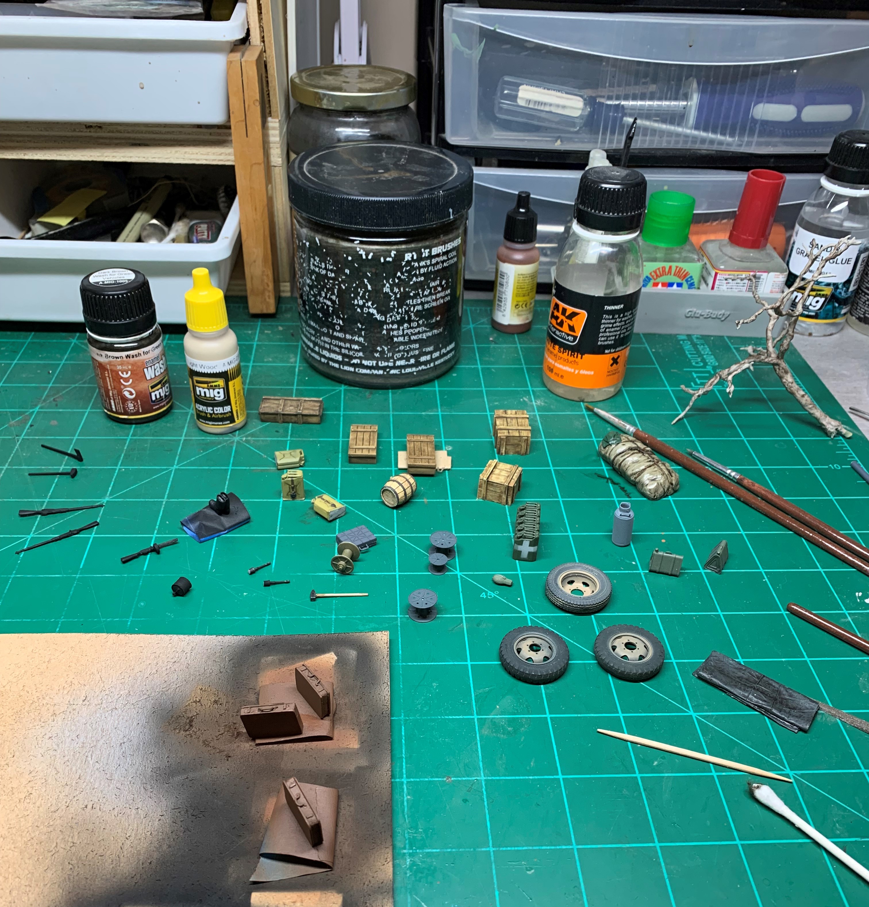

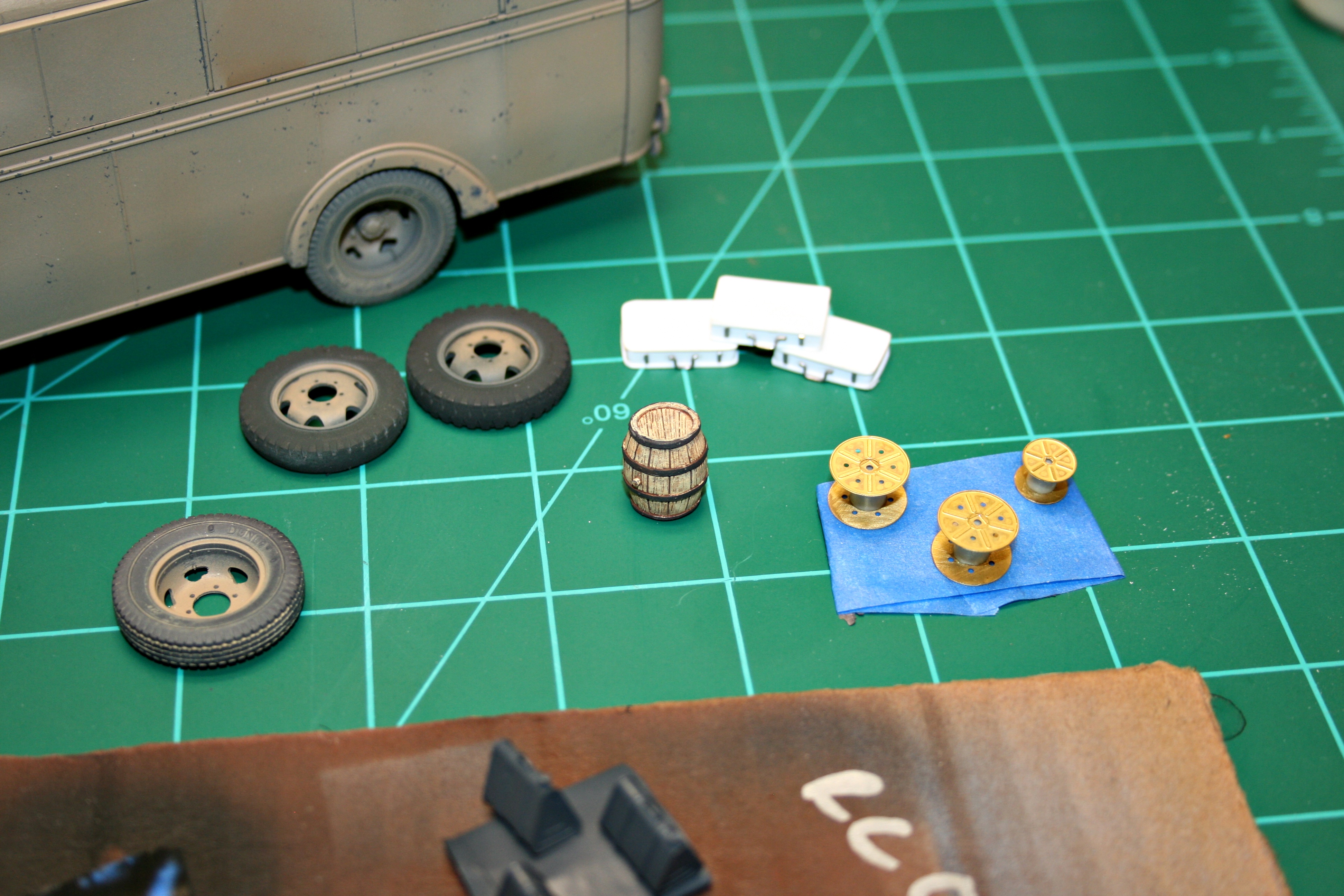

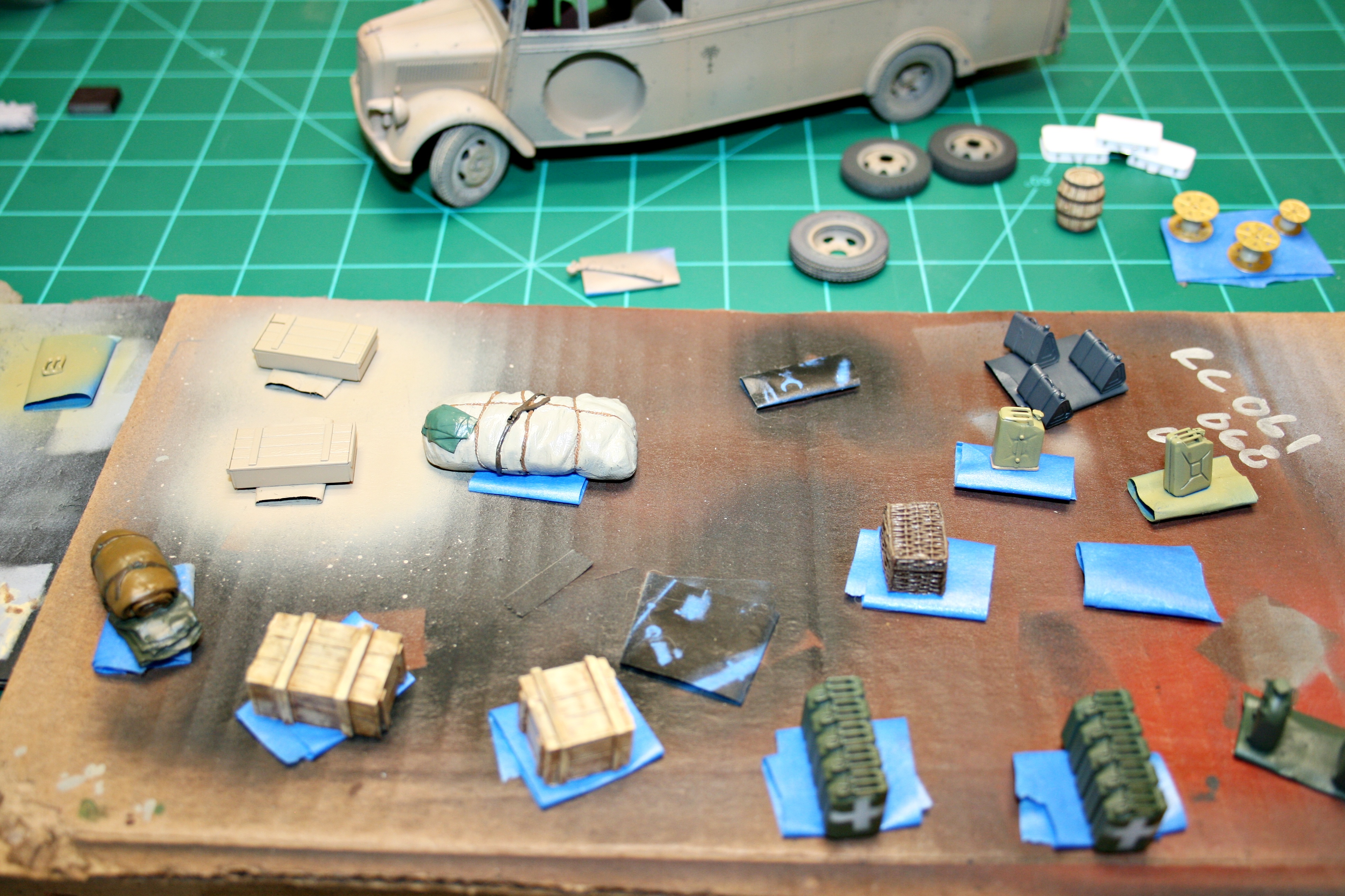

I have acquired a lot of stowage items over the years and have painted up what I thought a crew would want in North Africa.

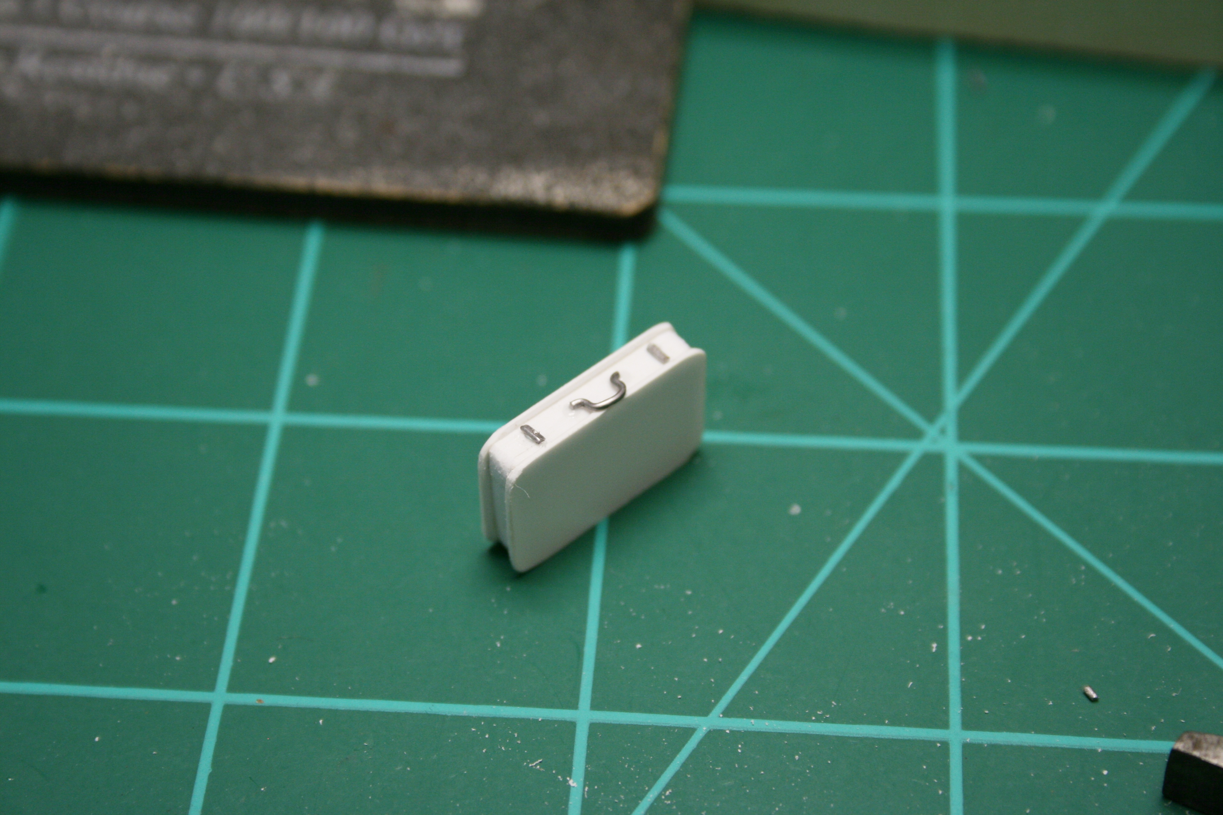

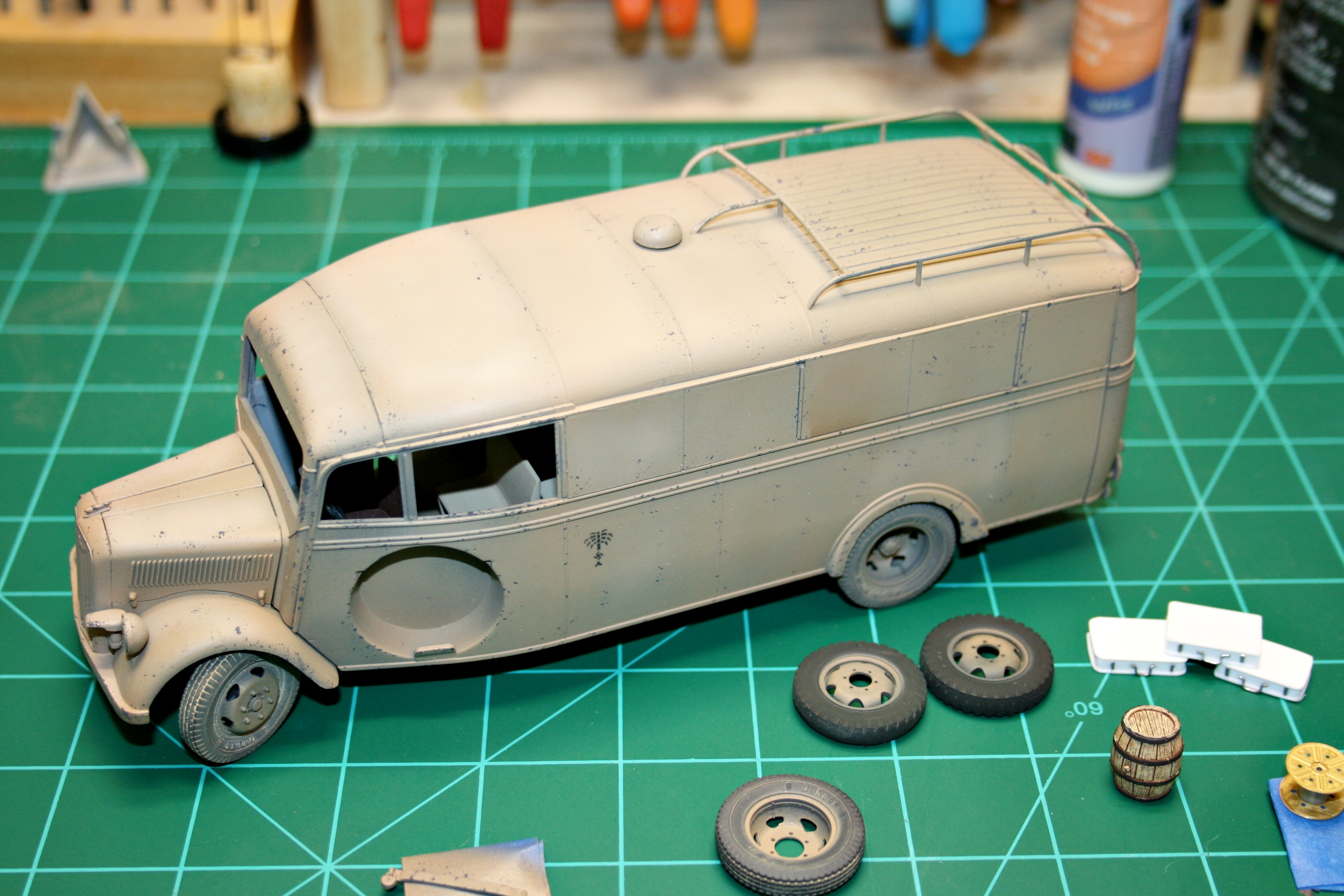

I started chipping the bus with a sponge and some of the gray base color. There's more to come on that, I'm just getting started. I started fiddling with some suitcases, not happy with the handle yet, pretty crude right now.
I'll mess with it next weekend, I have an idea to try.
Thanks for coming by, there's lots more to come.

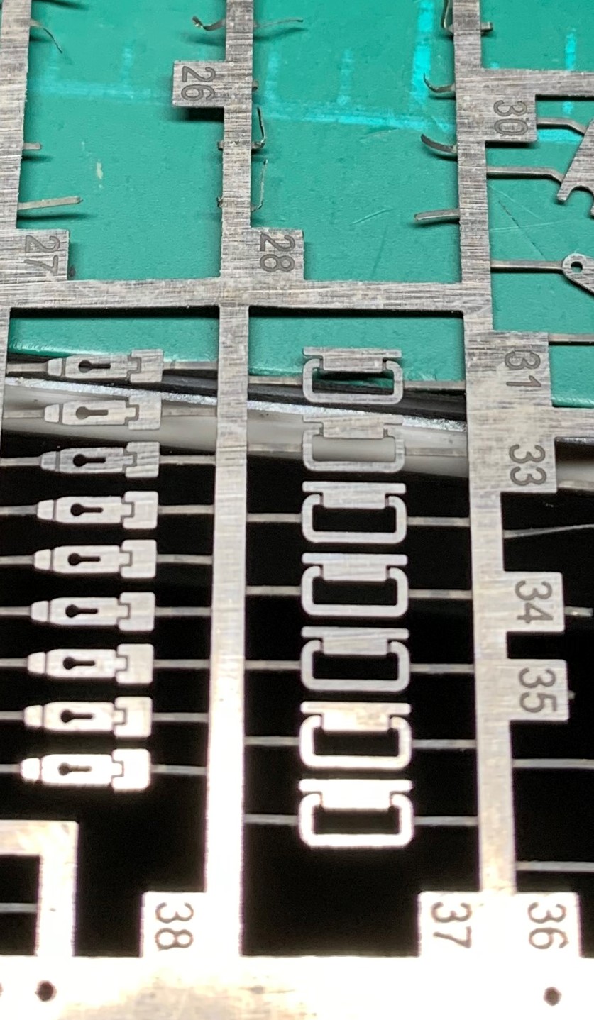

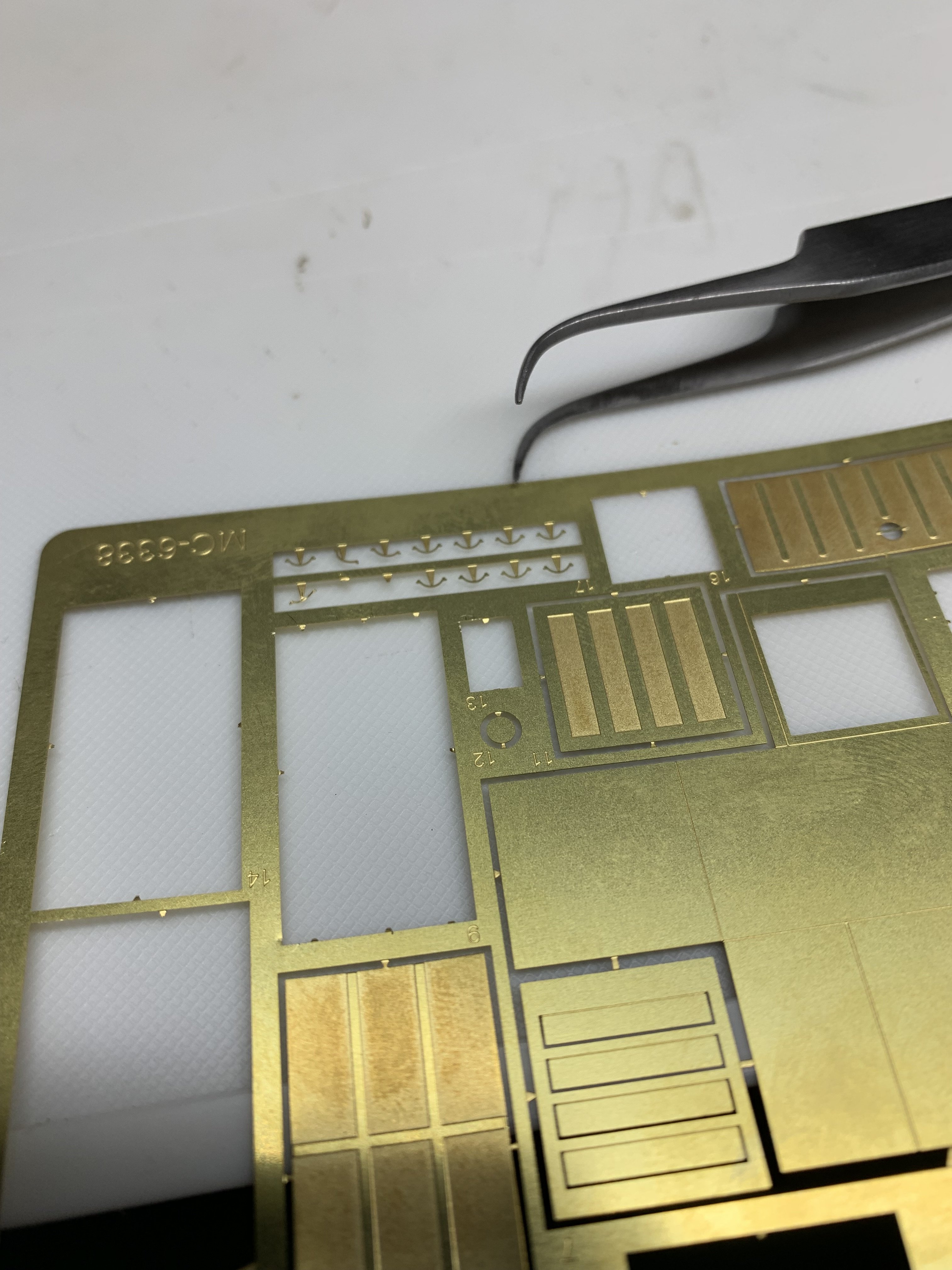

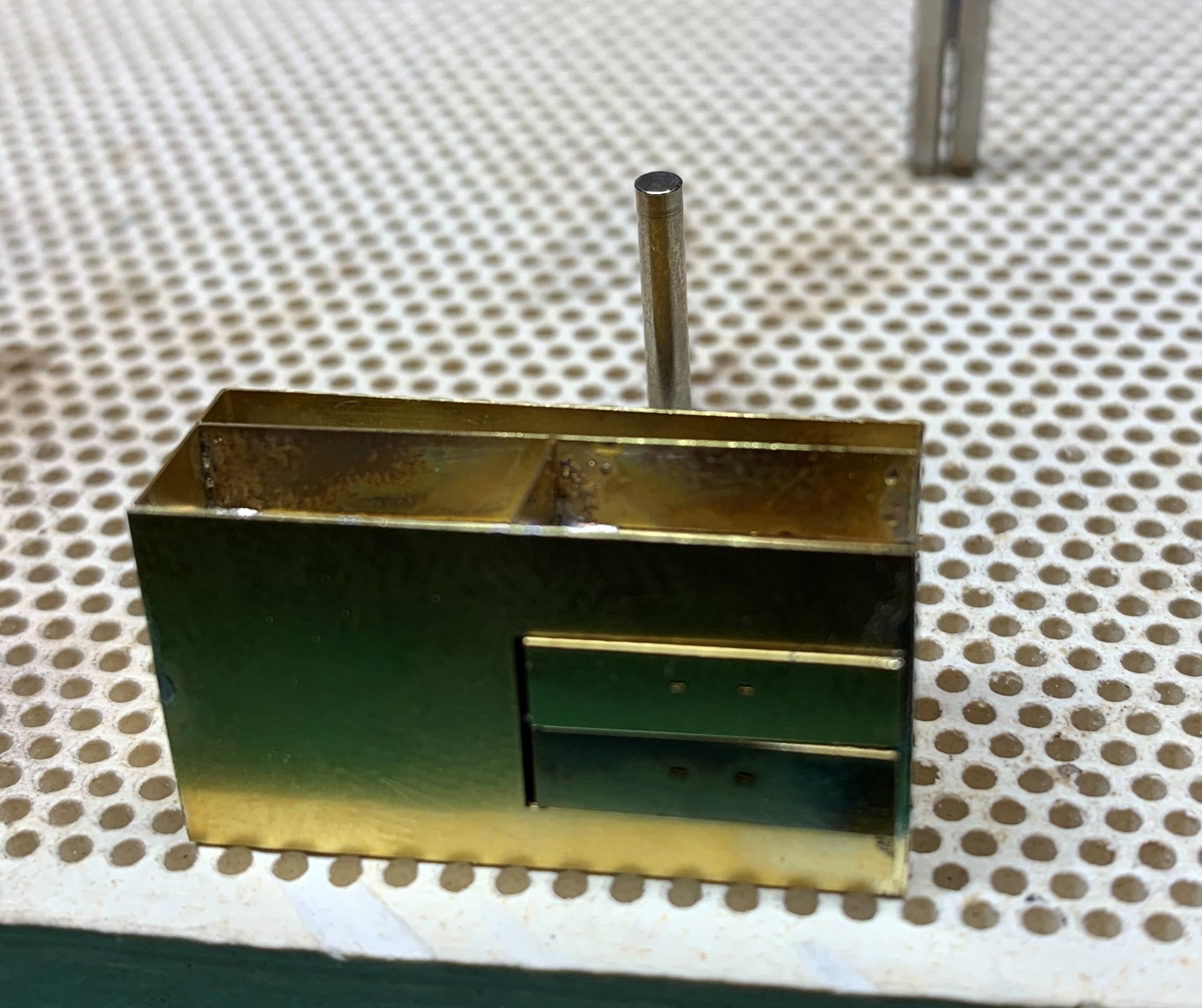

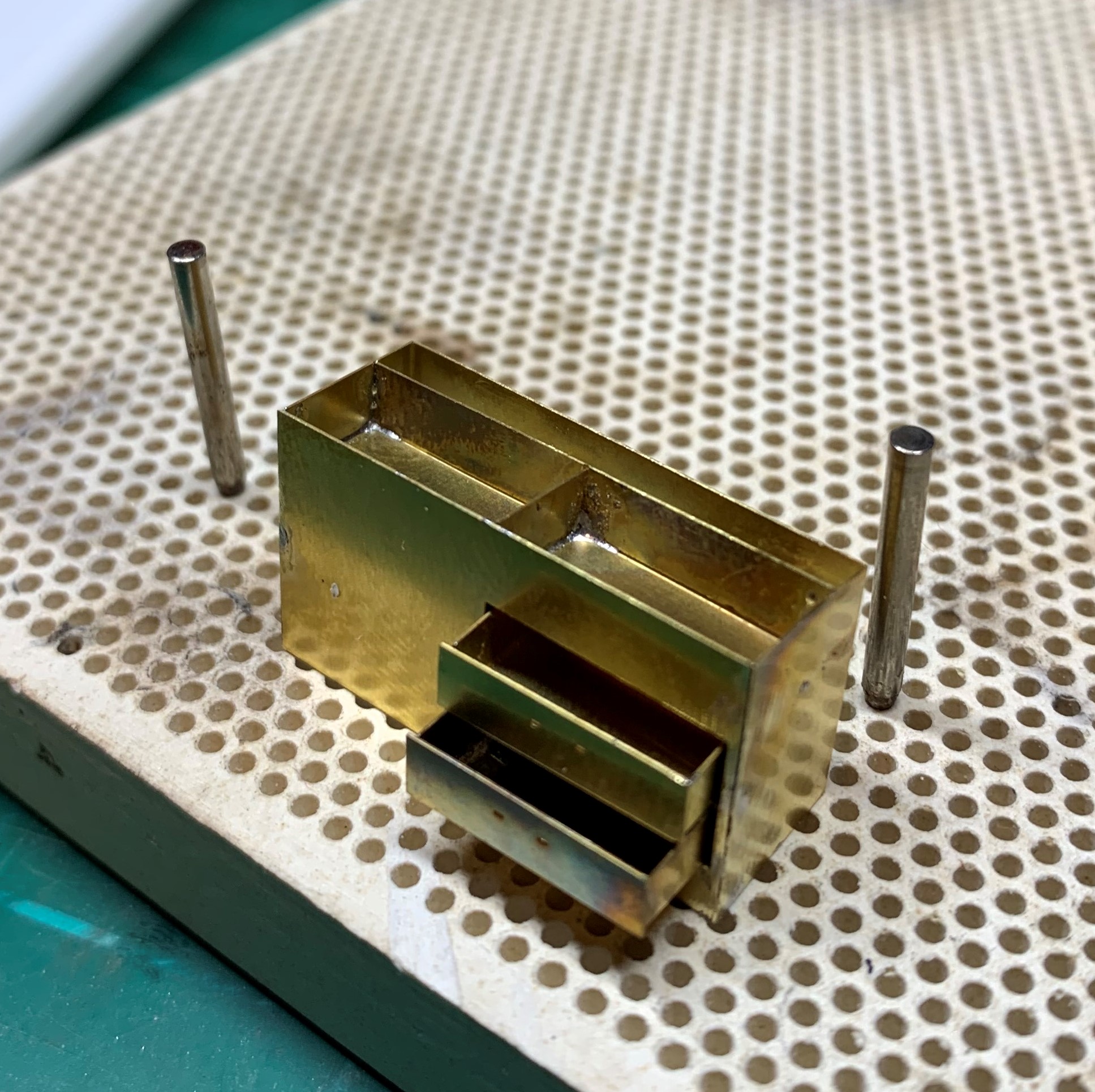

At the tip of the tweezers are the drawer pulls Dragon intended the builder to use. I ruined two between the crazy attachment points and the fact their square peg didn't fit their punched hole. :bang head I dug around my spare PE bin and found some suitable replacements.
Moving forward.

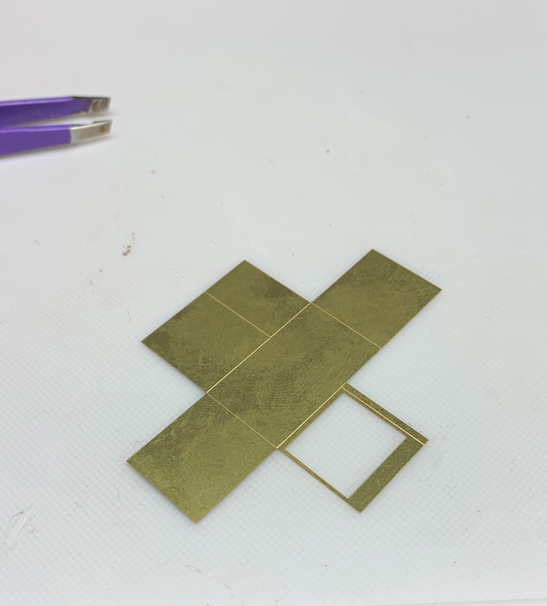

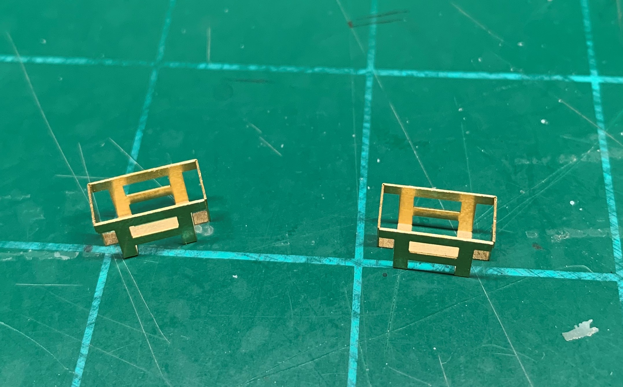

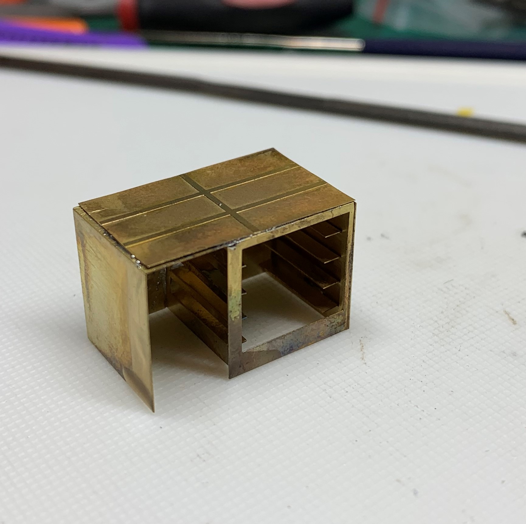

Next victim! Start here.

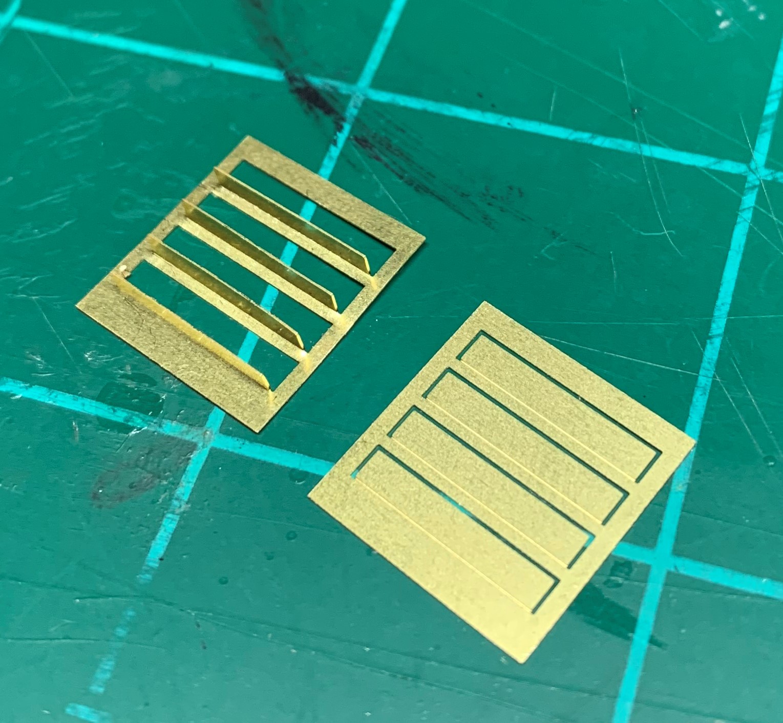

Fold, spindle AND mutilate!

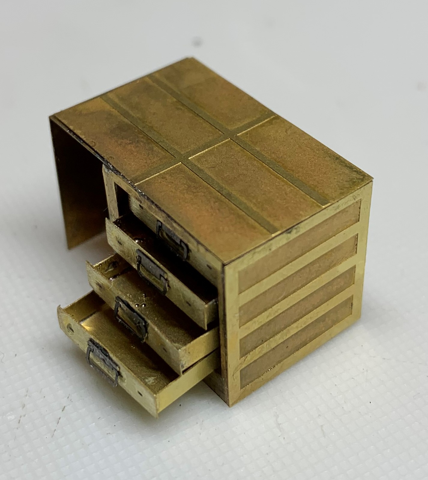

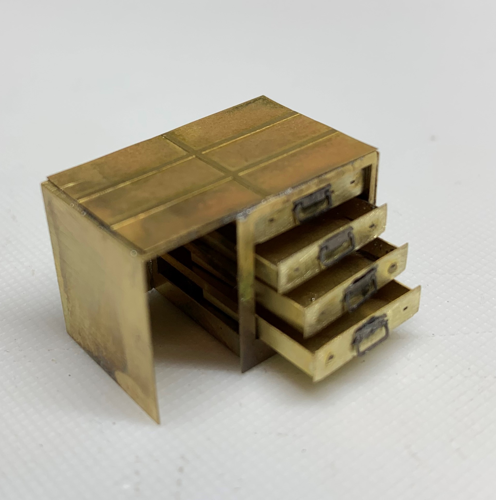

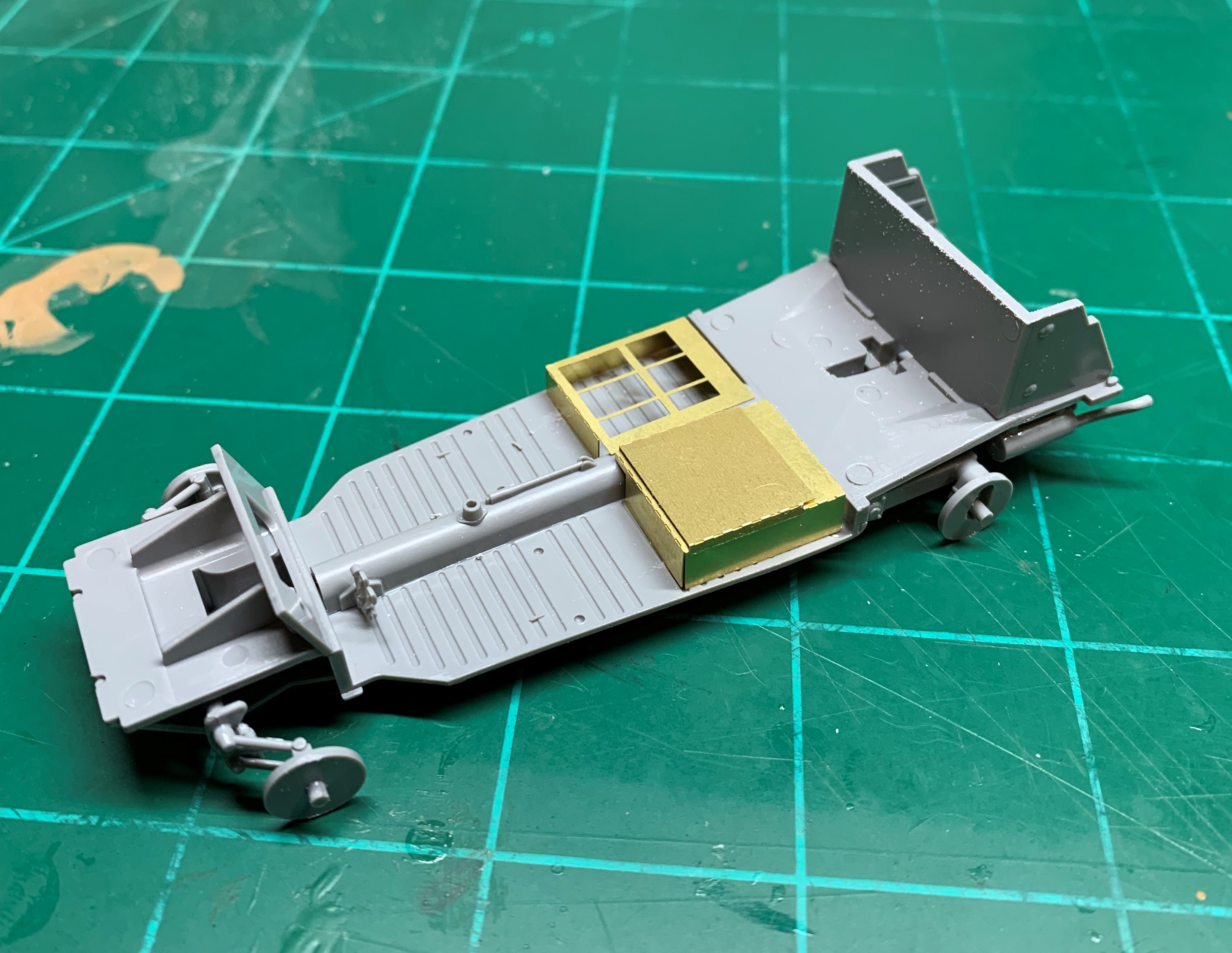

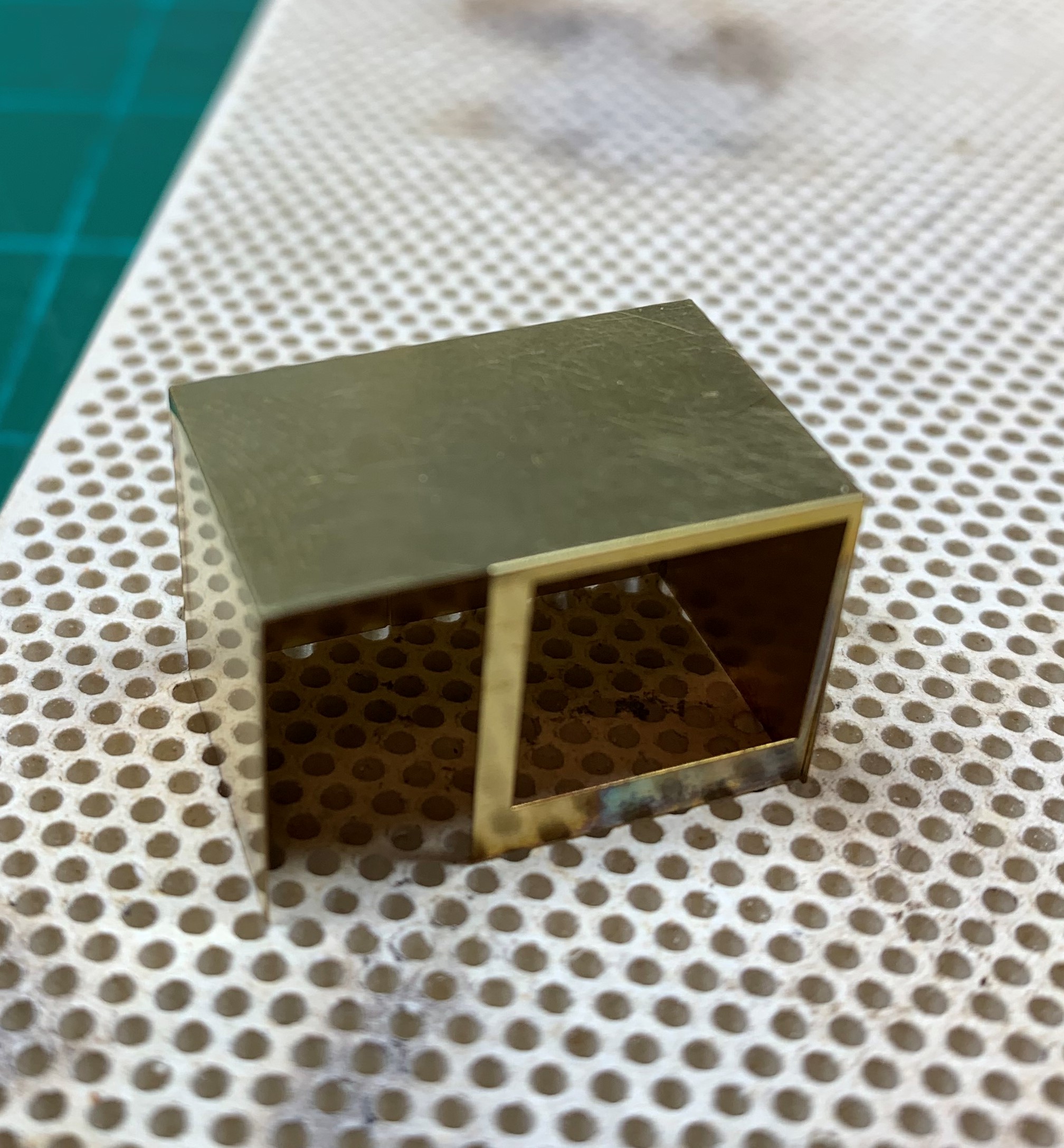

The piece on the left has the drawer guides folded, an interesting task. :eyeroll: Keep going!

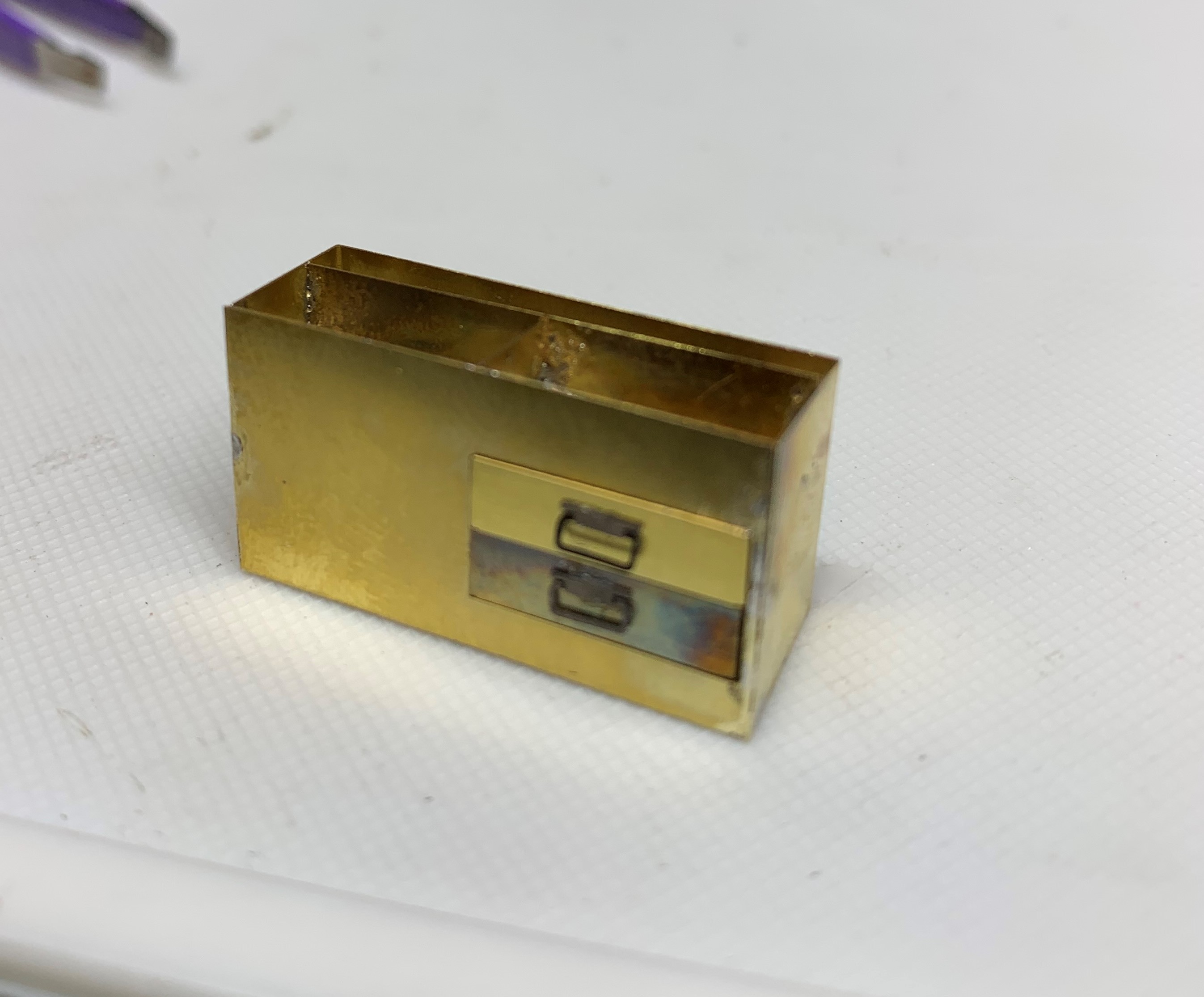

The drawers fit nicely and work!

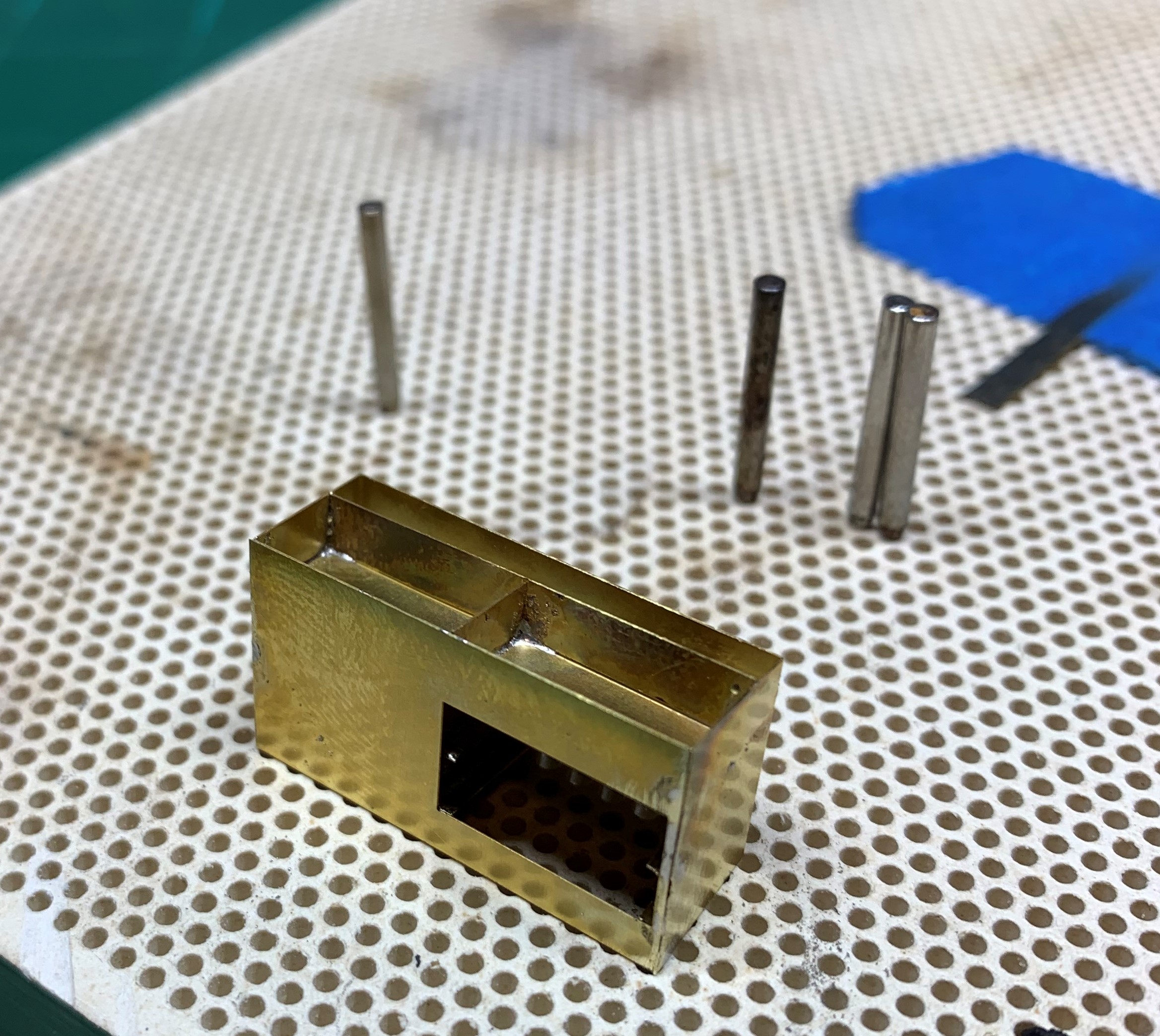

I didn't have enough replacement handles for two per drawer, so I filled the holes and centered the pulls.

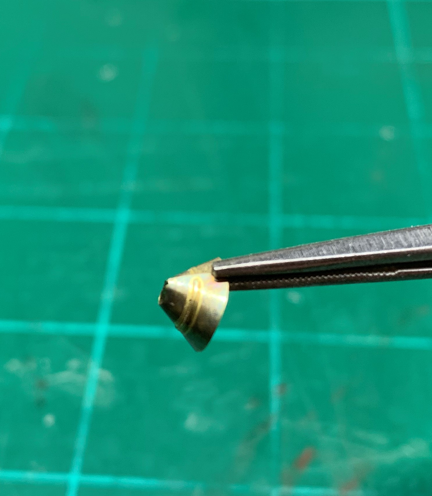

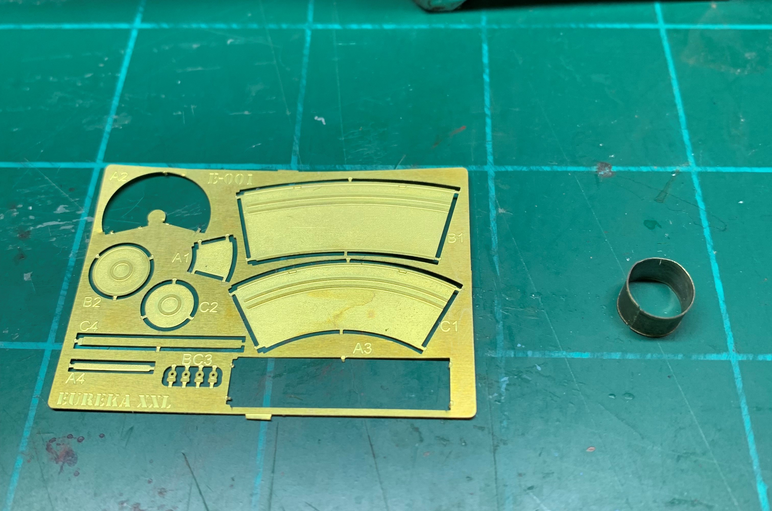

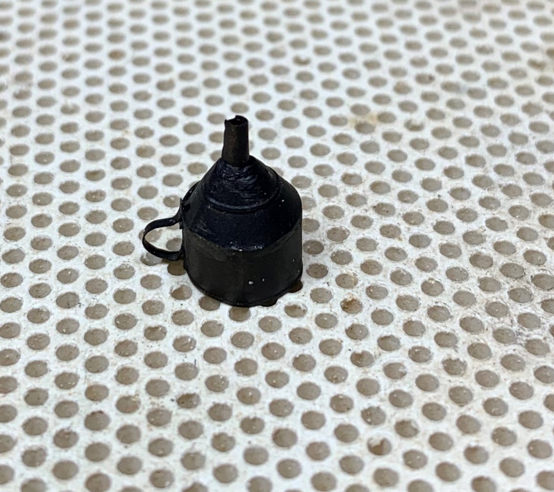

As if that wasn't enough punishment, I've had this brass funnel set forever, never had the nerve to try rolling the taper until now. What the hell? No balls, no babies, right?
Rolling the center section was pretty straightforward, although soldering the butt joint was tricky. Next!
Using my PE roller set from The Small Shop, I rolled the basic shape of the cone, then finished rolling it with my fingers and the rubber pad on the back. No progress photos while the shaping was done, bad words were said. Surprisingly, the smallest piece, the tip of the funnel was the easiest to form. Soldering it up was interesting, more bad words were uttered and I placed an order for some low temperature solder in case the situation arises again. In primer!
