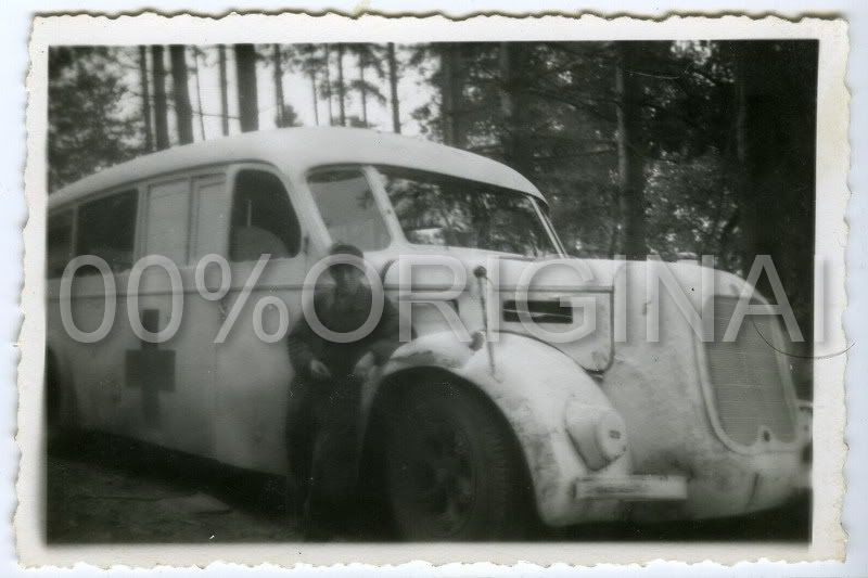

James is right , anything medical and factory produced for the German service branches would be some kind of off white or ivory .
From my [ and Ralph Kramden's ] research , most buses used by the German services were pressed into service and used for just about everything .
Not that there were not buses made expressly for the service branches , however standardised colors for the factory made vehicles are very hard to find and verify .

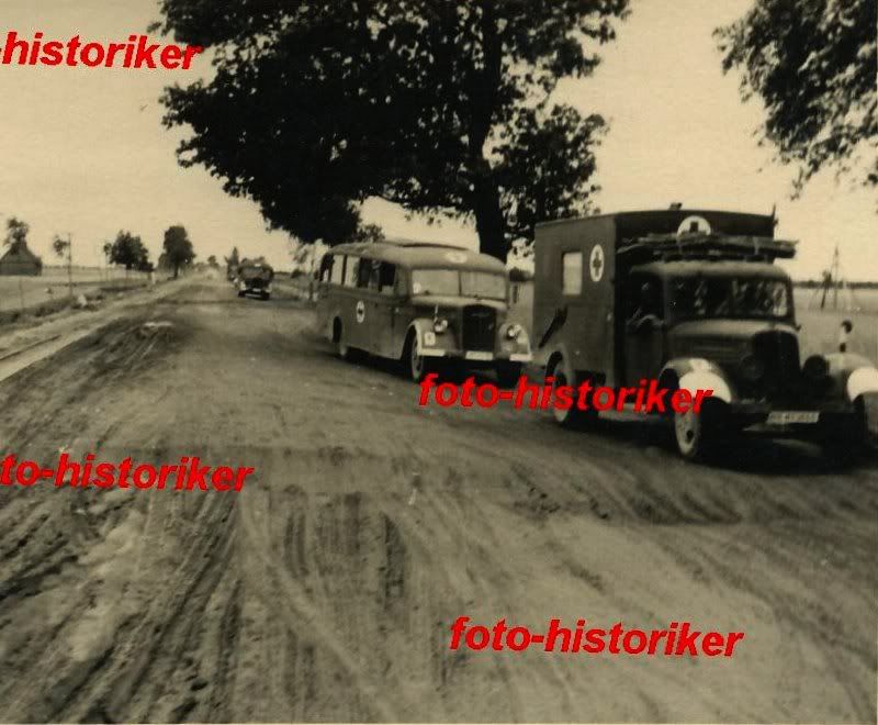

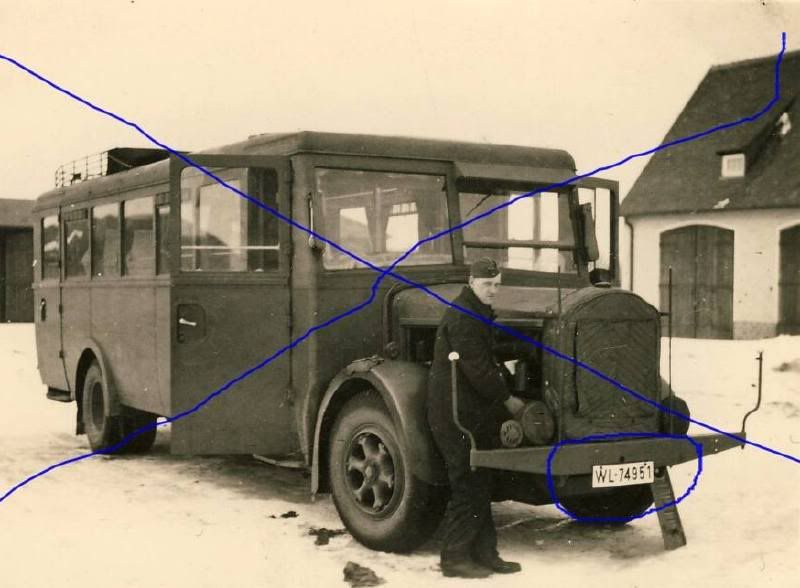

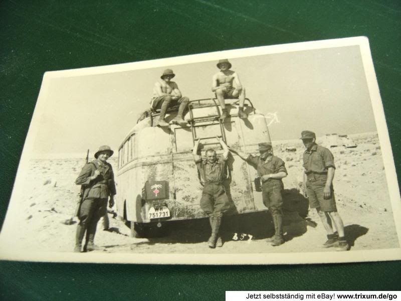

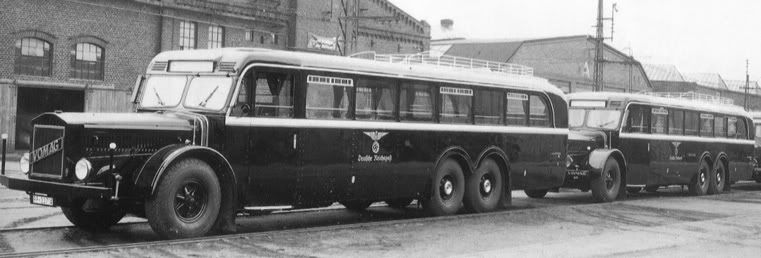

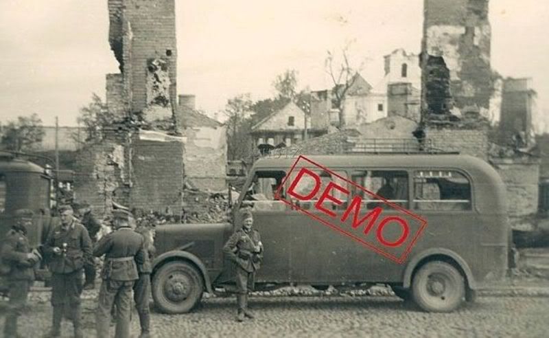

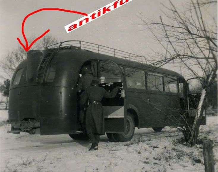

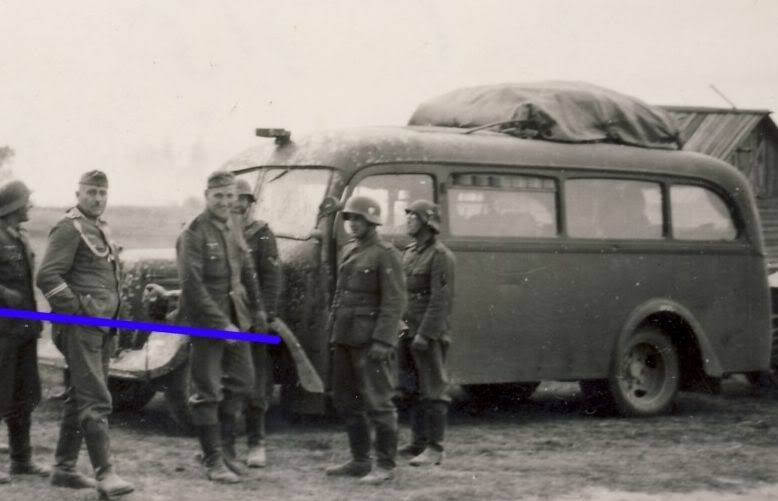

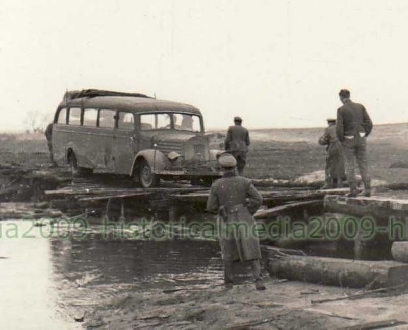

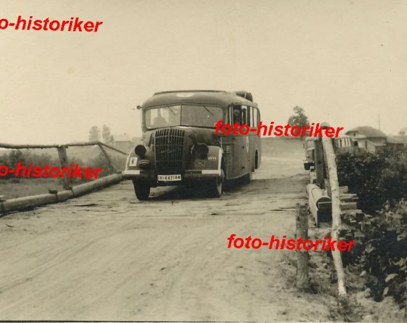

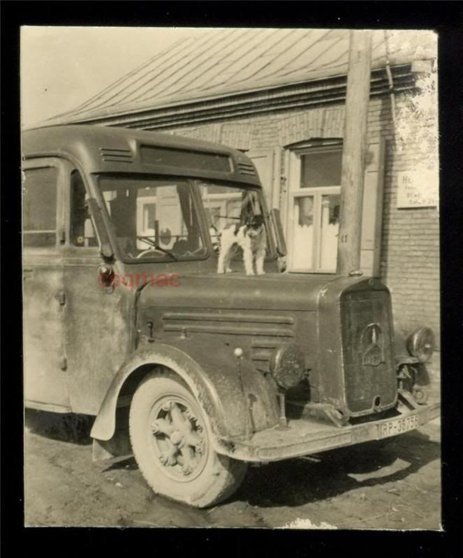

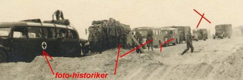

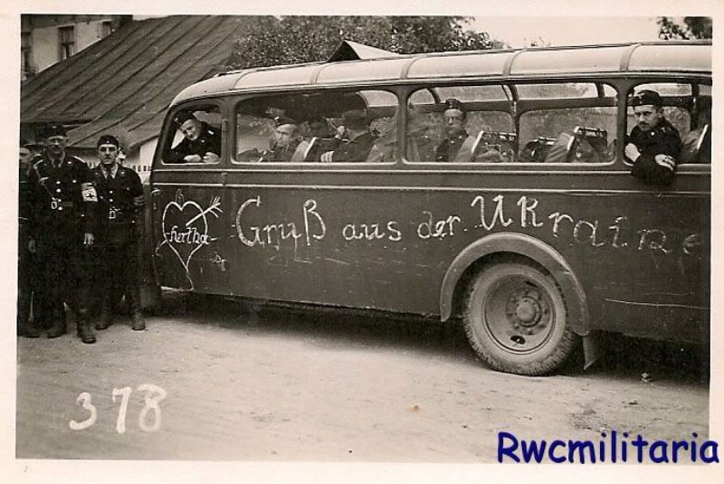

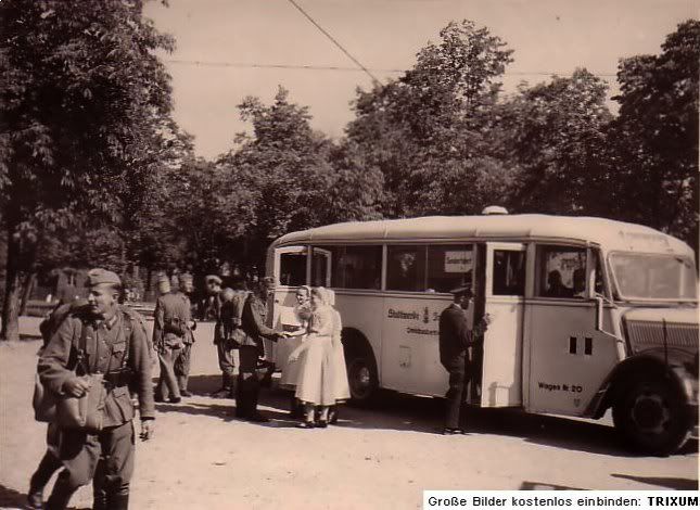

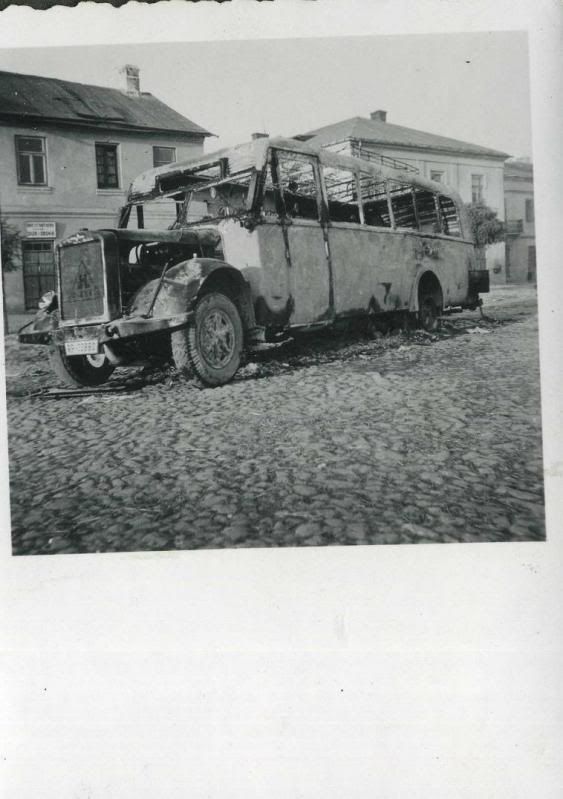

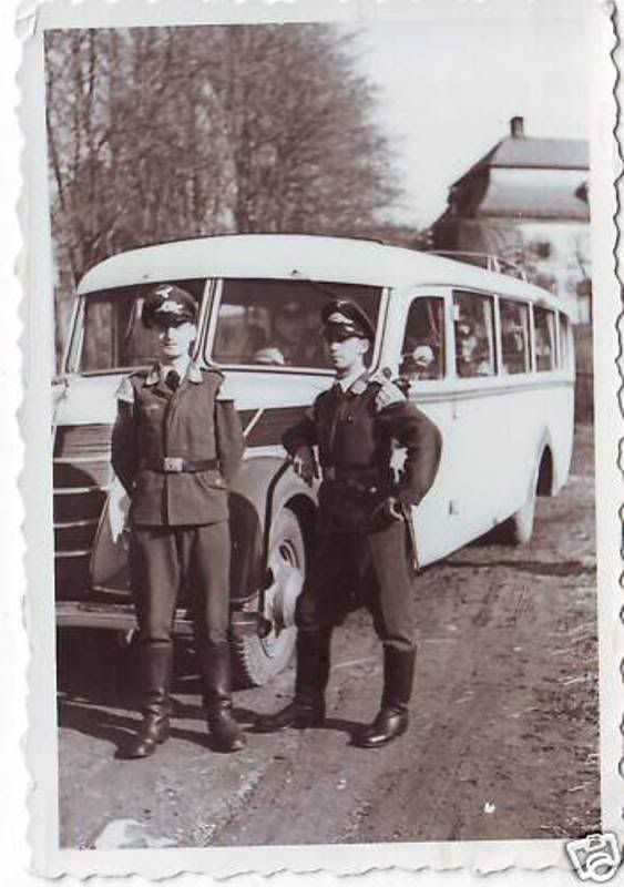

Some interesting bus stuff , Opel , Mercedes , Ford , Hansa Lloyd Borgward , Vomag , Magirus etc.
Sorry for the volume of pics. ........... I was bored this morning .

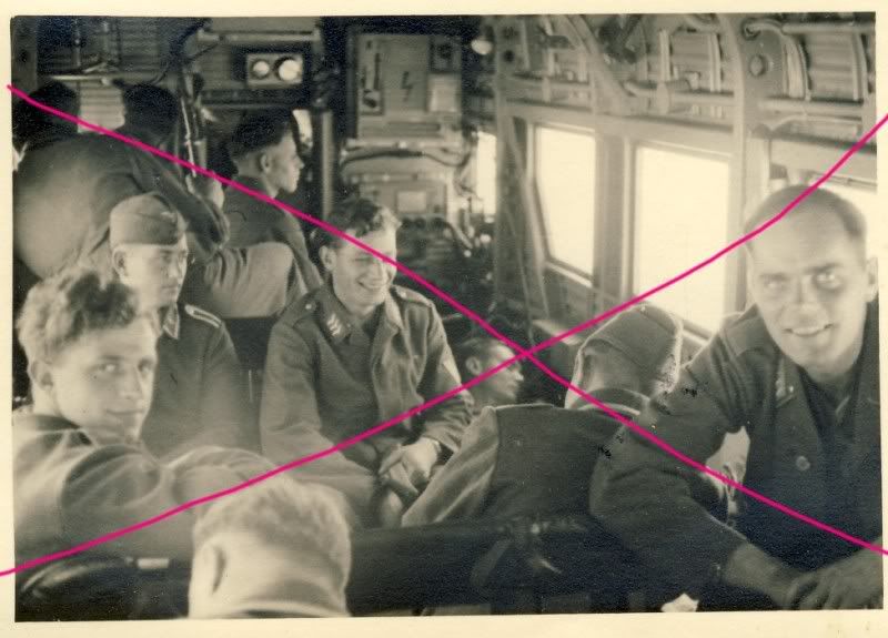

This one here depicts what you get int the kit for an interior,
mainly the wooden seats, which, if I'm not mistaken, probably indicates a built for purpose bus, where as most of the other ones look like the may be commandeered units or picked up already built and pressed into service as is. With this one in the pic the interior looks to be a touch on the dark side so if it is the exterior colour, it may be dark yellow and not Panzer Grey. Opinions most welcome.
