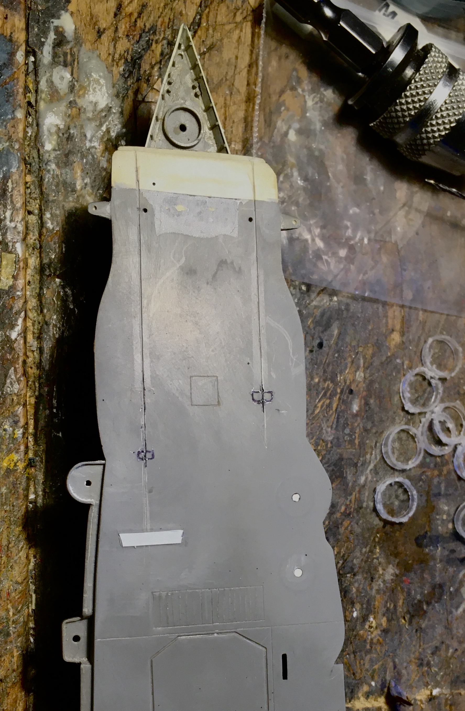

First, all these portholes have got to go! Plated over, sanded. A few left open for interest. The forward barbette mounted 128mm twin gun mounts are removed. They would be useless in the heavy seas of the North Atlantic. Additional hull plating and a healthy spray shield forward should keep the worst of Seas off the flight deck. Lengthened flight deck to accommodate more modern catapults. Gone are the clumsy, inefficient launching tracks and carts.

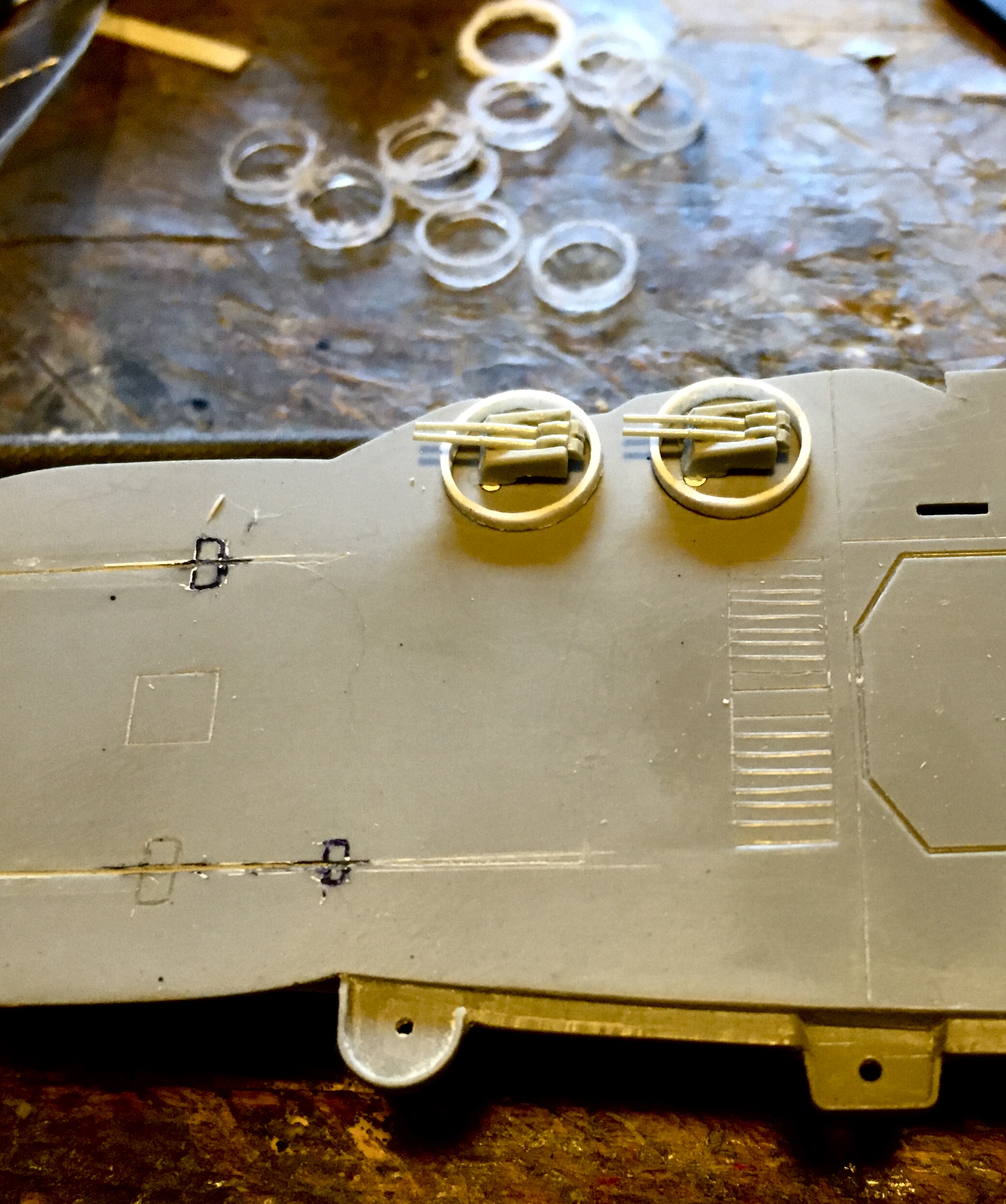

After a long hiatus, I have returned to my work (play) space. My honey says she is NOT a guest and I can model anytime I want, I just clearly chose not to. The trial fitting of new gun tubs for the resin 10.5 cm twin guns and added a JBD to the port side catapult (To deflect Jet Blast of course!) since more than one sort of German jet aircraft may operate from GZ. I may have to sacrifice the forward most gun mount. We'll see how the the clearance for the starboard side propeller driven aircraft catapult looks later on. :hmm: I finished off the kit hull platforms with spray shields. I am near sure the hatches would open toward the inside, but I drilled a hatchway and added the external 1/700 German Navy open hatch p/e part nonetheless. :bang head
