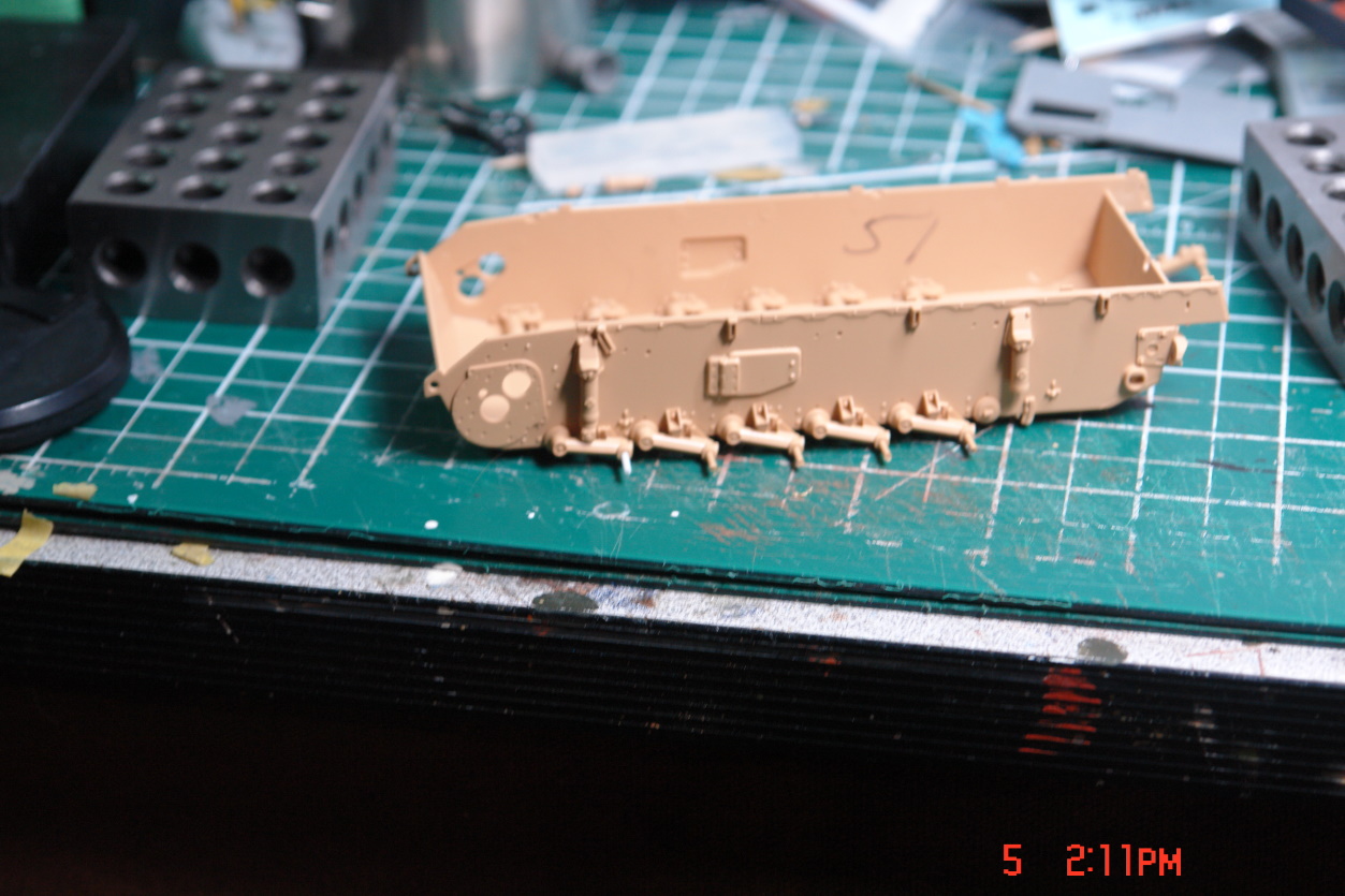

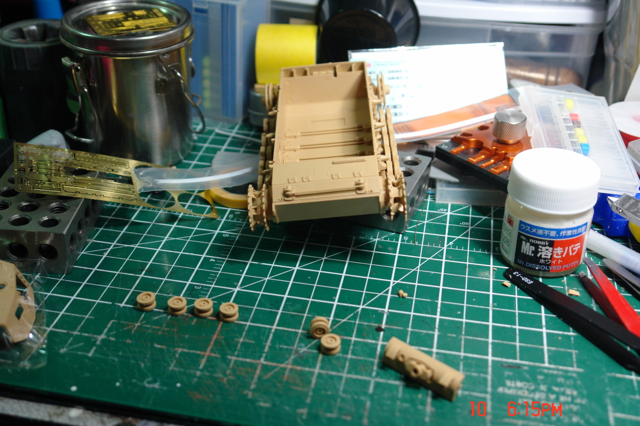

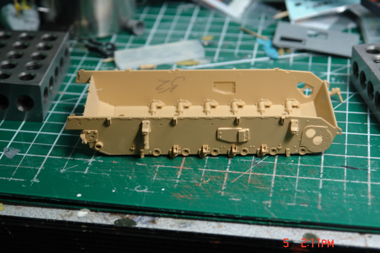

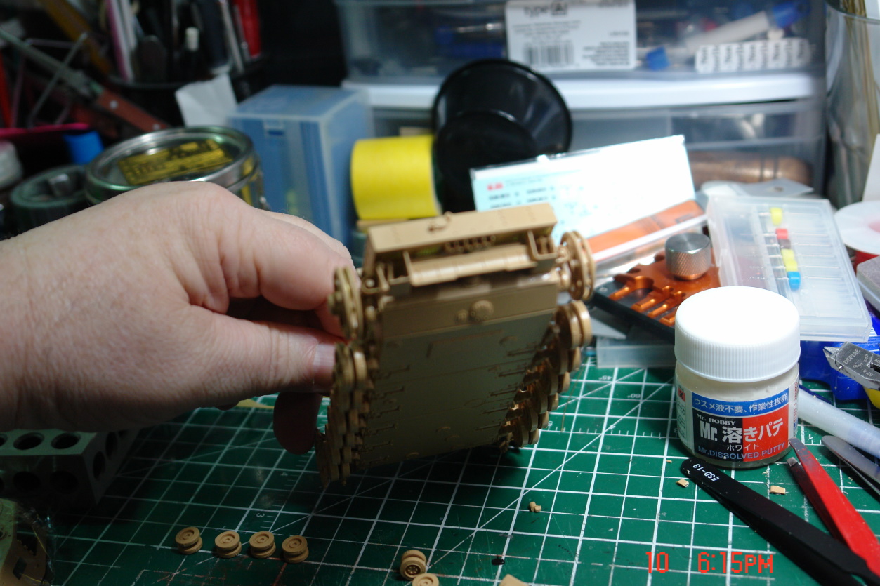

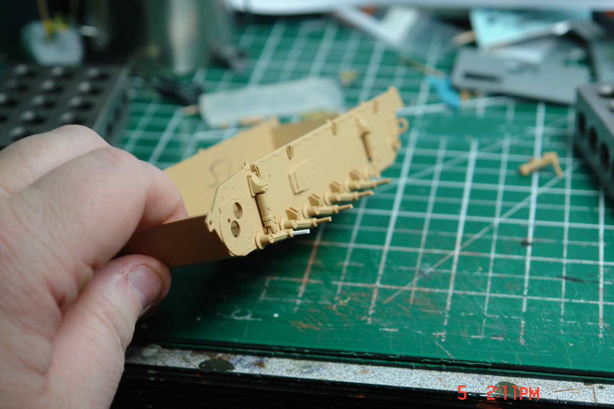

After 2 hours I have the tub built and started on the suspension. You can make this moveable and even the shocks can be made moveable. So cool or so I though. I cut out the little pegs that would make this a static build and built ip the shocks. Unfortunately despite my bib one piece flew off and I broke the axle getting it. So drilled out the arm and found some proper sized plastic rod and made a new axle. I got the suspension arms on one side and here I found an issue. With the Dragon kits the tabs are slightly angled so the arm is properly positioned They dont have working shocks though. This kit is almost the same method but the tabs are straight. So the arms are already sitting pretty much bottomed out. So not to figure how to deal with this problem. I dont want my tank looking like all the torsion bars have given out and its sitting too low. Something to think about after this freaking kidney stone stops beating me up. So where I am now.

So far I like it. I thought the 3 peice hull would be a pain but it all fits nicely. The only thing to this point that Dragon did better was the torrsion bars As I mentioned they are angled and so put the idler arms at the proper angle. Both kits are the same in having the little nib you cut off to make the suspension moveable. RFM made the shocks moveable so they score points there also. Hoping I can finish the hull before work tomorrow if my stones will let me.

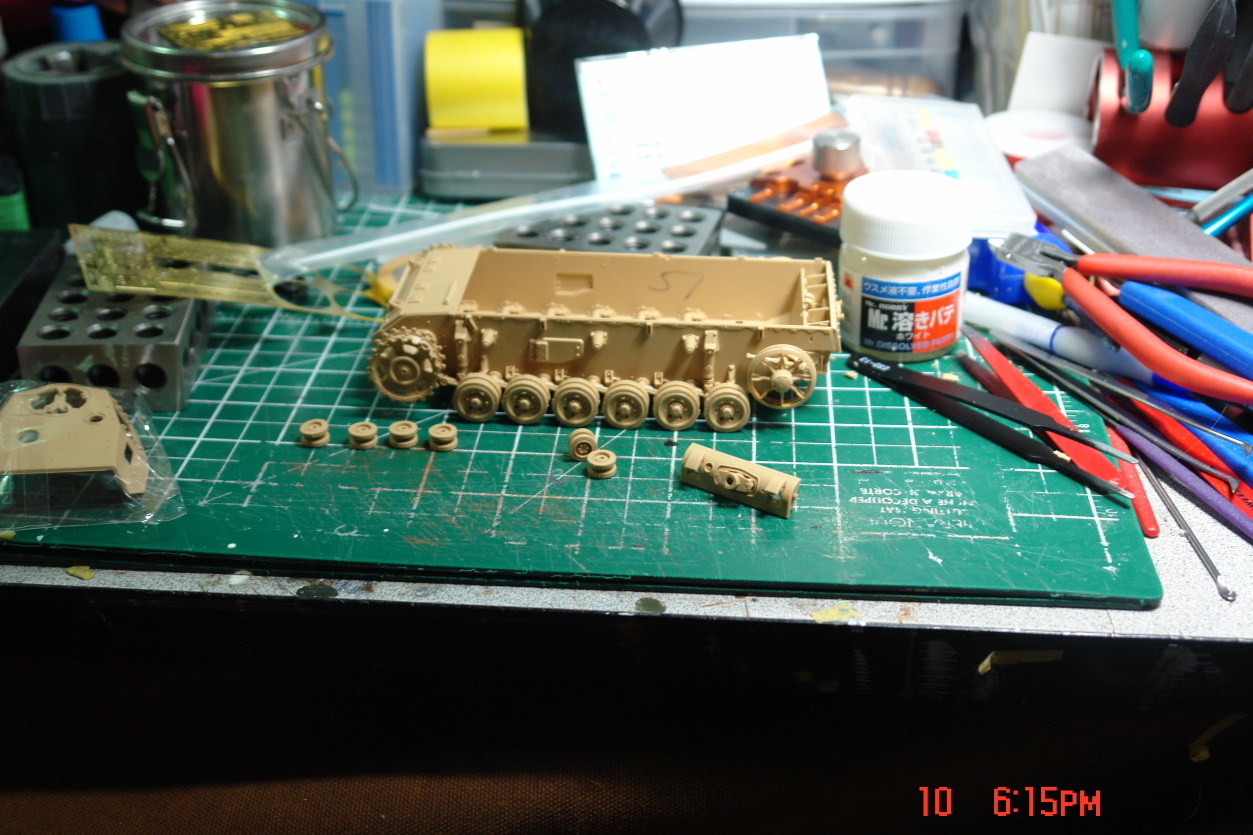

Okay its all worked out now. So build back on. Slight change because I can not find pictures of the markings I wanted to do. No probs I have a Pz III Ausf N which will work and a picture to boot. So now I am going to do a Stalingrad tank from the 24th Pz.Div. It means I will have to scratch build a box for the rear deck but I have pictures so think I can do it. Unless of course someone has plans and measurements in which case it will be even easier. So today finished the hull pretty much. Working on the turret a bit before I go back and work on the super structure. As i feared the suspension will not hold the weight of even half the tank. Will have to glue the suspension at proper height.

Of course I forgot the camera so this never happened. But if I did take the camera you would see the gun finished and the turret almost complete as well as the tracks started. I like them. Small and fiddly but they do work. Its cool also that they give you inside and outside pins. So if I can manage to get downstairs again tonight or tomorrow pics will follow.

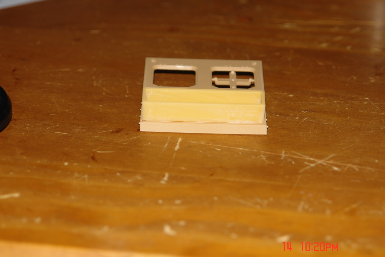

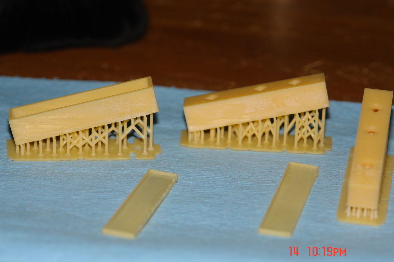

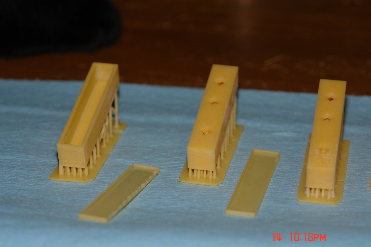

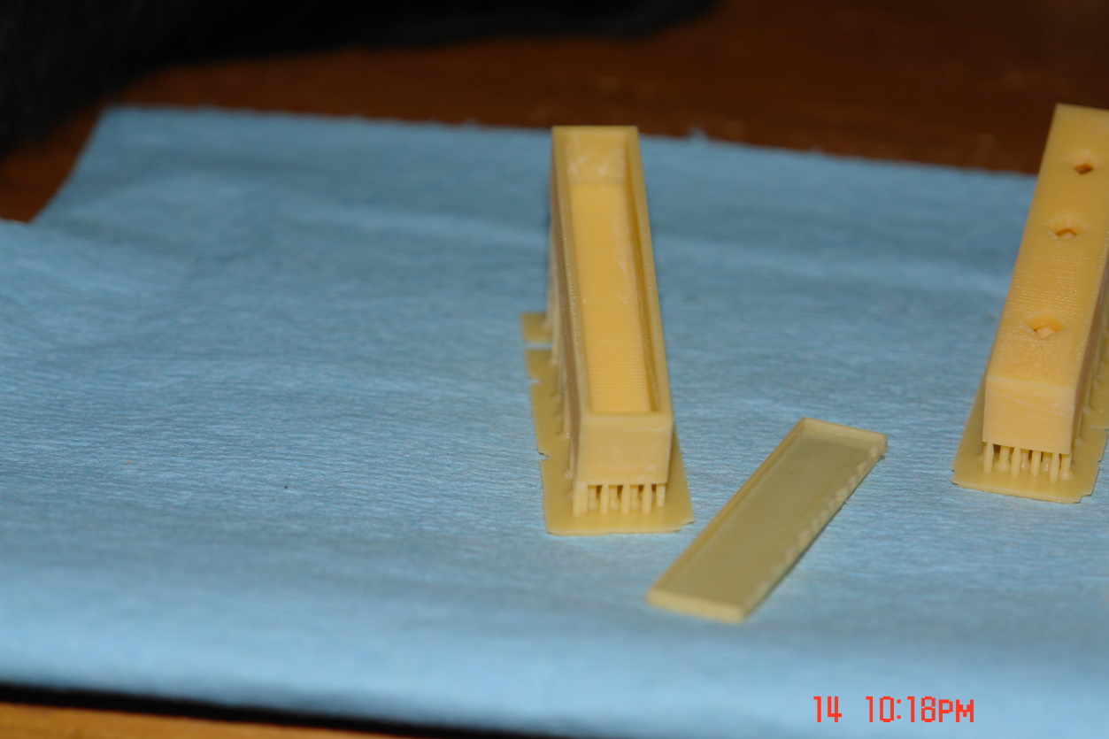

Finally got the new prints done. I made one box with 1mm sidewalls and 3 totally enclosed. As it isnt good to print a big block due to waste of resin I hollowed it out. Then added some holes as it is not good to leave resin inside which can split the item from what I have read. I dont know why the holes are on top though. I was sure I had them on the bottom for drainage. No matter they are done. Now to detail them a bit and work out how they were attached. I can not find a good pic and the 24 PD built and mounted theirs different than everyone else. Last pic shows the box on the engine deck. Just a little shy of proper size I think but darned close. I am happy. BTW this is using the water washable resin for the first time. Not as smelly but not sure if I am totally happy with it.
