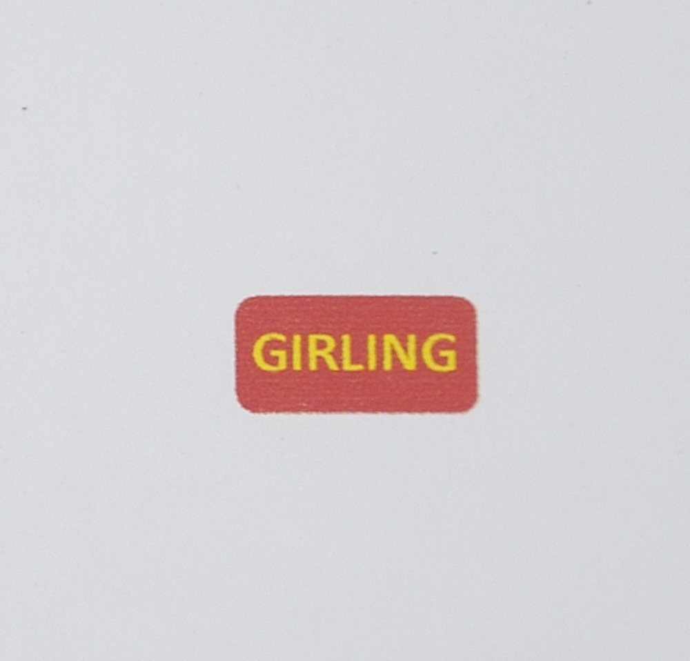

today i managed to get a design quite small without loosing to much detail/resolution.
It means i have to design my own decals first as i can t seem to do this with cut/paste of internet pictures but its a start.
First picture is the design printed on A4, it measures 8x4mm which is about 1:8 ish. (thinking about Revells 1:8 jag)
and this is it zoomed in, it is actually sharper than it looks, its just camera shake.
The quality of the paper can make a big difference on the sharpness of what you are printing. That is looking really good Paddy.
yea this is just a4 copy paper buy the decal paper i have was made by BMF. From memory last time i tried it many years ago it smudged.
Inkjet printer? All in flurry, were we?
I put my images in a Google Document. Sizes can be reduced up to a point without losing much resolution. The printing menu allows you to further reduce or increase the size of your images again if you need to.
I print my decal proofs on glossy photo paper, fit them to the model, make notes and proceed from there.

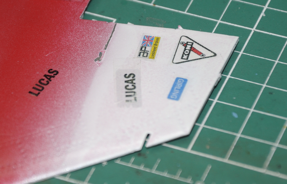

More progress today printing on transparent decal paper, in reality i will need to do this on white paper in most cases as you obviously cant print white
The yellow strip is 10mm x 1mm and the letters are half a mm tall and still very readable. Considering its a very cheap inkjet printer its not bad on resolution but it fails a bit on density of colour which is just down to the ink.
Anyway the above shows that this 1:8 Jag is going to be covered in decals :)
Sorry if this is all old hat to most of you who have probably been making your own decals for the last 50 years :)
