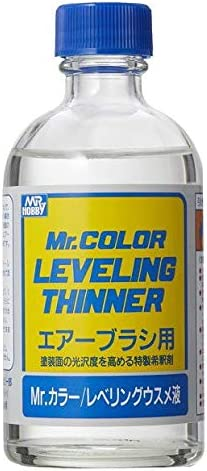

The secret of spraying Tamiya or Gunze ( aquos ) is using the Mr surfacer self leveling thinner around 50/50.
It also works with AK interactive lacquer paints .
Regards, Christian .
Thanks, i will order some mr surfacer, the AK paints seem to be the same as the Mig. its shame because the Mig Ammo paints are nice but they stay wet on the palette but the air pressure /flow seems to dry them on the needle almost instantly.

Tamiya , Gunze , AK real colors are all petroleum based and work will with this thinner. I think you will also get it to work with Humbrol since it is enamel ( which is petroleum based ) .
All in all , the many paints have their own properties and are formulated to work best with their brand thinner .
That said , the leveling thinner seems to be universally good with Petroleum products

I have thinned tamiya acrylic and gunze acrylic with Mr thinner leveling thinner with no ill effects. My main paints anymore are Gunze, both acrylic/lacquer, MRP, and AK real color lacquer based.
